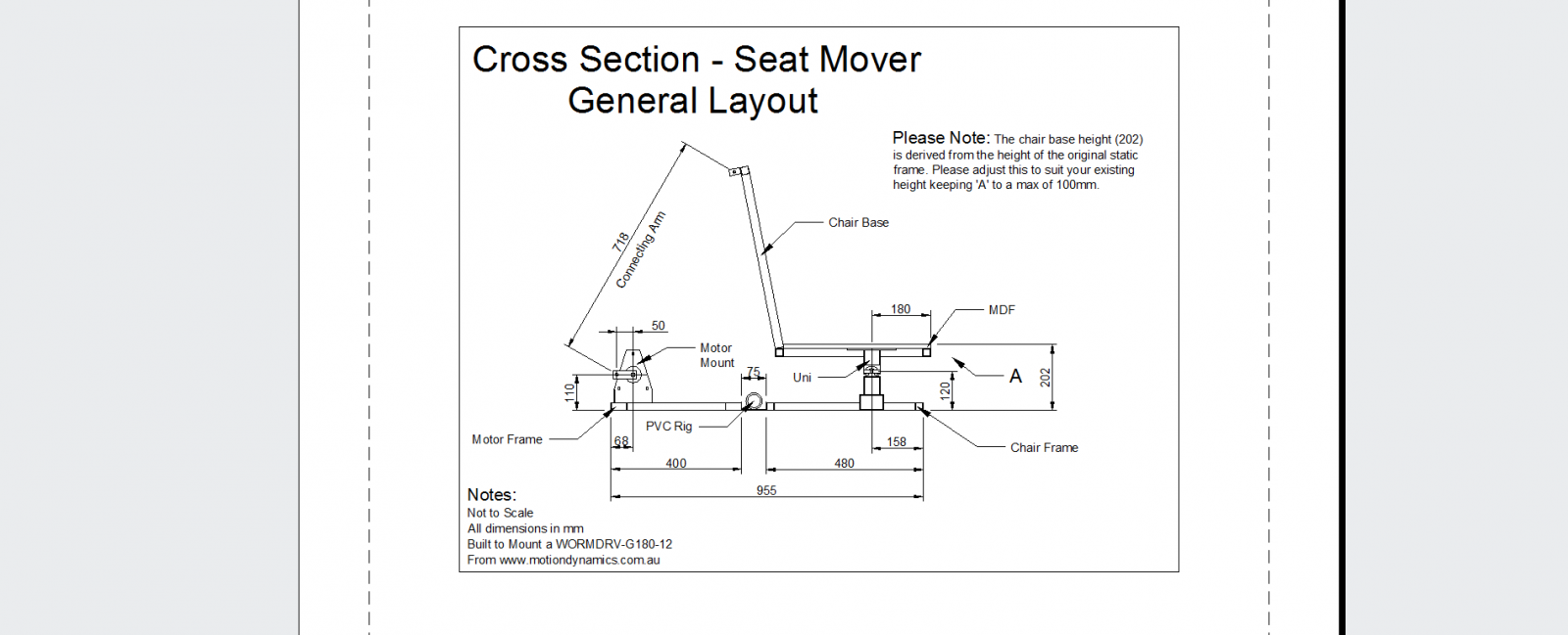

    I dont like wipers myself they can be a bugger to isolate the ground from and the internal gearing is very weak.
    A few of use use this, http://www.motiondynamics.com.au/worm-drive-motor-12v-24v-200w-180-rpm-20nm-torque.html
    And drive them with this, http://www.pololu.com/product/1393
    End result running both of the above.
    Plans are avail for this simple setup, For example.
    This is about 800-900 Aus dollars to buy everything including the simple PVC frame to hold the screen, pedals and wheel, 2x motors and 2x controller and DC power supply to be up and running in no time at all.
    This will produce about the same in some cases even faster reaction times than most actuators can move at too. The electronics are very simple only 7 wires to connect, no programming needed or special converters either. Setting up the Jrks with their own software is fairly easy as a few of us have them and can share settings among us.
    Good Luck in your build, I hope you have fun, I know we all do.

    Its interesting that you talk about cost, a pair of motors, pots, jrks, etc works out about $500 ish and these are stronger, faster and quieter than actuators.

    Cost is relative to the amount of work you can or want to do yourself.
    Since starting my sim I had always planned to upgrade to linear actuators from the wiper motors I started out with, I suppose if anything they look more commercial/professional if that's the look you are after, and to be honest I still struggle to get my head around the output of the JRK's for their size.
    However for the sheer results from the speed of the wiper motors and the tuning you can't beat the performance of a DC worm drive motor coupled with a JRK.
    For a beginner it is the best place to start, some of the positives being, no programming skills or code required, limited wiring skills, and for the most part all of the mechanical parts are exposed and maintenance is easy to undertake.
