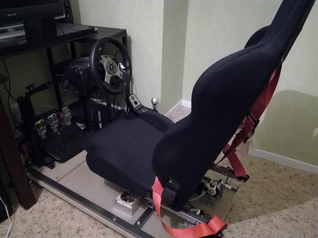

    Hello guy,
    This is my current seatmover, work in progress.
    It's a 2 dof with 120W DC motors and a sabertooth.
    The wheel is a G25.
    For the moment, i play on a old 720p TV, but a would like an oculus.

    As your refine your motion profile you may want to add some more heave and surge, with the latter also configured for gear shift effects: https://www.xsimulator.net/community/faq/snappy-gear-change-motion.121/

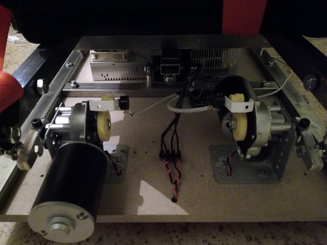

    There is flex of the motors, particularly the one on the right. You will get even better motion if you fix that so there is none.

    Thanks for your advices.
    For the gear effect, i will configured it when i will receive de diy version 2 of simtools. I have send a mail but i still wait for it.
    For the flex of the motors, i initially posed a second square, but the cam is to long and stops in.

    New video where we see the comparison of the support motor with 1 or 2 brackets. The difference in rigidity is blatant.

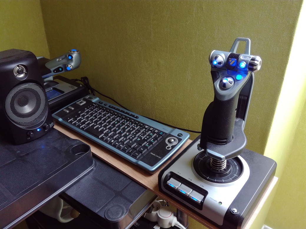

    Hello CreazyRider. When i want to play flight simulator, i just permute pedals, and i play with joystick on my legs.

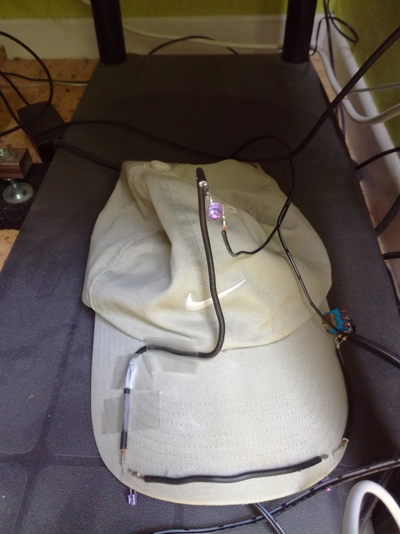

    What is the cap for ? head tracking, to turn the view ?

    Yes, it il head tracking, working with eye toy, but i don't really use it.
