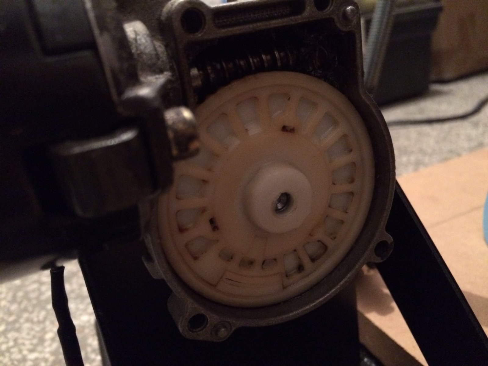

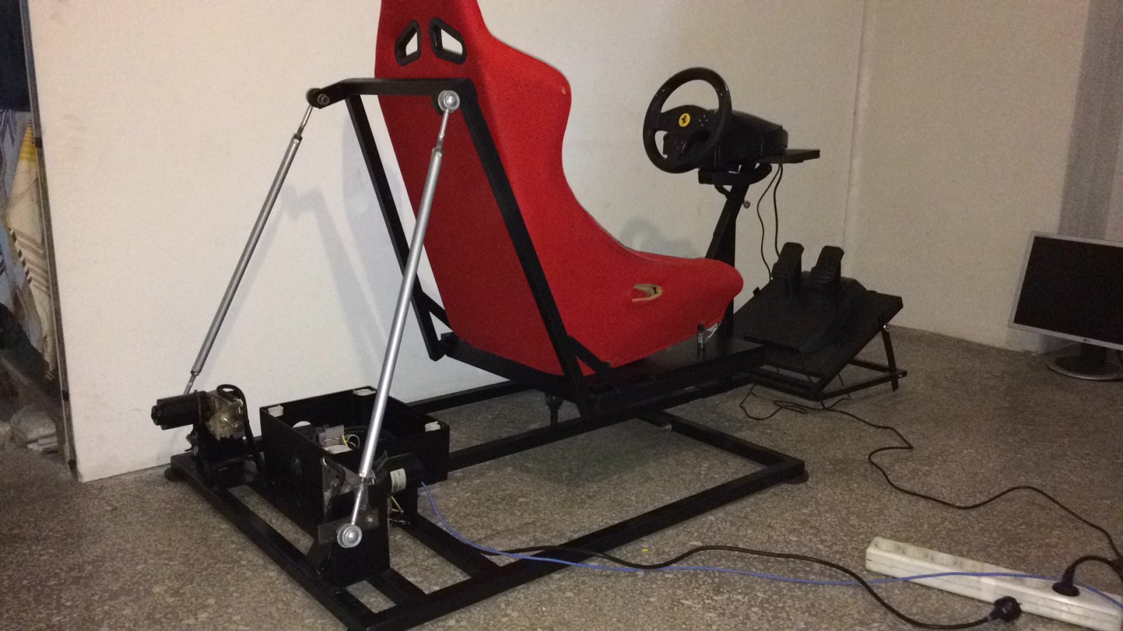

    Because I never had a static Sim and had to start from somewhere i decided to build a low cost 2dof seat mover shoulder mount with wiper motors, Arduino, motomonster and with @RufusDufus SMC3 Arduino 3DOF Motor Driver and Windows Utilities so i can get into the spirit of racing simulation and motion too.
    And the project begins:

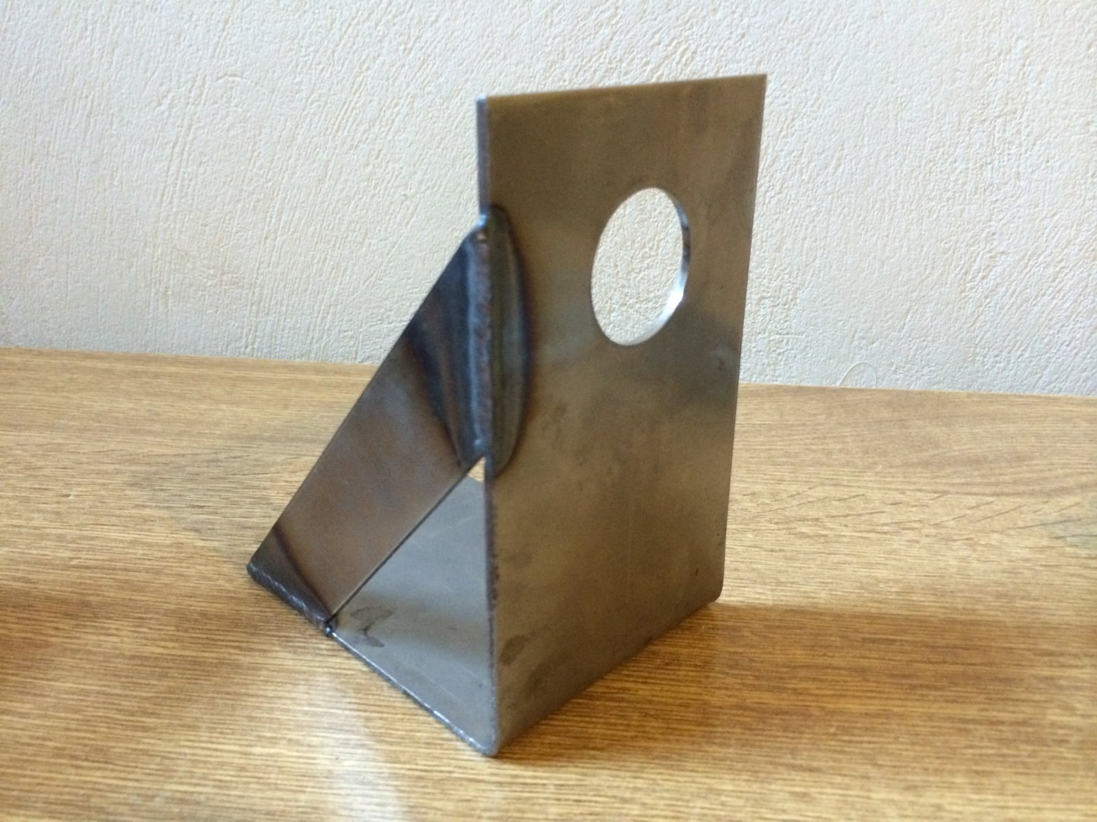

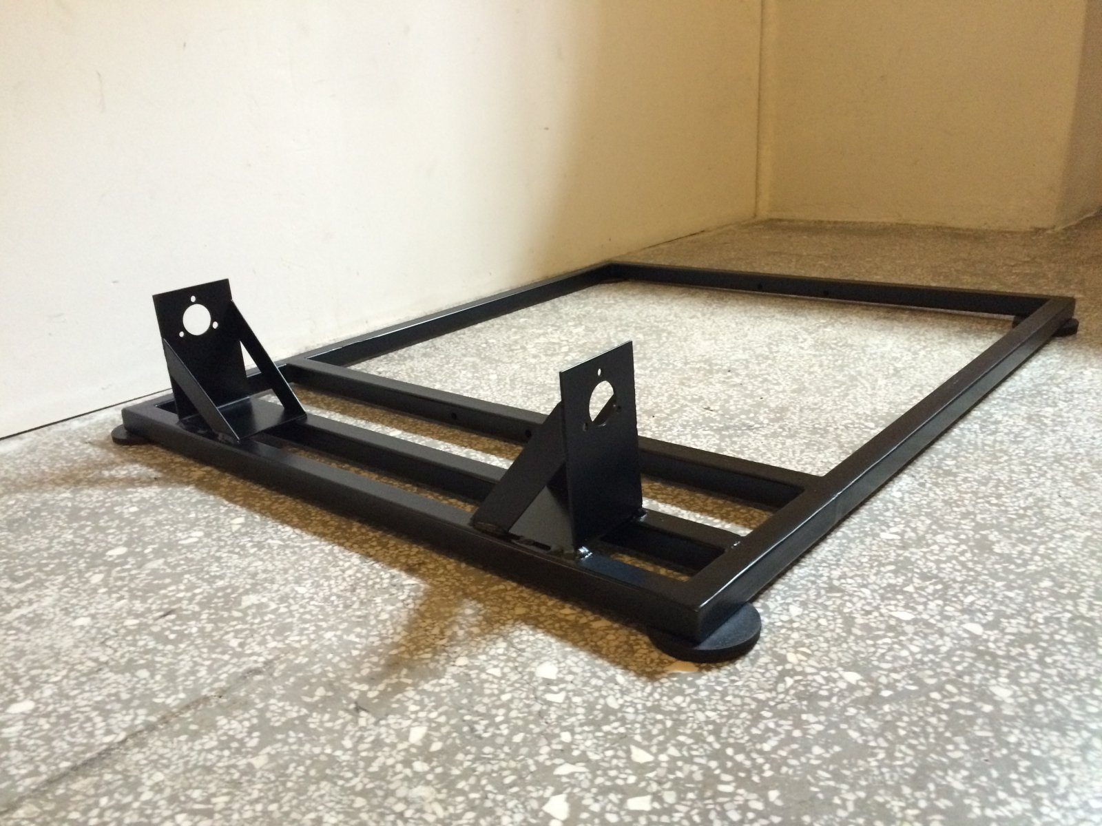

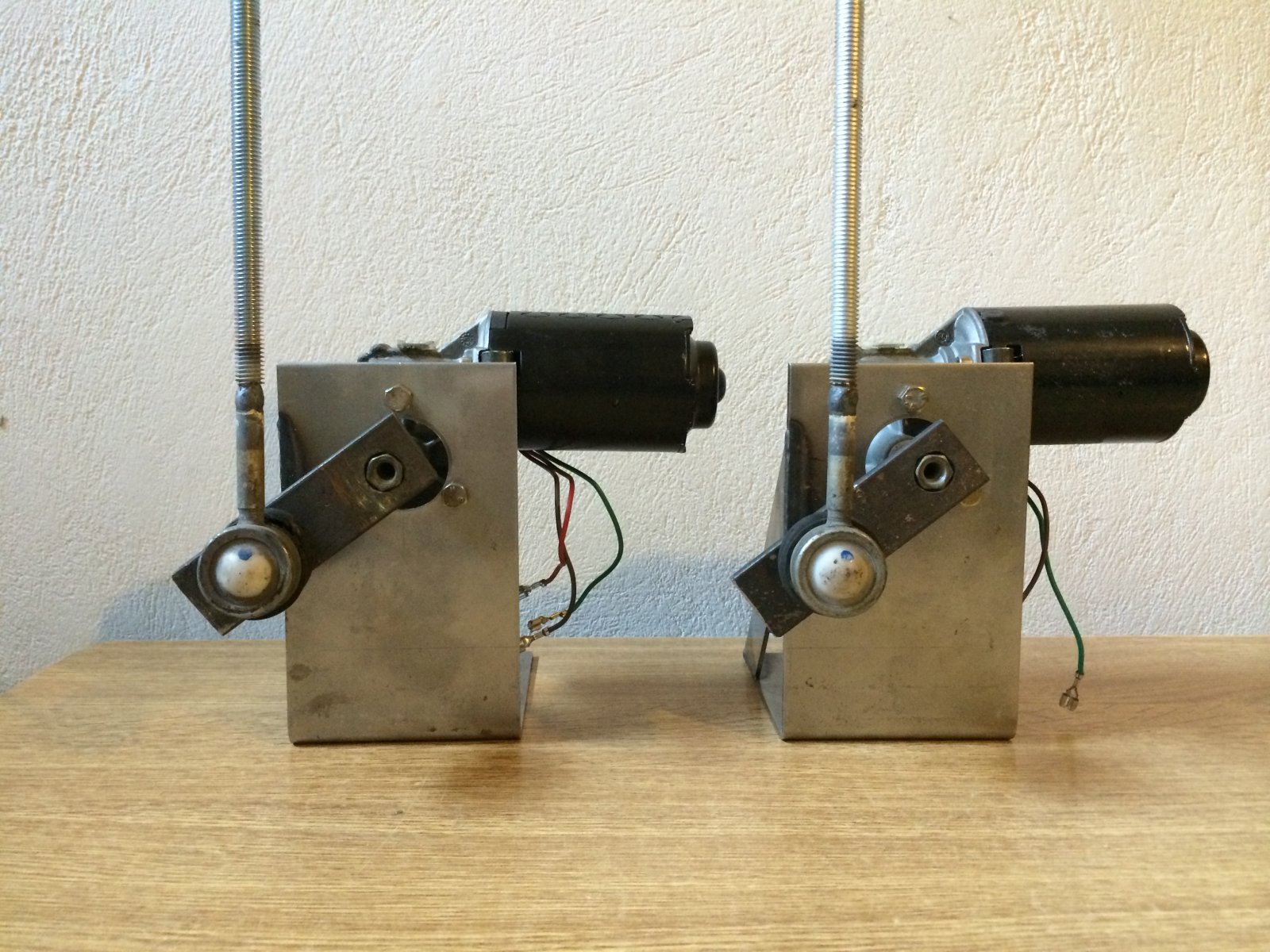

    motors mounts:
    3mm steel needs some reinforcement to be stiff

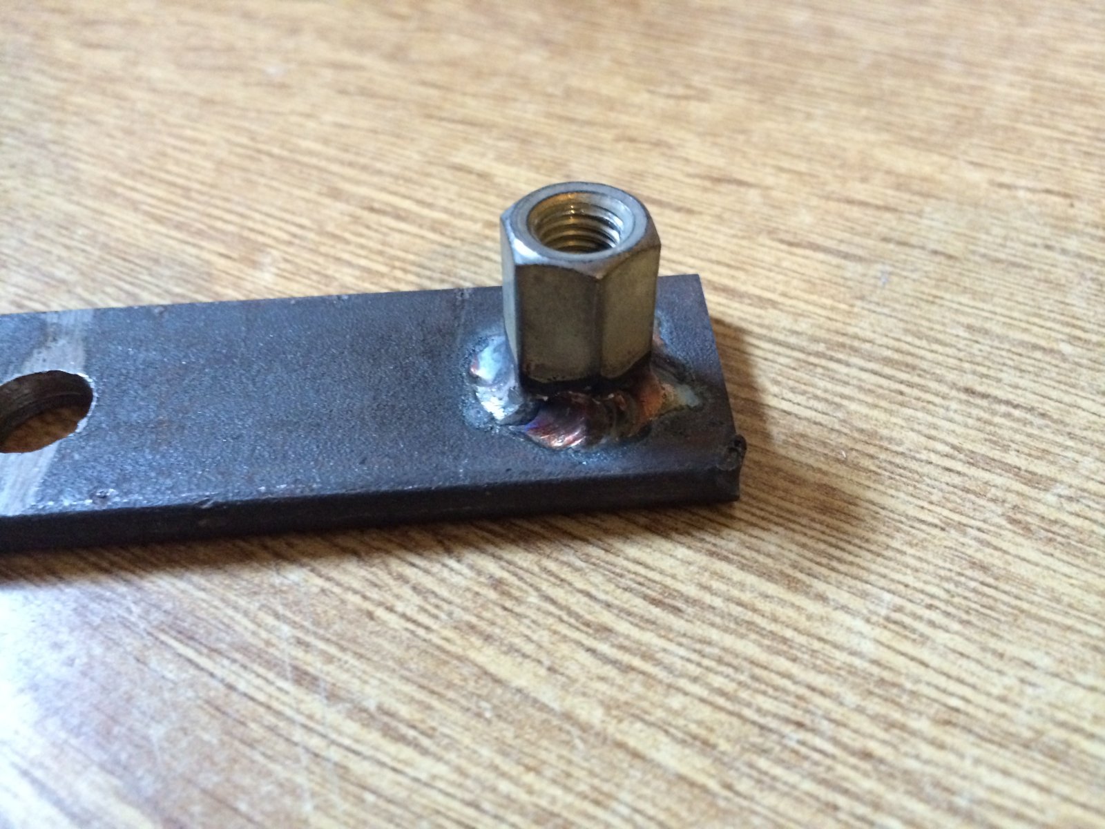

    CTC levels:
    5mm steel and CTC is 50mm

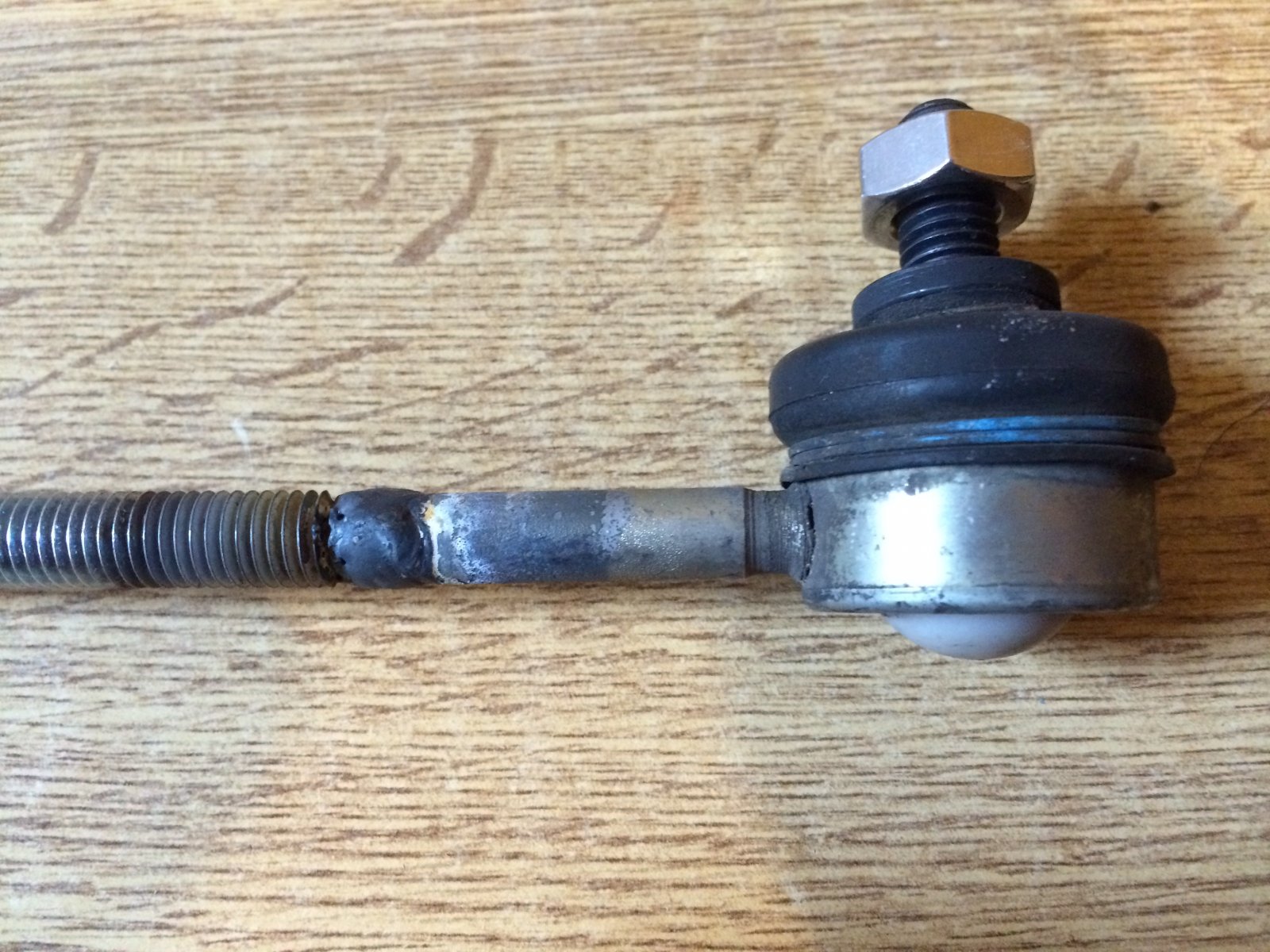

    Motors rods:
    steering rods bought from scrap yard cut and welded on a 10mm threaded rod
    Motors :
    Magneti Marelli from scrap yard. Didn't need ground isolation but needs to be checked

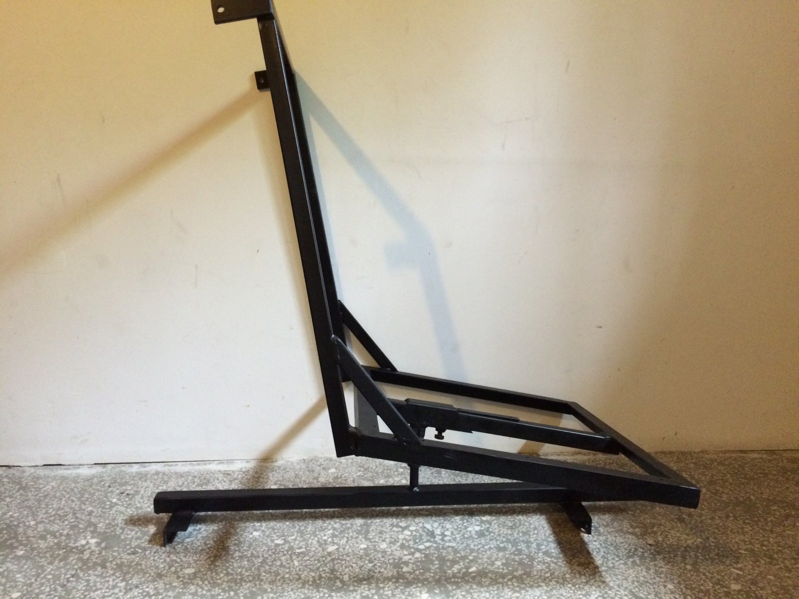

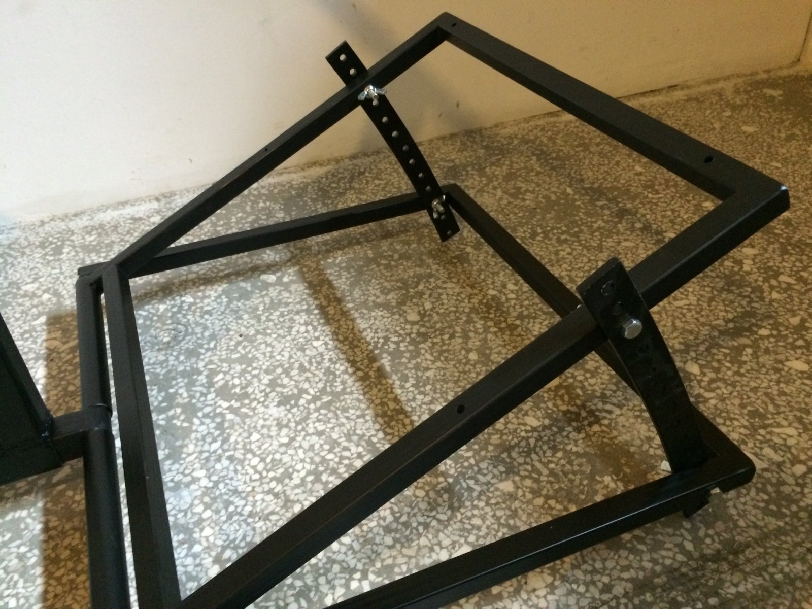

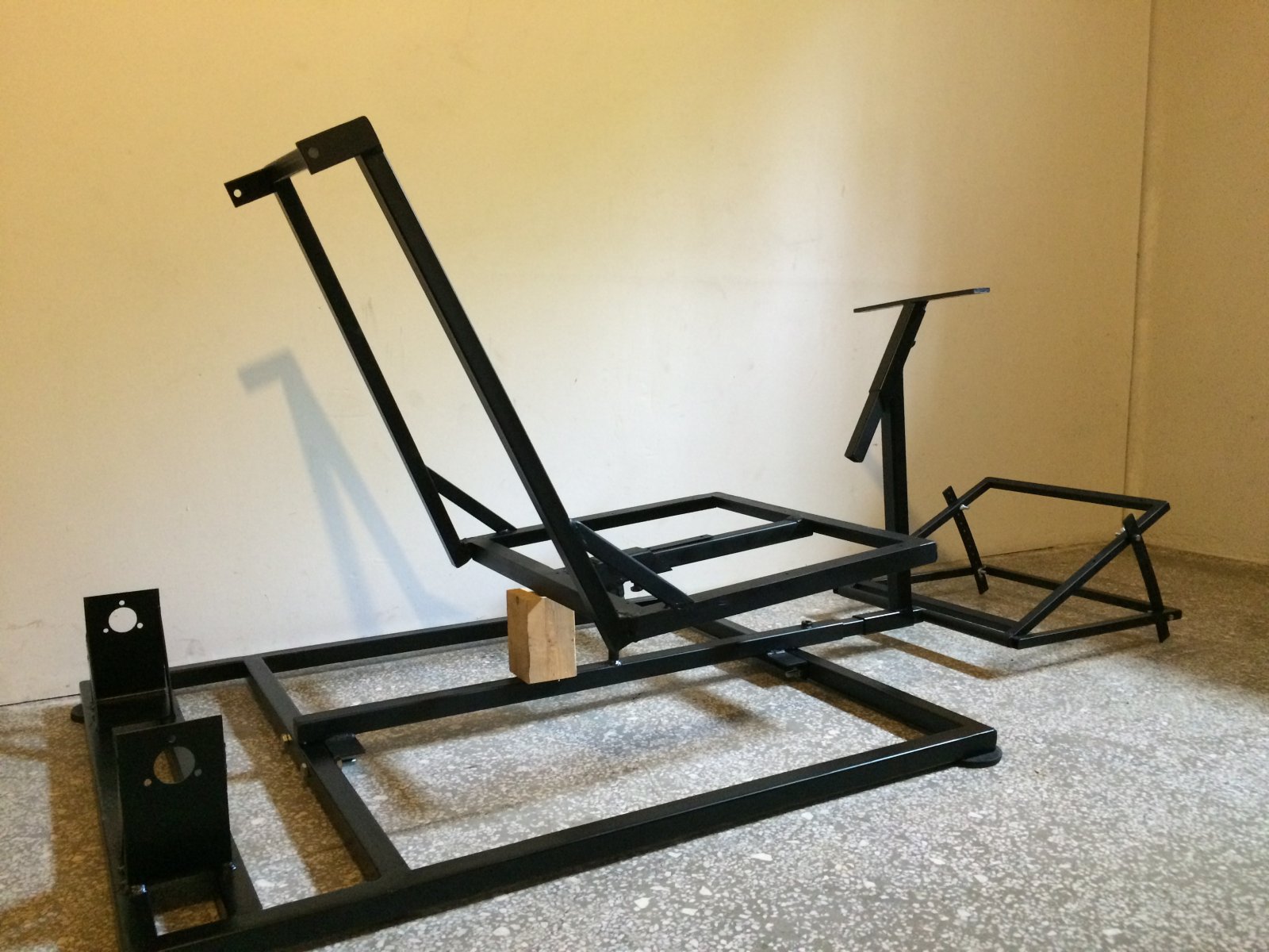

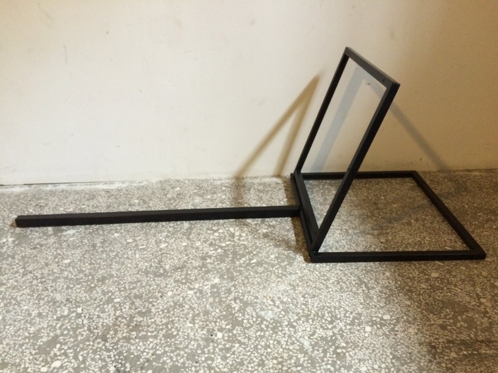

    Bottom frame:
    30x30x2,5mm tube steel
    Upper frame:
    25x25x2,5mm tube steel seat mount
    30x30x2,5mm tube steel base so wheel mount can go through

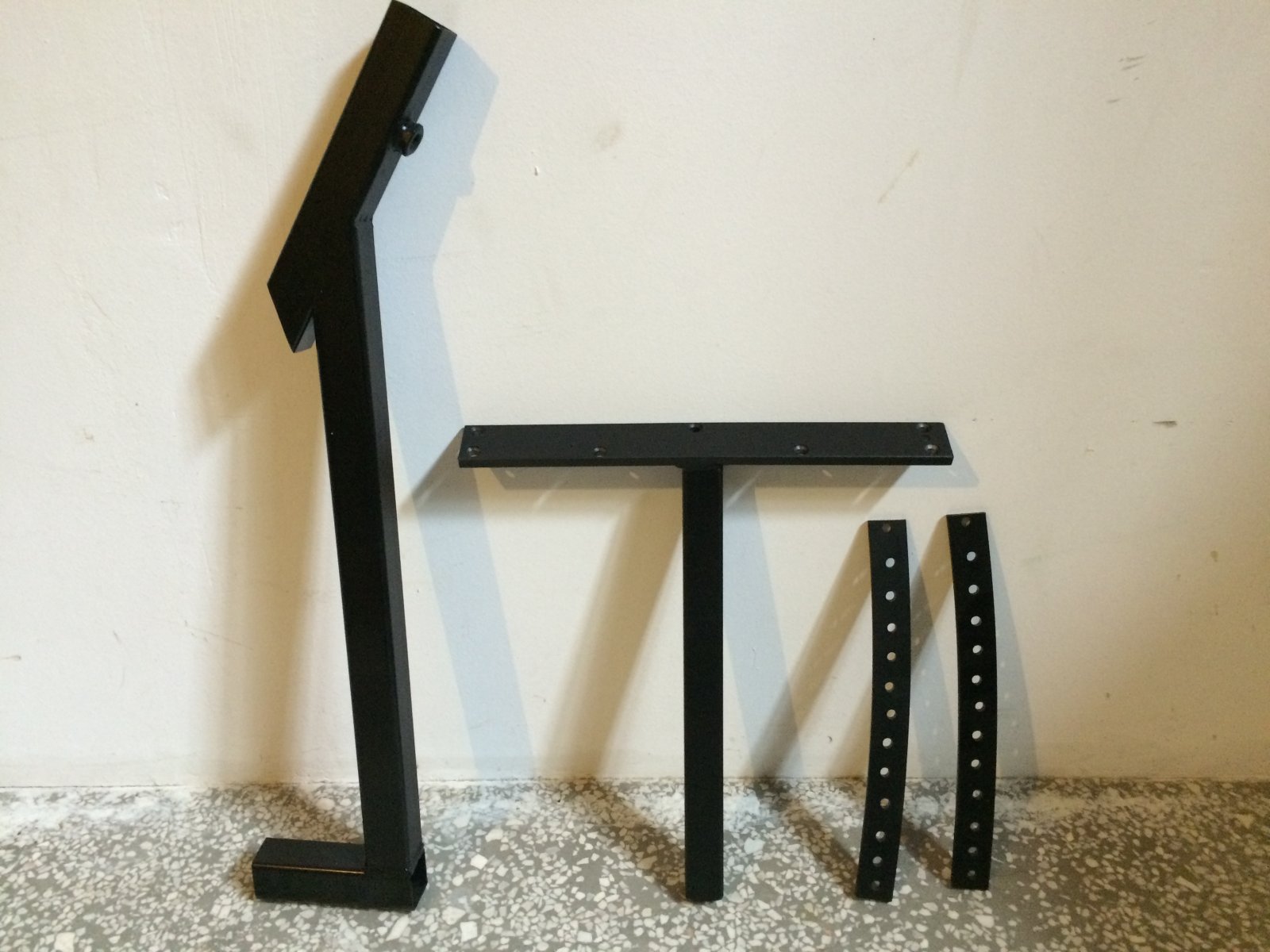

    Pedals mount:
    25x25x2,5mm tube steel adjustable forth and back
    10x10x0,3mm tube steel adjustable in angle
    wheel mount:
    30x30x2,5mm tube steel adjustable forth and back on the pedal mount
    25x25x2,5mm tube steel steering wheel can be adjustable up and forth
    Frame assembled:

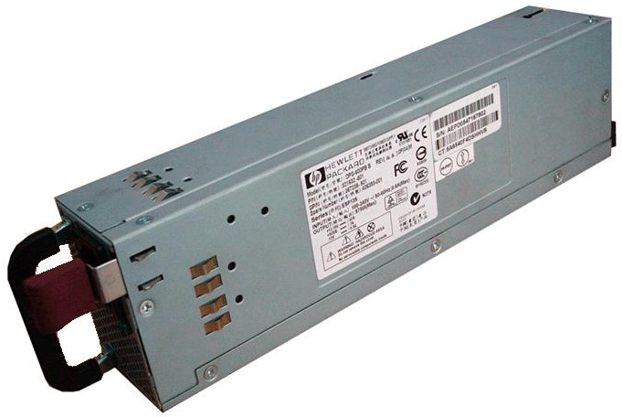

    Power supply:
    HP DPS-600PB
    How to Modify a Server Power Supply for 12v

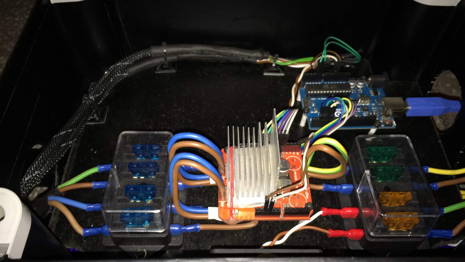

    Motor control box:
    arduino uno R3 original
    monster moto shield for arduino
    fuse box holder

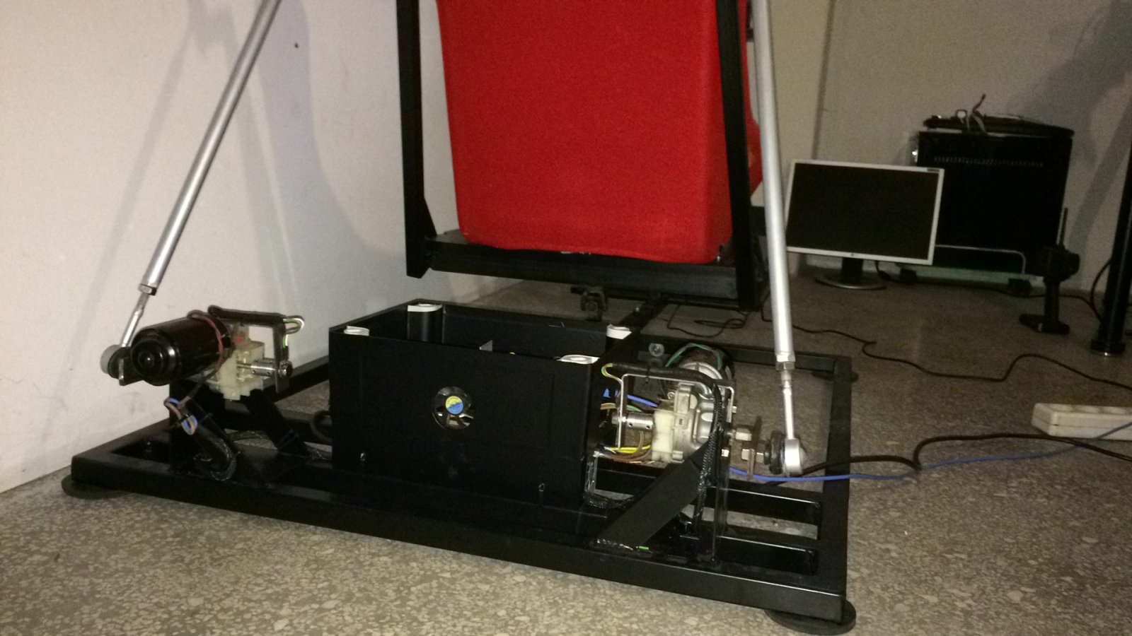

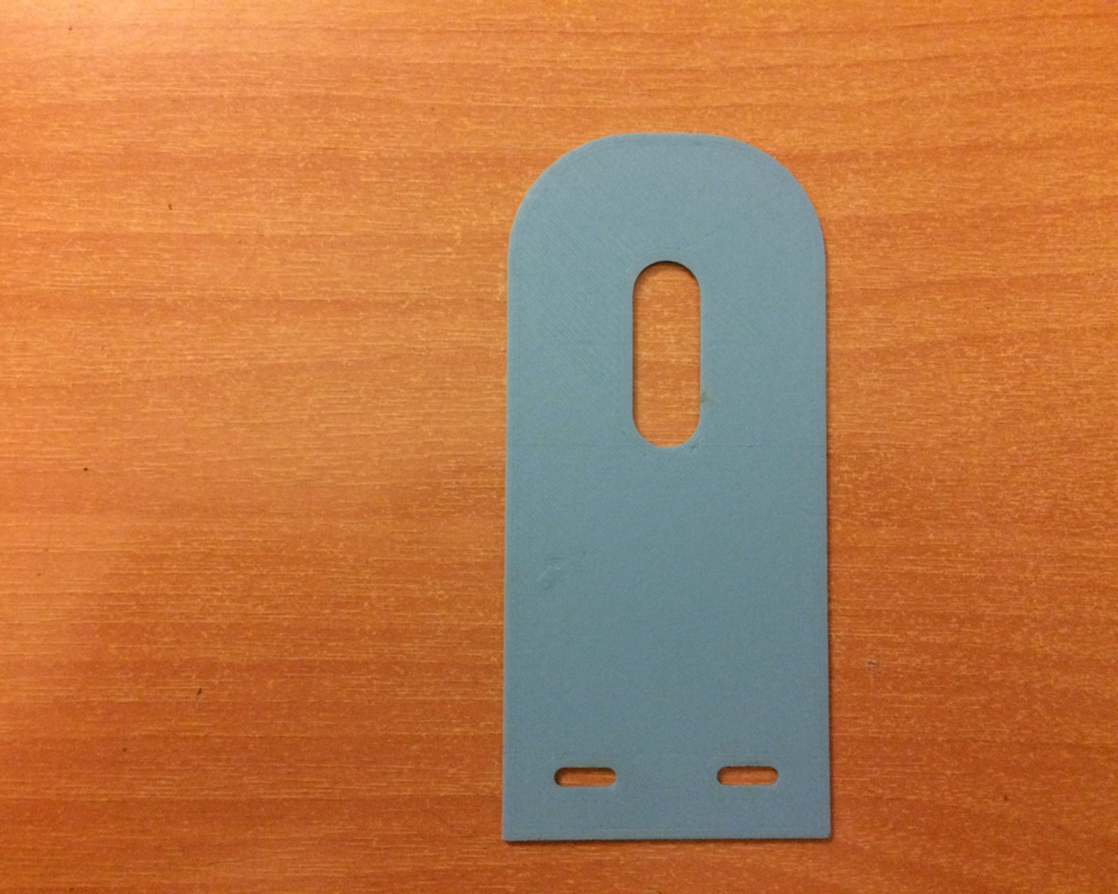

    POT mount:
    STL files for downloading

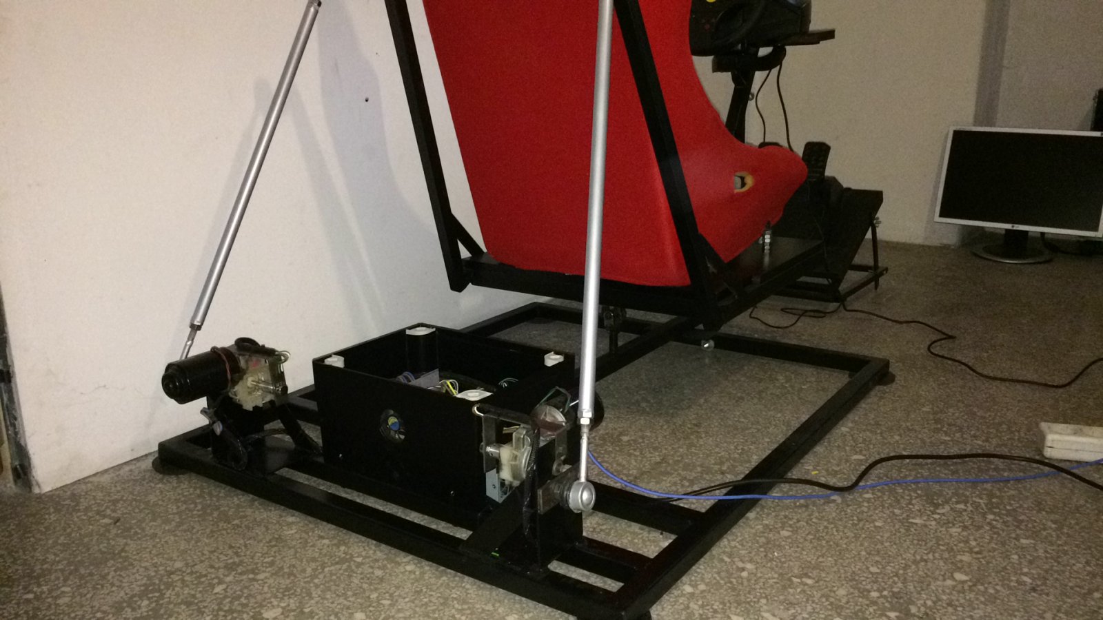

    and finally all above together:
    Although i have finished it haven't ride it a lot but for the few rides i have had when a profile was tuned a bit it feels really good.

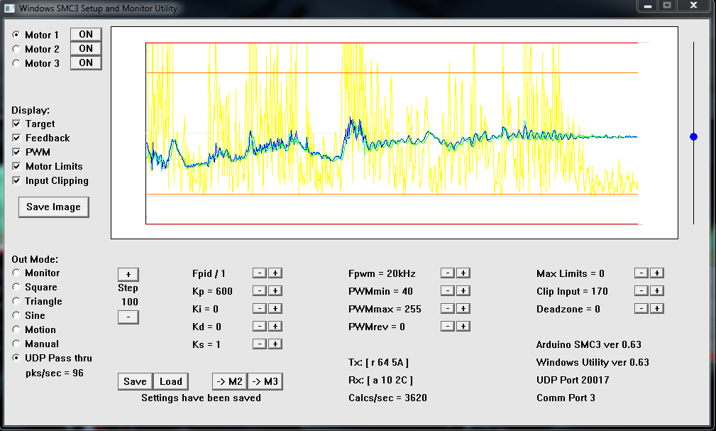

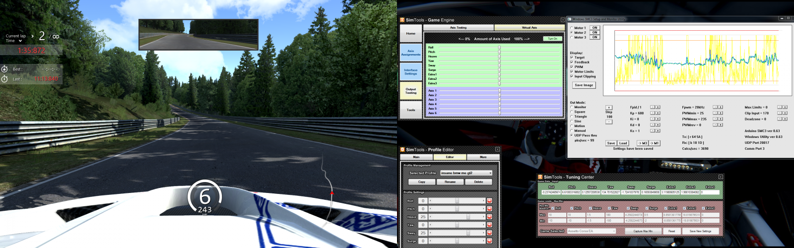

    had some spare time yesterday and spent some time playing and tweaking on my sim.

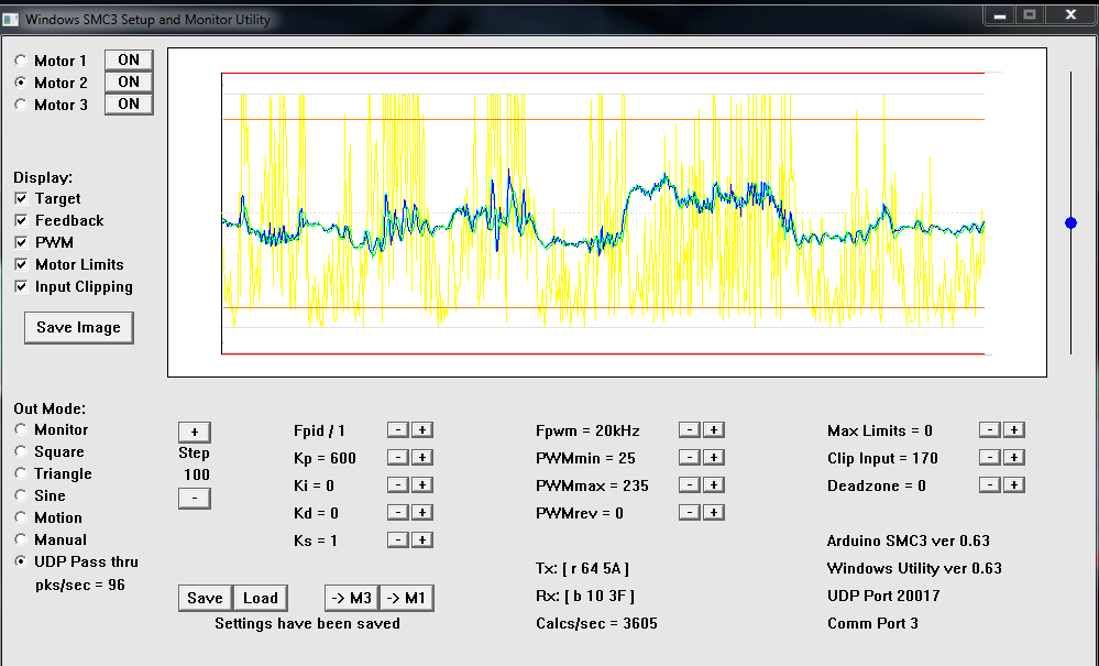

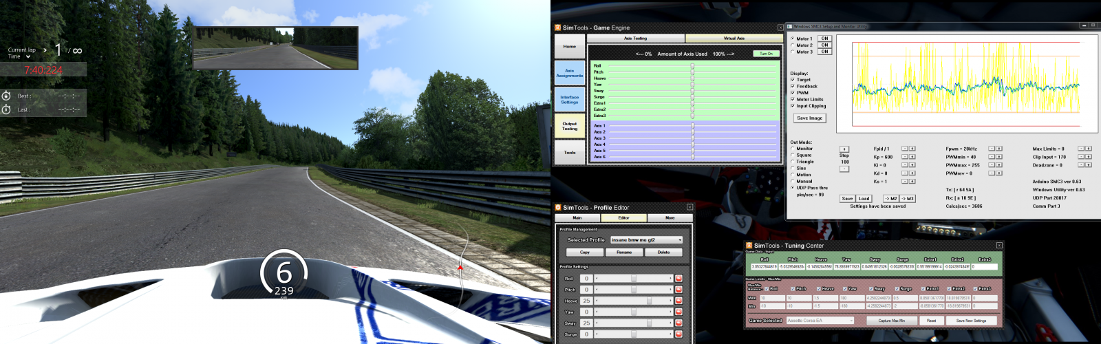

    SMC3 really rocks.Managed to monitor my motion while playing with SMC utility through UDP.
    Could monitor my motion on local PC and on a LAN PC. The difference between local and LAN is when i track my motion on a local pc i can see the target, feedback and PWM line and on LAN i can see only the target line. @RufusDufus I am mentioning this because of these post's
    here are some screenshots with my settings
    pCars:
    AC:
    @Pit @RufusDufus your advise would be appreciated.
    i can see some lag in my motion on the graphs but don't think i can do nothing for it with the motors i am using.
    with these settings i played around 2 hours and then i remembered to check what was going on with temps.
    MM was cool enough but motors were really hot. measured them 10min later and they where 50C. it was the first time i spent so much time on the sim playing and previous tests was with P=500 and PWMmin=0. cooling fans on motors must be done shortly.

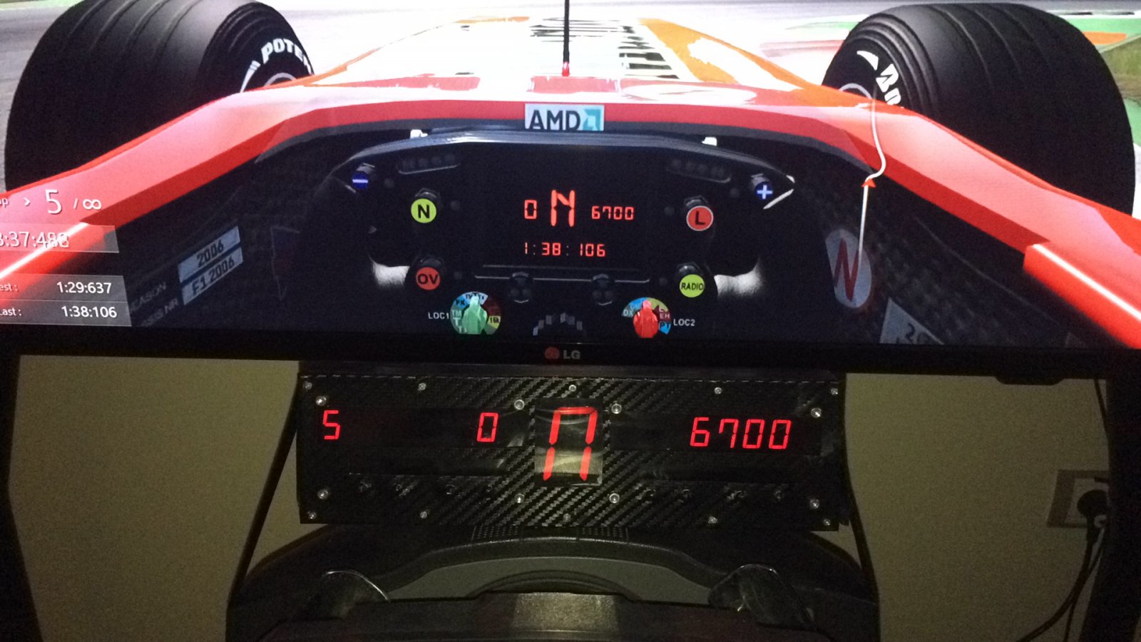

    not a big update but had some time playing and tuning my profiles, steering wheel and adding a dash.
    dashboard is controlled with AChub app from here (ACHub is modular and almost totally customisable dashboard system for AC, IRacing, ProjectCars, Codemasters games (Dirt 2,Dirt 3, Dirt Rally, F1 20XX) and Euro Truck Simulator dashboard).
    its a easy build and with variety of components-settings and the best thing is that most of us already have them.
    and some action:grin

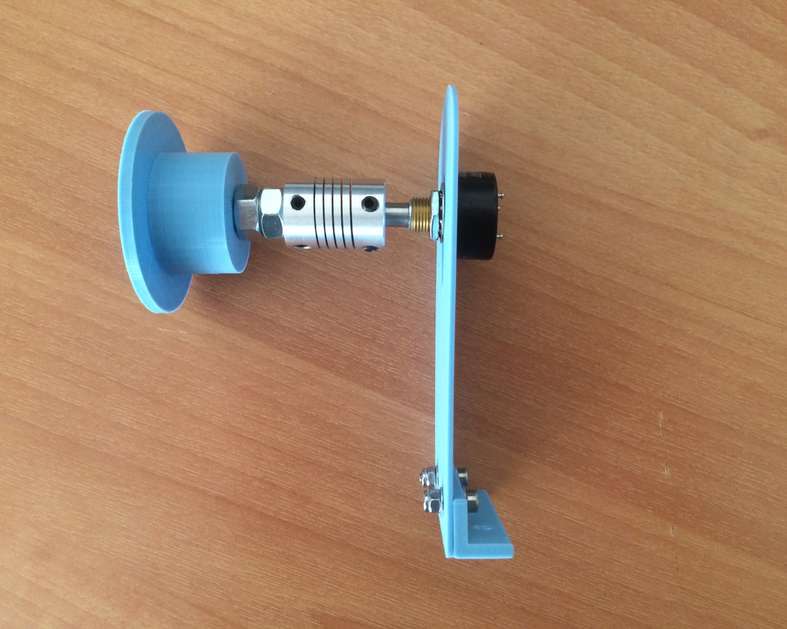

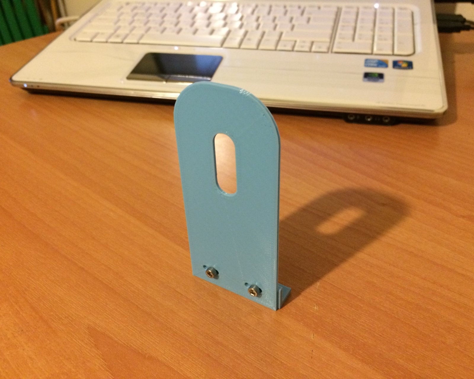

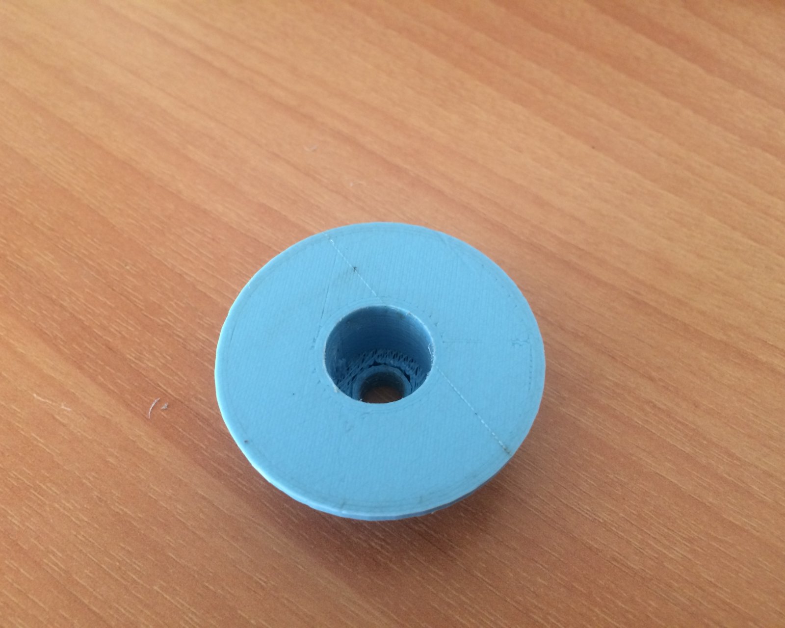

    long time posting here. almost forgotten i had a build thread:p. thanks to SimTools 2 i digged it out.

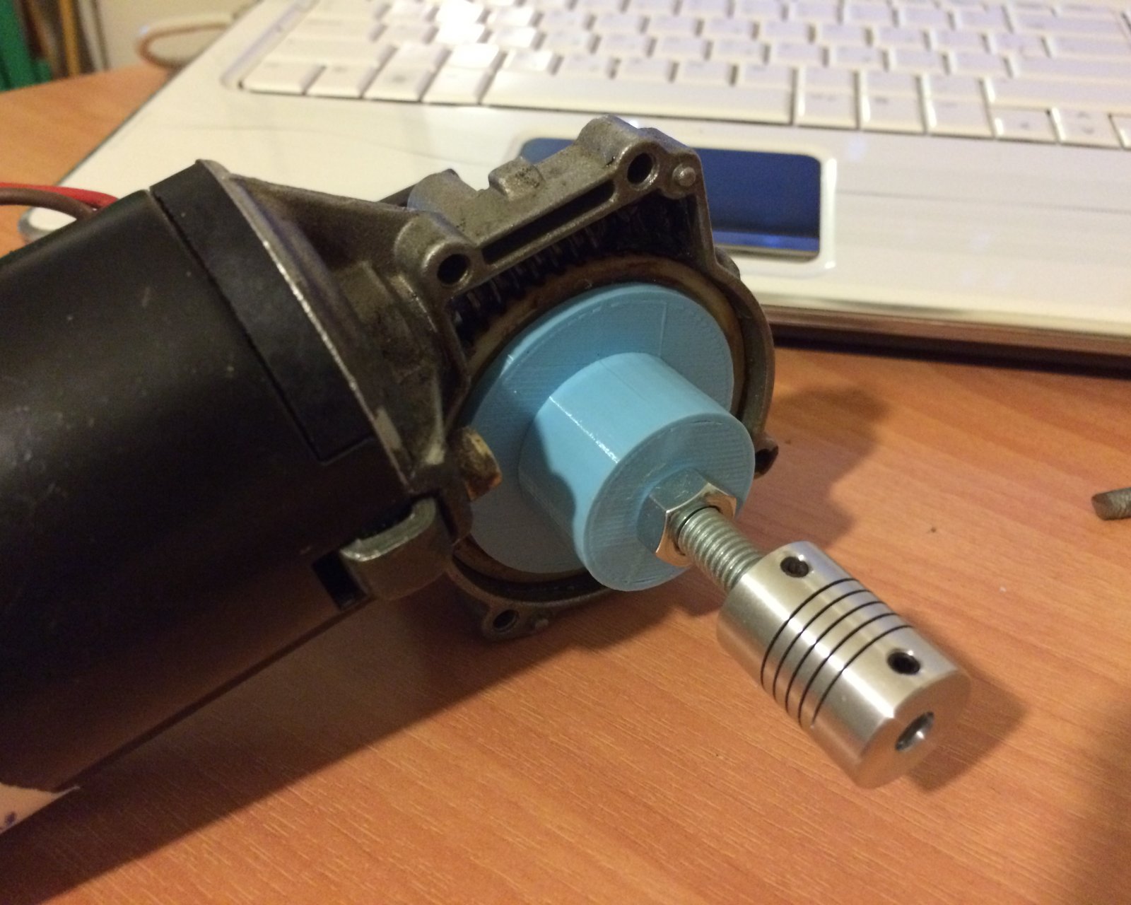

    some time ago i replaced my old cermet pots will hall ones. then i redone my motion profiles and boom.it felt like i was driving another rig and then Simtools 2 came out and boom felt a second upgrade with my rig. motion now feels really great.
    i want to thank all beta testers and devs for making SimTools 2hug:

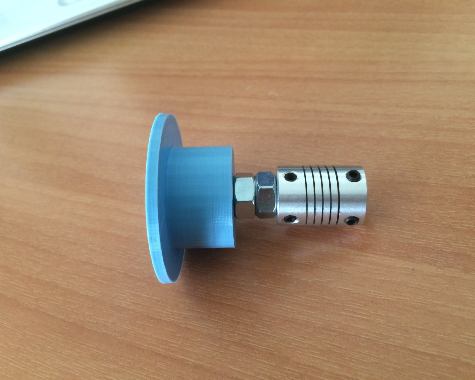

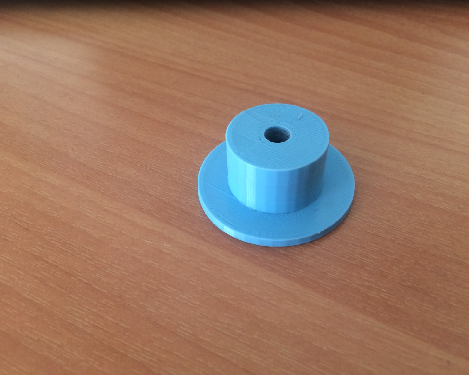

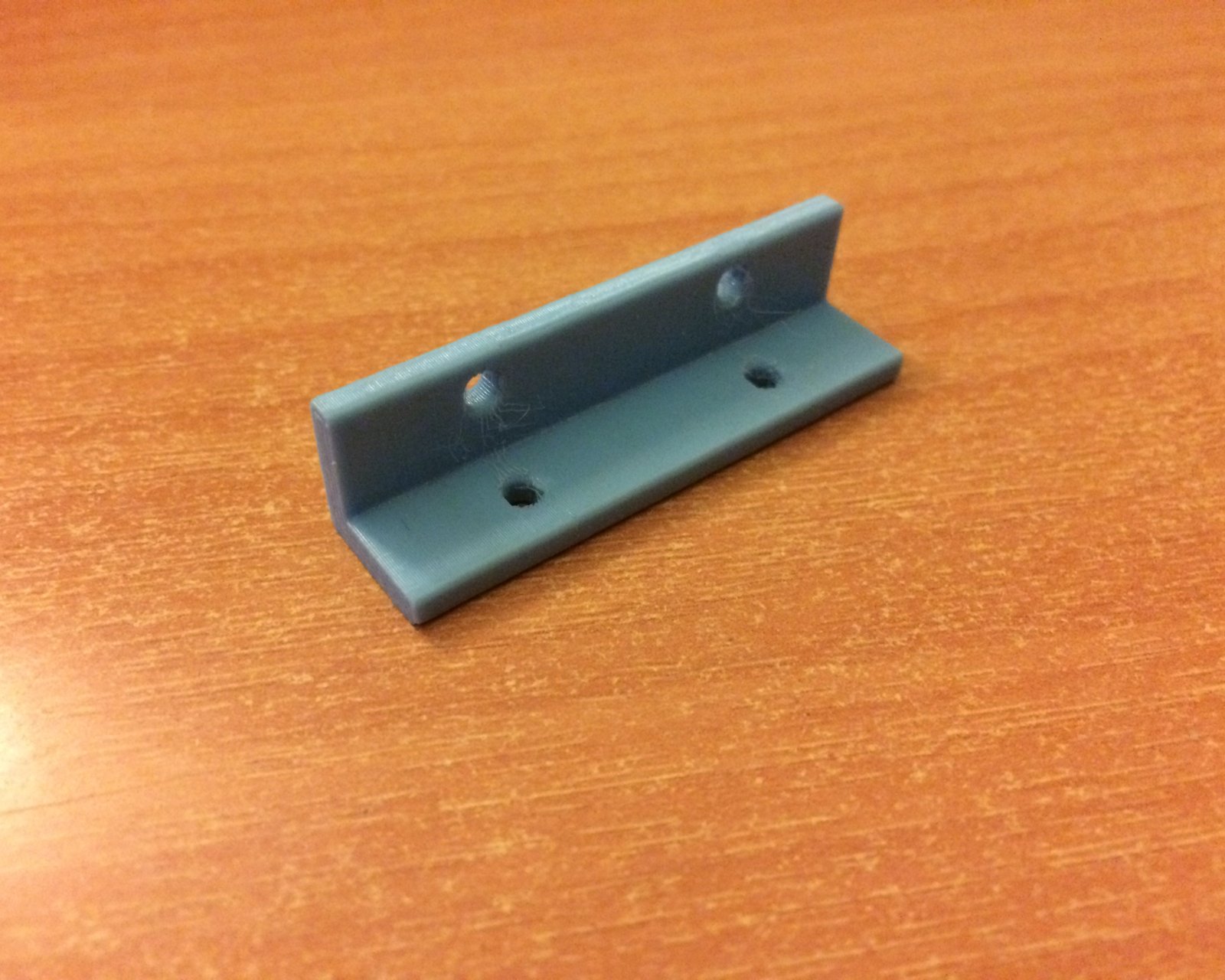

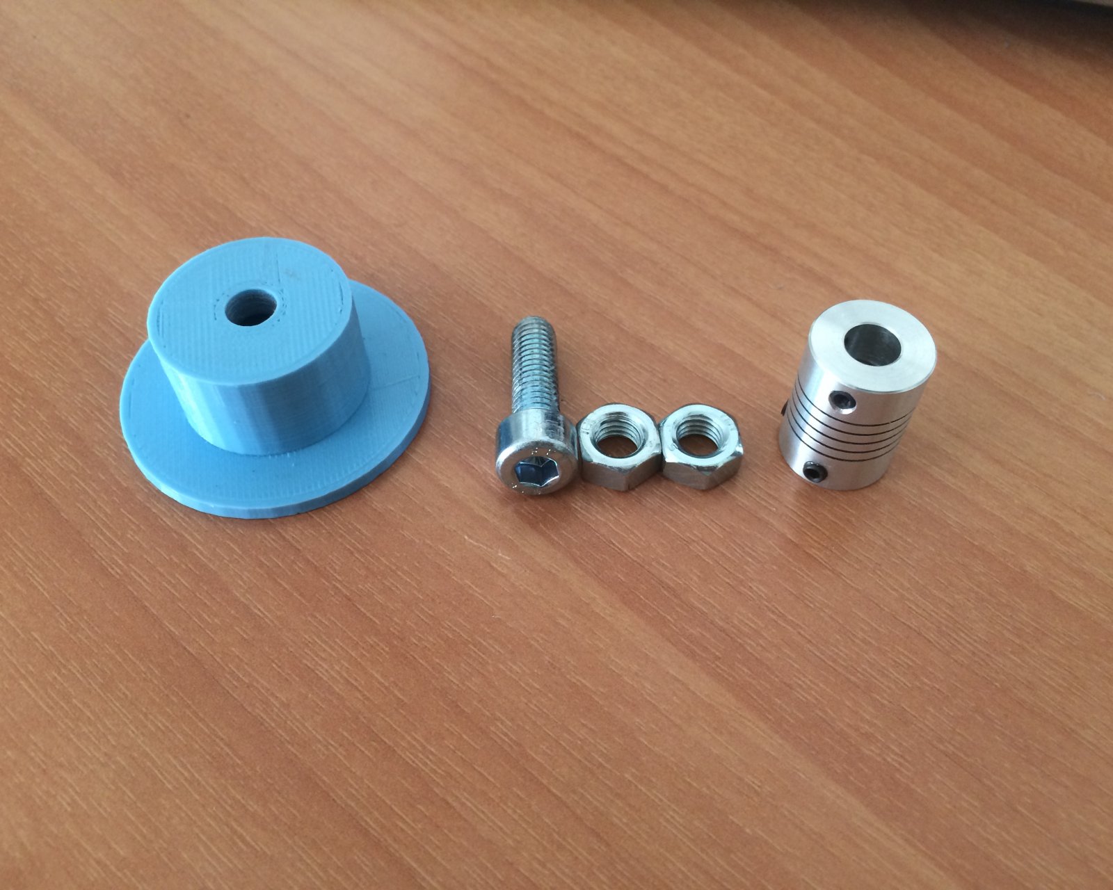

    here some pics of how i have mounted my new hall pots to my wiper motor.
    3d printer is my new friend... after my sim:D

    Looks like your Bridging had a bit of a hard time there on the inside of your Motor adapter. have you played much with Dense support layers ? They REALLY help get you details on that first layer when bridging. Also your Extrusion multiplier looks to a touch low, and I would suggest upping your Infill outline overlap to something around 25% or even a tick higher.
    If you want, be sure to post those parts in the 3d printed parts section. :cheers

    thanks for your inputs @Nick Moxley:thumbs i know i have to spend more time tweaking the 3d printing profiles.
    damn everything has profiles and all need tweaking from simtools to wheel , 3d printer an so goes on.....:D
    do you mind sharing a profile from your printer so i can compare them with mine.we dont have the same printer but i guess i can see whats wrong with my settings. i have seen your printings and they are perfect
    going to post it in 3d section with the STL files too
