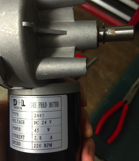

    Now the parts are arriving one by one and today I've got my motors. As I wanted to save money where I could, I looked around, to find a cheap one that is still capable of lifting my 70ish kg on my approximately 30-40 kg wooden seat construction (build not started yet). Here is what I wanted to give a try: 24V DC, 210 rpm (using 24V) 40 W, 30Nm

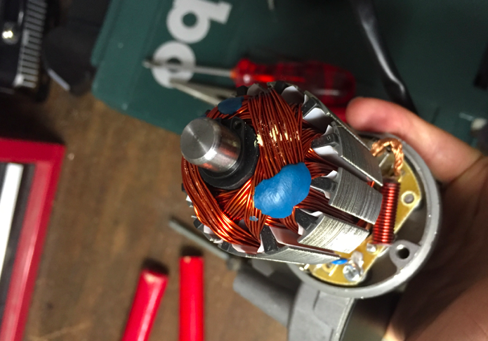

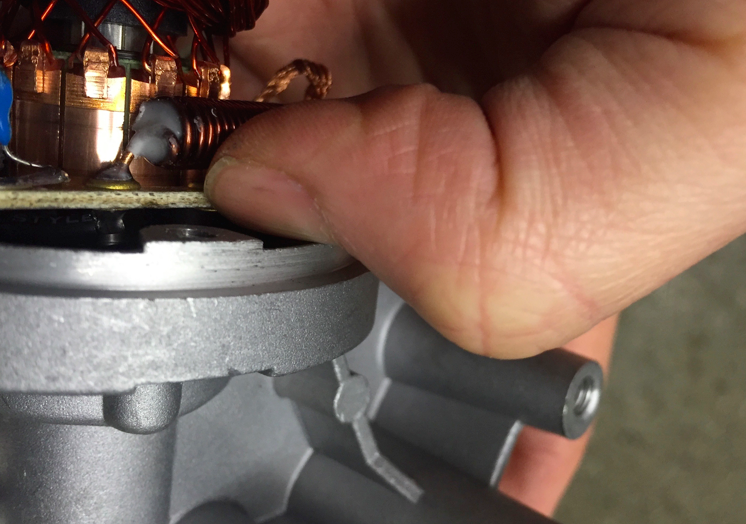

    As I read in multiple posts about short circuits concerning motors using the case as ground I opened one of them, to have a look inside. What a beauty :)
    The black cable is soldered directly to the coil without touching the case, so this should be fine without further tweaking:

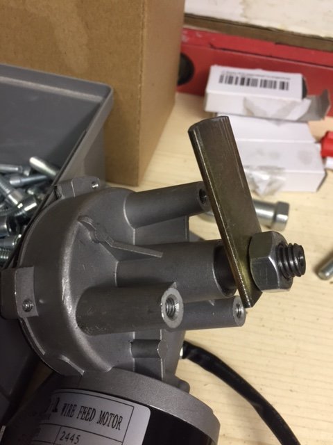

    However, what I need to fiddle out now is, how to connect the rod. As the thread is only a M4, using this directly for the connection doesn't sound as a very good idea.

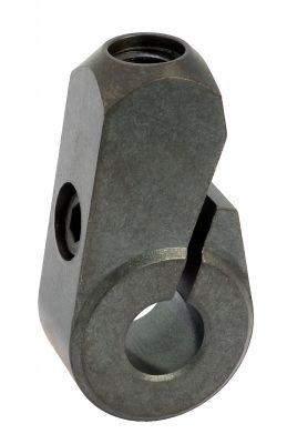

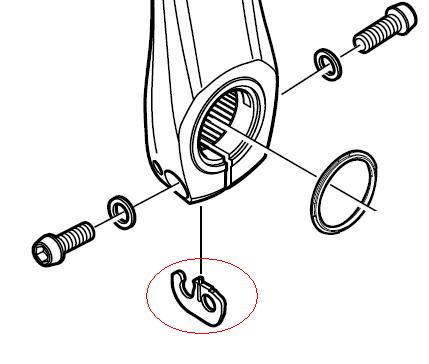

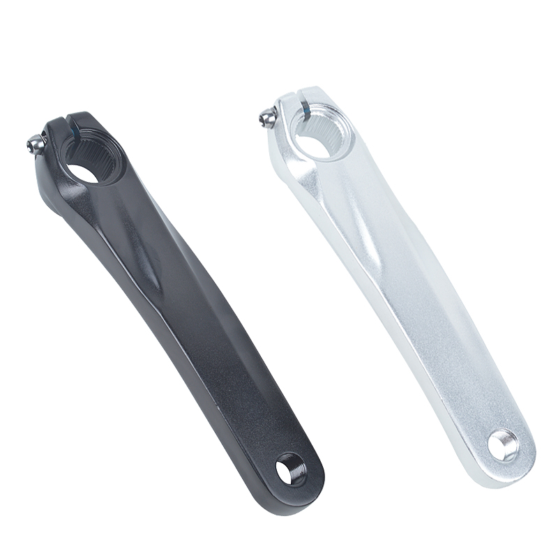

    sorry, but 40W motors will never give you 30Nm... your torque specs are probably not acurate saddly
    here some actual examples from https://simukit.com/ :
    - DC moteur 120W 24V 40rpm 25Nm
    - DC Moteur 350w 60 rpm 40Nm​

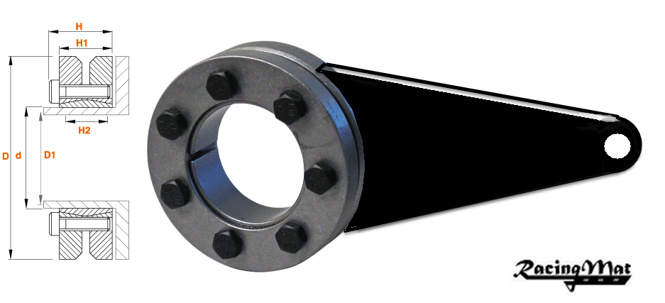

    If you look for rod connection, here are some ideas: :)

    So the motors are most probably not strong enough, to give a good performance, right? I mean, as they are the ones I've got, I will give them a try anyways. And if they are completely useless, I can still modify my bbq with them
    However, according the rods connection, I thank you very much for the input. I was thinking the complete other way arroung, in somehow using the thread instead of the shaft.

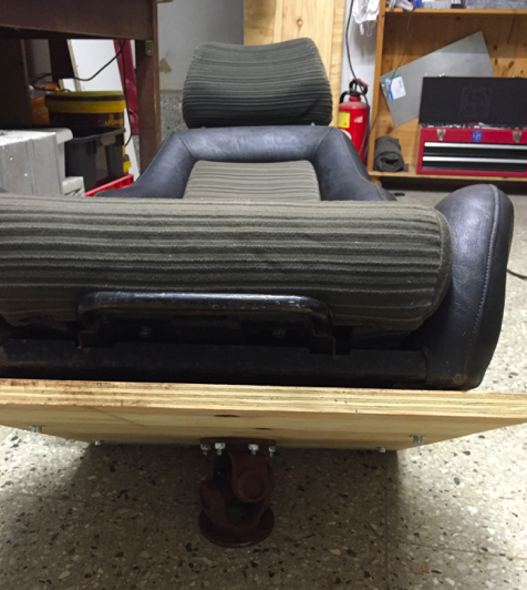

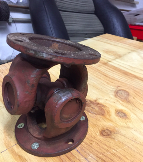

    Small update on the build and a quick question on the rod connection. It's really hard to find those adjustable bike cranks here in Germany. All cranks I've found have a fixed size... -_-
    That second picture you attached to your first post, @RacingMat, what exactly is this?

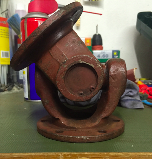

    Here is my U-Joint, it's from a Belarus MTS Fortschritt ZT.
    I also bought an old Recaro which I attached to it's wooden base.

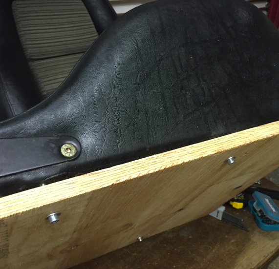

    I'm thinking about using only the joint as the distance between the bottom base and the seat. This would give me enough room to additionally attach Roles underneath (my driving wheel is quite low). Although I'm a bit afraid to roll away, under heavy breaking. Has anyone experience with rolling seatmovers?

    According the U-Joint, I looked around quite some time to find one which I can use as is, as I don't have experience in welding nor a welder at my disposal. If someone is desperately looking for one, just PM me. They came in a pack of seven ;)
    Thanks for the explanation @RacingMat. I decided now to try and cut an external thread directly into the motor shaft. If this doesn't work out, I will go with a coupling and try to find someone for the welding.
  10. RacingMat
    2,237
    21,050Coins
    ok!
    but I would say that motor shafts have a surface treatment such as thermal tempering
    that would prevent you to thread it with standard tools
    keep us informed :)

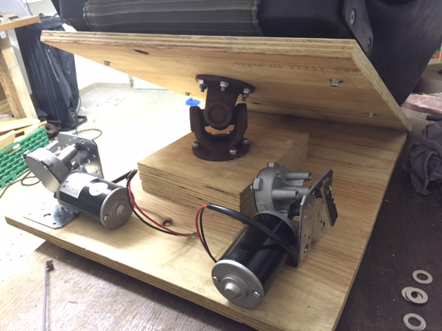

    While waiting for the thread cutter box, and a thicker cable to connect my PSU, I attached the U-Joint.
    To find the balance point I followed the instructions here: https://www.xsimulator.net/communit...-of-gravity-to-balance-a-motion-simulator.55/ Afterwards I attached the Joint temporarily with wood screws to get a feeling of how well I hit the point.
    I moved the joint back just some mm for the final attachment, but it had a big impact on the overall balance.

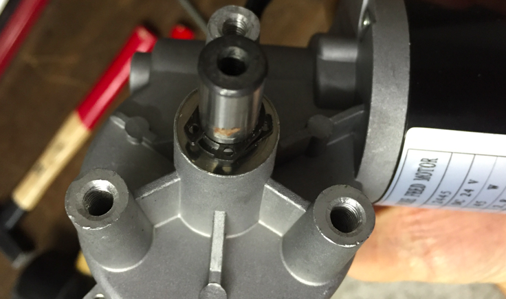

    That may be true of some but not all, the 25:1, 50:1 and 60:1 wormdrive gearboxes commonly used by DIY builders are not hardened.
    The gearboxes pictured have a hole in the end so it would be worth seeing if a thread can be cut by hand with a tap tool.

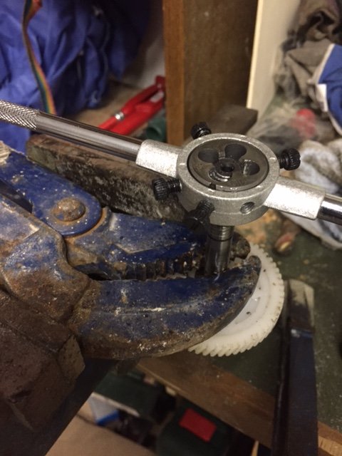

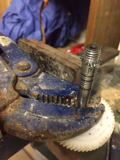

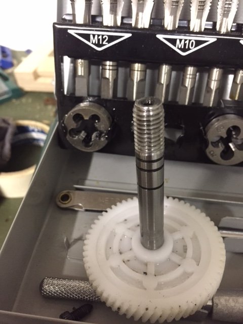

    I'm done. I did not think that it could be that hard, but I finally did it.
    The hardest thing was really to fix that shaft in place, so it couldn't move in any direction while I was turning like a madman. Here is what worked best for me:
    Cutting a m12 thread before starting the m10 helped a lot. At least I found it a lot easier to cut the start with the bigger one.
    And the final result:
    The tools I used worked pretty good. What helped a lot, was the cutting oil I bought for half the price of the whole toolbox. But without that I wouldn't have made it.
    This is how it looks back in the motor. I will most probably use the tube connection for the potti.

    I fixed the joint to the base today. This is how I would like to position the motors.
    I built a little podest for the U-Joint, but I'm not quite sure if the 16cm between the base and the seat in horizontal position is enough. Looks like I need to add some more height... -_-

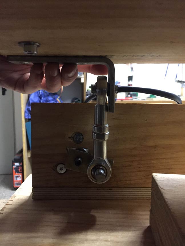

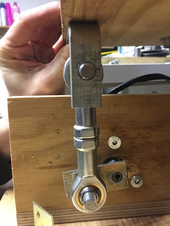

    I'm a little stuck here and asking kindly for your support. After I finished my motormounts I see now, that the joints are a little too long. As you can see in the images, the levers are a little away from the 90 degree position. And also the offset is slightly different from lever to lever. Now my question: Do I need to raise the seat to have more room, or is the difference somehow compensated by the motorshield, or neglectable in later operation? I'm afraid, I already know the answer... -_-
    Btw. I can't lower the motors any more as otherwise the lever can't go in full 360 degree movement, that's why I added the bottom plate. I mean, if I would remove the bottom plate I have enough room for the right adjustment of the levers, but than I need to somehow restrict the movement between 210 and 330 degrees. Is this possible? Would this be recommendable?
    Lever 1
    Lever 2:
  16. noorbeast
    21,724
    152,057Coins
    +11,064 / 56 / -2
    It looks like your seat should be a little higher.
    Both levers should have the rose joints in the same orientation like this one, otherwise binding would be asn [​IMG] issue with one at 90 degrees to the other:

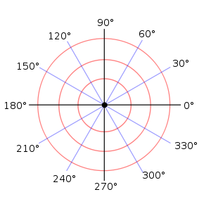

    I am saying that to prevent binding both rose joints need to be the same orientation.
    Effective torque delivery with a lever is at its maximum when at 90 degrees. Torque effectiveness falls off rapidly after about 40 degrees up or down. So it pays to have the same angle range up and down for a particular design. So while not mandatory it is sensible given your design to have the levers start at 90 degrees.
