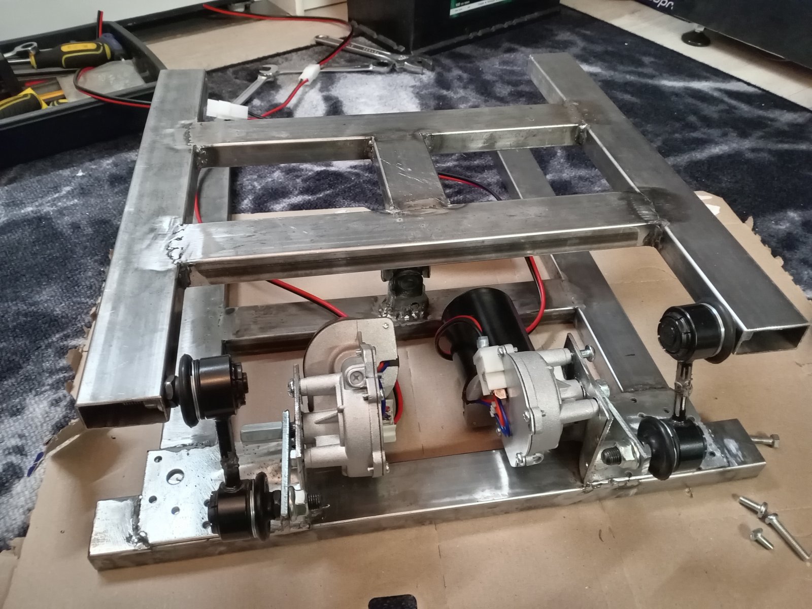

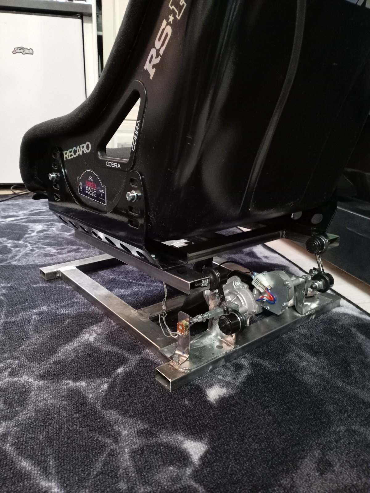

    Hello! Im here to learn about building 2dof seat mover. I have already made my own wooden rig and ffbeast wheelbase. I have ordered some parts already and In few weeks I can start building I hope I can make it work

    Last night it started working! I did some testing and all looking good! Today I will take it to real test with driving

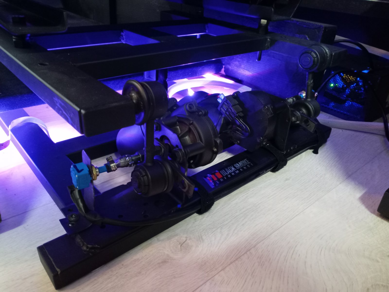

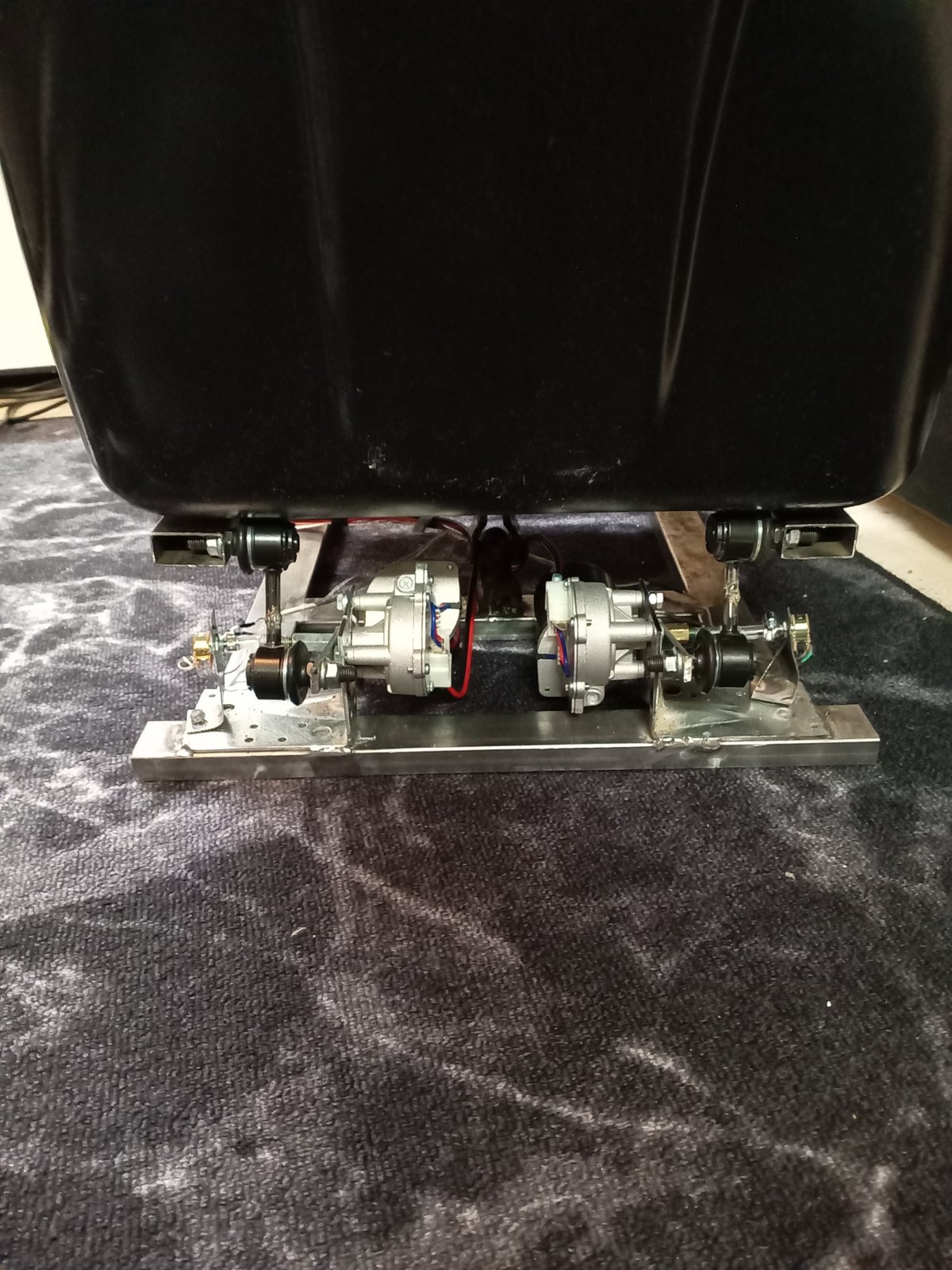

    Hello!
    Another one of my seat movers wiper motor gets really Hot after playing 5-10 minutes.
    Could it be some kind of settings thing or is the motor just bad?
    I run with 2 same type of motors. Second motor is warm after playing but not Hot like other.
    Thanks!
    21,594
    151,227Coins
    Design wise wiper motors are not ideal for a compact rig, as they are not very powerful and a compact rig requires a lot of torque.
    Similarly, too long of a lever will also put unnecessary strain on a motor, as it reduces torque with length.
    Unequal balance will also affect one motor more than the other.
    That said, settings could have an impact, as could a somewhat faulty motor. Posting pictures of all your settings would help.
  5. Joonas Temonen
    Joonas Temonen New Member Gold Contributor
    Jan 3, 2025
    23
    37Coins
    +7 / 0 / -0
    Thanks for those advices!
    All I did was i shortened levers from 6cm to 4cm and changed some settings.
    Last night I played 1-2 hours and motors only get little warm,not Hot like before.
    It feels really good now!

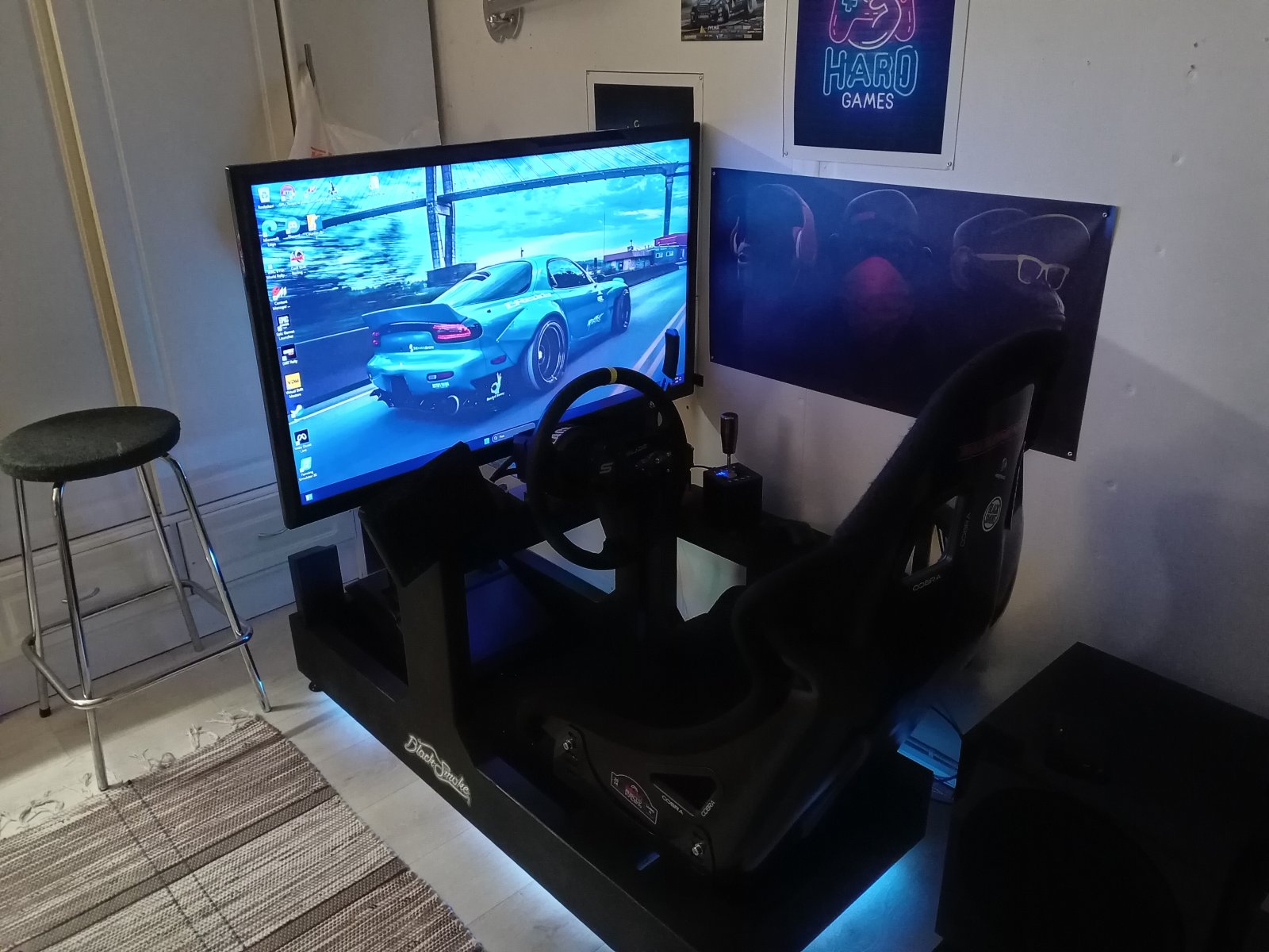

    Here is little video clip of my seat mover In action. This is nice thing to play with

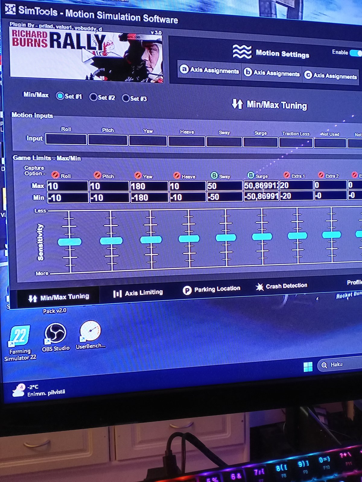

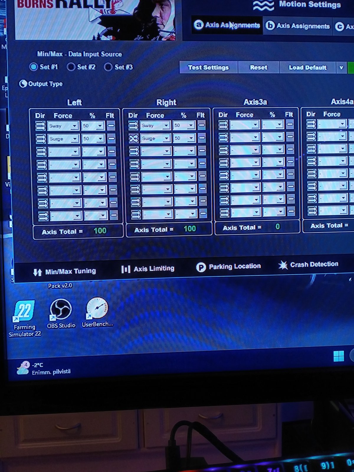

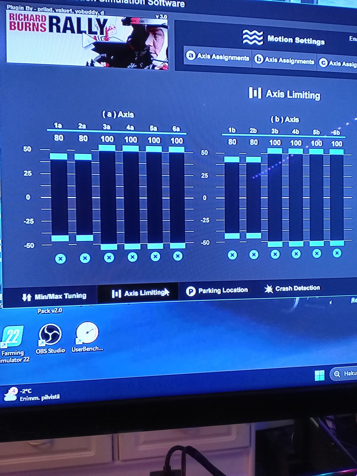

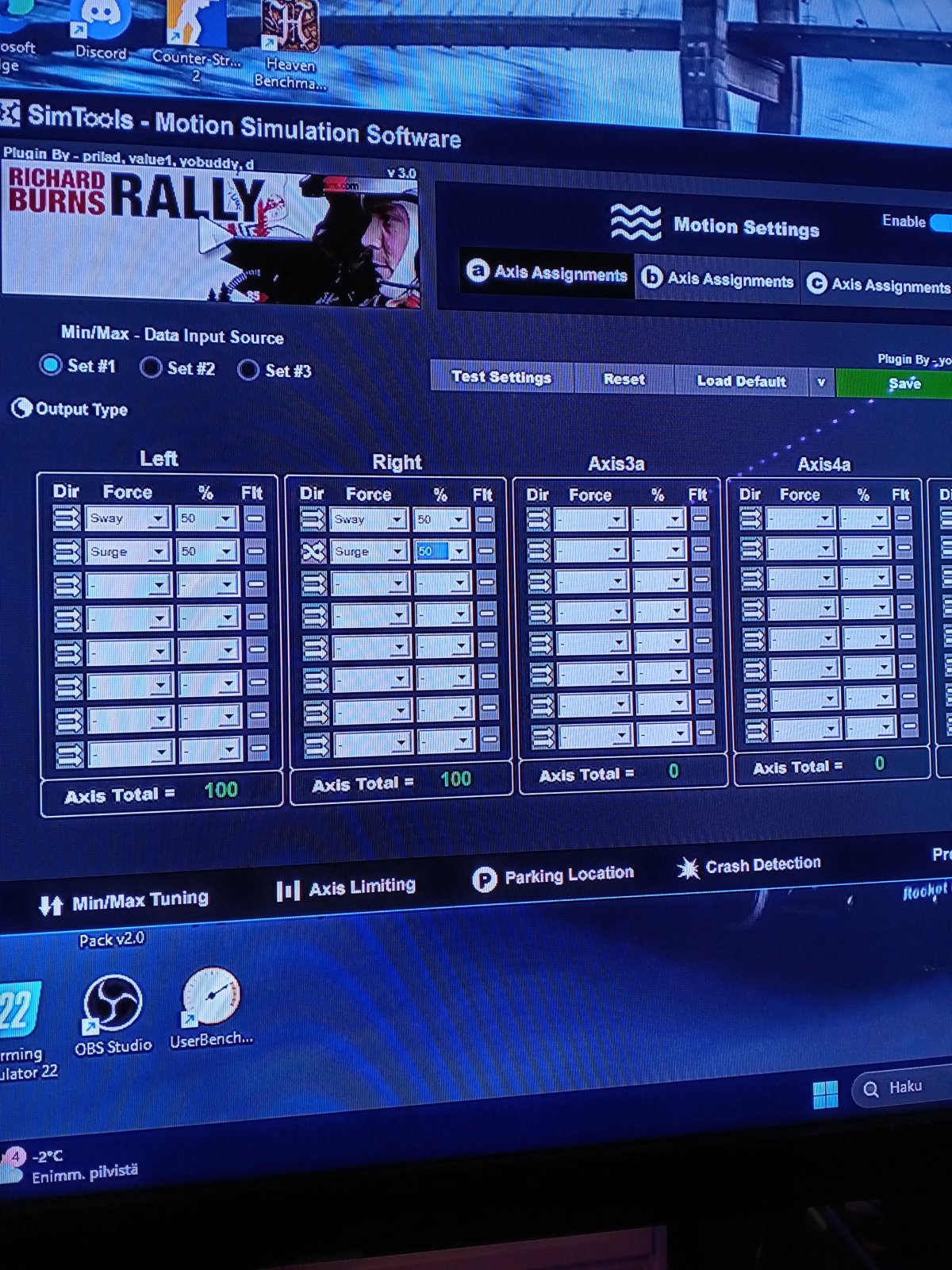

    Hello everybody!
    What is wrong with my sim tools settings for rbr?
    Here is some photos to show.
    In assetto corsa everything works fine and I dont even have to use 50/50 settings to get enough sway and surge.
  8. Joonas Temonen
    Jan 3, 2025
    23
    37Coins
    +7 / 0 / -0
    In rbr Surge feels good only when brakeing, when accelerating, it moves a little..
