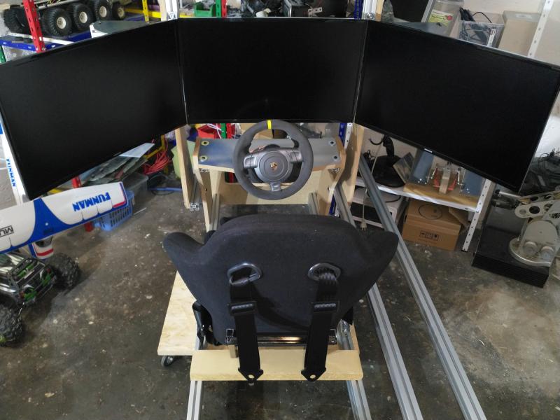

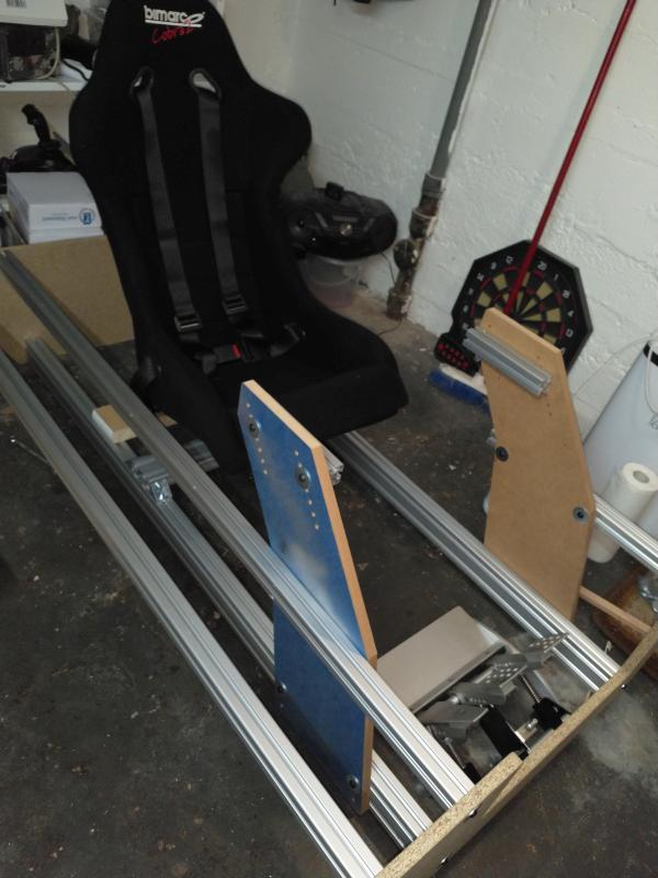

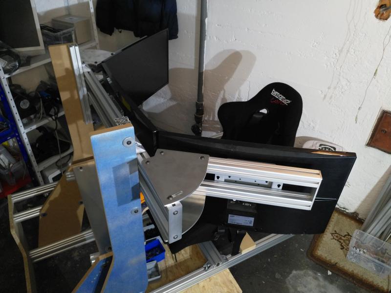

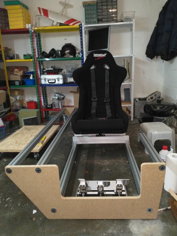

    Hi there,

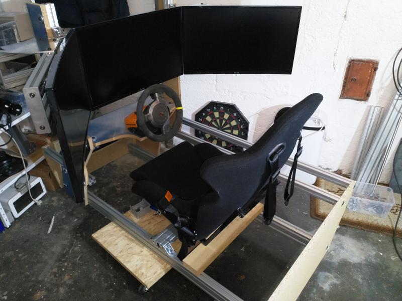

    just after 1.5 years of thinking (and doing nothing) I startet to build my 2 dof seat mover sim rig. The design is influenced - er, mainly copied from ;) - the APX series from Ricmotech. I increased the length to have space for the wheel chair motors, 24 V 350 W each:

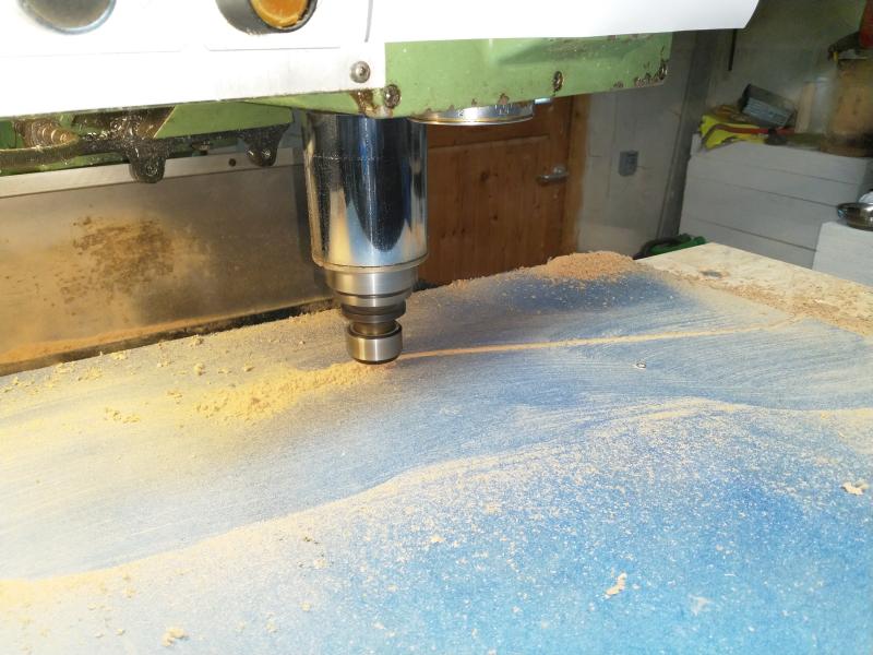

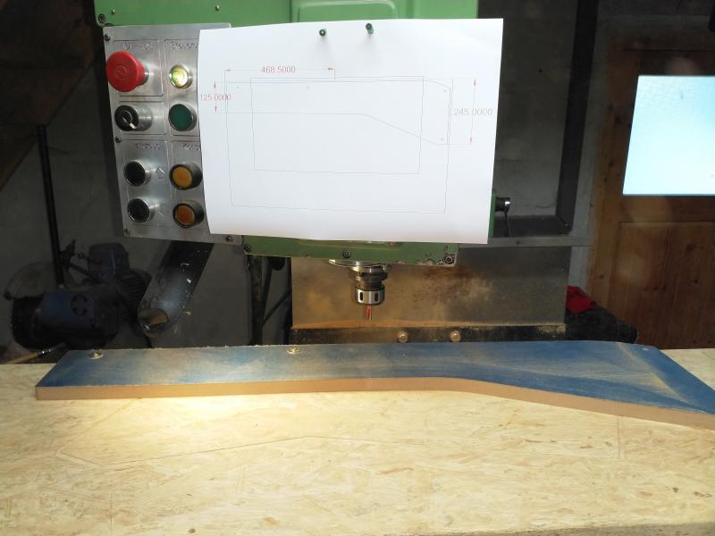

    Machining the wooden parts:
    I used an industrial cardan which I got at a cnc forum meeting for a few euros:
    "Final" (provisional) assembly:

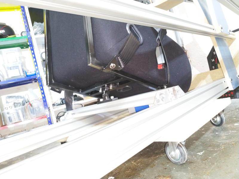

    Next step is the paint work, I've got black left over from a garden project...
    ... And then: try to get it move :D I plan to use a chinese dual channel 100A driver.
    Options: I read about the G-seat and figured out, that my seat can be modified for that purpose. If I manage to keep the parts thin, they could easily be placed under the cushions (which are only fixed with velcro strips).

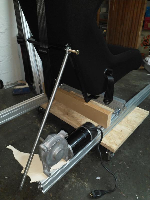

    It's too cold to paint, so I went on with some mechanics:

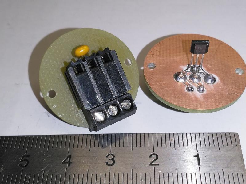

    I shortened the axle of the worm gear to fit a lever 20 mm thick. And made some threads to fit the position sensors. I plan to go with DIY hall sensors. I did some tests here.

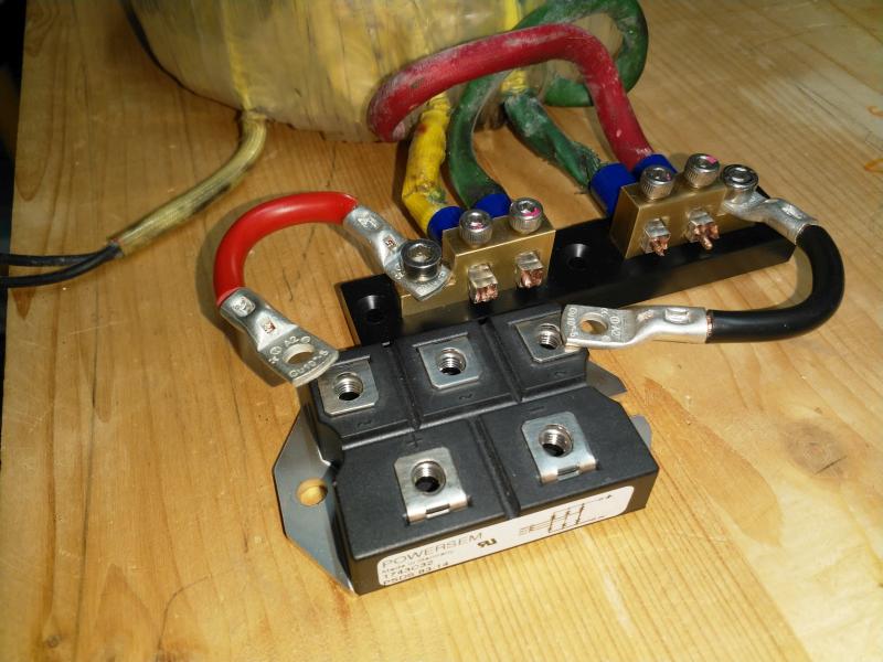

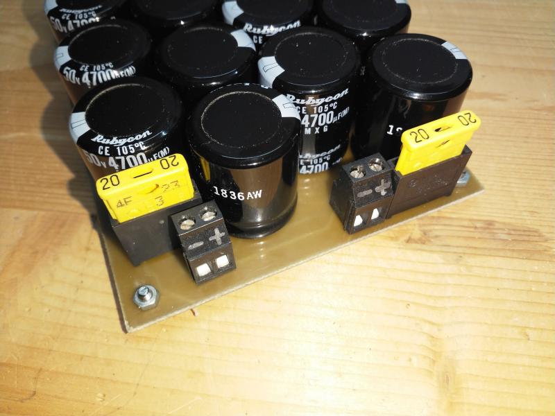

    And it's time for the power supply. From an old CNC project I had a toroidal transformer left over, which outputs 2 x 15V /26A. I connected the 2 coils in parallel resulting in 15V 52A AC. After rectification there should be 24+ V DC available.

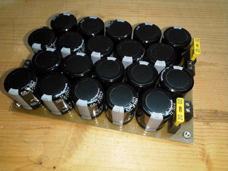

    For voltage damping I milled a PCB, which gets equipped with 20 pcs 4700 µF capacitors and fuses for the drivers.

    Ready to use: Capacitor board...
    ...and sensor pcb :)
    I need a smaller soldering iron :confused:

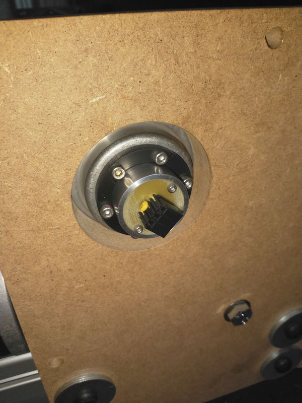

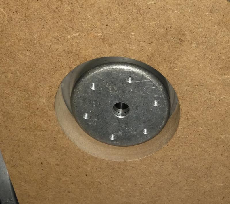

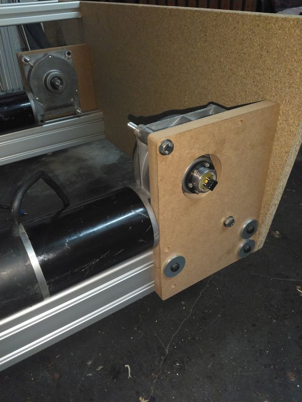

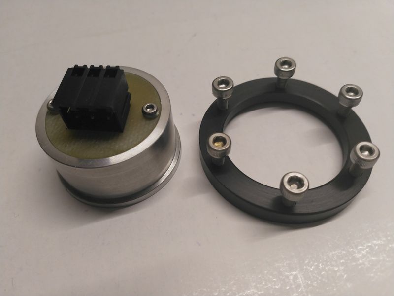

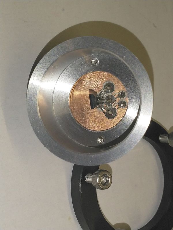

    I turned the housings and clamping rings for the sensor pcb:
    Just fitted to the motors:
    To adjust the sensors I loosen the screws, turn the sensor housing and fasten the screws again. Not much torque needed, 6 screws are totally oversized :cool:

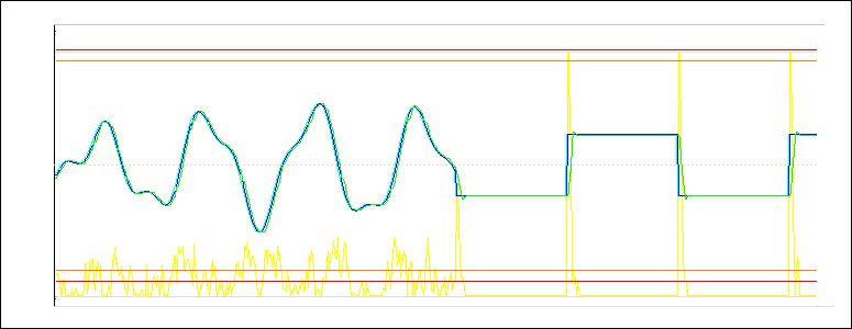

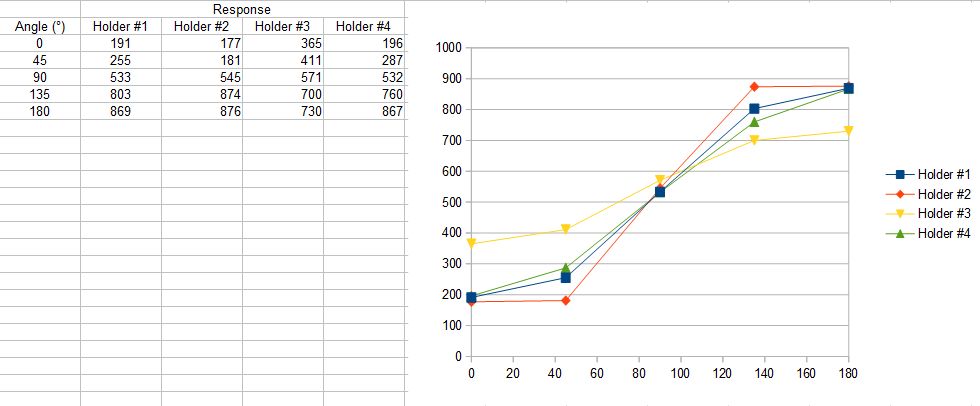

    So, first problem arose...
    Tests with Arduino Uno + SMC3 + hall sensors gave way to low working angle of the lever. Only perhaps +/- 30 degrees. A deeper look on the curves from SMC3Util showed a very steep slope around the center (0 - 30 degree) and a wide, flat area over some 40 degree. Dimensions of the magnet holder were the same a at my testings, but I used other magnets. For the tests I used some 3 x 3 x 1 mm N42 magnets, but I had only these two pieces, so I bougth some new. For easier machining I purchased round 5 x 2 mm, but in N52 quality. This lead to the extreme early saturation of the SS49E hall sensor.
    So I did some more tests with different distances of the magnets:
    1. Holder #1: 3 x 3 x 1 mm N42, distance 7 mm
    2. Holder #2: D5 x 2 mm N52, distance 7 mm
    3. Holder #3: D5 x 2 mm N52, distance 13 mm
    4. Holder #4: D5 x 2 mm N52, distance 10 mm
    Result: Holder #4 ist most suitable with most usable angle, nearly like holder #1
    So I switched to holder #4 (had to build 2 of them) and ran some more tests:
    I have little overshoot in the square step response, and can't get rid of them :confused:
    My settings are Kp = 400, Ki = 0, Kd = 1000, Ks = 3. Even with the smallest Ki I get oscillations...
    I also observed some "stepwise" motion of my levers. As if the position is faster reached as the SMC3Util can send next position. Does anybody know the update frequency of new position data from SMC3Util?

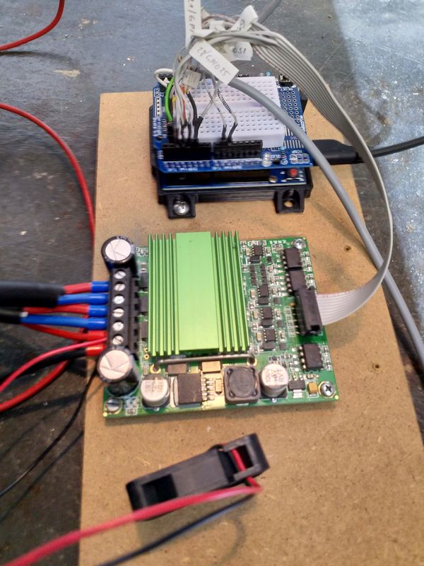

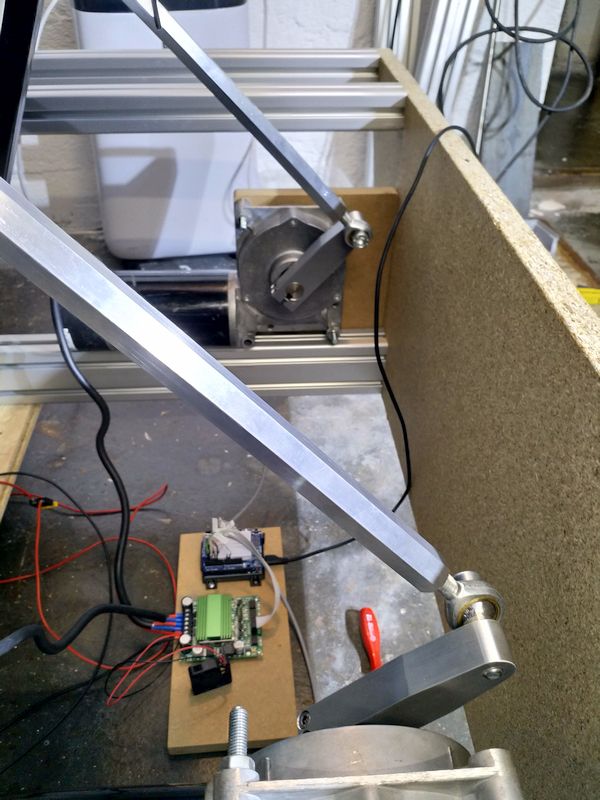

    Nonetheless I continued to build my rig. Milled the levers and turned the pushrods.
    Until now I use this chinese dual H-bridge:
    The used components are not so bad, FETs are IRFB 3307 (75 V, 130 A from datasheet), and it has it's own step down converter on board. But thermal dissipation design is - er - ok, suboptimal... That nice, little, green, hollow (!) heatsink is way to small, and is glued with some thermal silicone on the plastic side of the FETs. For SMT FET there should be a larger area of copper for heat dissipation. But there is - none... At my tests with too high Ki and some oscillations the driver got very hot and burnt a part of the pcb -> smoke. But surprisingly nothing died...
    It's really a shame. On the electronic side this H-bridge could be a winner, but thermal design - along with the underdesigned screw terminals - no comment. Just buy a sabertooth...
