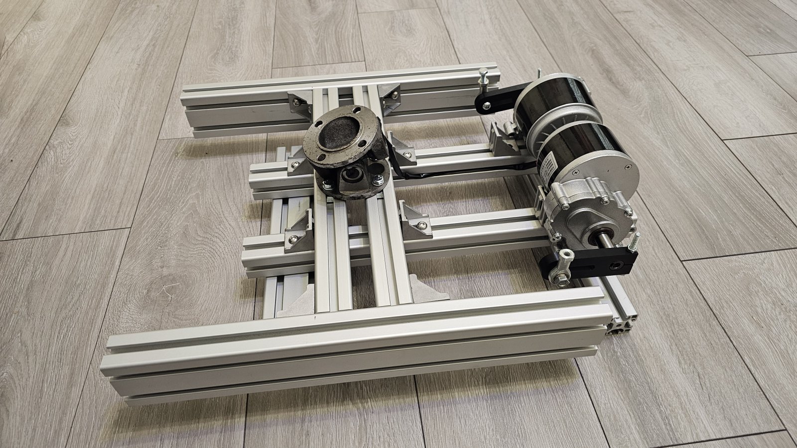

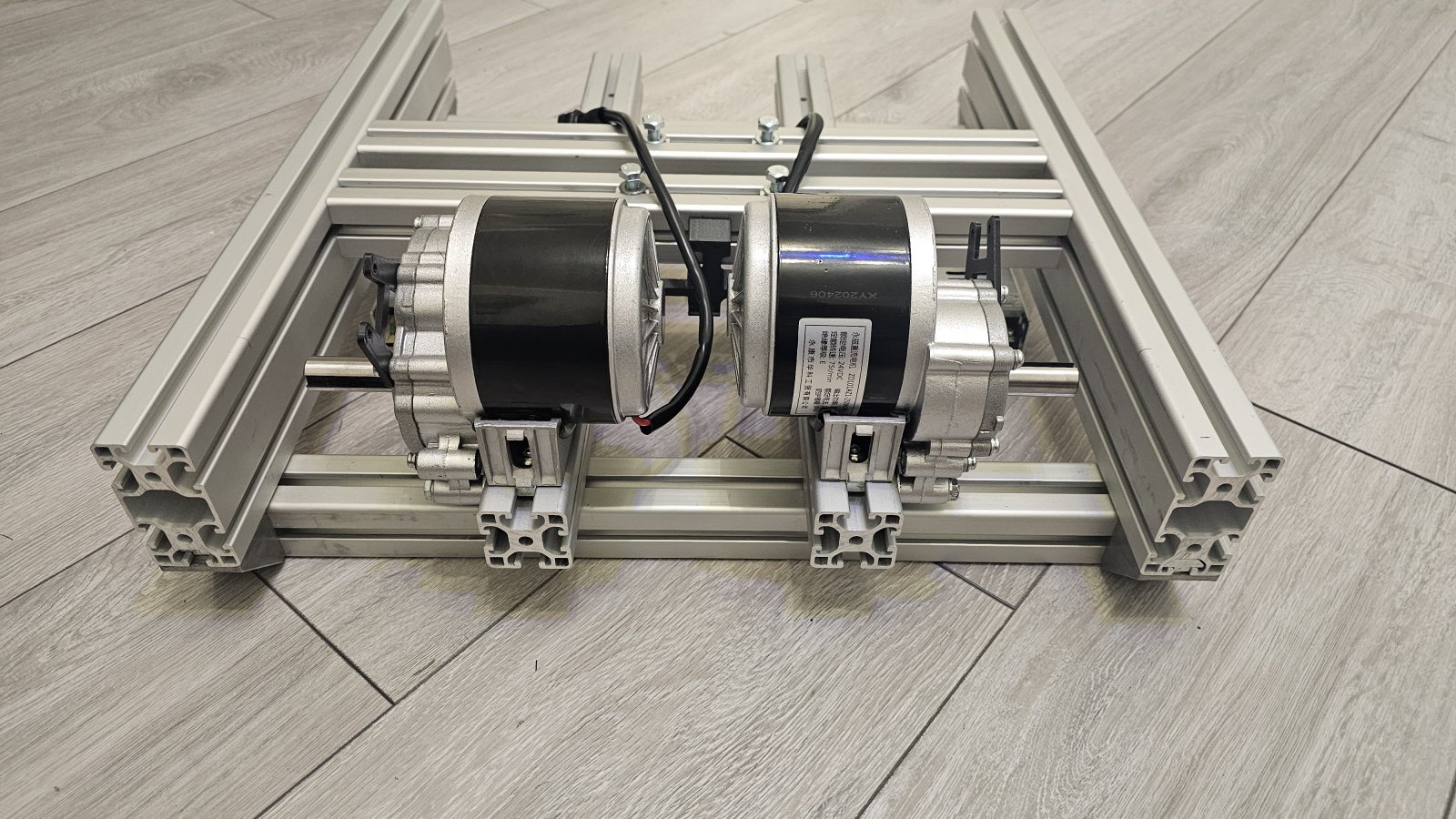

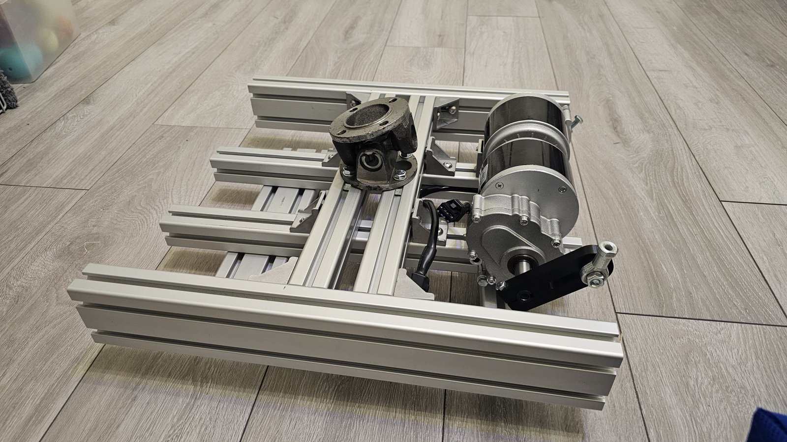

    Alloy arrived so I have been building to base to get a rough idea on layout. Ive 3D printed some arms for now ready to fabricate as needed. Next will be to get the top frame on and the bearing arms connected.
    A quick query too, is there much difference in mounting the motors, more inside the frame than outside, given the arms start position will be the same? Just looking to make it as compact as possible.

    Yeah @noorbeast I will take another look now it's pretty much all built, just didn't know if there was any other reason people mount them differently, maybe just personal choice etc.

    Aesthetics and personal preference are a genuine consideration, but can create challenges when contrary to physics.

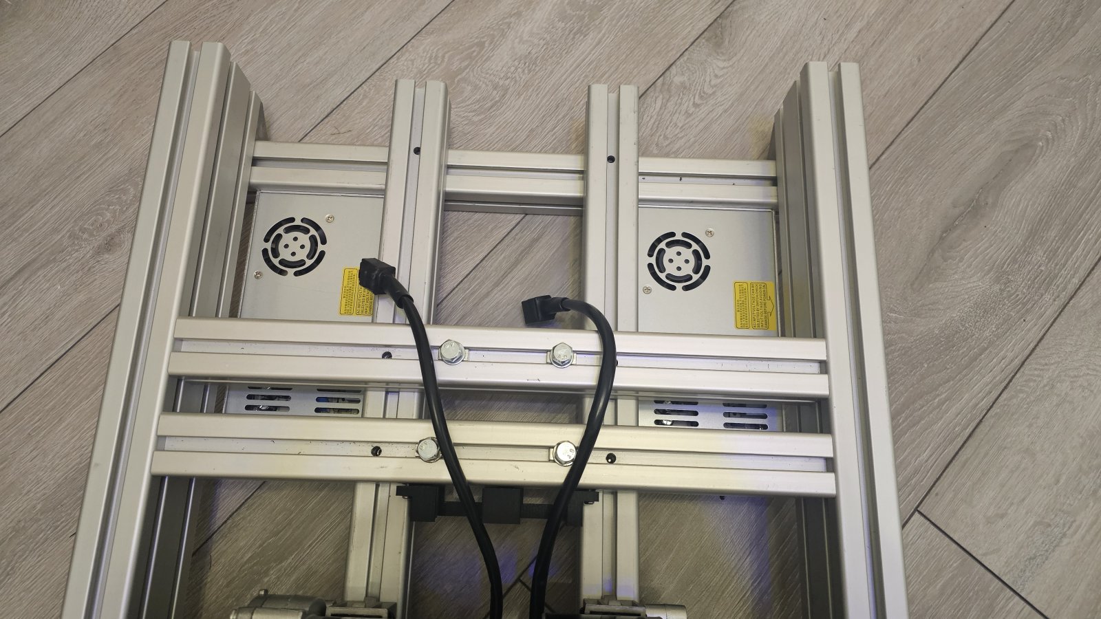

    A quick update then.
    The PSUs are here and I've spent the morning bolting up the base frame, making sure it's all square and tight.

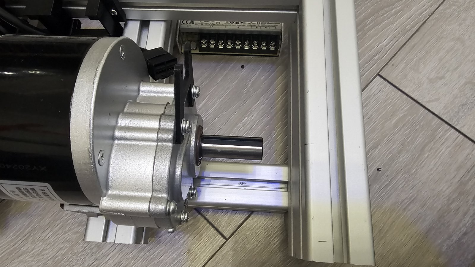

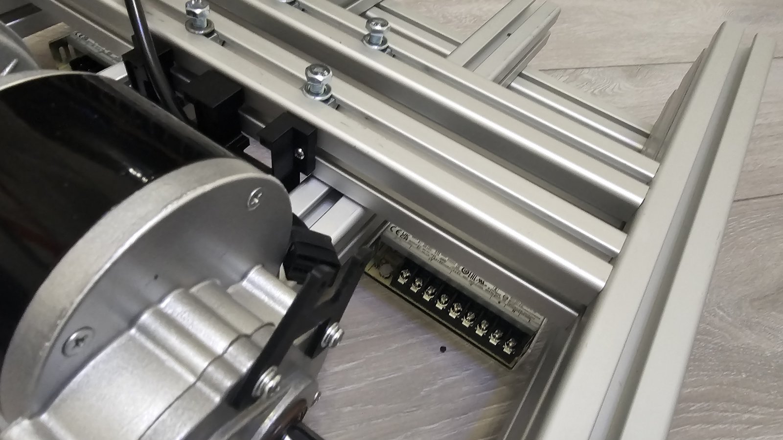

    For the motors, I have added in a bracket either side for extra support, with some protective rubber on the top to just cushion them a little.

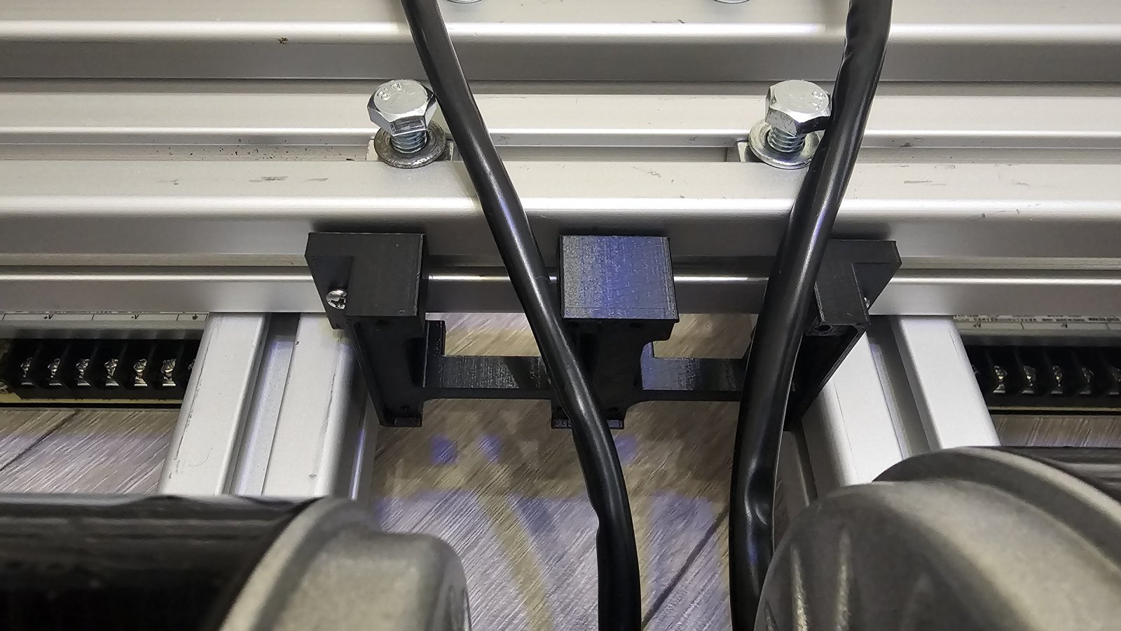

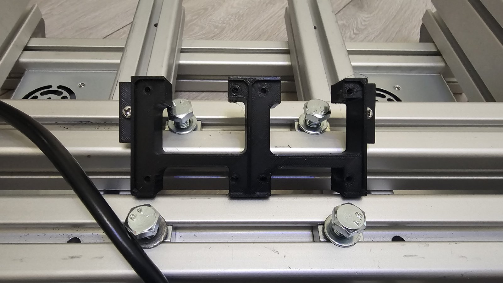

    The motors are mounted, by calculation in the correct place for a 60mm CTC arm. I have also 3D printed a custom dual IBT mount that will have a fan then added over the top. This was taken from an existing design and I am now waiting for some M4 T Nuts to arrive to bolt it in place. THe PSUs will also use the M4 T Nuts, I will be printing the brackets for these over the weekend to get them tucked under the frame.
    I am now just waiting on the CTC arms to be made, £220 I have been quoted by a friend, but his CNC work is amazing. For gears, I am still looking around, the 70t gear I found was MXL, which I believe is different to GT2.
