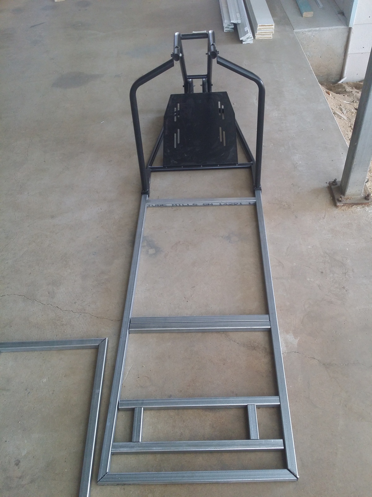

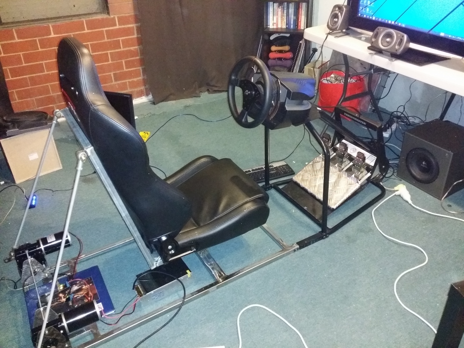

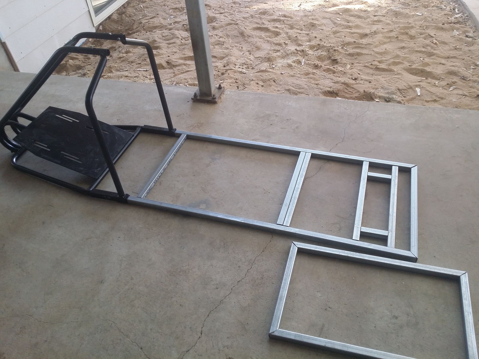

    Alright, Well I have been busy with work and also slack.

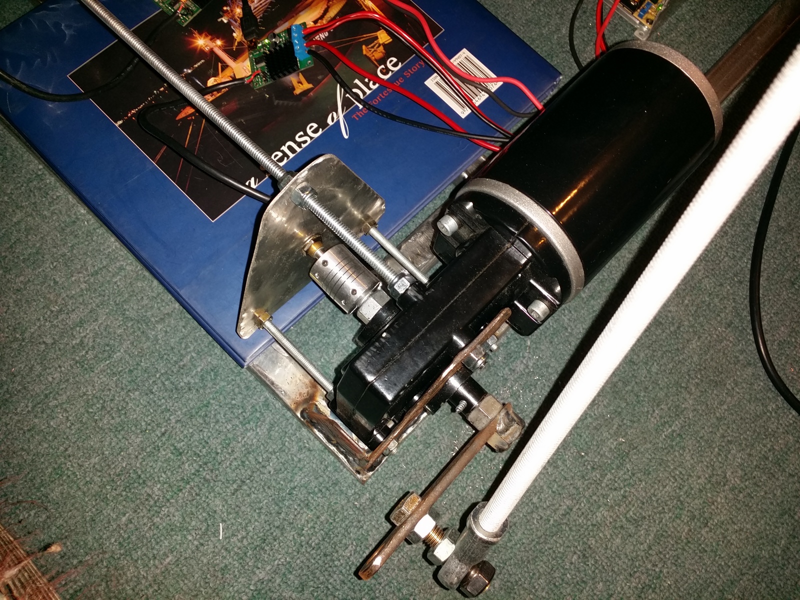

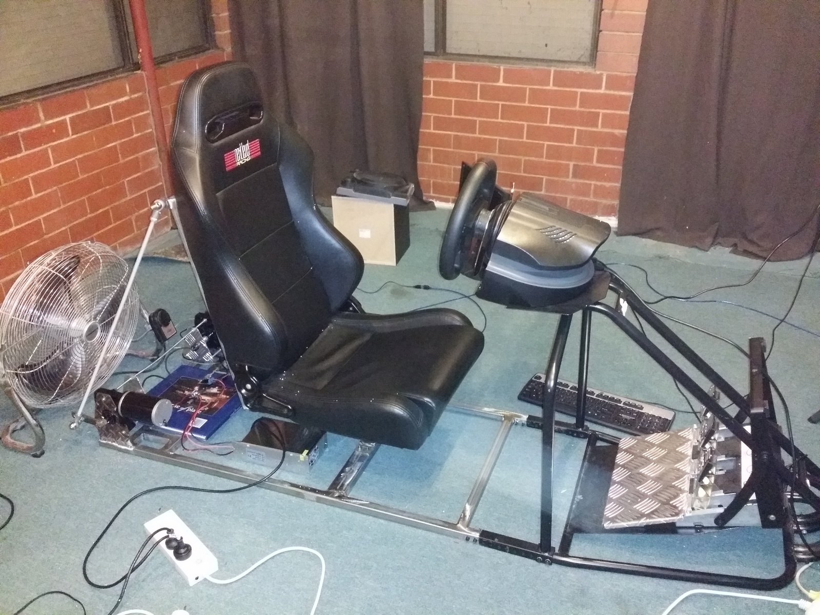

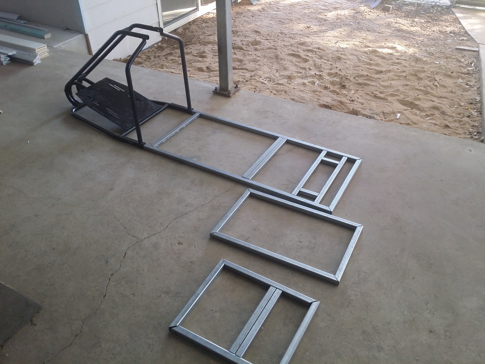

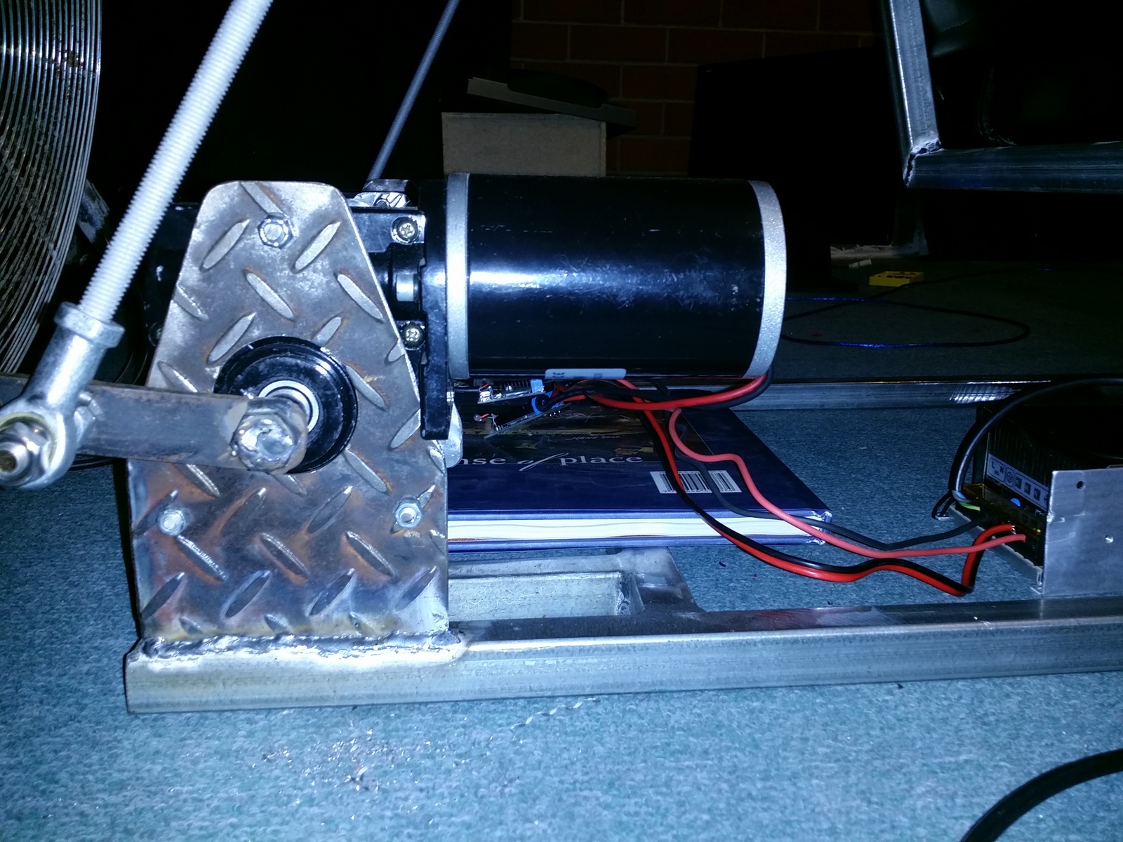

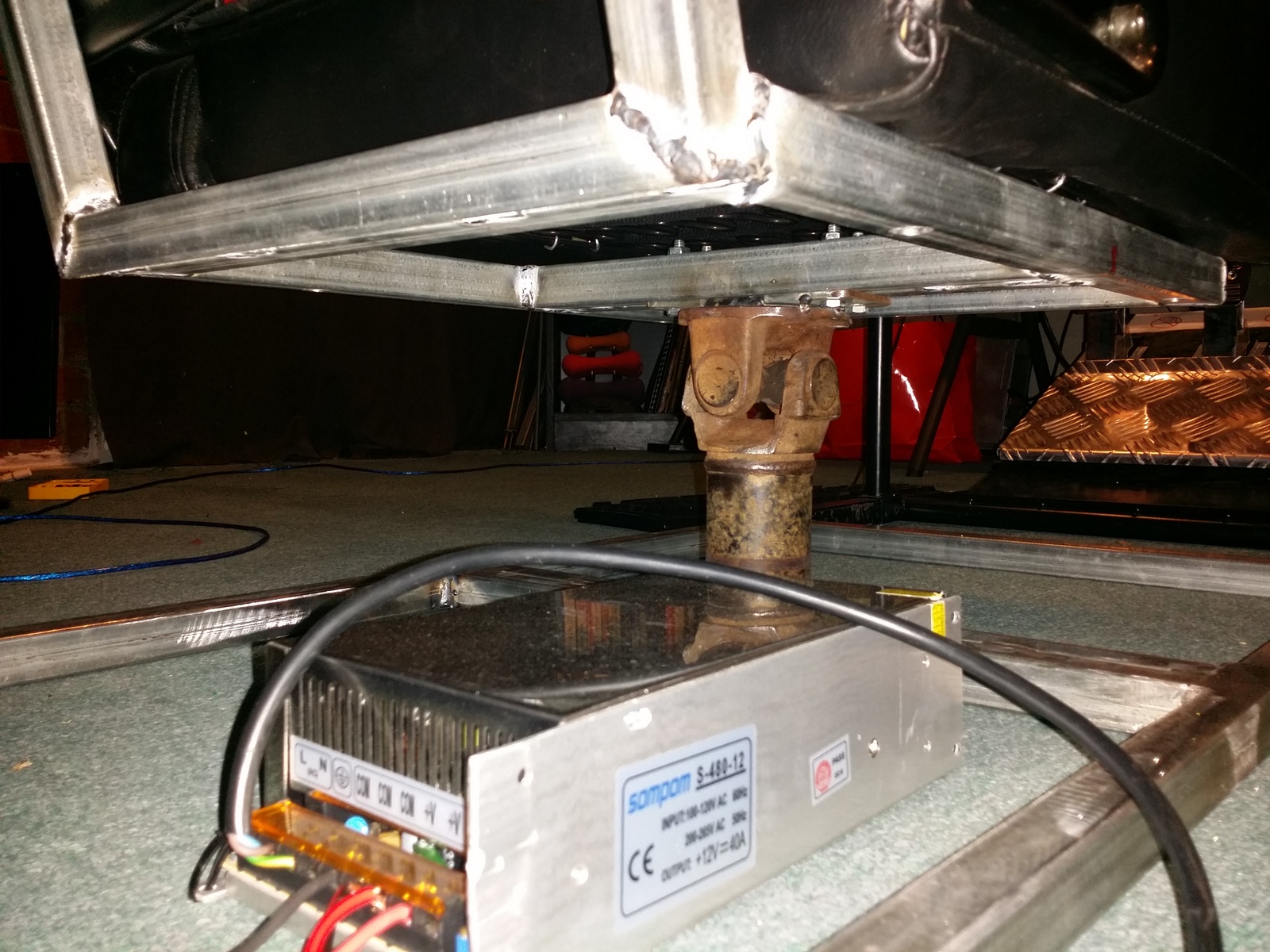

    A few weeks ago @eaorobbie and I put the simulator together. If it wasn't for him, this would have never been possible.
    It's still a work in progres, but it works really well. I have a few things I need to sort out, mostly cosmetically.
    I'll post some pictures for now, if you have questions please feel free to ask.
    We had a little issue so had to make some adjustments with the postions of the motors, I asked to make it has compact as possible, but still be a seat mover. So in the end we had to move the seat forward a little and motors a little further back and outwards if that makes sense. These 25:1 just couldn't continuously keep up with the weight put on them.
    You will notice the different placement of the uni-joint holder for the chair between design and finished product.
    I've very happy with the way it has come out so far, I want to pull it back apart, paint and put some checkered plate on the floor.
    Also need to put the JRK's in a nice box with fans, I just got to excited and wanted to play !!!
    If you have any suggestions or questions I would be happy to hear from you.
    Cheers,
    madgino
    P.S The guy in the photo is not me, it's a metal fabricator *hint*, *hint* :)
