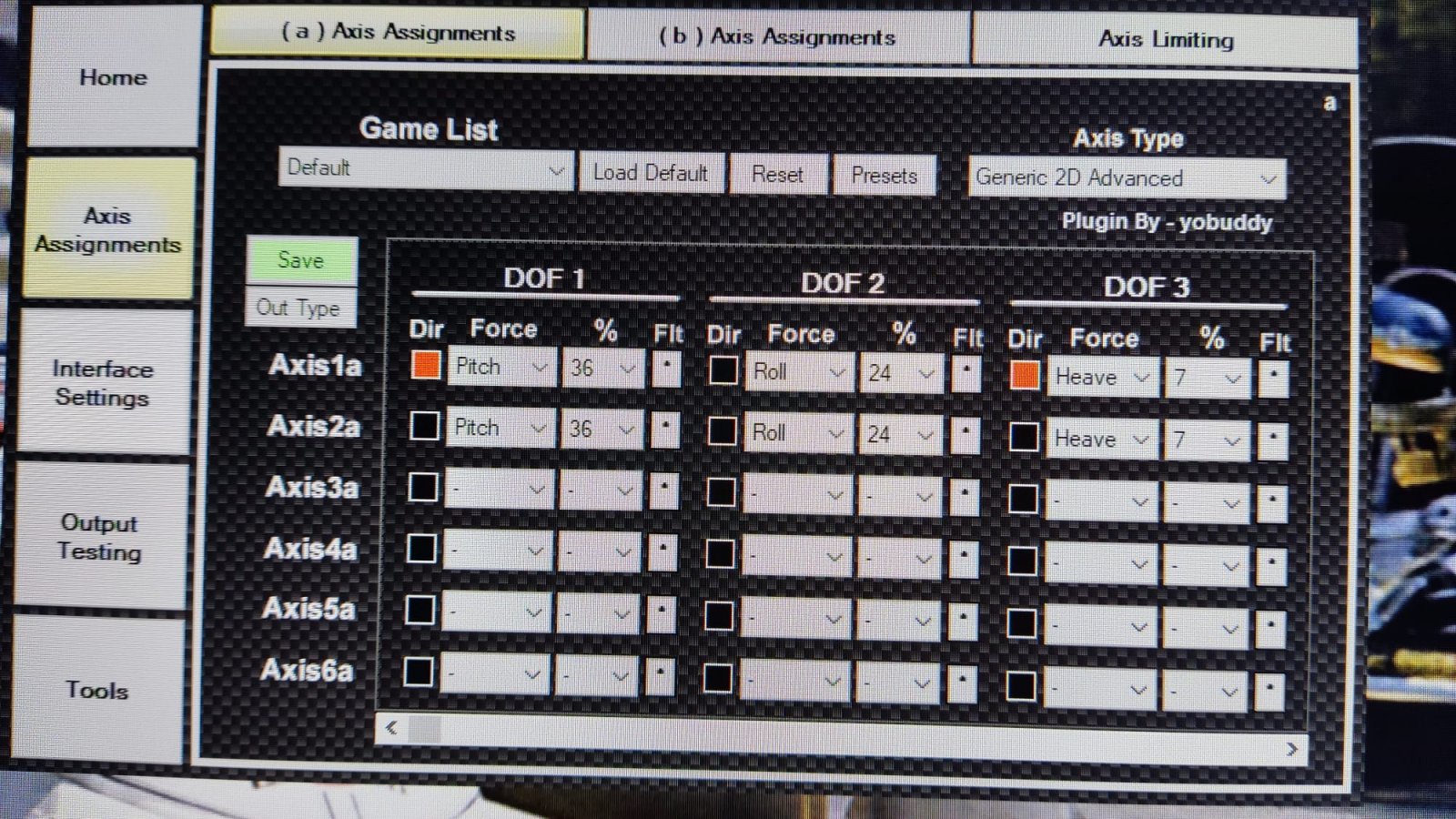

    I have a problem with my 2 dof motion, it uses two motors. I set all ok on SMC3 and is working well, then I try Simtools sliders on test output and everything works. Later when I go to Simtools and play AC, my left motor drops and only moves the right motor.
    What can I do? it happens on AC and ACC, not tried other games, except AMS2 that not have any response.
    21,592
    151,215Coins
    Please post pictures of all of your settings, it could be SMC3 settings need further refinement.
    Design is also a significant possibility, the rig must be properly balanced, with all peripherals attached and you in it, so did you do that?
    The motor placement and lever Center To Center (CTC) used must also be appropriate to the specs of the motor and mass of the rig. What is the lever CTC length and have you tried a shorter CTC length?

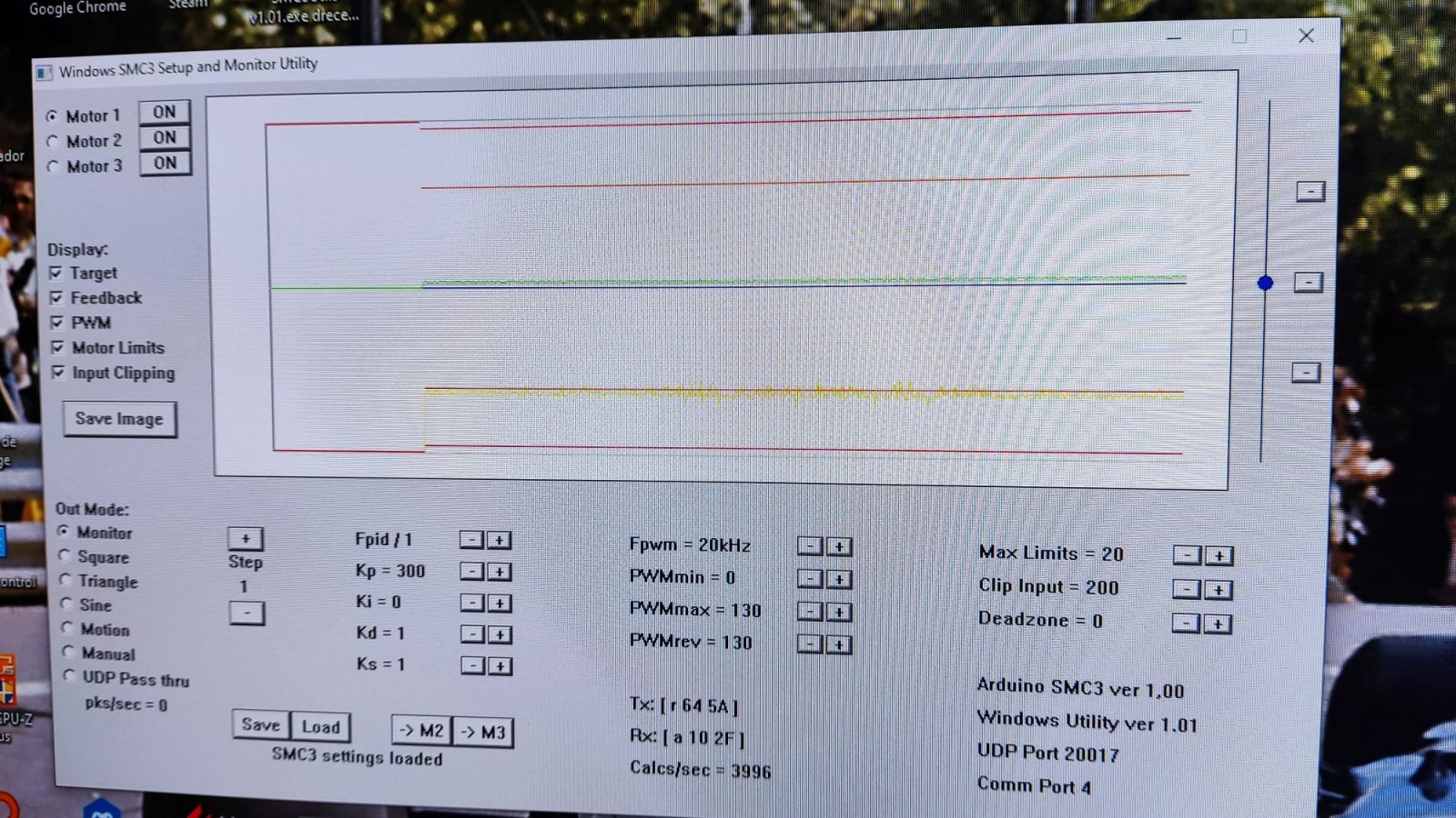

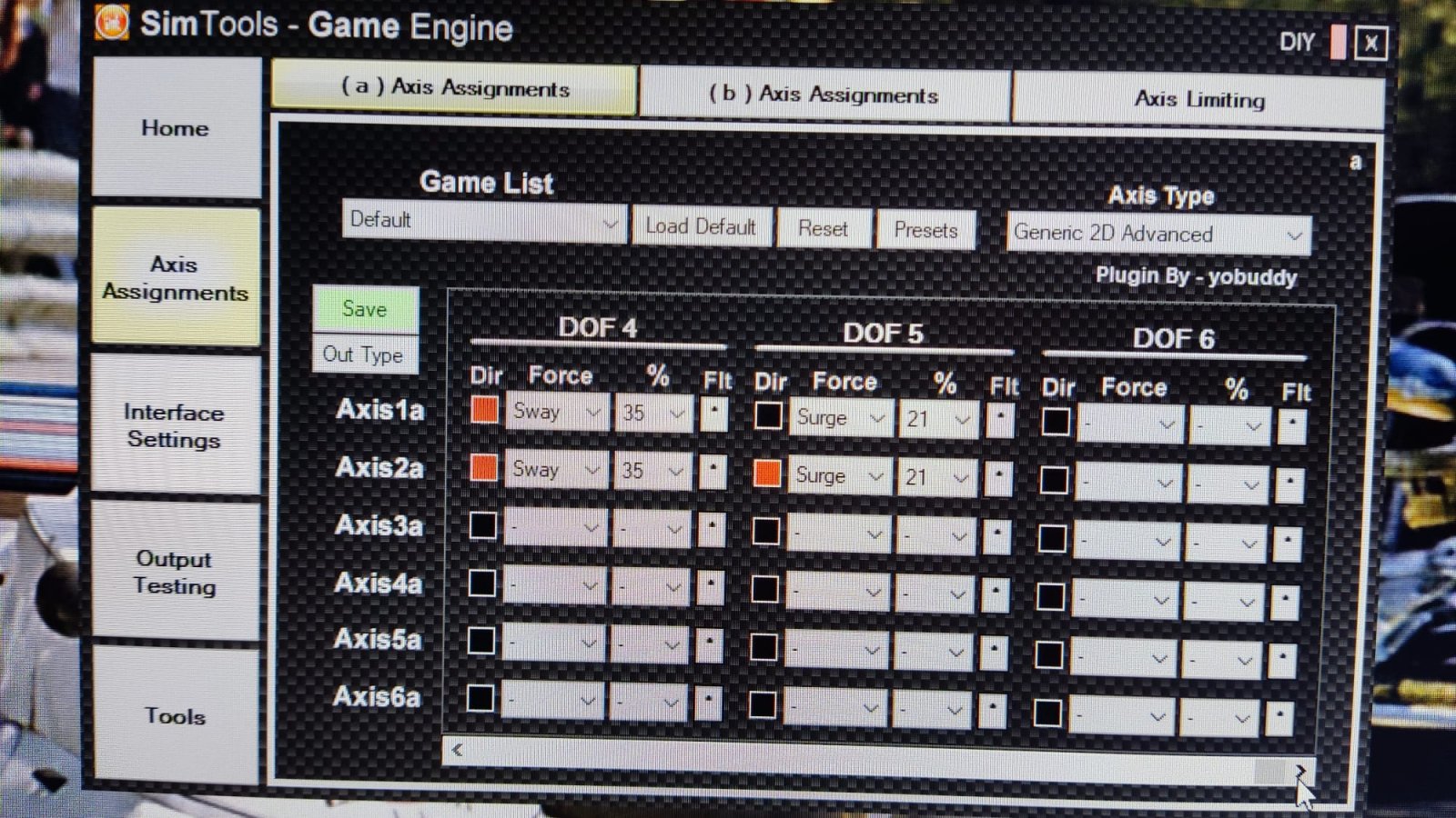

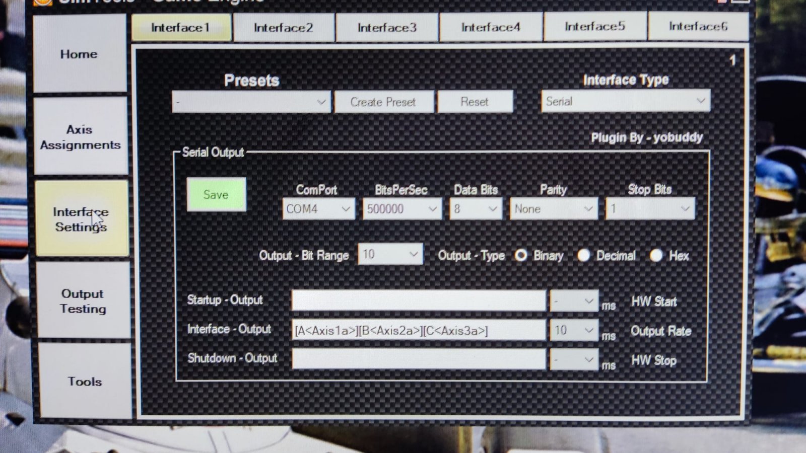

    Hi, I started this sequence:
    1. I go to smc3 and the rig goes up horizontally
    2. I close smc3
    3. Then start game engine
    4. I turn on output testing
    5. I move for enhance the pitch slider to the right and the rig goes up and if I move to the left the rig goes down, when I go far from 30 the rig drops and simtools sliders don’t move the rig, it disconnects.
    6. When this occurs I go back to the step 1
    It’s strange because yesterday I was playing ACC only working one motor and today, when I start ACC the rig goes up horizontally correctly, but when I go inside the cockpit the rig goes down again and disconnects.
    I attach 4 files with my configuration
    Thanks for the info
    21,592
    151,215Coins
    The rig must be properly balanced, with all peripherals attached and you in it when determining the balance point, so did you do that: https://www.xsimulator.net/communit...-of-gravity-to-balance-a-motion-simulator.55/

    Hi again. I did that you say, better for balance, after redoing my center point it was the same, but... I FOUND THE SOLUTION!
    After reading some threads, I saw one talking about antivirus, it was not my case but I checked the programs running in background and I kill someones, then I tried and the problem was out. After I found the program that uses my Gigabyte called Check_kill that controls a program called RGB fusion and it was the BIG problem. Renamed and kicked out from my system. Now I'm flying on the moon, hahaha... what funny is this motion. Thanks for all the clues that you gave me. A big hug for everybody
