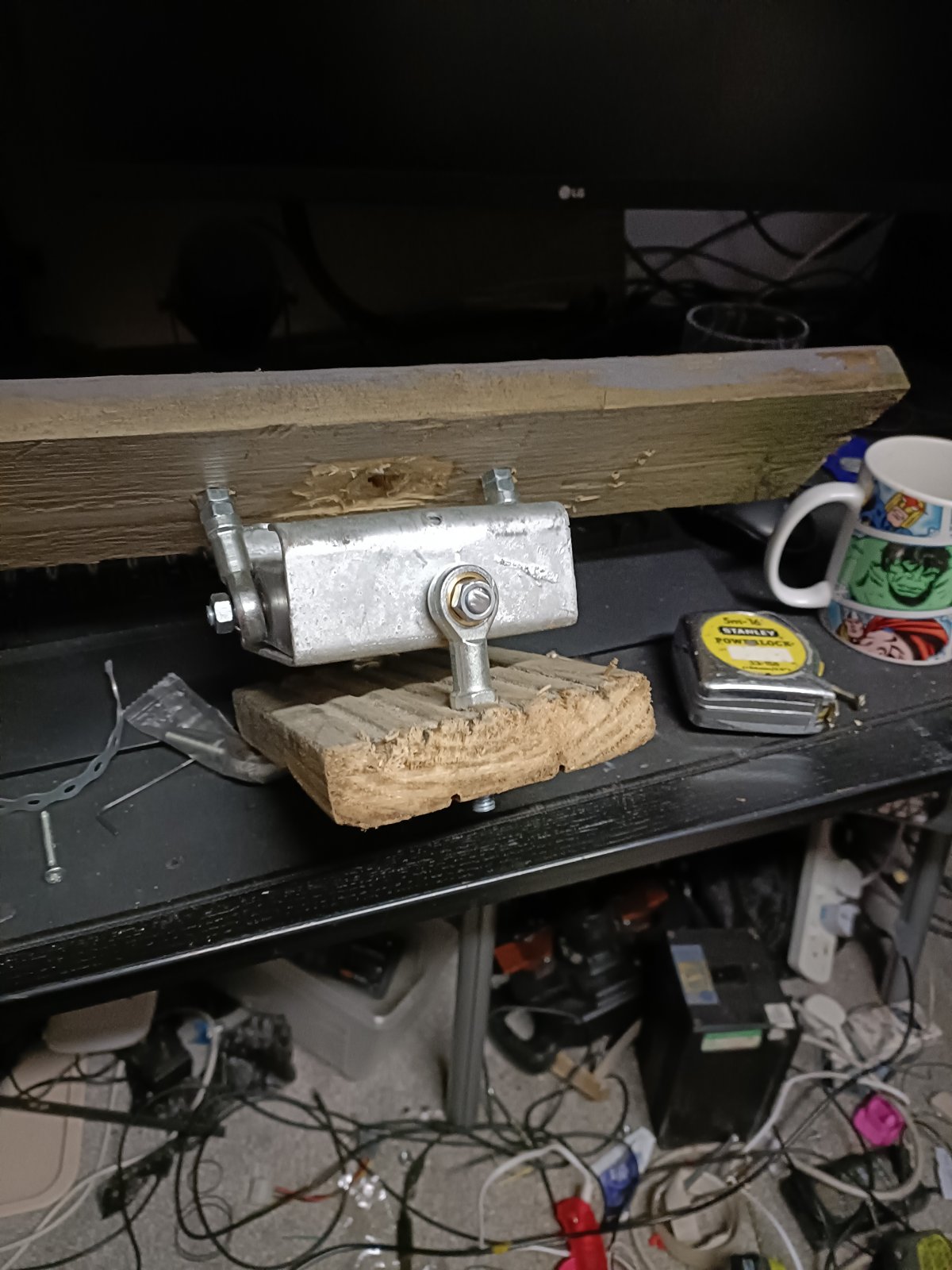

    Built my own heavy duty u joint.

    It is a good idea for those who do not have a universal joint

    curious how durable it is in action. good job!

    From the feel of it I think it will be very. Hopefully anyway

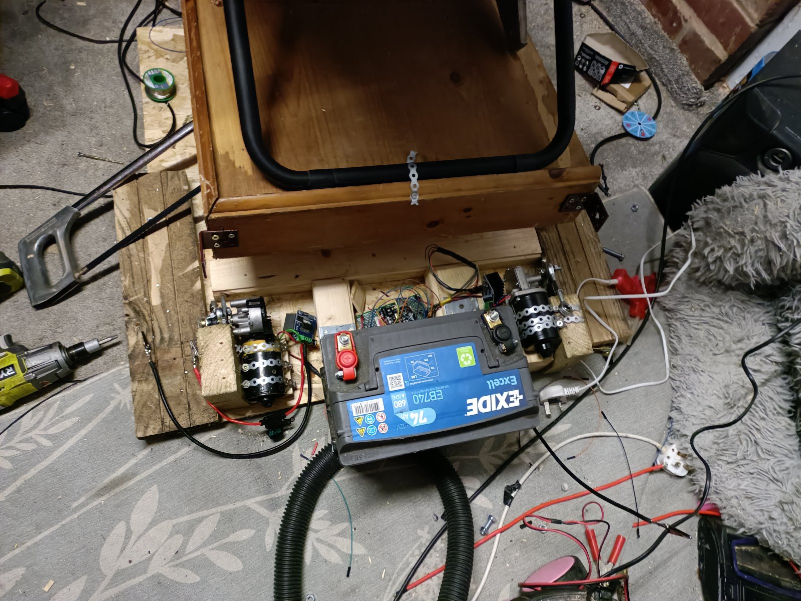

    Iv just shorted my motor arms. With the rig been wood it's very heavy for the windscreen motors. Going to test tonight.

    Had to put battery on rear as counterbalance, due to oversight on my part. Version 2 out of aluminium will be much more compact.
    Just need to connect everything up and test now.

    Was hoping to have this working by now. Had an issue with motor 2. Only working in 1 direction. After much testing and resorting to applying 5v to the enable pin and power pin figure out I have a faulty h-bridge. Waiting for replacement

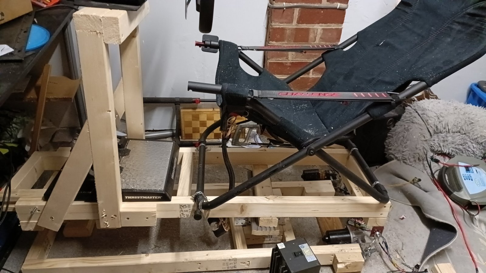

    Since waiting for my replacement h-bridge I decided to rebuild my rig as it's way way to heave and huge.
    Will have an better update soon

    Built a complete new rig out of wood..basic design that I'm going to use in aluminium in the future.

    Actually got it working :) got my self a cv joint for £6 to see if it would remove some of the unwanted rotation. but no difference. Limits of a wooden rig.
    Going to neaten up cables and submit a video.
