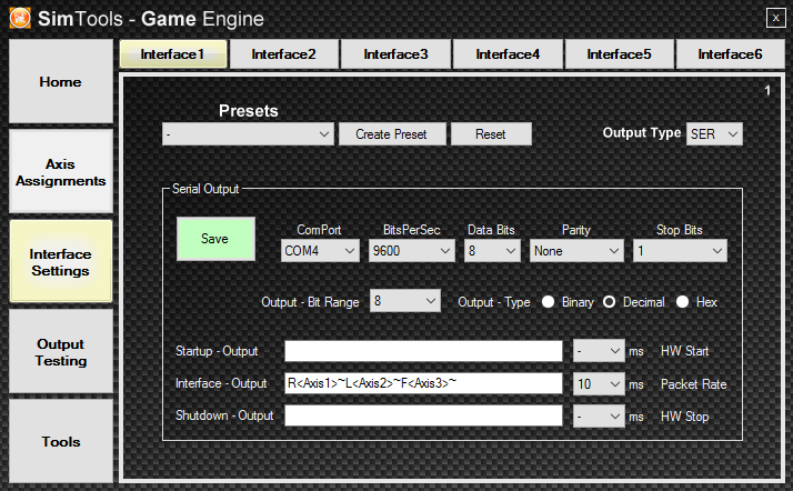

    I have the preset and the arduino code from the @eaorobbie 's post: https://www.xsimulator.net/community/marketplace/rc-model-code-for-arduino-uno-2dof-expandable.89/
    and for the configuration I used this Captura de pantalla 2016-08-02 13.53.16.png Captura de pantalla 2016-08-02 13.54.15.png
    I did right now the unpatching and patching of the game and it seems that it works, but like the both microservos are moving with the same forces, like both are configured for the same movements, I think this problem is related with the Axis Assignments and de DOF 2 configuration, but I didn't find anything to configure this in the right way

    In Axis Assignments the Dir box determines which way and axis moves. For roll one Dir box should be checked so it is orange. That way one servo goes up and the other goes down for roll.
    The convention for which way each force/axis should move is here: https://www.xsimulator.net/community/faq/which-way-to-set-simtool-axis-movements.230
    You should read through the official SimTools documentation, so you have a foundation for understanding how it is configured: https://www.xsimulator.net/simtools-complete-documentation/
    You will also find specific tips and tweaks in the FAQs: https://www.xsimulator.net/community/faq/simtools-settings-tips-and-tricks.18/category

    After reading all the tips that you give me I've changed the configuration, but I still have a problem.
    When I'm going to start a race one of the microservos, change its position, and also when I turn right it still in the same position that going straight. I left here the new configuration in order to know if it comes by there:

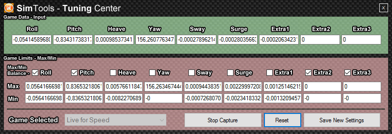

    I think that the problem could be related with the tunning centre, I have followed the steps that are at the FAQ section, by you @noorbeast and by @eaorobbie but I get some strange numbers, here is the image:
    Please help me in this issue, I don't know what else could I do
    21,581
    151,100Coins
    It is not the plugin it is the configuration. If I understand correctly you have one RC servo that acts as expected and one that just stays in the same position, is that correct?
    If that is so check all wiring and configuration.
    Have you got batteries or something that supplies power to the RC servos, as depending on what they are they can draw more than the Arduino can supply.
    In the Interface Output you can just use 2 axis instead of 3.
