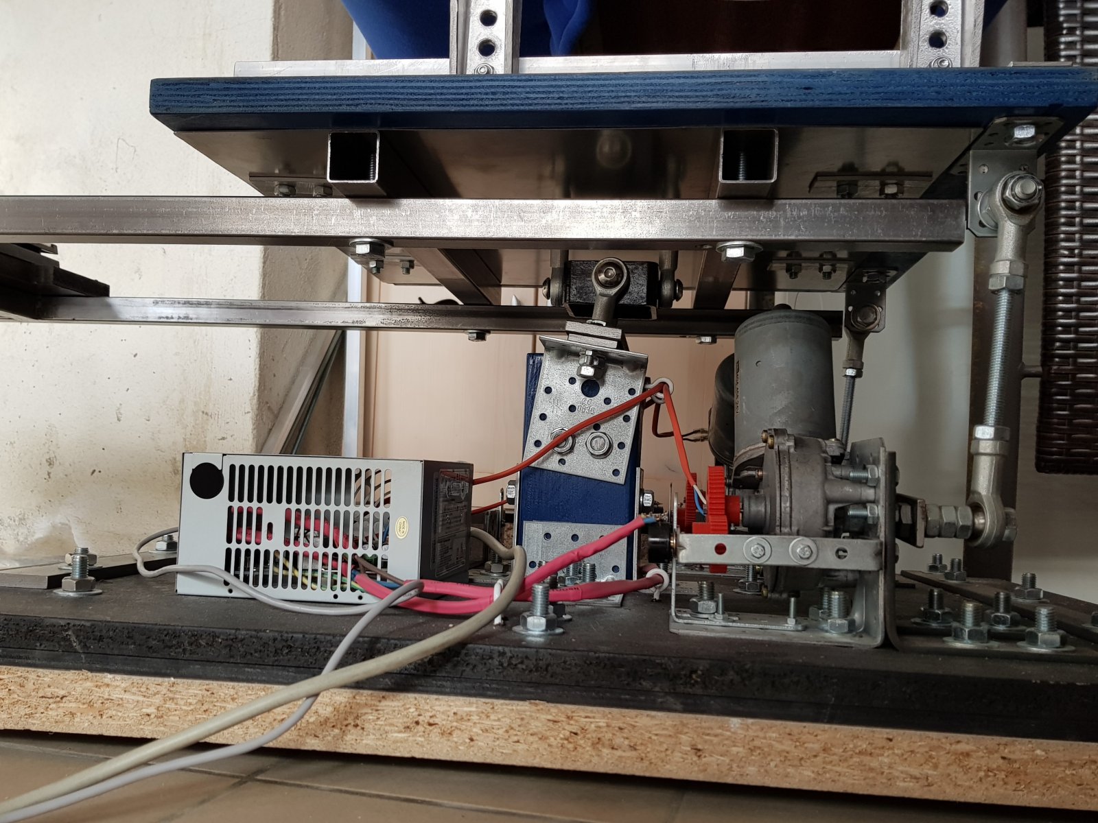

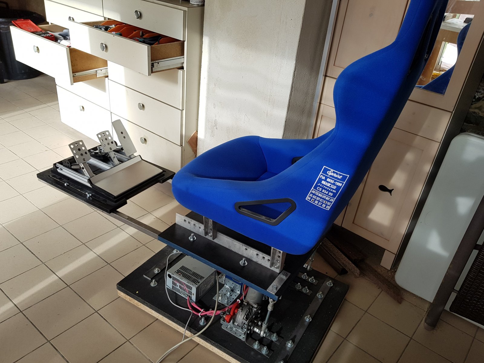

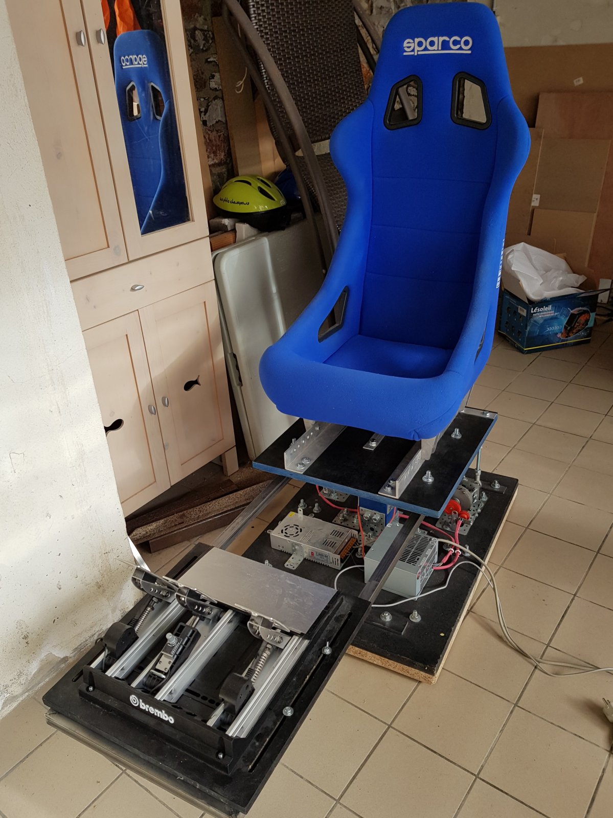

    Hey there, back again on this project, as I had to make a break for a while ...
    Many week s has passed, and I have to restart to learn everything that used to be simple in 2015 :confused:
    Anyway, here are some pictures of what I made this weekend, hopefully I will finish the whole installation with steering wheel and gearbox next saturday. Then settings and first tests with games in real situation (have also oculus rift, and mostly play dirt rally, assetto corsa, and elite dangerous)
    Sorry to all of those who have waited for information (not much now I'm afraid :D), I'm pretty confident I will finish this project soon and will enjoy it as it must be.
    Stop talking, photos now :
    Bye
