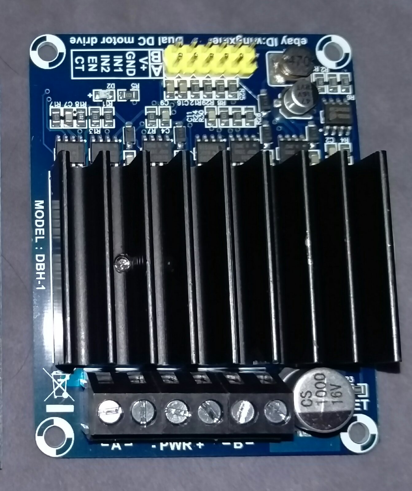

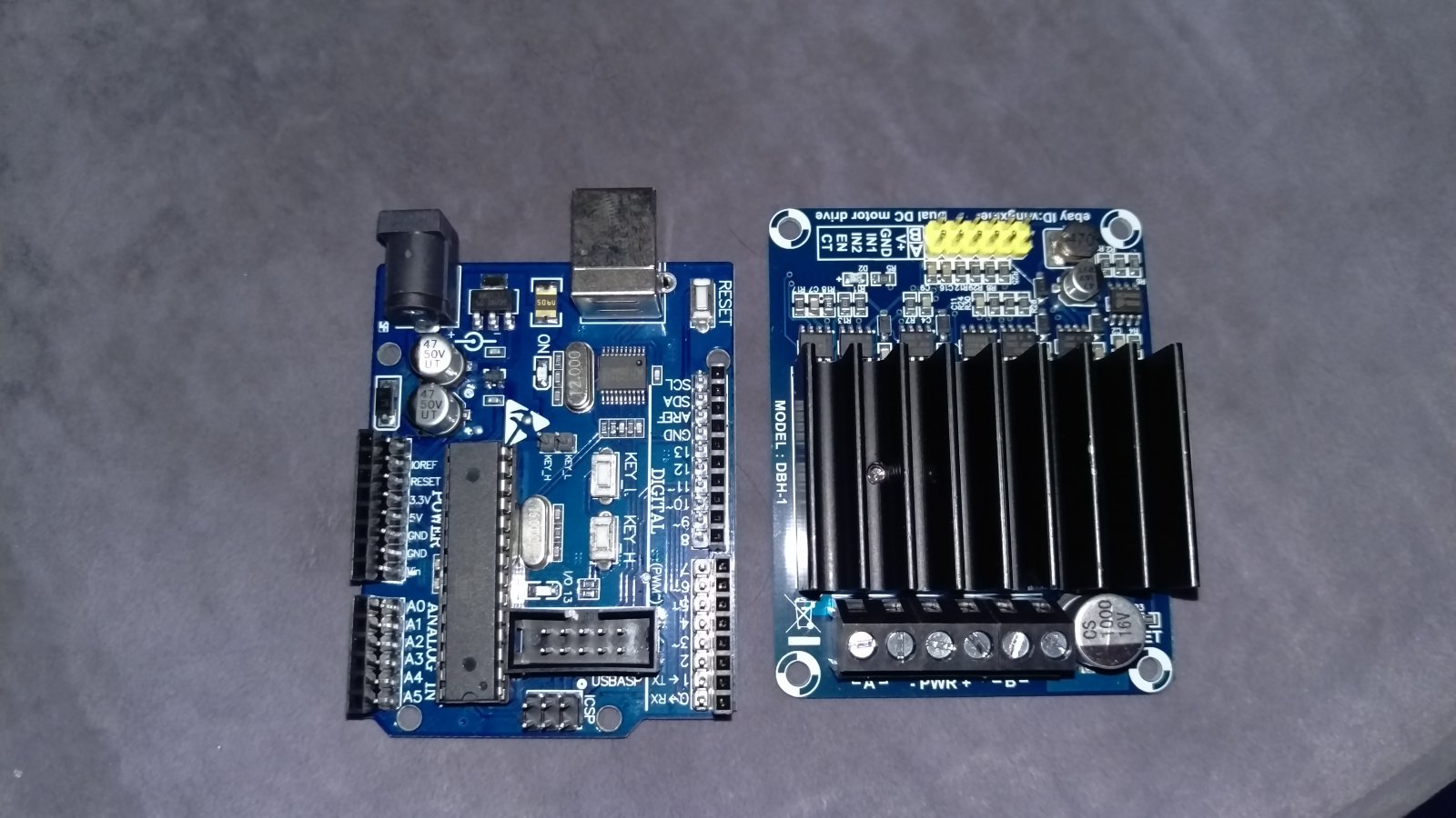

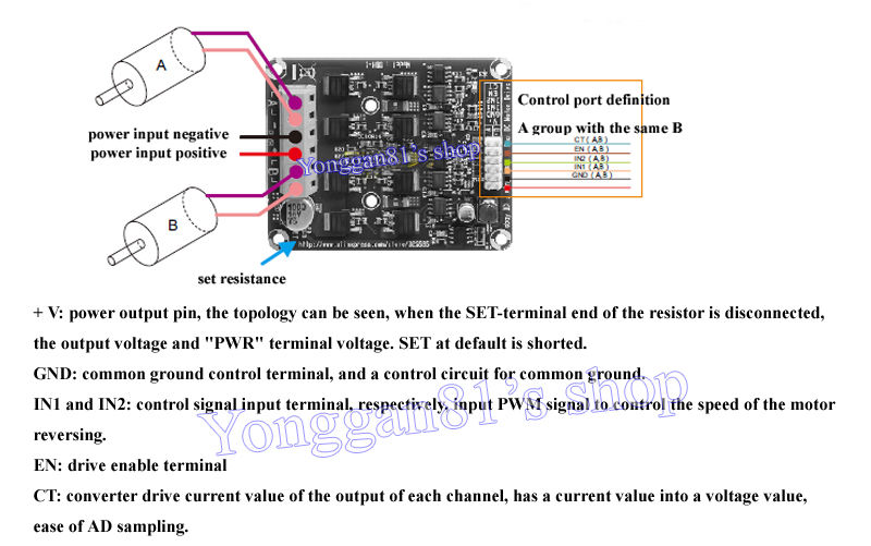

    Hi all
    can anyone tell me if this Arduino and H-bridge will work with Racing mat's 2dof code
    if yes please I need a wiring diagram:sos
  2. yobuddy
    51,674Coins
    +5,204 / 19 / -0
    @MarcNSF ,
    First I have not seen any spec sheet on the HBridge, the PDF you sent has noting useful in it.
    I would think they have some real documentation somewhere?
    Anyway, looking at the HBridge, you can see where the motors get attached on the bottom where its labeled 'A' and 'B'.
    The center two screws on the bottom of the HBridge is where the battery gets attached.
    So that takes care of the 6 screws on the bottom.
    You with me so far?
    Next you can see on the top, where the yellow pin header is, that there are 2 rows.
    One for 'A' motor and one for 'B' motor.
    I believe the Int1 and Int2 are the direction pins for each motor.
    The GND and + is power and ground from the Arduino. (not sure if its 3.3v or 5v thou, guessing 5v)
    EN = enable so both of those get hooked to (5v?)
    and the CT is the PWM input pins.
    ....GND <-> GND pin
    .........5V <-> 5V & (EN1 & EN2 - probably could attach a safety switch here)
    .....pin 4 <-> in1 motor1
    .....pin 5 <-> CT1
    .....pin 6 <-> CT2
    .....pin 7 <-> in2 motor2
    .....pin 8 <-> in1 motor1
    .....pin 9 <-> in2 motor2
    .....pinA0 <-> center pin of pot 1
    .....pinA1 <-> center pin of pot 2
    .....pinGND <-> 0 ohm's pin potentiometer 1 & 2
    .....pin 5V <-> 10k ohm's pin potentiometer 1 & 2
    You understand @MarcNSF ?
    Does this look good @RacingMat

    The HBridge didn't have any other documentation
    wasn't sure about in1 ,in2 ,and CT didn't want to burn the HBridge :p
    Thanks for the explanation @yobuddy hug:

    Hi @yobuddy
    found this HBridge from the same supplier but it's a single motor driver
    Performance parameters:
     Rated voltage: 3 V-15 V
     R1 short circuit, VCC and B + short circuit. VCC output voltage and drive the input voltage.
     R1 open circuit, VCC and B + disconnect. VCC input voltage 3-12 V.
     Rated current: 30 A
     Current peak: 70 A
     Switching frequency: 1 K to 200 kHz
     Dimensions: 5.0 cm (long) * 5.0 cm (wide) * 3.1 cm (high)
    V + Power Input +
    GND Power Input -
    EN Driver Enable, high enable, low off
    RPWM Forward PWM input, high active
    LPWM Reverse PWM input, active high
    CT Current signal output, analog signal
    VT Voltage signal output, analog signal
    The CT is a current output
    What do you think should I proceed with your wiring diagram?

    Hi
    this what I came up to regarding my Hbridge with the sm3 code
    but not sure about the pwm of it goes to in1 or in2:confused:
    pin2 ENA ---->A IN1 motor 1
    Pin3 ENB --+->A EN motor 1
    Pin9 PWM ---->A IN2 motor 1
    pin4 ENA ---->B IN1 motor 2
    Pin5 ENB --+->B EN motor 2
    Pin10 PWM ---->B IN2 motor 2
  8. yobuddy
    51,674Coins
    +5,204 / 19 / -0
    the In1 and In2 are the direction pins.
    the PWM goes to the CT pins of the HBridge.
    What's wrong with the one you got buddy?
  9. MarcNSF
    MarcNSF Marc
    May 24, 2017
    66

    @yobuddy
    I'm still using the same HBridge
    Found this while searching
    https://github.com/bjornburton/champbot/wiki/H-Bridge-DBH-01C
    This is the same h-bridge I have and they have some documentation on it
    The CT is really current output
    That's why I sent this:
    But still confused about PWM and in1,in2
    Do you agree???
    Any advice??

  11. yobuddy
    51,674Coins
    +5,204 / 19 / -0
    you would not hook the PWM pin to a direction pin.
    Use it as the CT input.
    like this buddy
    Ard ---------- Hbridge
    ....GND <-> GND pin
    .....pin 5 <-> CT1
    .....pin 6 <-> CT2

    Wired everything up:
    ....GND <-> GND pin
    .....pin 5 <-> CT1
    .....pin 6 <-> CT2
    After checking every single wire many times, I turned it on
    The PC immediately turned off
    The USB port ,ARD and Hbridge sadly died
  13. MarcNSF
    MarcNSF Marc
    May 24, 2017
    66
    Lebanon
    - 97Coins
    +42 / 0 / -0
    Bought new ARD, HBridge and a usb hub with external power supply
    Wired it up :
    ....GND <->
    .........5V <->
    .....pin 4 <-> in1a motor-a
    .....pin 5 <-> ENa
    .....pin 6 <-> ENb
    .....pin 7 <-> in1b motor-b
    .....pin 8 <-> in2a motor-a
    .....pin 9 <-> in2b motor-b
    It worked finally :)
    But the output of the motors reached 5V max
    Any ideas?
    Marc

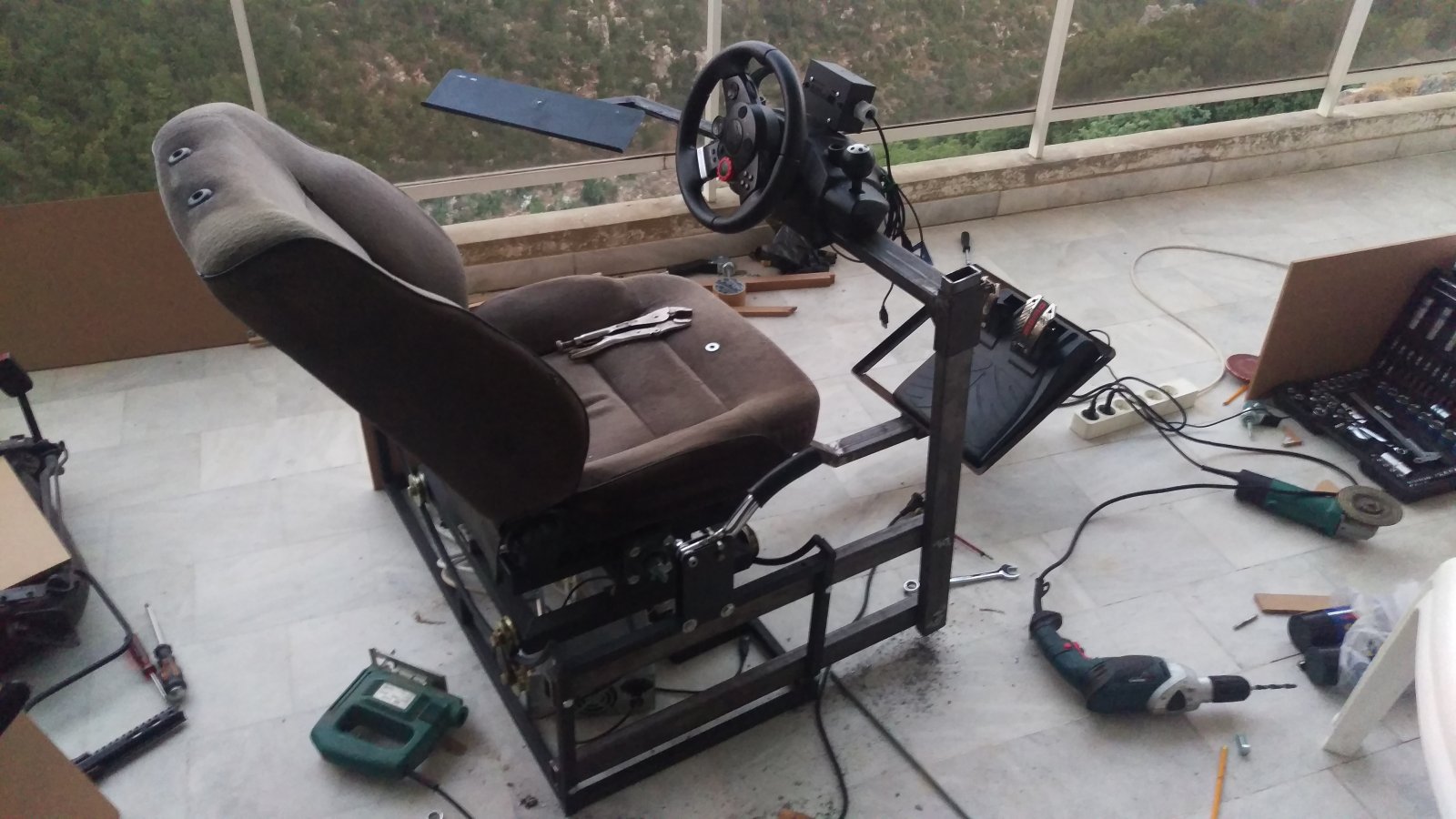

    Hi all
    Using the SMC3 software and code helped a lot
    The platform is working:D
    Thanks to @RufusDufus ,@noorbeast ,@yobuddy ,@Pit and this great forum
    Will post some videos
    And pics soon
    Regards
    Marc

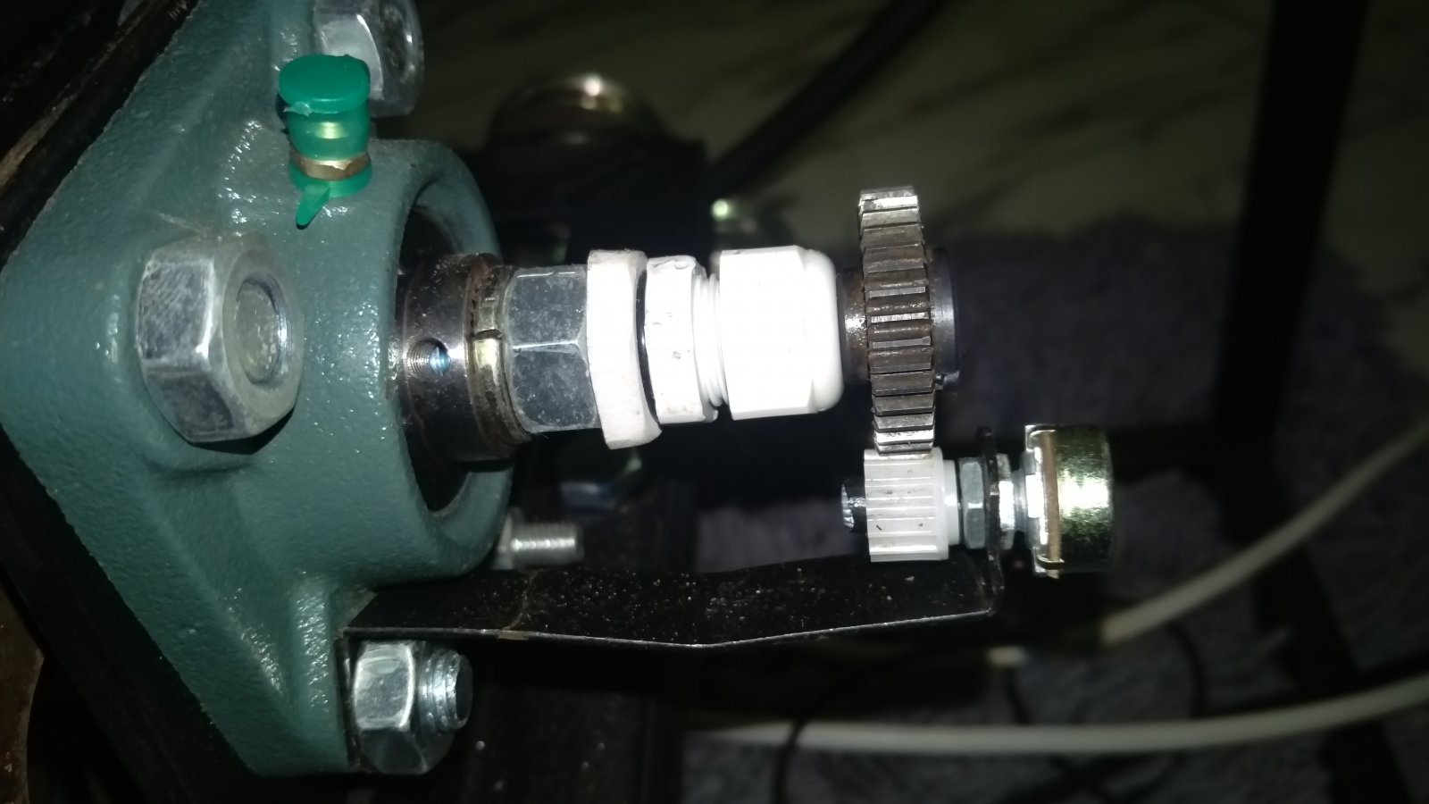

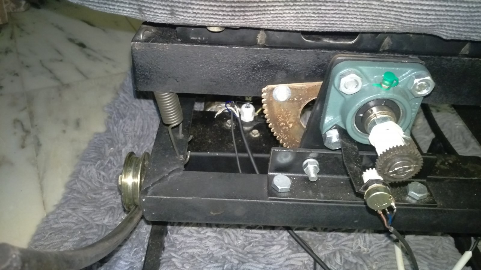

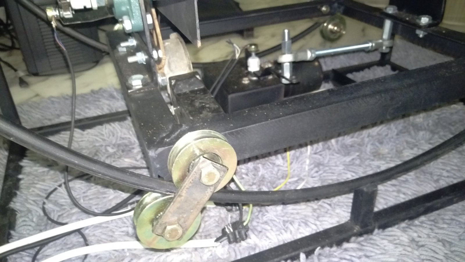

    Had to add 2 springs to counter balance
    One is always under tention ,the second will be when the rig tilts backwards
    Also added roller bearings
    For more precise sensitivity

    As promised a small test video
    Dirt Rally motion test

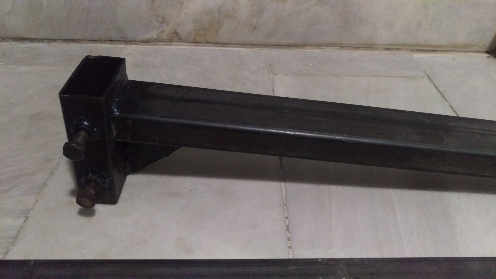

    Upgraded the rig;)
    • Like Like x 5

    Man that is different to anything I have ever seen, its cool and compact as well, well done awesome work.
  20. ferslash
    ferslash Active Member
    Feb 8, 2011
    495
    4,798Coins
    +181 / 2 / -0

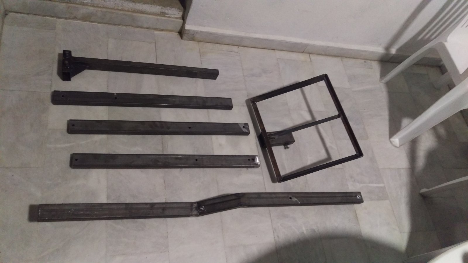

    how did you bend the steal that good to be round and equal in the two bended bars?
    nice sim!
    fer
