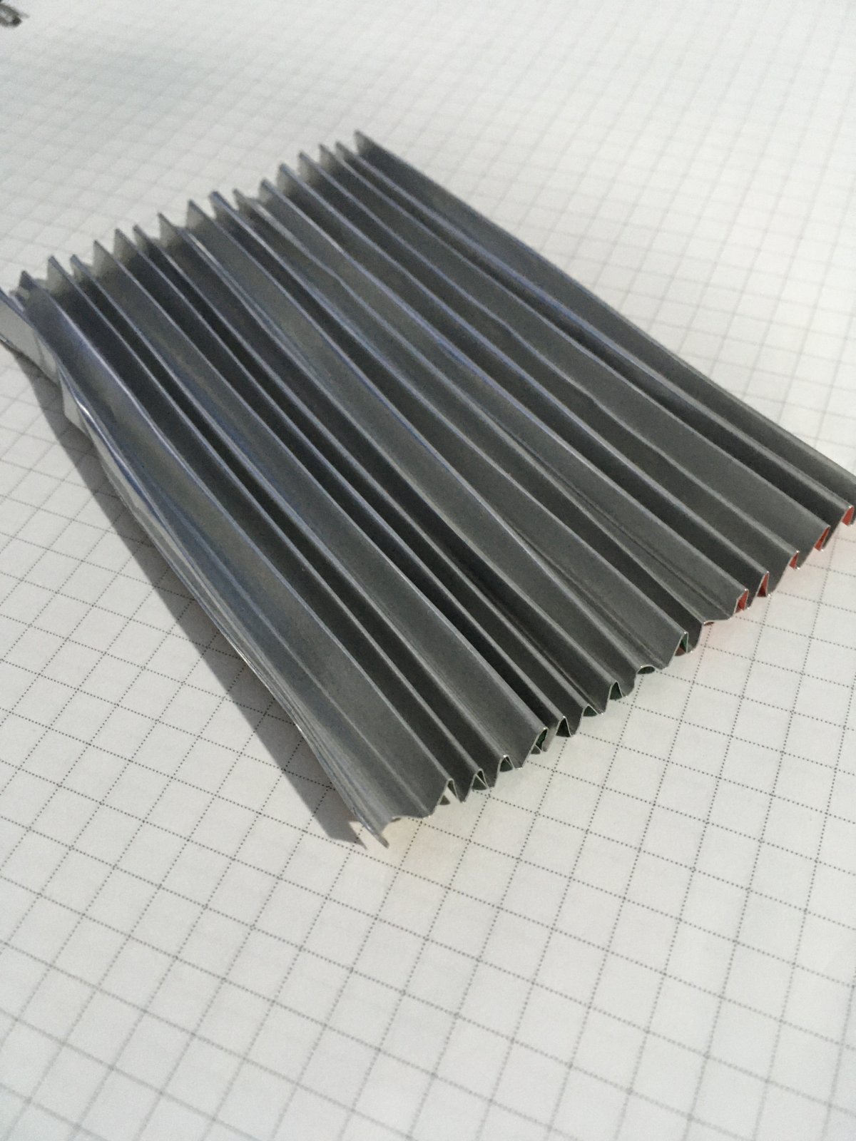

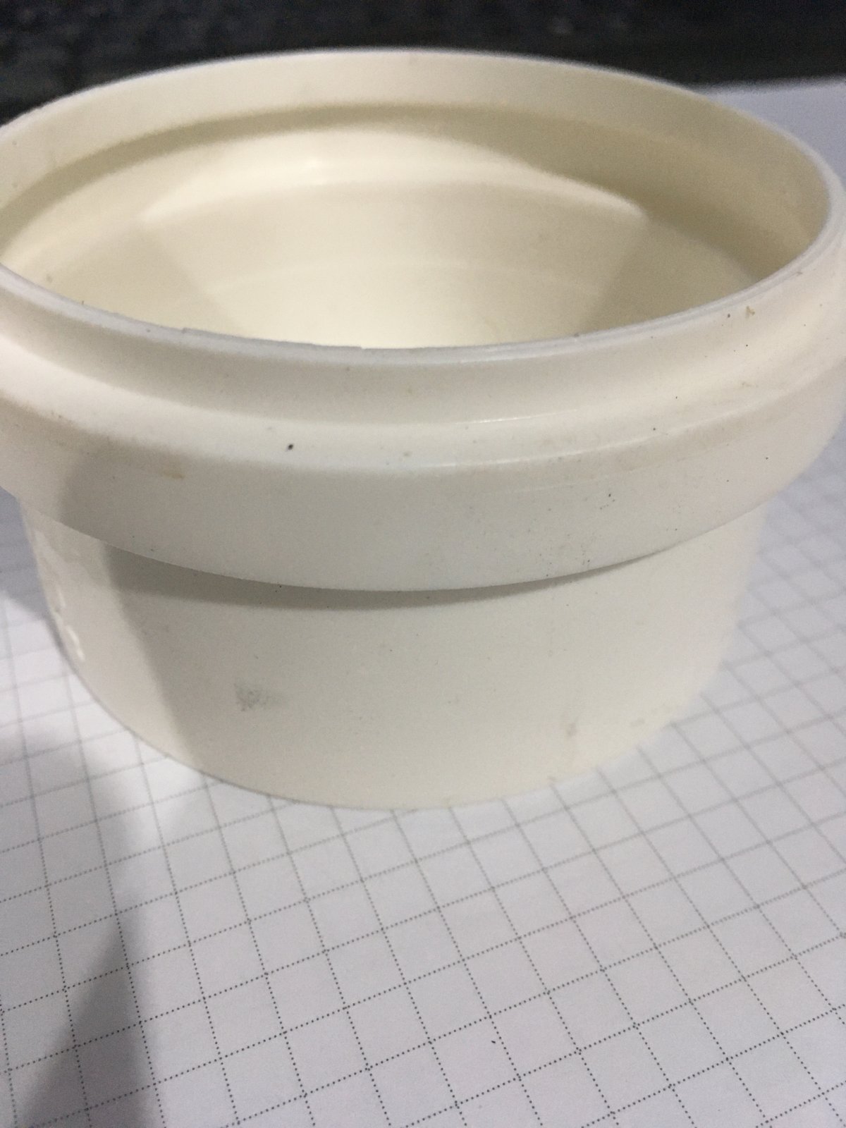

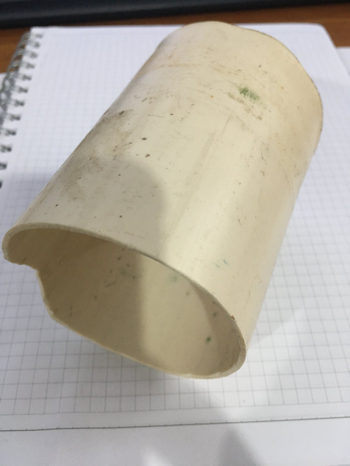

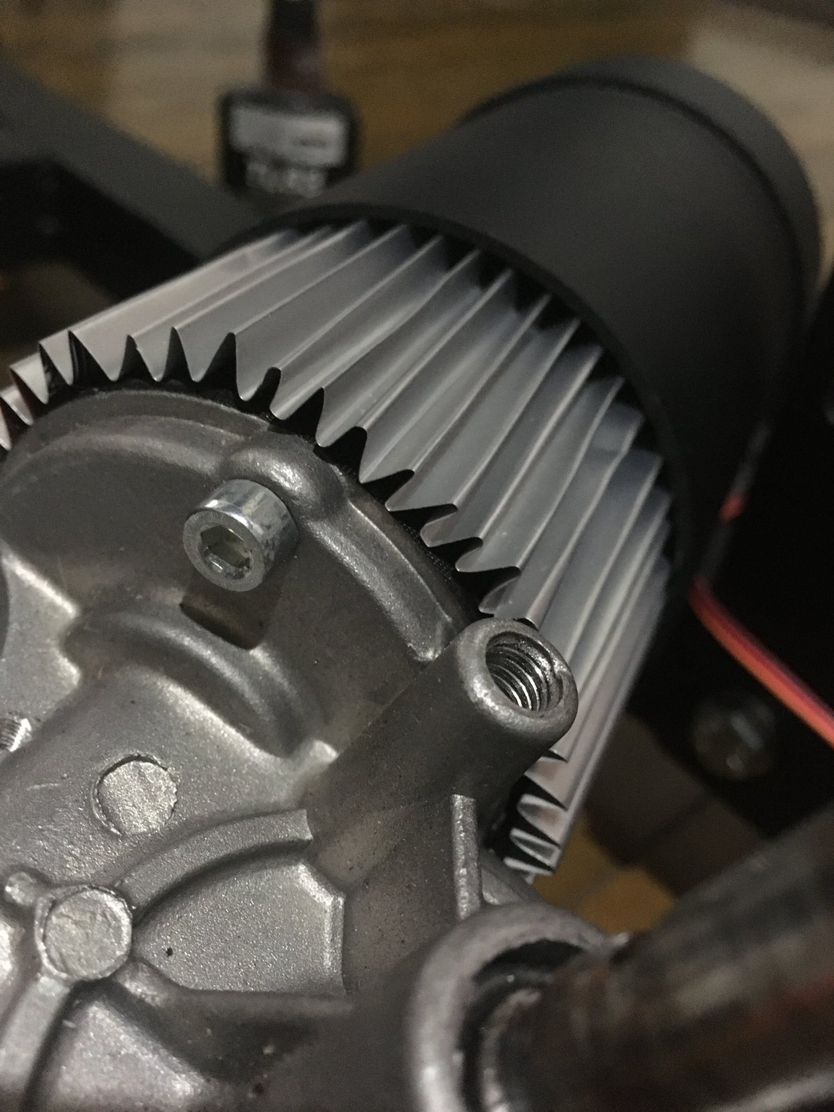

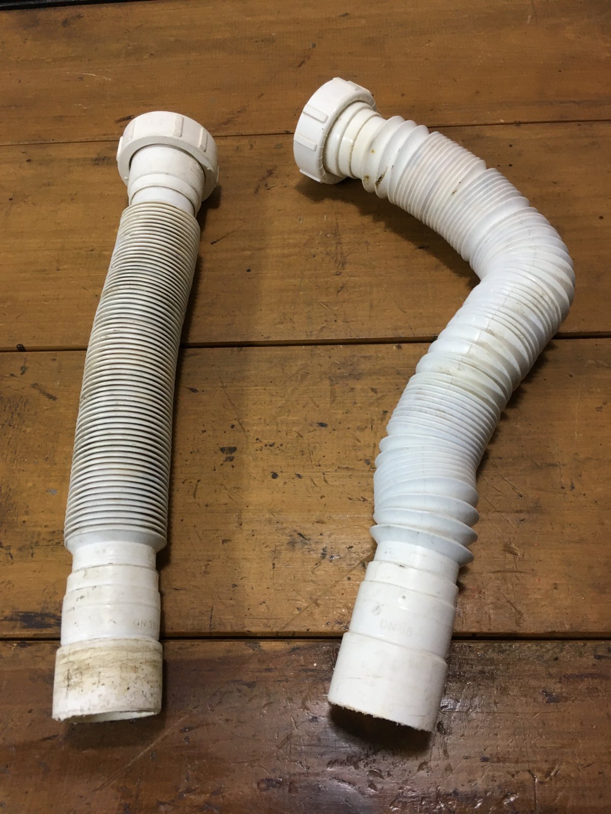

    EXTRA - COOLING SYSTEM
    Flexible connections, PVC Ø75mm and aluminum container.

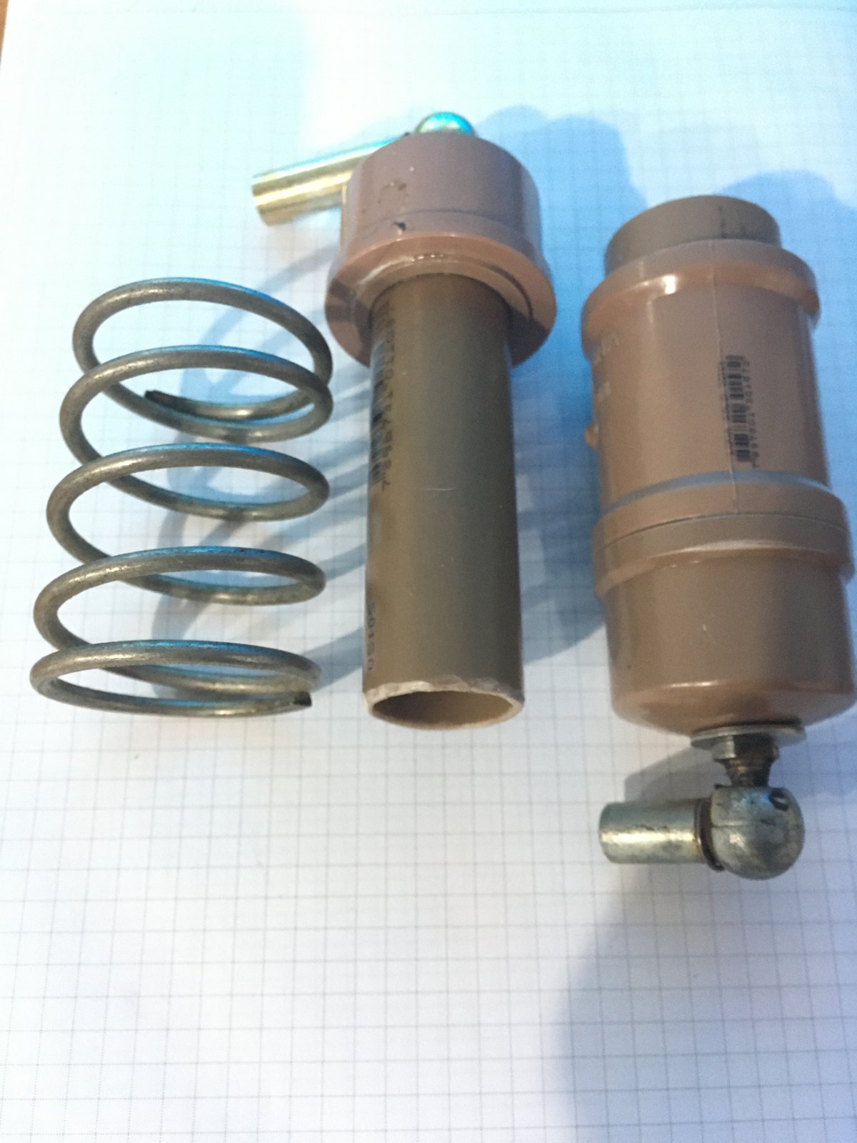

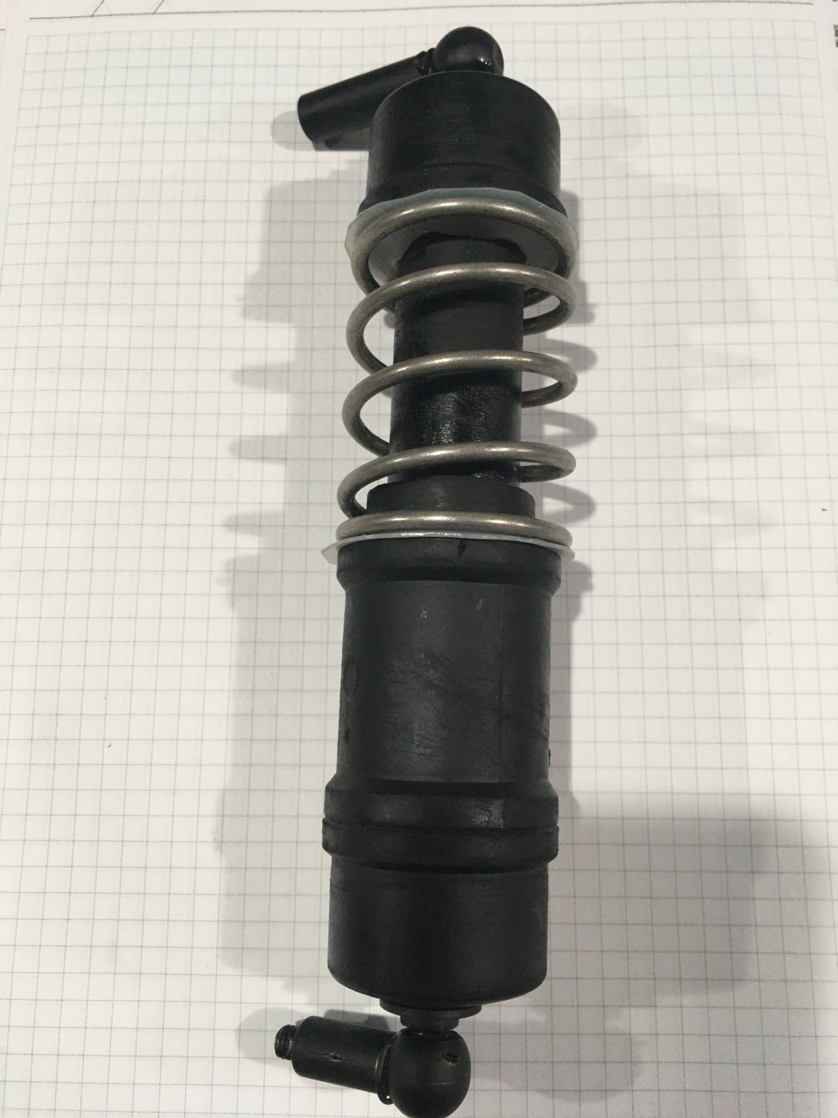

    EXTRA - DAMPING SYSTEM
    PVC connections Ø32 and Ø25mm, spring and M6 bearings.

    I am curious as to how the springs behave under load, it would be great to see a video of your rig in actions, when you get the time.

    Yes, I will soon post the video as soon as I adjust my cockpit.

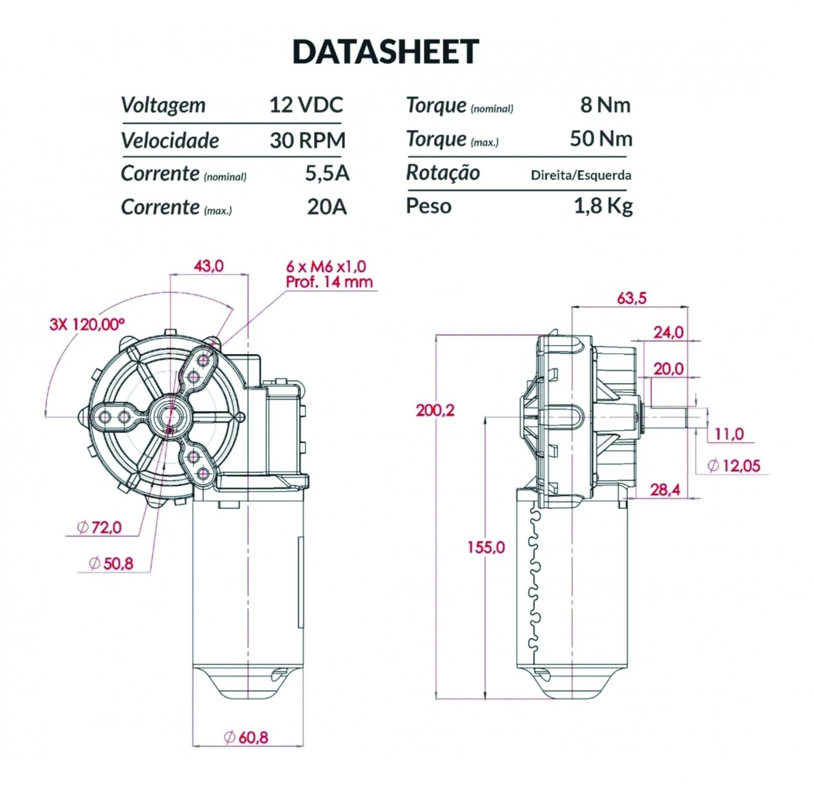

    Hello, please help, I test my engines on the SMC3, start the cycle but stop, it seems that they lose strength, does anyone have an idea of what it could be?
    The engines are weight free in this test.
    Thank you.

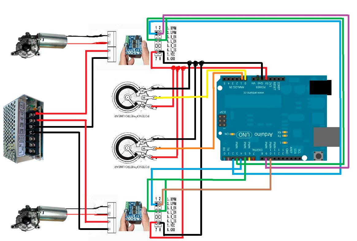

    UPDATE - ENGINES AND H BRIDGE
    After several tests, the change in electronics and part of engines proved to be inevitable.
    The PONTE H MONSTER showed variations and problems, replaced by PONTE H BTS7960 43a.
    The engines were weak, replaced by 12v 30RPM.
    After several tests with the new update the system operated without fail and perfectly copying the telemetry of the game.
    The change in the connection is necessary!
    My project was excellent with the new updates.
    Good luck to everyone! ;)
