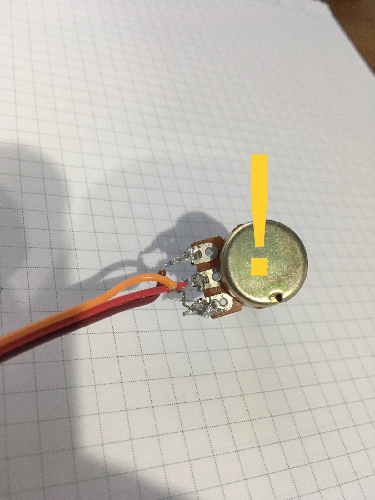

    Does anyone know why one of the potentiometers when turning in one direction activates both motors and the other direction activates only one. The other potentiometer starts only one engine and perfectly. Help, I was satisfied that my first system had worked correctly and not now. :(

    Possibly a ground isolation issue.

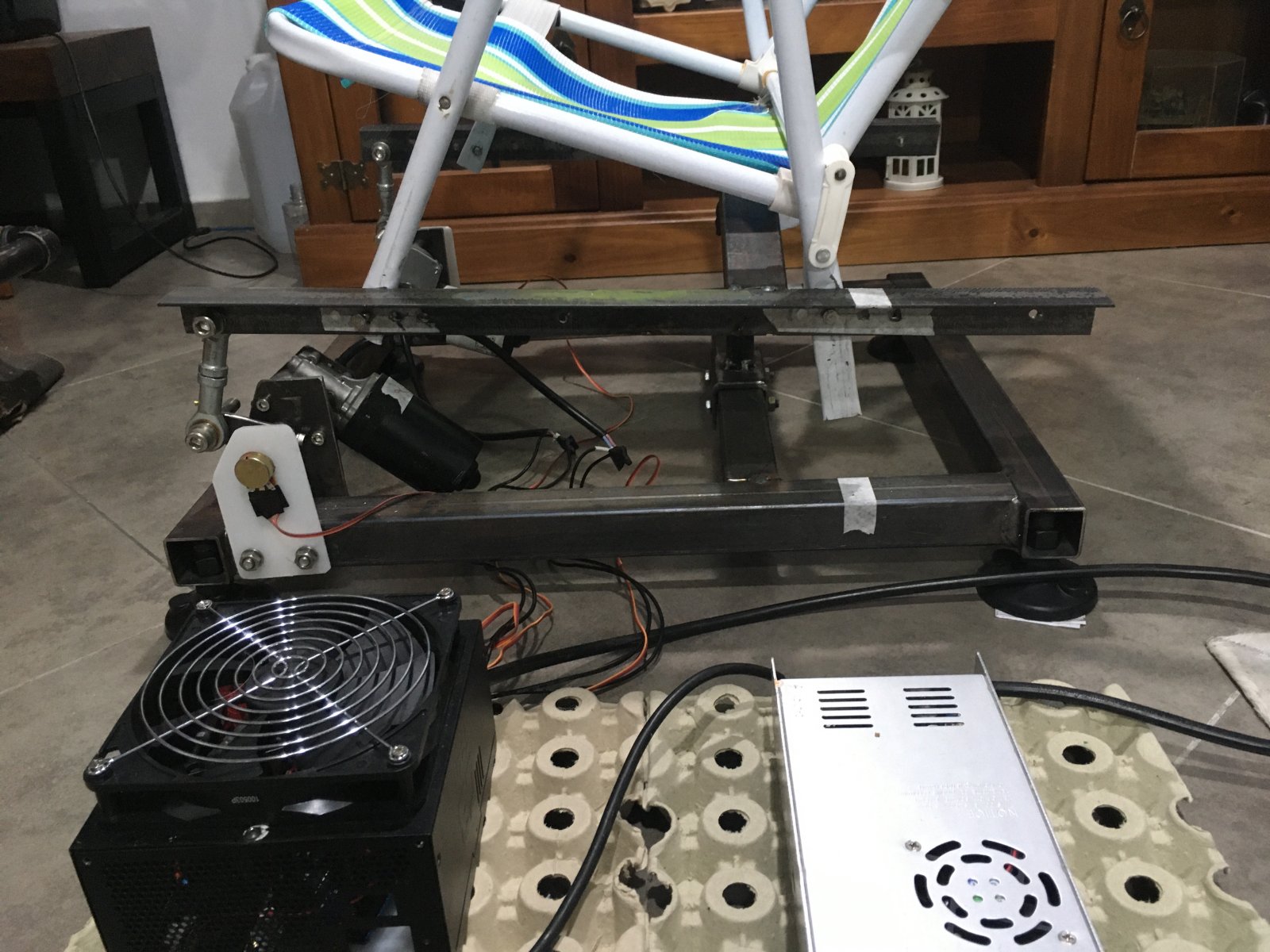

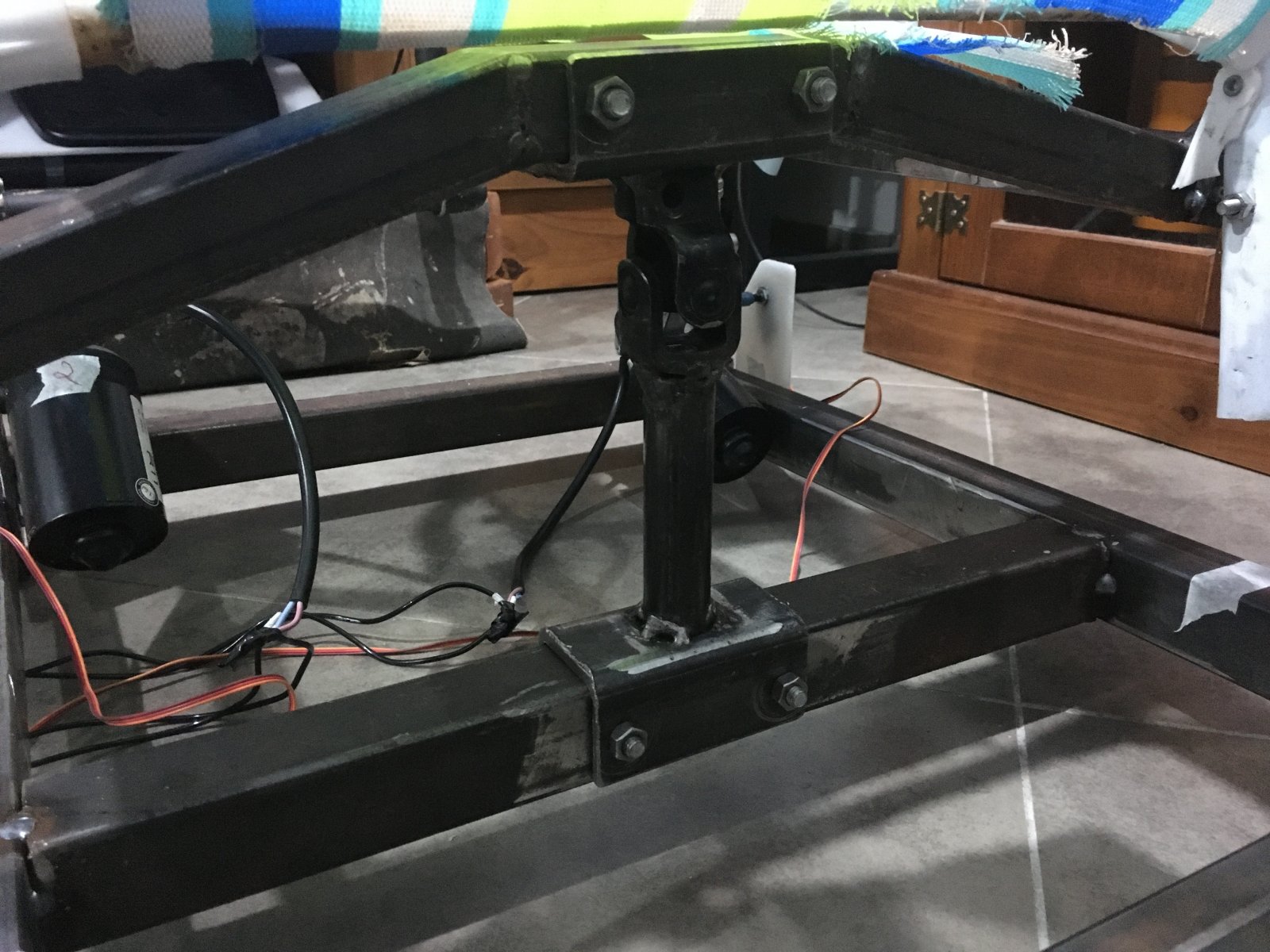

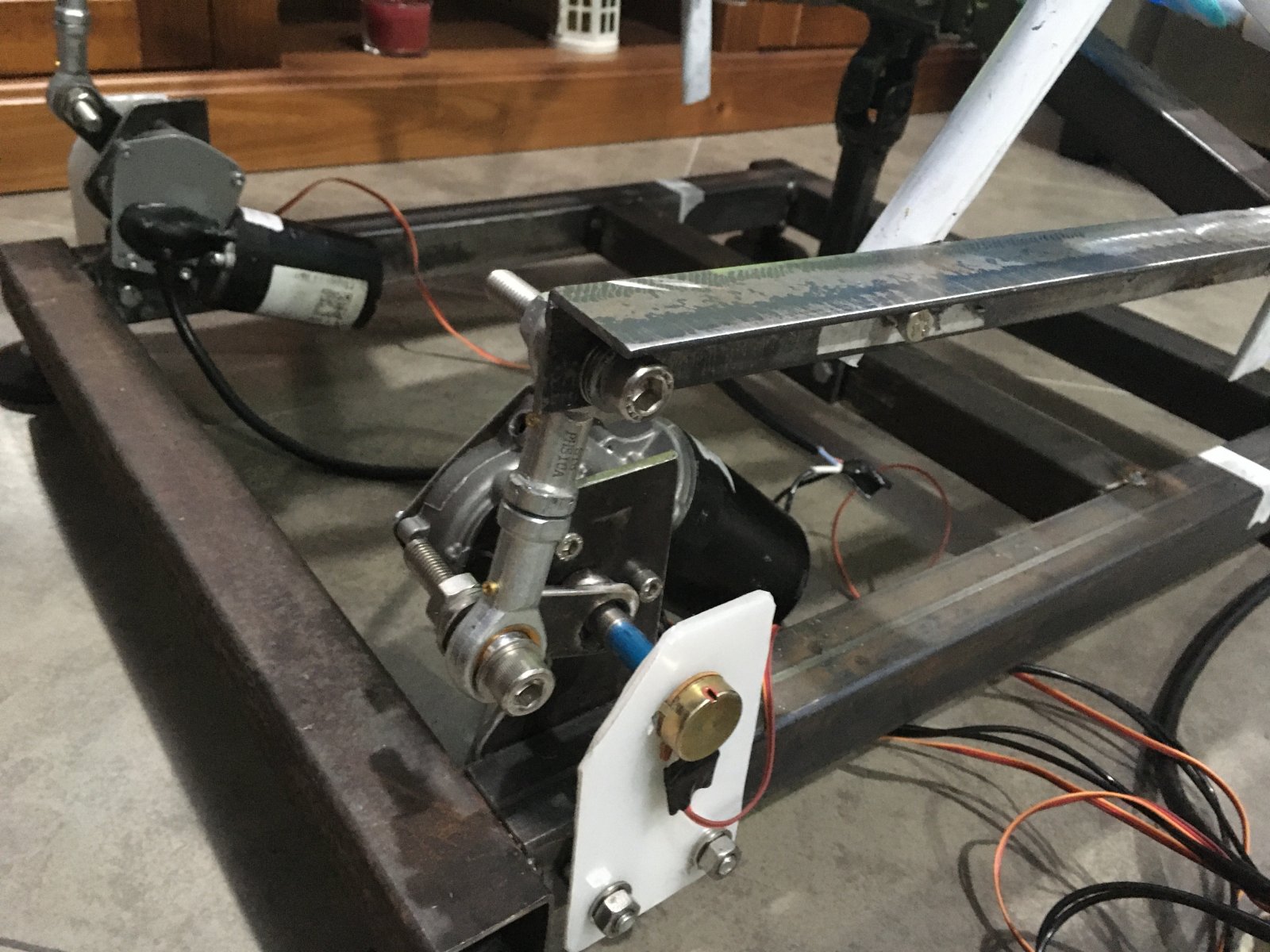

    Some details, now we just have to disassemble, adjust and finish painting and fixing all the components.

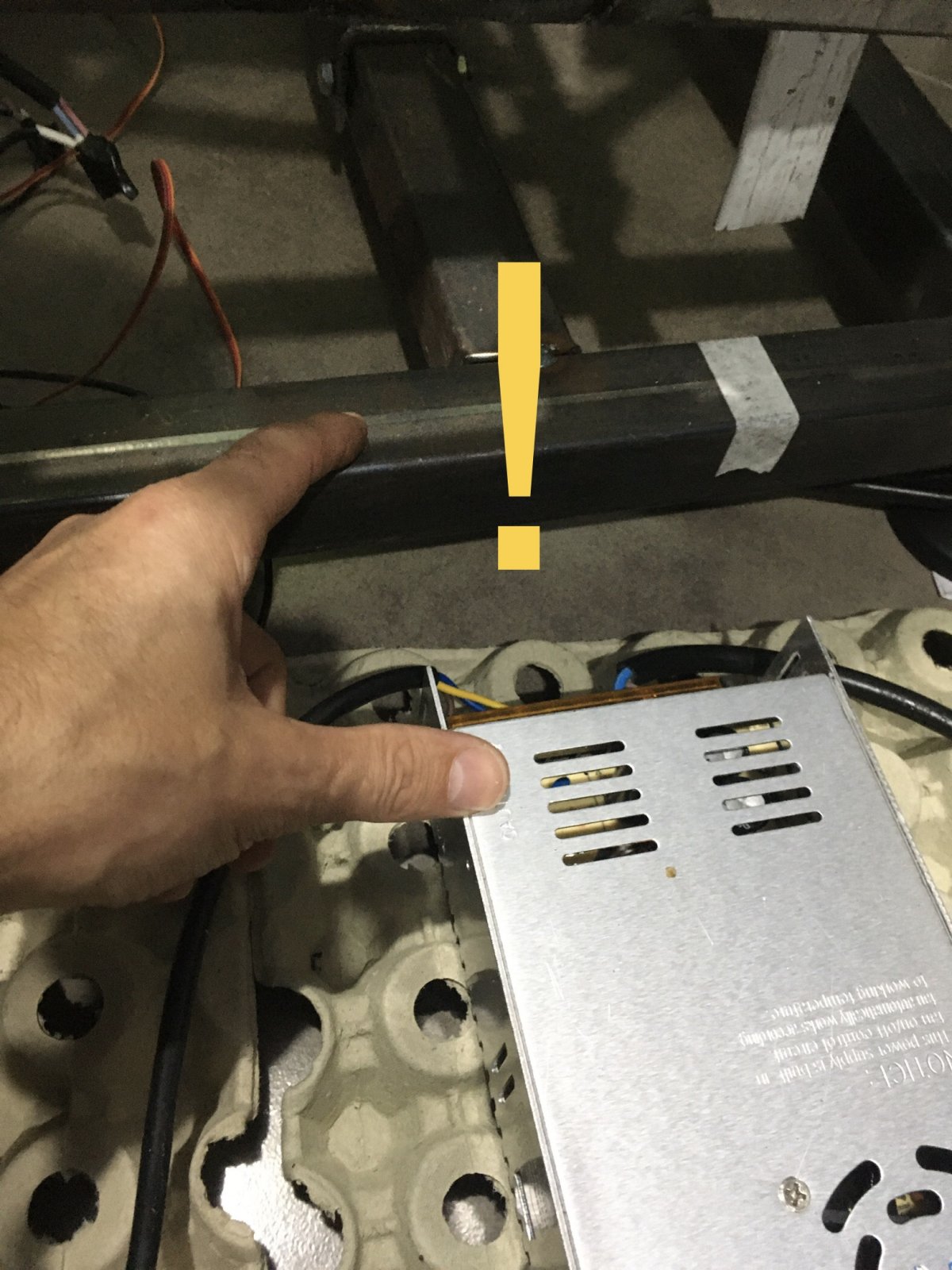

    Final considerations.
    I want to thank everyone who shared their knowledge, especially those who responded and helped me directly on the forum. Thank you!
    Unforeseen
    A) First burning of the Arduino and burning of the H Bridge.
    Cause:
    Potentiometer badly fixed, in the test of operation it turned and joined the wiring that was not isolated causing the burning of the components.
    Solution:
    Isolate potentiometer connections and fix them correctly.
    B) Second burning of the Arduino.
    Cause:
    The housing of the energized source touched the structure causing the component to burn.
    Solution:
    Isolate and secure the source in a safe place.
    C) Difficulty in configuring movement in SMC3, faulty movements.
    Cause:
    Potentiometers were disassembled to remove the 180 ° swing lock and when assembled they probably must have been twisted in the system causing poor energy distribution.
    Solution:
    Do not disassemble, if disassemble take great care in disassembly and assembly, as they are very sensitive.
    Use pots of excellent quality.
    My weight
    65KG
    *Good luck to everyone!

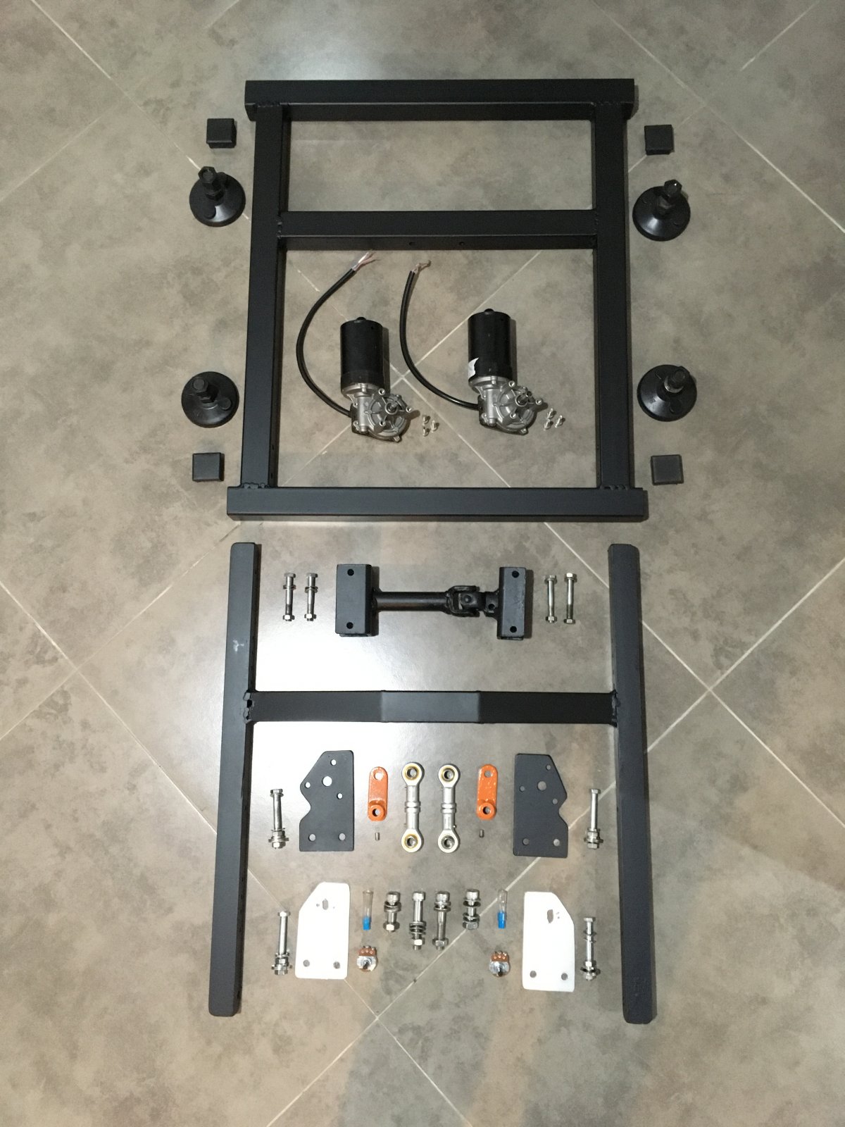

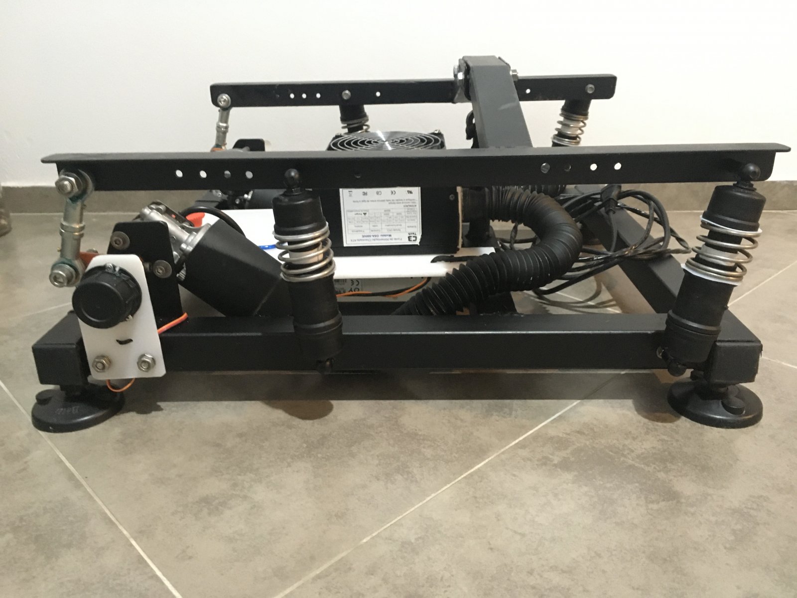

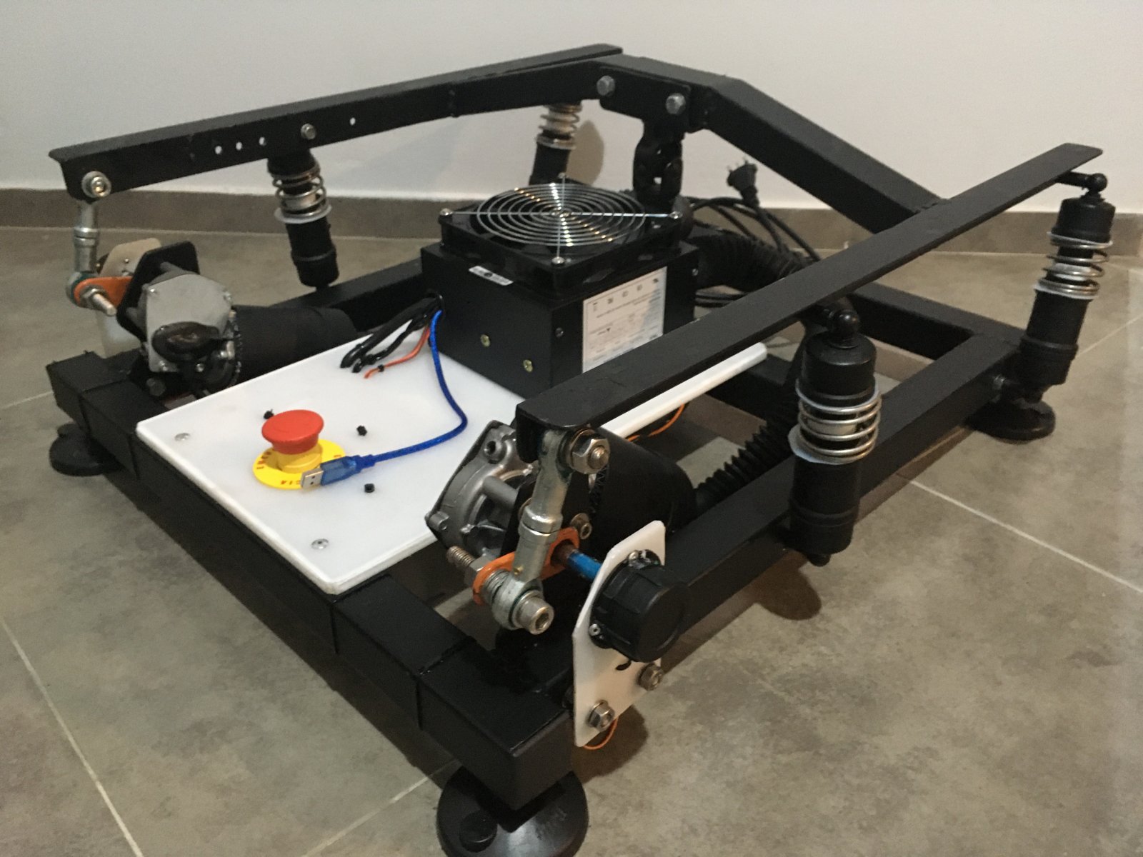

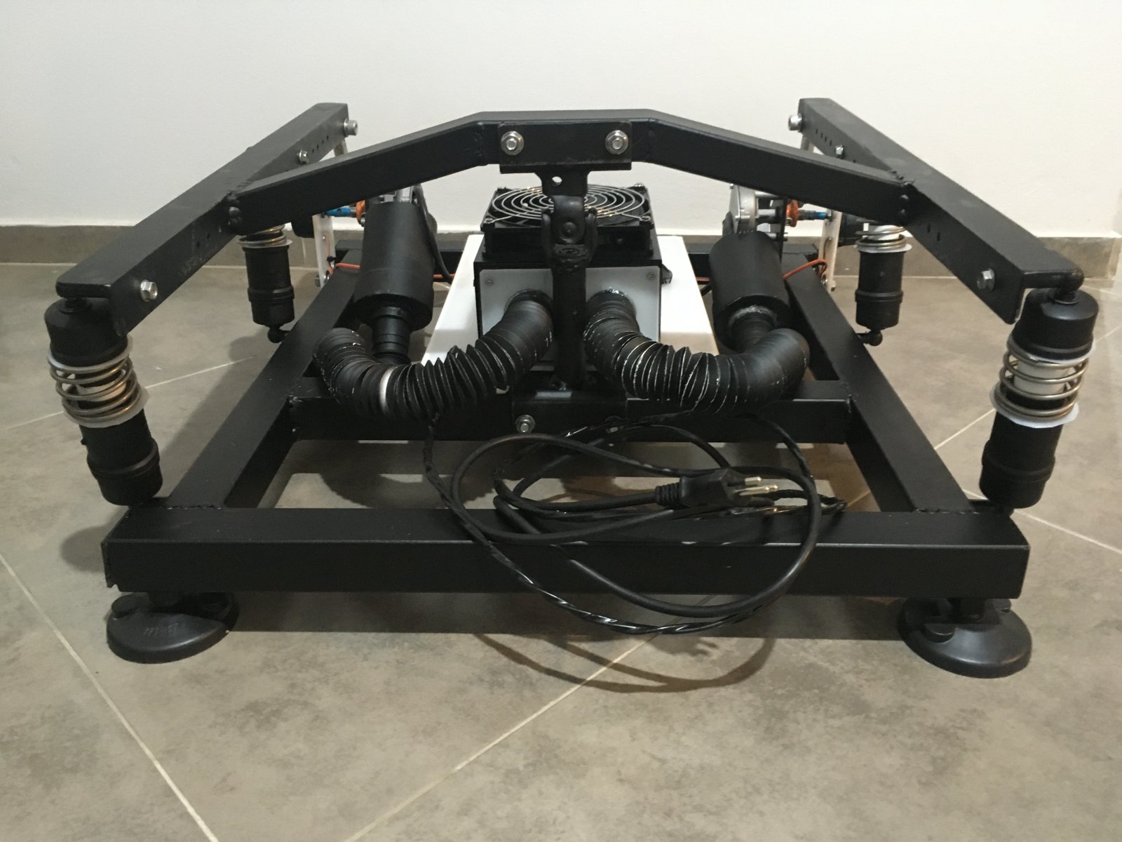

    Main System Parts
  20. Marcos73
    Marcos73 Member
    Feb 14, 2020
    77
    100Coins
    +55 / 0 / -0

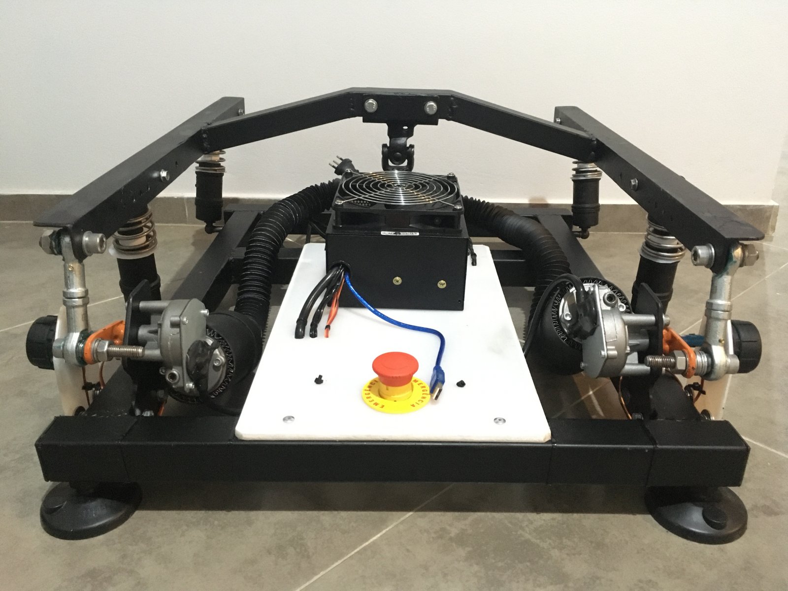

    FINISHED
    with extras
    My project finished with engine cooling system taking advantage of the electronics box cooler and suspension system that makes the system softer and assists the engines in returning to the neutral point of the mechanism
