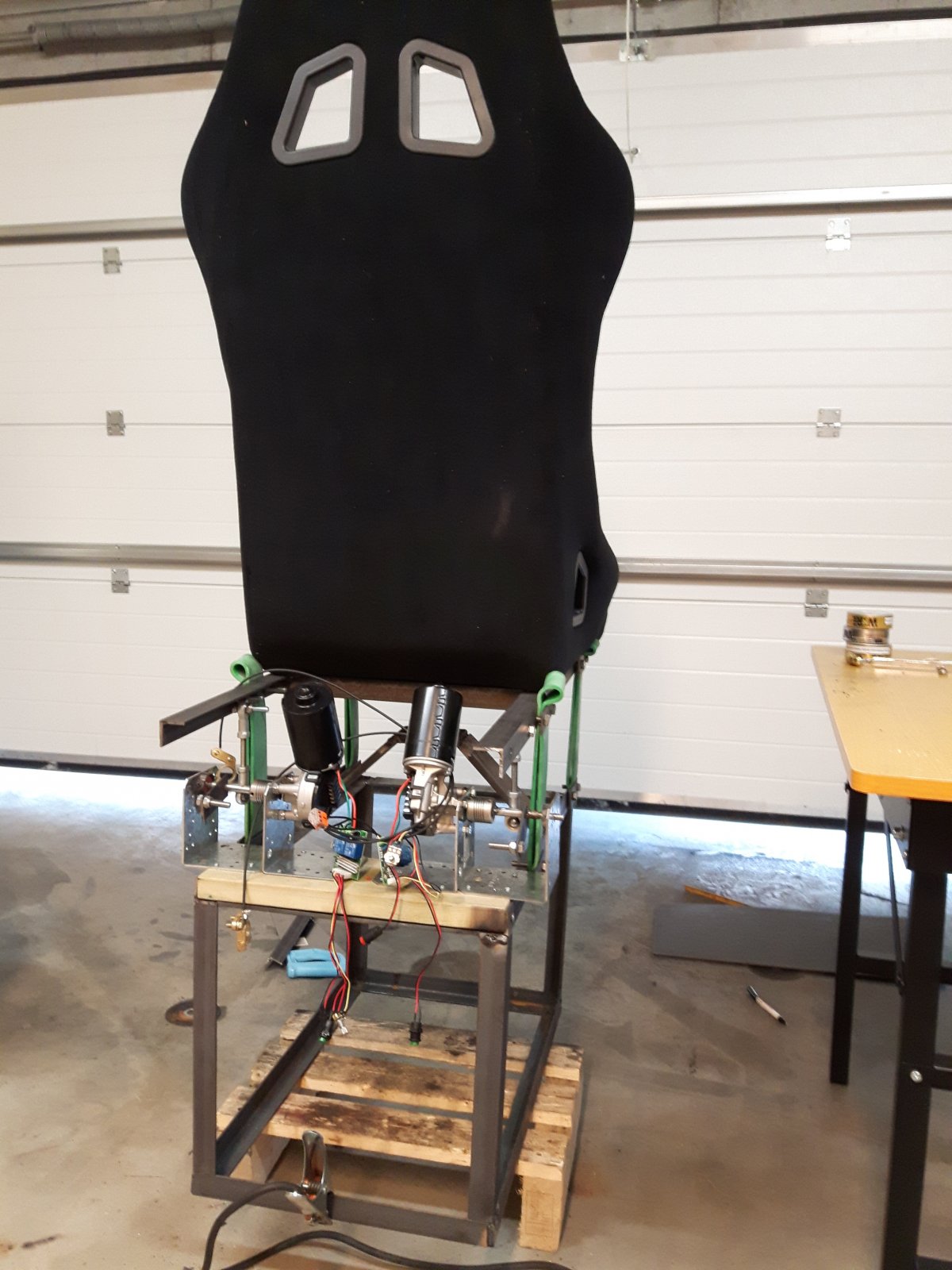

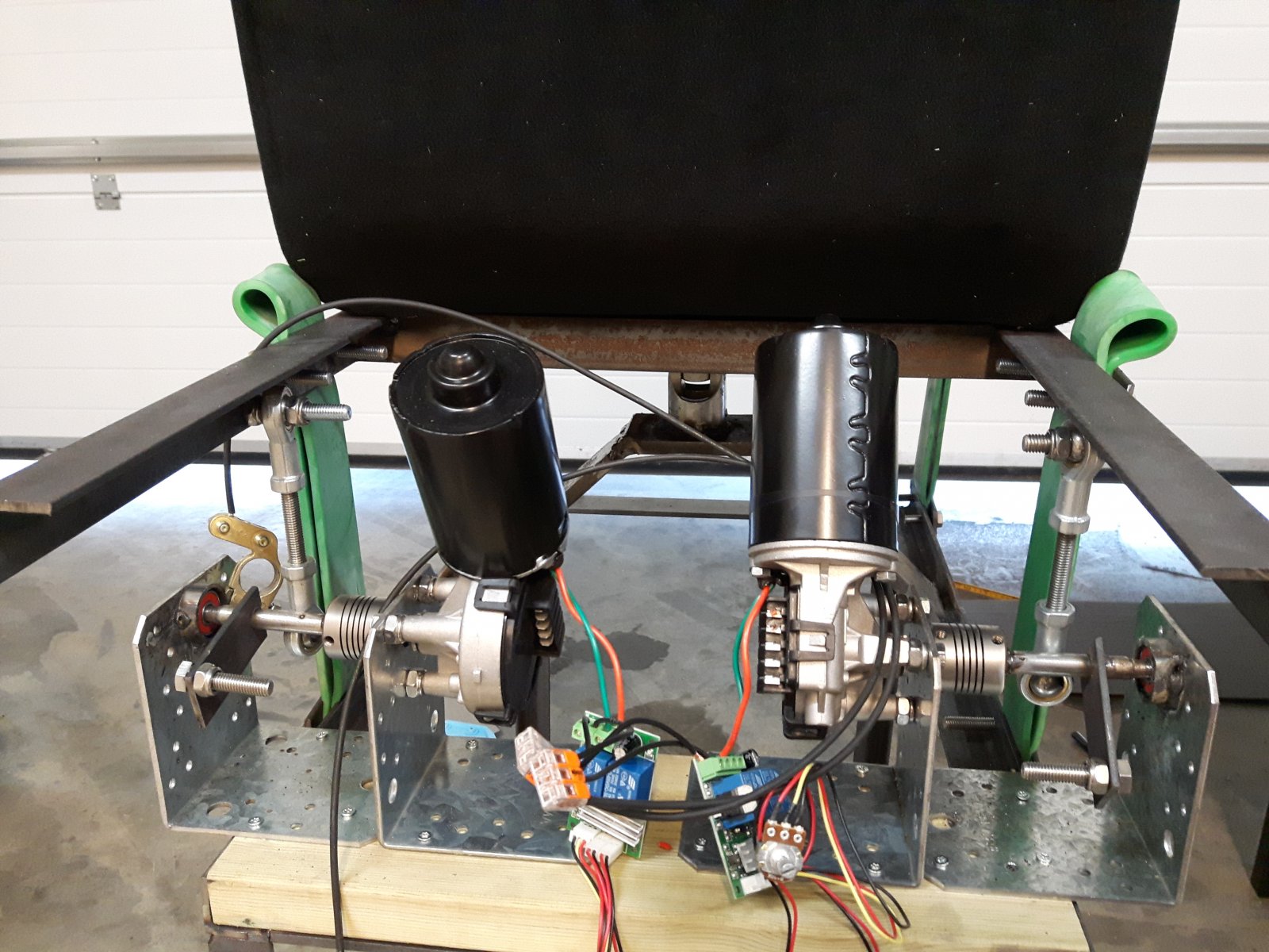

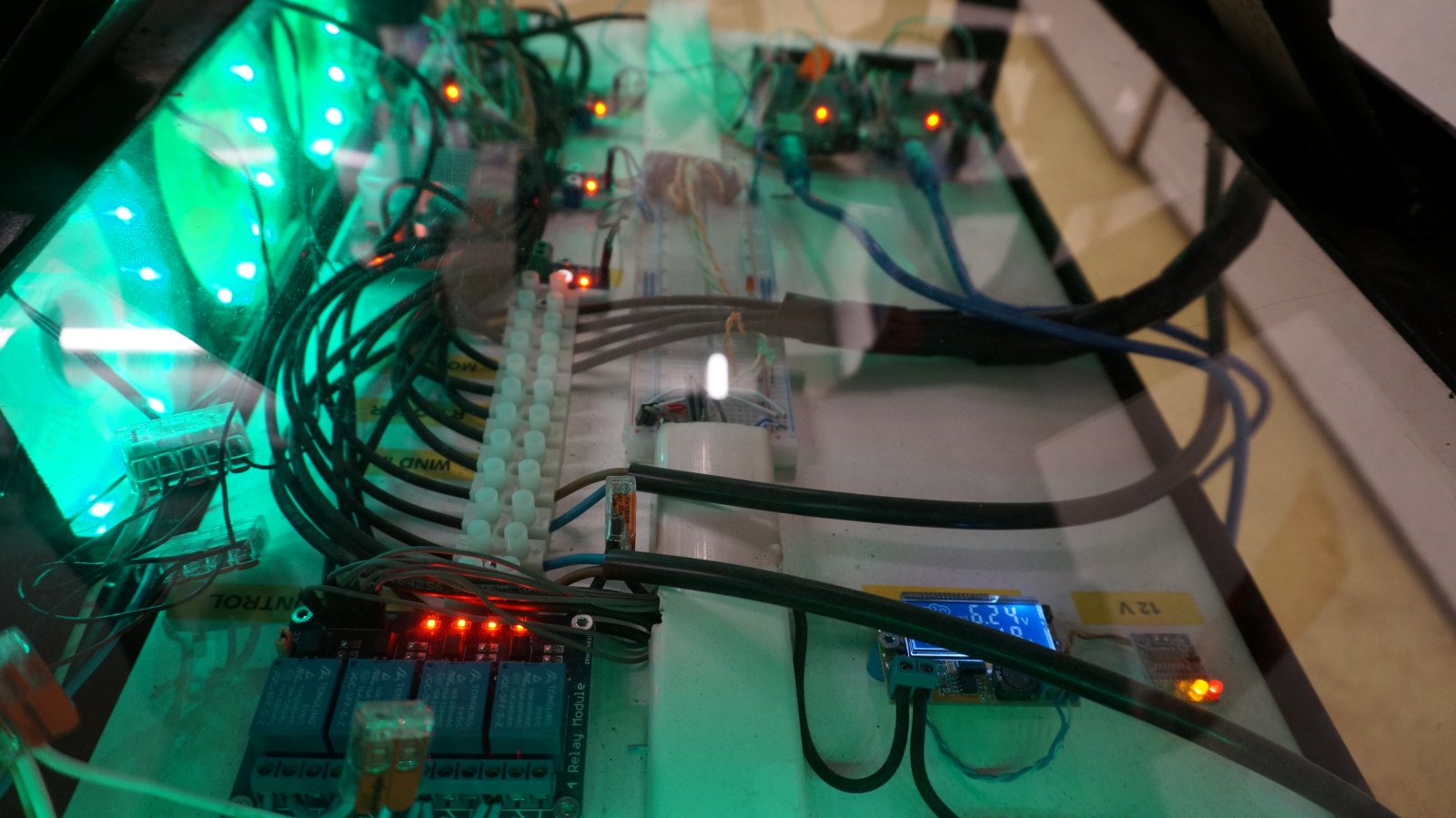

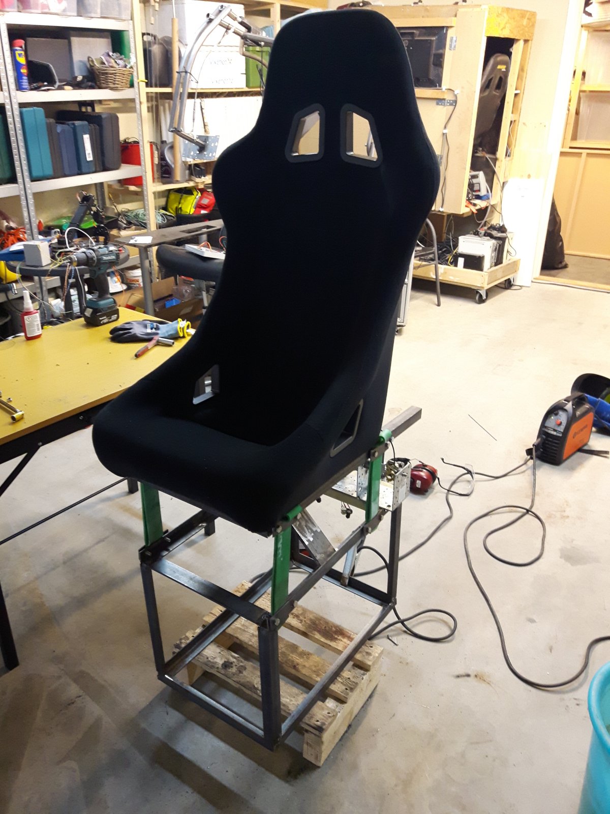

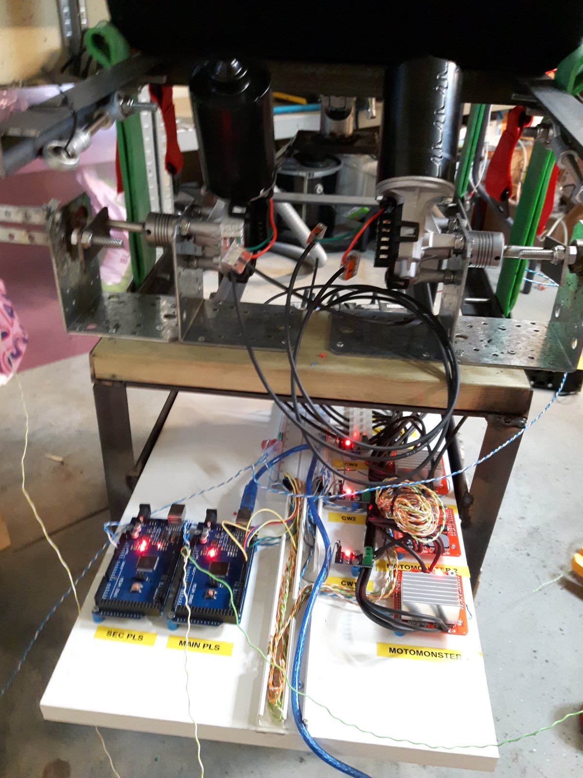

    Got some updates. The pneumatic build takes some time, so i went for a version with two wiper motors first, so i can play with the software. Got som pics from the build here 20180711_223239.jpg

    2DOF, AC motor, Arduino, Joyrider, 6DOF
    Now I got the simulator up running. Got movement, but not all correct. Have to figure out the axis. It moves when i Test output in sim tools, but not sideways. Pitch work, but when i roll I have just one motor moving.

    The Dir checked orange or not in Axis Assignments determines which way each axis moves and this is how SimTools expects it to be configured: https://www.xsimulator.net/community/faq/which-way-to-set-simtool-axis-movements.230/
  8. Tags..(VR)
    Tags..(VR) Member
    Aug 28, 2017
    237
    indiana
    - 6Coins
    +29 / 2 / -0
    what is the gauge in the wire your using in the arduino's and moto's ?

    Thank you Noorbeast! I will check that out :)

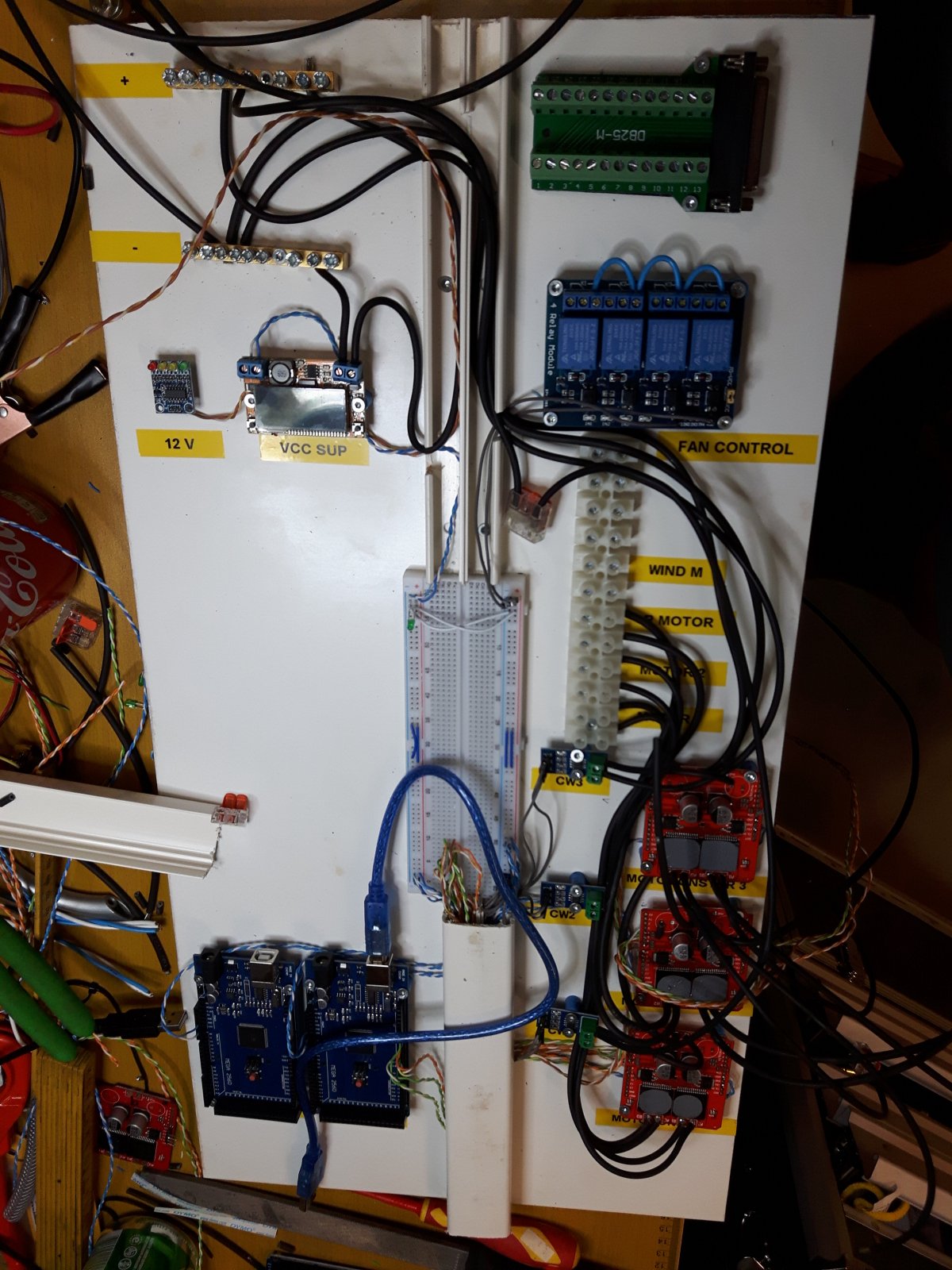

    Christopher; The display or the tre chips marked with cw ?
  10. Tags..(VR)
    Tags..(VR) Member
    Aug 28, 2017
    237
    indiana
    - 6Coins
    +29 / 2 / -0
    and the metal brackets? i really like those.

    Up and running now :)

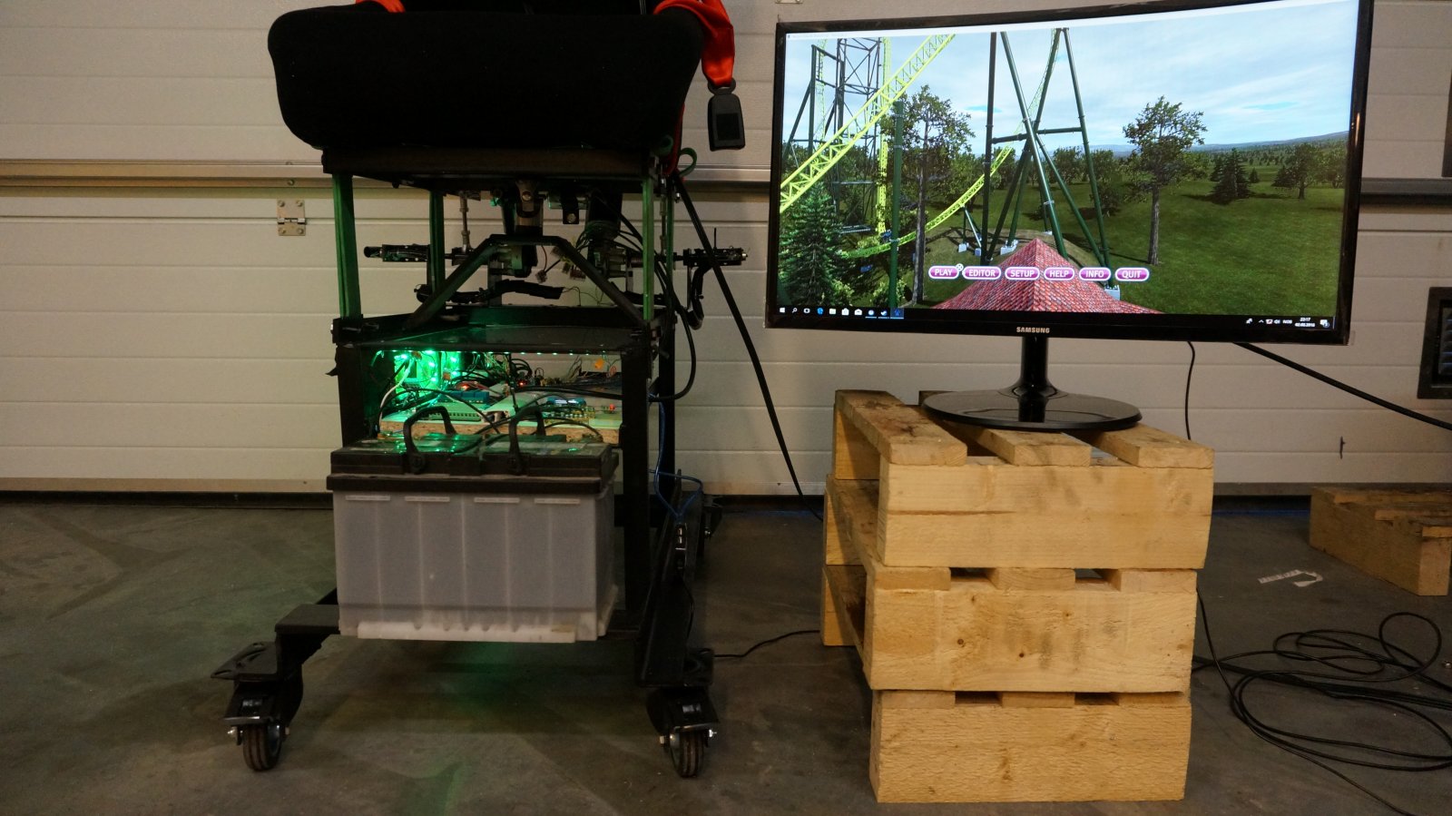

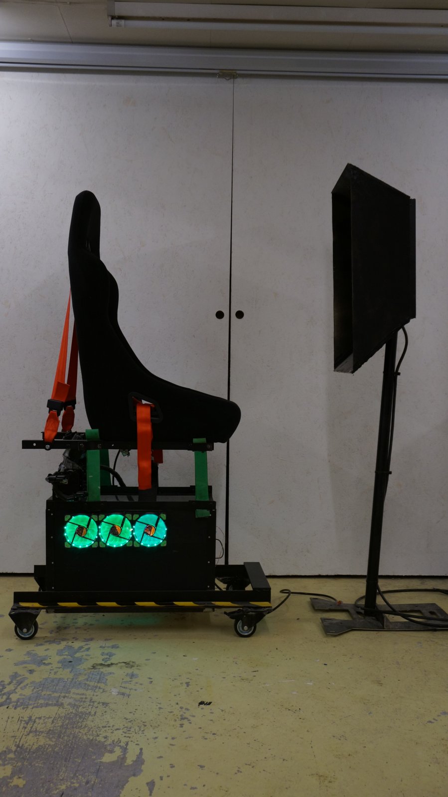

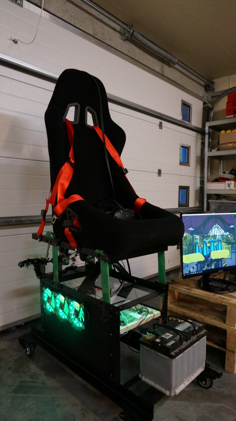

  13. Blekkulf
    Blekkulf Member Gold Contributor
    May 18, 2018
    73
    Molde
    342Coins
    +13 / 0 / -0

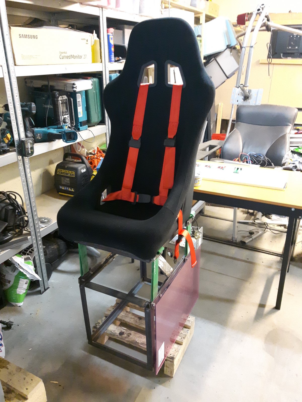

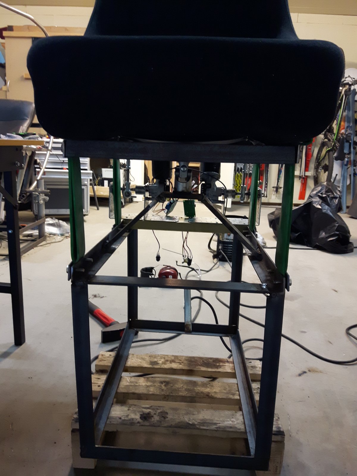

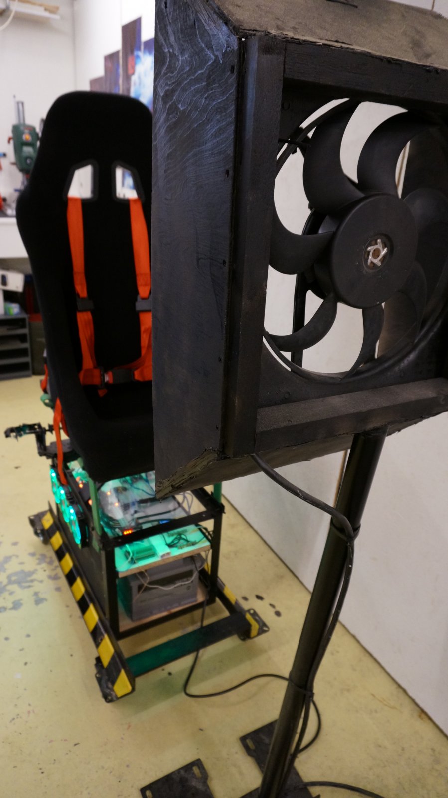

    Some final pictures on the 2Dof NoLimits simulator. Working on a 6Dof, and my girlfriend wants to have one of the cars in the garage when the snow comes:grin So this will be dismounted now.
