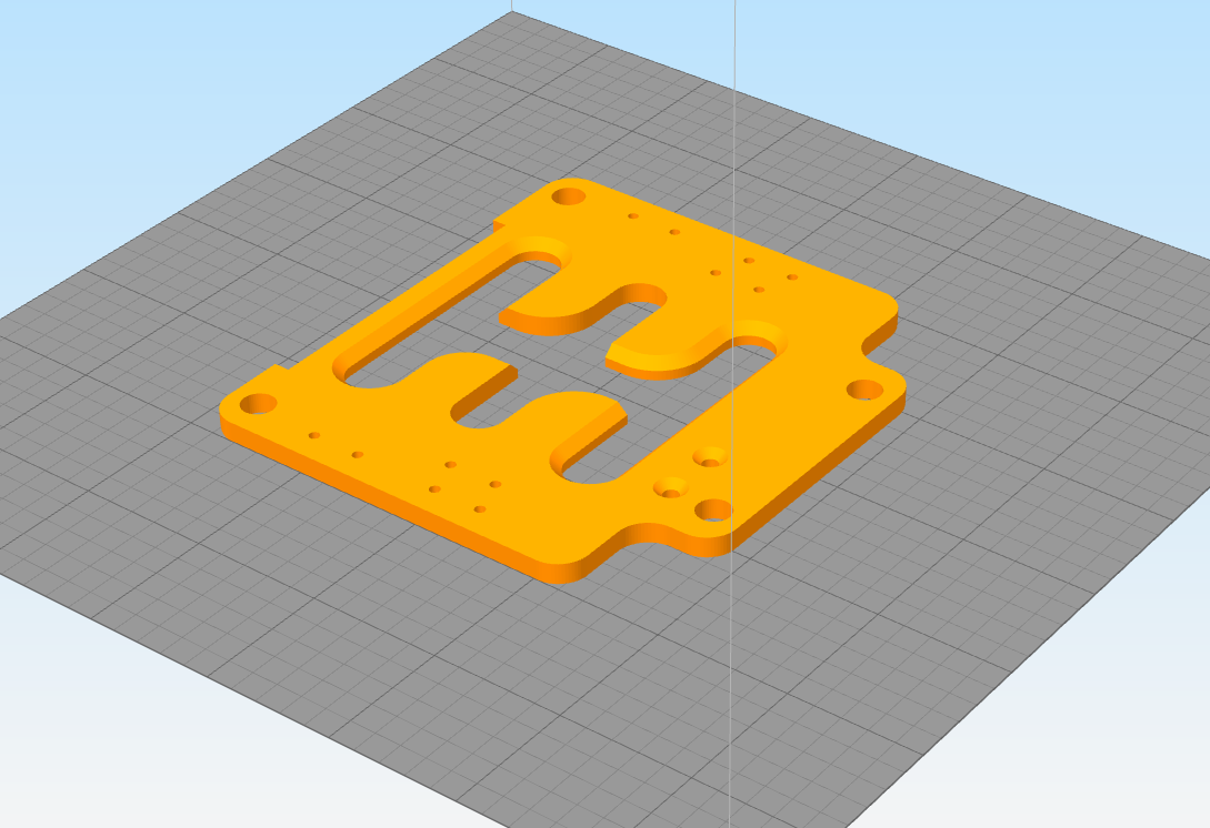

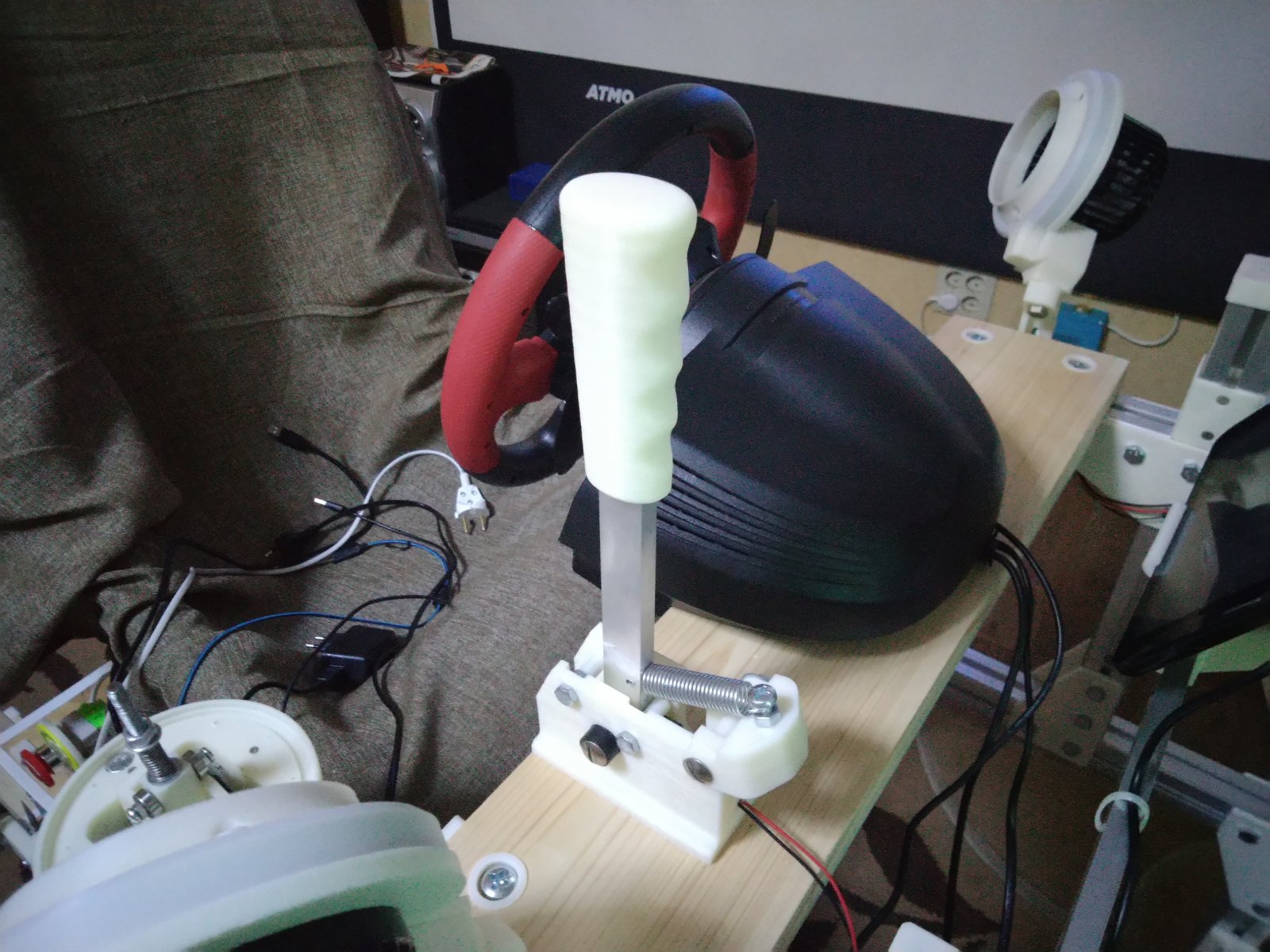

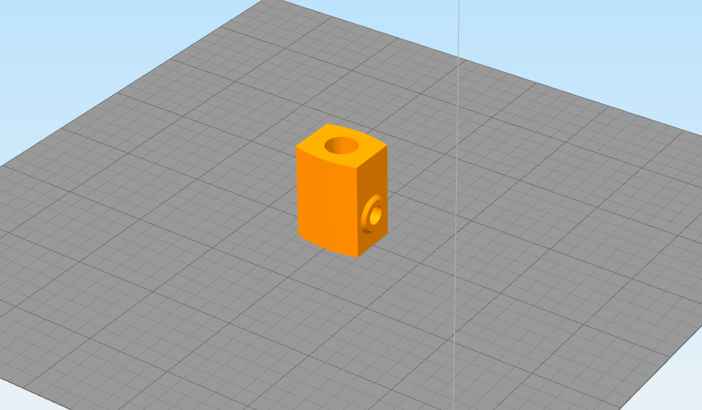

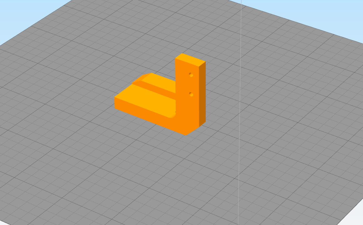

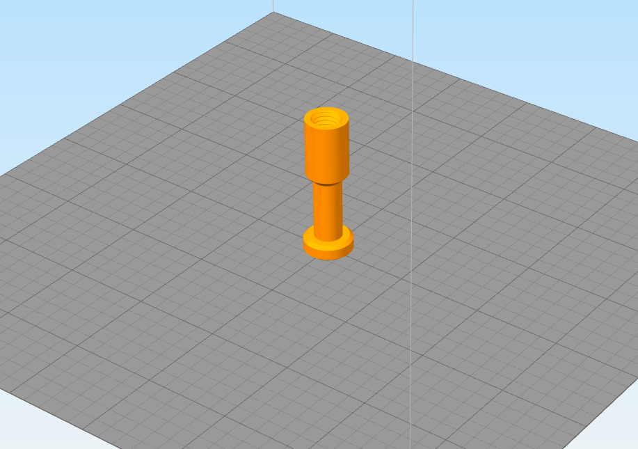

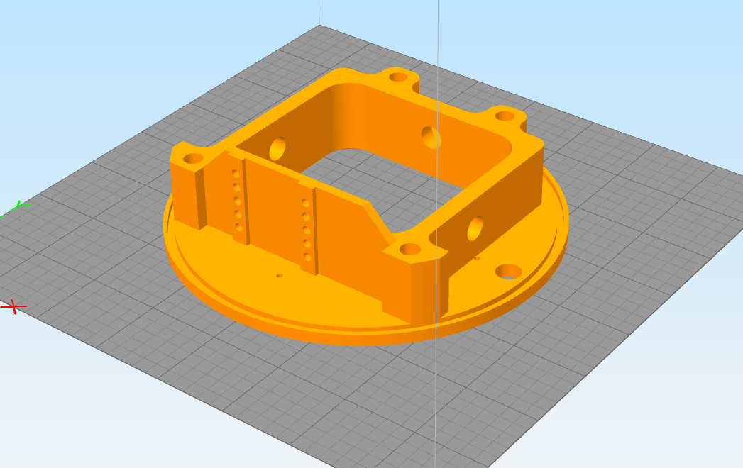

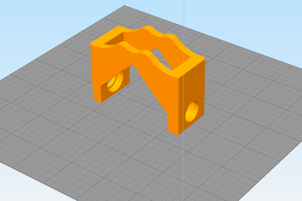

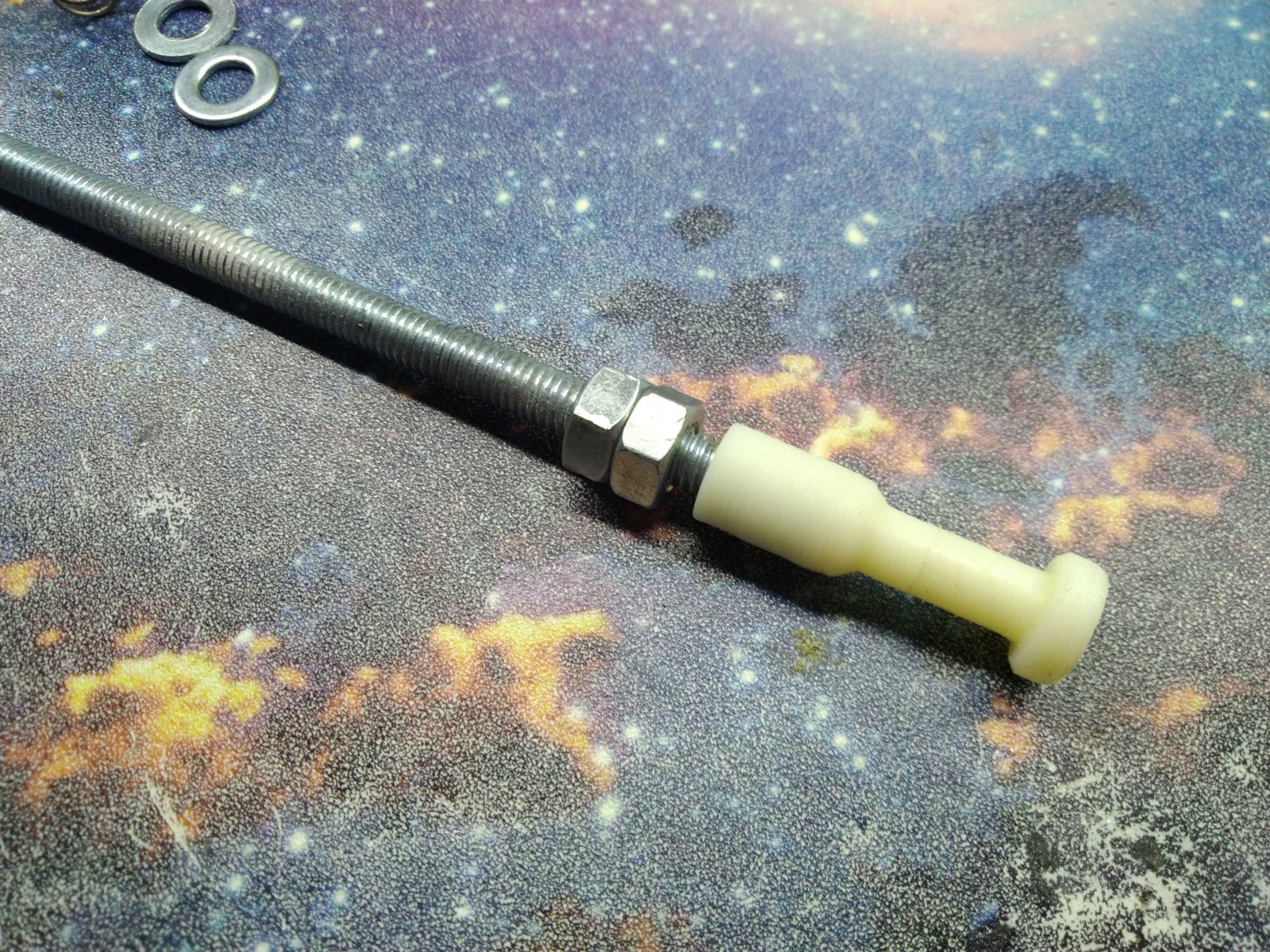

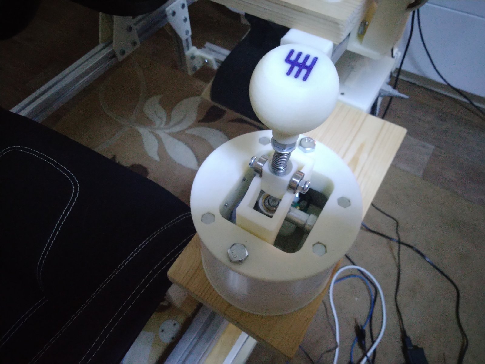

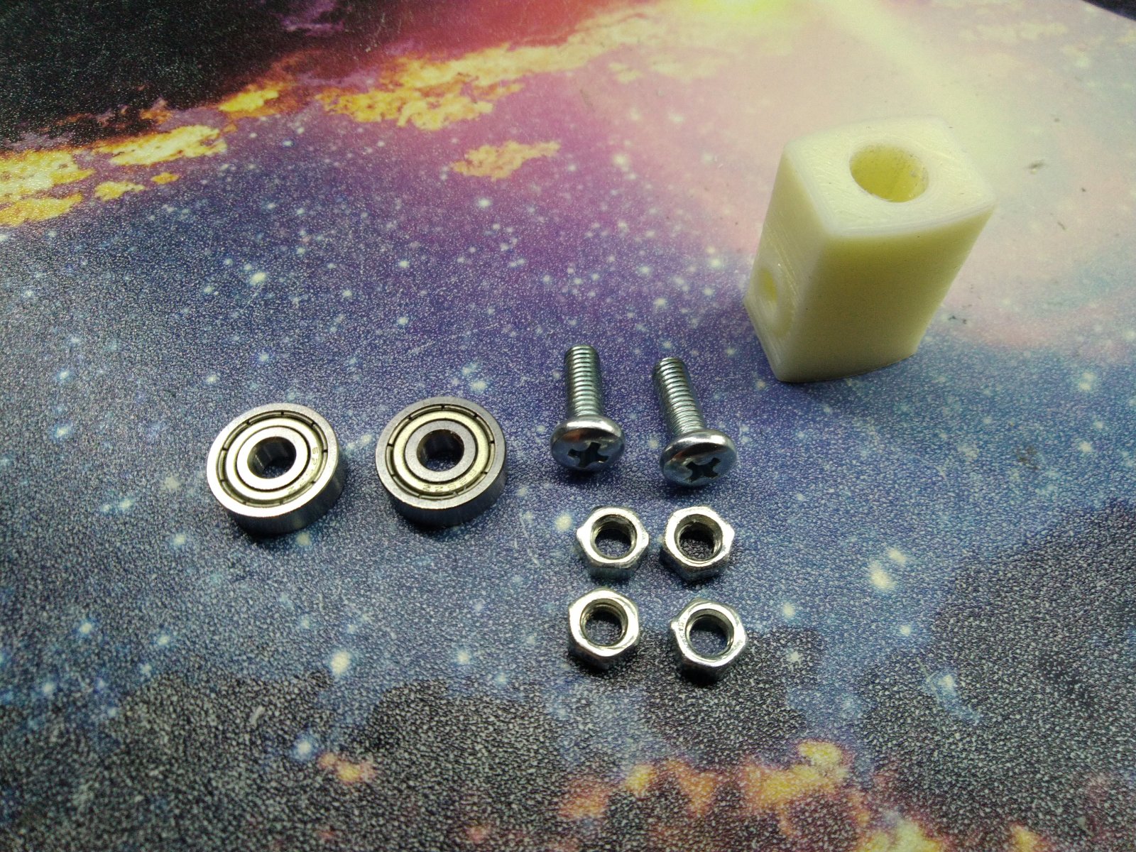

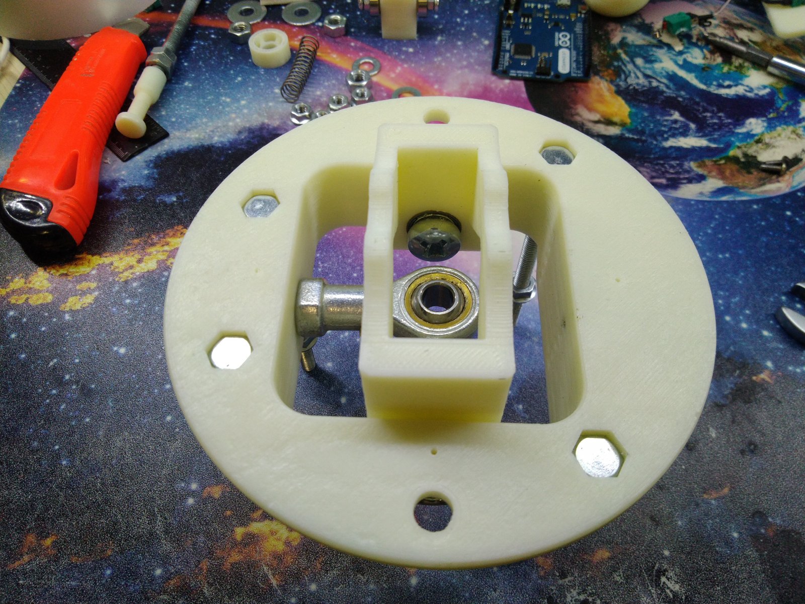

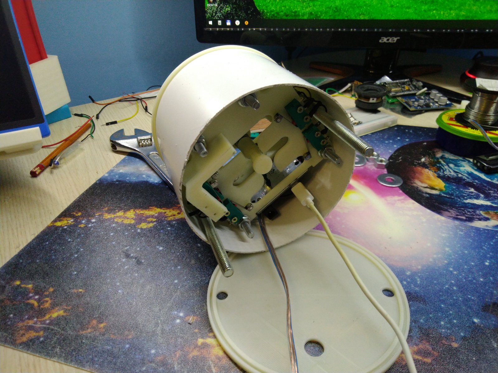

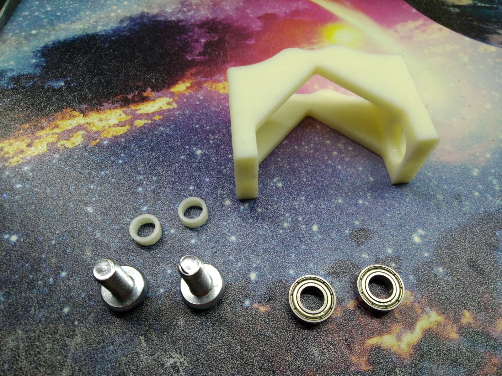

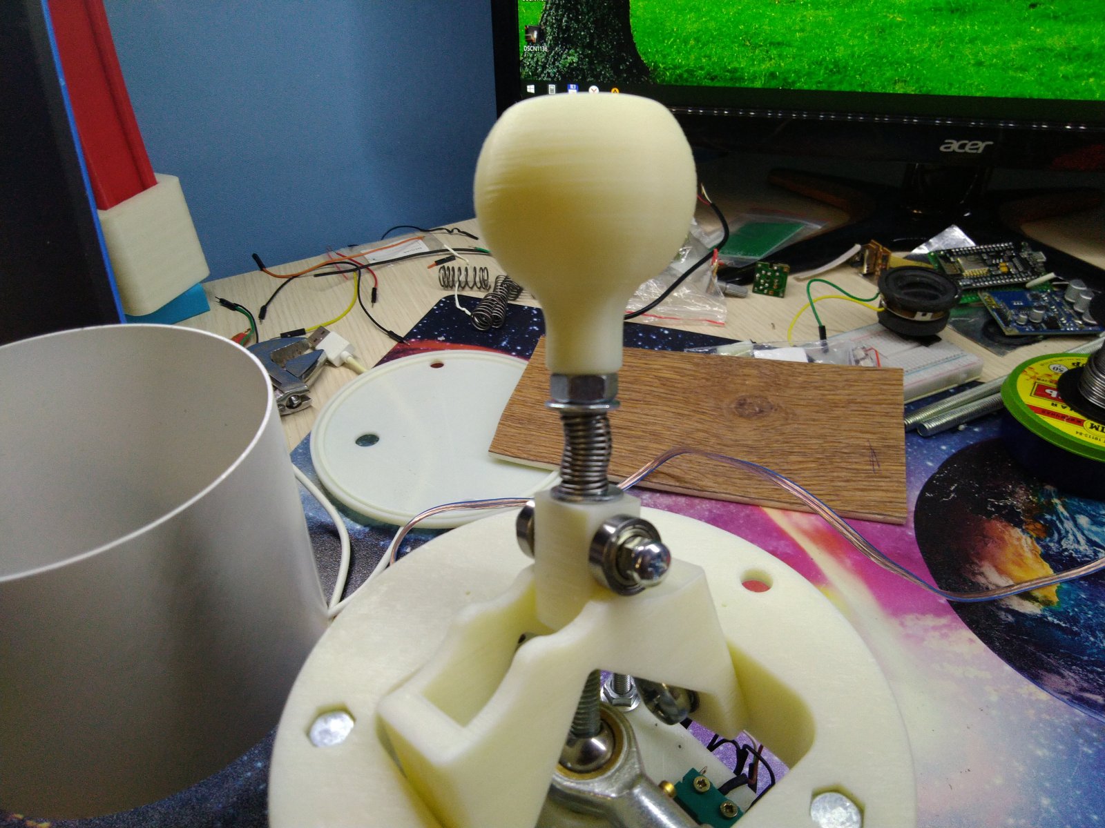

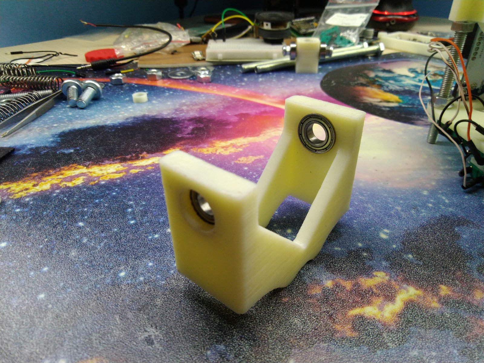

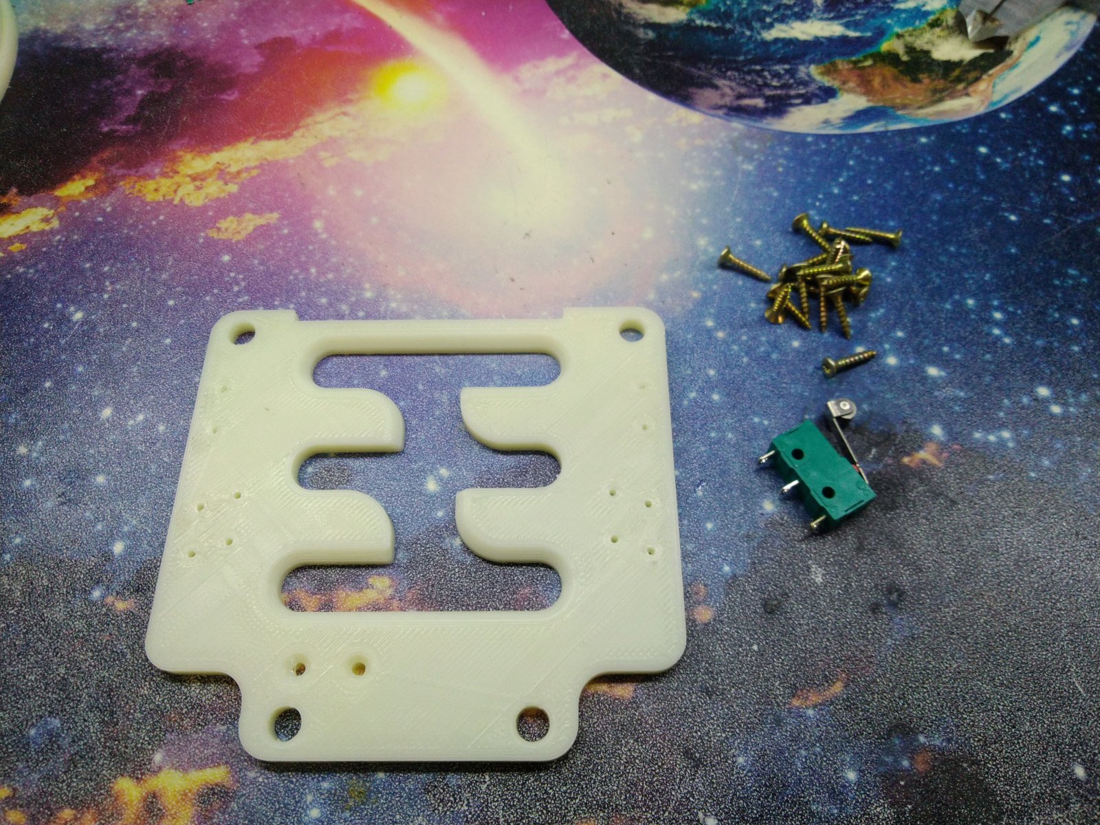

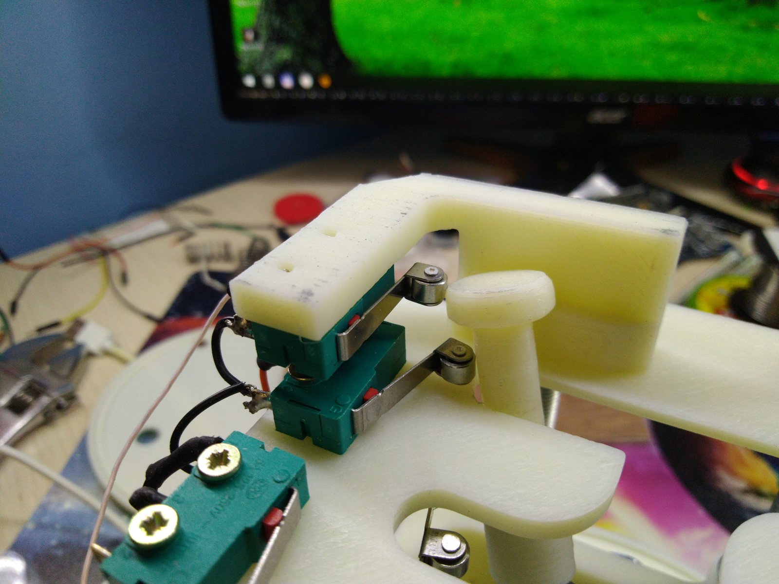

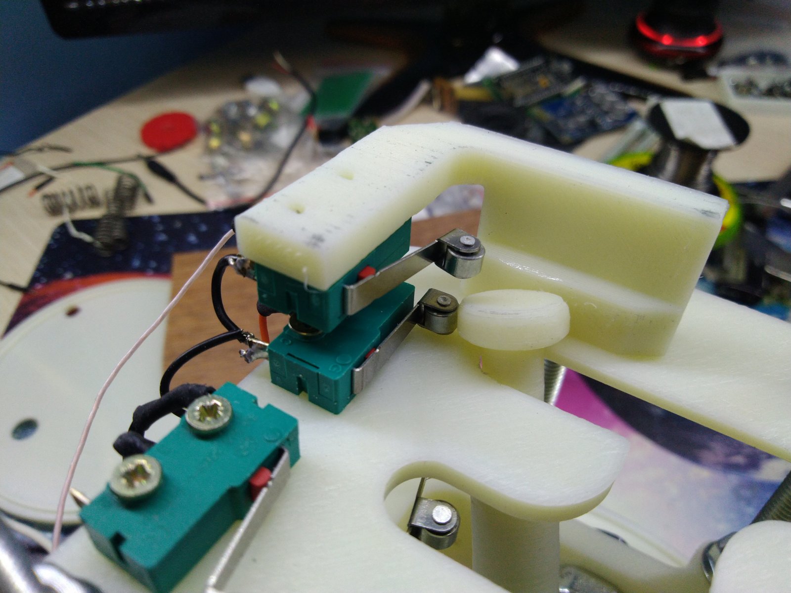

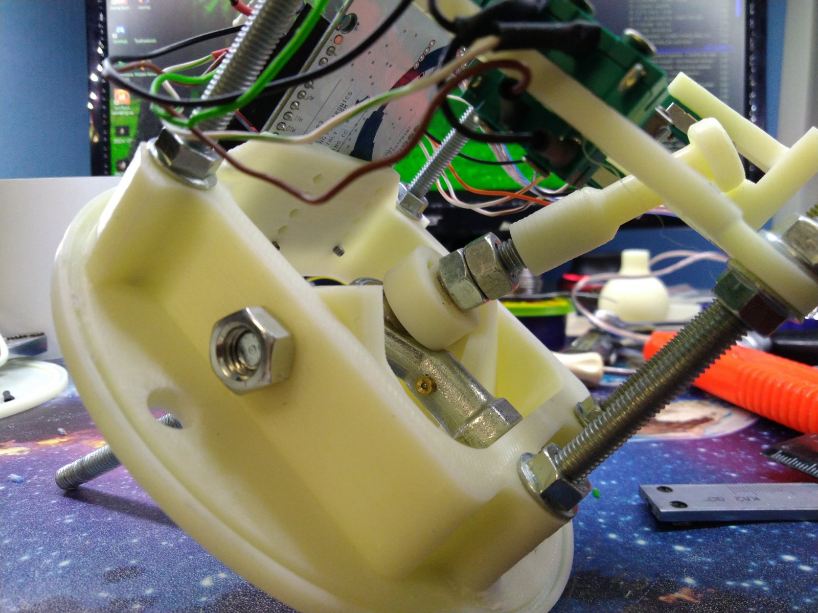

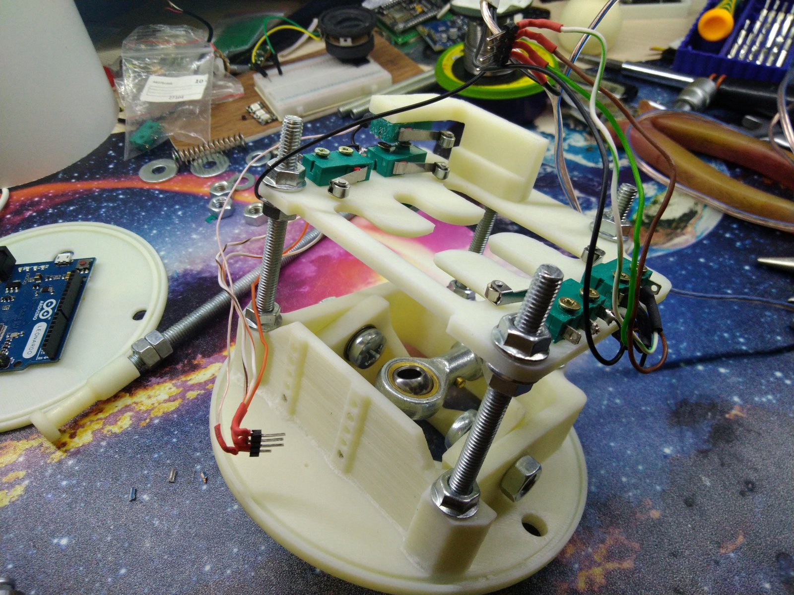

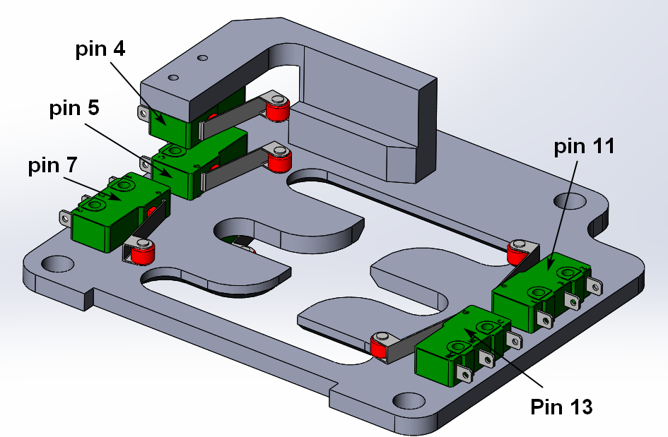

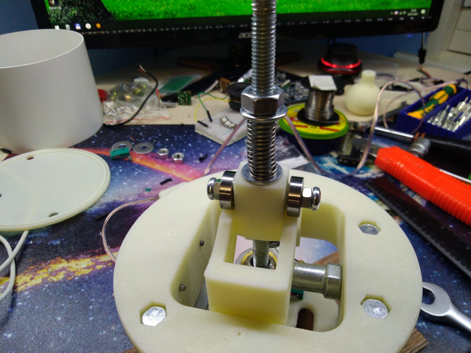

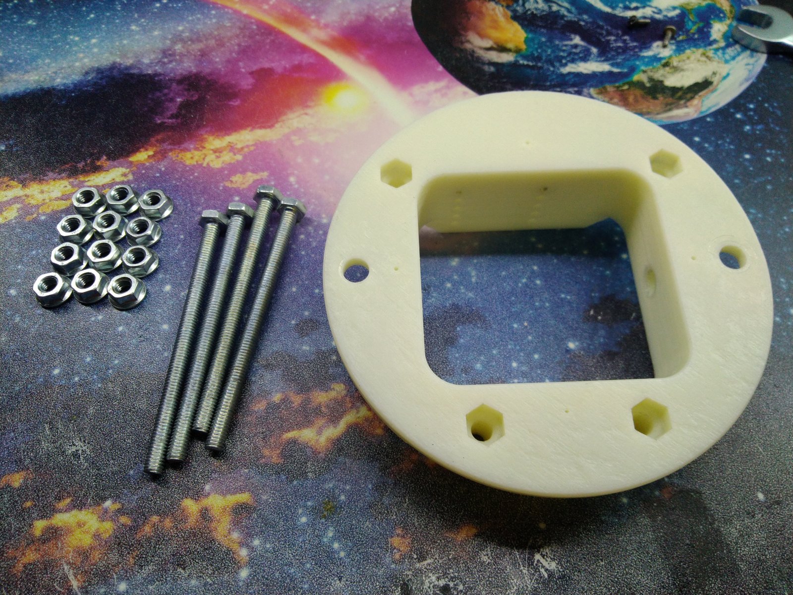

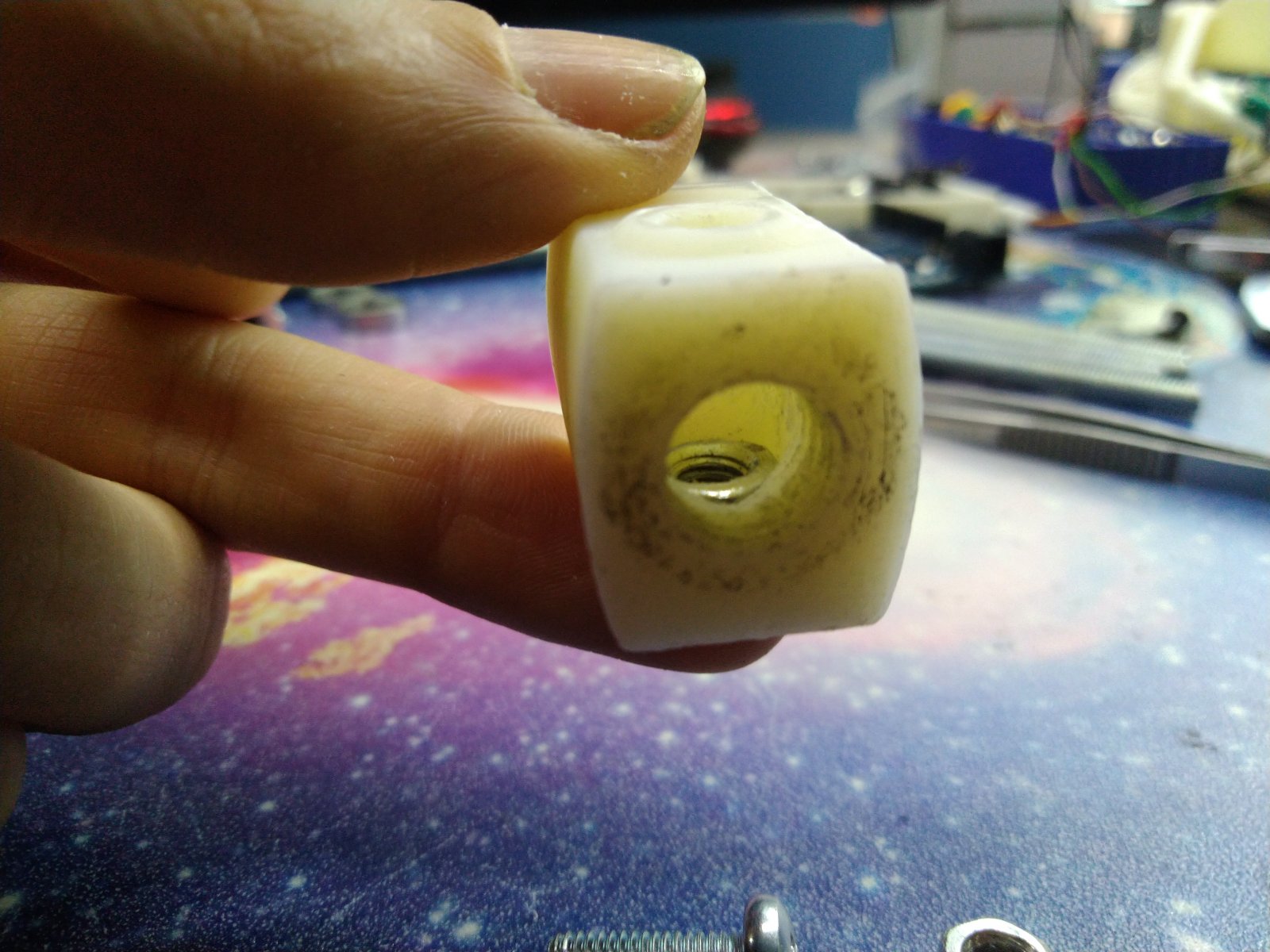

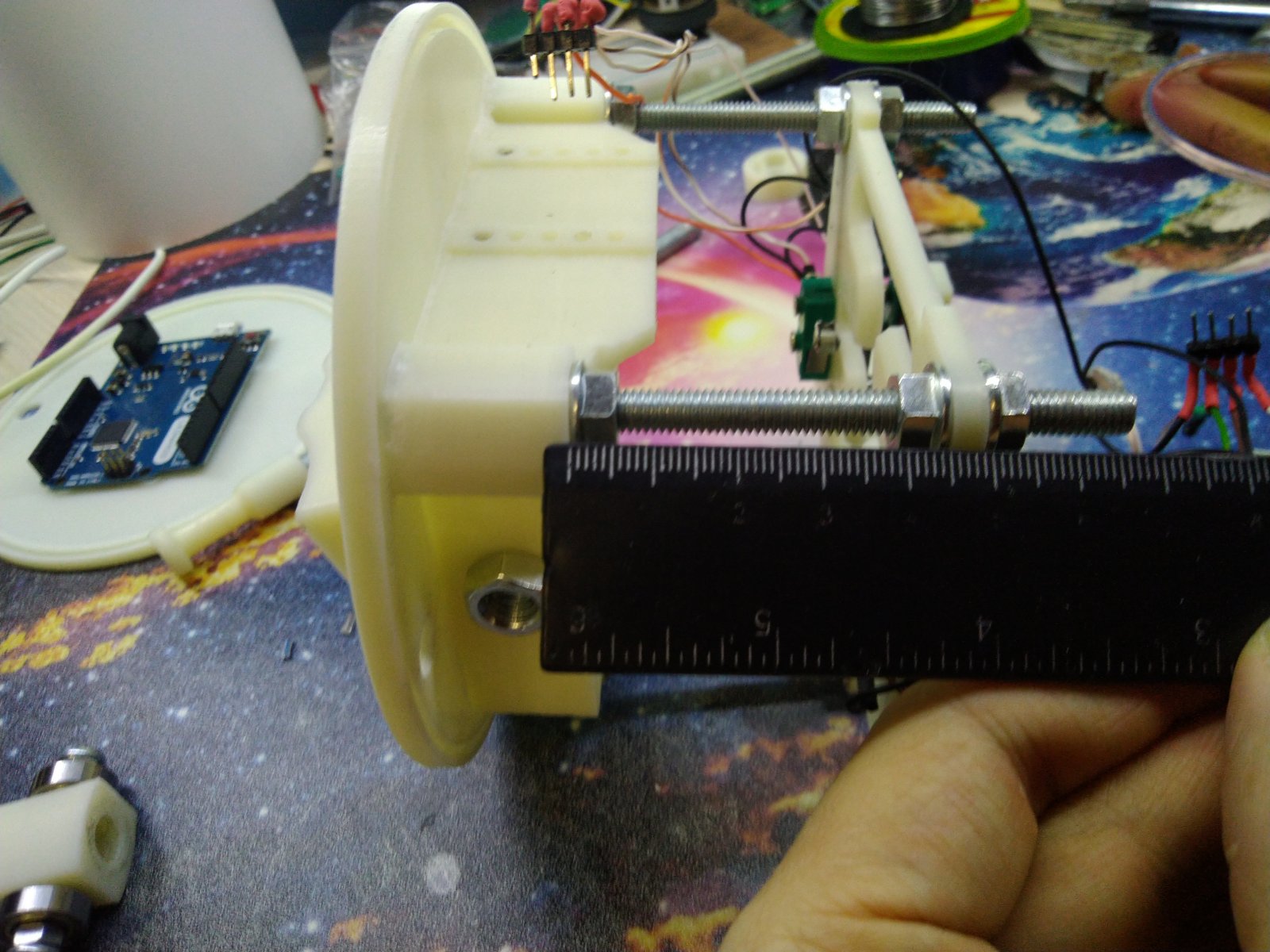

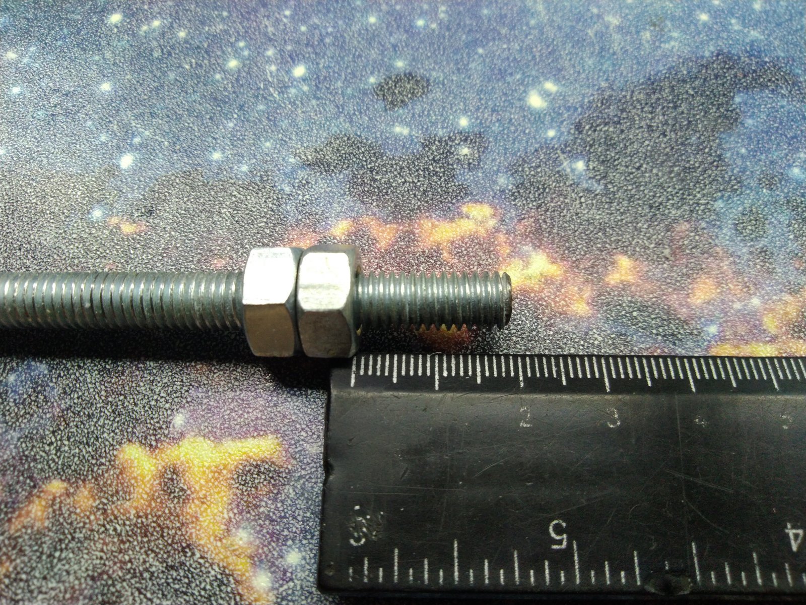

    Files for printing gearbox in the archive. Support-free printing
    Bottom.png Center block.png Handle.png Lower_ring.png Reverse_gear.png Sleeve_x2.png Staple.png Stencil.png Tip.png Top frame.png

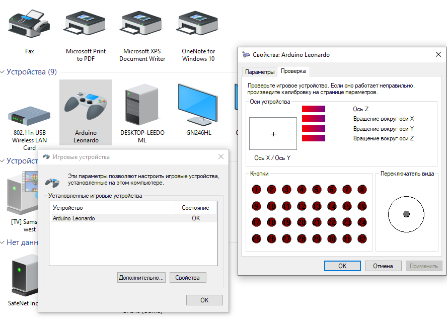

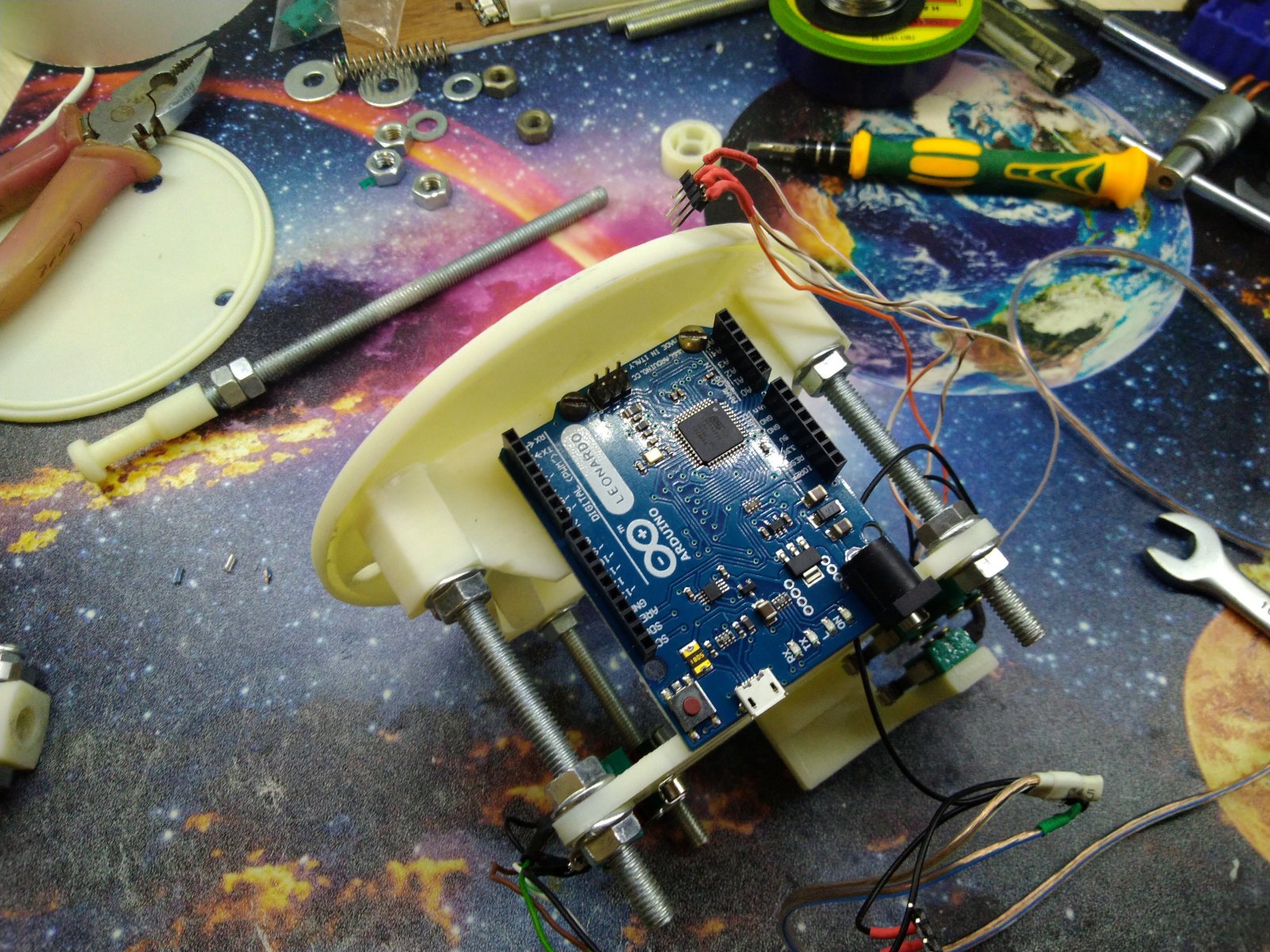

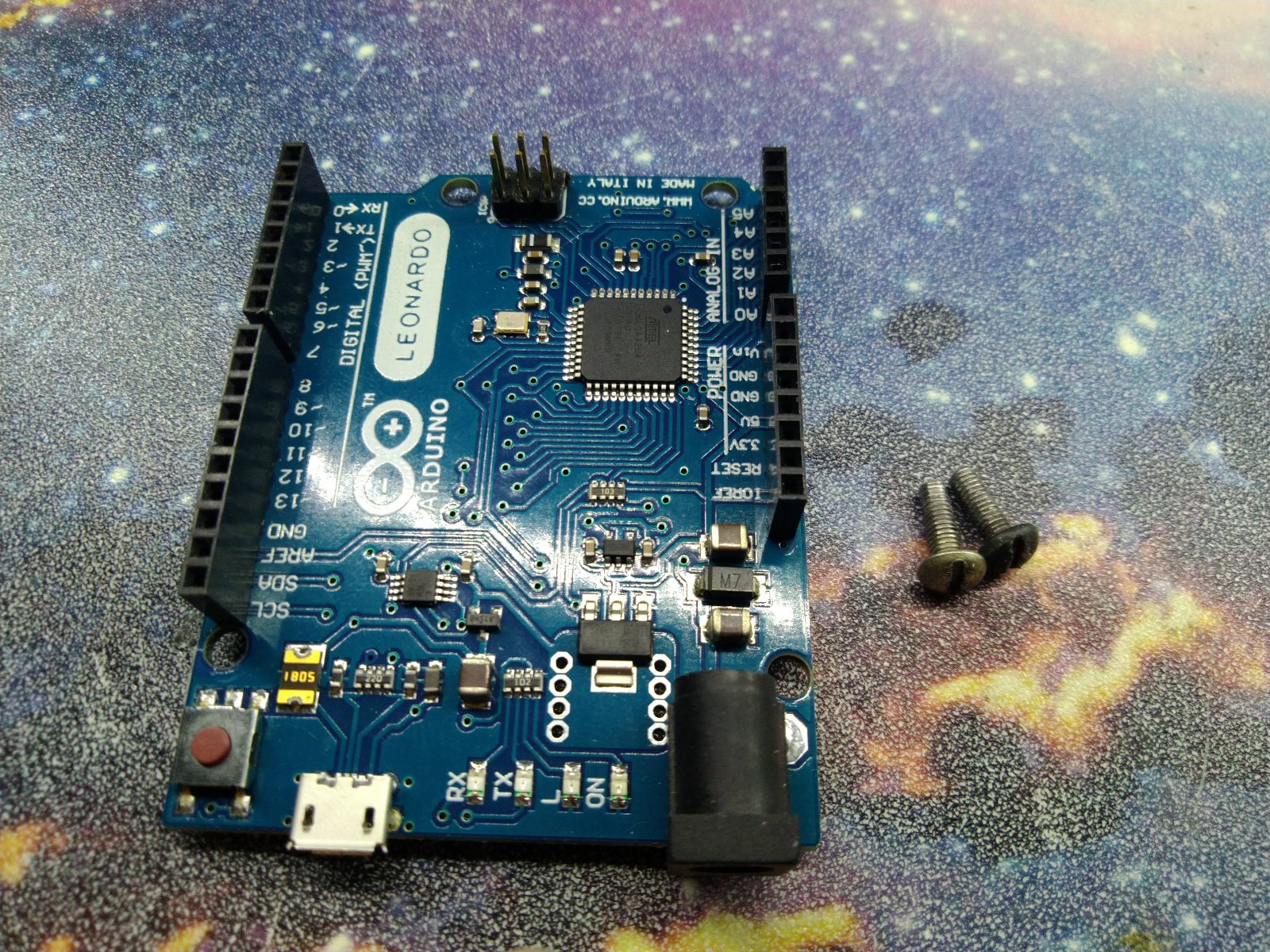

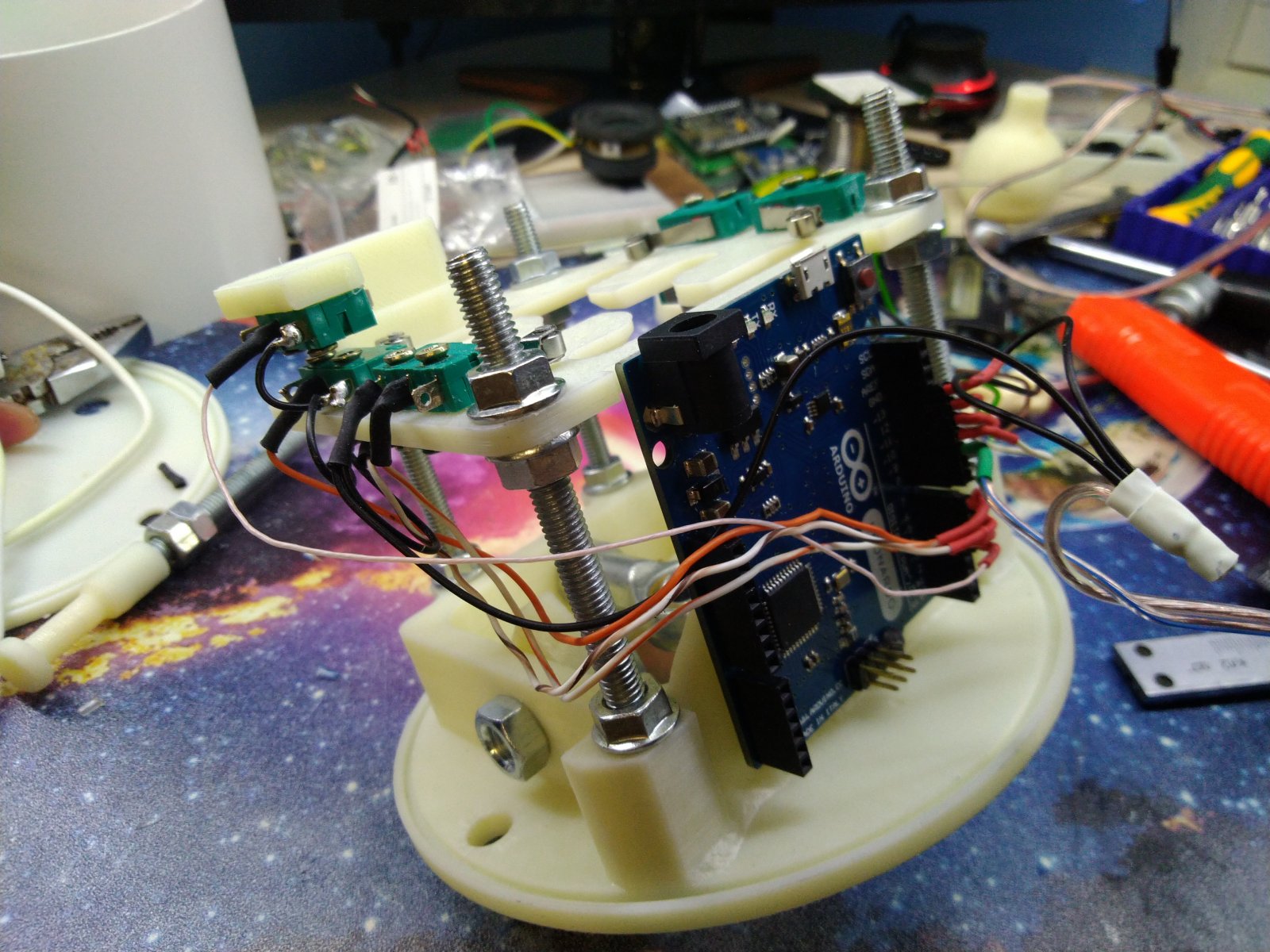

    Arduino Leonardo firmware and necessary library in the archive

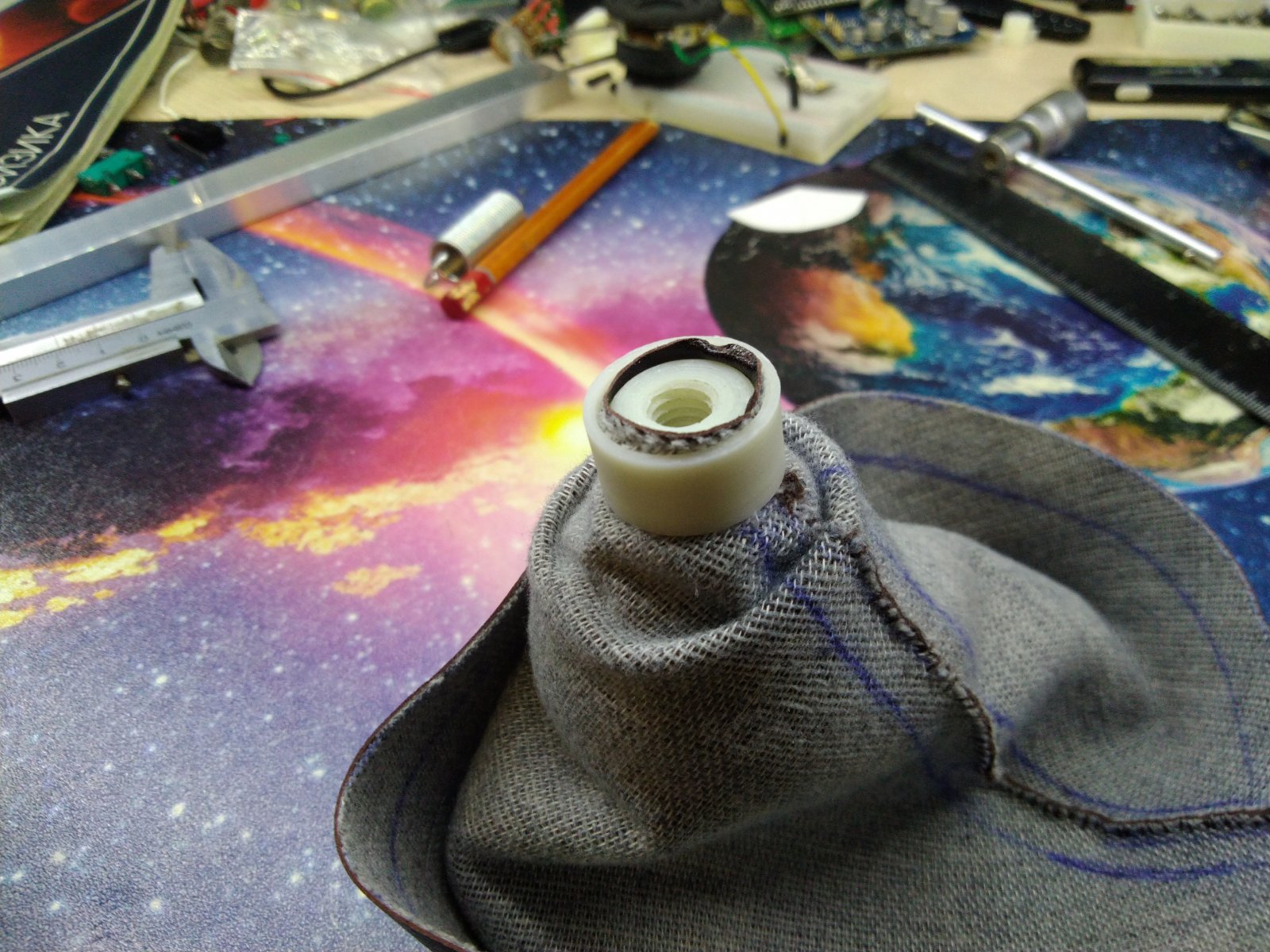

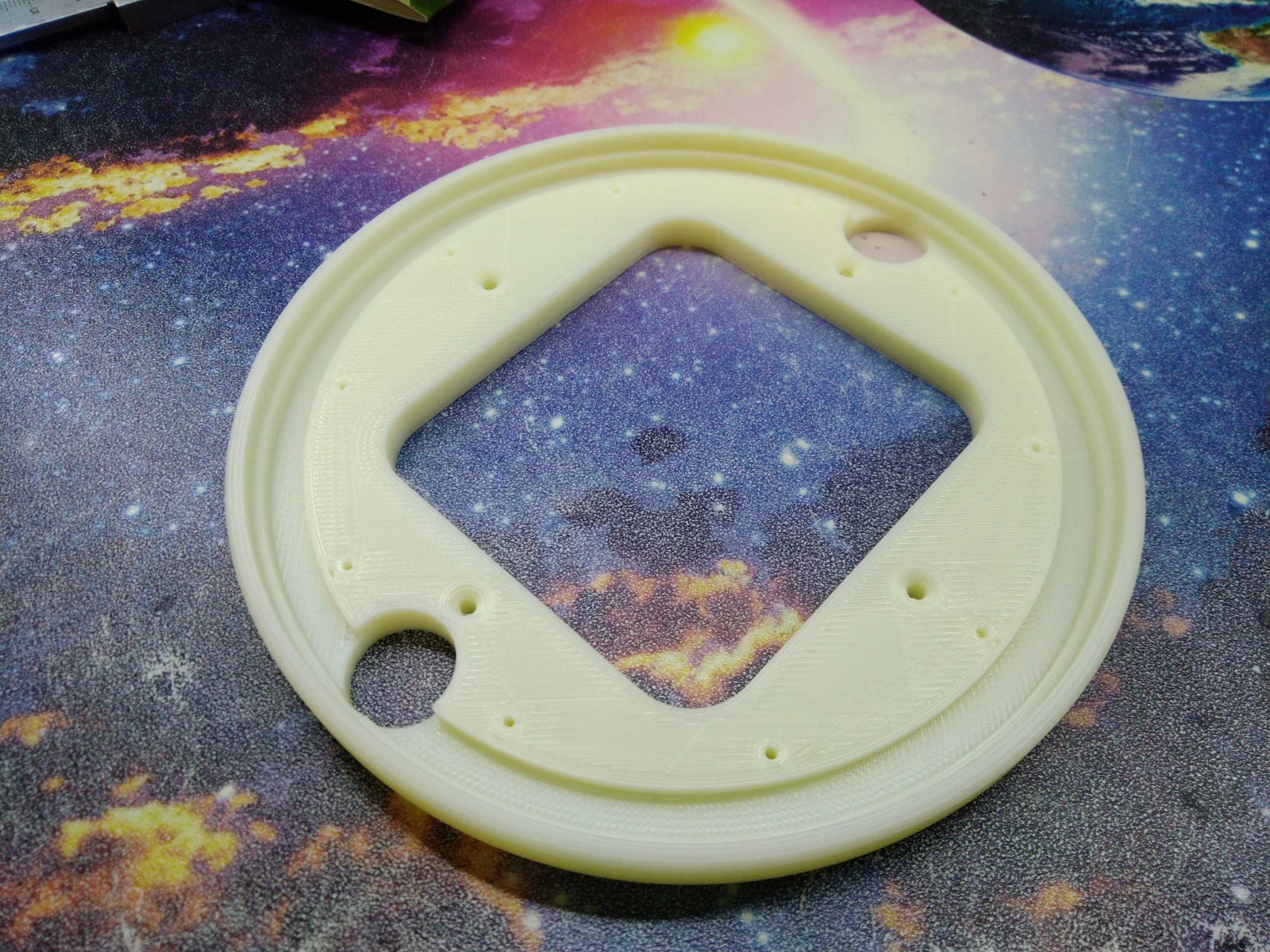

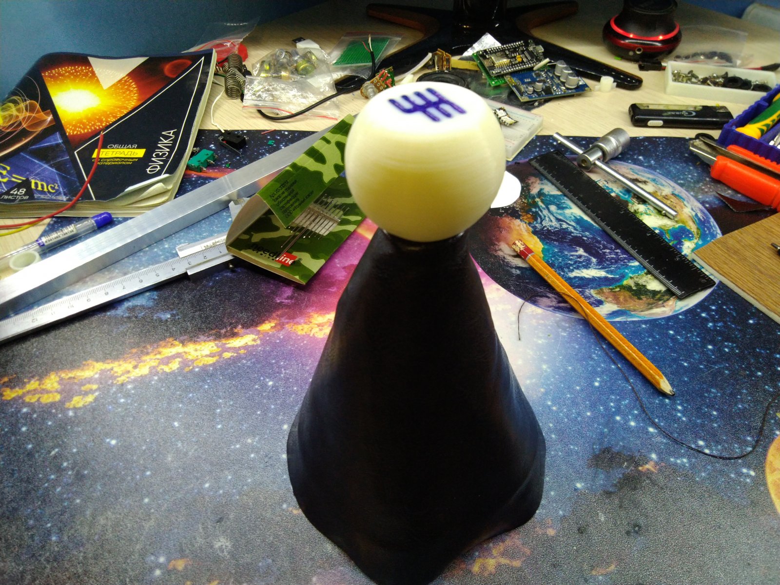

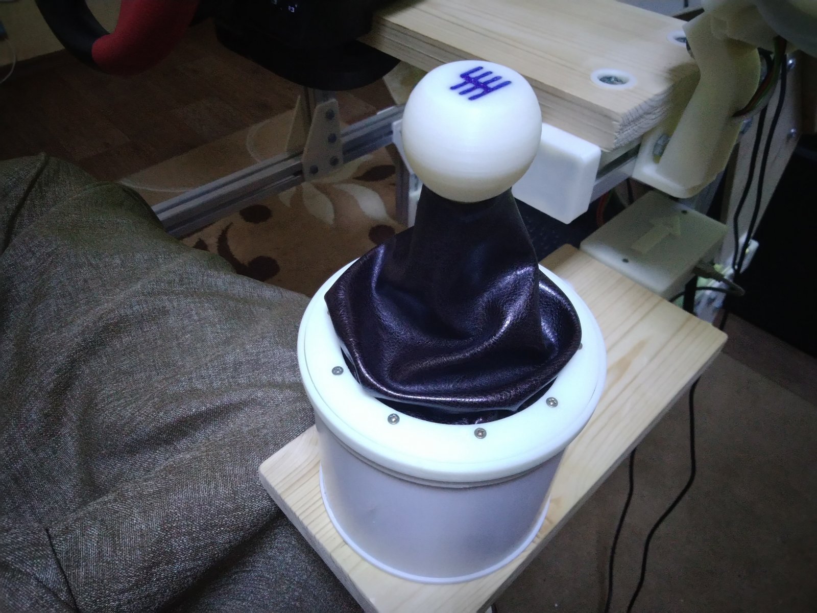

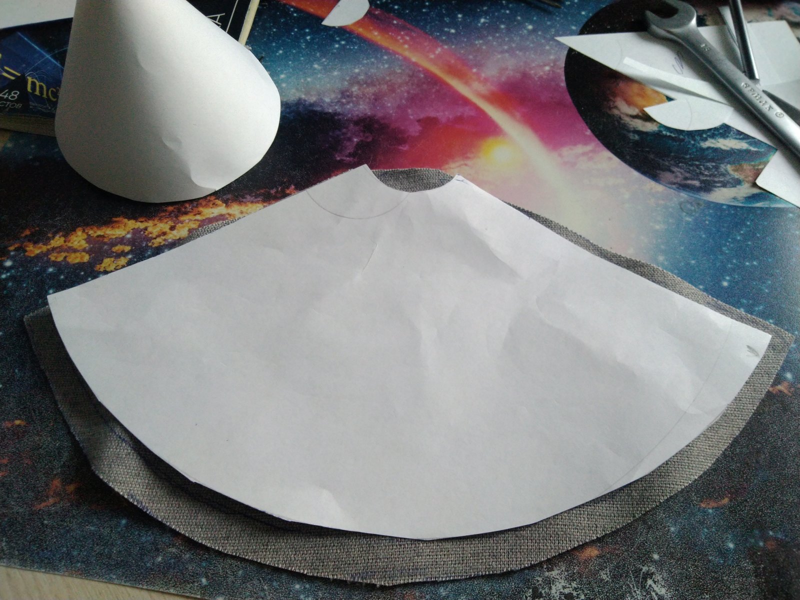

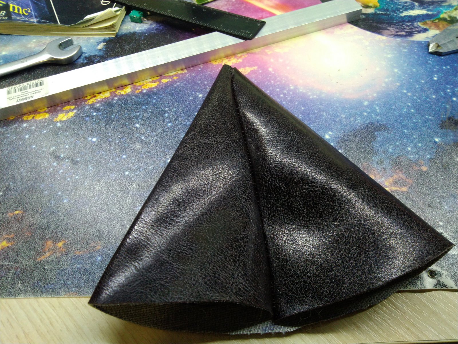

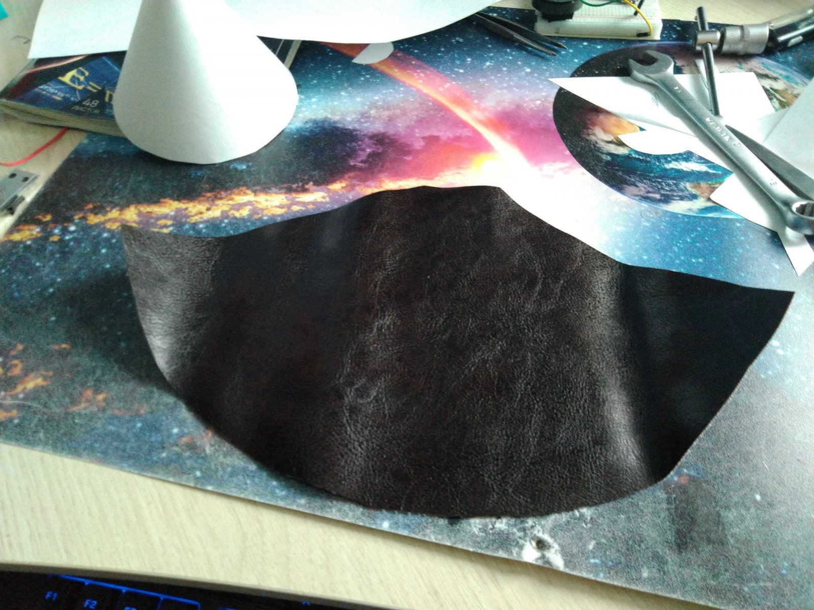

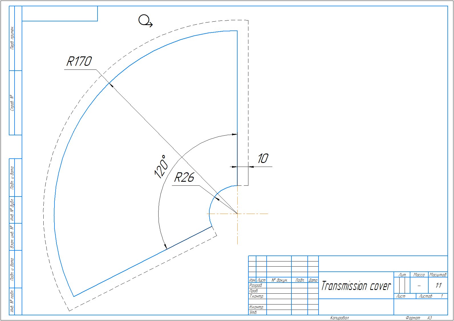

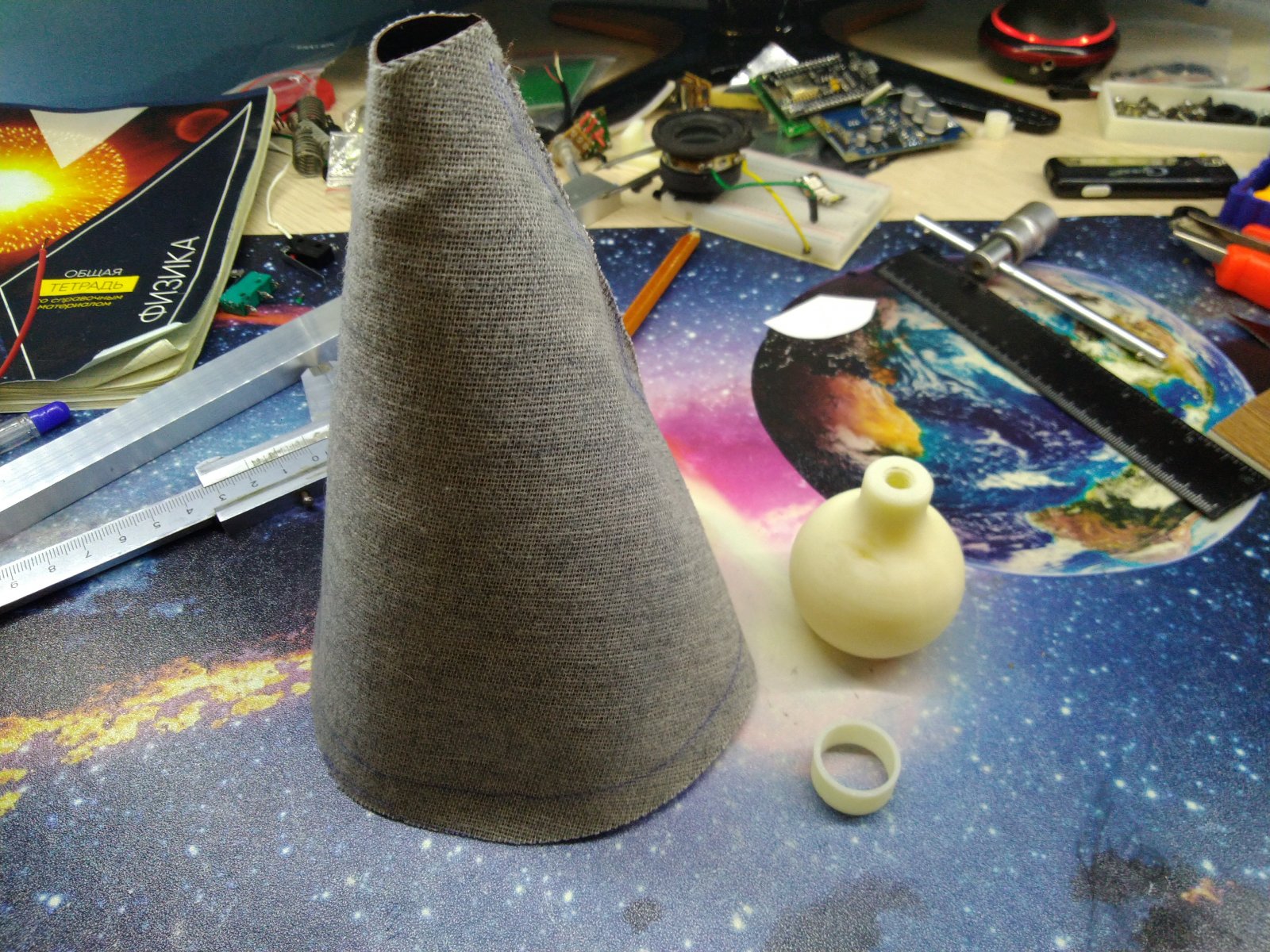

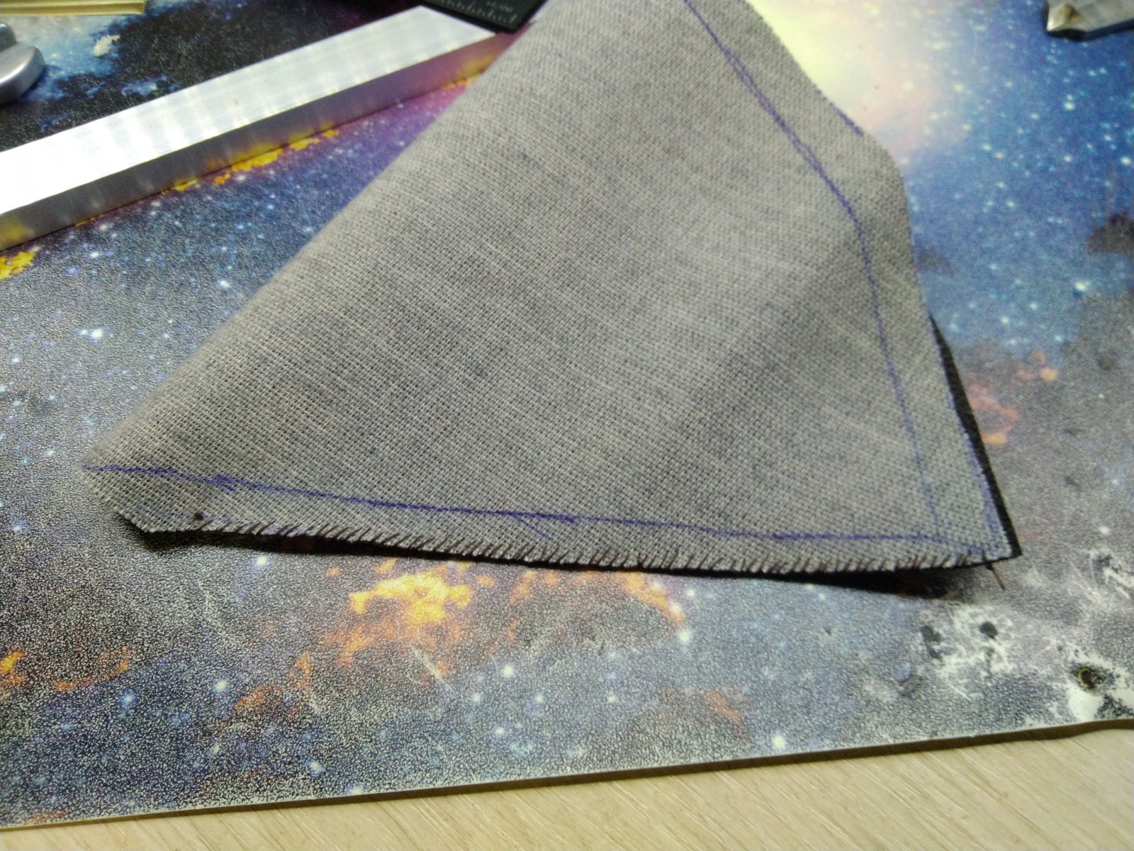

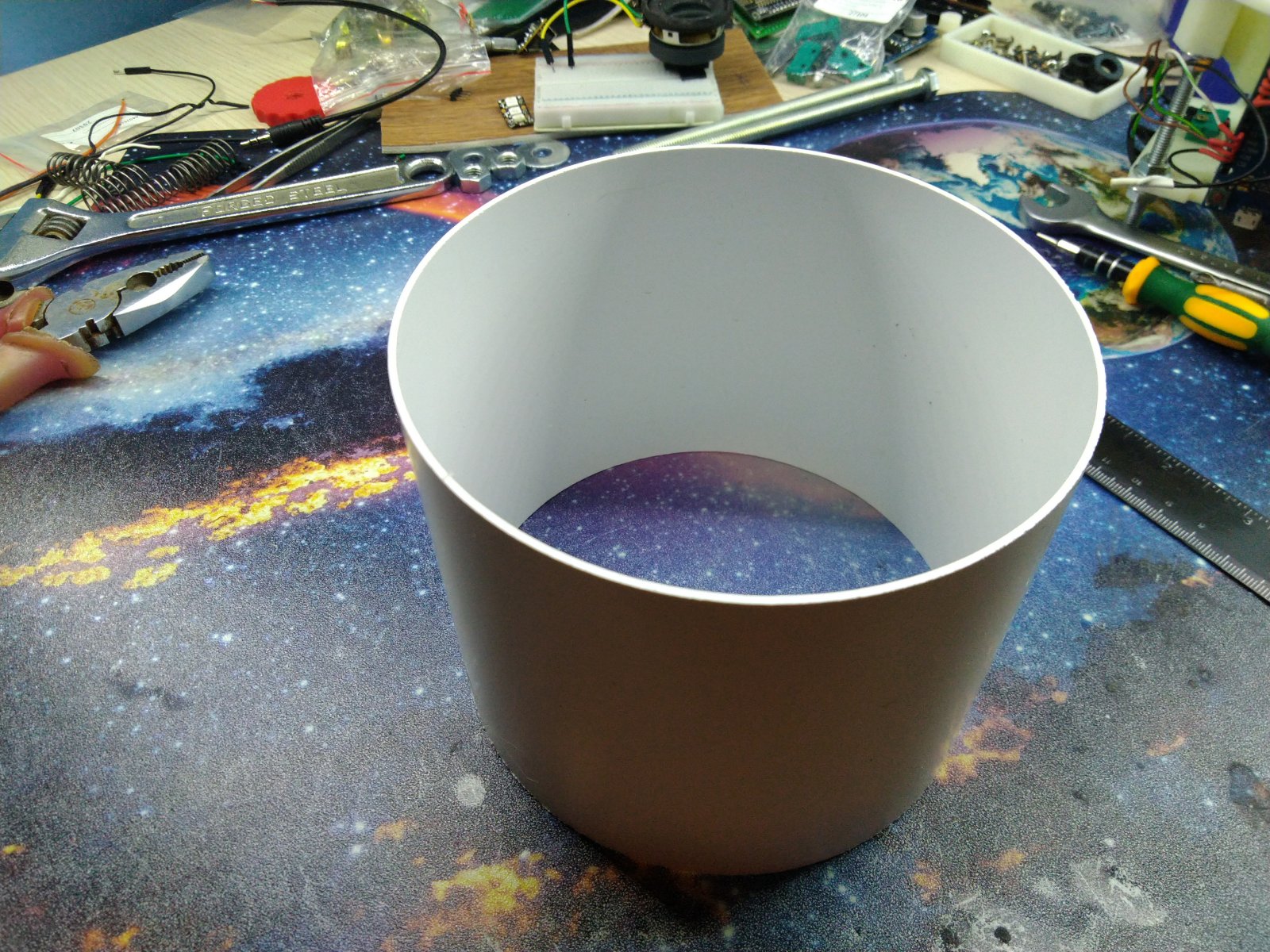

    Gearbox add-on. Lever cover. First, you need to cut the material in accordance with the dimensions in the drawing. Add 10mm to the side as shown by the dashed line

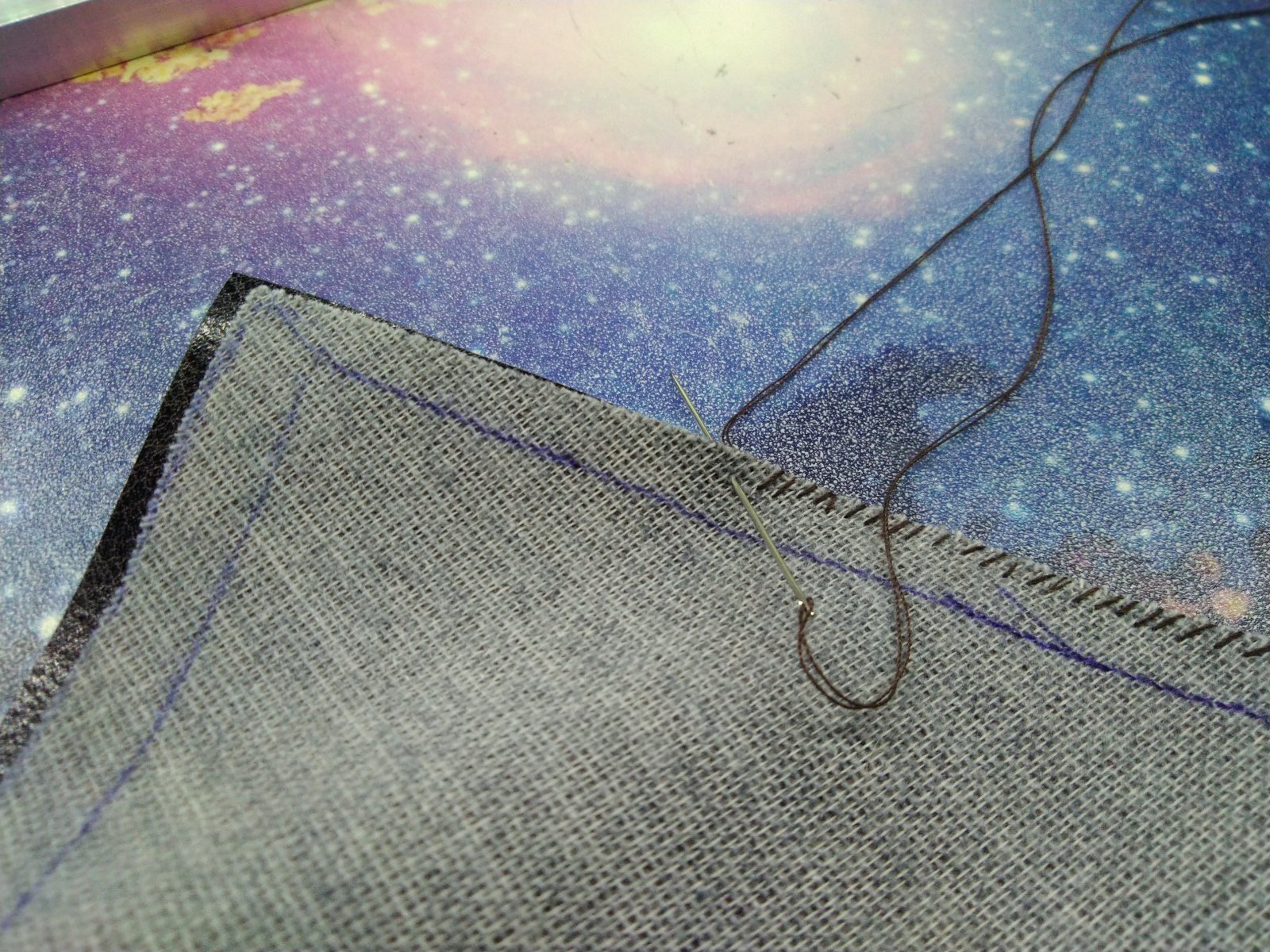

    Sew with thread. You should get this cone

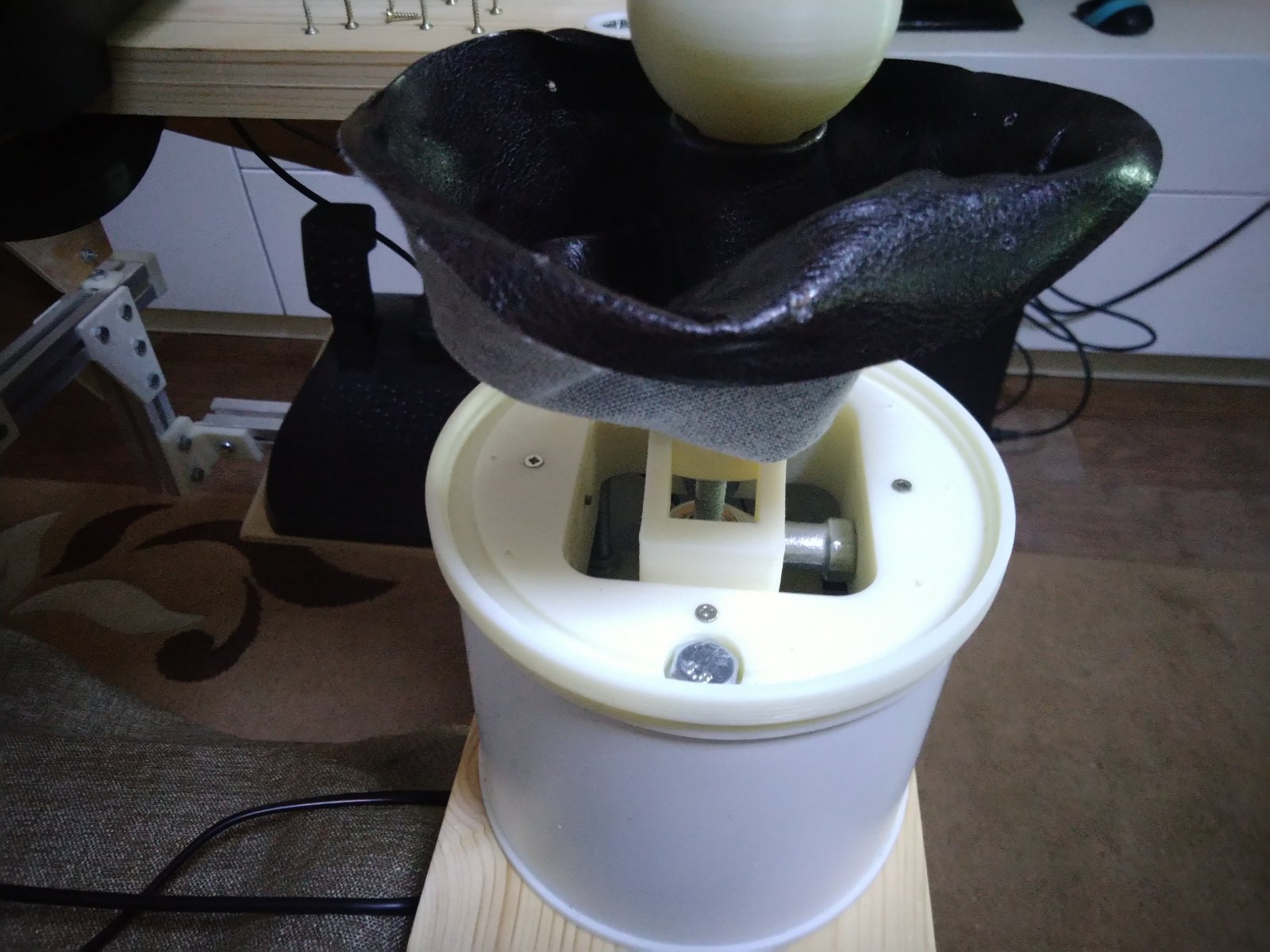

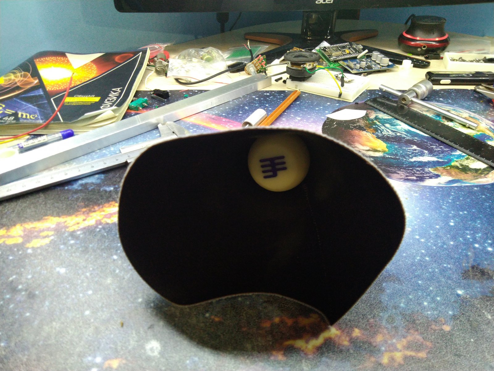

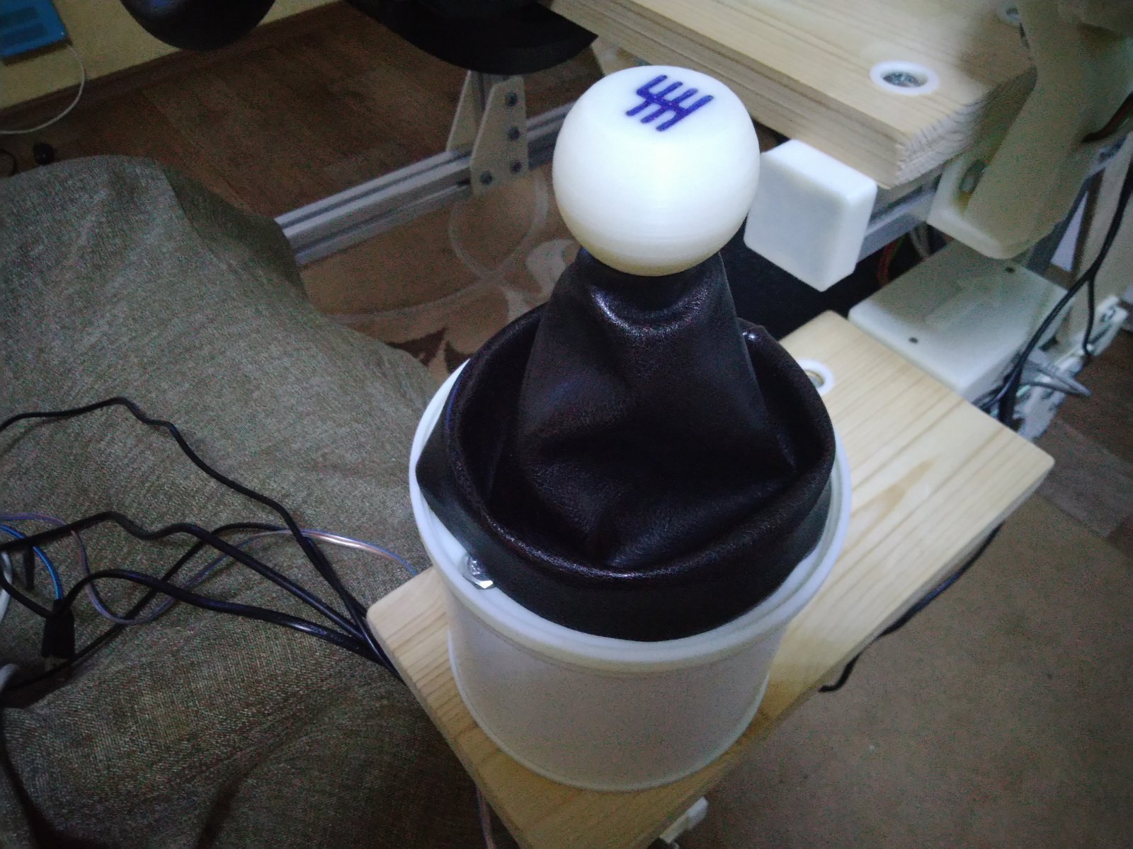

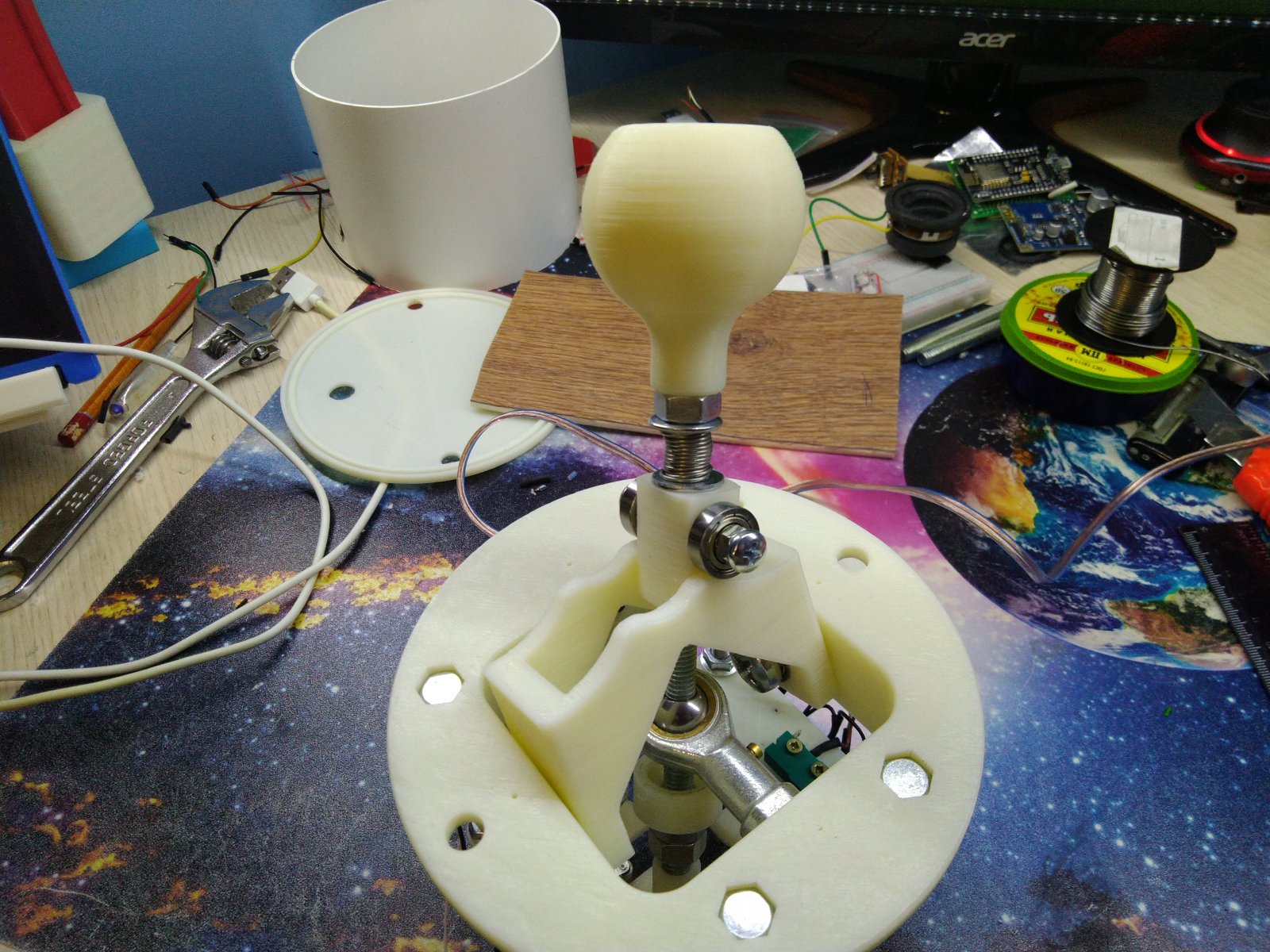

    Print out the ring “Ring_handle.STL”. See file for printing below. Pass the handle into the sewn cover and press the ring on top. If it dangles, use glue. I got it very tight and holds great without additional glue fixation
    IMG_20210103_222843.jpg IMG_20210103_222900.jpg IMG_20210103_223439.jpg IMG_20210103_225346.jpg
    Print the cover “Onlay.STL” and screw it with spirally grooved nail 2.5x13 to the gearbox. There are already holes for this!
    Screw the handle with the cover onto the lever

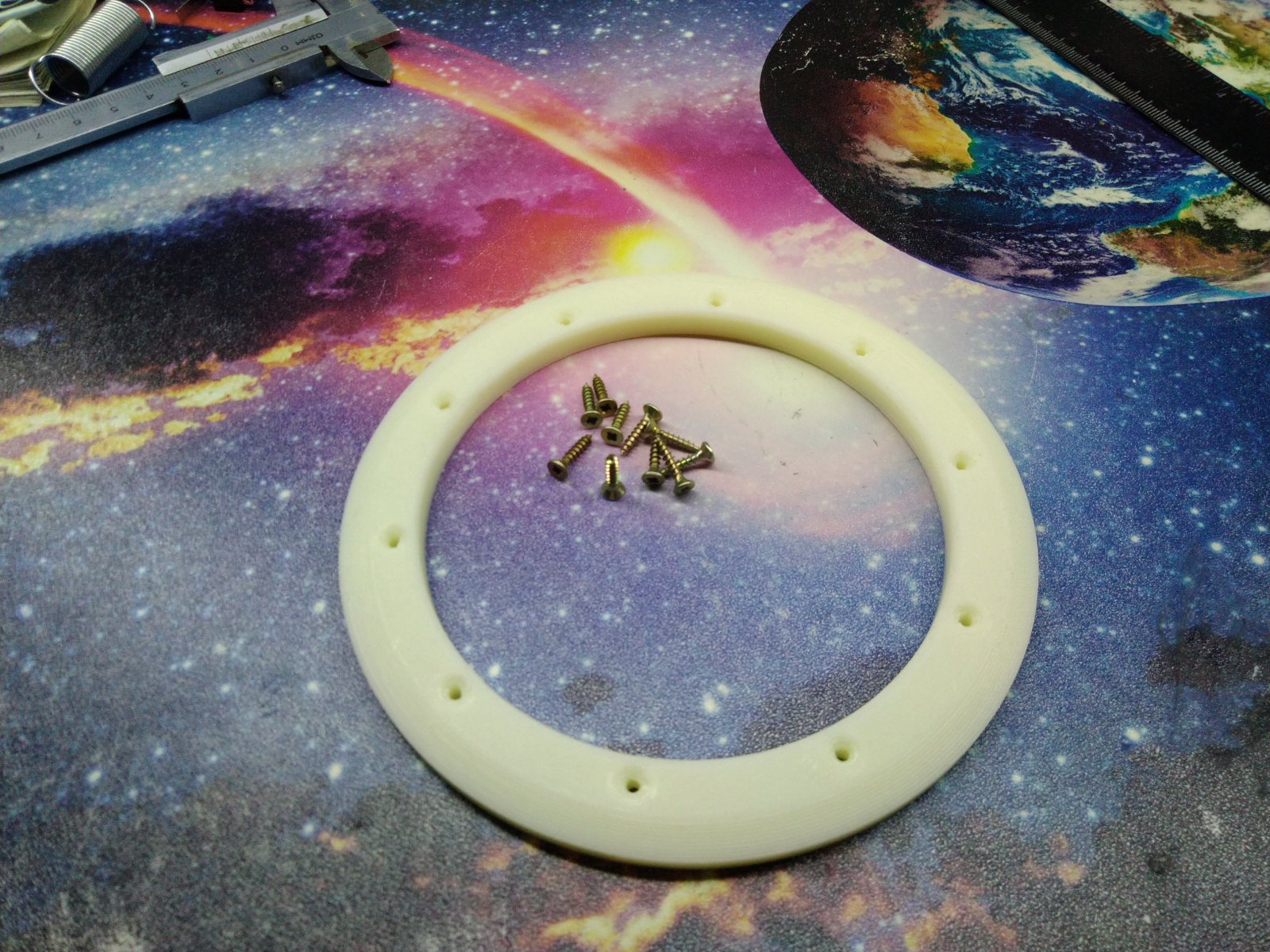

    Print out the “Ring.STL” ring. Fasten the ring from above with 10 screws with 2.5x13 self-tapping screws, carefully tucking the bottom edge of the cover under the ring. It should look like this. Good luck!

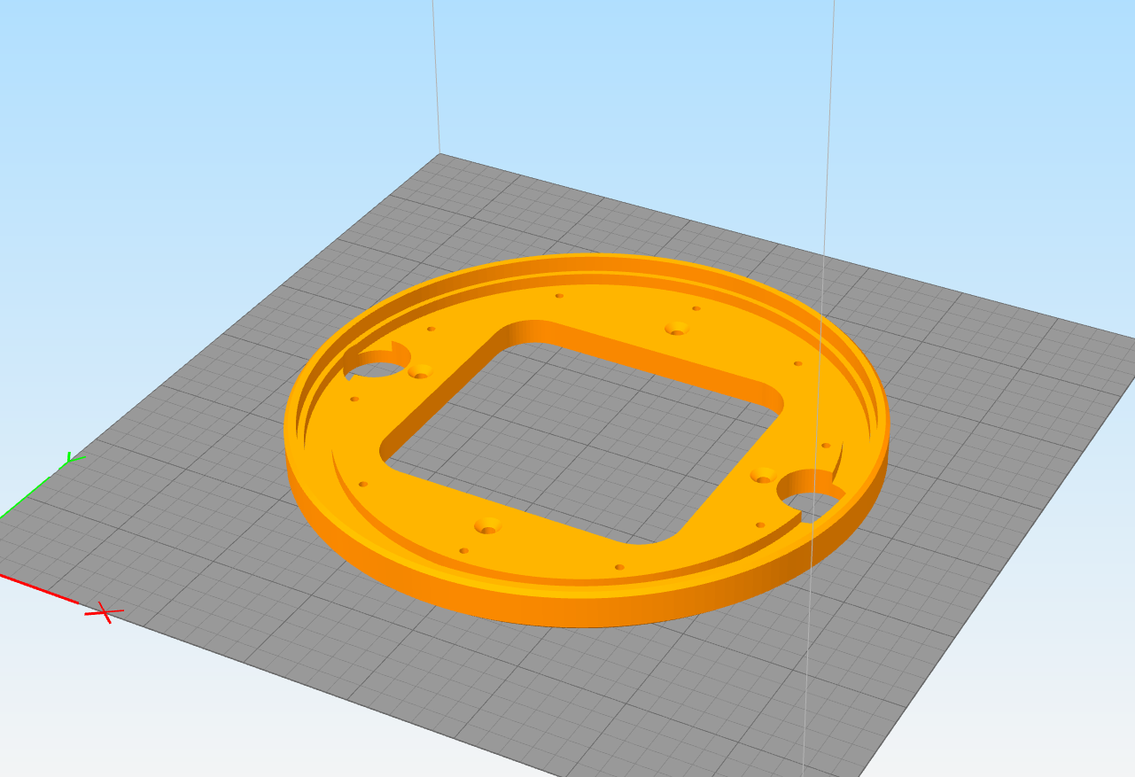

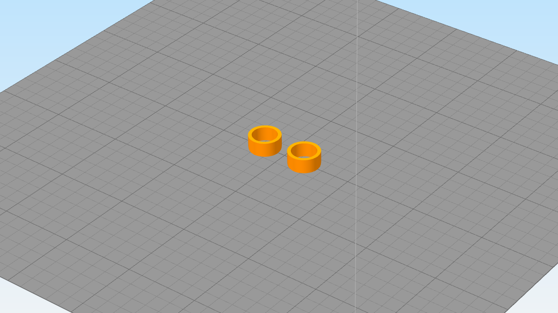

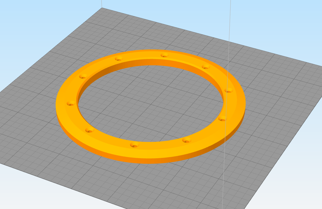

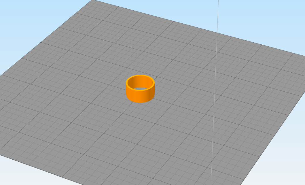

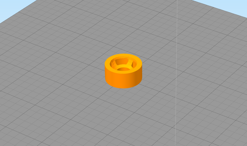

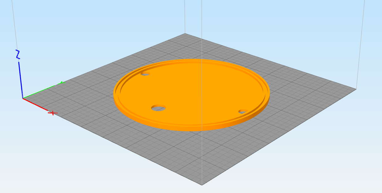

    Details for printing gearbox supplement

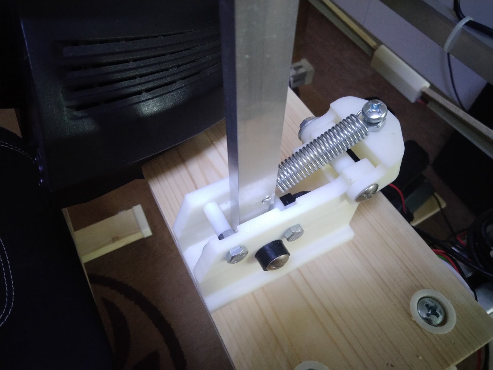

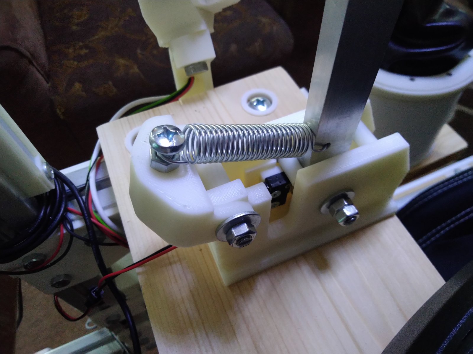

  7. Michael_miass
    Michael_miass West
    Nov 16, 2019
    145
    Russia, Miass
    725Coins
    +175 / 0 / -0

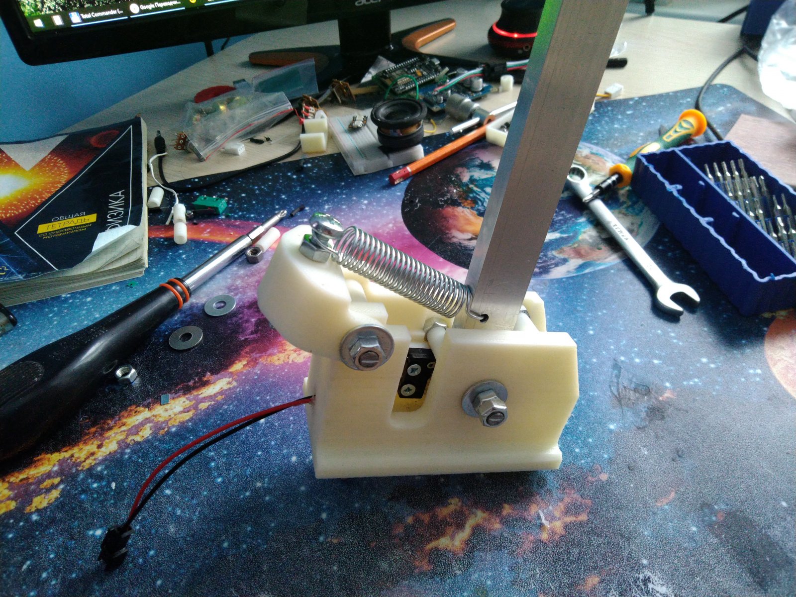

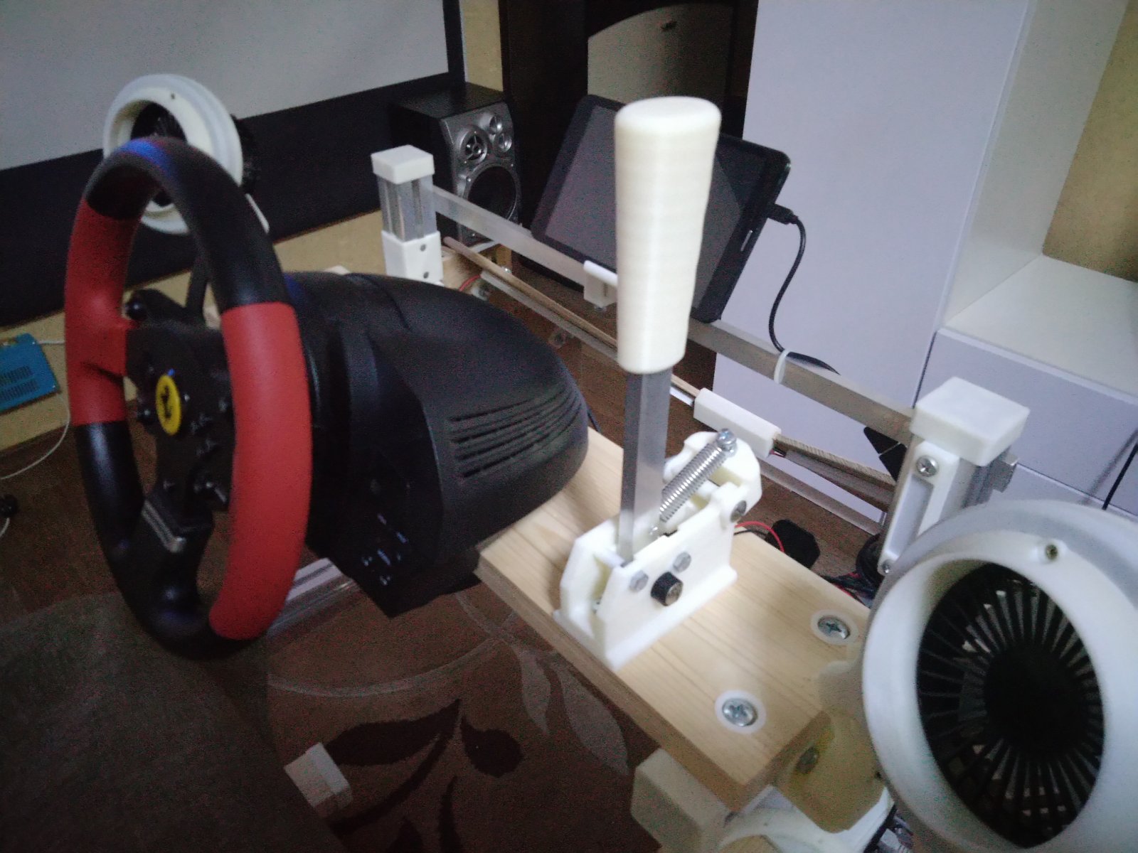

    Today I made a handbrake. Now i can drift:). Connected to arduino Leonardo gearbox
    IMG_20210105_120509.jpg IMG_20210105_122744.jpg IMG_20210105_122829.jpg IMG_20210105_140540.jpg IMG_20210105_193528.jpg IMG_20210105_193543.jpg

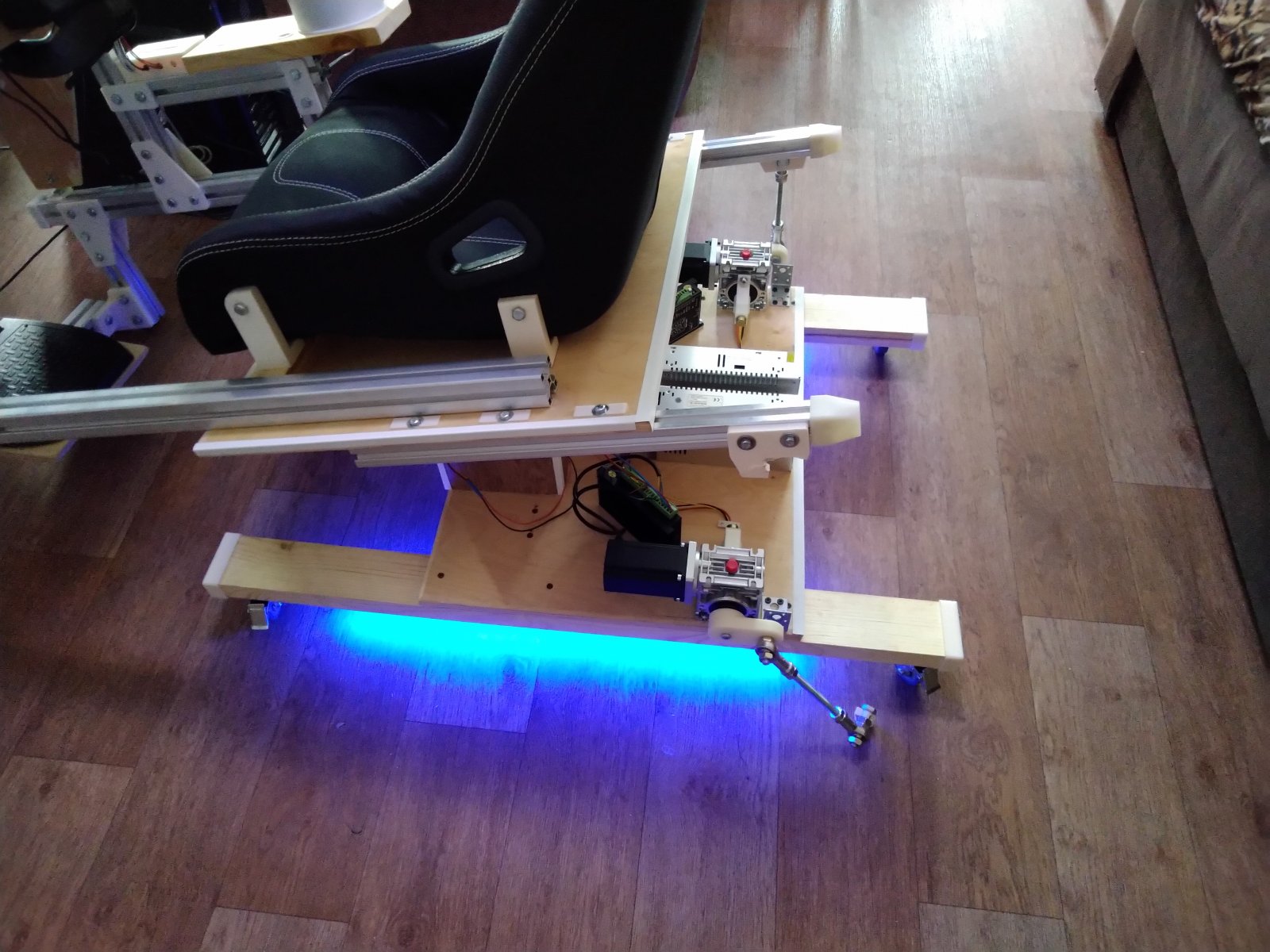

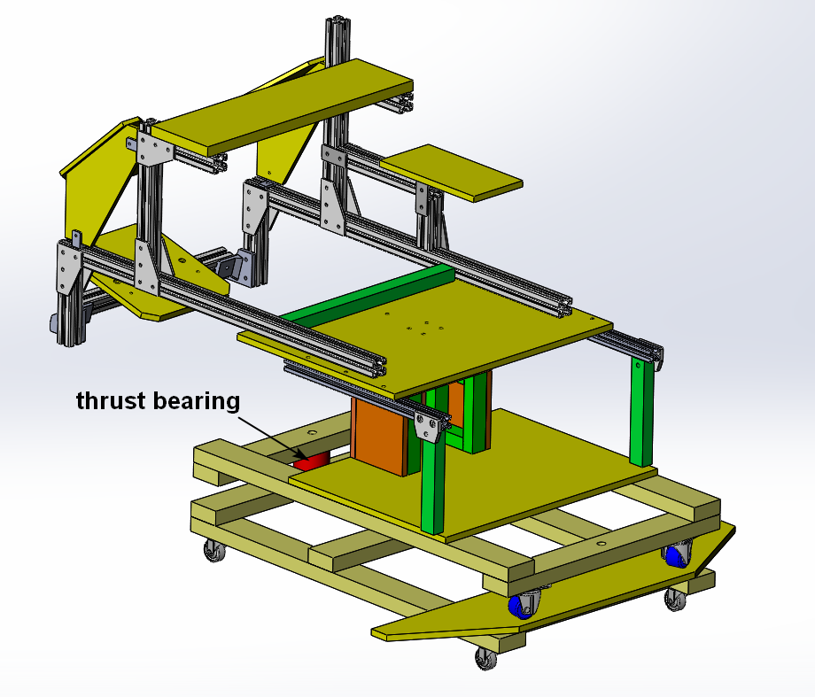

    I think it's time to introduce the third axle (traction loss). Convert 2DOF to 3 DOF:)
  9. Michael_miass
    Michael_miass West
    Nov 16, 2019
    145
    Russia, Miass
    725Coins
    +175 / 0 / -0
    What angle would you recommend for traction loss?
    21,723
    152,051Coins
    +11,063 / 56 / -2
    Around 150mm each way, so something around 300mm total.
  11. Michael_miass
    Michael_miass West
    Nov 16, 2019
    145
    Russia, Miass
    725Coins
    +175 / 0 / -0
    Thanks for the advice. I thought about the same:) I understand that the load on the motor will be less than that of other motors. I have a BLDC 150W motor, through the gearbox I think that's enough

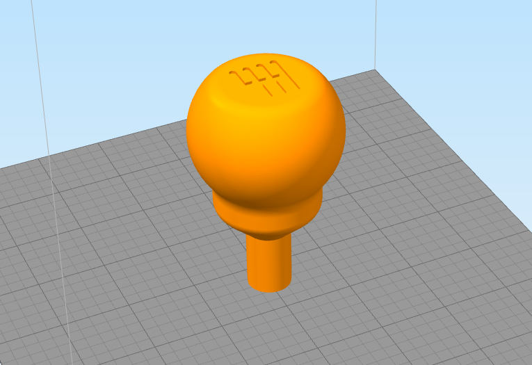

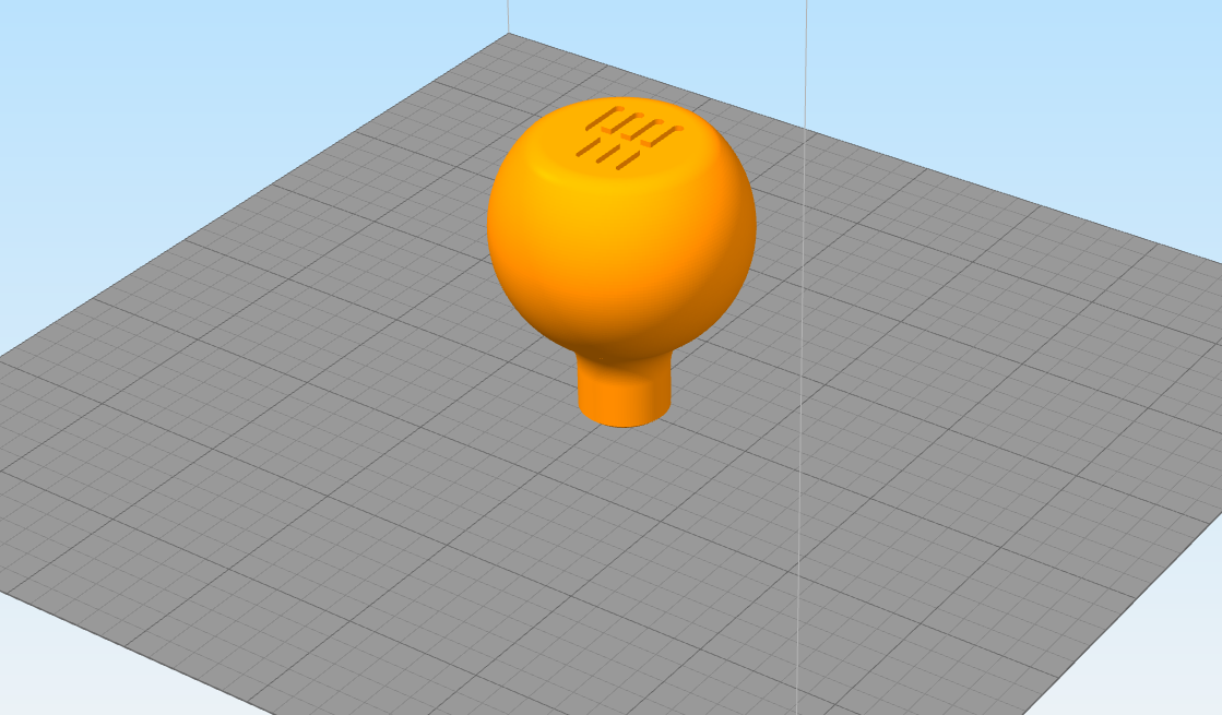

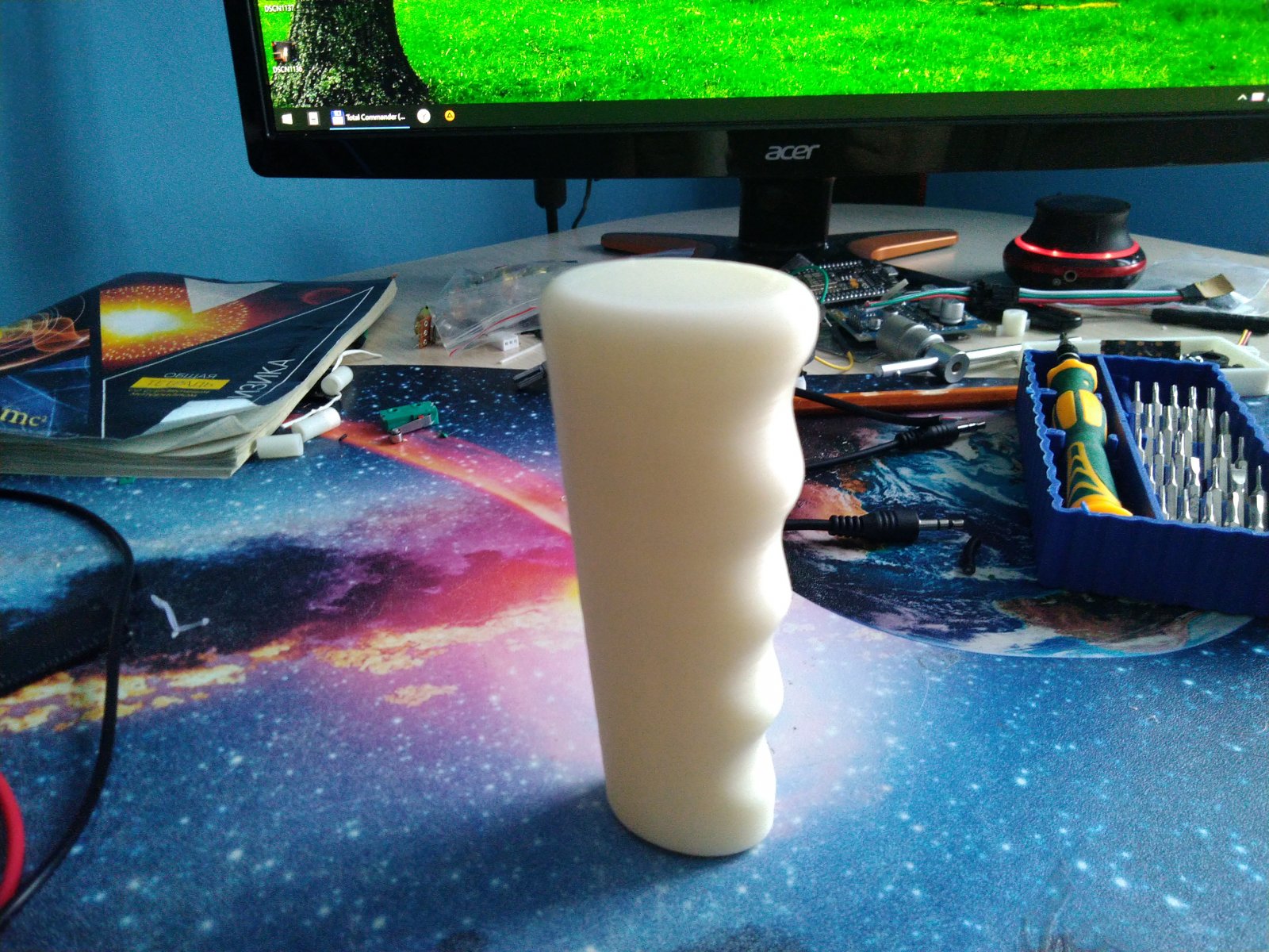

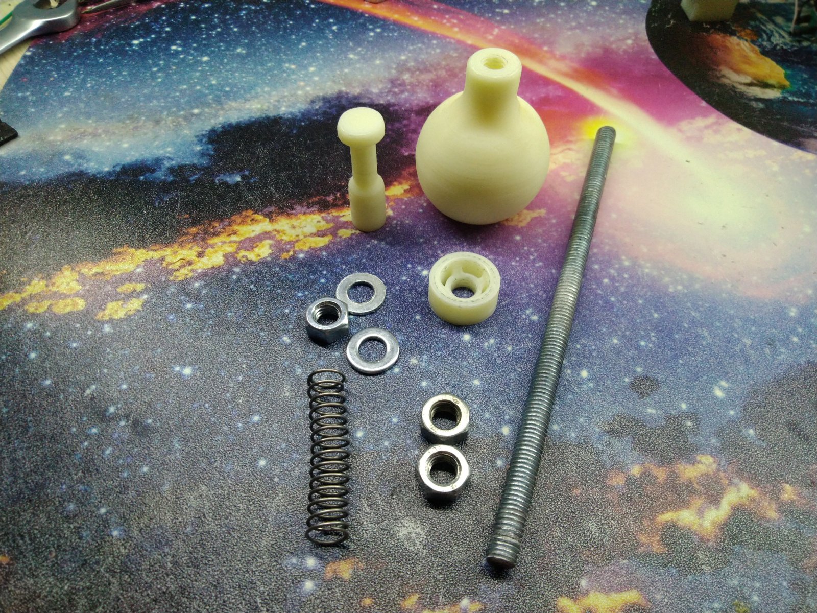

    Improved gear knob. It is larger and feels better in the hand
    File for printing

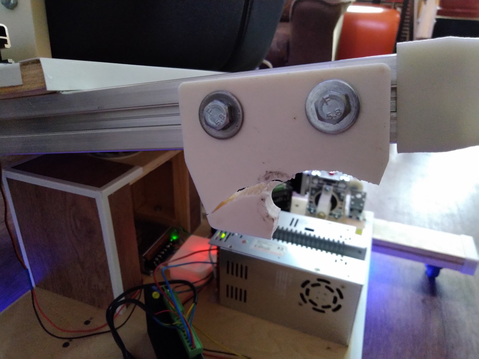

  17. Michael_miass
    Michael_miass West
    Nov 16, 2019
    145
    Russia, Miass
    725Coins
    +175 / 0 / -0
    Crash car or traffic accident:eek:
    Plastic could not stand high speedso_O

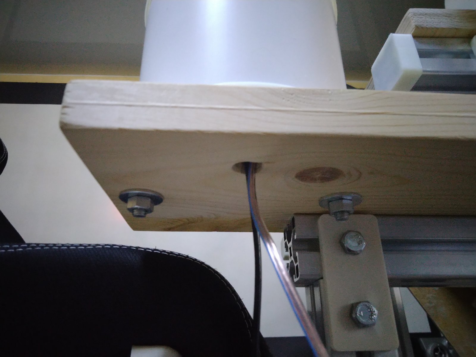

  18. noorbeast
    21,723
    152,051Coins
    +11,063 / 56 / -2
    There is a huge amount of flex in the base, which will also affect motion fidelity.

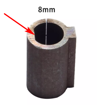

  19. Michael_miass
    Michael_miass West
    Nov 16, 2019
    145
    Russia, Miass
    725Coins
    +175 / 0 / -0

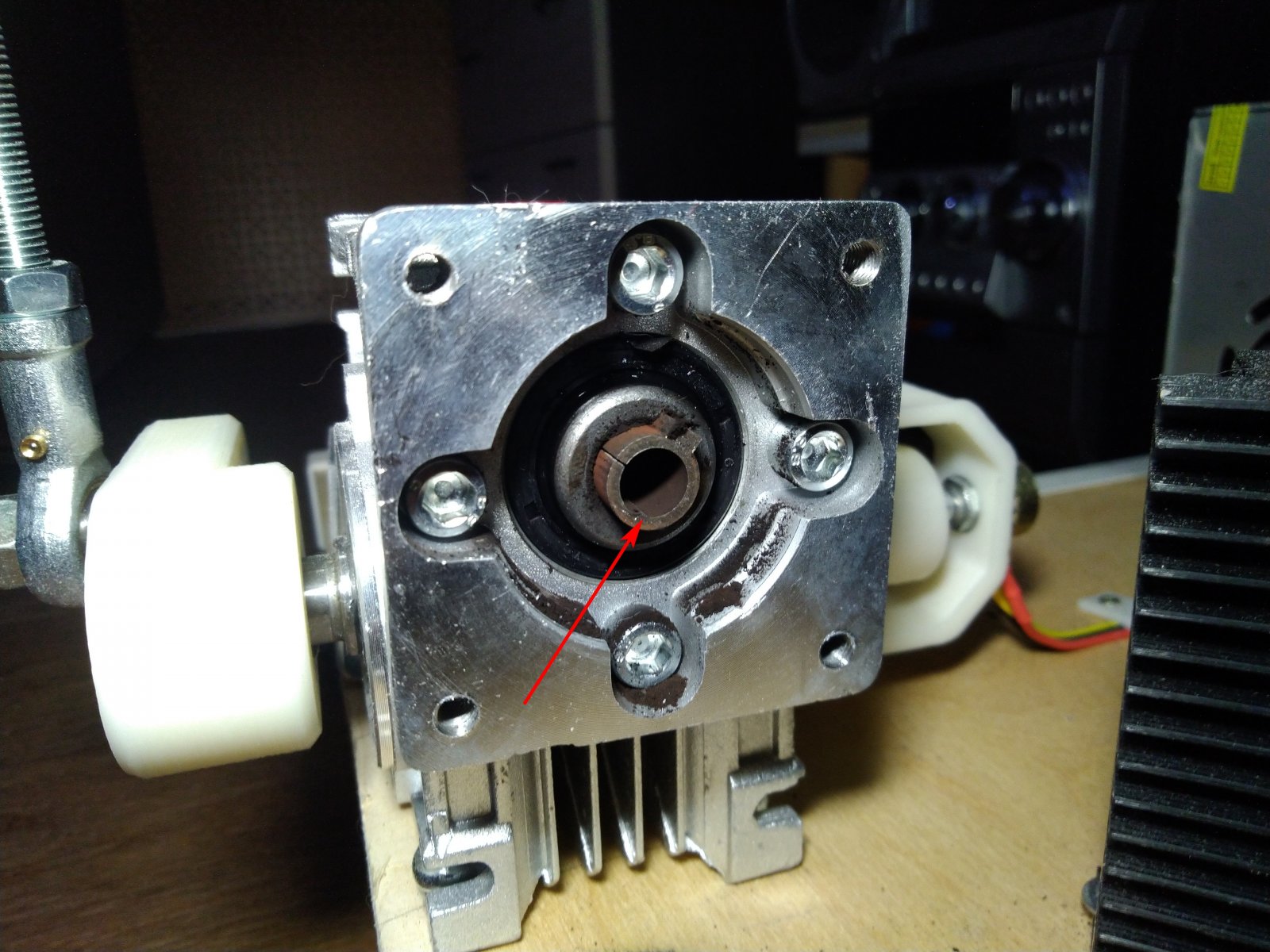

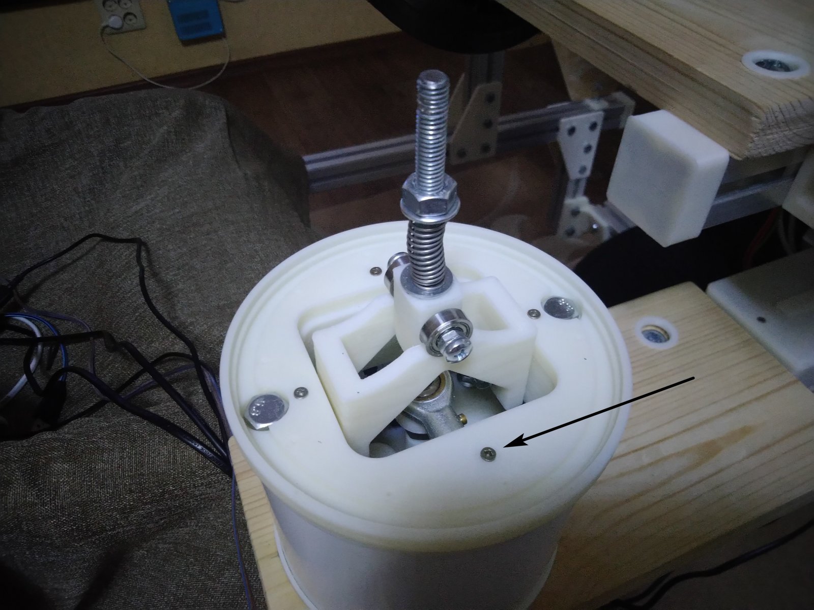

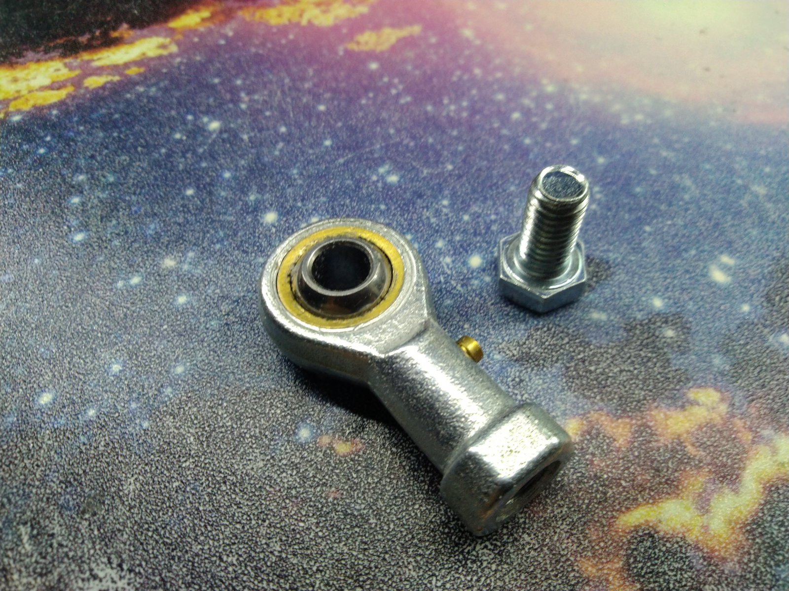

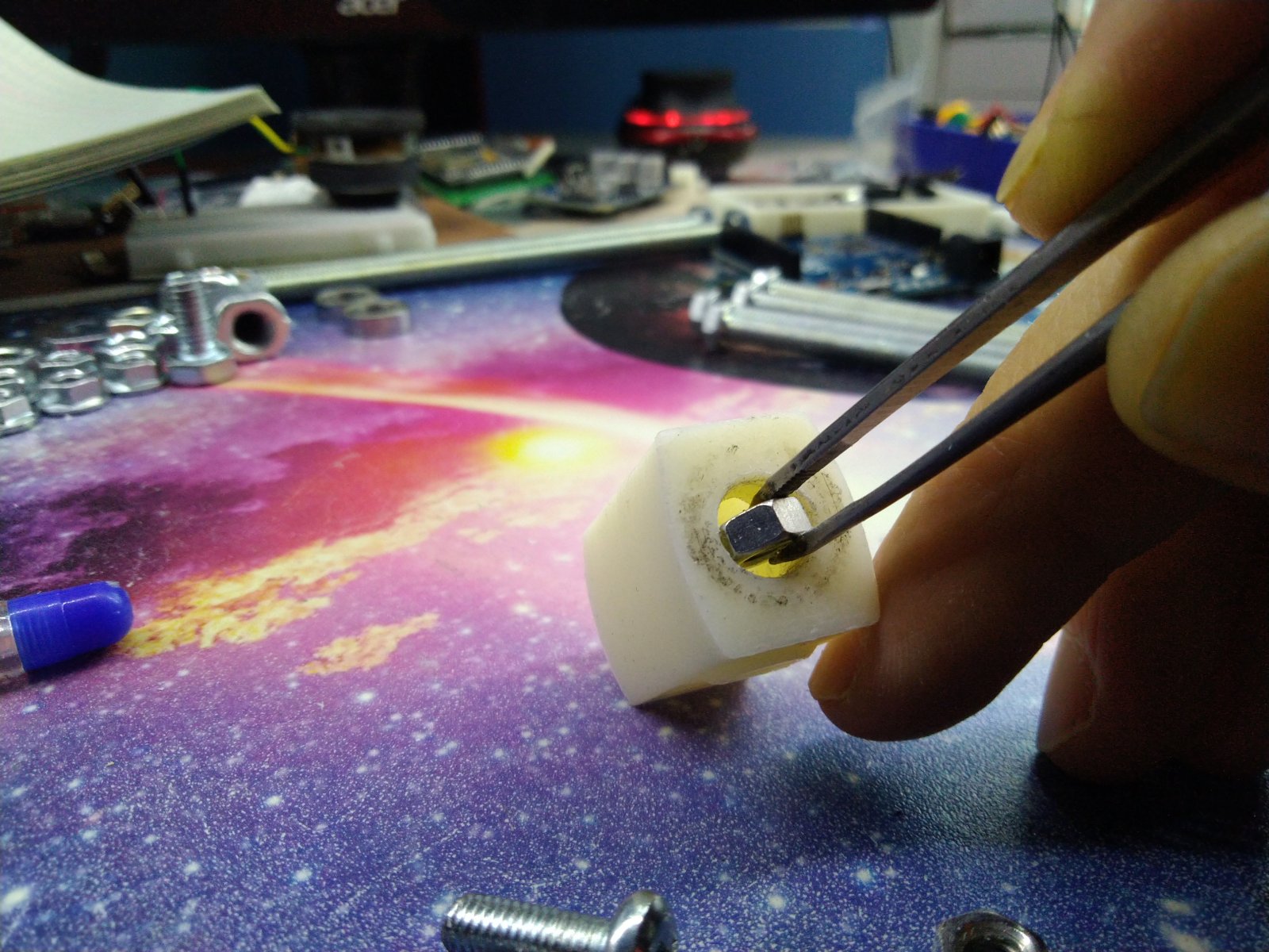

    An adapter for a shaft with a diameter of 8 with a flat (red arrow in the picture) for a diameter of 14 with a key is included with the gearbox
    As you can see in the photo below, on the inner diameter of 8 flat (red arrow in the figure), it is almost worn out. After a while, the connection between the motor and the gearbox would be interrupted
    Best used without an adapter. Select the appropriate shaft on the motor to connect directly to the gearbox
  20. Abram Manoge
    Abram Manoge Member
    Apr 6, 2021
    46
    Web developer
    South Africa
    319Coins
    That looks a bit scary. have you considered making the base longer both back to front and side to side, that will help stop the rig from jumping of the ground . that weakens the plastic joint brackets that hold the rig together or maybe switch to steel brackets
