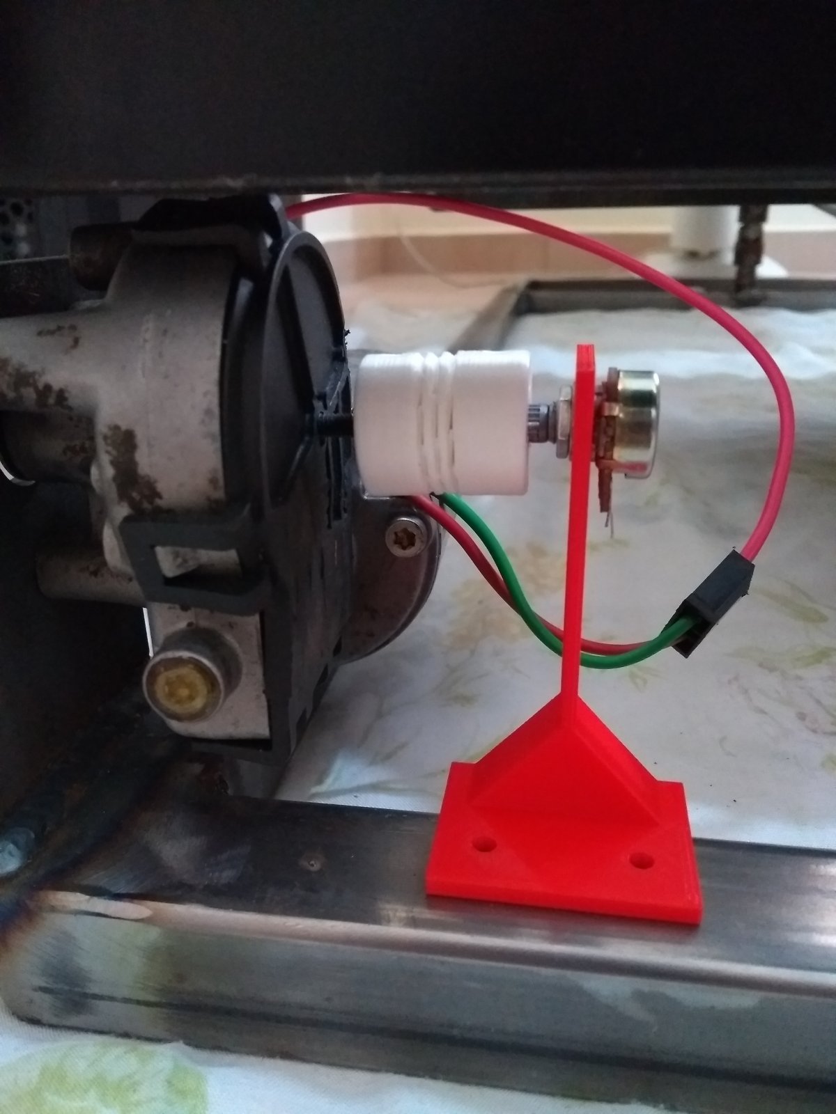

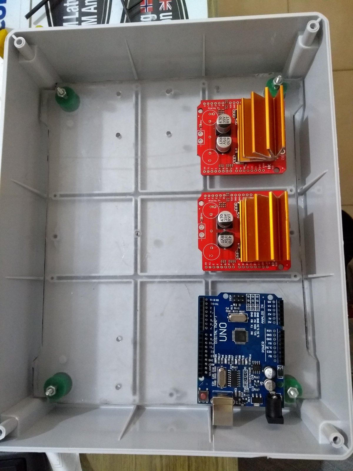

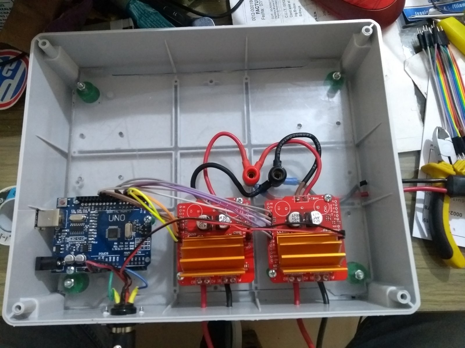

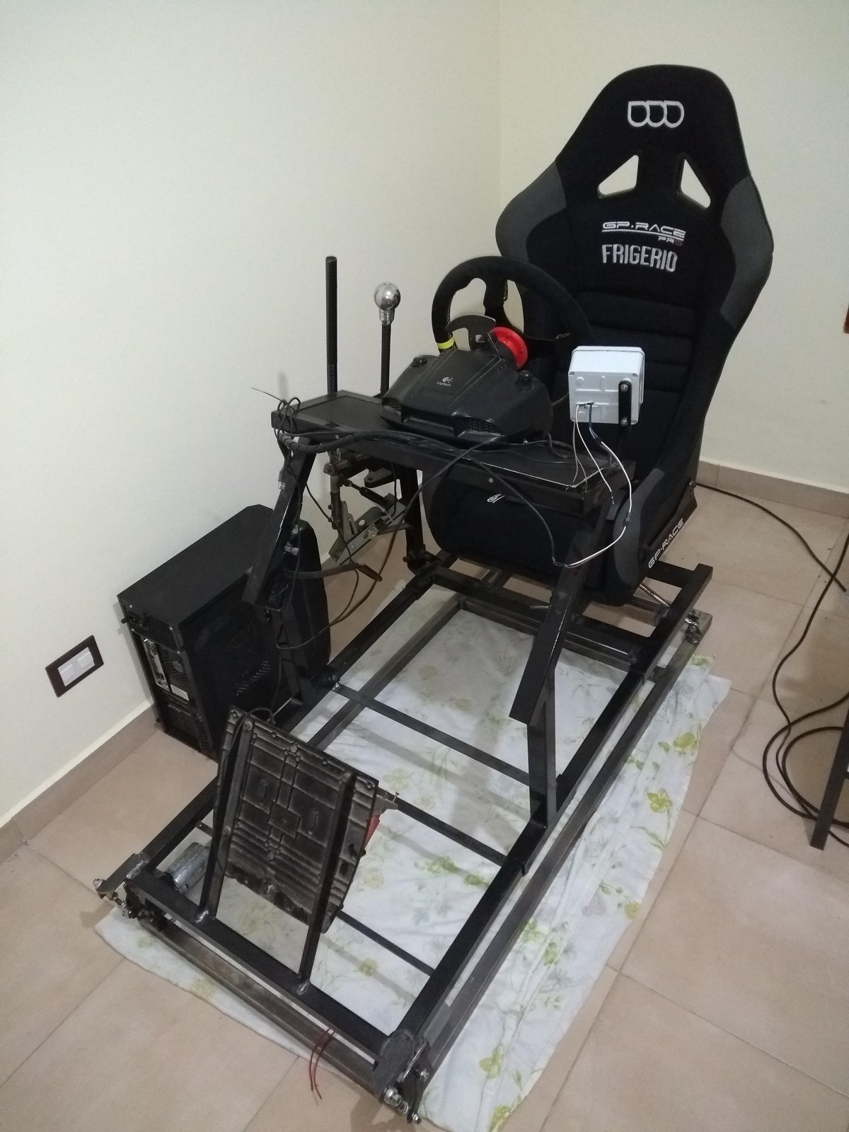

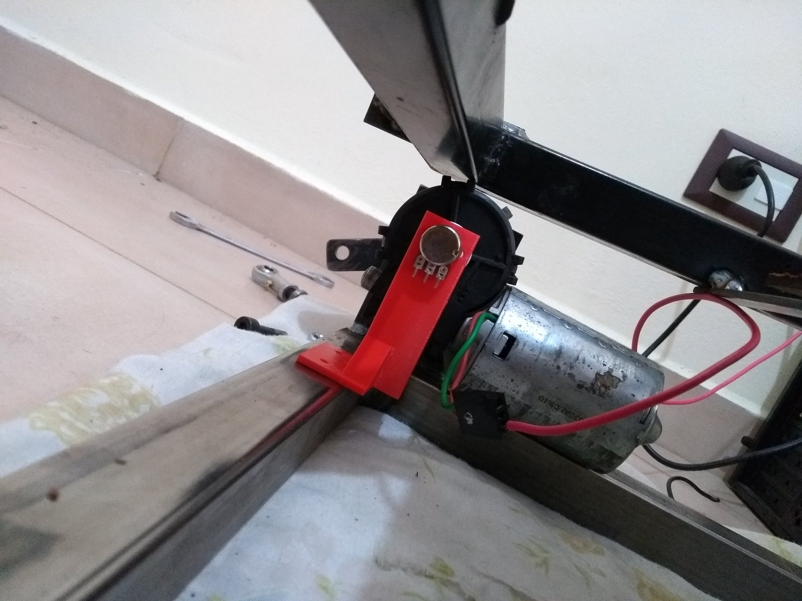

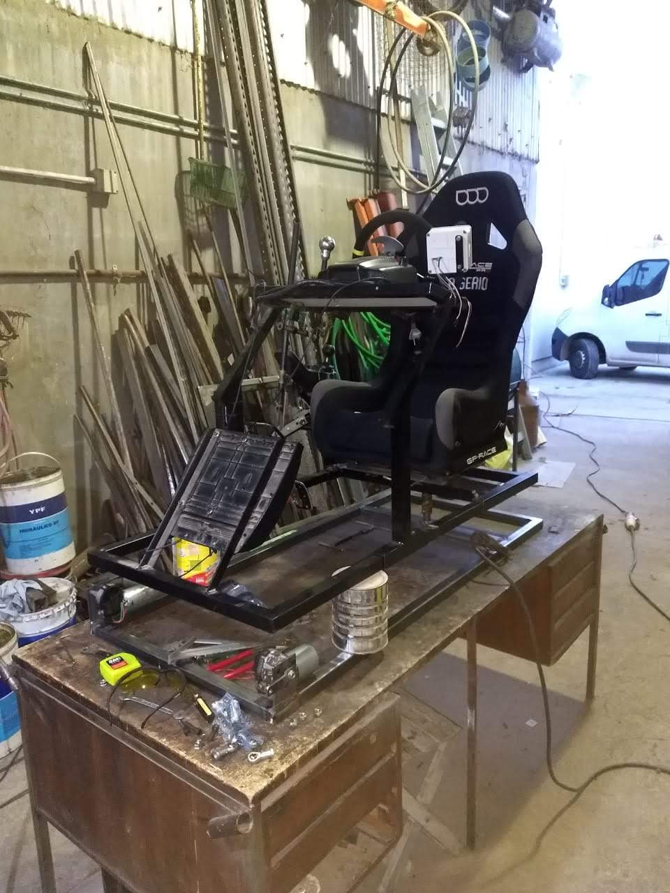

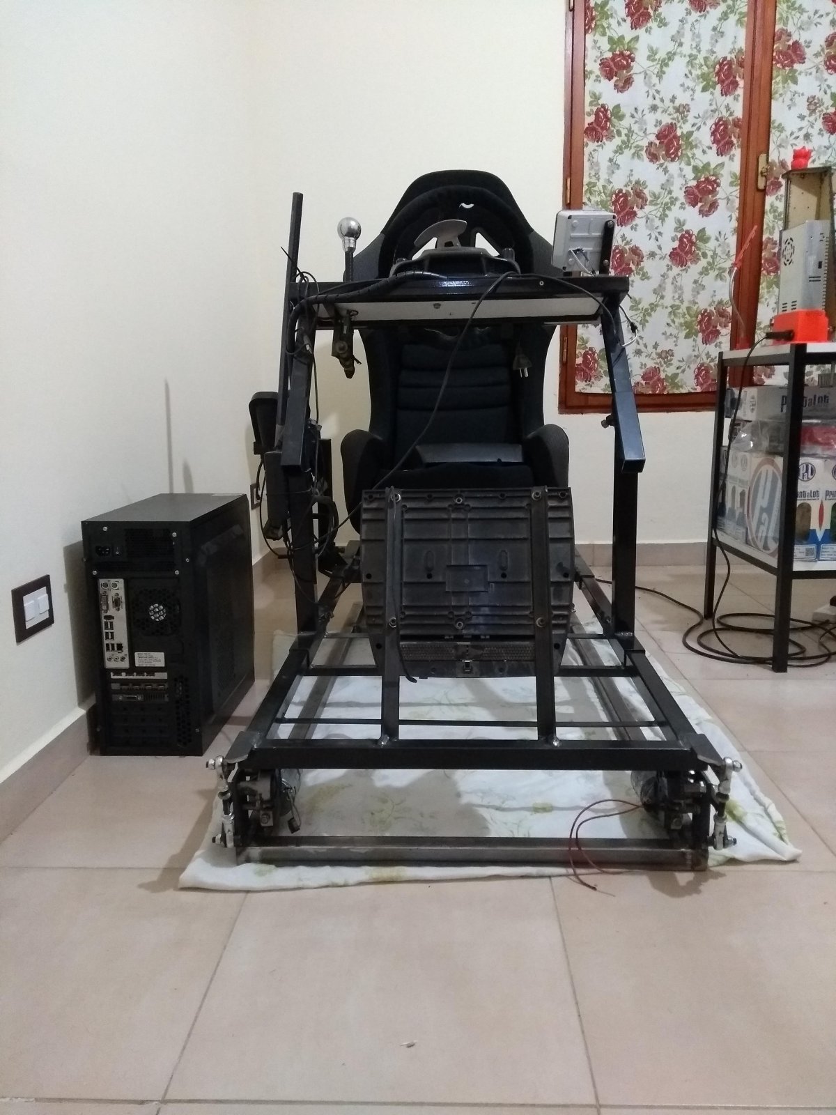

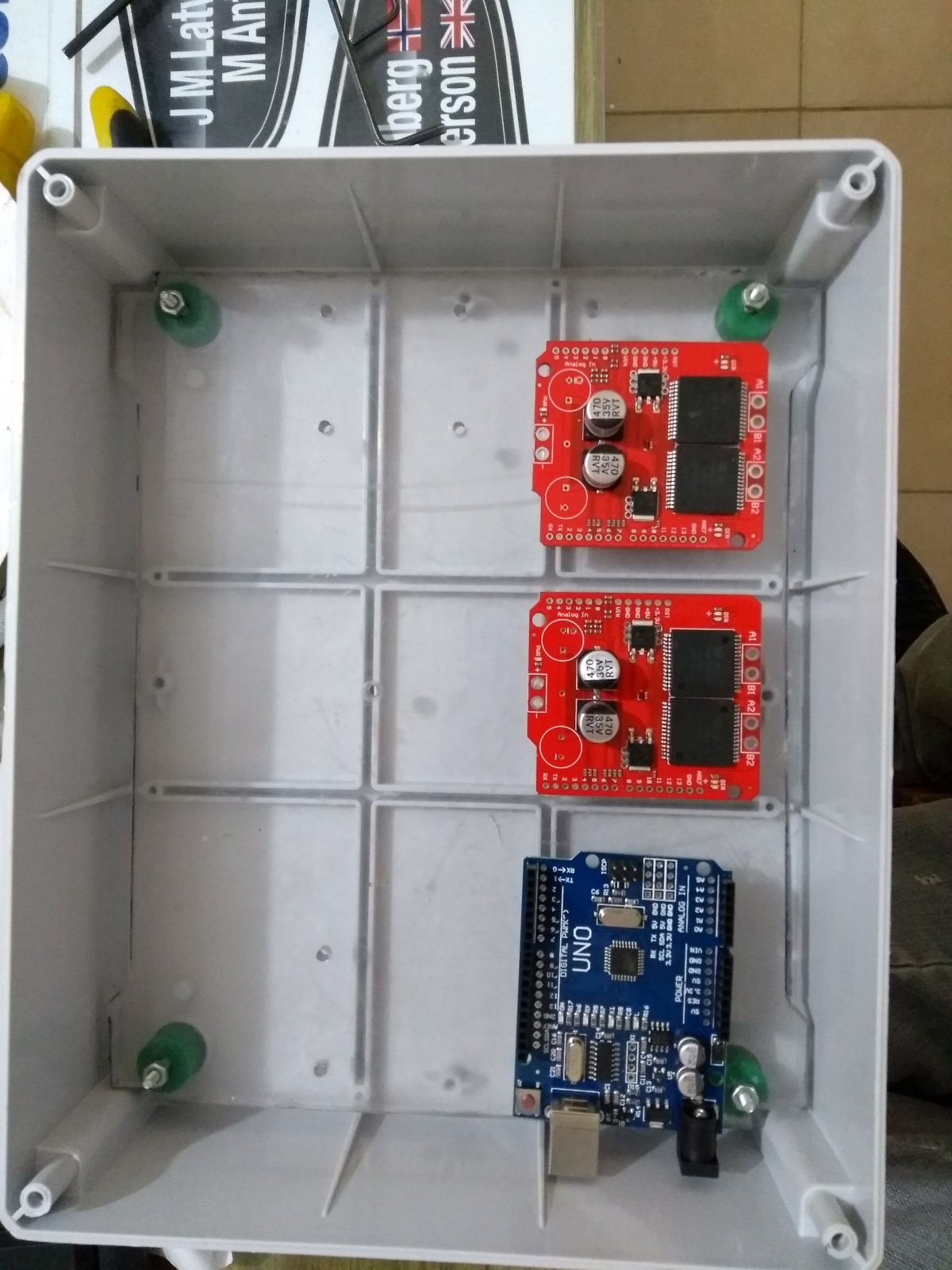

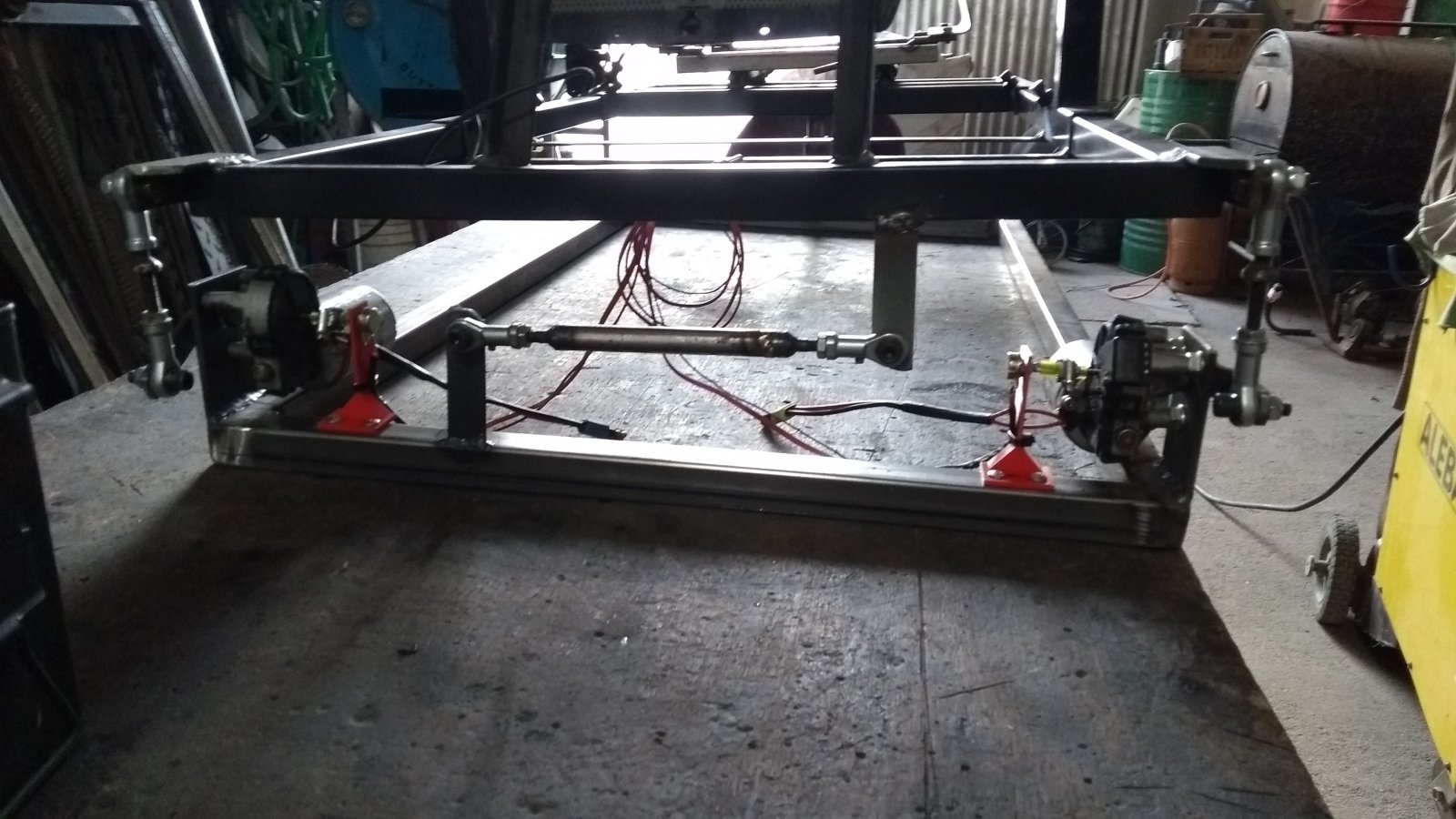

    I preface my simulator which a couple of years ago I have and choose to put movement, as some friends insisted me.
    The Simu has LogitechG27 Volante with a 330mm hoop, structure type Zalem, and now I add the movement.

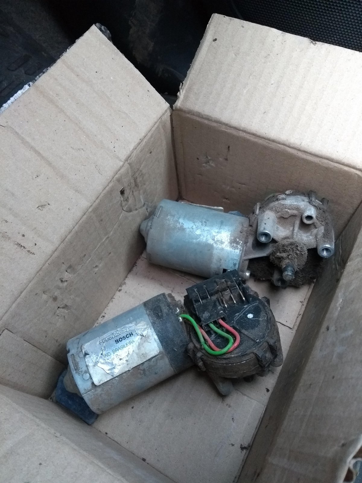

    Two windscreen wiper motors from VW Gol

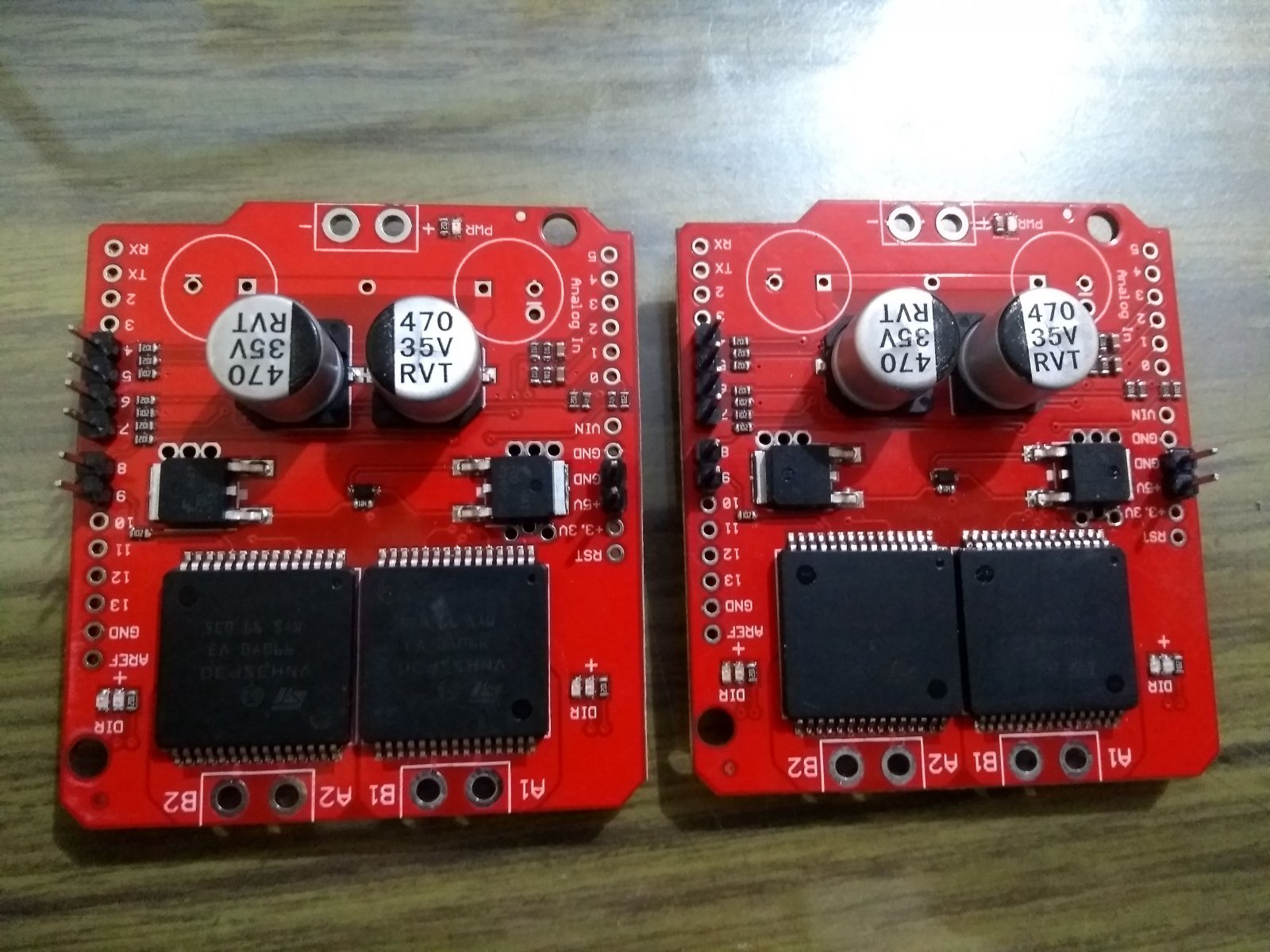

    the Arduino Uno R3 electronics and two Moto Monster Shield, I'm going to use one for each Mtor not to demand them as much and last a while longer.
    Attached some photos of the advances
    IMG_20190509_102830781.jpg IMG_20190513_122000663.jpg IMG_20190513_123035945.jpg IMG_20190513_194403382.jpg IMG_20190513_194509853.jpg IMG_20190523_022510276.jpg IMG_20190523_023616500.jpg IMG_20190526_163447838.jpg IMG_20190617_013441721.jpg IMG_20190620_224501852.jpg IMG_20190620_224514511.jpg IMG_20190621_003618739.jpg IMG_20190621_003657312.jpg IMG-20190620-WA0059.jpg

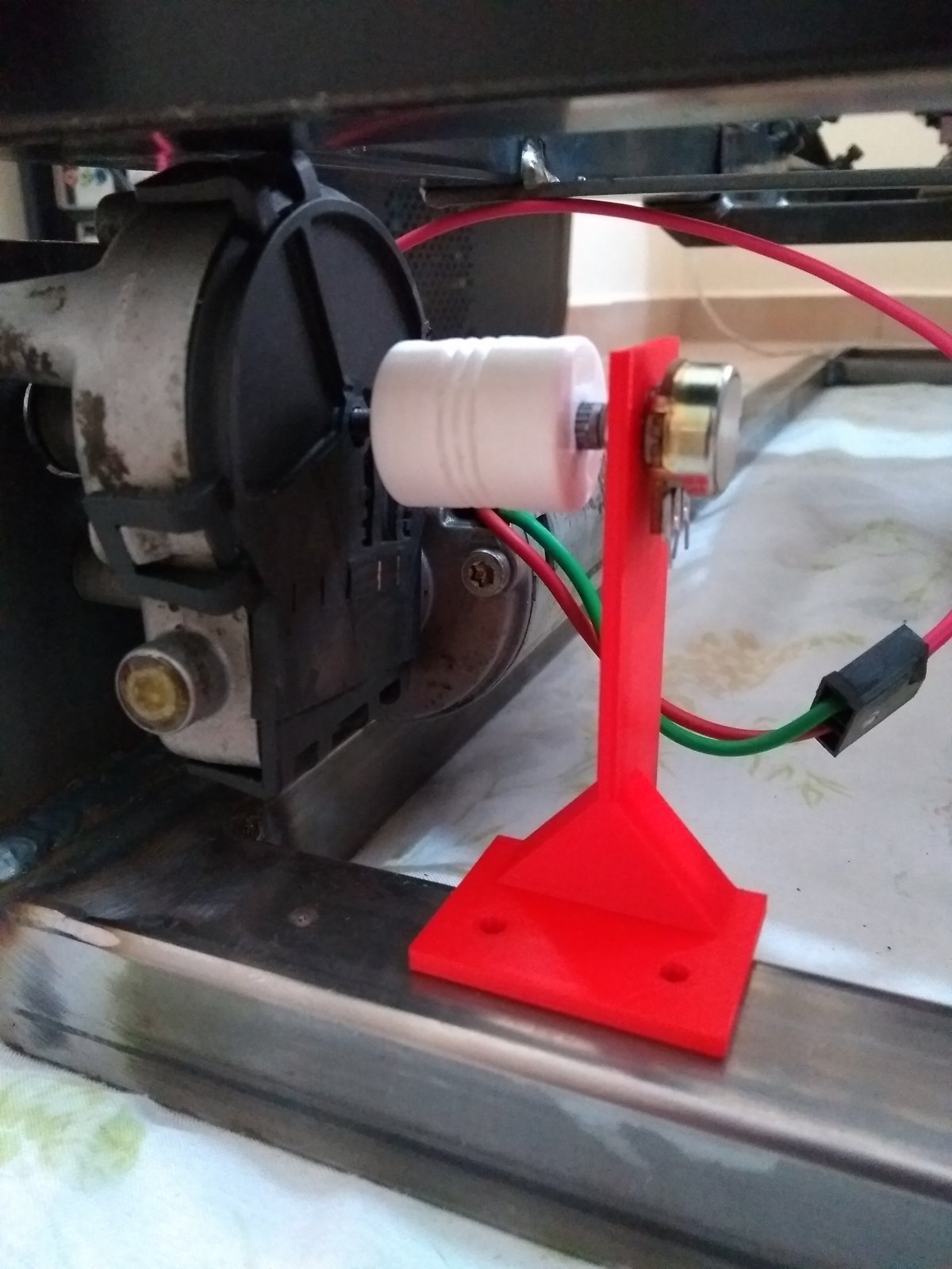

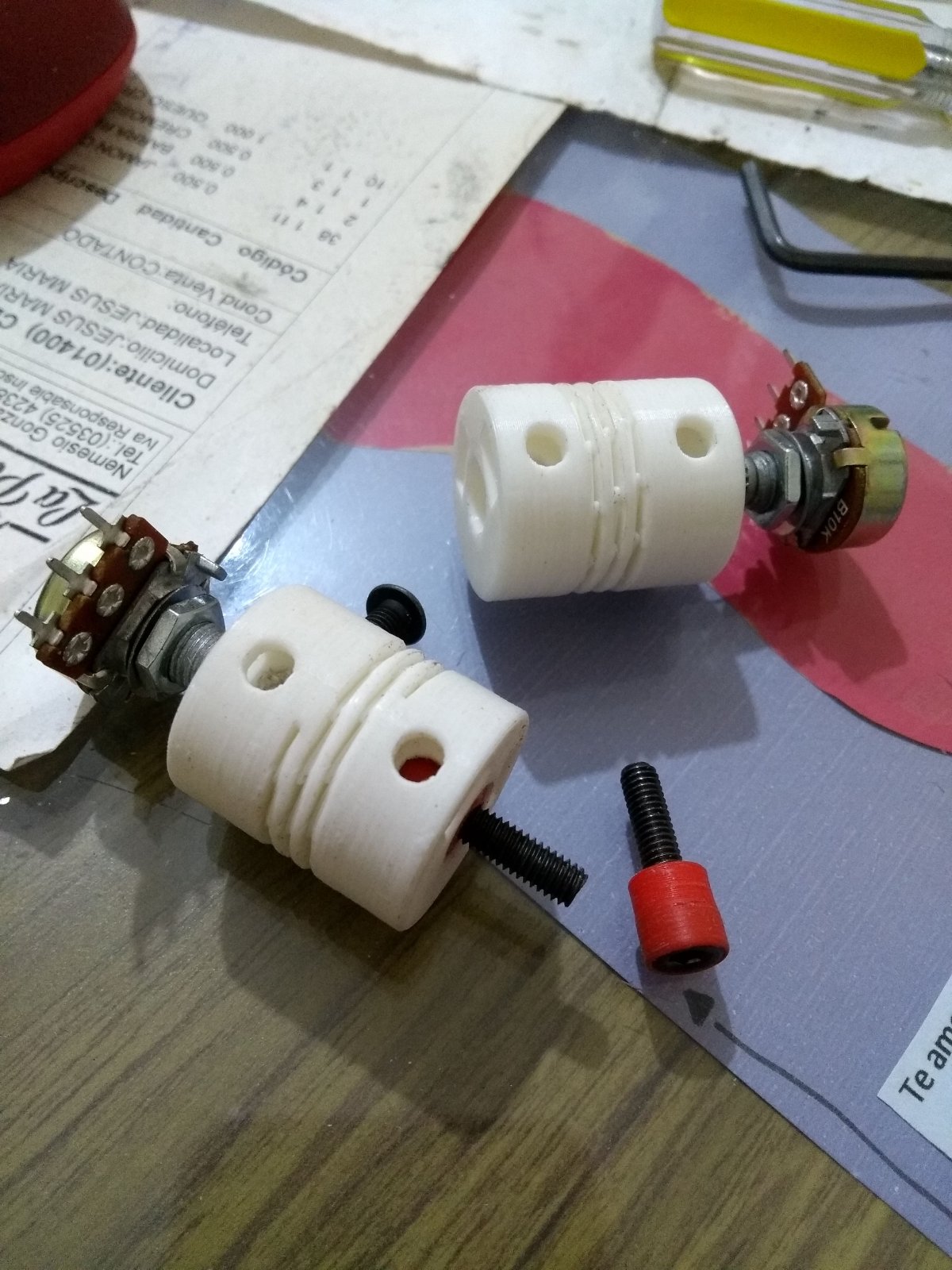

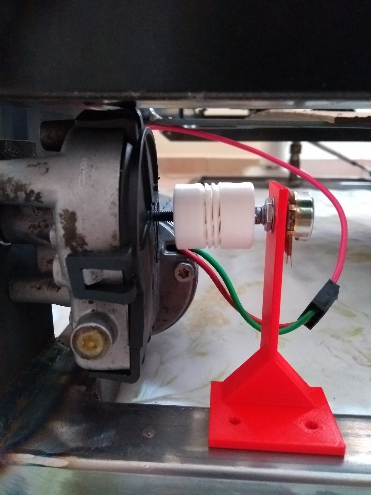

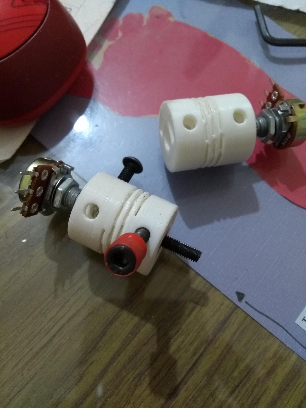

    some assembly advances for the potentiometer
    IMG_20190621_121352264.jpg IMG_20190621_121340687.jpg IMG_20190621_121323915.jpg IMG_20190621_121315199.jpg

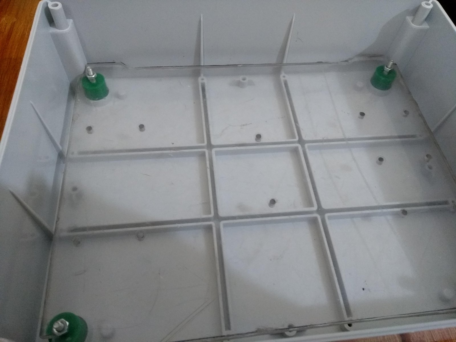

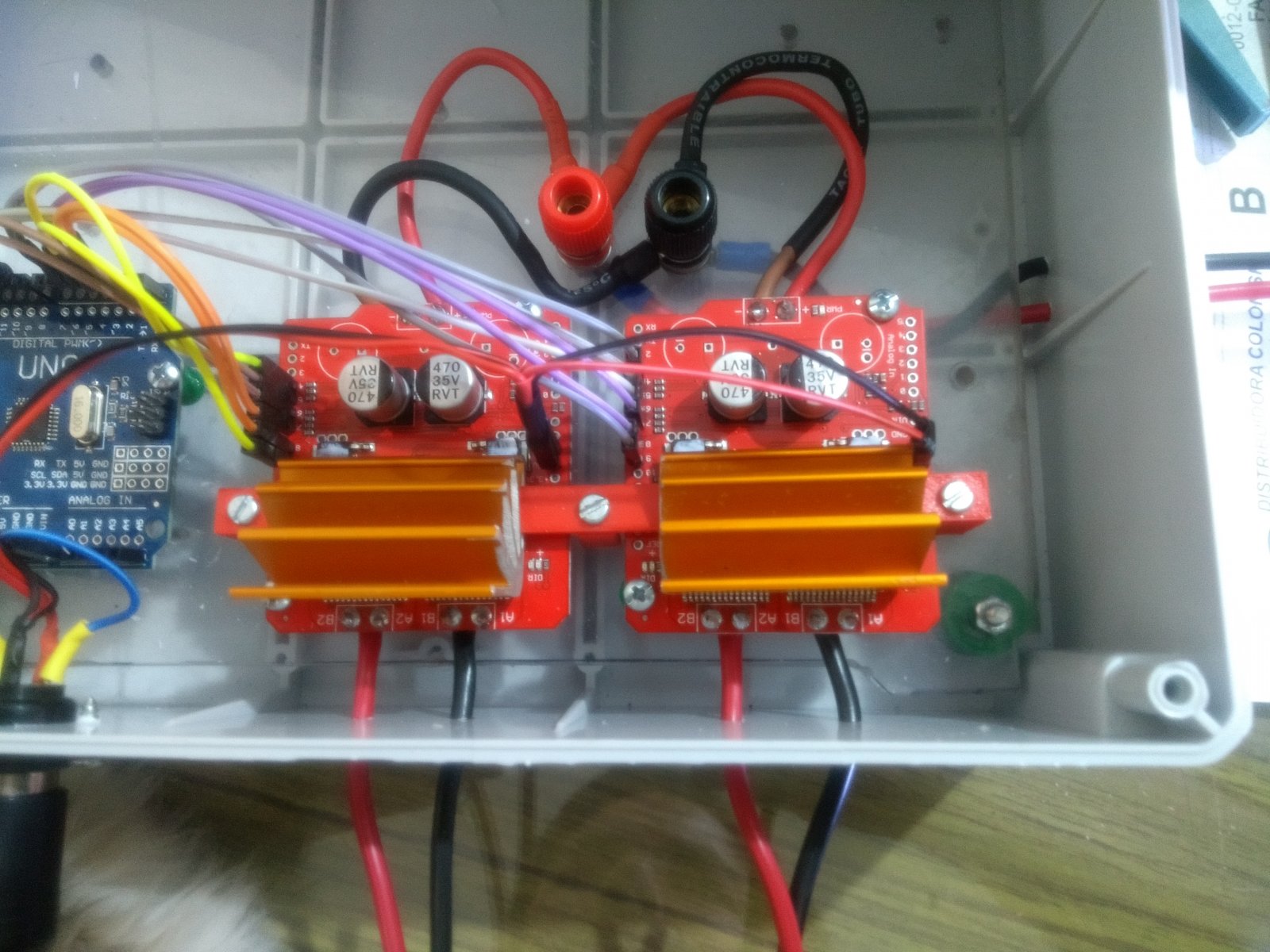

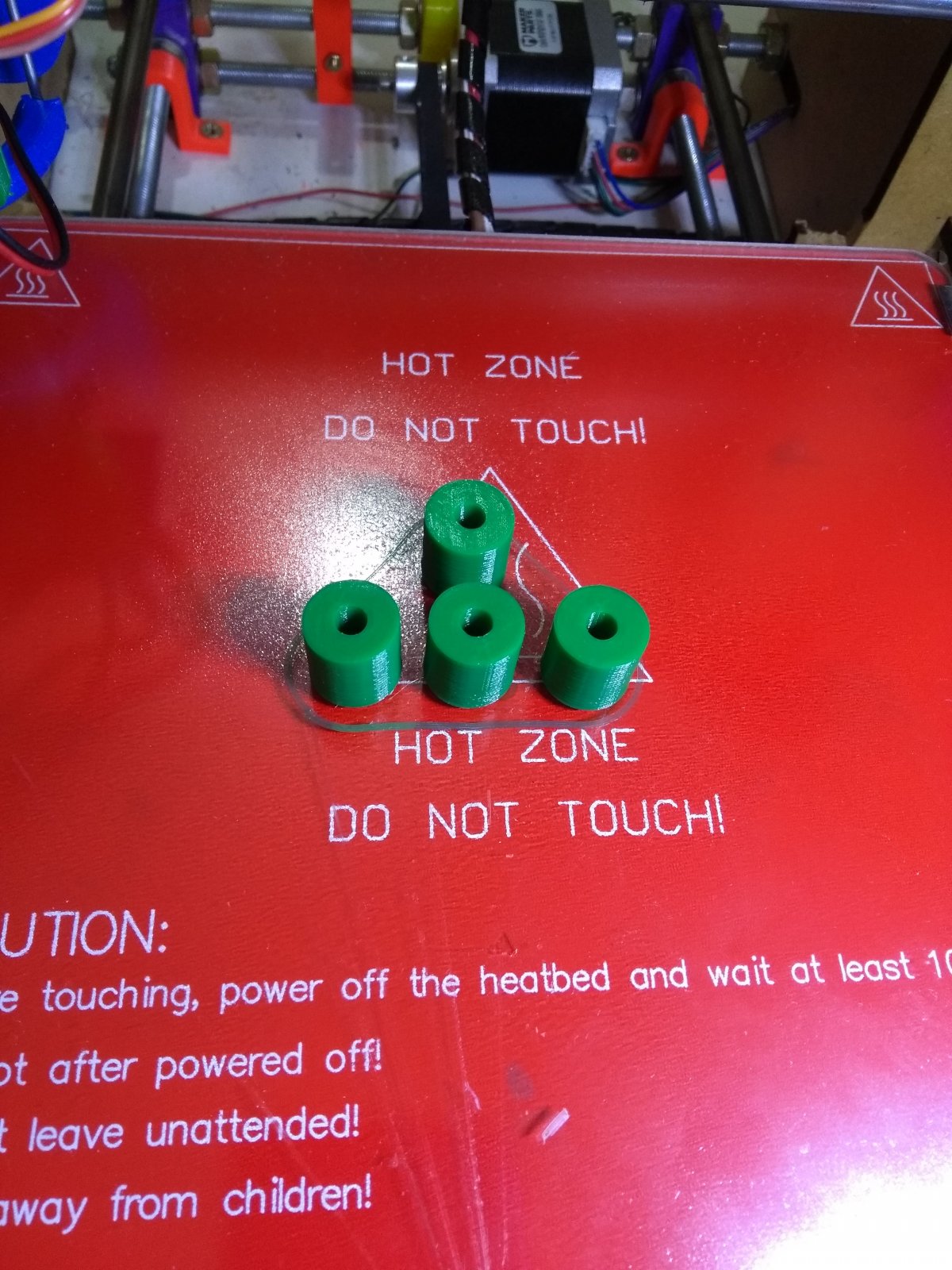

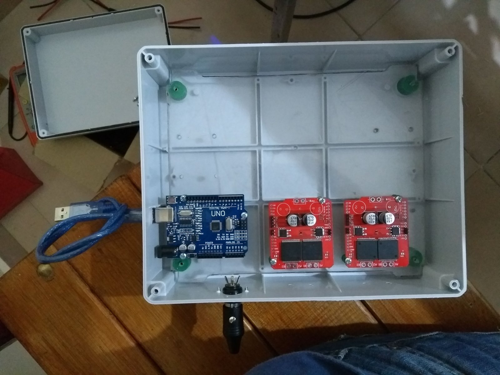

    here the support to fix the heatsinks to the Shield. retirement is night and to be able to have it in march

    I am doing some tests with SMC3Utils the following thing is happening to me, it makes the movement, but in moments it leaves it at the top. I leave a video

    3DOF, AC motor, Arduino
    Hello friend, have you tried to run SMC3utils in administrator mode ?, on the other hand check the lateral clearance, you should correct that part, observe how the structure is balanced for the sides

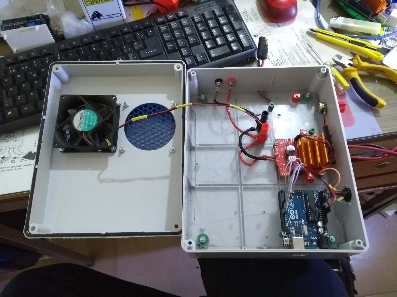

  8. Ivo Herrera
    Ivo Herrera New Member
    Jun 21, 2019
    7
    83Coins

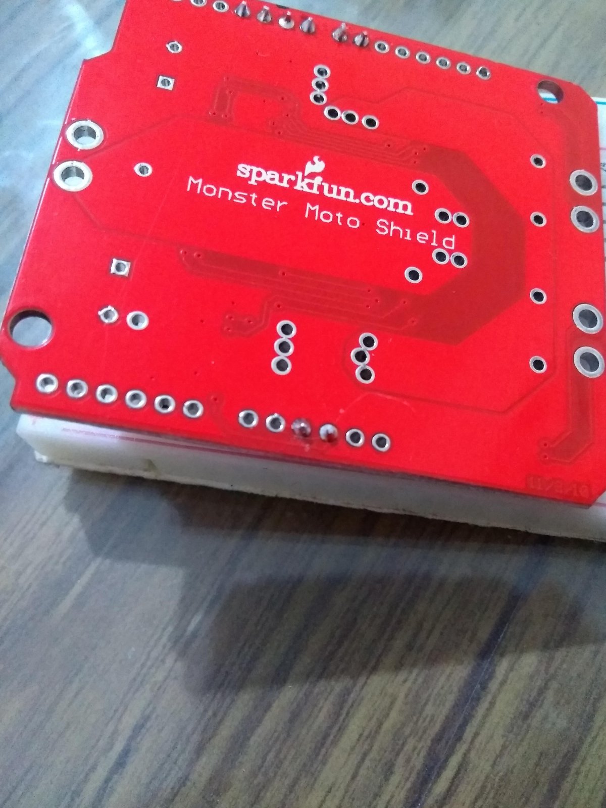

    good step to tell you. one of the MMS loved an exit so I did not have any mention to the engines. I am working with a single MMS using it for the two engines. I share an image and video of the elec

  9. Ivo Herrera
    Jun 21, 2019
    7
    83Coins
    Hi mate, if the SMC3Utils is running perfect.
    It was one of the MMS that was failed, it was loved in a short time because the test gave me very well when I control it. If the truth that I stay narrow with the width of the structure.
