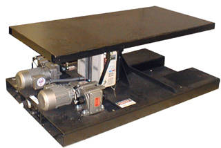

    Finally - This forum inspired me to make my dream project i.e. 2 DOF motion platform. I am hoping the platform will look something like this

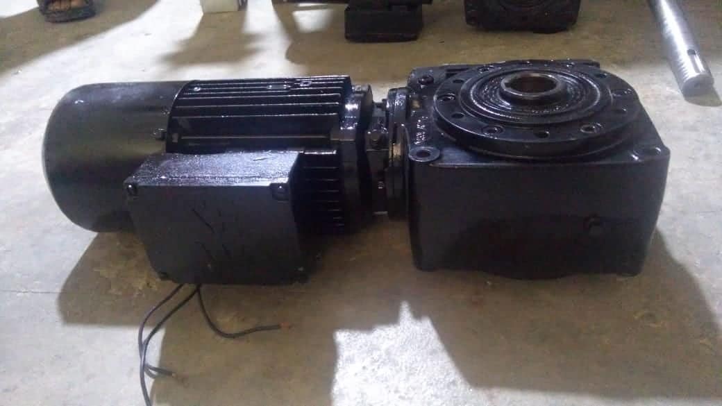

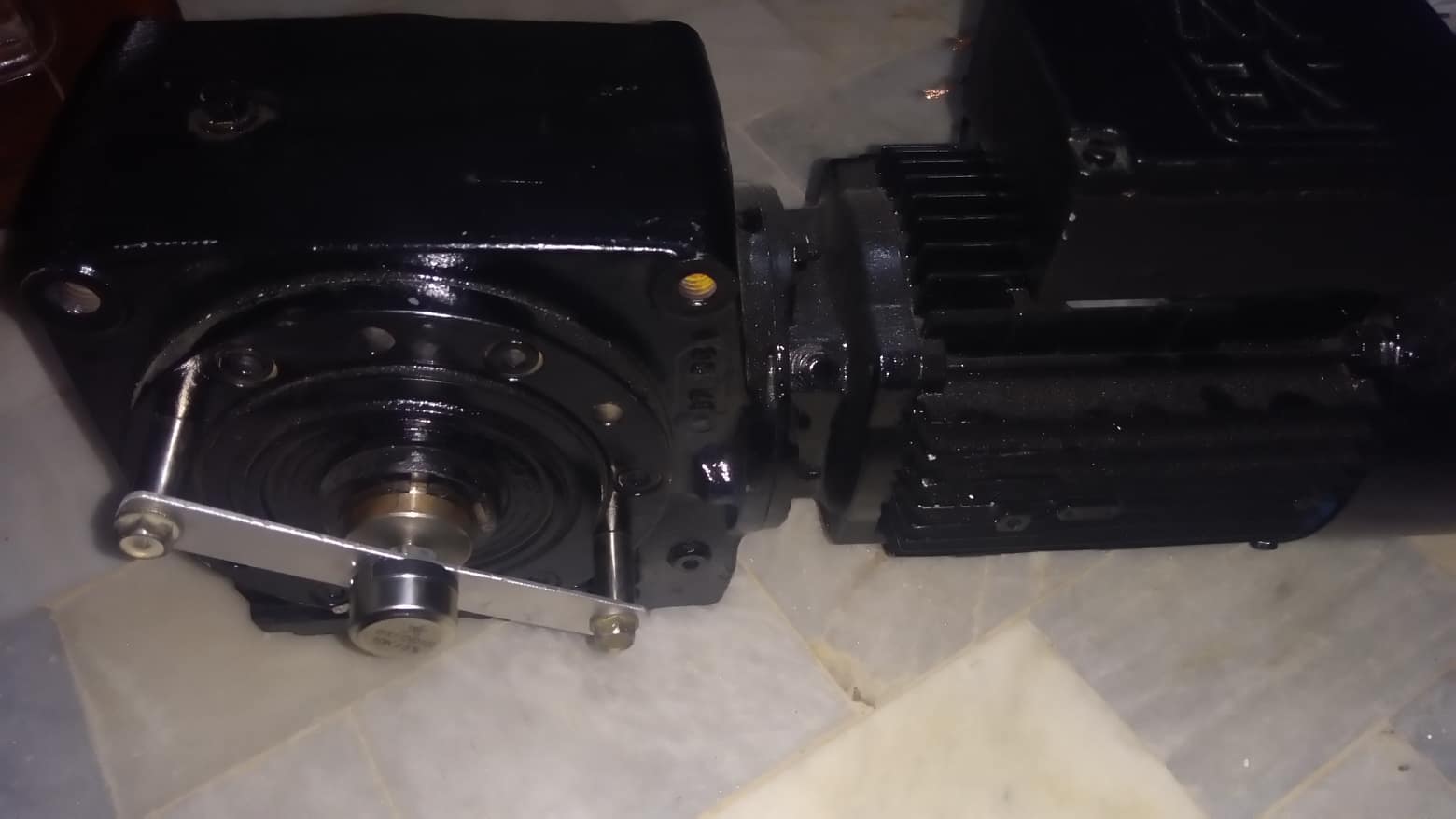

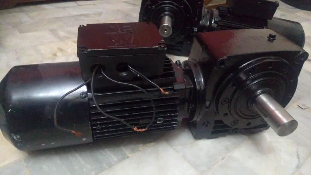

    I have started to gather the needed components. So far I have got following

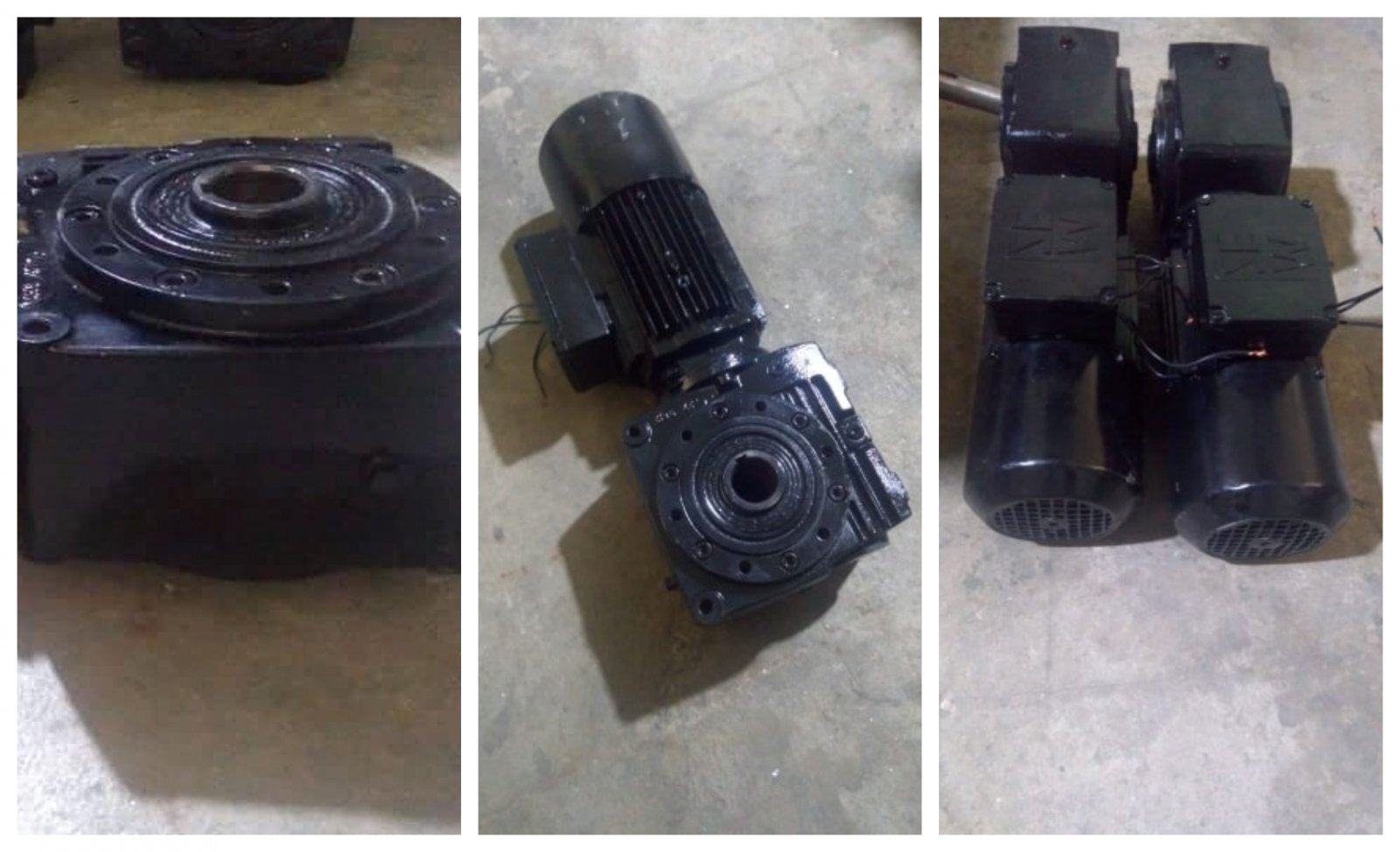

    1.5HP SEW Motors + GearBox. This combination gives 140 rpm without load
    I have also installed brakes on these motors. I am not sure if I will need them but since they are already installed, why not. The motors are three phase so I have wired them in Delta configuration.

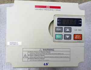

    Next, I have got 2 x LG iG5A VFDs. These VFDs are single phase to three phase.
    These VFDs support speed control using 4-20ma signal as well as 0-10V signal.

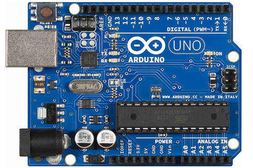

    For control, I will be using Arduino UNO.

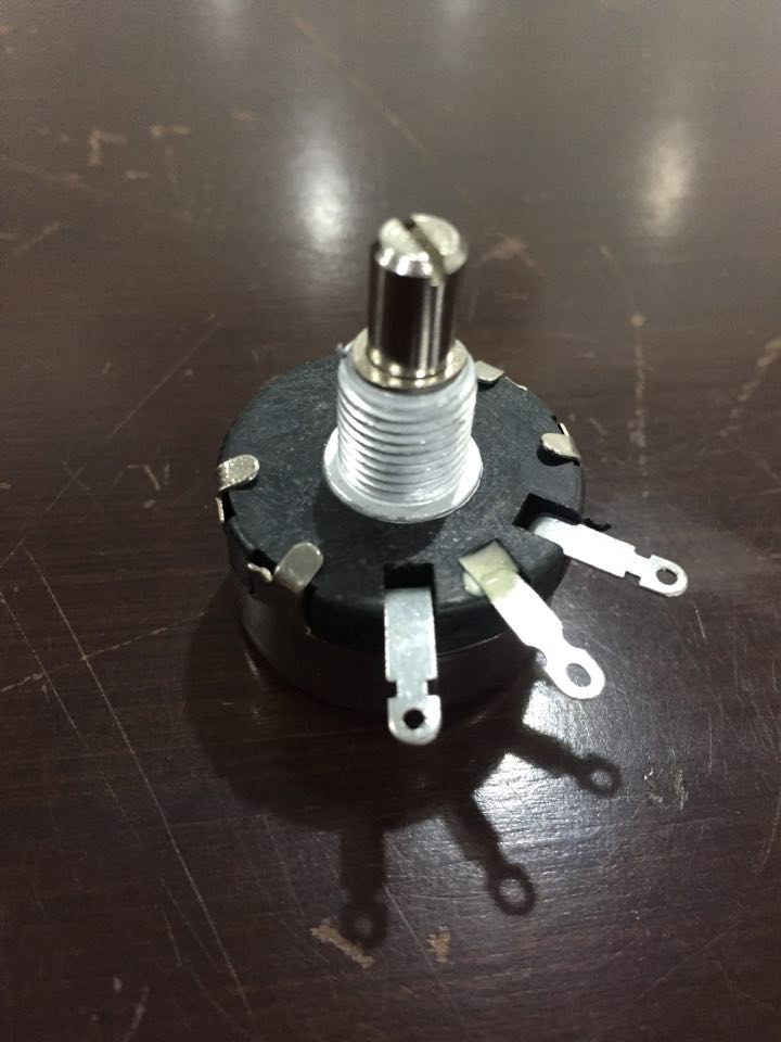

    Next, I will be making motor shafts and will add 10k ohm potionmeters to these.

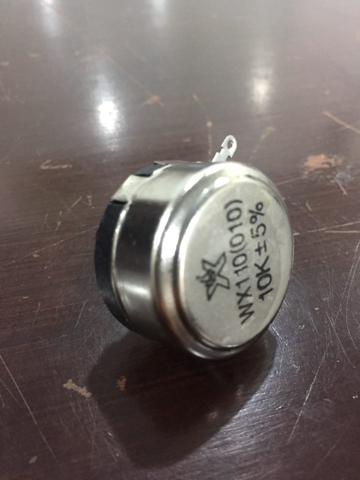

    A question and a small update on the project.
    QUESTION: I am reluctant to use a 10k Potentiometer due to its limited life. Would an OMRON incremental encode be a better choice? If I use an incremental encoder, homing the platform on startup will be an issue. Any code that is pre-written to cater for homing issue? I am planning to use RacingMat code for platform control.

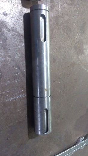

    UPDATE: Made 2x Steel shafts, 35mm dia. Will be making a bracket once pot/ encoder is finalised.

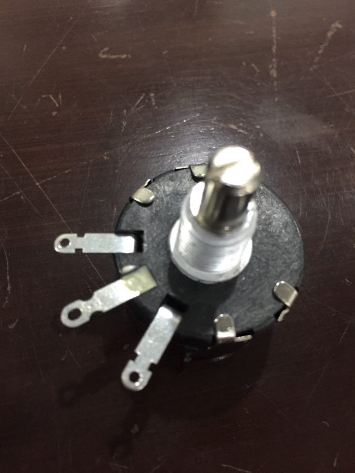

    New Update
    Bought 10k, single turn, Wire wound pots

    UPDATE: 35mm shafts installed in both motors

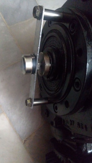

    Added Pots on Shaft of motors

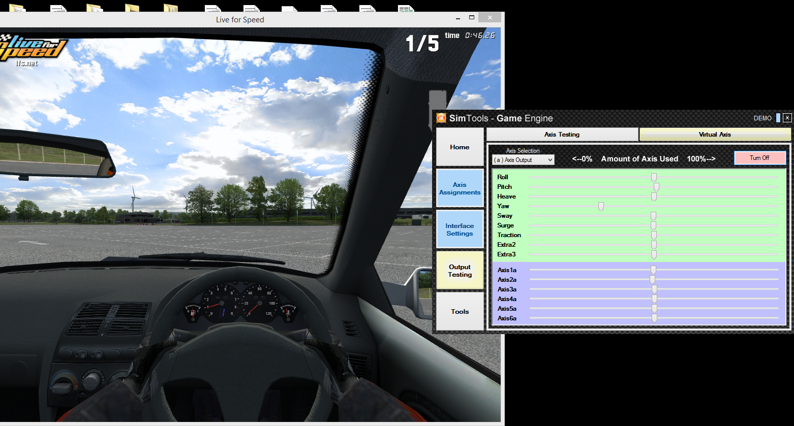

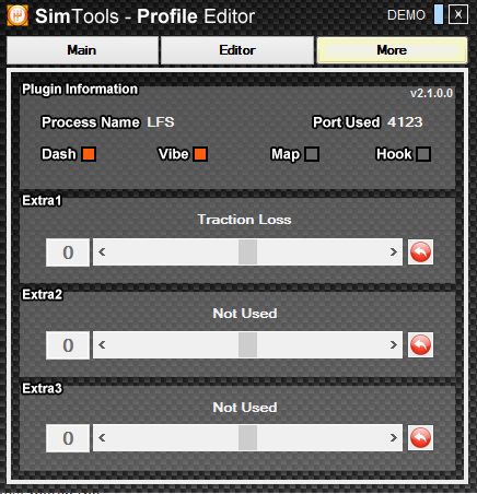

    A small issue I encountered which I was able to solve. Sharing here for benefit of others
    If I went into "Axis testing" and moved the slider, the motors moved. However, when I played LFS and opened "Virtual Axis", the sliders did not move as I played the game
    The problem is with LFS configuration. to correct this, you need to open cfg.txt (found in installation directory of LFS). Scroll to bottom of file and change following
    Conn To Master 1
    OutSim Mode 1
    OutSim Delay 1
    OutSim IP 127.0.0.1
    OutSim Port 4123
    OutSim ID 0
    Your port ID must match the Port Used ID identified in Game Profile Editor
    If everything is correct, once you play the game, the sliders should move as well.
    Hope this helps

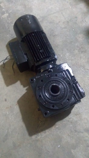

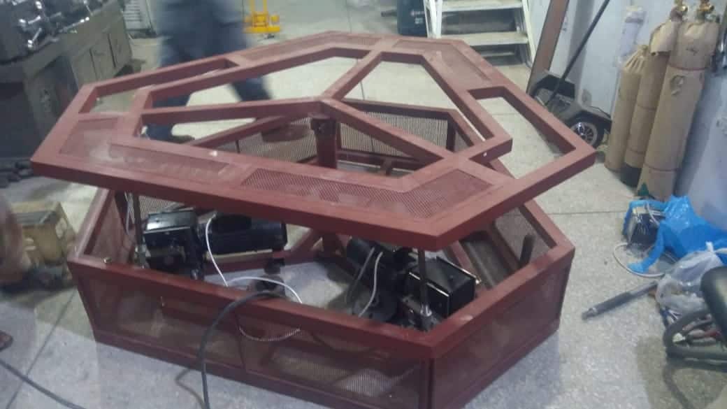

    Small Update:
    The SEW gearboxes didn't hold position under load. Hence I changed gear to classical worm type. Gearbox is 1:40.
    Secondly I have learnt that output RPM (gear shaft) between 35-50 is good. Any fast is too fast and any slow is slow. This, however, is linked with your platform geometry. Platform picture is attached
