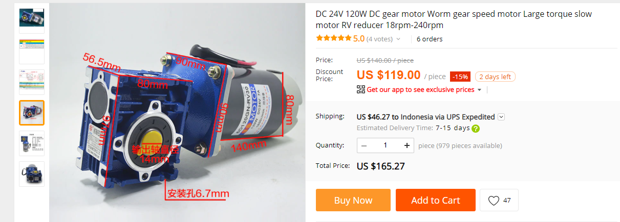

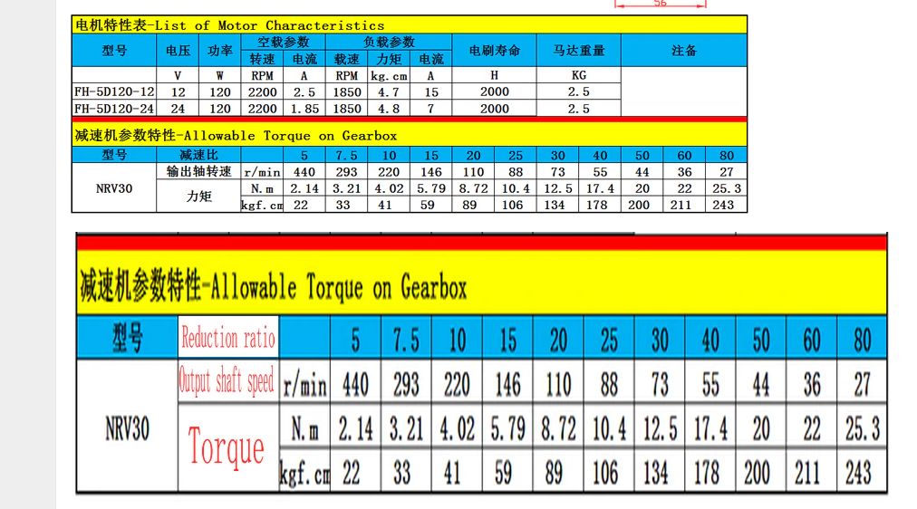

    it is a shoulder mounting type with a capacity of 150 kg

    I suggest you to look at simukit.com for DC motors 24v :thumbs

    Yes you are right, motiondynamics seems to be a better option :)
