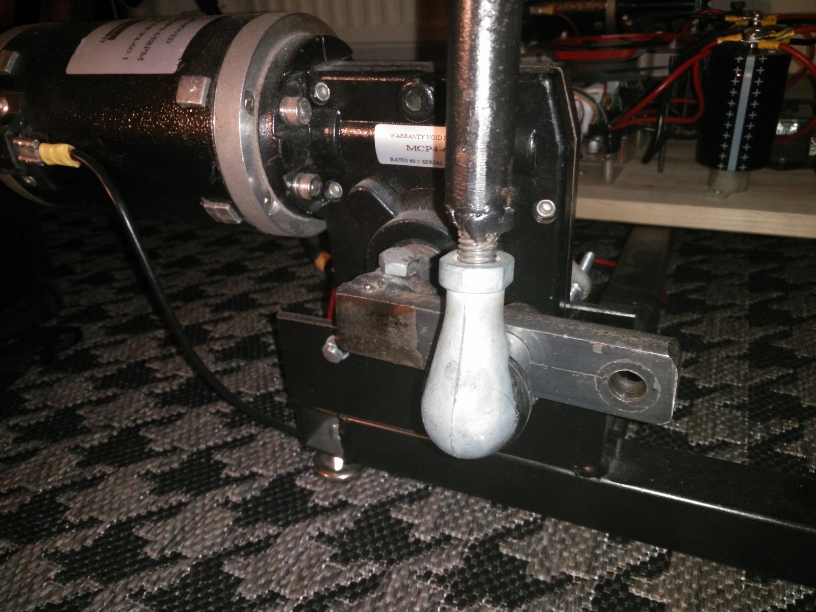

    Recorded a video of dirt rally today. My webcam does not like dim rooms so the video is a bit blurry.
    I also moved the rods one step closer for the first time. Now the CTC is 4.5cm and the movement is a bit snappier. I think it's better this way. Now I'm wondering why I did not do this earlier..

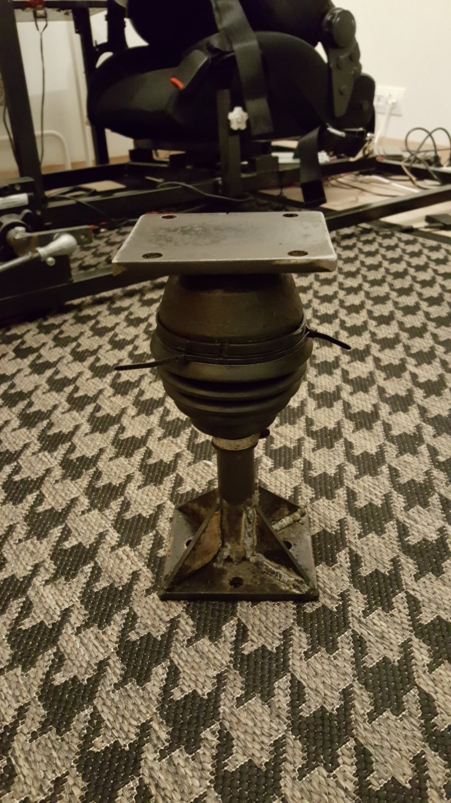

    I made a little upgrade to the sim. The old universal joint from a steering wheel column got upgraded to a universal joint from a cardan.
    The movements seem much more refined now that the swinging of the simulator is reduced a lot.
