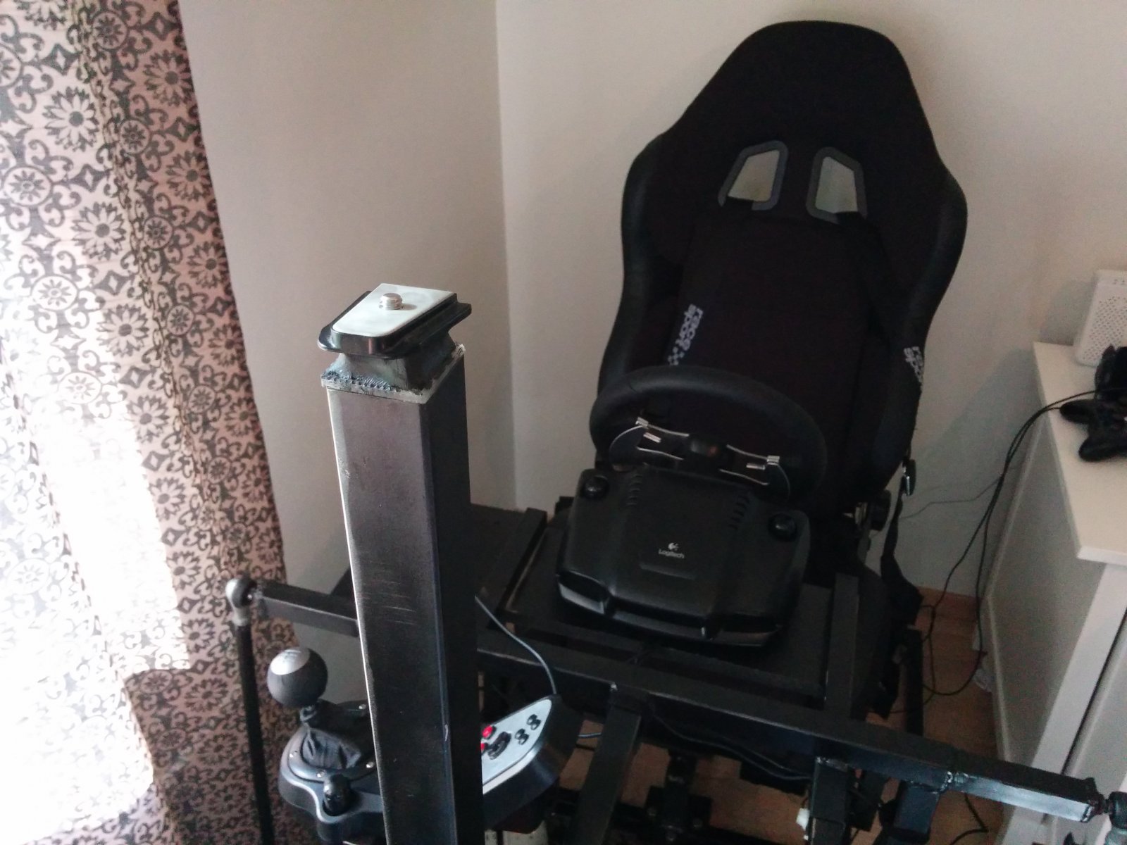

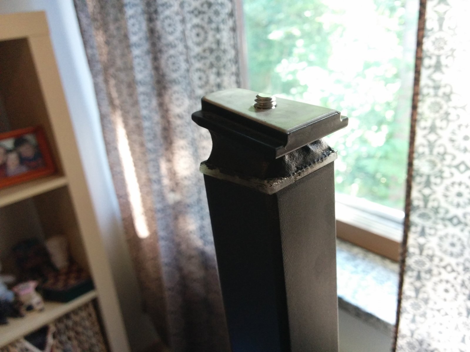

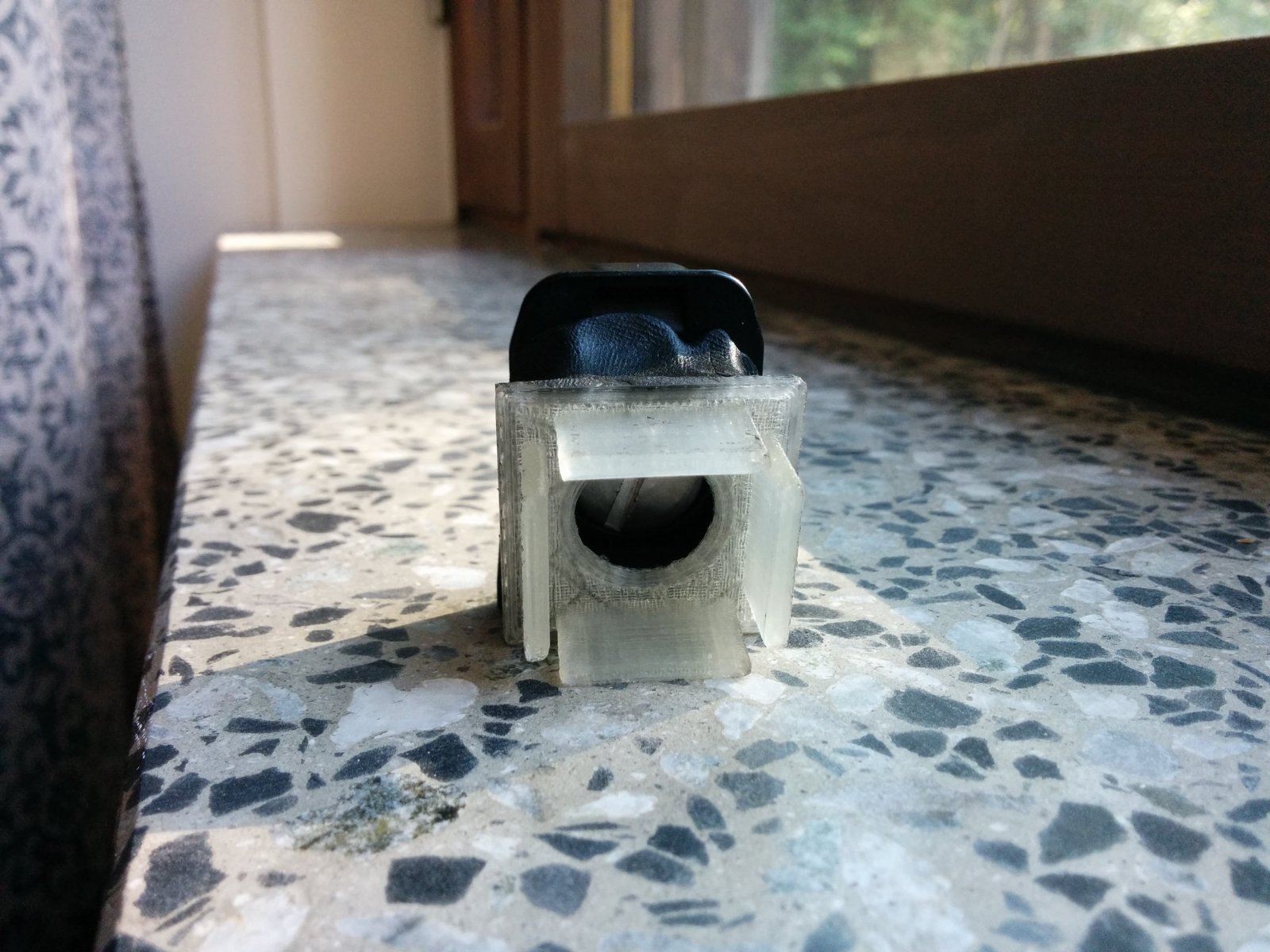

    Today I got couple cheap chinese H-bridges that I ordered some time ago, so I got the SIM moving finally. The problem is still that they're not really that powerful and the movement of the sim is pretty lazy at the moment. That will hopefully change later this week when I get the moto monsters.

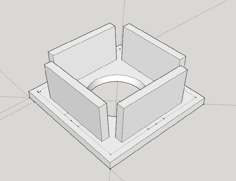

    I also made a mount for the rifts tracking camera.

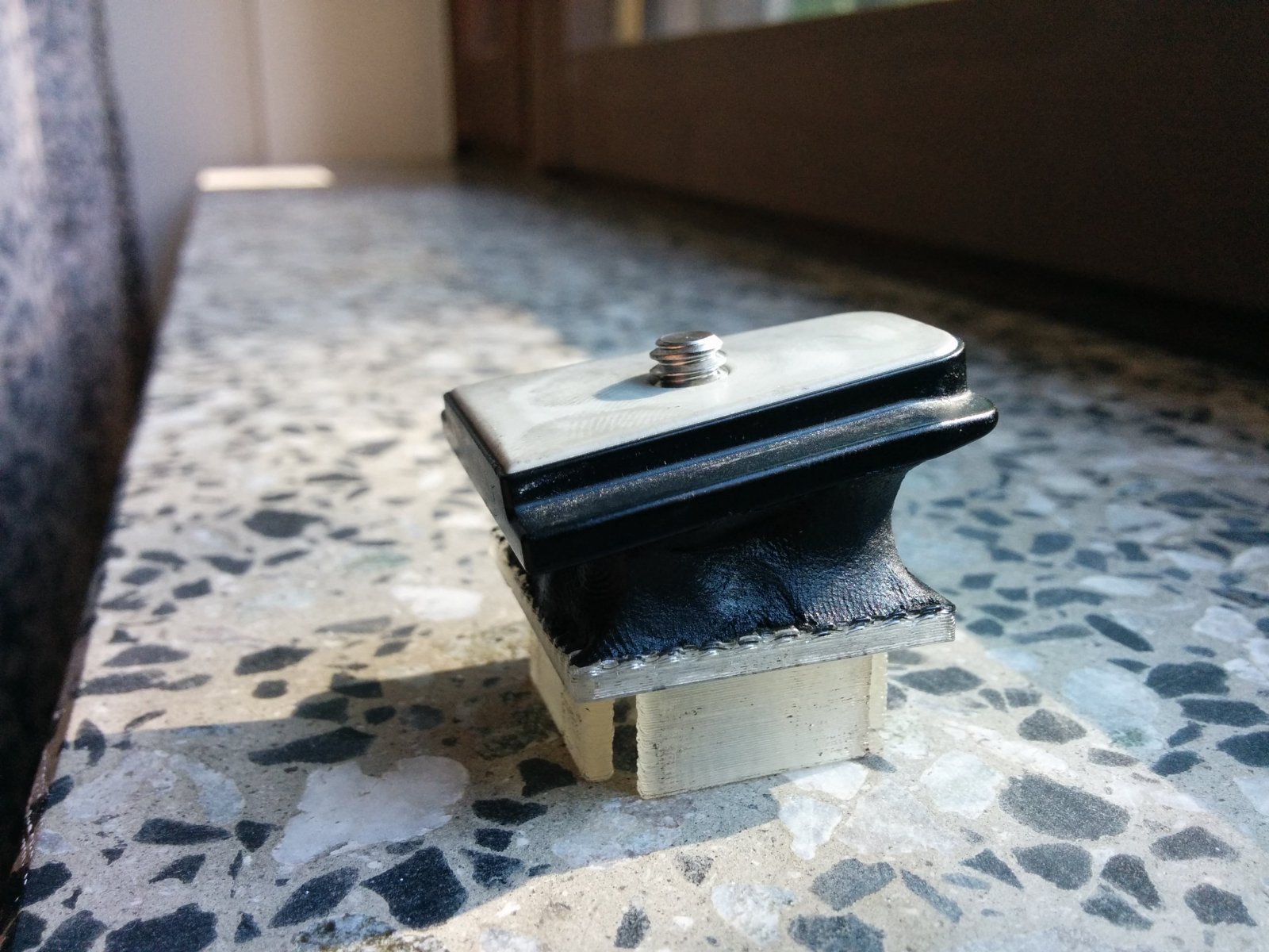

    I drew and 3d printed this part that fits on the hole of the 30mm square metal rod that the sim is made of:
    I then used Sugru to attach a GorillaPods camera mount screw thingy on top of that. The reason behind using sugru to attach the camera mount to the bottom half was that I've heard the vibrations that the motion sim produces does not work so well with the rifts tracking camera. As the sugru is rubbery substance I hope it will isolate the camera from the SIMs vibrations. I don't know if this is going to work or not but I'll see that in couple of days when the Sugru is hardened and I can give it a test.

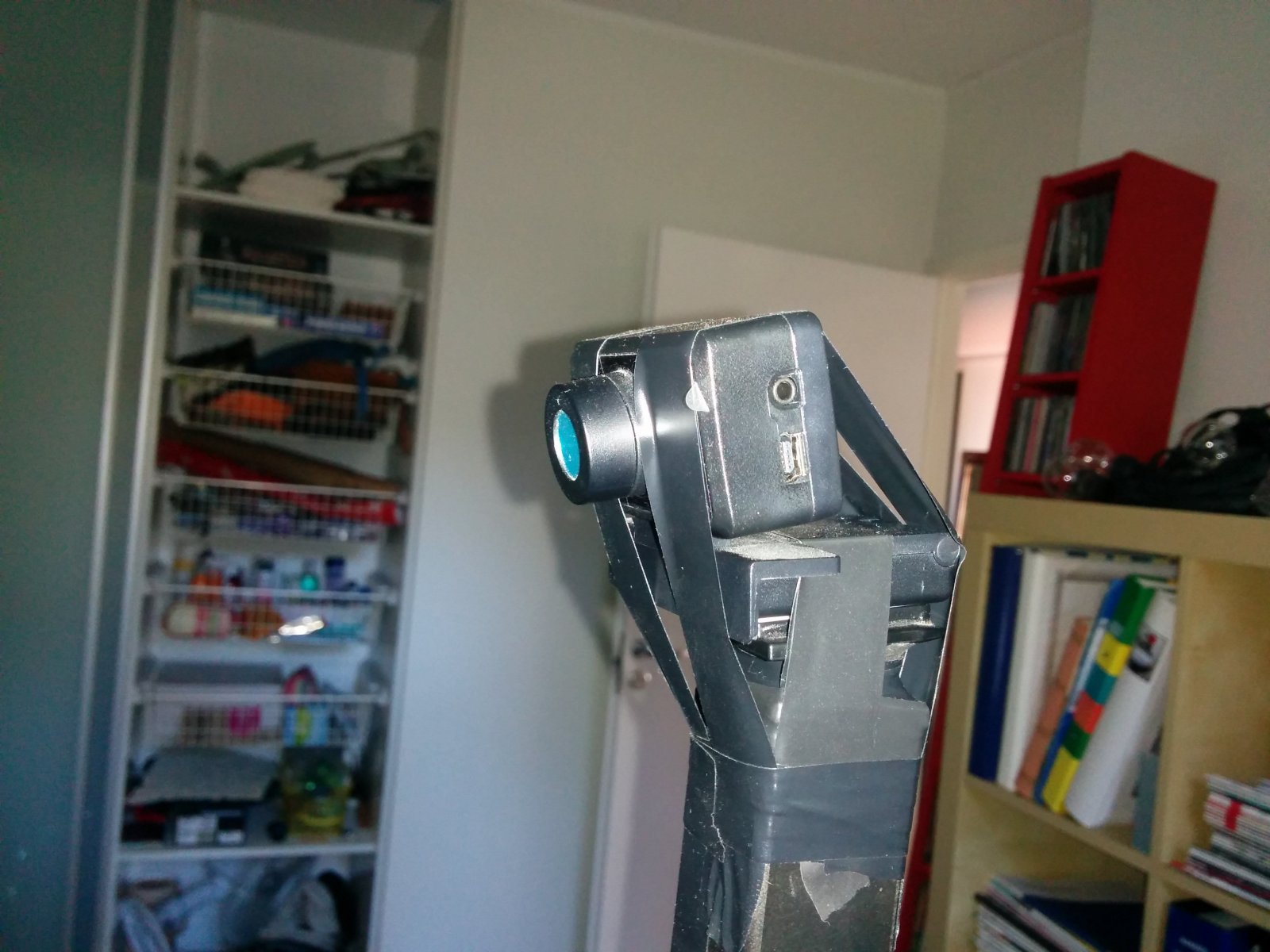

    You've tried a lot of different things to keep the camera still! Let me know how the rubber shock absorbers go. We can only hope that Oculus/Vive comes up with motion cancellation. But I doubt it's not on the top list of their to-do lists.
    My mount did not work so well after the first tests. I was jumping all around the cockpit in Elite even from little movements. Then I tried adding some electricians tape to keep the cameras swivel arm from moving. That helped a lot. Now it works pretty well. Even Asetto Corsa seems to be working but that might change after I get the motion profile set up correctly and the more powerful MMs.
    I've been thinking about using active stabilization system to keep the shaking to mimimal, but that's only on idea level at the moment. For example there's a spoon for helping Parkinsons disease people to eat called liftware spoon. Only problem is that it costs 300$, just a tad too much for a testing purposes :D And there might be a problem with it correcting too much of the movement, not just the vibrations.

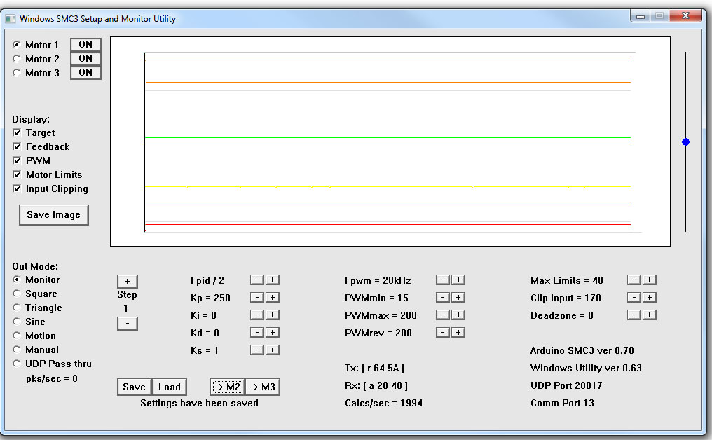

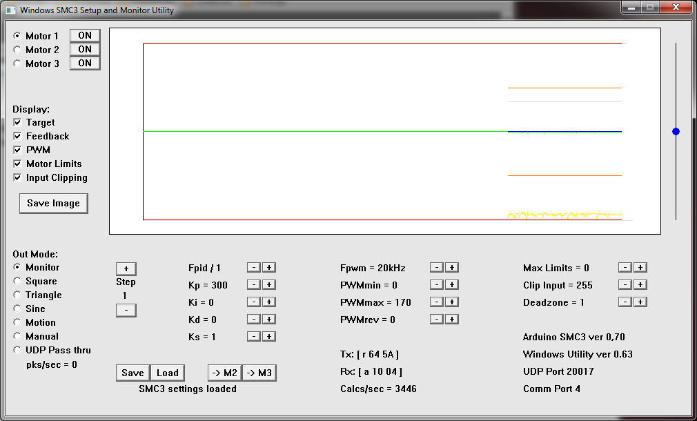

  16. tombo
    tombo Active Member
    Oct 5, 2013
    283
    1,969Coins
    +249 / 2 / -0
    DC motor, Arduino
    Nice to hear you got it working.
    What are your settings in SMC?
    I use this settings. It's never blown a 20 A fuse.
    Did you only use a Heatsink or with an active cooler?
  17. Ville Pesonen
    Ville Pesonen Active Member
    Jan 13, 2015
    136
    869Coins
    +200 / 0 / -0
    Thank you for your settings!
    I have heatsinks and a 140mm fan blowing on them.
    I found out that with these settings they're staying on. I probably should increase the PWMRev value to make the motors break also.
    I'll continue to tune them tomorrow as it's getting late tonight.

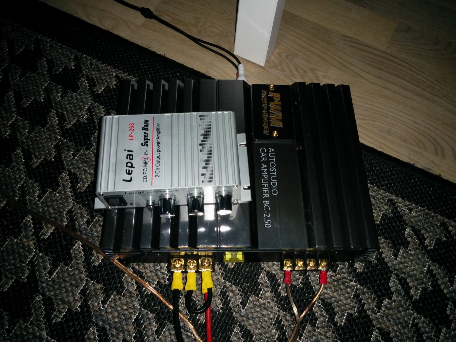

    Today I upgraded my cheap and small Lepai amplifier that drives the bass shaker to more beefy amp. The new one also has low pass filter built in so no more high frequencies from the bass shaker.
    For someone interested here's how I taped the rifts tracking camera to reduce the effects from vibrations. It works pretty well. Although I have not tested it in any rally games, only Asetto Corsa.

  20. Ville Pesonen
    Jan 13, 2015
    136
    869Coins
    +200 / 0 / -0
    That's something I could try in the future if/when I get a rally game that moves the sim really hard. I'm pretty sure my current tracking camera mount does not work in that situation.
    At the moment I'm pretty pleased to the tracking camera mount as it seems to work in Asetto Corsa pretty well. although that might change when I get the profile to really move the sim.
