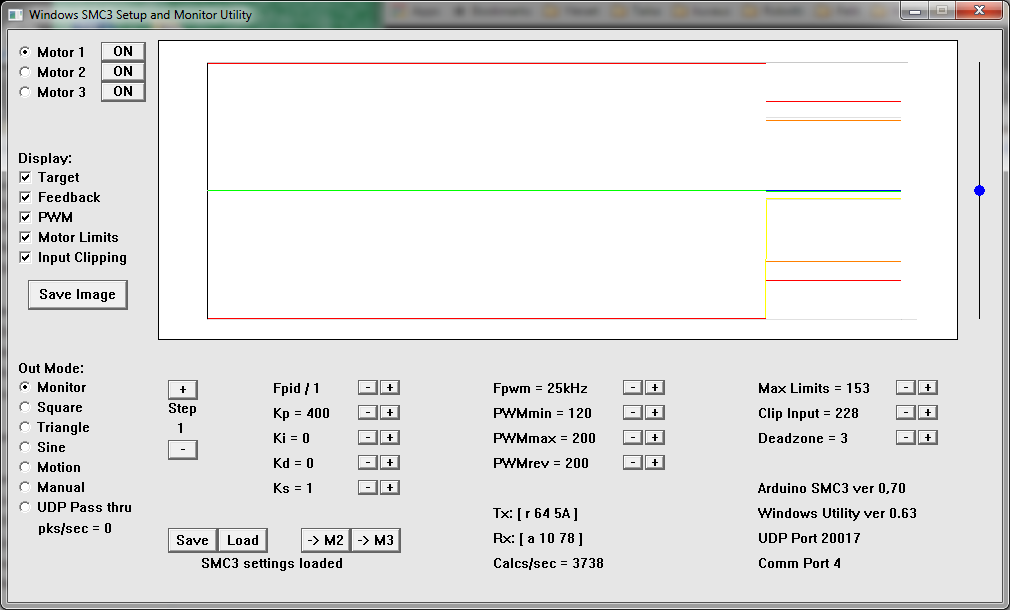

    I'm having a problem with the sim. There's a little slack on the gearbox:
    When I get on the sim and it becomes balanced, it starts to oscillate.
    The motors were like this when I got them, atleast I think they were. I'm guessing that there should not be any slack in the gears?
    I set the Deadzone to 2 in SMC3 and the oscillation stopped while only SMC3 is connected to the sim. But when I tried Asetto Corsa the oscillation was back.
    Is there any way to fix this or do I have to go gear shopping?

    @Ville Pesonen what values do you have in SMC3 utils ? can you post some screenshot with yours settings.

    Here's my settings:
    Only way I could get the oscillation to stop was by increasing the deadzone value to 3.

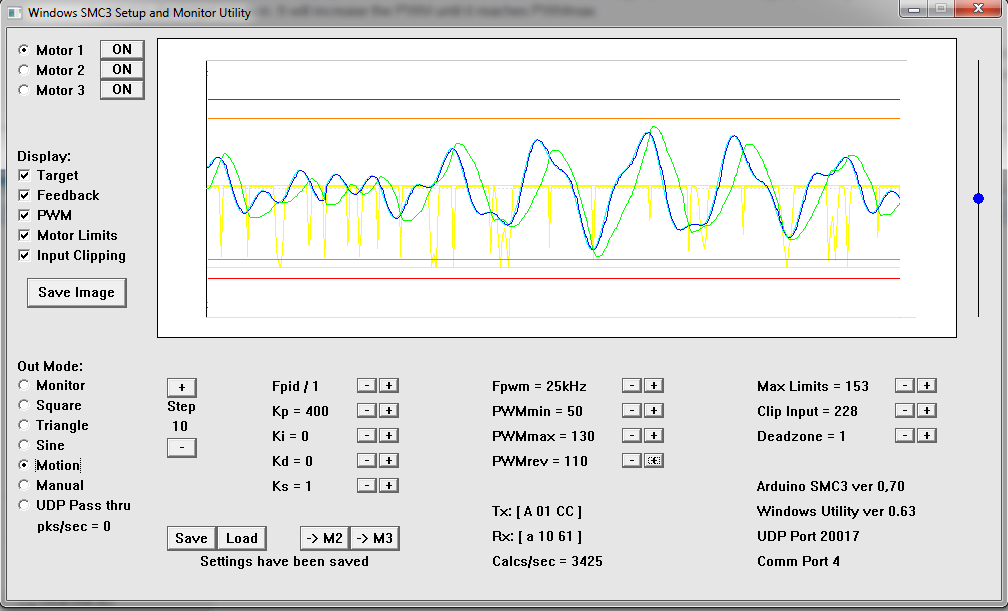

    I lowered the PWMmin to 50 and it got rid of the oscillation!

    thats what i did too at my sim, lowered PWMmin, as i had the same trouble. good you got it working

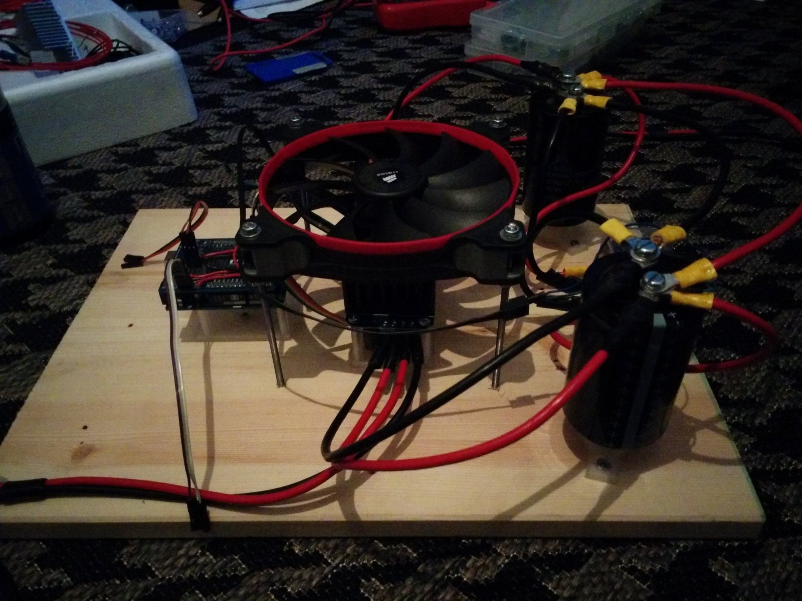

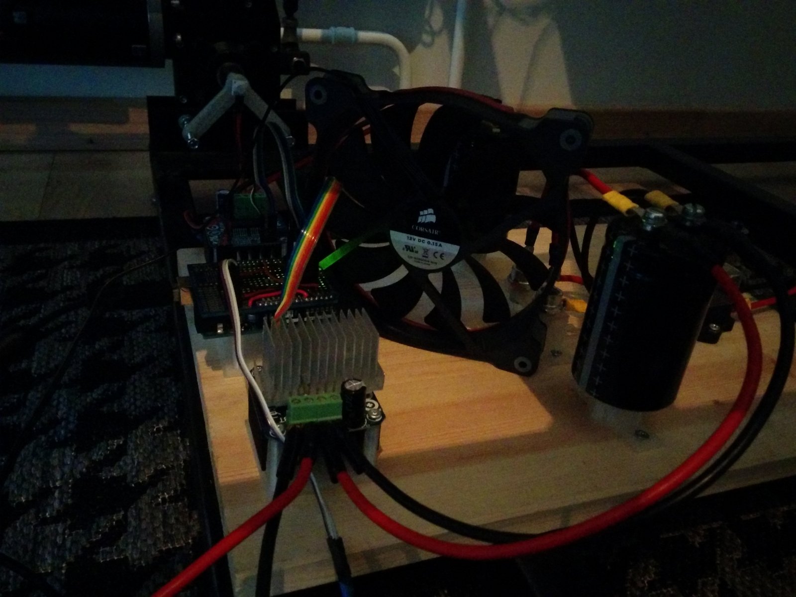

    The H-bridges already had coolers on them but I added another one just to be sure. Now it's sandwiched between two coolers. The original was under the board and I added the new one directly on top of the two half bridges. I also added a fan to keep it from heating. The sim still stops. The problem seems like it is not related to heating of the H-bridges
    I can keep the sim moving as long as I keep the PWM-Max under 130 in the SMC3 but that makes it a "bit" sluggish.
    when I have the PWM-Max value higher the sim moves for a while and then stops (around 30 seconds).
    I tried several different things to troubleshoot this but none has worked so far.
    I have the power supply plus connected to a diode to stop the "backlash" voltage from reaching the power supply and shutting it down. After that I have a capacitor connected to provide the high current peaks and last the Chinese H-bridge.
    diode
    + ------>----|-----------------| H
    CAP | BRIDGE
    1. I tried adding another psu to provide current
    2. I removed the capacitor
    3 I removed the diode
    4 Added the capacitor without the diode
    nothing helped. The sim still stops after a while, thinks about the world problems, and then continues its work. If I turn off the PSUs and then back on, the sim starts to move.
    I measured the voltage on the H-Bridge while it was not moving and it showed 12 volts, so it is getting electricity. Also the fan that is connected to the PSUs does not stop moving. I have no idea what is causing this. Does anybody have any ideas what I could try to do to get the sim moving?

    Sorry it was my error probably not talking about the correct motor driver. You could reduce the Kp value down to 250 while raising the PWMmax, but the limit is the motor driver which has to operate under a certain load and is seems it is not able to handle such a high demand of current. One year ago I tested two Chinese bridges and both were failing after a short while.

    I tried lowering the Kp to 250 and upped the PWMmax little bit. Now it seems to stay on without problem. Thank you!
    I redid the electronics and added a 140mm fan to keep things cool.

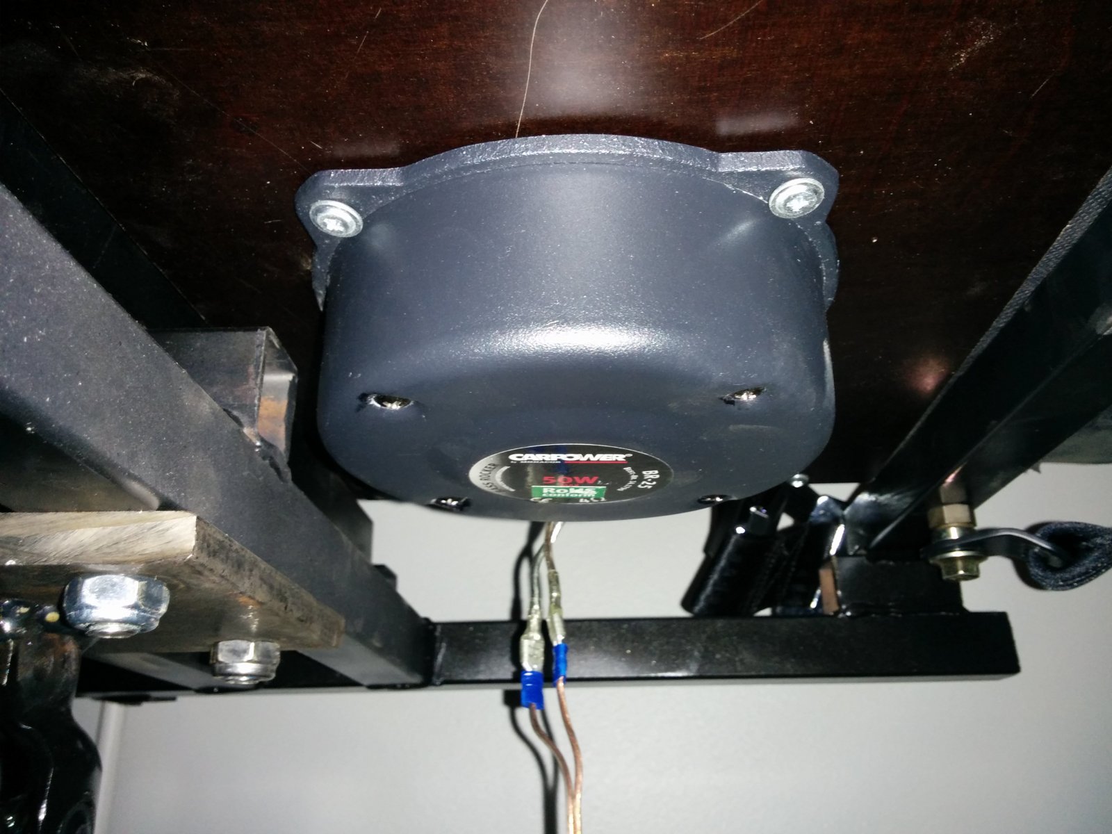

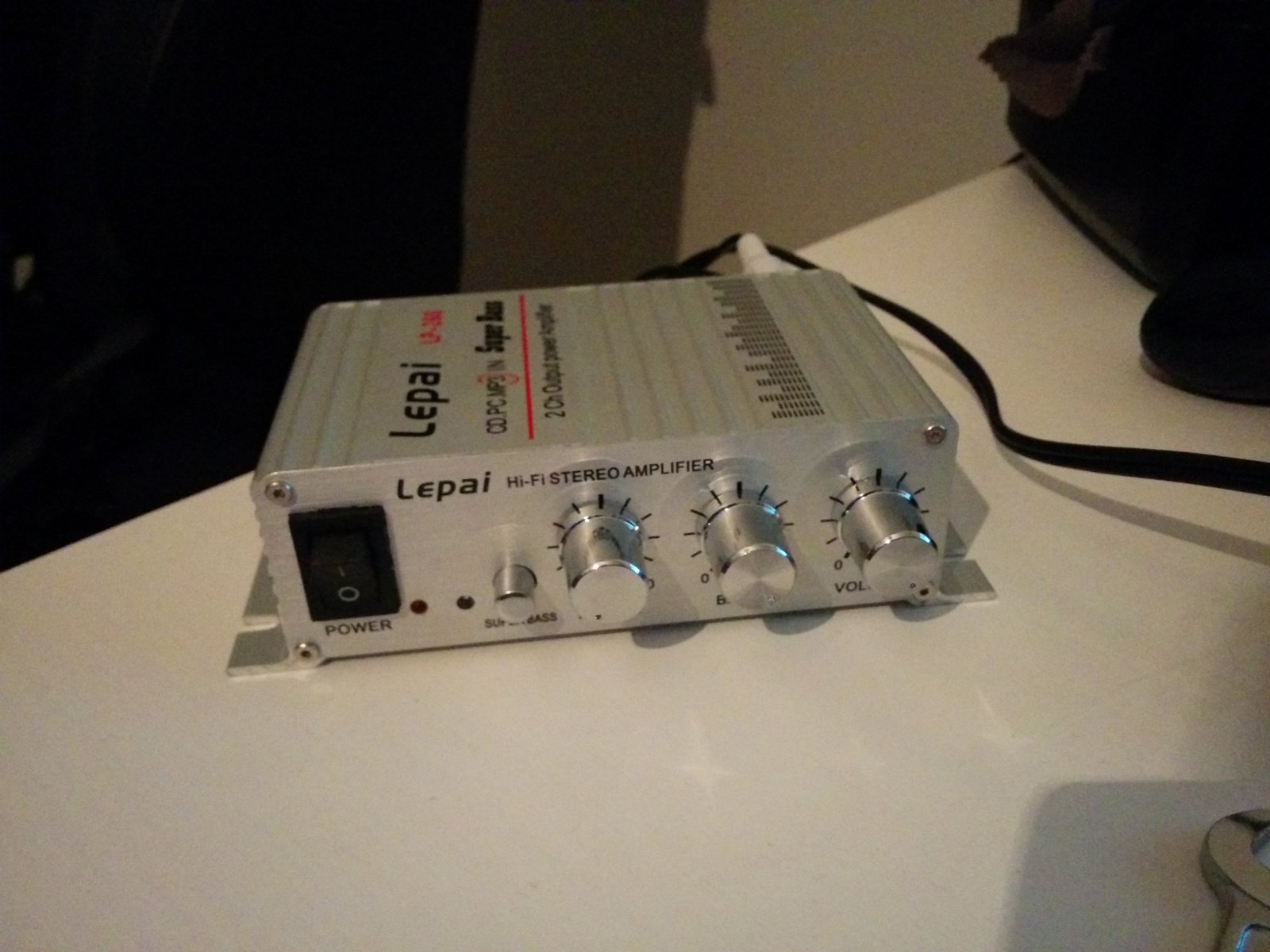

    Today I got Lepai LP-268 mini amplifier that I ordered last week to drive my bass shaker. I tried it briefly and it seems like it's doing its job. The bass shaker is attached to the bottom of the seat.
    Now I'm only waiting for MMs to arrive so I can get the thing moving. They can not arrive soon enough.
