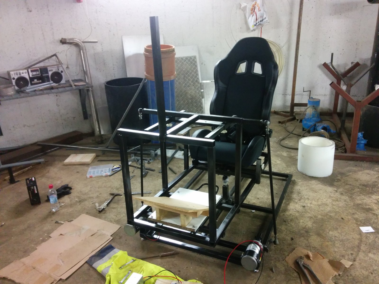

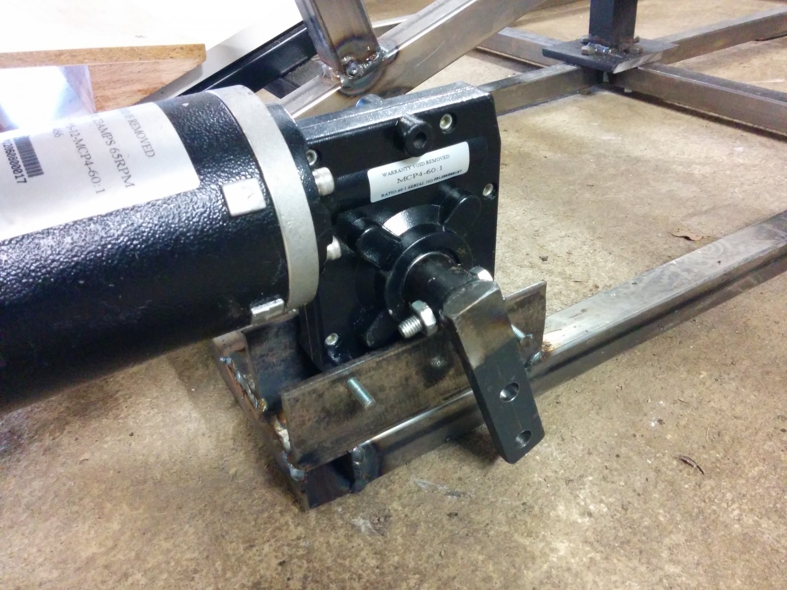

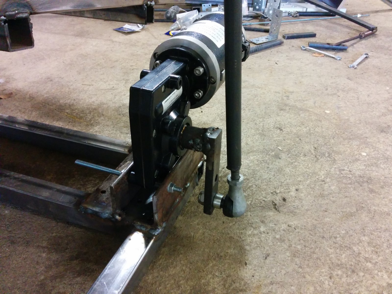

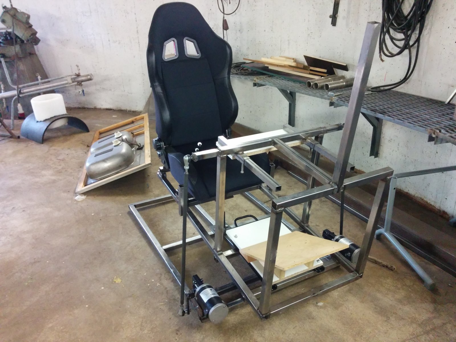

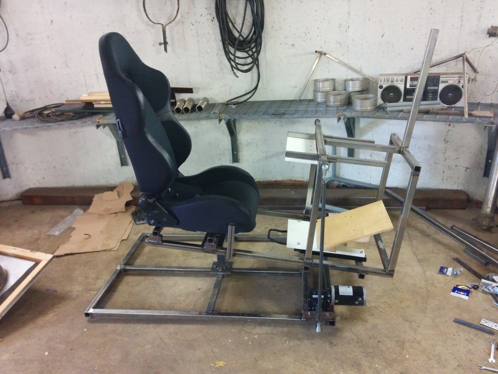

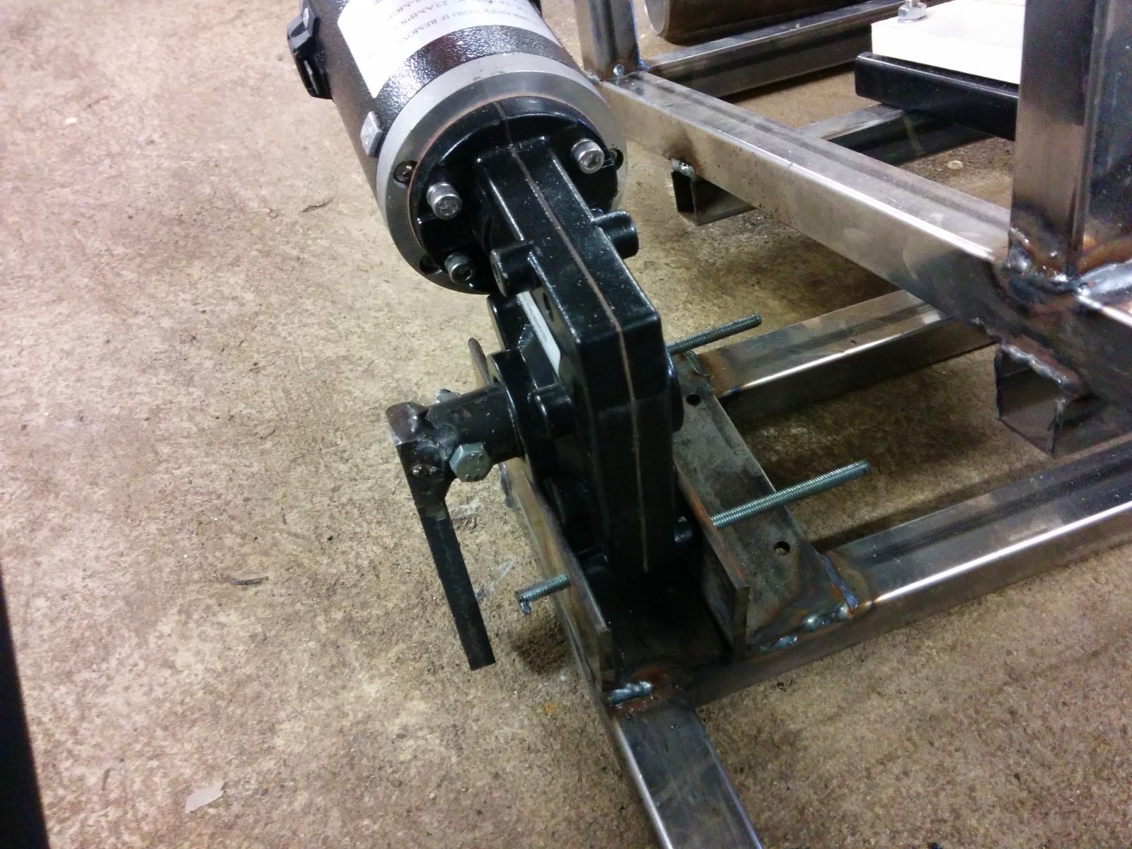

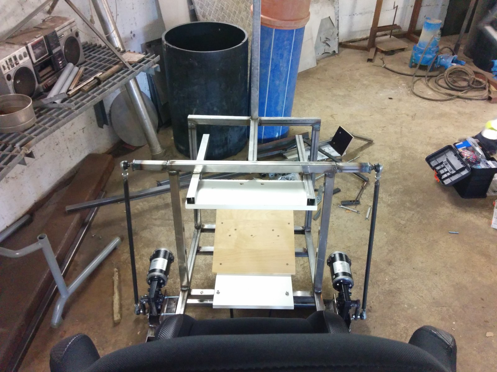

    very little progress on the frame this weekend. Finished the motor mounts and the lever stick thing on the motors. The ctc:s are 8 and 4,5 cm.

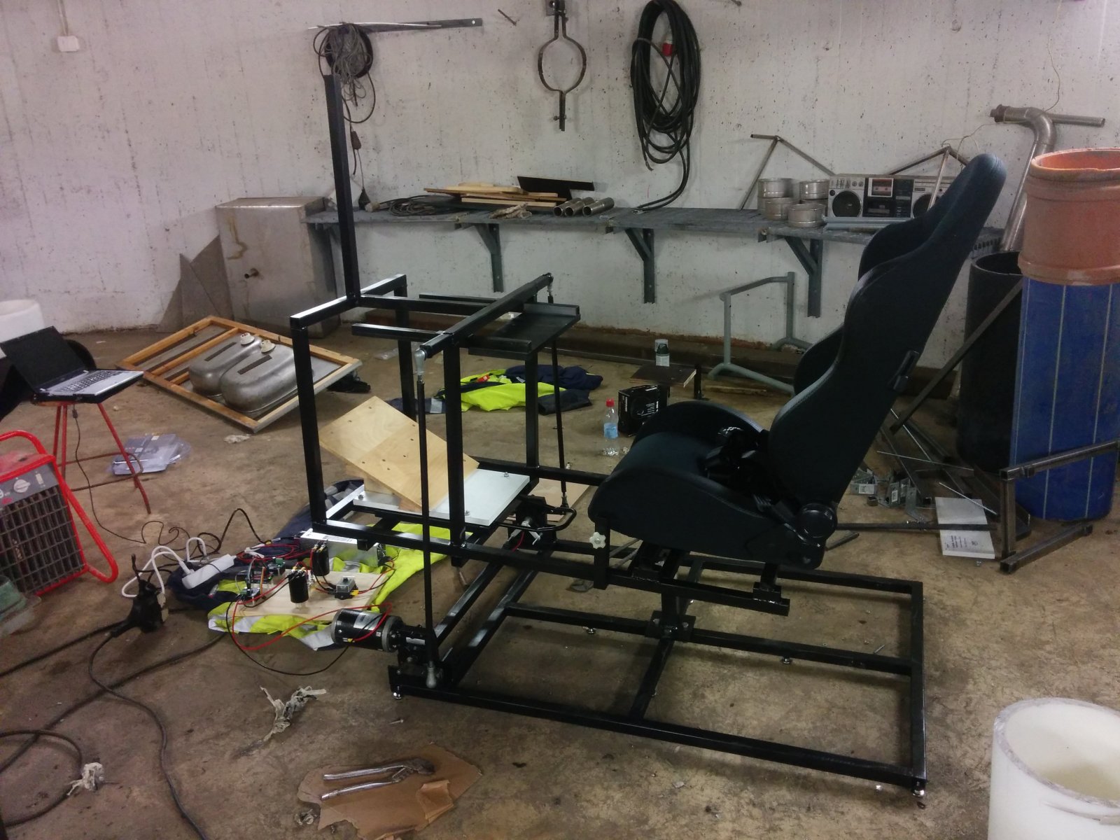

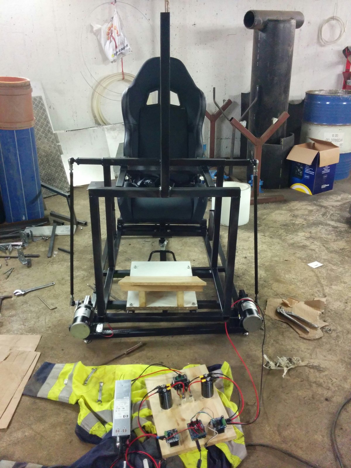

    The sim is nearing completion!
    The connection rods are finished so the sim looks like a sim now.
    I'm not sure about the width of the connection points of the rods and the frame. I might have to make it a little narrower to get more roll on the sim. We'll see how this works.

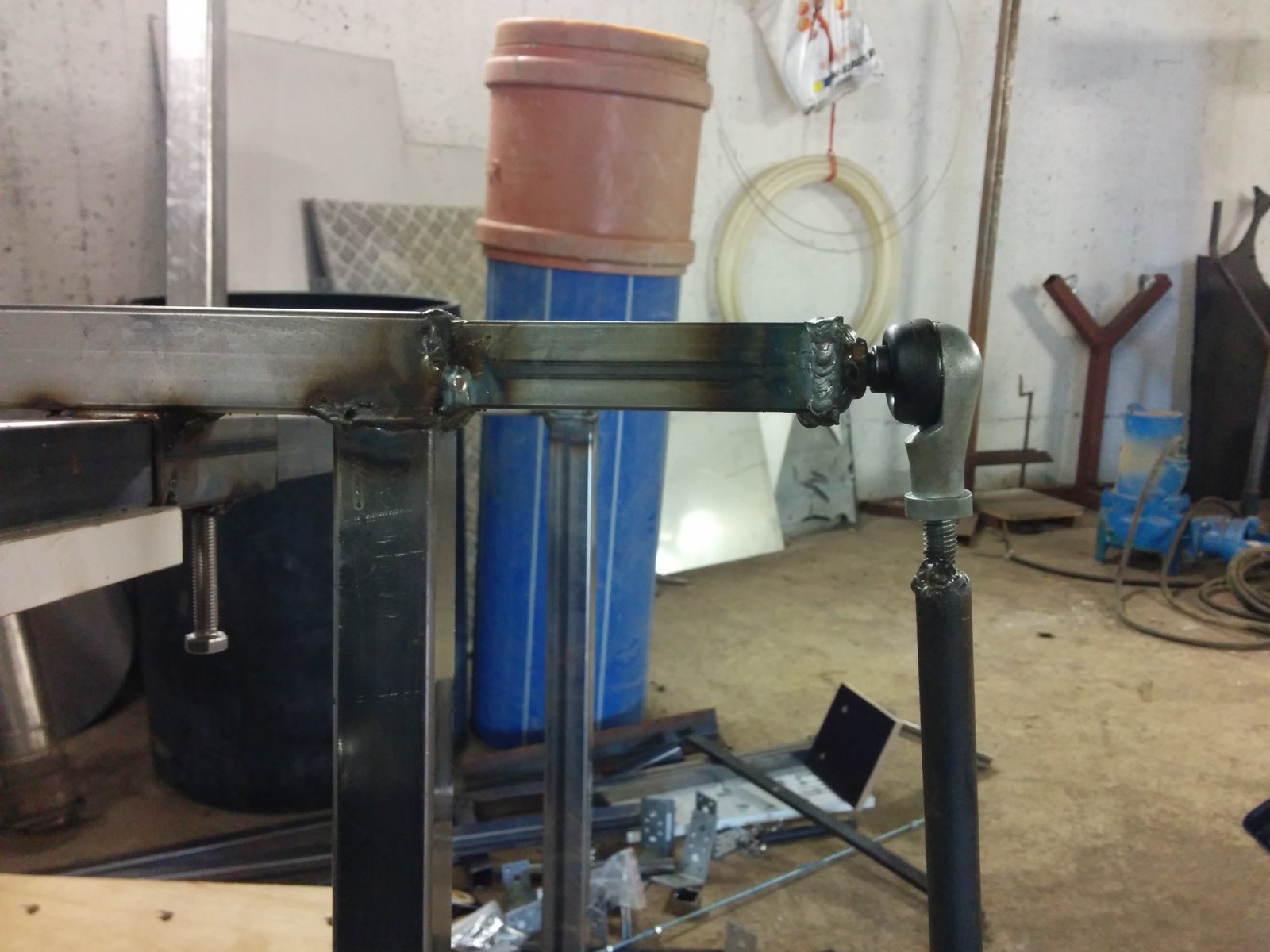

    The rods are made from a solid metal rods (can't remeber the width). I drilled holes in both ends and welded a M10 threads to the ends to attach the joints.

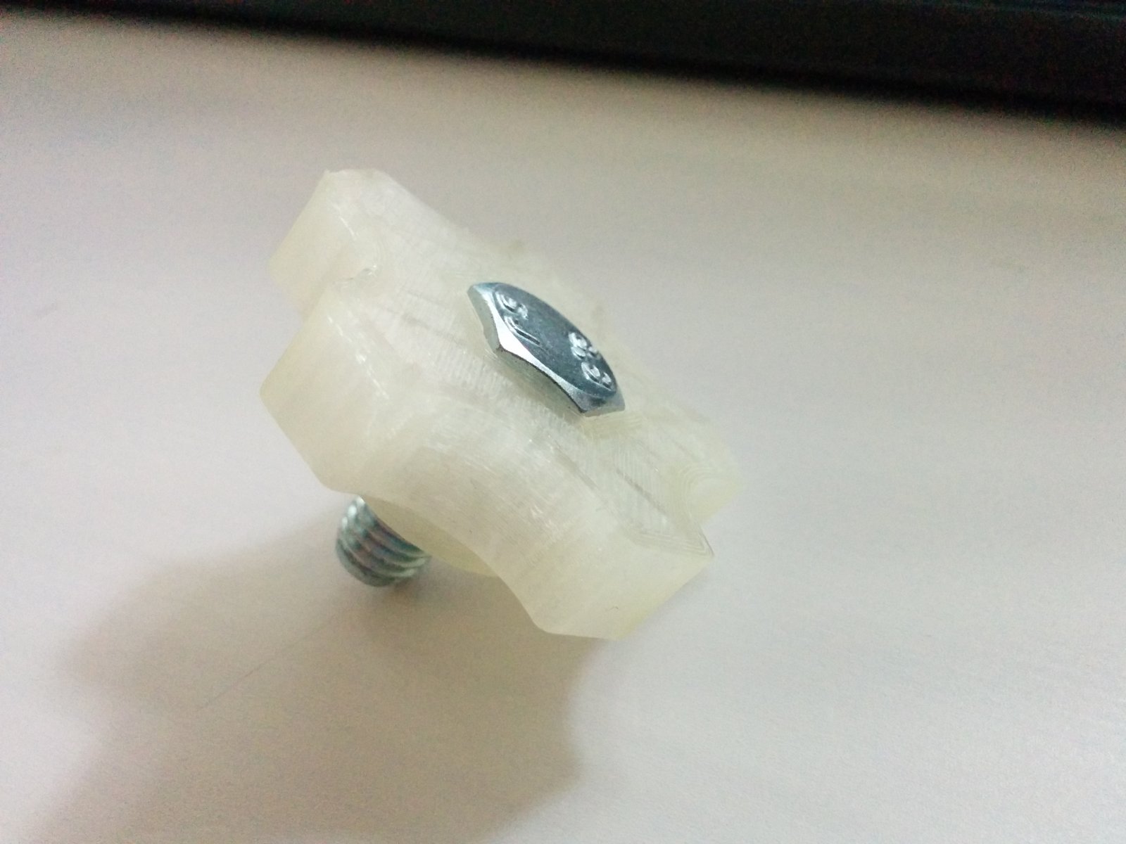

    I printed couple of hand knobs for m8 bolts to make the wheel adjusting a bit easier. Now I don't need a wrench to adjust the wheel.
    Too bad that I can not test them, as my simulator is at the "construction" site 20km away.
    here's a time lapse video of one of them printing for your amusement.

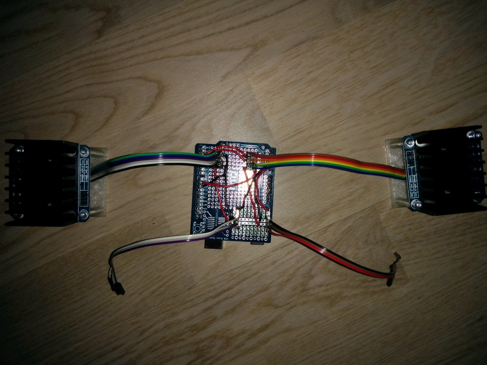

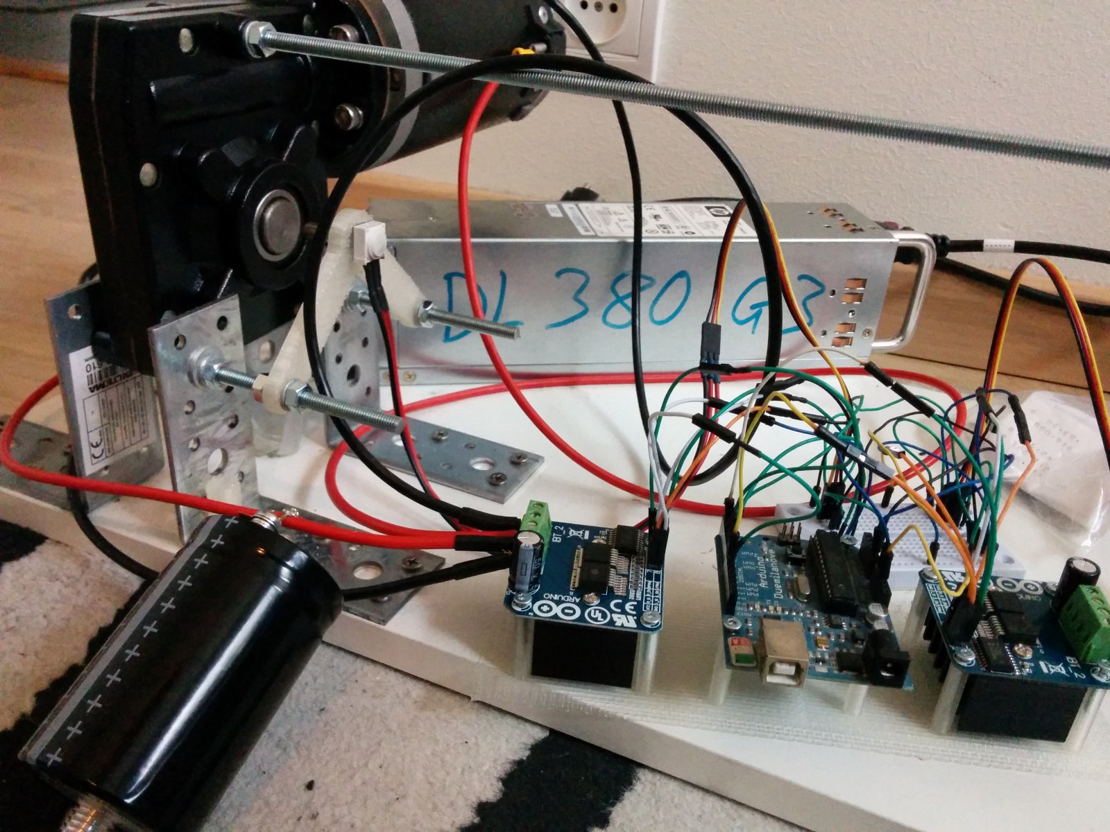

    Yesterday I soldered a shield for the arduino to make it easier to connect it to the H-bridges and potentiometers. Now it's easier to swap the arduino if it breaks. The shield only has connectors soldered and wired to it.
    it's an improvement over the wire mess that I had earlier

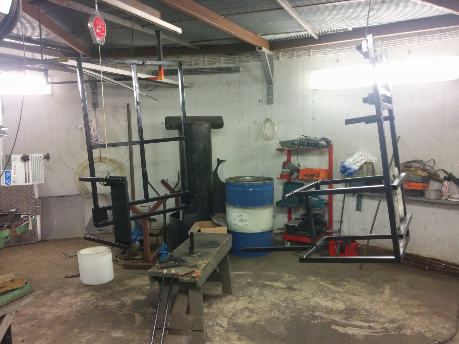

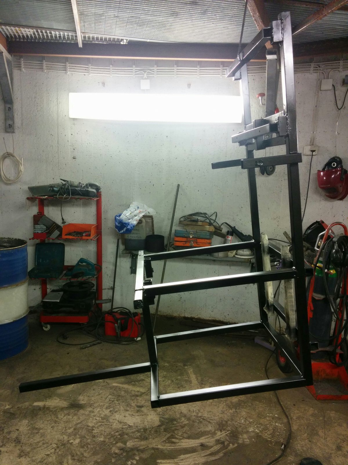

    All parts are now painted.
    Pretty soon it will be finished and I can bring it home!

    I blew the other H-bridge while I was testing the electronics. The motor only spins to one direction so I guess the other half bridge got fried on the board. Well, I can only blame myself for putting 12 volts to wrong pin on it :D I should have double checked the wiring....
    Anyway, I ordered 2 more H-bridges and hopefully I get them soon. in the mean time I hope to finish everything else on the sim so it's ready to move when the H-bridge arrives.

    Some progress today. I assembled the sim today, well at least the parts that I had with me. Now I have a bass shaker attached to the bottom of the seat.
    I also got the sim moving for the first time today! The potentiometers were not connected to the motors, but I got the motors to turn manually
    I had some problems with my H-Bridge also. It seems it's overheating and shutting down. I'll have to add a fan to cool it down and see if it helps.
    Next on the list is to make holders for my Saitek X52 stick/throttle and attach the seatbelt somewhere on the sim. I also have to see if I have to redo the pot connectors. After that I think it's ready to come home.

    No worry, this is an expected behavior. Stick some coolers on the chips and use some fans to avoid any shutdowns.

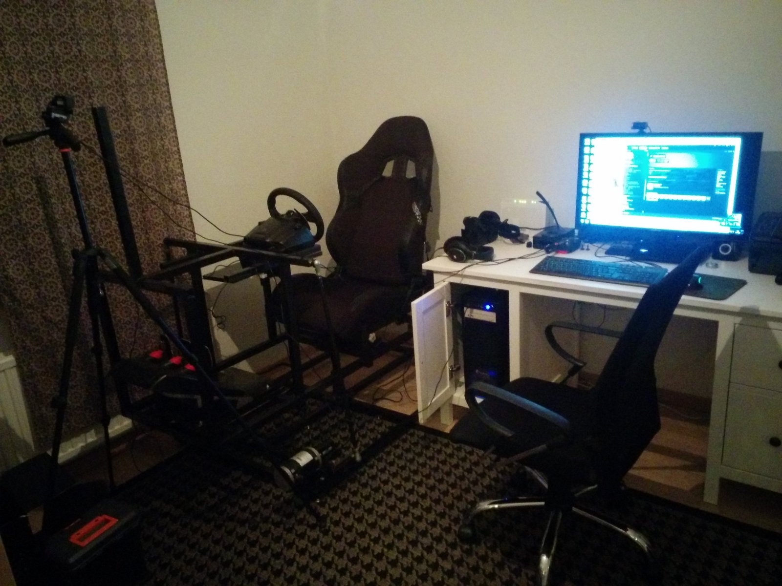

    today I got the SIM home. It found a nice little corner for itself.
    I'm still waiting for the h-bridge so I can get it to move. In the mean time I'll see if I can get it to move via computer one motor at a time.
