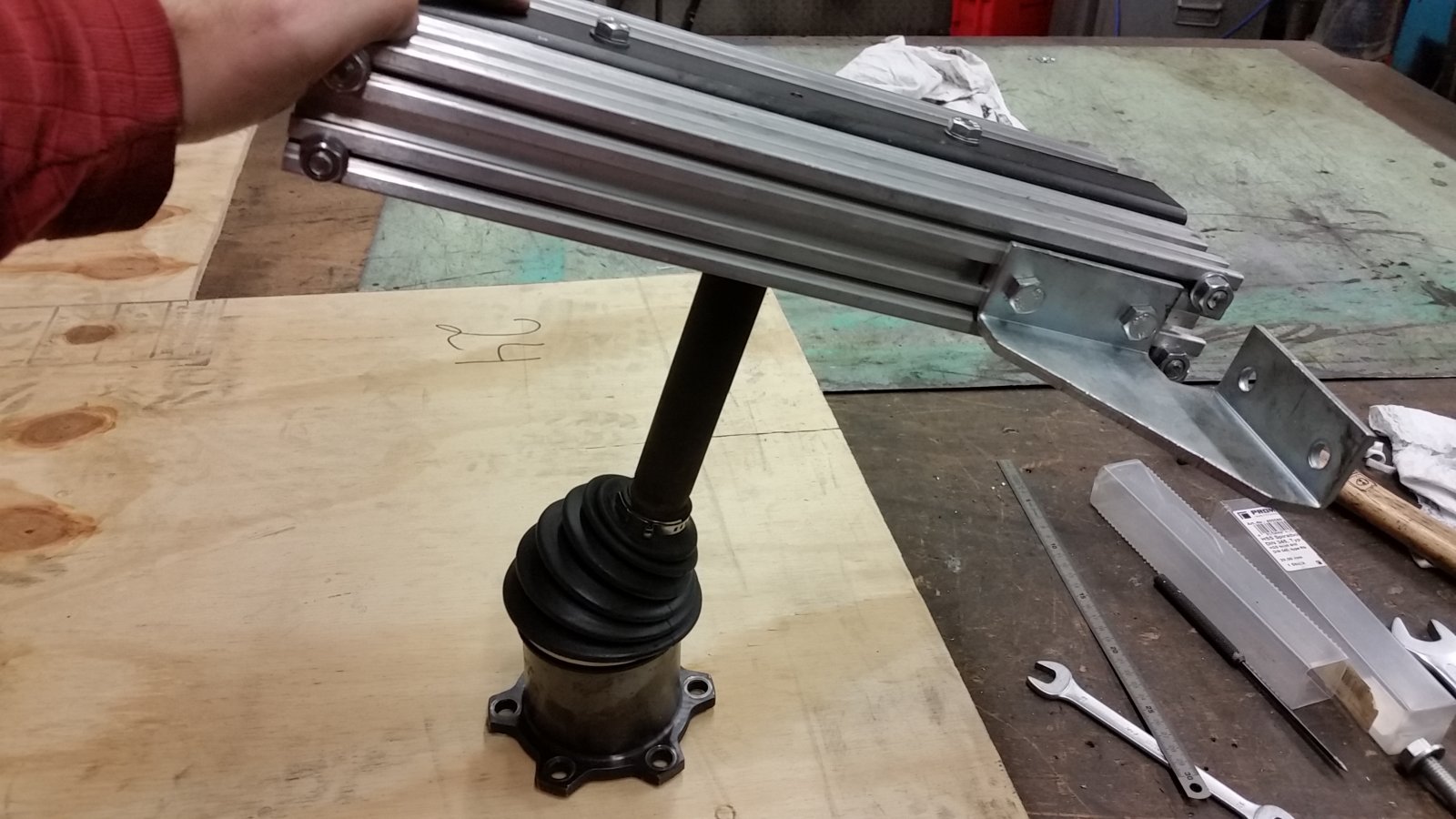

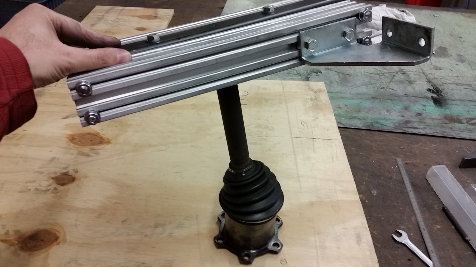

    here is my cog. no torsion and a large angle. with 4 brackets it can be brought into the correct position under the seat (only 1 bracket to see the positions of the screws). the cog is in a type of sandwich. the aluminum profiles outside and 2 rectangular steel tubes in the middle with a hole which receives the cv. 20151121_032543.jpg 20151121_032633.jpg

    thanks for the tips!
    with the engines I currently have the most problems. it only confuses me why some have used 24v motors. half the voltage means 1/4 power. I´m still looking for these motors which used most of the community. a dealer of the engines in germany or in europe would be nice.
    The CV joint has no lateral twist, it is very strong and smooth.
    The frame will be foot mounted.
    The seat... I agree with you. it's about twice as heavy as a sports seat. i´ll replace the seat against a lighter one.

    Also the CV has to be as near as the cog as possible, so you have to put it as high as possible, not the other way
