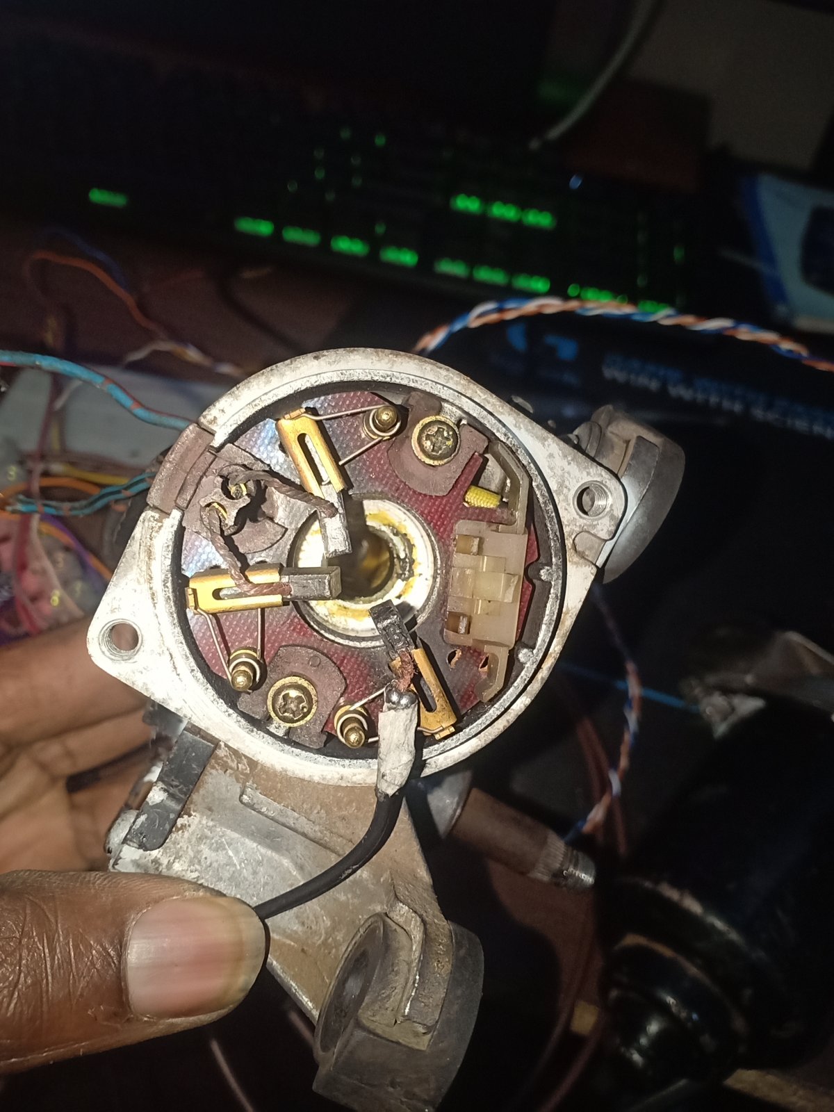

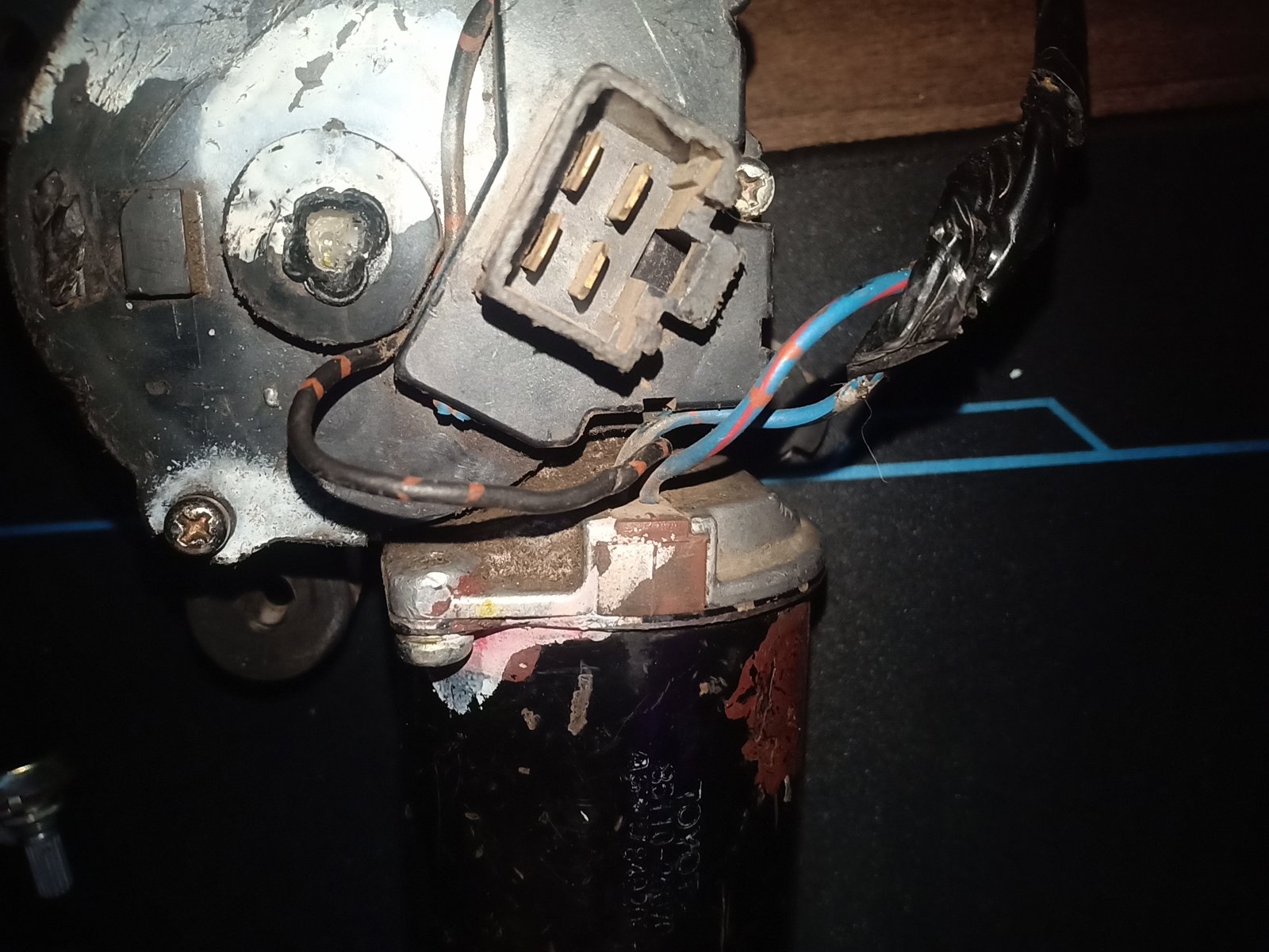

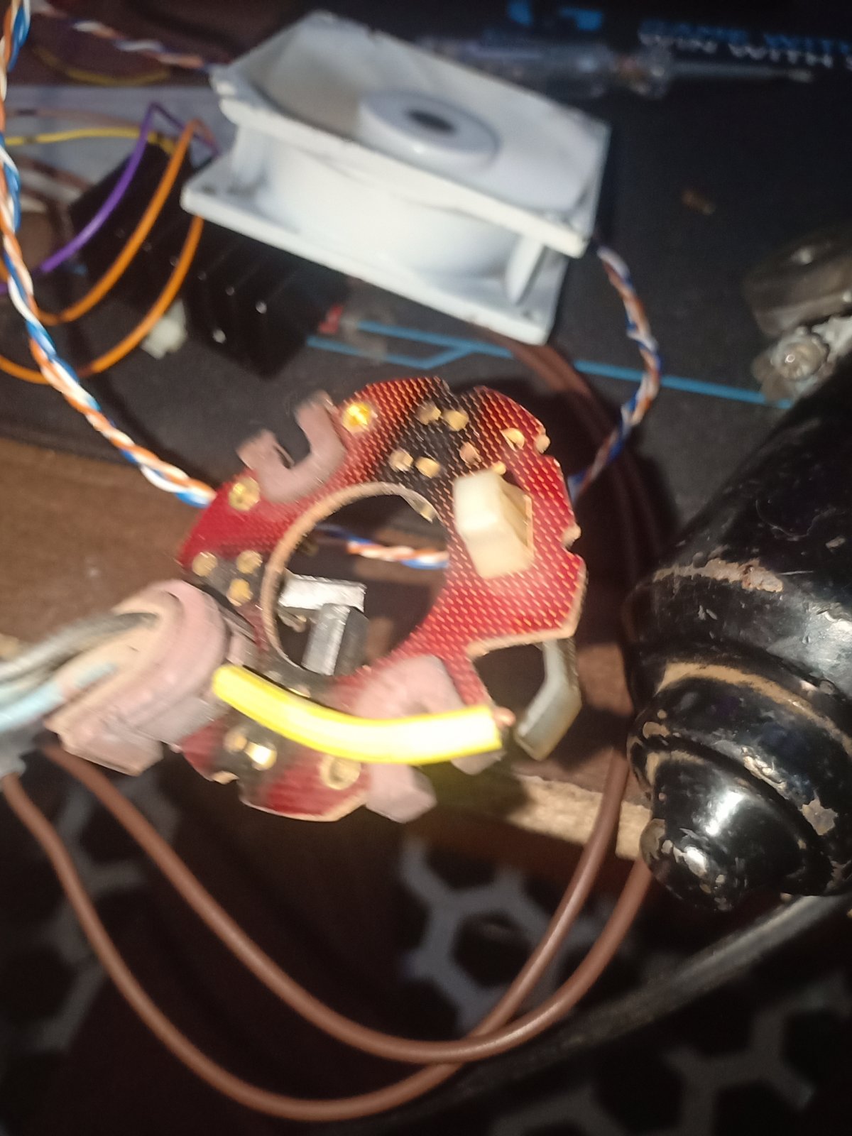

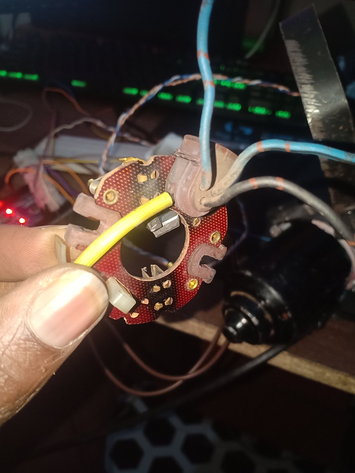

    Hello im on the last stages of wiring and testing but i can only get the motor to turn one way all test work but in only one direction ,ive read the ground isolation methods and tried one but still no results below are some photos of how i did it i also noticed that my motors have 3 wires does it mean its isolated? Any advice IMG20210520000121.jpg
    21,560
    150,980Coins
    +11,025 / 56 / -2
    If you are using wiper motors then they do need ground isolation: https://www.xsimulator.net/community/faq/wiper-motor-mandatory-ground-isolation.25/
    Wiper motors are often wired for high and low speed, you need to figure out which wire is high and which is low.
    Only moving one way can be a number of things, including rotating the housing. Use the Custom Google Search on the Recent page to find possible solutions to try.
