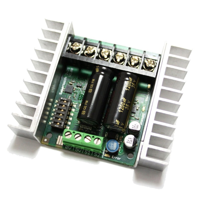

    +45 / 0 / -0
    Excuse me, what bridge H, have you used?

    Ciao! I approached to the realization step by step and at the end the choice fell on a Sabertooth 2x25A! :thumbs

    This is an image of the H bridge.

    What difference does it have with IBT2?

    I do not know in detail the ITB2 H bridge, but the sabertooth has the advantage that it can be driven with only 2 wires (serial).

    The Sabertooth H bridge has 2 channels (can drive 2 motors) and there are several models from 12A to 32A per channel (if I remember correctly) and is already installed with the heat sink.

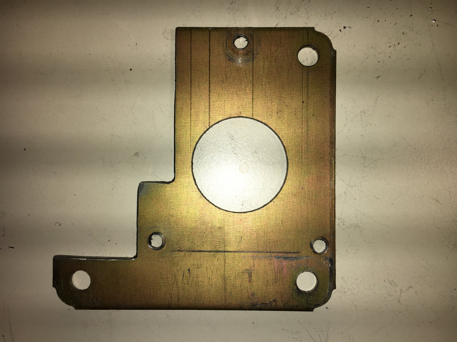

    Other small steps...
  8. ilbiga
    ilbiga Active Member
    Apr 4, 2014
    233
    Network Engineer
    103Coins
    +139 / 0 / -0

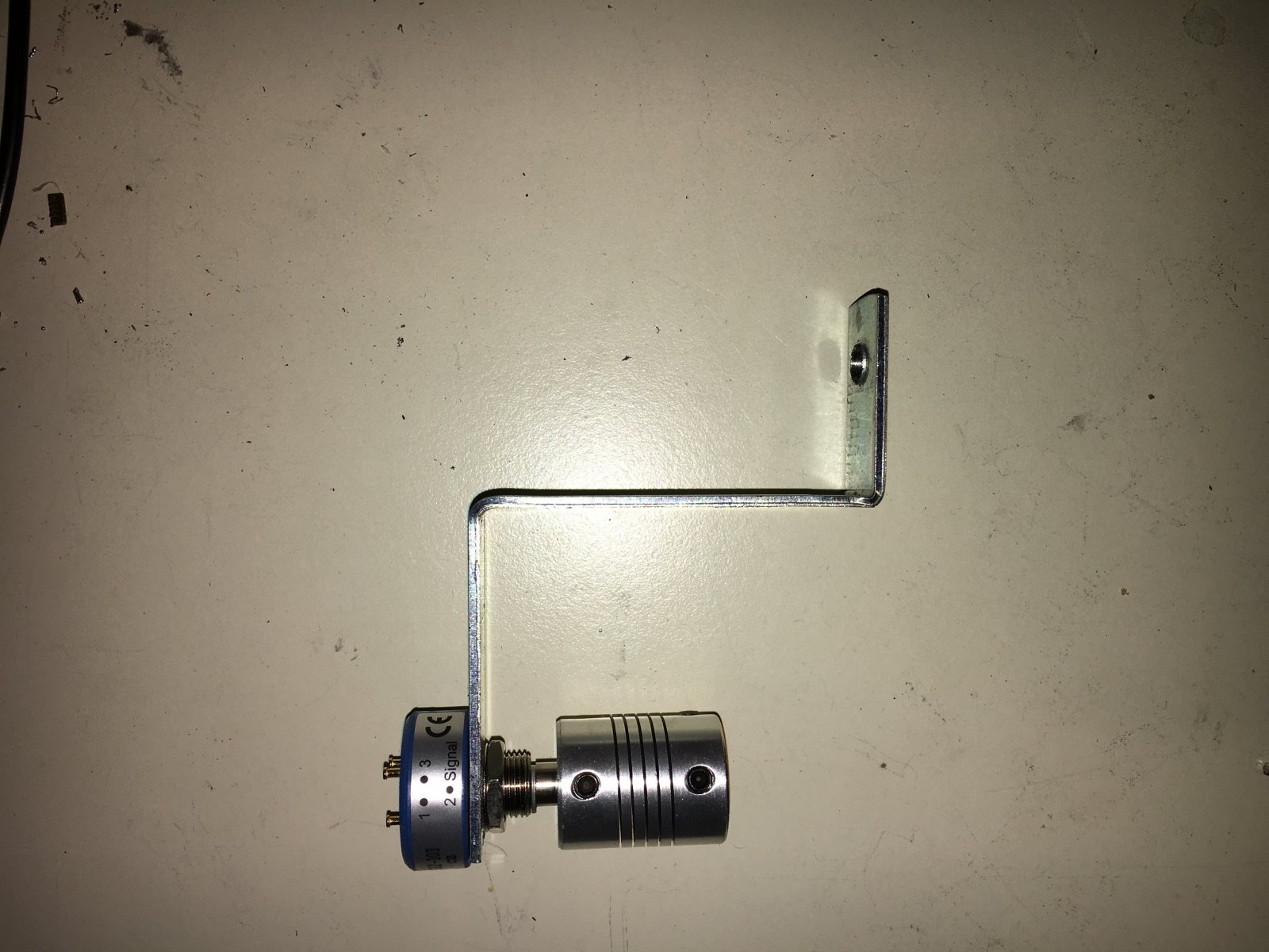

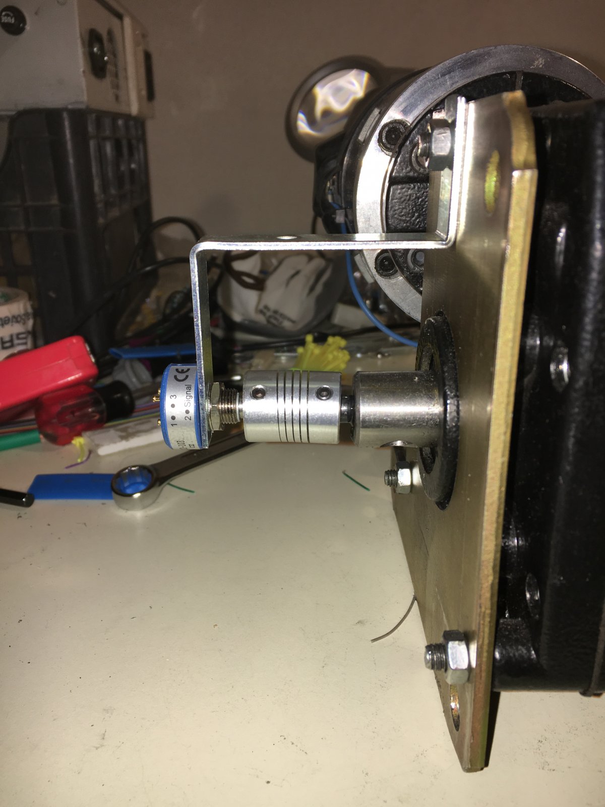

    bracket for potentiometers...
  9. ilbiga
    Apr 4, 2014
    233
    Network Engineer
    103Coins
    +139 / 0 / -0

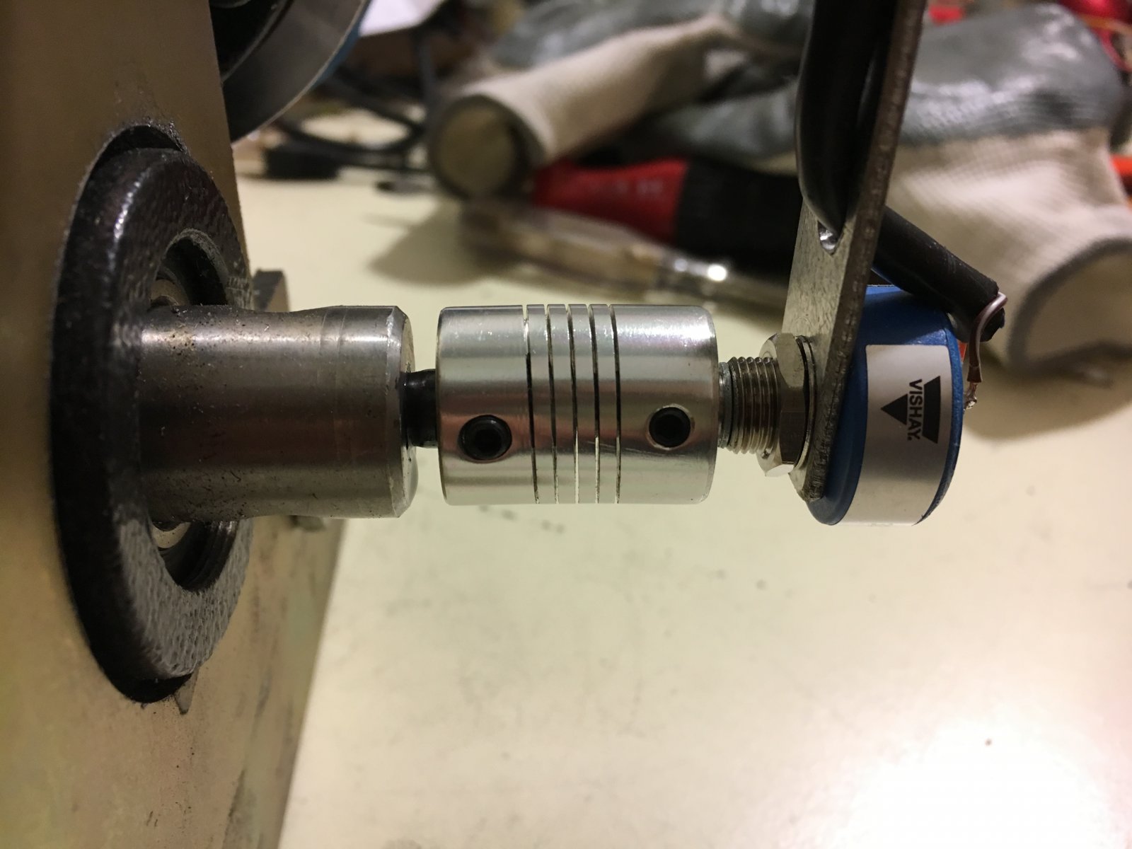

    A bit 'rough, but it seems to work ...
  10. ilbiga
    Apr 4, 2014
    233
    Network Engineer
    103Coins
    +139 / 0 / -0

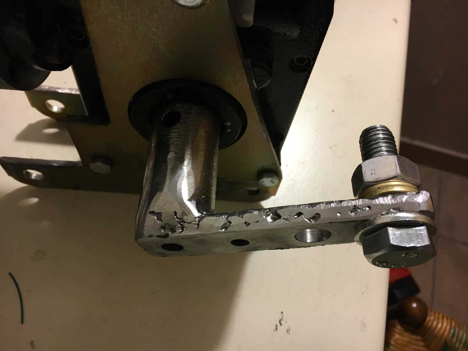

    Levers (a bit 'ugly :think...) and engine brackets.

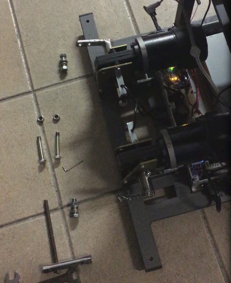

    Montaggio motori su telaio...
    Engine assembly on the frame ...
    Purtroppo non posso caricare il video, ma i motori sembrano funzionare mossi da simtools! :)
    Unfortunately I can not upload the video, but the engines seem to work fine by simtools! :)

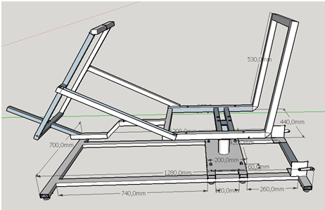

    Nel frattempo la struttura ha subito alcune modifiche...
    Meanwhile, the structure has undergone some changes ...

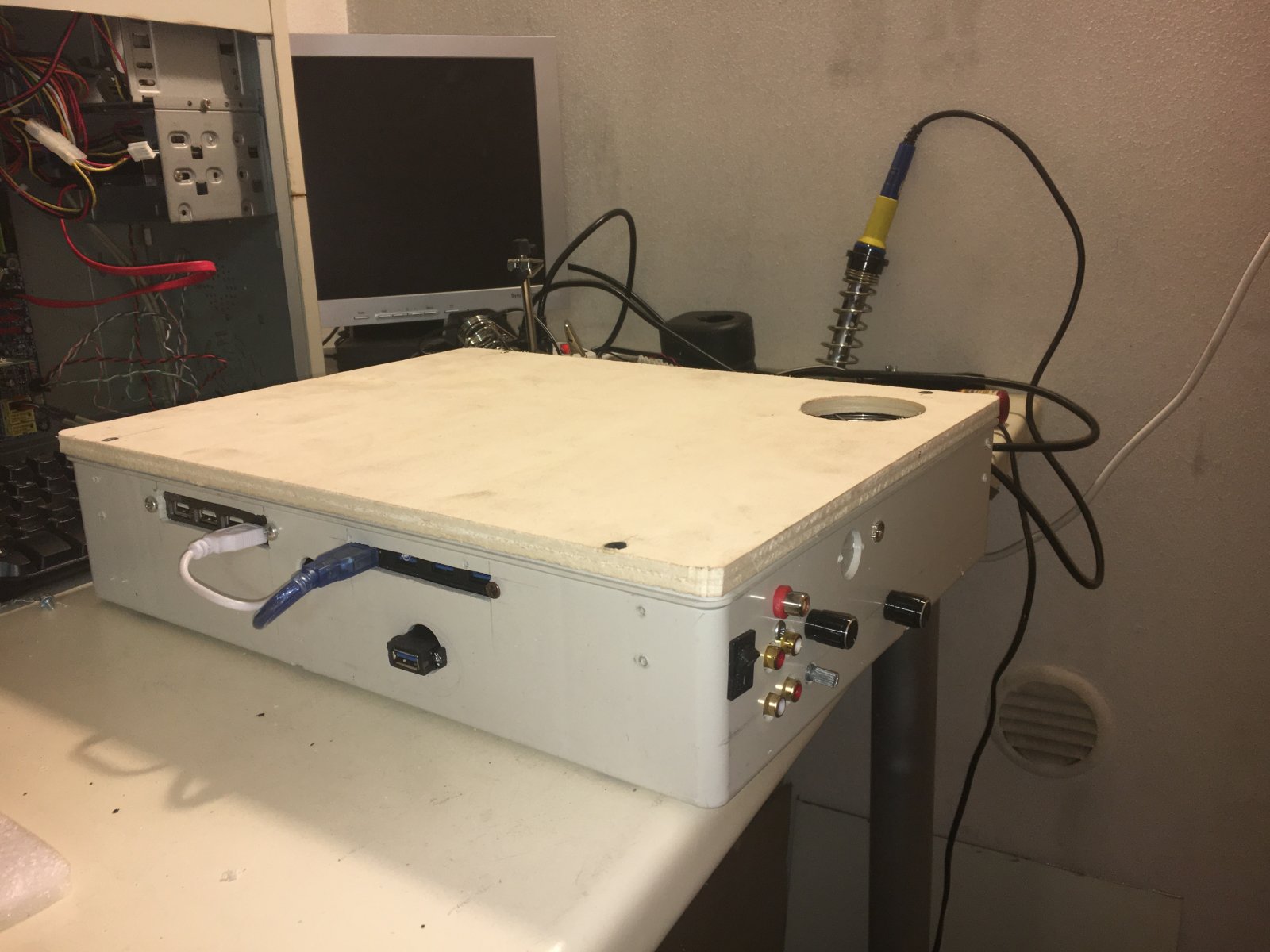

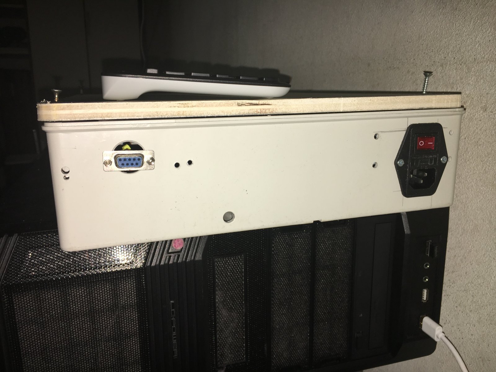

    Sezione audio/Vibe quasi ultimata.... :)
    Audio/Vibe section almost finished .... :)
