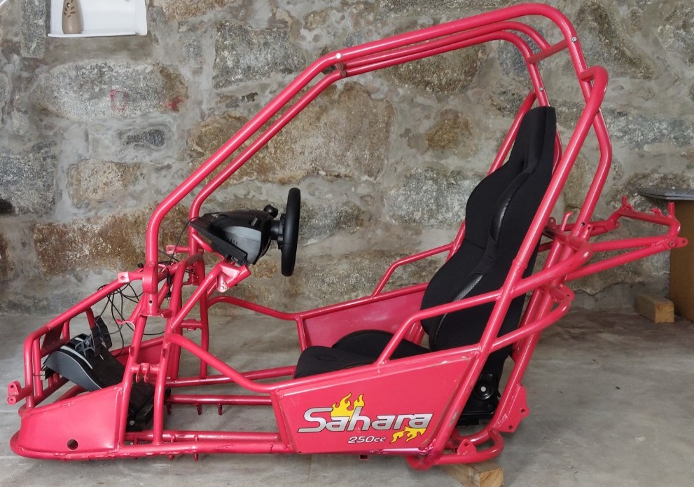

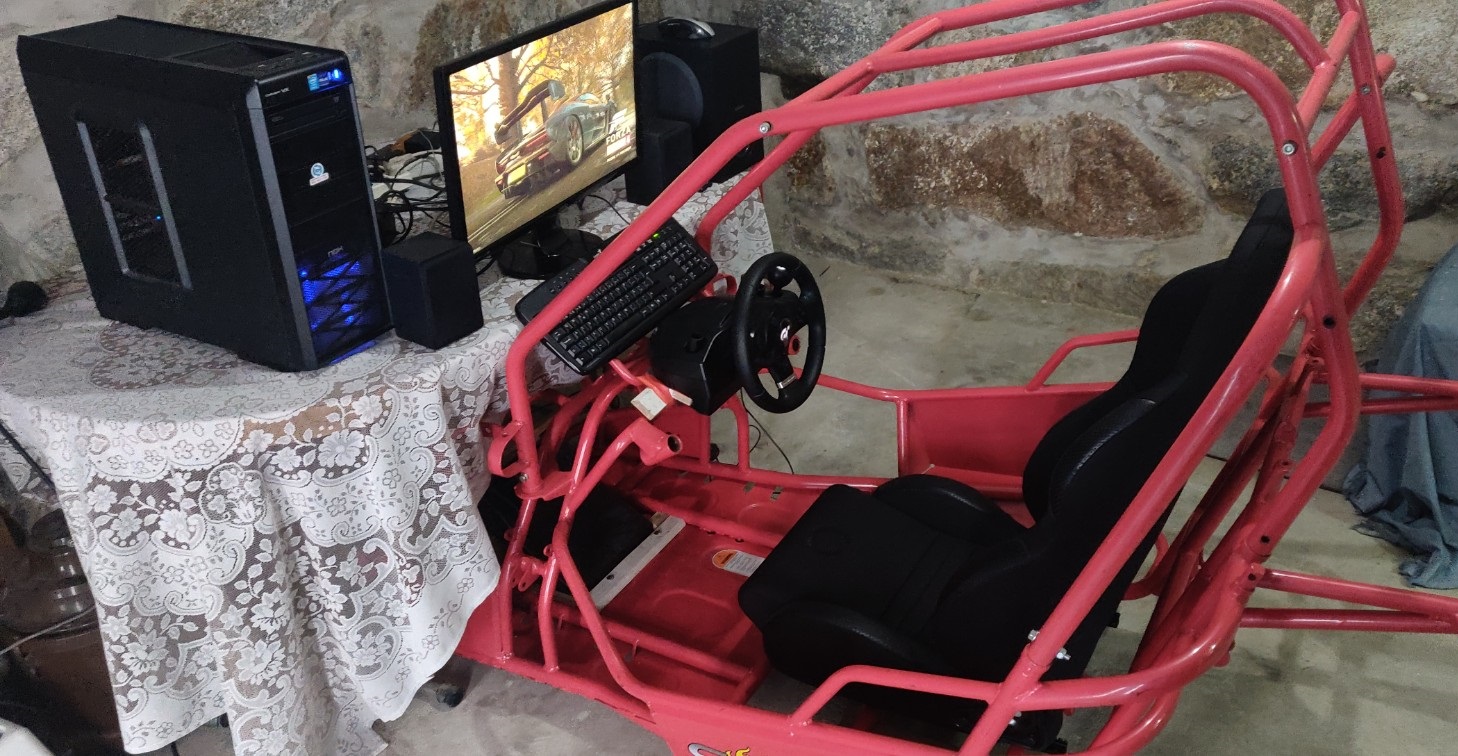

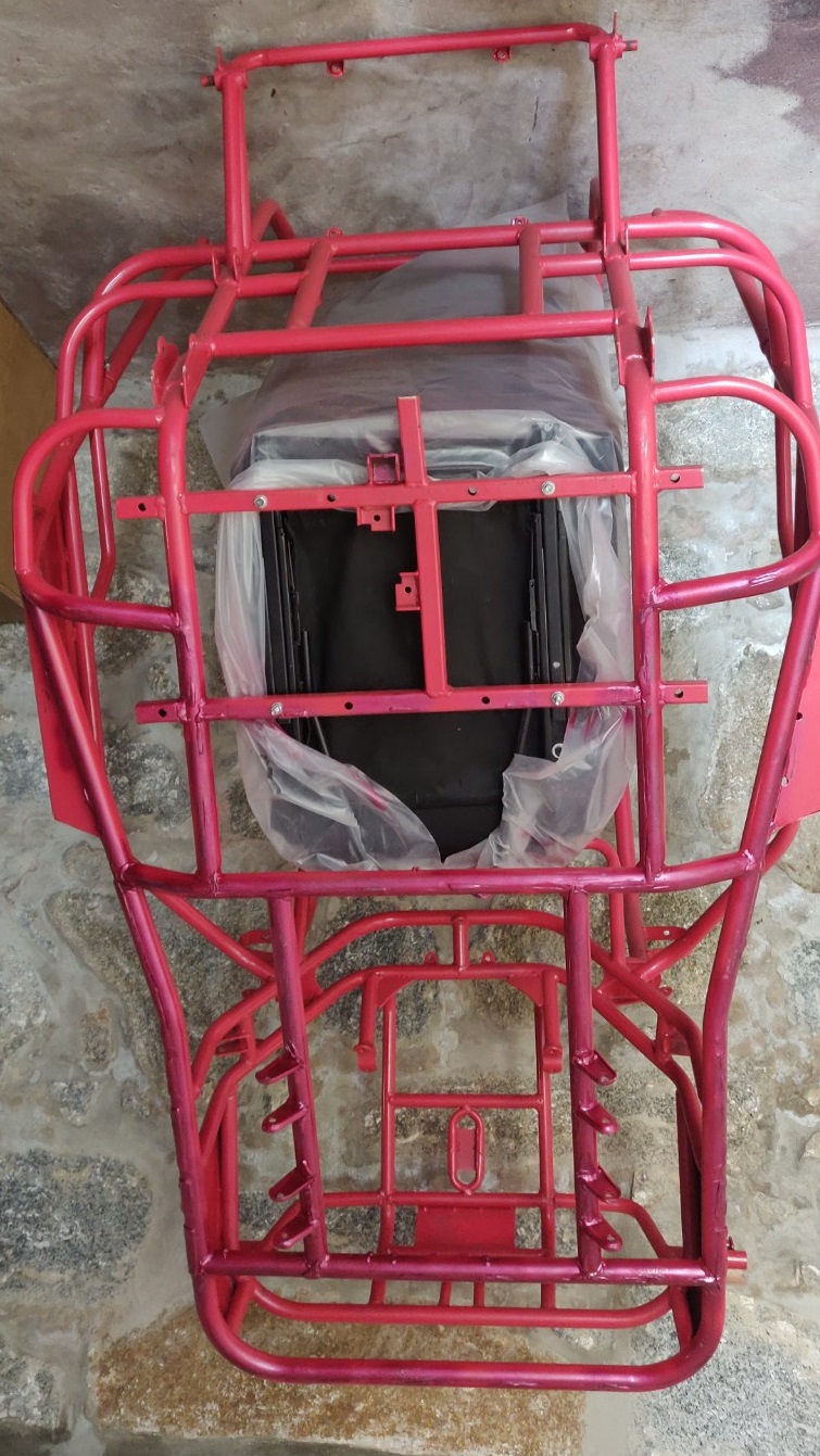

    I started do my 2dof simulator in 2 weeks ago, but this idea alredy have a lot years, but now is the time...
    Material that i have:
    • Logitech Driving Force GT.
    • PC (B45 pro gamer motherboard + AMD MATRIX R9290X-P-4GD5 grafic card).
    • Monitor Benq GL2460 24".
    • Creative 5.1 speakers
    Material that i bought :
    • Kart cross chassi
    • Baquet seat

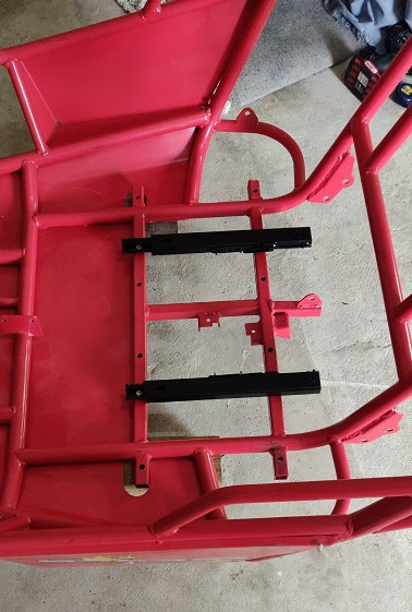

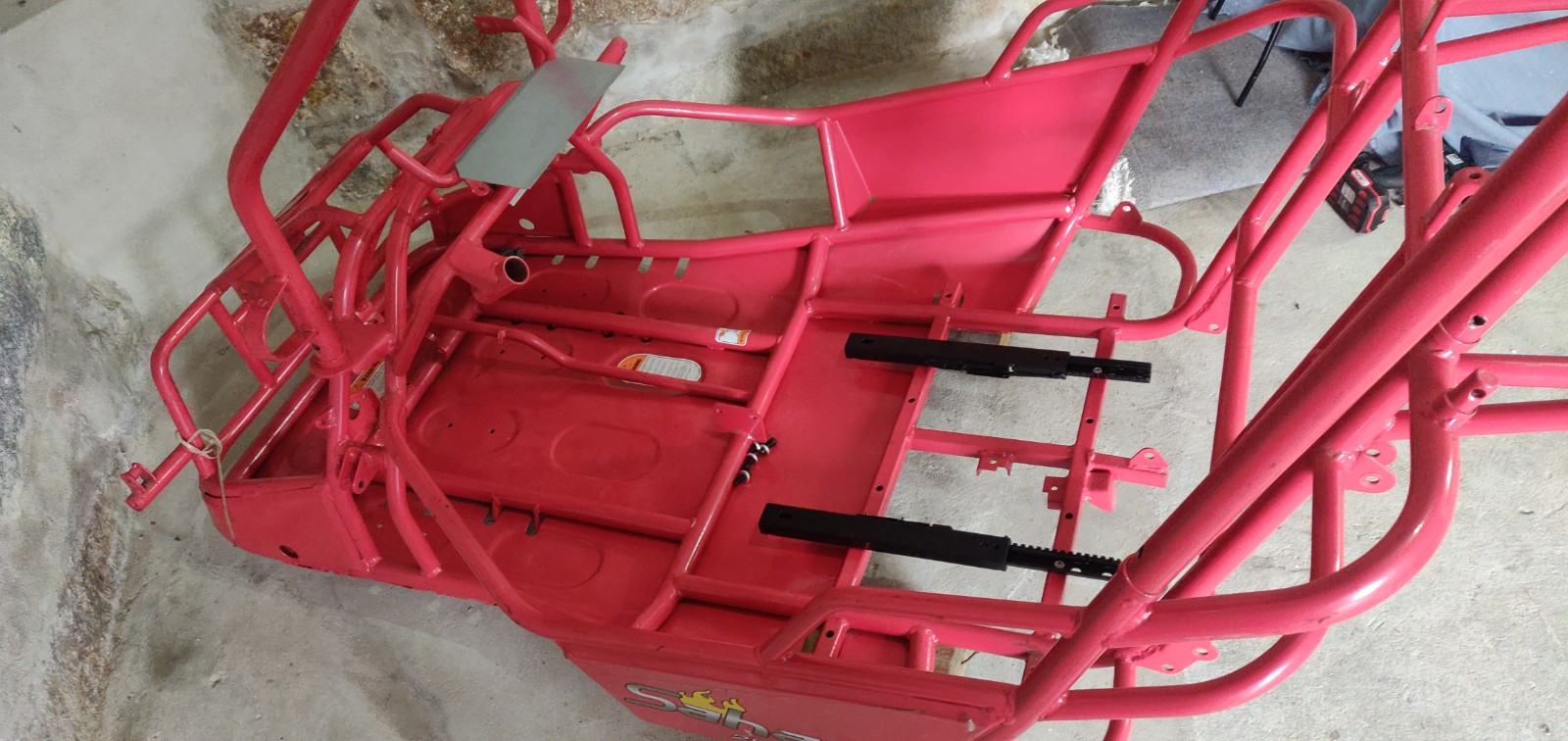

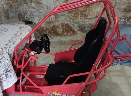

    The first job was install the seat and the steering wheel:
    IMG_20200509_114654.jpg IMG_20200509_115342.jpg IMG_20200509_164149.jpg IMG_20200509_194856.jpg
    Next steps:
    • Create the definitive supports for the steering wheel and pedals.
    I will need your help...
    Thanks.

    Do you plan on motion just for the seat, or the whole frame, as the latter has a lot of mass?

    My plan is on motion the whole frame...
    Yes, it was a lot of mass, but it's possible reduce a little...

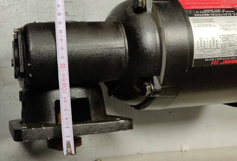

    I will try use AC Motors...
    Someone have experience to help me to find the correct specifications to Motors?

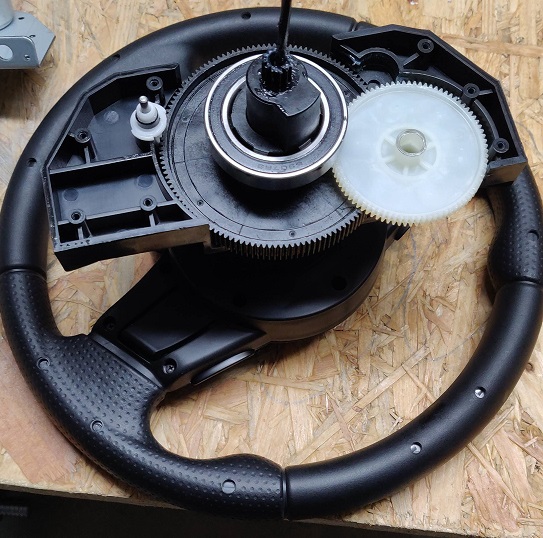

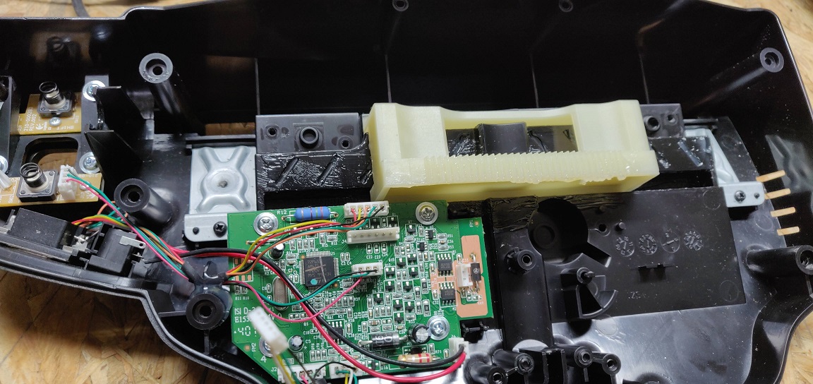

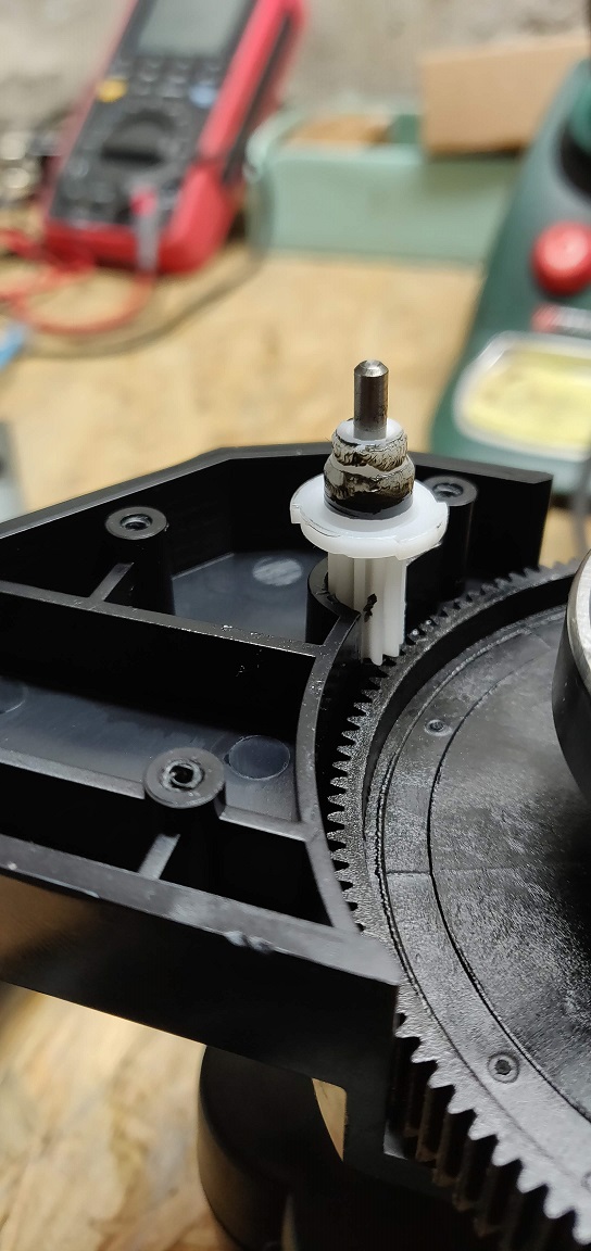

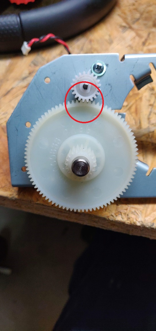

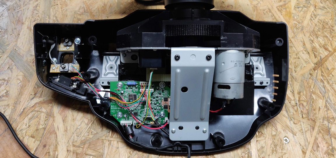

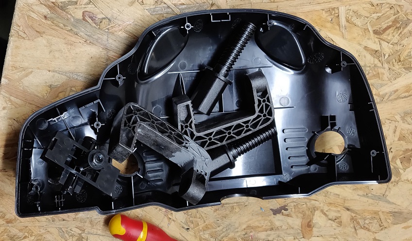

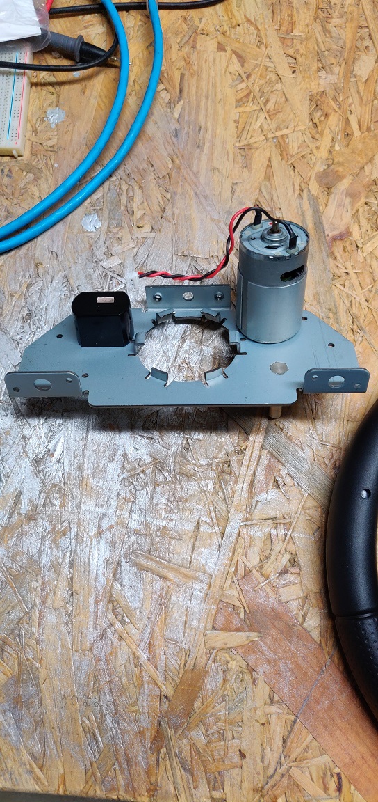

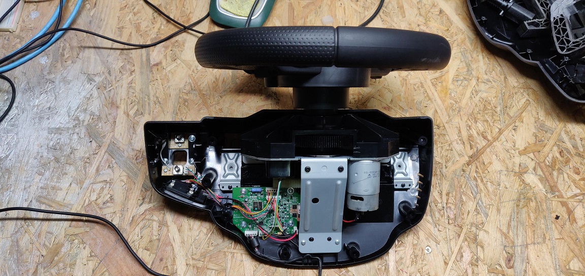

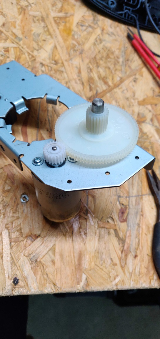

    I passed some years without play with my steering wheel, i don´t know why but the steering wheel was stuck... :confused::confused:
    Time to repair the steering wheel:
    After checked some parts, i saw that the problem was in the a lot of pressure in the gear from the motor...
    To solve the problem i widened the motor mounting holes to relieve pressure in the gears...
    Now is better... :)
    Some fotos from the steering wheel...

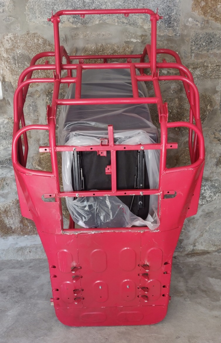

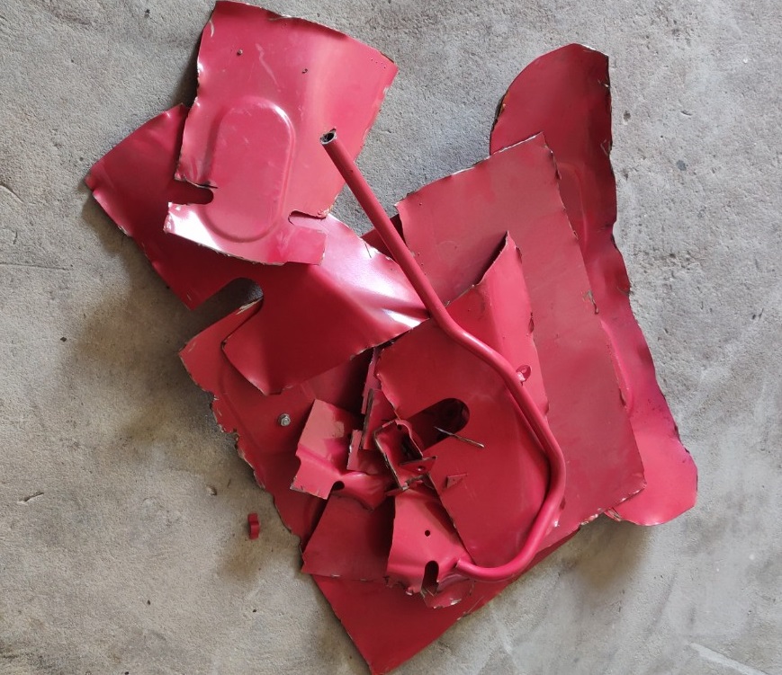

    Today I reduced the weight of the chassis 10Kg:

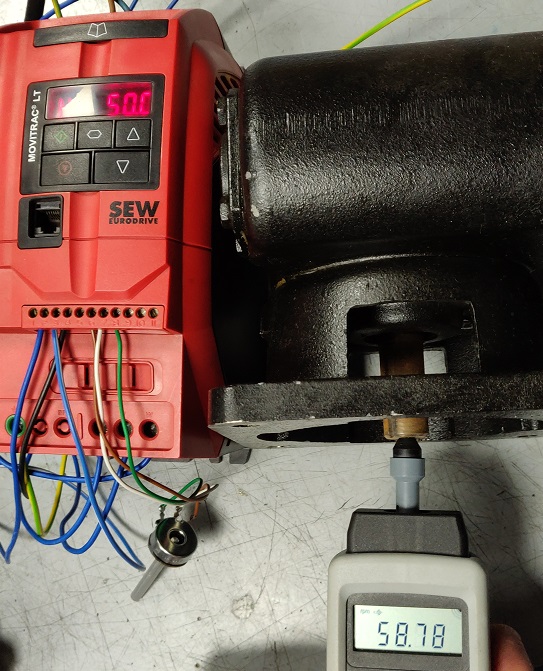

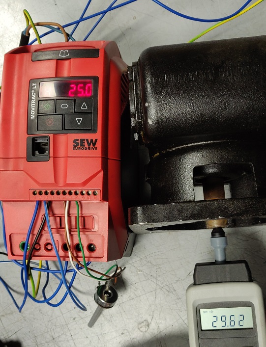

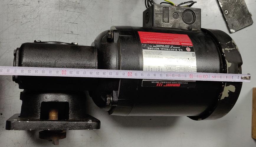

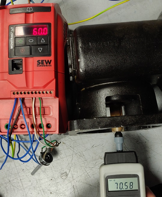

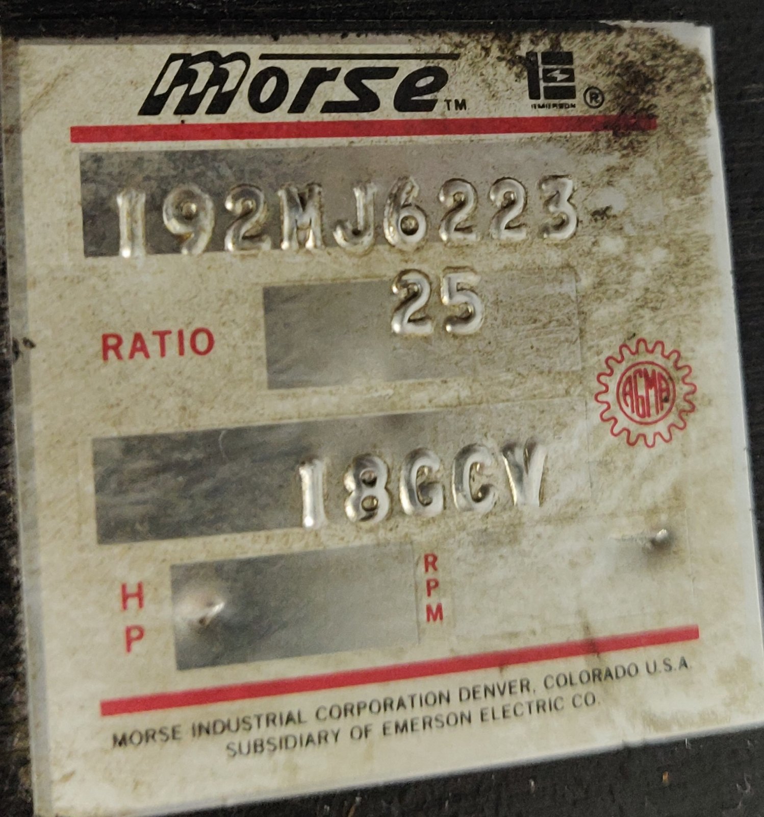

    Motors
    What is your opinion about these motors?
    characteristics:
    25Hz-
    50Hz-
    60Hz-

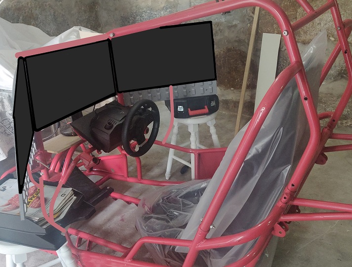

    I need your opinion... Considering that I'm going to use a triple monitor...
    Do you think it looks better with or without coverage?

    Its a trade off, looks are one criteria, the other is performance, so the less mass the better for the latter.

    It´s true, i will try made the two options, adapt the actual coverage and make a new without coverage and after i will see how it works with motion...
    The coverage have 11.6KG o_O The rest I don't know yet ...
