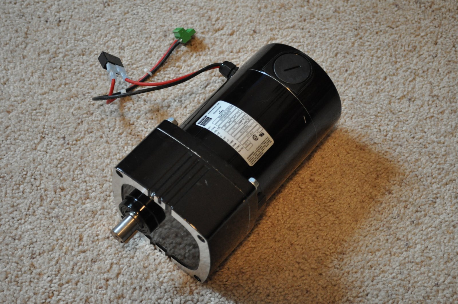

    Here are the motors I'm using. At 13 pounds, they are solidly built, but that doesn't necessarily mean they are great motors for this application. It is too early to tell yet, but a few others have used them with success in different styles of sims. This thread discusses these motors in detail.

    A couple extra goodies came with the motor, as you can see in the picture.
    Coming off the motor is a nice Molex connector, which I'll keep for something else since conincidentally I already have the mating piece.
    The little black block is a 10A self resetting fuse. I'm sure I'll overload that all the time once the sim is done since the motors are rated at 23 amps, so eventually I'll remove it. But for now it seems like a good thing to leave in place to help avoid burning something up as I have no spare parts. Once I have everything together and moving slowly, I'll gradually ramp up the profiles until the fuses start tripping and then bypass them once I'm pretty comfortable things are working as expected.

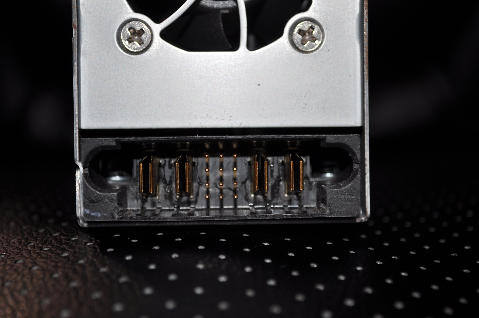

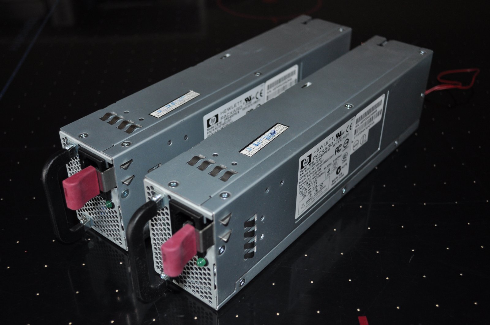

    Here are my power supplies. Like many people, I've gone with used server power supplies. HP Proliant DL380, 575W, DPS-600PB, 47A at 12.15V. Also gives me plenty of 5V should I need it. At just $15 each with free shipping, it is a screaming deal. I wonder why there are so many of these floating around. They work fine, so the servers they were in must have been scrapped?
    re [​IMG]
    Using these power supplies is a little tricky to use, since they assume they are in a server. If you just plug these in, the fan will run but you will not get the 12V output. Several of the pins need to be connected to enable the power supply.
    Looking at back with fan up, pins are as follows
    1 2 3
    4 5 6
    7 8 9
    10 11 12
    Usage:
    1 = +5V
    2 = +5V
    3 = +5V
    4 = Fan Speed (float = always high speed, ground = low/auto)
    5 = -12V
    6 = PS Kill (pull to ground to enable +12V)
    7 = Unknown
    8 = Gnd
    9 = Voltage Adjust
    10 = PS On (pull to ground to enable +12V)
    11 = Current Share (connect to pin 11 of 2nd supply when in parallel)
    12 = Unknown
    Right = +12
    Left = GND
    Definitely follow the recommendations to run the fan at low speed! With the power supply in standby mode, the fan runs and my thought was "That isn't loud at all. What are people complaining about?" But then once I enabled the power supply the fan went to screaming mode and I totally understood. As I understand it, grounding pin 4 doesn't permanently force the fan into low speed, but instead puts it into auto mode where it will still speed up if needed. I haven't put much load on mine yet, so I can't verify this.
    Following the recommendation of @bruce stephen I'm going to run the power supplies in parallel so both supplies work together to run both motors. That will decrease the odds of having one shut down with a big spike. That means I will connect pin 11 on the two supplies.

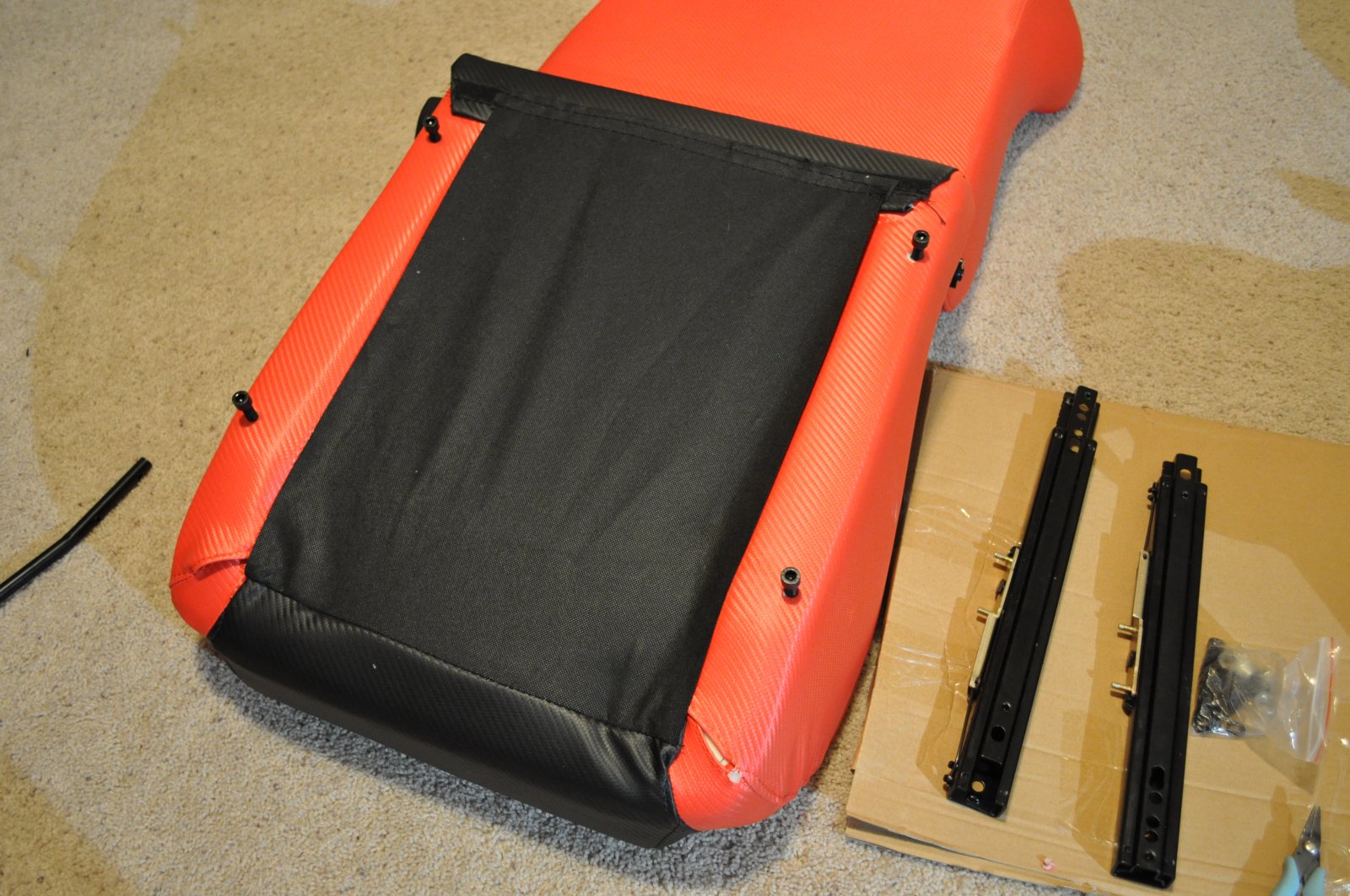

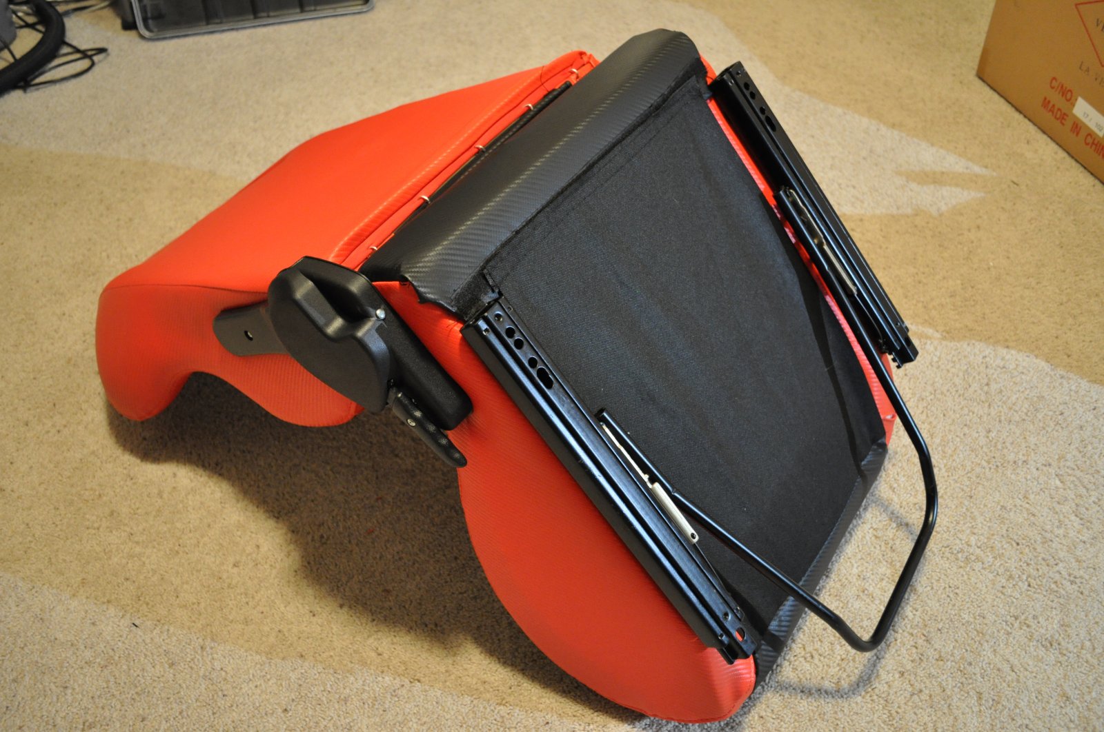

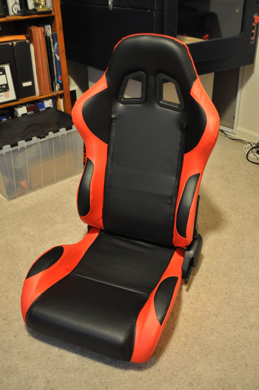

    I got a great seat for $128 USD off ebay. http://www.ebay.com/itm/381293703282 It fits me like a glove and is more comfortable than any car seat or even office chair I've ever had. But I'm rather skinny (5'10" 150 lbs, 187 cm 68 kg), and it looks like it would be a tight fit for someone heavier.
    You would think setting up the seat would be the easiest part of this project! But mounting the included slider to the bottom of the seat was a trick. The mounting holes were covered by enough foam and fake leather that they were nearly impossible to find. Then figuring out which way to mount the brackets was tricky since mine are backwards from what is shown in most instructions online.
    The sliders have an 8 1/2" range of motion, meaning I should have no problem setting things up to handle kids through adults.
    20,553
    145,136Coins
    +10,779 / 52 / -2
    Some food for thought.
    I am not sure of your design plans but generally it is a bad idea to have an adjustable seat, as it messes up the COG and puts unwanted strain on the motors.
    What is a good idea to have adjustability for different size people is to use the seat adjuster to move the pedals, something like this: http://www.xsimulator.net/community/faq/car-seat-adjustable-inverted-pedal-mount.98/
    Or alternatively for all controls like this: http://www.xsimulator.net/community/faq/adjustable-tube-pedal-and-wheel-mounts.147/

    Great suggestions @noorbeast! At this point I have no idea where the center of gravity is going to be, so I'll leave the slider on the seat to make it easier to dial that in. Once I have the CG right, I may just bolt the seat down in that spot. Having the pedals and controls adjust does seem like a better idea. I only have 25 foot pounds of torque to play with, so the CG needs to be pretty close for this to work.

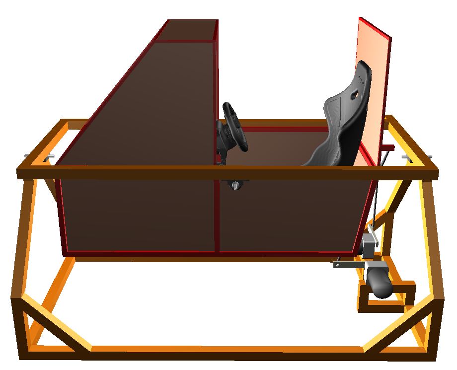

    At this point I'm drawing up a rough design. I've looked at a lot of pictures of Joyrider type setups to see where they put the bearings. Since I'm planning having an enclosed sim, that will change the balance a bit, but hopefully not too much. Unfortunately I need to make a lot of design decisions and build at least the inner frame before testing the balance. The good news is the inner frame is going to be quite cheap compared to the rest of the sim, so if I get the balance way off and need to rebuild it, that won't be that bad.

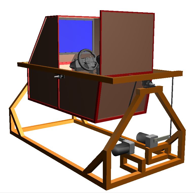

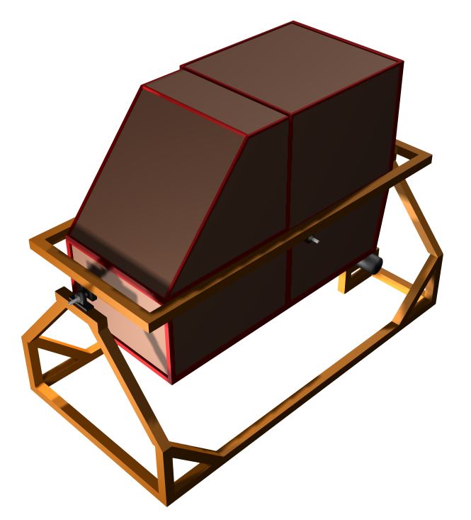

    After temporarily getting sidetracked with a pumpkin chunkin' project, I'm now back on the simulator. Here are the crude design as it stands now. The plan is to have the back half of the cover slide forward for access.

    I've got enough 1" x 1" square steel tubing to get started welding up the middle frame. I'm a little concerned about the weight. The basic frame without the cover, walls, floor, seat, monitor, etc. is going to weigh around 30 pounds. By the time everything is in there plus the weight of a person, the part that moves could easily top 300 pounds. I'll need to get the balance points pretty close if I'm going to move that with my 25 ft-lb gear motors. Right now I'm mostly guessing where those pivot points should be. Even if I get it perfectly balanced the acceleration might be pretty slow with all that mass to overcome.

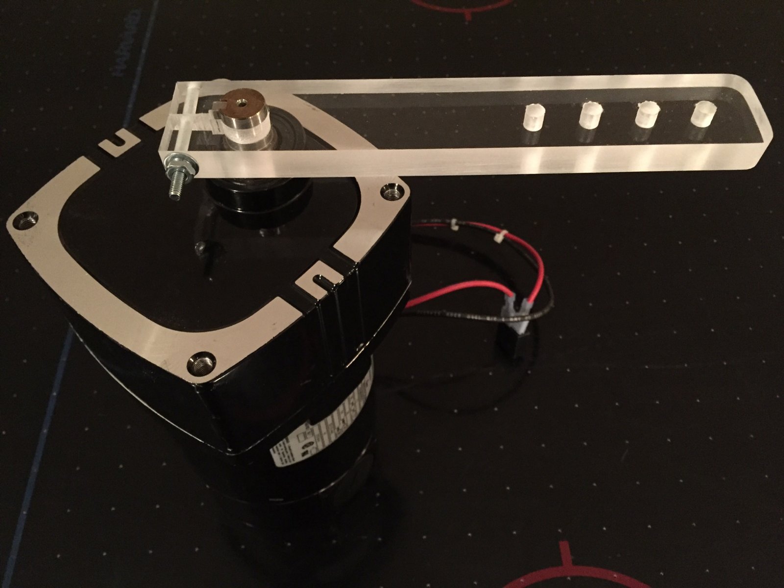

    Working on the lever arms. This is the short one that will probably work for roll, but I think is too short for pitch. Made out of 1/2" acrylic since it was easy to work with and my local plastics shop practically gives away small pieces like this (this piece was about $0.25 USD). Hopefully this will be strong enough, since I'm not sure I could make the equivalent out of steel. Aluminum maybe, but that would be an expensive piece.

    I don't know how strong are these acrylic levers but I would advise making them at least with 4mm thick iron or steel.
    Your most vulnerable point, is around the hole that fits the motor axis.
    • Agree Agree x 3

    @pipis2015 I think you are probably right that the acrylic isn't strong enough, even at 1/2" (13 mm). Acrylic tends to crack. But for now it is cheap and easy to work with, so I'm considering it a mockup piece. Once I have everything assembled and the dimensions right for the lever, I'll try to replace it with something stronger.
    The problem is, how do a make a lever out of steel? I don't think I could cut out something that matches the keyway out of steel. I was thinking I could buy a collar with the keyway already cut in it and weld the collar to my lever, but I haven't found a collar like that yet. Or should I ditch the key and use a collar with a set screw. I could probably flatten the motor shaft if the set screen didn't work with the keyway.
