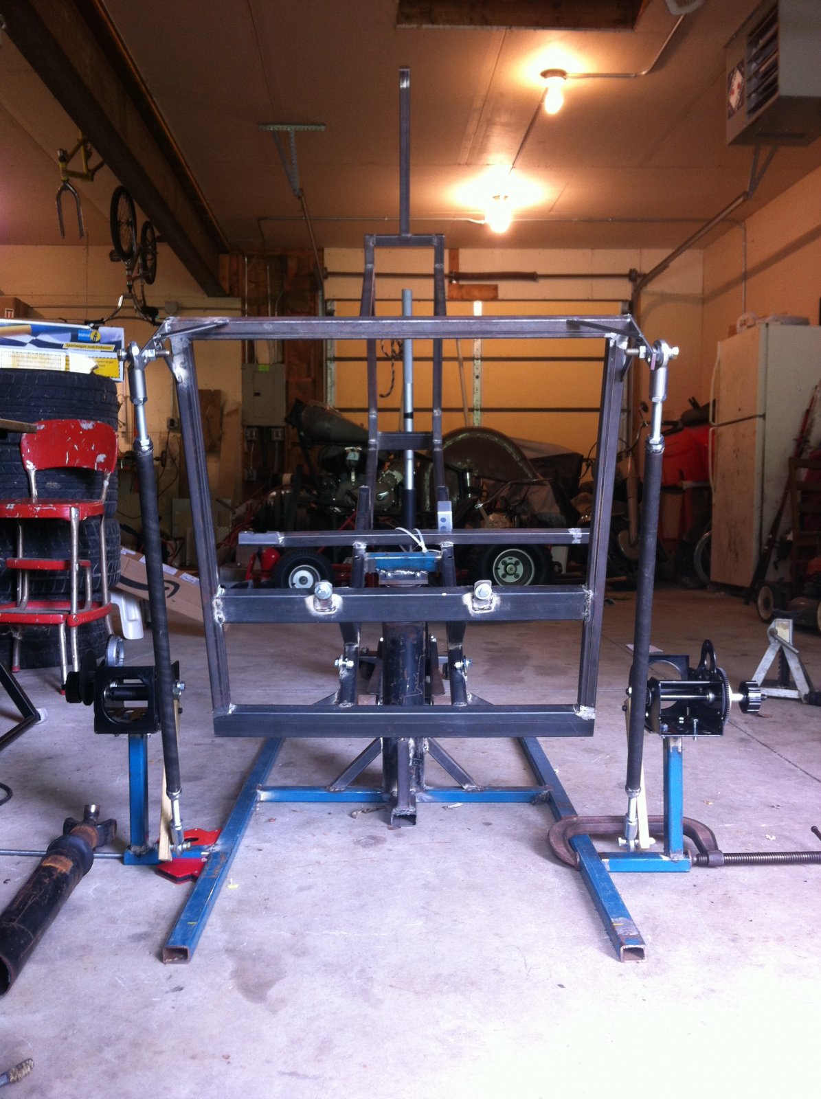

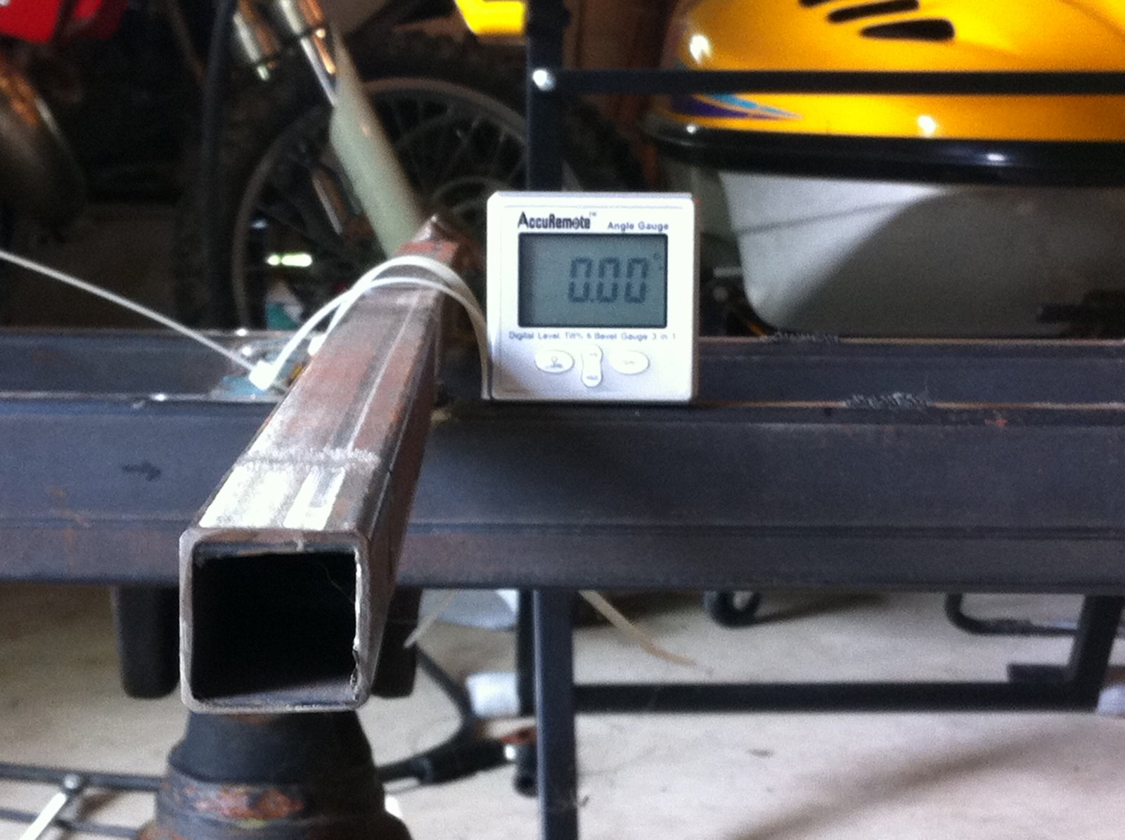

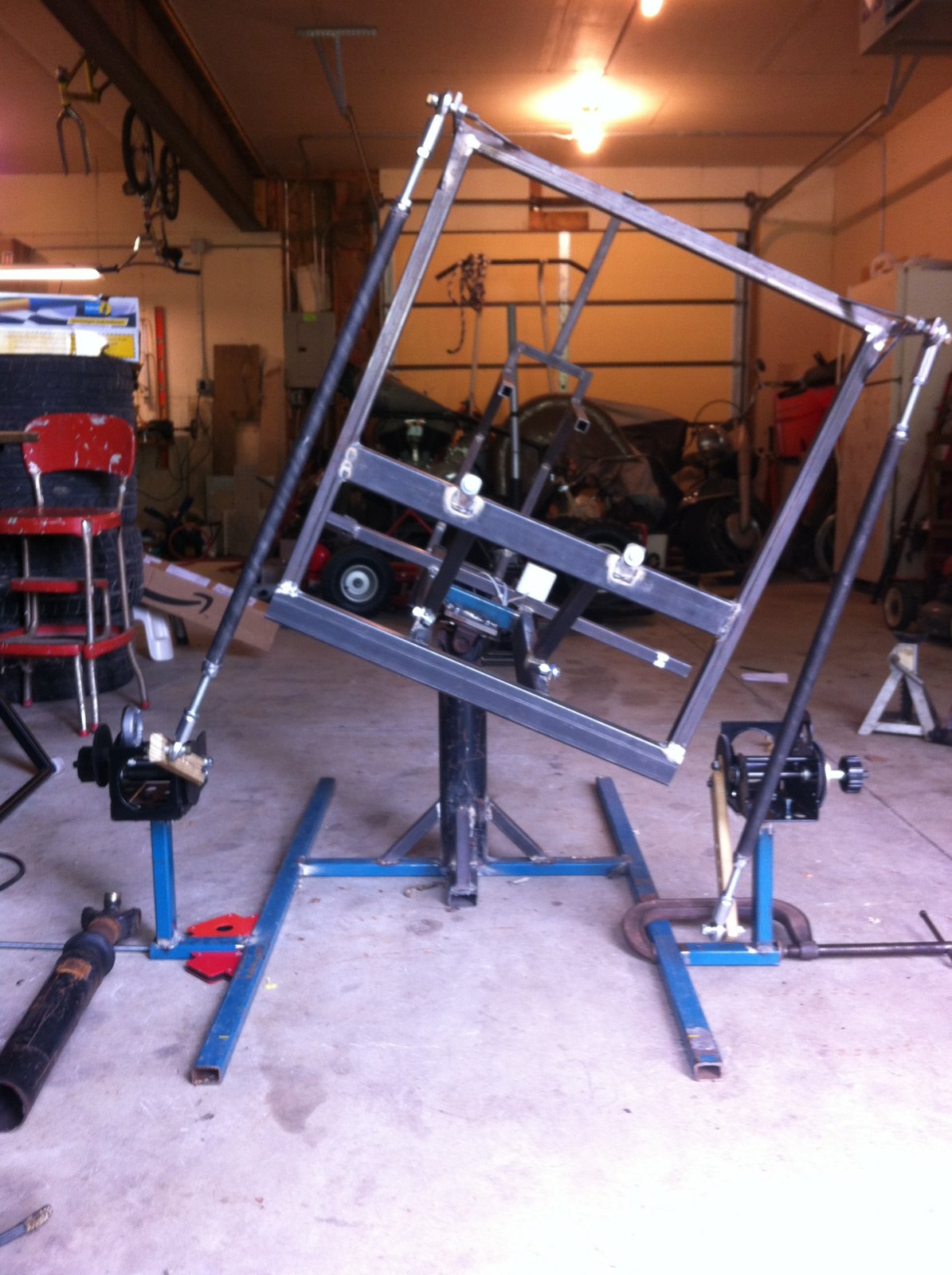

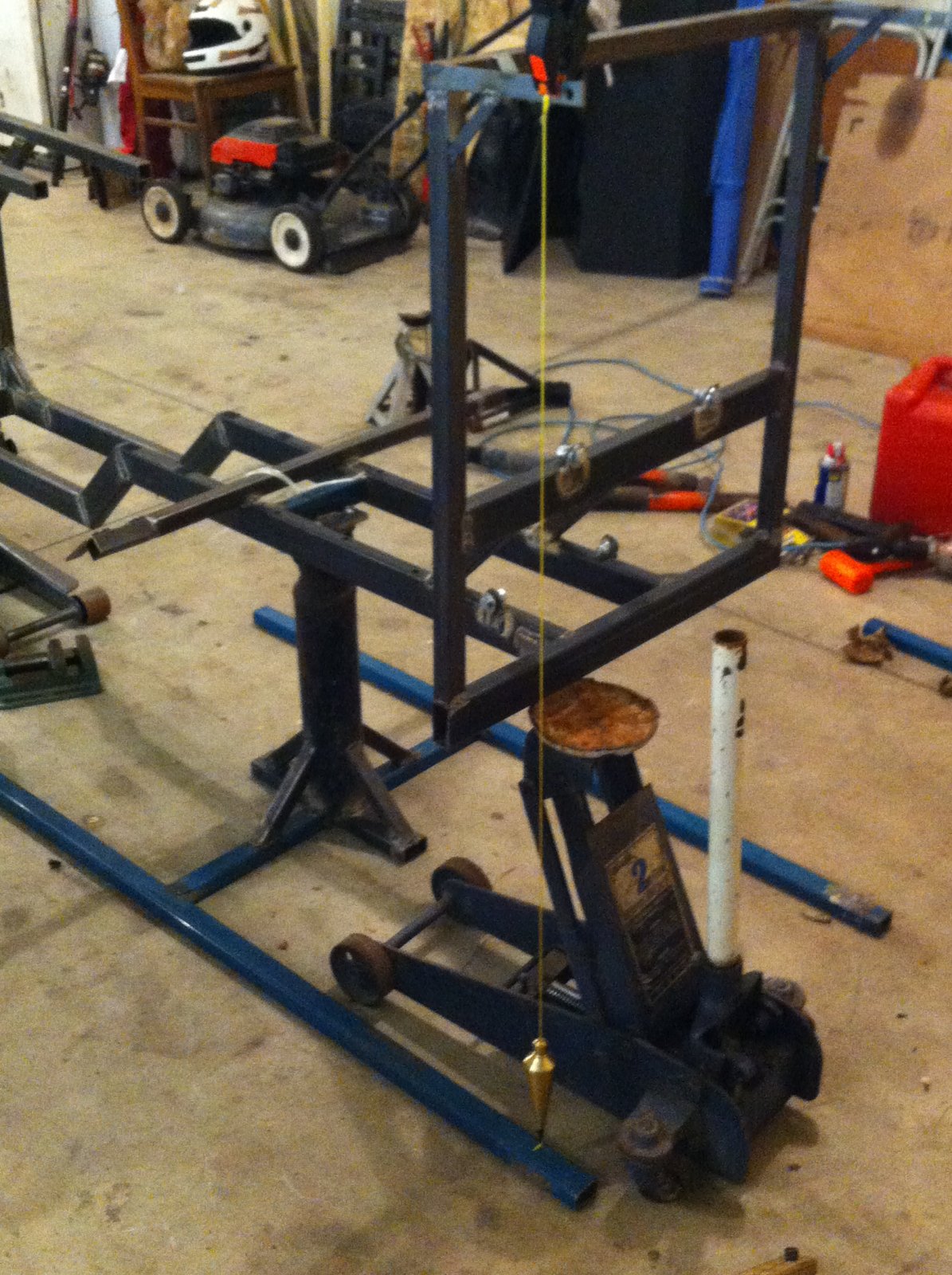

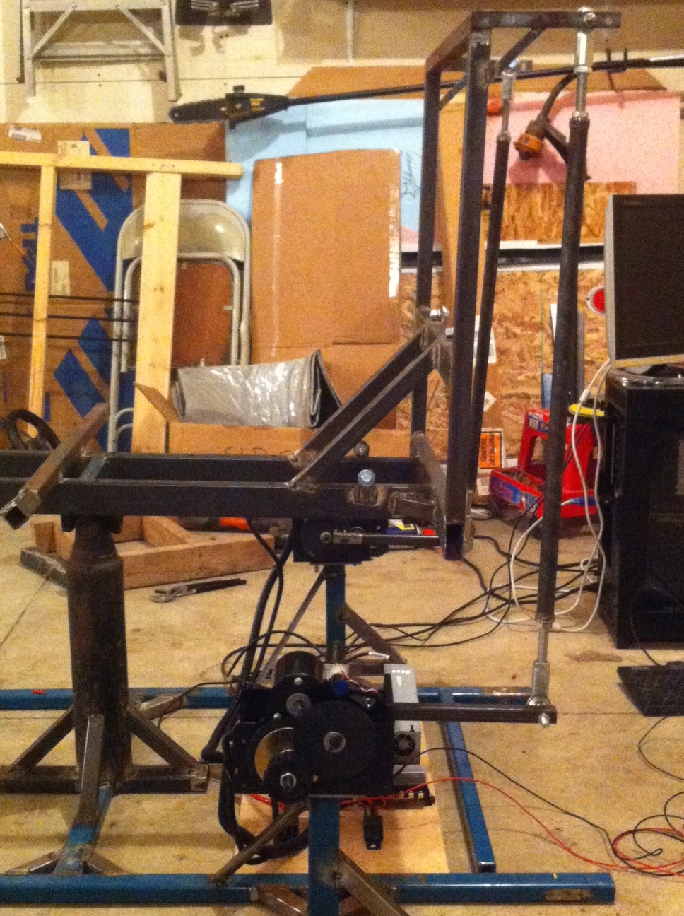

    2DOF, JRK

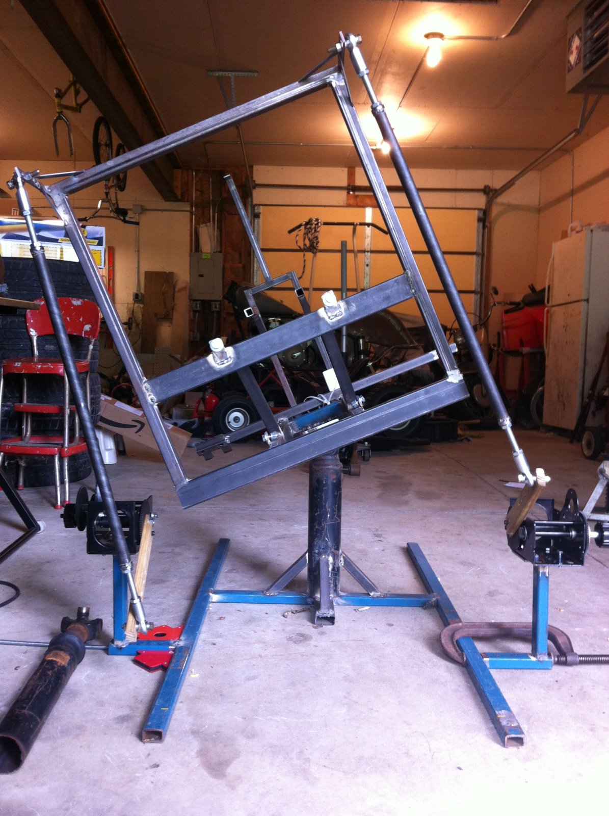

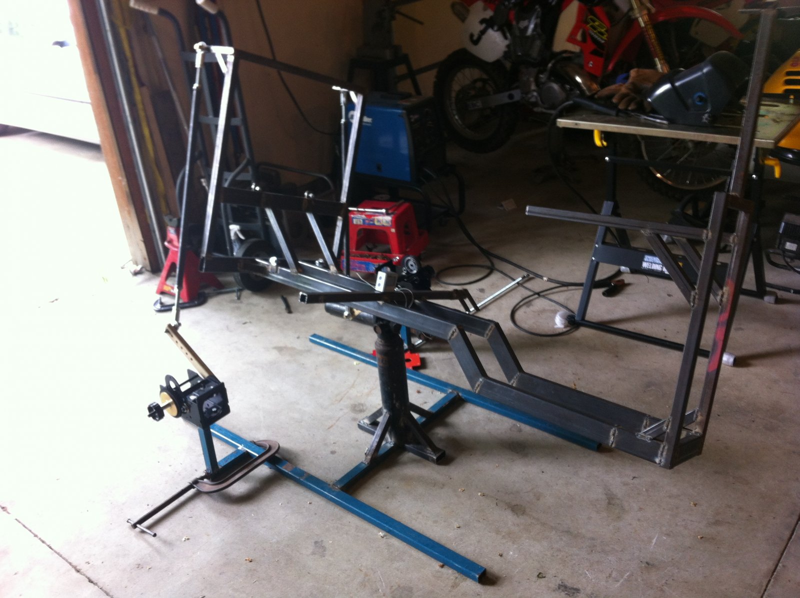

    A small update showing a potential placement for the motors. The first image shows a plumb bob hanging from the upper mounting location with the frame parallel to the floor. I started with the motor arm axis of rotation directly in line with that mark, but that seemed to limit some freedom of movement of the frame at large angles. I actually went quite a bit forward of this to get what I thought was the best (at least better) range of motion. Here are the initial resultant angular travels with a lever arm of approximately 10" (That's 254mm or +6 times more than the recommended arm length; should I mention here I still really don't know if this will work o_O ) A video is at the end
    • Pitch Up : 24.95 deg.
    • Pitch Dn : 23.15 deg.
    • Roll L : 22.85 deg.
    • Roll R : 23.90 deg
    Transposing the upper mounting location to the base
    Frame level to the floor
    Pitch Up
    Pitch Down
    Roll Left
    Roll Right

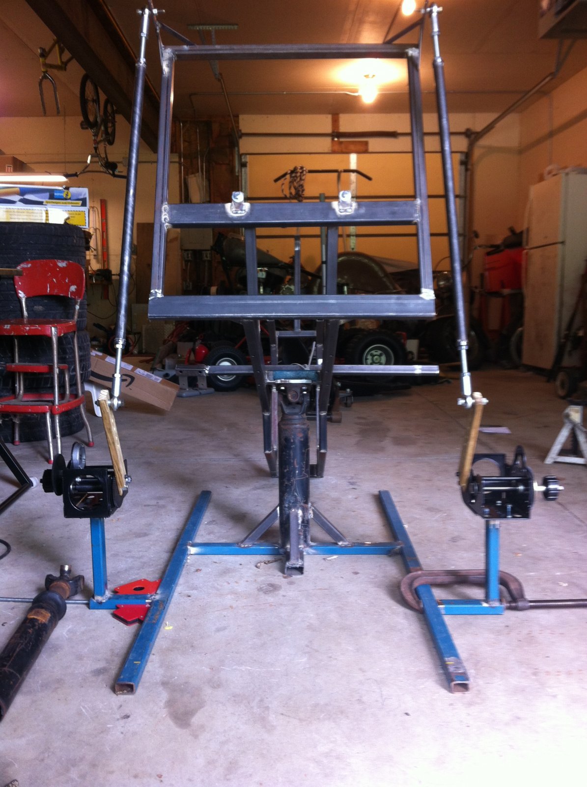

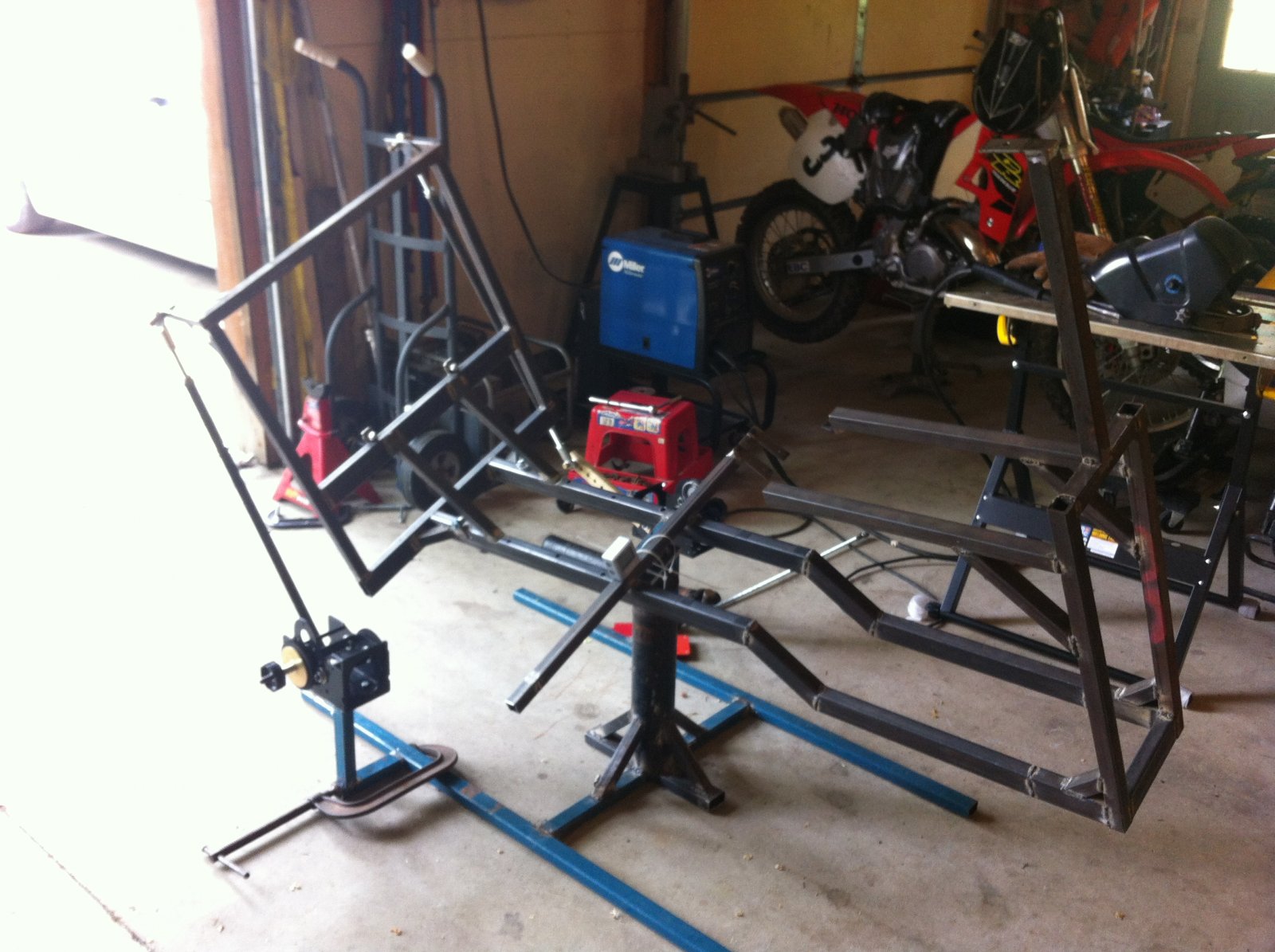

    WhooHoo!! It finally moves!! :D:D:D

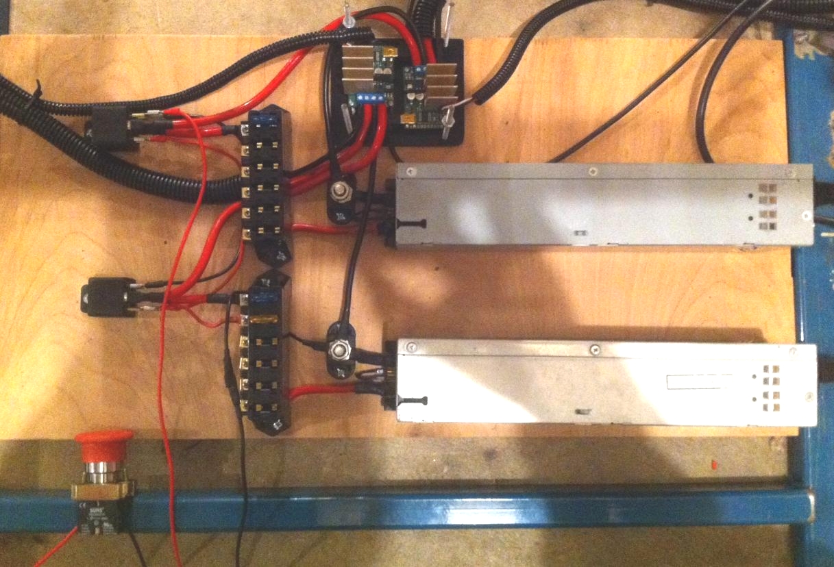

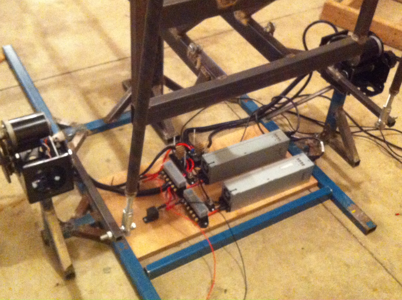

    So far about 4-5 hrs total running (setting up JRK's, AC profiles, DCS profiles). Everything so far has been with me off to the side watching closely for malfunctions since I'm using nearly full travel of what my system is capable of (in other words, if either Axis goes out of range bad things will happen to the mechanical pieces :) ).
    With heat sinks on the JRK's its about +10 degrees F above ambient during testing (No fan on yet and no weight other than empty frame on top).

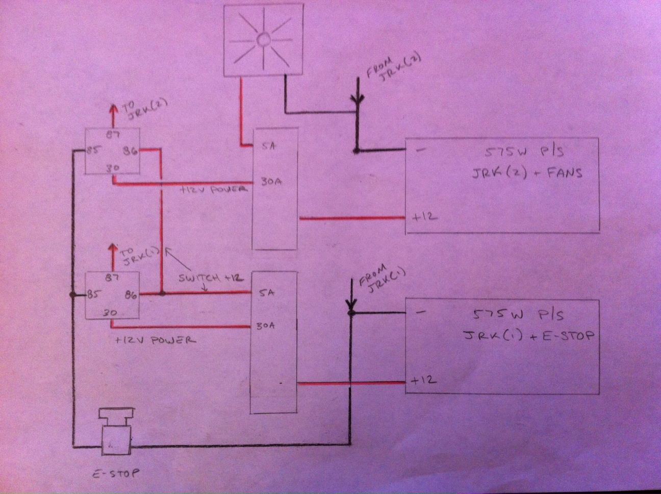

    From memory basic JRK configuration is : P=0.39 / I = 0.0 / D = 0.5 , Integral limit 2000, no acceleration or current limits. Only problem I had was when I reset the 'Learn' limits and somehow screwed up 'Detect Motor Direction' after that. For an hour I seriously could not figure out why the motor arms would accelerate as they approached the min and max limits :eek:. I have at least +50 successful uses on the Emergency Stop Switch which works perfect. One power supply controls the two 40Amp relays wired in parallel to turn the JRK's on/off. I'll let the other power supply run the fan(s).
    Profiles are currently 20% to 40% per DOF (pitch,roll,surge,sway,heave). So that means about 100% to 140% in total for what I tried so far (Again, all done sitting off to the side watching). I can see the tuning center will keep me busy for a while. I noticed that my power supplies would shut down when some of the in-game axis would go crazy back and forth at high frequency. To fix this I added 25% 'Smoothing' to the DOF and this Dampened the erratic behavior observed in Virtual Axis.
    That's about it for now. Before I get on the frame I still need to do a few things: Final Solder on the Pots, Solder JRK boards for AUX pin, A little more bracing on the upper frame for strength, a little more welding on the lower frame motor mounts to take the load. Thanks for looking

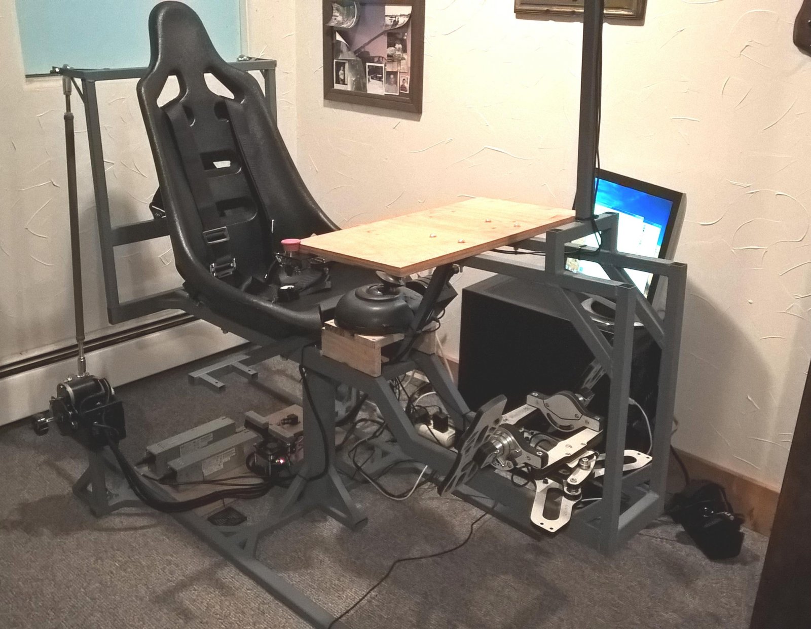

    Merry Christmas! Everything is up and running now. Here she is in primer grey :)
    Most of my time has been spent tuning DCS and with Oculus - Just amazing and can't wait for the next generation VR sets. I have to tell you guys, it feels incredible to light the afterburner on the DCS Mig-21 (surge set at 60% of 33 degrees) to be pushed back in the seat and then pull back in a high speed climb. You can see the seat belt system there which helps, plus it's cool just to strap it on before a flight :D
    What's amazing to me is that the JRK's do not get much over ambient, even with me out of balance to the rear. I was really worried about that initially with all of the travel I wanted, but these guys are running cool as can be.
    Have a Great Holiday Everyone!
