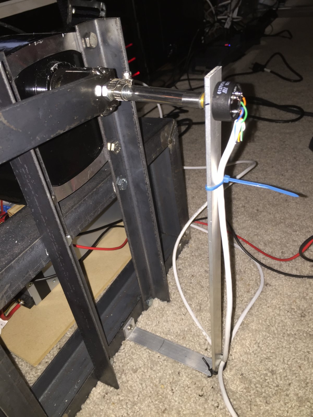

    Making progress, but slowly. Both motors can run freely and I've messed with the CTC of the levers until I have what seems to be a good range of motion on both axis, and still plenty of power and speed.
    Next step is to make the mounts for the hall effect position sensors. Since I have a single shaft gear head, the sensors need to come off the levers. This gives me the nasty possibility of chopping off the pot with the push rod if the motor takes off and makes a complete revolution. I'm going to use a hose attachment which will hopefully just pull off if that happens, instead of breaking things. The brackets themselves will be made of relatively light aluminum bar, which should bend out of the way if struck.

    @cgodwin I did this on an earlier rig and had over a year no problems with motor spinning out of control . The levers were made by bending a wire coathanger and soldering to a bit of brass tubing to fit the pot shaft. Not many degrees of movement for the pot but adequate if set up properly and safe for the pot. Just a suggestion. Good Luck.

    @Rastus - That is a very innovative solution that exactly addresses my issue. Thanks!
    I'm running 9" CTC (23 cm) so I would need the wire tracks to be at least twice that long. A little awkward at that size, but still probably better than what I planned on doing. My other option is to put the pots at the pivot points on the frame, and I did do the design to allow for that option. But in that case the pot is so far removed from the motor that I'm worried the motors will "hunt" or struggle to maintain position because of all the backlash / slop in the linkages.

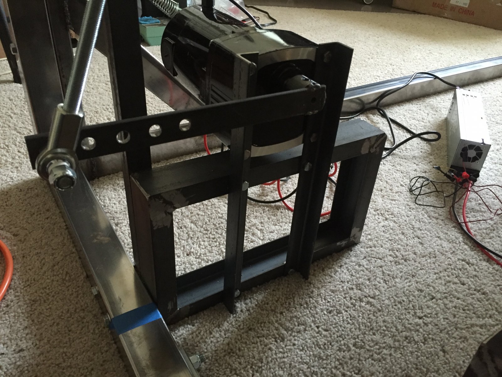

    A little hard to see in this photo, but here is my pitch lever assembly. The lever is 32 cm CTC since it operates almost 1 meter from the pivot point. The roll lever is "only" 14 cm. I think my range of motion will end up being about +/- 20 degrees in roll, and +/- 15 degrees in pitch. Not as much as I wanted for flight and roller coaster sim, but I think it will be enough. Any more than that and things start binding or hitting.

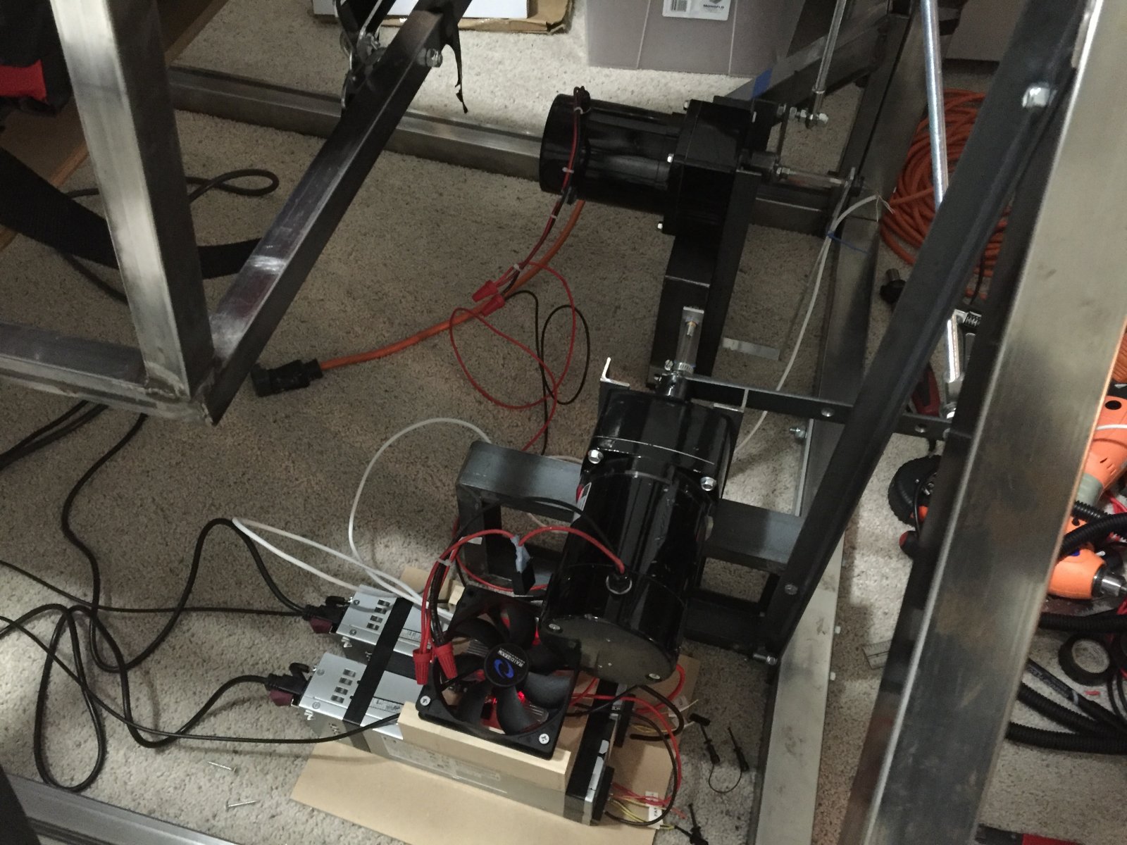

    I've been working very slowly on this. Just not a lot of time to devote to the build...
    But, today I got it running with Live for Speed! Took a while to get the JRK and SimTools software sorted out, but once I did it works amazingly well. What a blast!
    I'm having so much fun driving, I almost hate to take the next step in the build. Now I need to take the whole thing apart, make the enclosure panels, paint everything, and then reassemble it in a different room while sorting out all my cable management. Plus I really need to install my emergency stop switch.

    Here is my hall effect pot setup. I've got a 1/4" bolt coming through a hole in my lever arm assembly. I had some some extra 1/4" ID hose from my laser cutter that fit nicely over the pot shaft but was loose enough on the bolt to require a hose clamp. I've got 1" x 1/8" aluminum holding the pot. The idea is this whole assembly can flex to correct for any alignment issues, plus if my motor happens to go crazy and make a complete revolution it hopefully won't break anything important.
