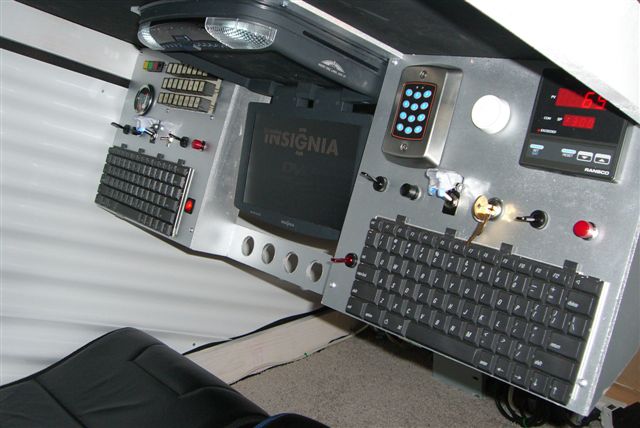

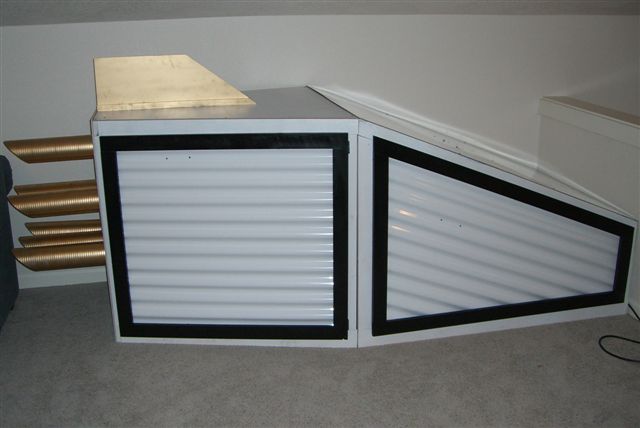

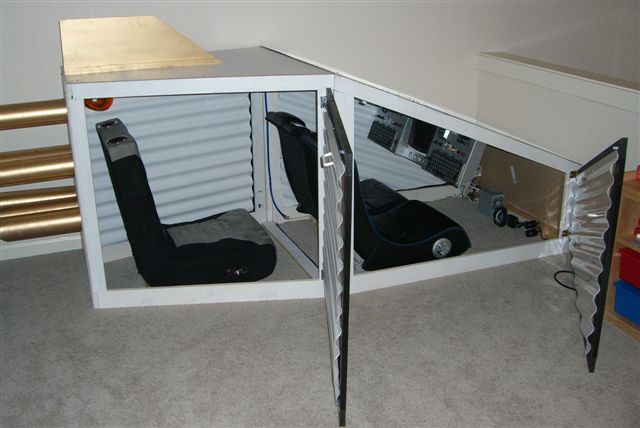

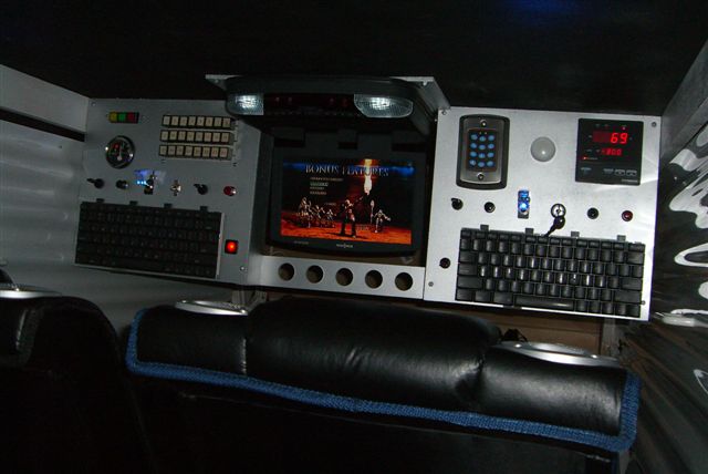

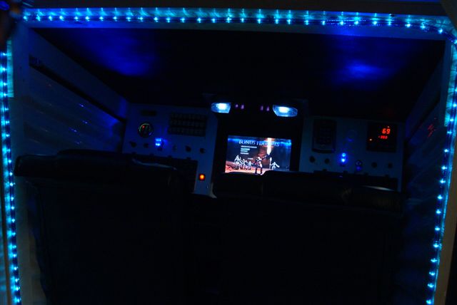

    Here is my old "simulator" which had to be disassembled to make room for the new one. Less a simulator than a static playhouse themed like a spaceship. Working knobs, buttons, lights, sounds, night vision camera, etc. But the kids outgrew it and it didn't move, so time to upgrade!
    21,740
    152,213Coins
    +11,065 / 56 / -2
    That is like the ultimate cubby house for grown ups...love it!

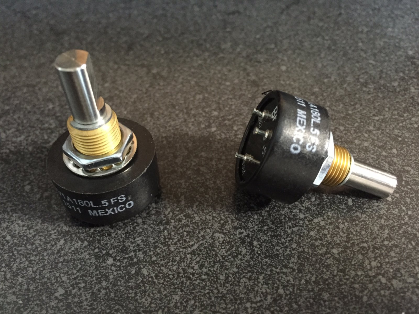

    Received two hall effect potentiometers today. $15 USD each plus shipping from DigiKey. That is really expensive for a pot, but not if they work better and avoid problems down the road. They are 180 degree sensing, but allow for 360 degree movement with no end stops. That is nice so I won't break anything in case my motors run away. Really smooth movement compared to a normal pot.
    The first odd thing is there is no zero mark. And then there is the question of what happens after it reaches 180 degrees? Does it just peg at 0 or 5V for the other 180? The only thing I can do is hook them up and run a few tests to see how this thing works. The datasheet provides no help at all.
    The question for the group is where do I mount these on a Joyrider? I can put them at the pivot points on the frame, which should provide the most accurate positioning for the rider. But if there is a lot of slop (backlash) in my drive levers, that could cause the motors to oscillate trying to hit or hold a position. Placing them right at the motor shaft probably means more consistent control of the motors, but lack of accuracy for the rider. Pots at the motor means my lever assembly needs to work symmetrically, especially on the roll axis to make sure it rolls the same amount left and right.

    I ran some tests on the hall effect potentiometers, and got those sorted out.
    Pot: TT Electronics 6127V1A180L.5FS - http://www.digikey.com/product-search/en?keywords=987-1392-ND
    What I'm calling the 0 degree position is the flat on the shaft facing directly opposite the anti-rotation pin and Vout pin. I'm working with a clockwise rotation.
    0-90 degrees = Constant low voltage 0.21 V
    90-270 degrees = Voltage increases with clockwise rotation to 4.88 V
    270-360 degrees = Constant high voltage of 4.88 V
    Once the pot hits the 360/0 degree mark, it makes a sudden drop from 4.88 to 0.21 V
    This is a nice setup, since it means if you overrun your 180 degree range of motion, you have an extra 90 degrees before something ugly happens.
    My second hall effect pot was just a tiny bit different, with a 0.21 to 4.84 V range.

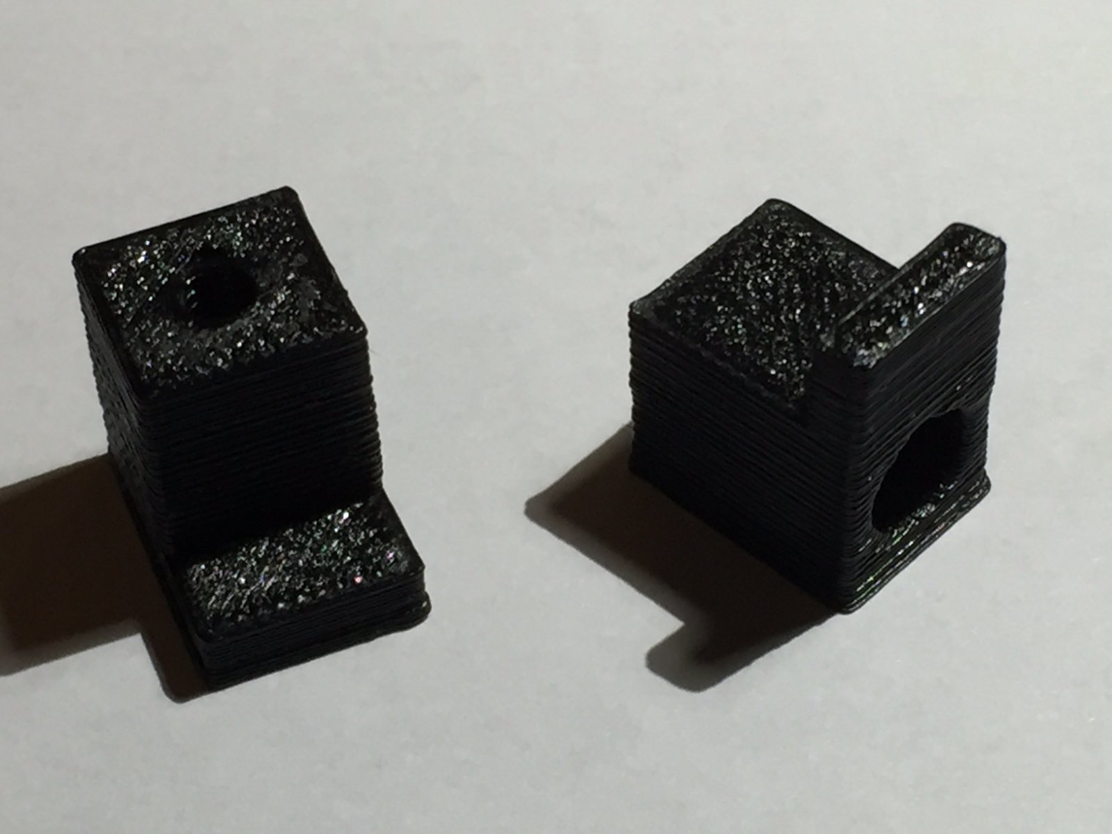

    Not much of an update today. Just 3D printed some guides so the sliding cover for my enclosed cockpit will stay centered. These are small - about 1/2" square. I could have made these by hand, but a nice excuse to use the 3D printer for something useful.

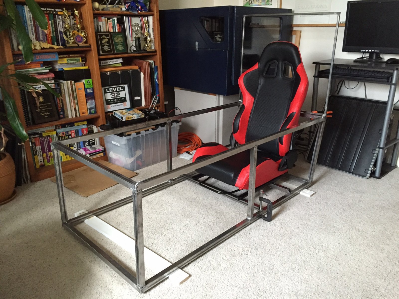

    Very slow progress recently, but I'm finally getting back to it. Got my new gaming PC, got JRK's on order, and purchased enough steel to finish the middle and outer frames over the next few weeks. I've sorted out the positions of the seat, monitor, and various controls. The balance point is pretty far back, but that shouldn't be an issue. Not sure where it balances vertically yet, but I'm planning on rigging up a test this weekend. IMG_1499.JPG

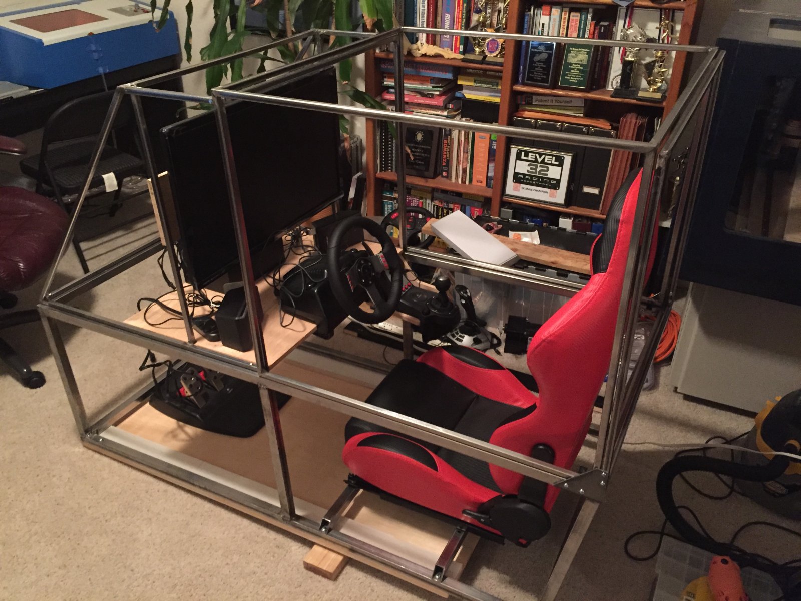

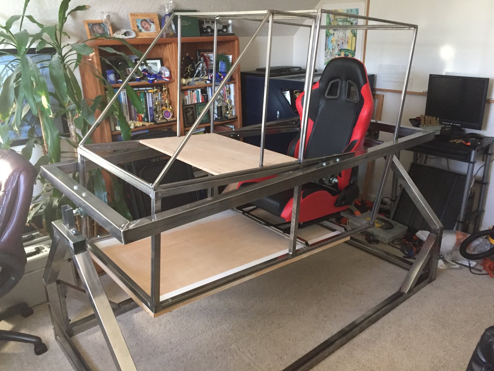

    Finally got the time to weld up the middle and outer frames. Right now it balances out really well, and takes surprisingly little effort to move with a person in it. But a lot of the components aren't mounted on it yet. Just sitting in it and having it roll and pitch with slight body movements is already a lot of fun! There are nothing that limits the range of motion yet, so I've been lucky not to flip it upside down and smash my head on the ground yet - something that would be really easy to do.
    Now I'm working on the motor mounts. That is a big step, since once those are done I'll finally be able to tell if motors can actually move this thing.

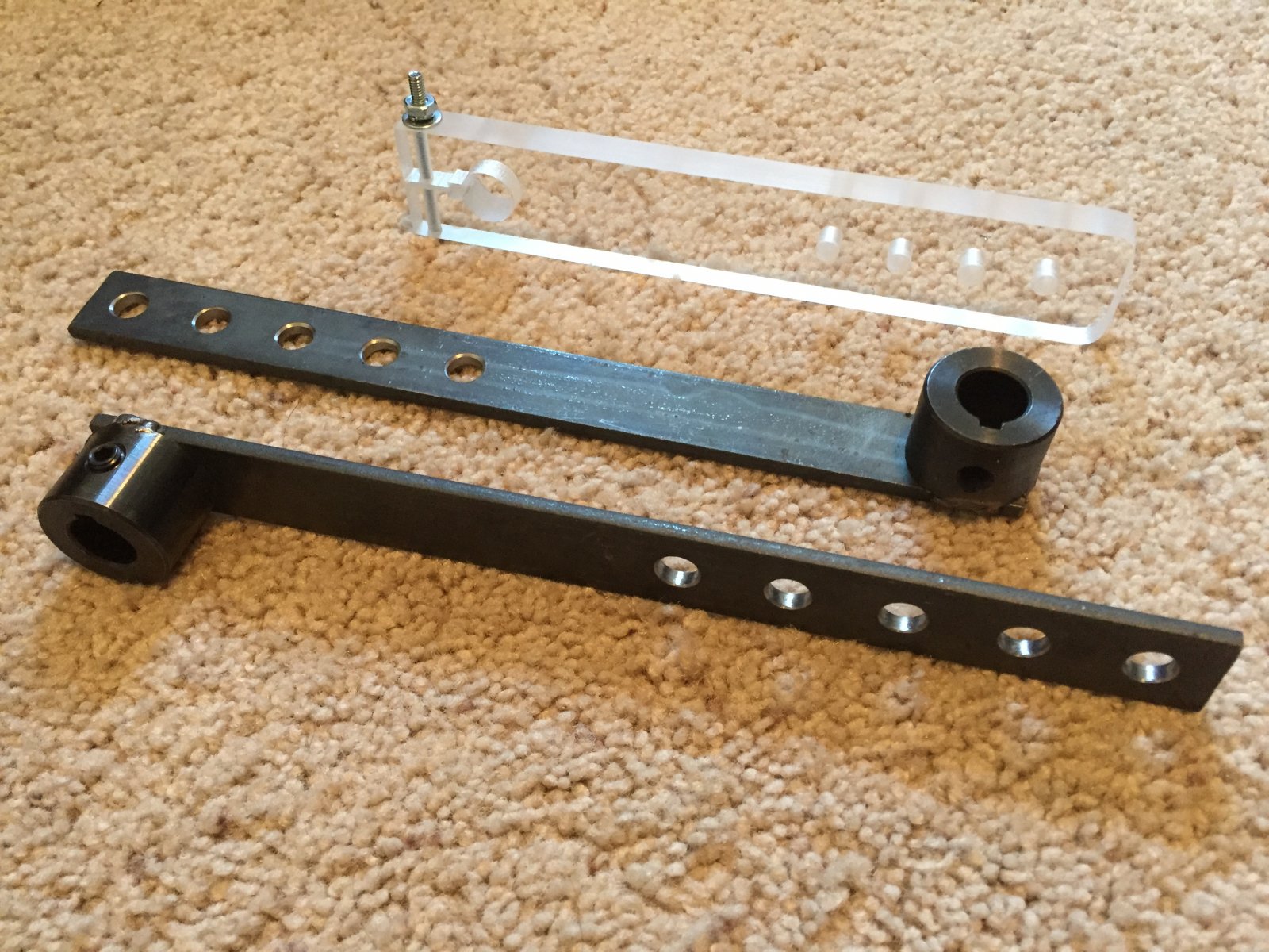

    I decided not to wait to see if my 1/2" acrylic motor lever was strong enough. Once I got the frames assembled are realizing how much weight has to get thrown around, my gut was telling me that even a thick piece of acrylic was likely to crack right away.
    Following a tip from @noorbeast I got a ridged coupling, cut it in half, and welded those to some 1" x 1/8" steel. No question these will be strong enough. I'll be cutting at least 1" off one of these for the roll axis so both motors can make a complete rotation and not hit each other.
