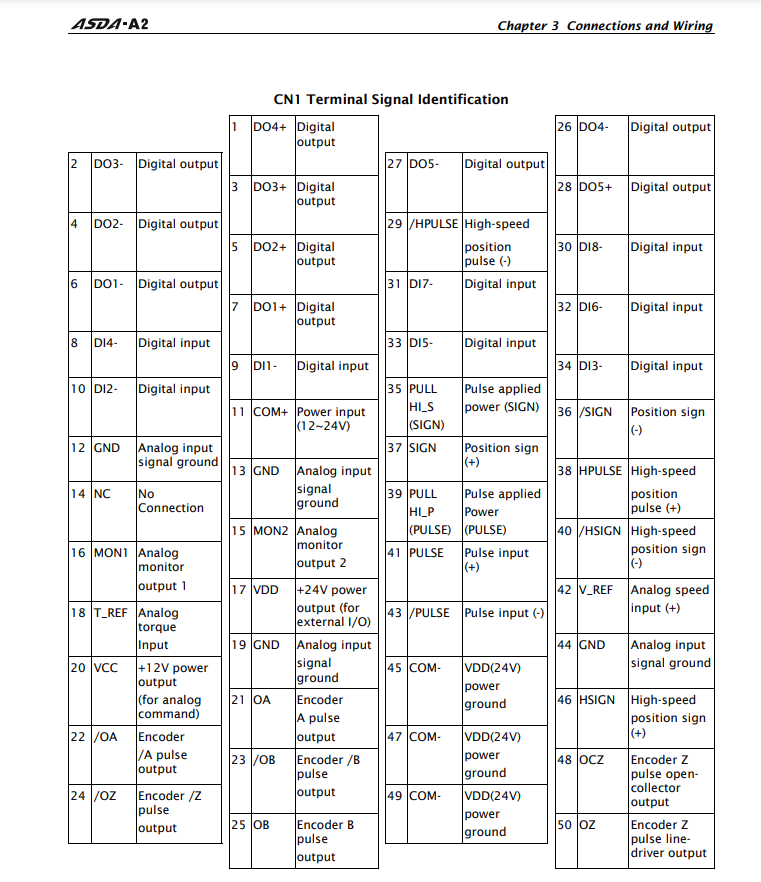

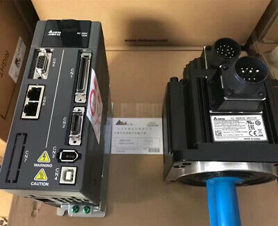

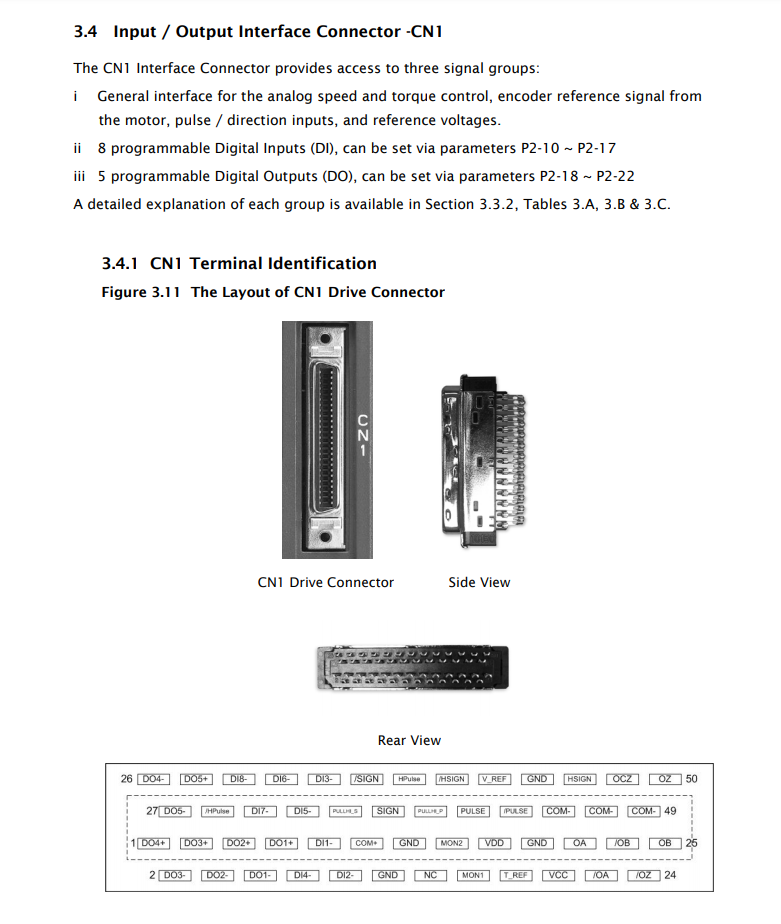

    I have two ASD A2-1021-M servo drives and two ECMA-E11310QS motors. I want to make a 2dof simulator with these products. I will play a video. So I will use Video Ride Creator and Video Ride Player. I have arduino mega, arduino uno and stm32f4, which one should I use? From what I read on the forum there are those who use arduino mega with servo motors.
    https://github.com/tronicgr/AMC-open-hardware-servo-controller-4DOF
    I understood that I can use servo motors with the product shared on this link. But I could not figure out which connections should I make in my quitch. This product is made for 4dof systems. and custom tuned to a servo brand. but how should i connect my drivers with auino mega to video player?
    I would be very happy if you could help.
    datasheet of my servo controller:
    https://www.deltaacdrives.com/Delta-ASDA-A2-User-Manual.pdf
