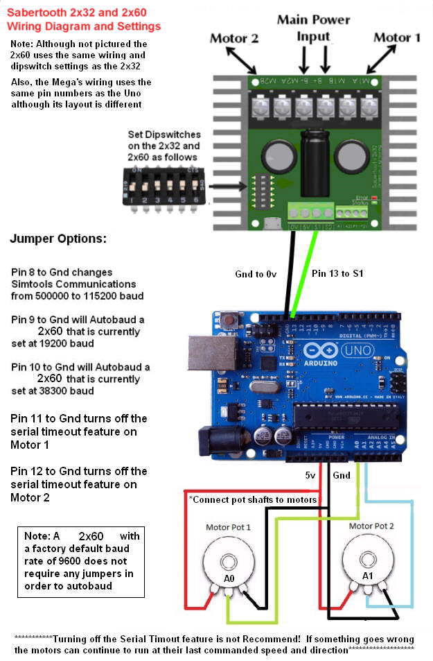

    Hey Mirko,
    You have your emergency stop switch wired in series with your power supply so its current will be flowing through the emergency switch. Does it have a high enough voltage and current rating for line voltage/current? You'll also be running line voltage/current to wherever your emergency switch is located. Most setups I've seen here have the emergency stop using low voltage and in the circuit where your power and secure start switches are located - but I am not familiar with your power supply so can't comment on if those are wired correctly or not.
    I think you need another signal wire on the Sabertooth from the Arduino.

    About the Arduino to Sabertooth connections, I don't actually know. I don't have Sabertooth circuits or Arduinos to have looked into that. Edit again - it's high level comms so two wires is fine Mirko. I was thinking the Arduino was outputting a PWM signal like it does with MonsterMoto boards but the Sabertooths are smart. Forget what I said about those Arduino to Sabertooth connection not looking right.

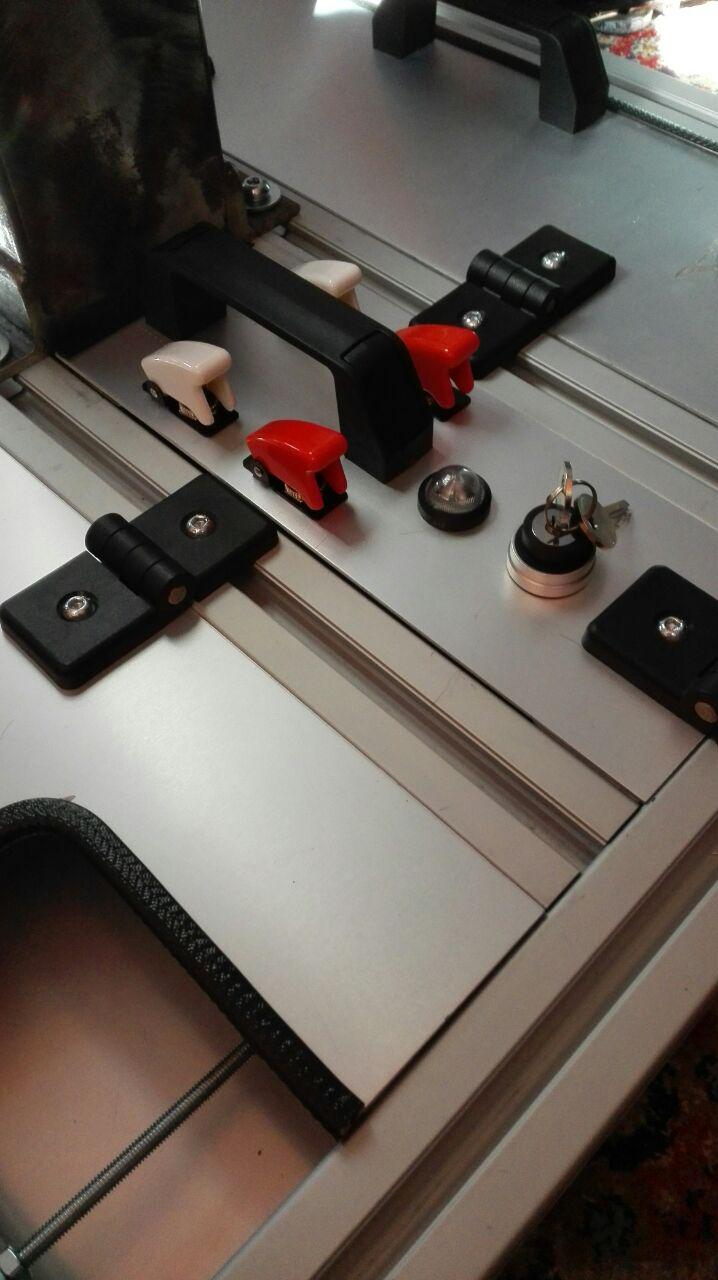

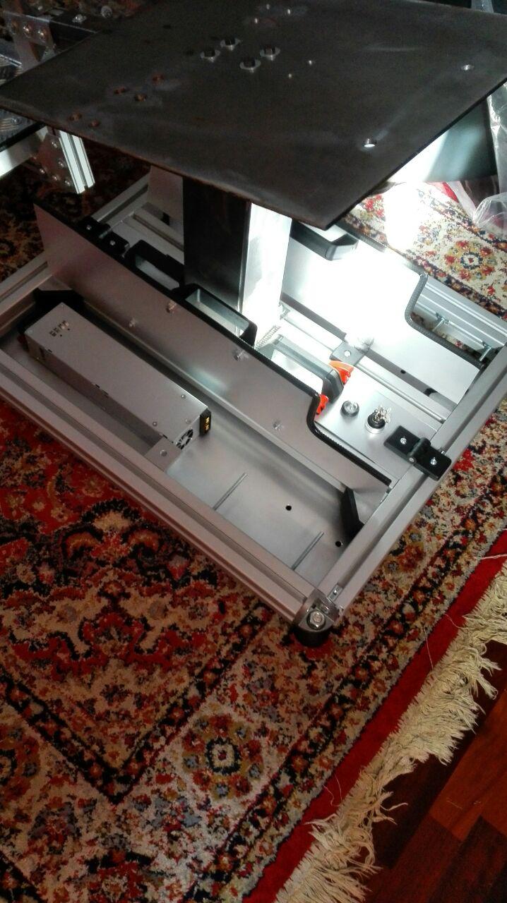

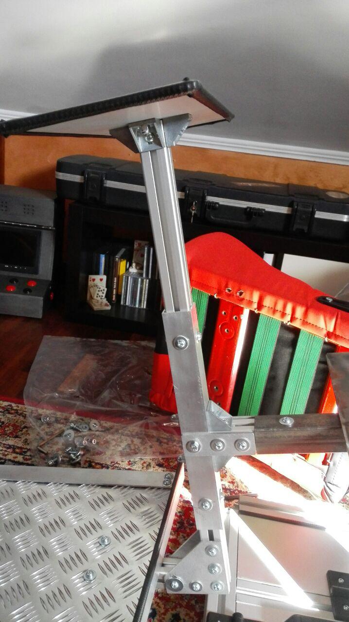

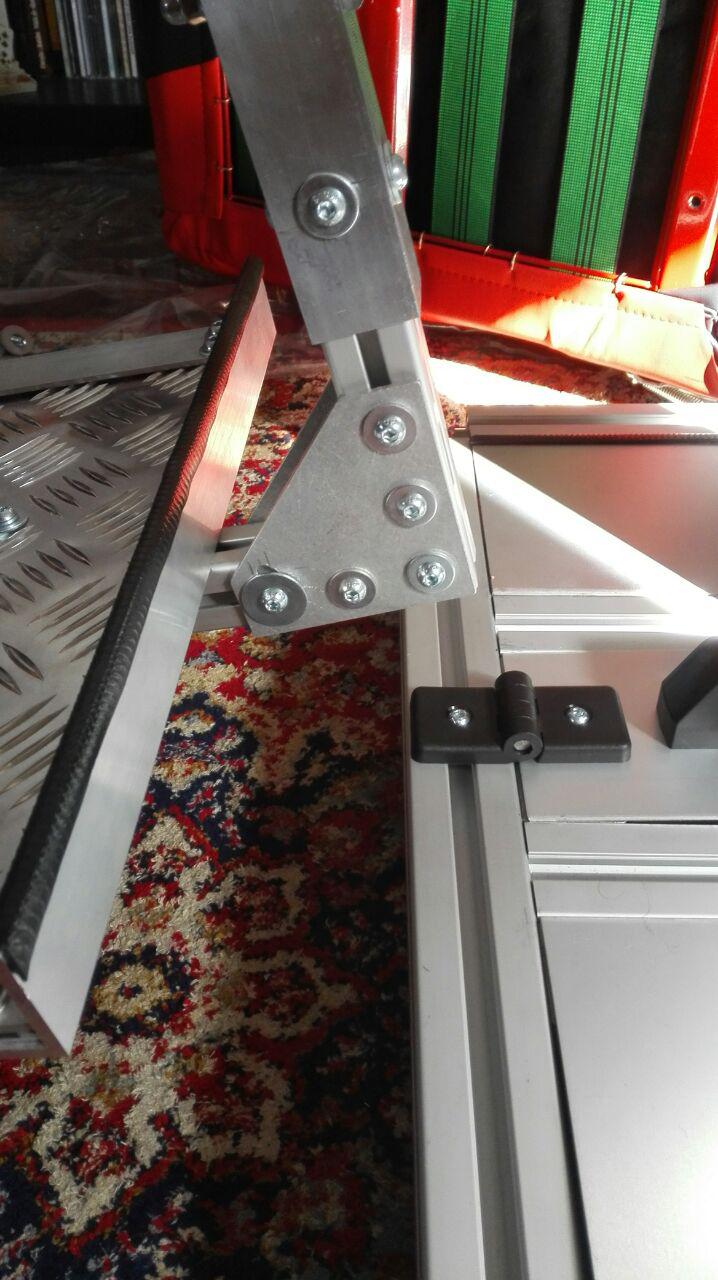

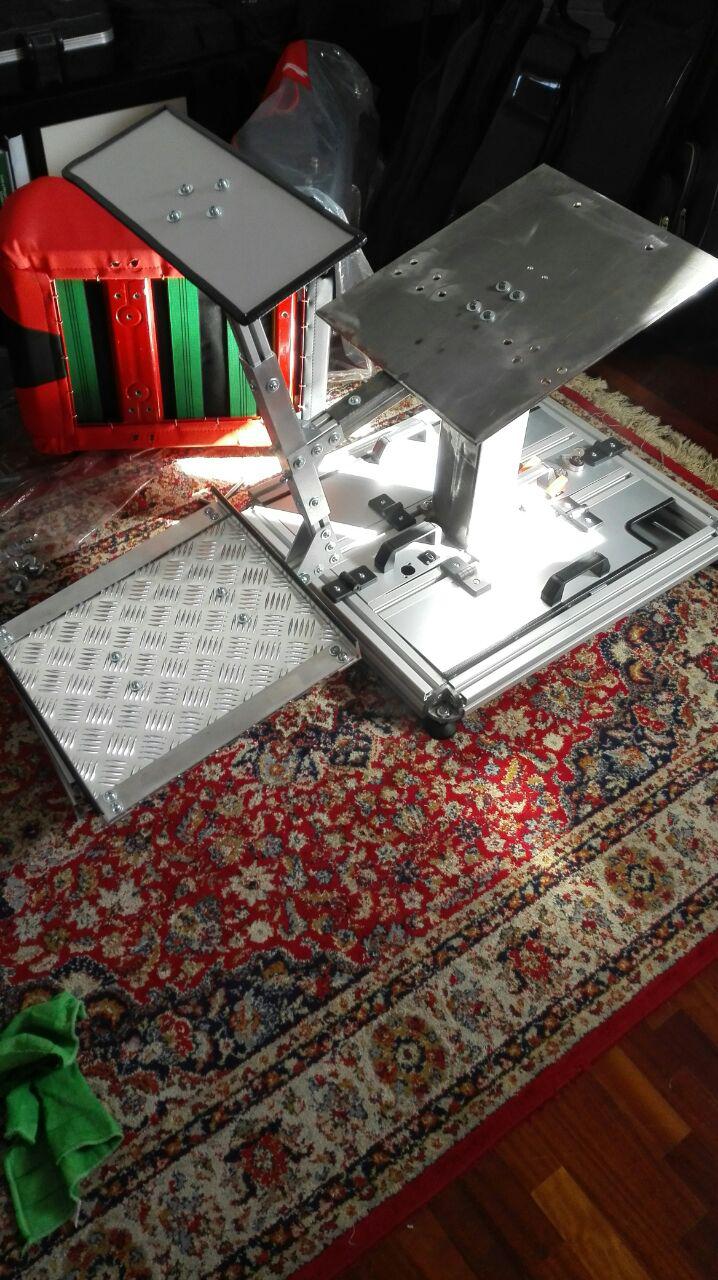

    Little updates to my sim... I need to make plates for hall sensor and after that, I can say that mechanical part is near the end.
    With this kind of connection, I can give to my pedal plate different angles:
    To change size of any part of my sim, I should only screw 4 bolts:
    Inside I can hide all of my electronic connection:
    I have one master key and one led (will be connected to pins of my HP DPS 600, to give consense to start PSU). Regarding 4 buttons, my original idea was to connect them to give separate consense to 4 fans (2 for JRK and 2 for motors)... maybe it's a waste of space to use 4 button for 4 separate fan, so i'm thinking if I can use one button for 2 motor's fan and one button for 2 JRK's fan...but I don't know now what to do with other 2 buttons.

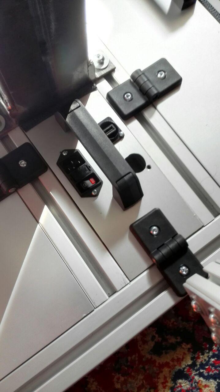

    Here my Alim port with 2 USB ports (for JRK). I must buy other USB port panel. I've bought only one alim port because in my original plans I was think to use one DPS600. Now I want to use 2 JRK, so I need 2 power supply.
    I don't know what I can buy to split signal from power panel and sents it to 2 PSU... I don't think that a Power strip can be inserted inside my simulator.

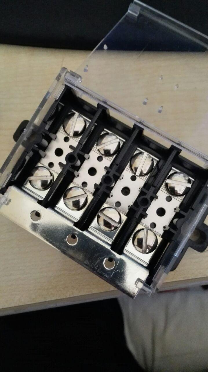

    With this barrier I can take signal comes from my power supply and send it to JRK, fans and other things
    at the same time. It's rated about 60A, so no problem.

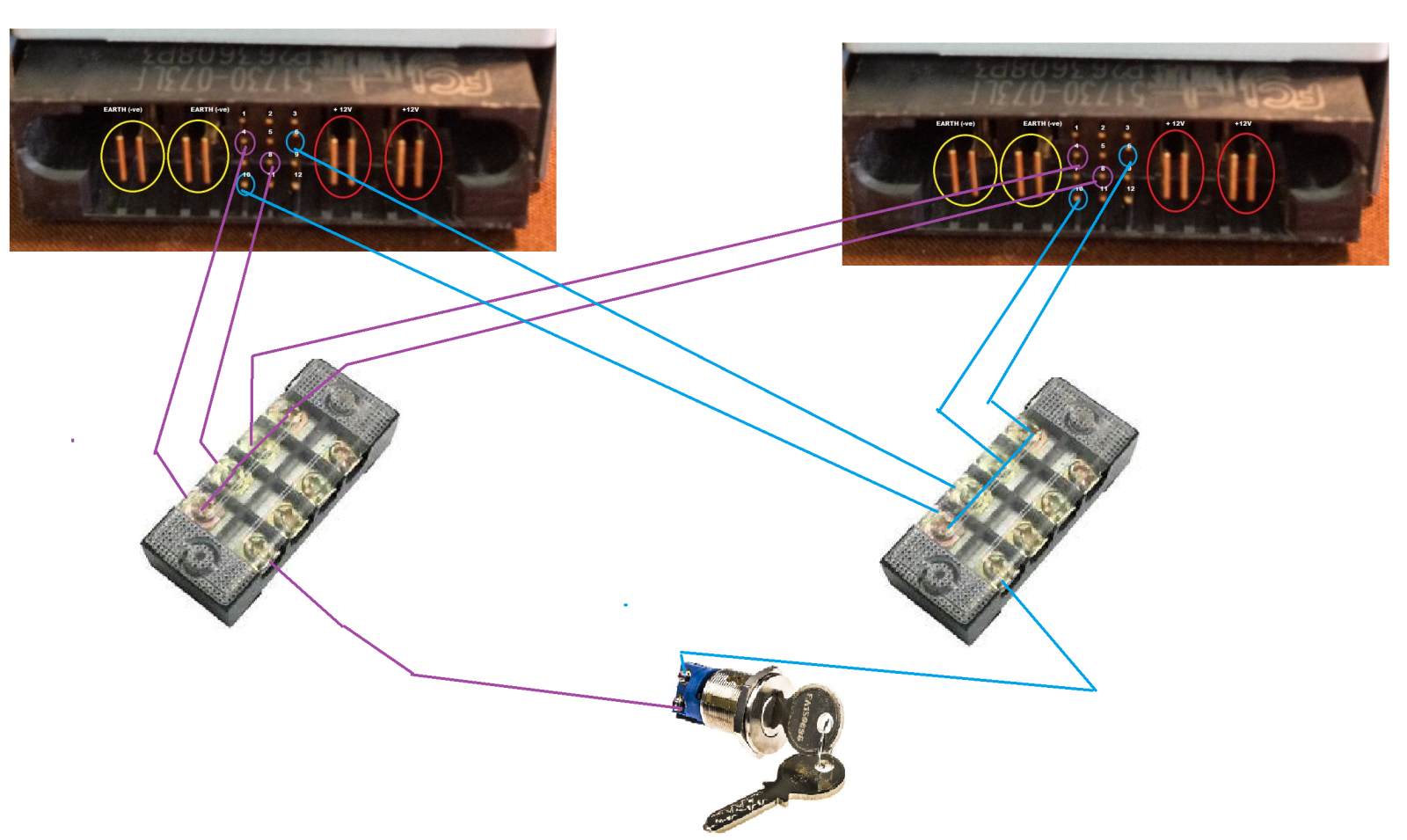

    Hi to all,
    Can this schema (very bad :D ) works? I want to give the start to my 2 PSU (HP-DPS600) with only one key.
    Thanks to all :D
