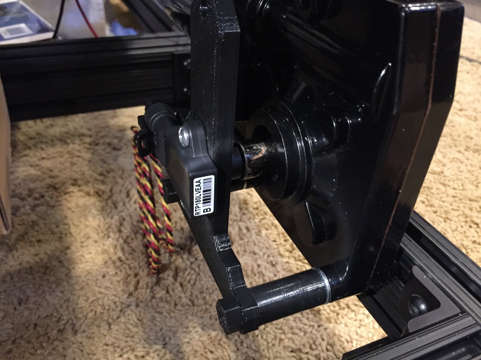

    @mirkobastianini & @Bastiuscha - the Hall sensors I'm using are Honeywell RTP180LVEAA 180 degree sensors. I know Mouser.com and Digikey.com have them. I am certain they will work fine but have not actually used them yet to say for sure. Use them at your own risk. I'm still waiting on some parts and the time to finish the hookup but will let you know as soon as I do that they work, if they work. If you decide to go this route you will also need the connectors and contacts:
    https://www.digikey.com/product-det...ity-solutions/RTP180LVEAA/480-6128-ND/5252730
    https://www.digikey.com/product-detail/en/te-connectivity-amp-connectors/282087-1/A105021-ND/1860707
    https://www.digikey.com/product-det...-amp-connectors/282110-1/A105220CT-ND/3440490
    Note the red secondary locking bar for the contacts in the product photo at DigiKey. If that is pushed in, they won't insert. You need to have that pulled out as shown in the photo to be able to set them in the connector.

    Ok, if it's possible I have 2 questions:
    1) With Hall effect potentiometer, I need to fix this potentiometer to motor? Or I can fix it where I want in the simulator? I ask this because I can't welding or print in 3d nothing. Maybe I'm not fully understand how the hall effect potentiometer works... If I must fix into motors, what I can easy invent?

    The bracket holding the potentiometer should mount to the motor. The motor will twist and torque against your frame. You don't want to transfer that to any pot or encoder. Just a few degrees will quickly destroy a pot.

    Ok, and this is necessary even if I'm using @Zed potentiometer? Or Can i not fix this kind of potentiometer to motors?
    I'm try to understand wich choice is better for hall potentiometer..
