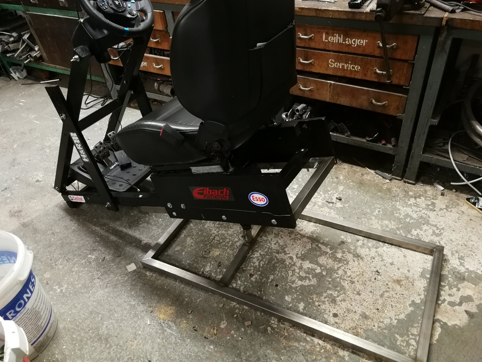

    I would like to build a 2dof platform below my exsiting playseat made by timber (see pic).
    As I am not expereinced with welding, I would like to use as much lumber as I can.
    I am still reading in this forum, but my plan is do have the complete motion platform below the exsiting playseat, so no shoulder holder.
    what do I have taken into account for this with regards to motors etc.
    With software, arduino, raspi, ... I am experienced, but not with mechanical design, motors etc.
    looking for some help of you

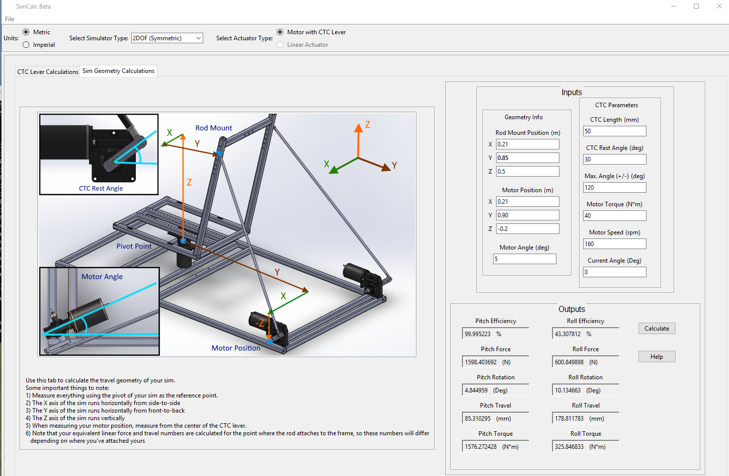

    So, here is my first outcome of SimCalc.
    Irritating for me is, that the geometry info is in metres, where other values are in millimeters.
    Can somebody check if the values make sense ?
    I don`t have frame or motors yet, just starting to think. So I took the default values for the motors and enter only the x,y and z coordinates for pivot, motor and rod.
    Is this feasible ?
    Thanks,

    Ok, as the degrees are very low, I increased the CTC length. Now it seems better...
    Any idea, if this is feasible and which motor to choose and where to get rods ?

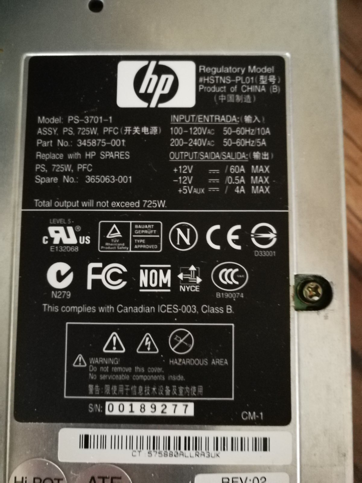

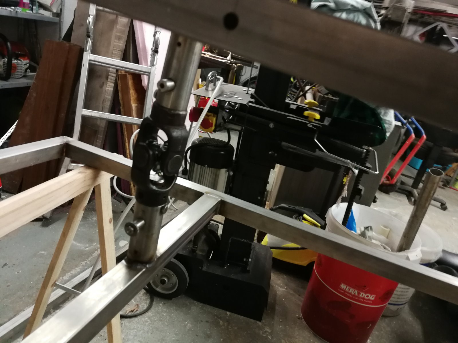

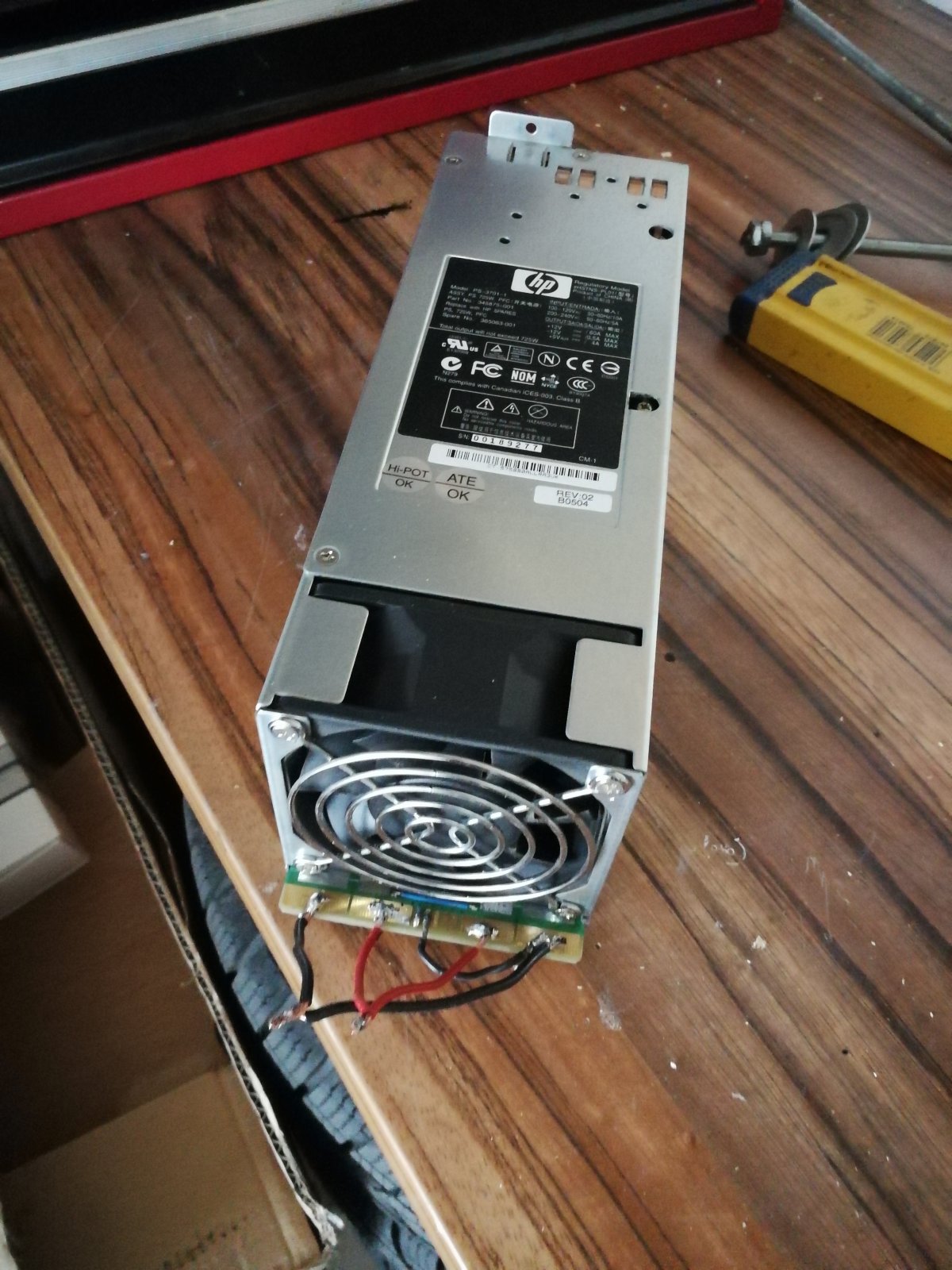

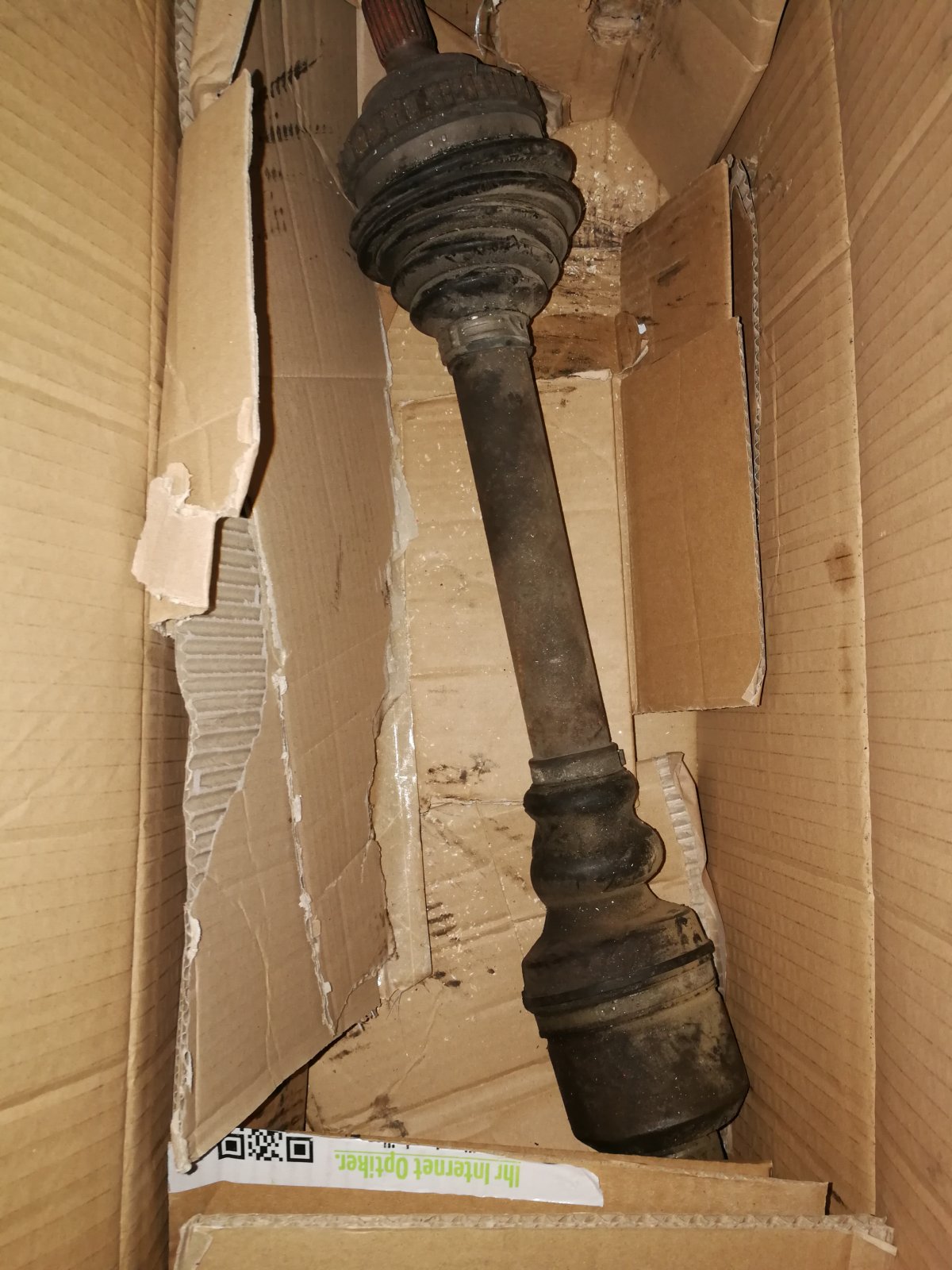

    Here some Pics from the U joint and the server PSUs.

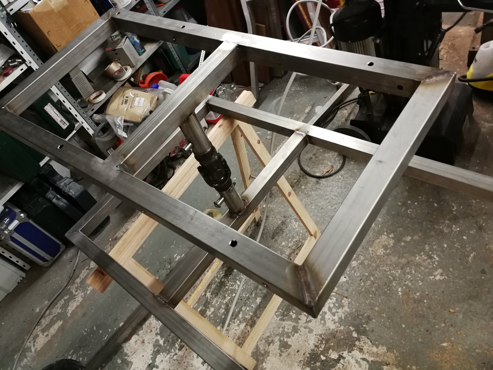

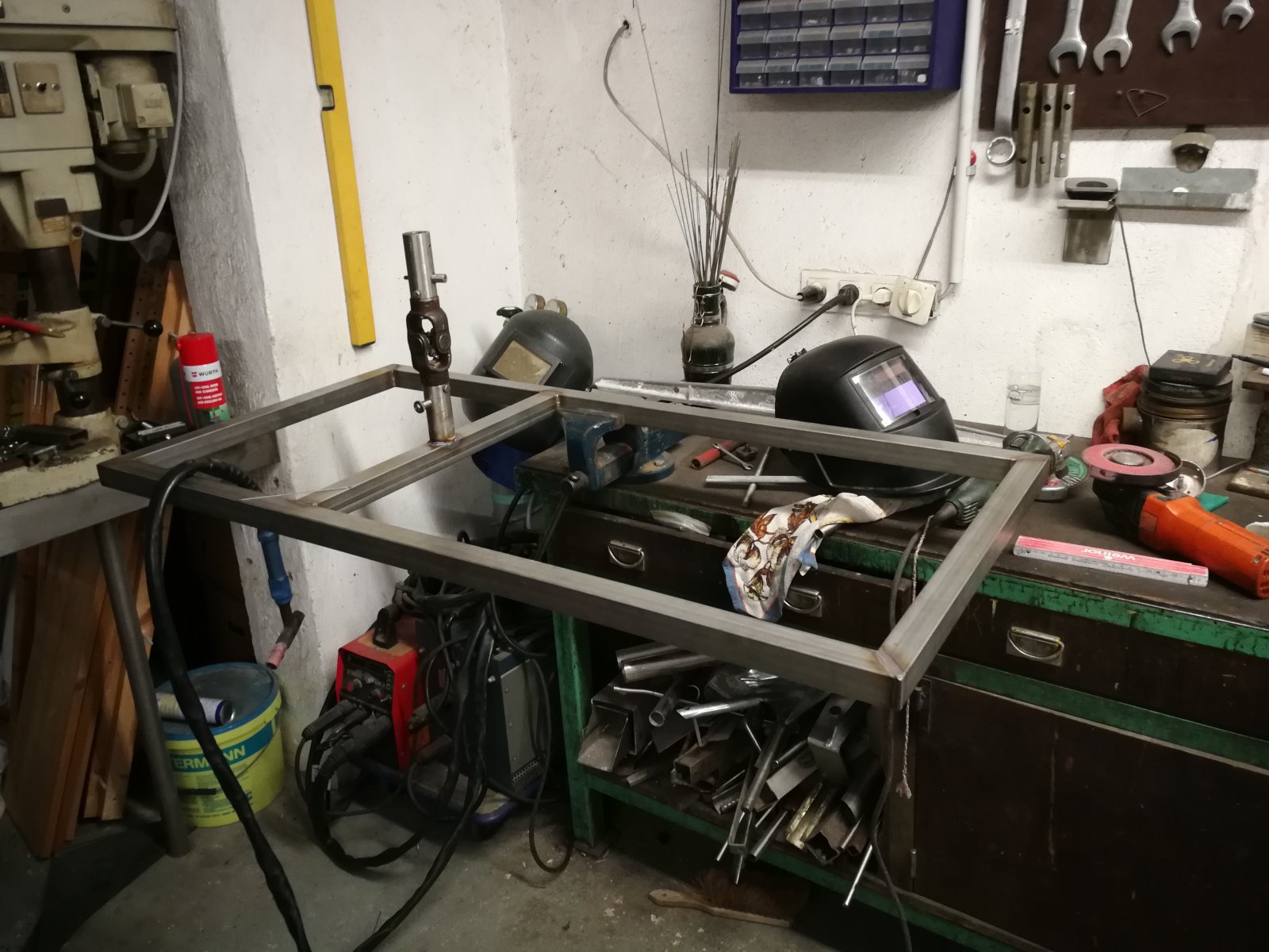

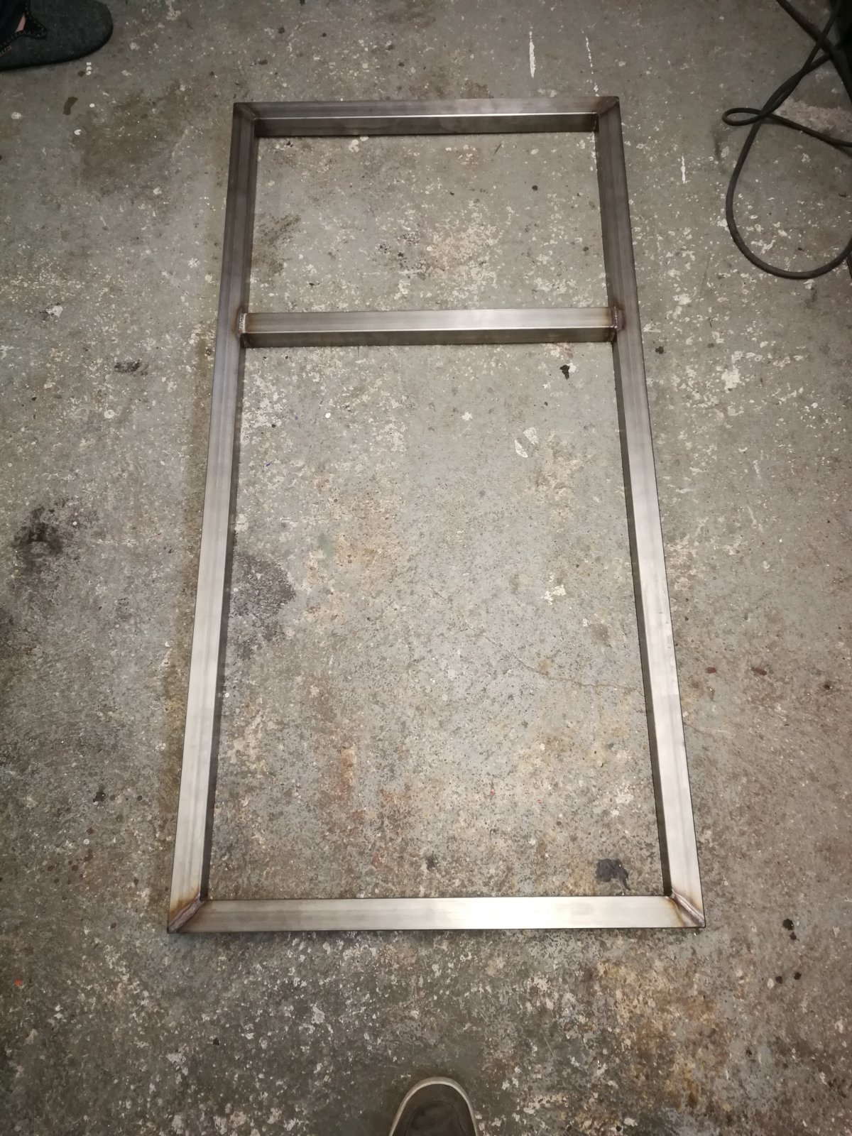

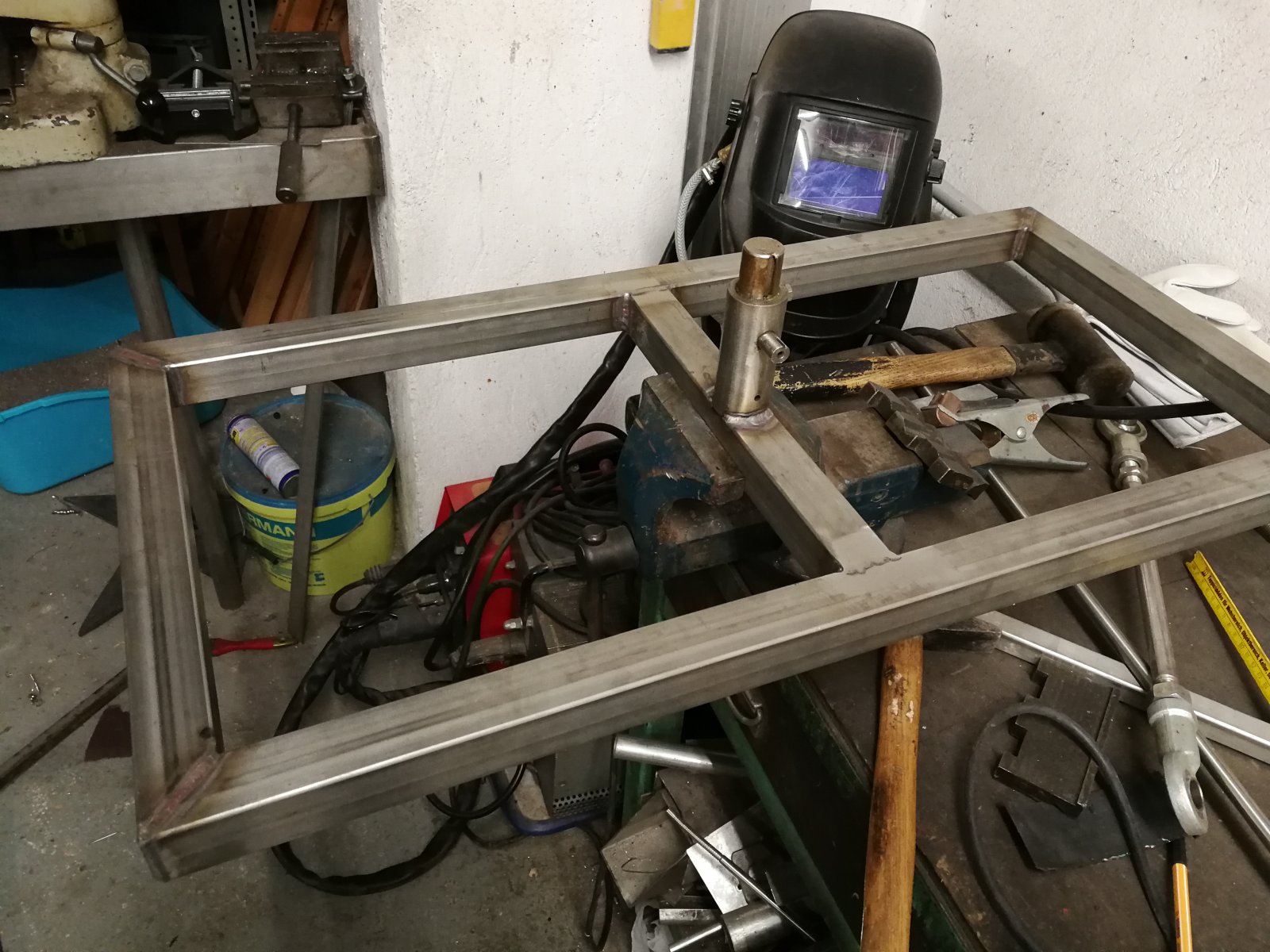

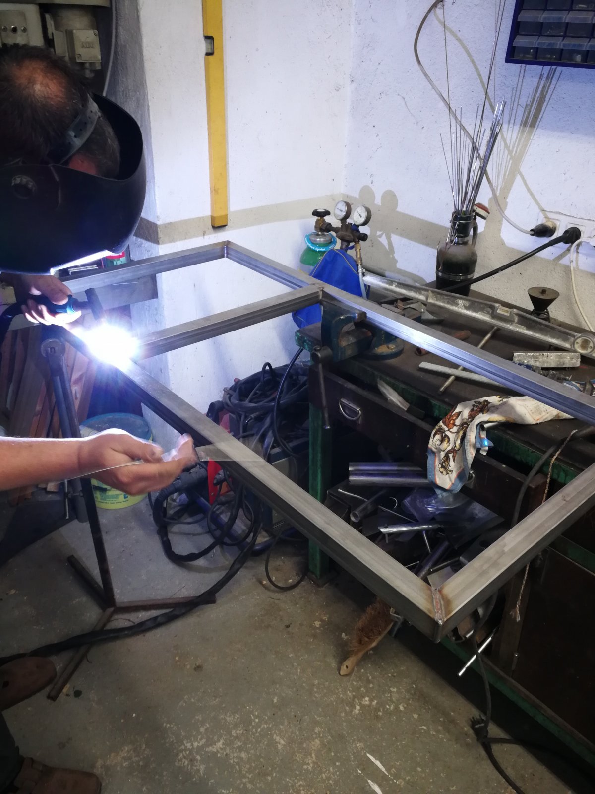

    so I made some progress, first (bottom) frame is welded.
    I also ordered 2 motors from pgsaw (25:1 ratio).
    I´ll keep you updated.
    cheers,
    Arazok

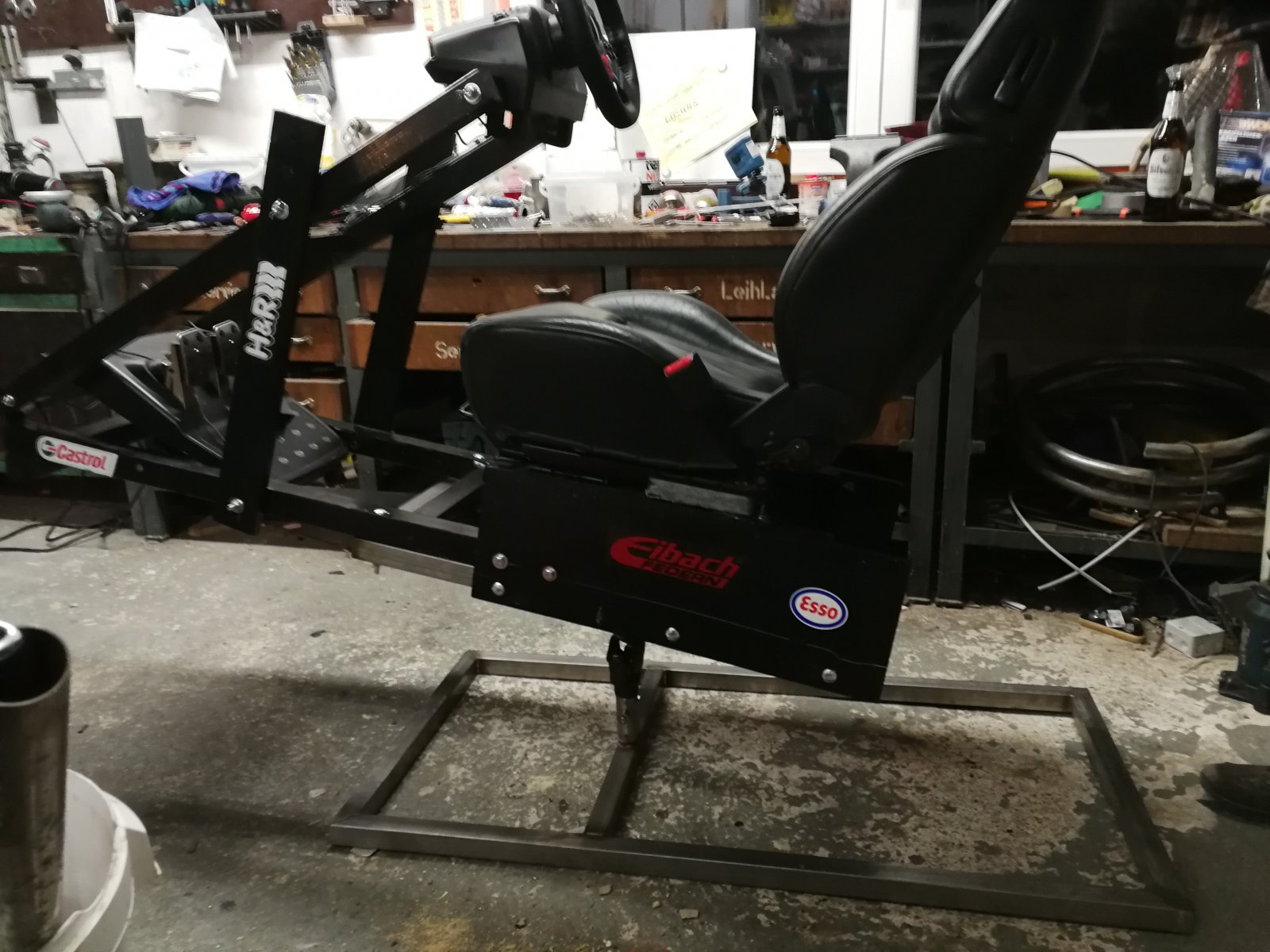

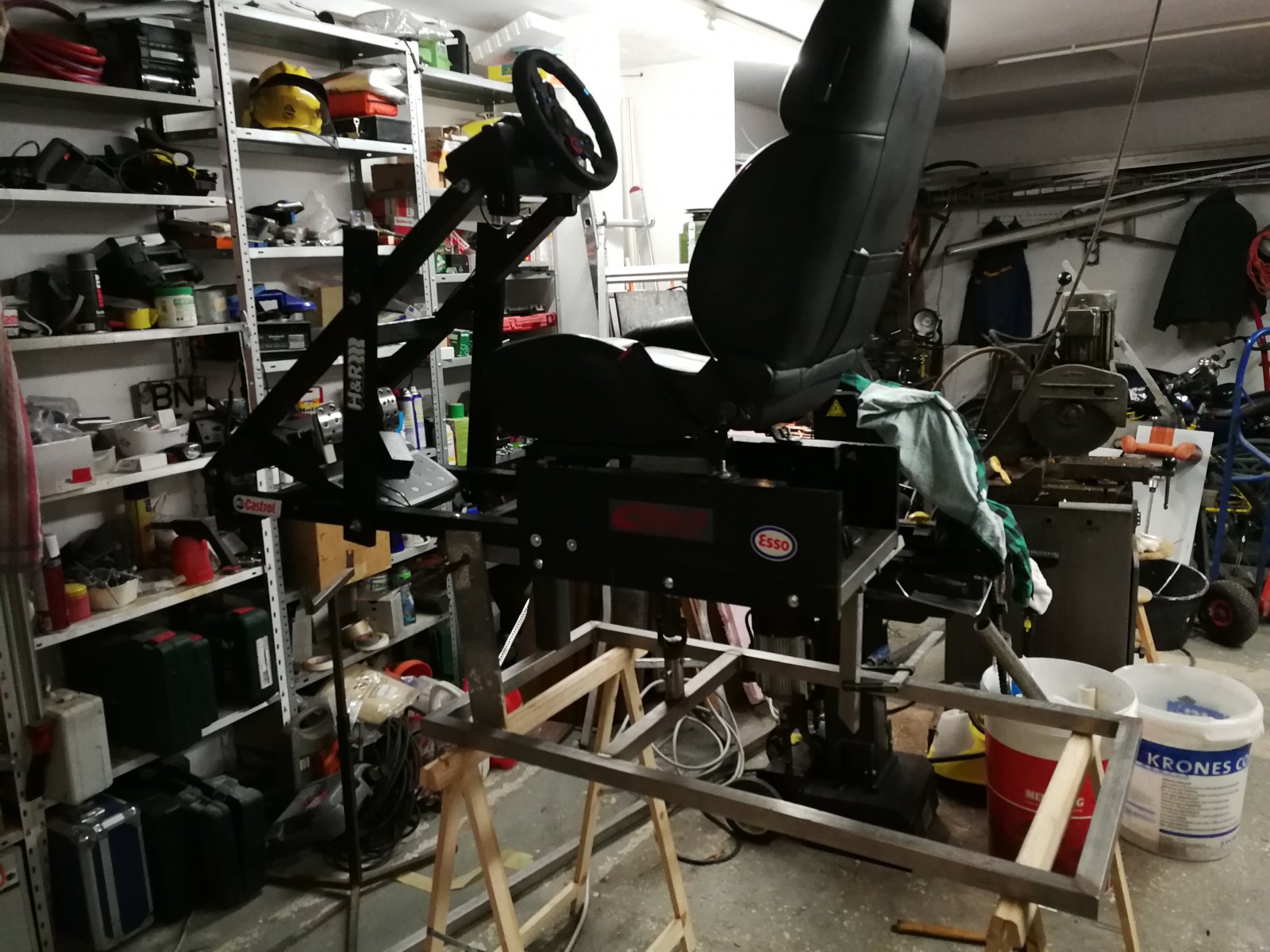

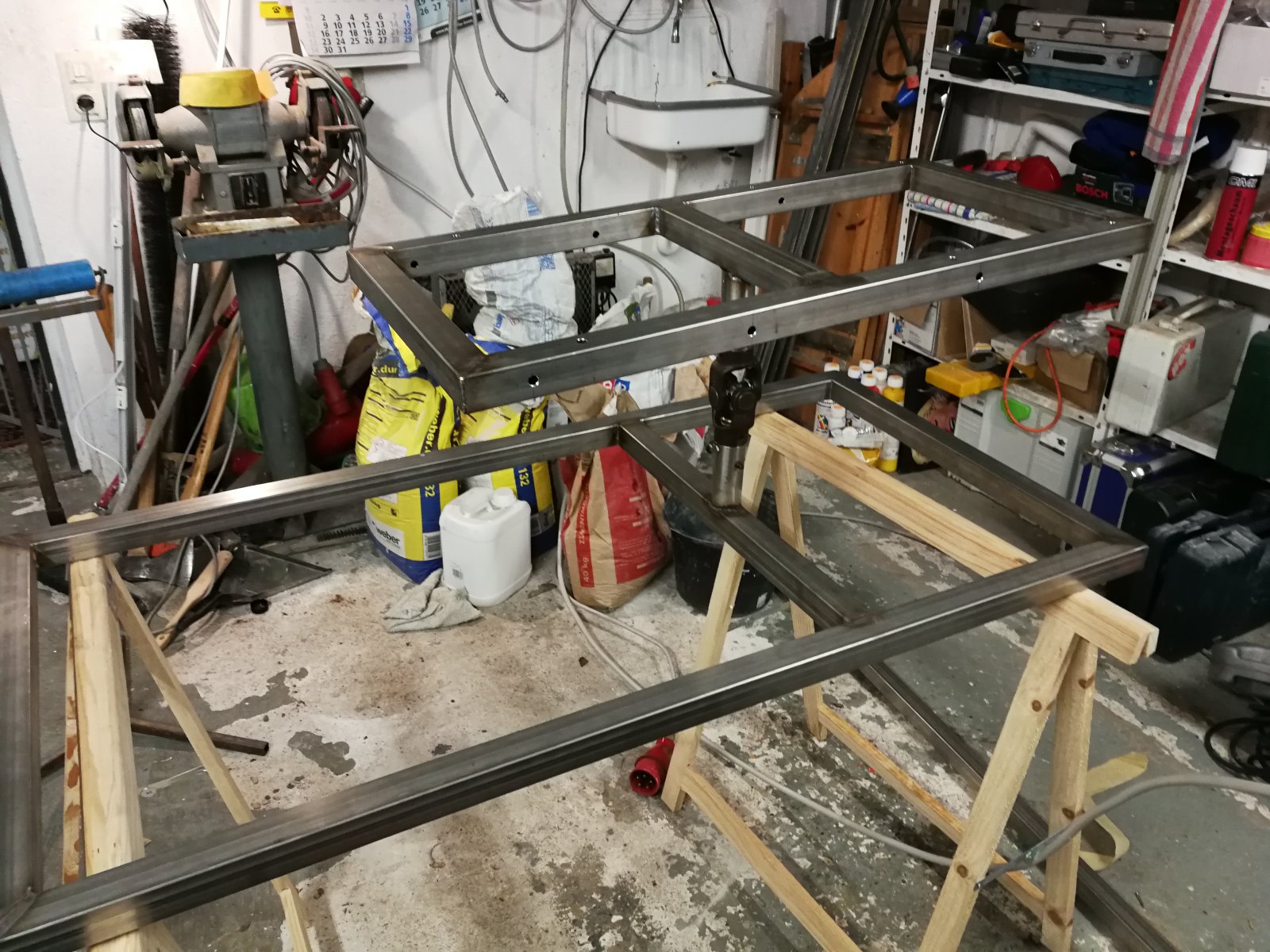

    Yesterday we made some progress after month of silence in terms of the playseat.
    We finished the aluminium frame and placed the wodden seat upon it.
    Now we have to place the motors (pgsaw 1:50) and the shoulderplate...
    Why do a lot of people here place the rods so high ? Is it due to the minimised force ?
    IMG_20181228_194909.jpg IMG_20181228_201825.jpg IMG_20181228_202026.jpg IMG_20181228_202031.jpg IMG_20181228_204324.jpg IMG_20181228_204555.jpg IMG_20181228_210150.jpg

    So, we did a first 2e2 test. It works, but it is far away from beeing perfect.
    The center of gravitiy is much to high !
    Now I know, why in most cases the rods are at shoulder height.
    So we have to adapt, reduce weight, increase pitch angle, .... a lot of work.
    Here is a video....
    cheers,
    Dirk

    Yes, one thing is that the center of gravity is rather high, but the other thing is that the fully loaded rig including the pilot/driver needs to be balanced. As far as I see from your construction photos, this has not been done, because it seems that you have welded the universal joint to the frame before determining its optimal position.
    The link provided by @noorbeast includes a link to another page that explains how to balance a rig.
  19. Arazok
    Arazok Member
    Mar 26, 2018
    180
    Computer scientist
    783Coins
    +32 / 0 / -0
    Thanks Marcus,
    no, we balanced it, so the joint is exactly at the center of gravity (when I am sitting on it), at least in xy direction.
    The problem is the height of the center of gravity (z axis), it is too big/too high.
    So we have to reduce the height of the seat and put the rod mounting point much higher, I think.
