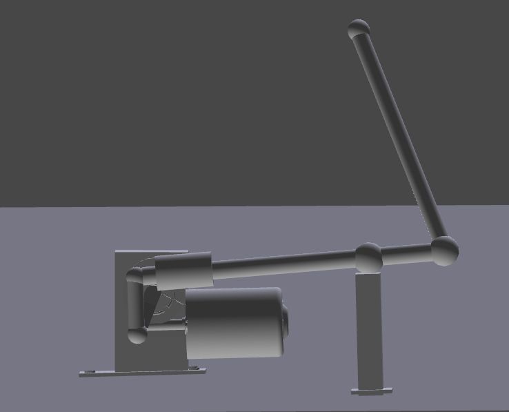

    I will be adding heave to my sim soon, mechanical part is almost resolved, just a question about potentiometer setting. I use SCM3 wich as a default, centers the motors at the start, this is no problem for 2dof, but for the heave movement I will use a spring that it will be getting its center position once I get on the sim, so the only way that the motors won't struggle against the spring, is to power on the heave motor once I get on the sim, but also if the sim is used by another person (different weight) the heave motor will be trying to center the sim all the time. Any advice?
    22,185
    154,750Coins
    +11,196 / 57 / -2
    How have you implemented heave, do you have some pictures or better yet a video?
    I am just in the process of swapping mine over to a 50:1 gearbox for heave, as it can't be back driven.

    Not done yet, but the idea is to do a center spring with a guide, and one or two motors with levers, something like this but with two motors:

    More like this, but using a lever system like the other video

    When I get the new lever made up and change the gearbox on mine from the 25:1 to the new 50:1 then I will be able to let you know how it compares with a gearbox that can't be back driven.
    On mine the 25:1 could not hold the sim when nobody was on it because of the heave assist spring. Also it was fine for racing but the motor got noticeably warmer when I started to mess with flight sims, particularly long climb outs constantly putting sustained load on the heave motor.

    It is too slow, but if it lifts 2000kg with the current gearing, it could be able to do the work with a 1/4 of the reduction (500kg is more than enough).
    If you have access to gearing stuff could be nice to try!
    My current idea to use it for heave is keep the gearing and add a lever.

    I am very pleased with the 50:1. As it can't be back driven it has no problems holding the sim when unloaded against the heave spring. Speed wise performance is still good
    The only down side is that the 50:1 comes with a large 8mm bolt hole through the otherwise solid shaft, which I was a bit concerned weakens the shaft. I had a local machine shop turn up a very thick walled interference fit lever tube for me so the shaft is supported as much as possible.

    I would have never have thought of this so cheers for the idea! I did a quick test and it really does not take that much to lift my 140+kg (me included) Simlab P1X rig from the back using levers. I happen to have 2 wiper motors lying around and some heavy duty springs that will work wonders. It does move a little back and forth though so that needs to be addressed but my rig is already on wheels so its not a big issue for now
