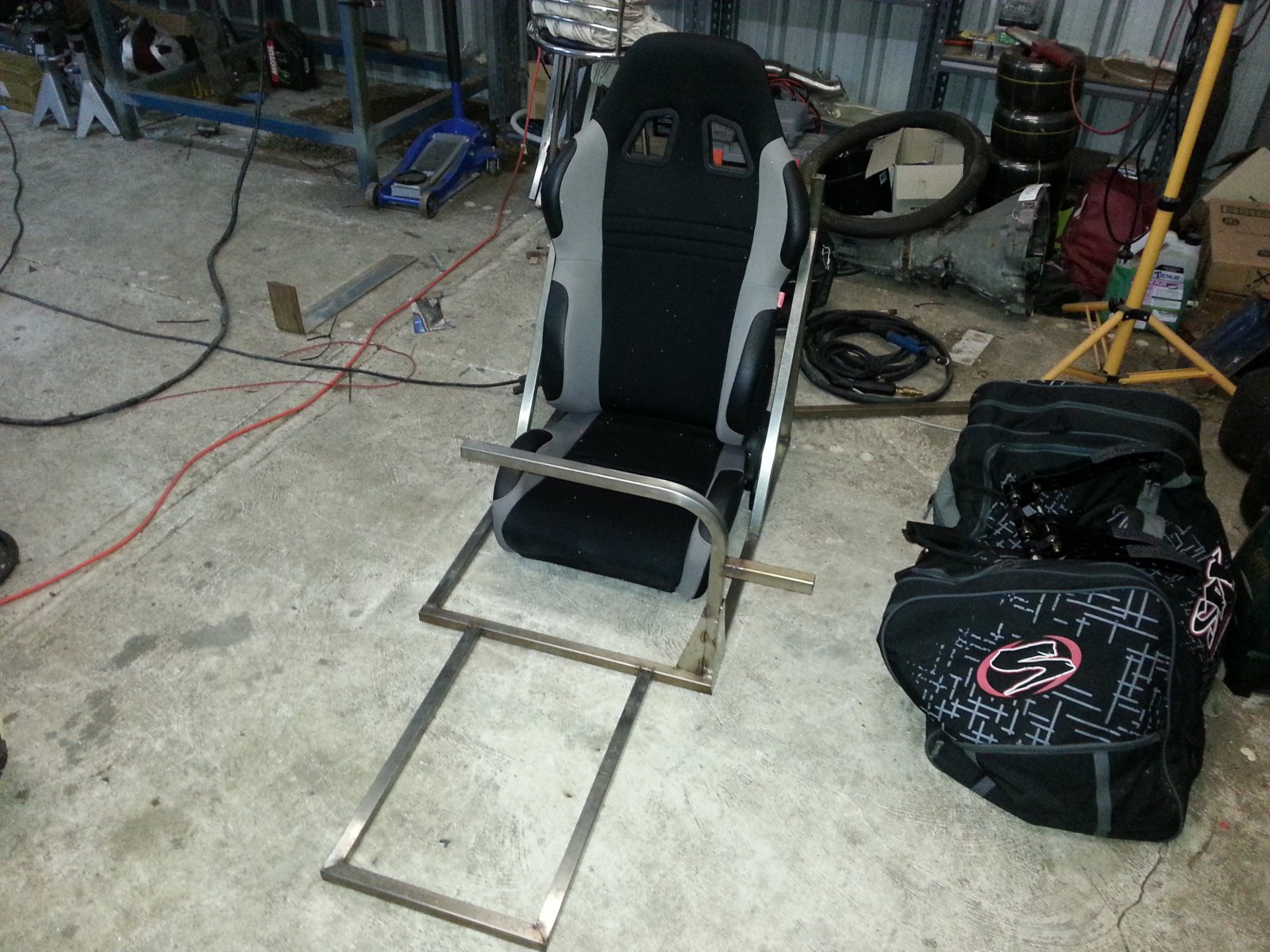

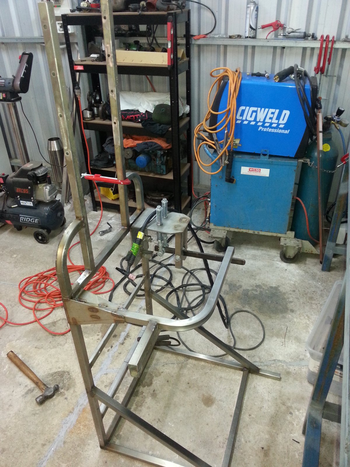

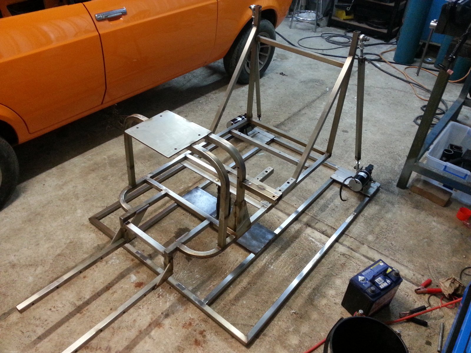

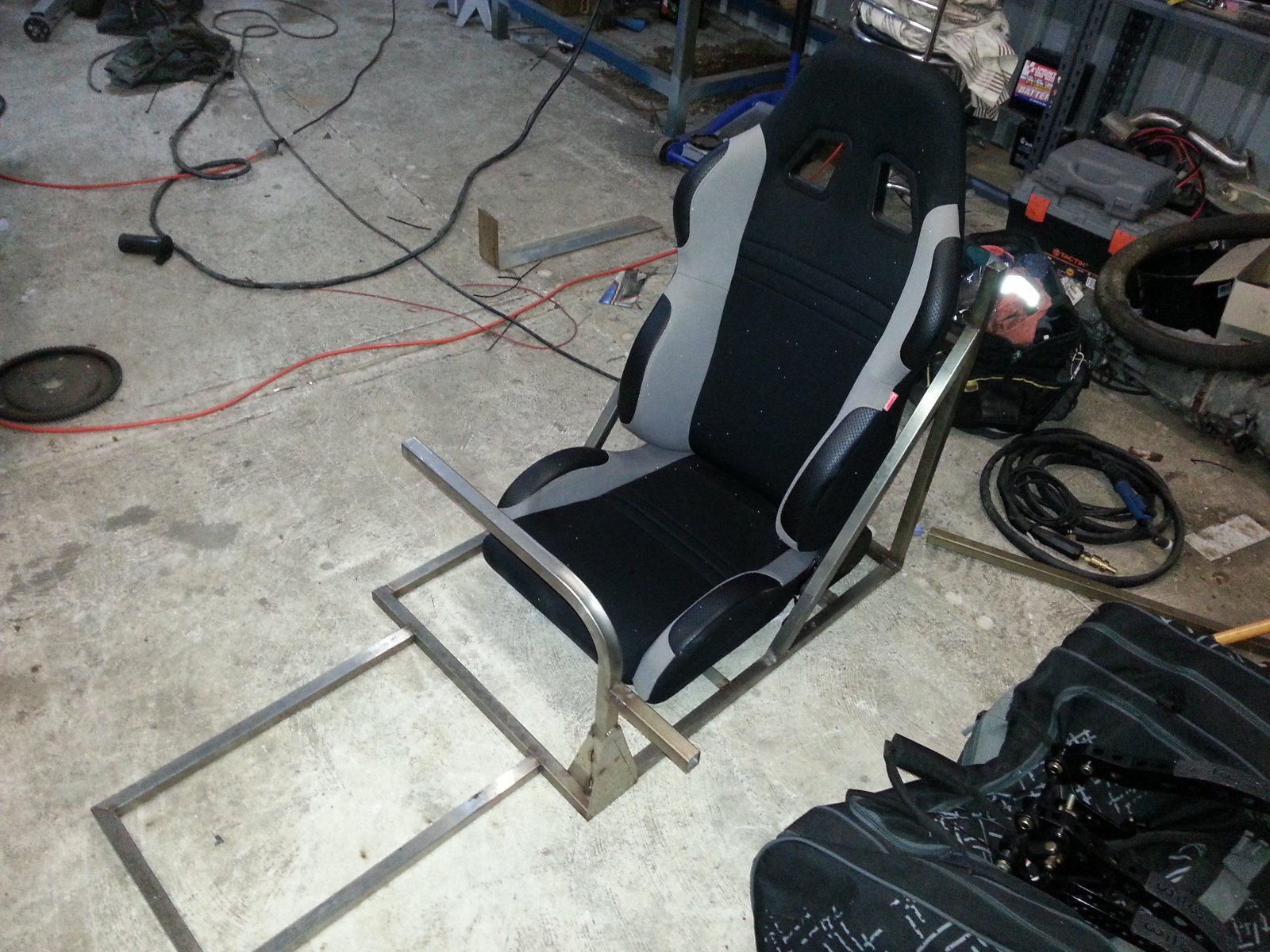

    This project started out as just a frame for a chair and pedals. I decided to build one myself as I never really had any fabrication skills and wanted to learn how to weld. Also I had already picked up a chair for $50 and my mate could get scrap steel from his work for free. Materials used were 25x25mm square tube in stainless steel. So lets begin from the start.

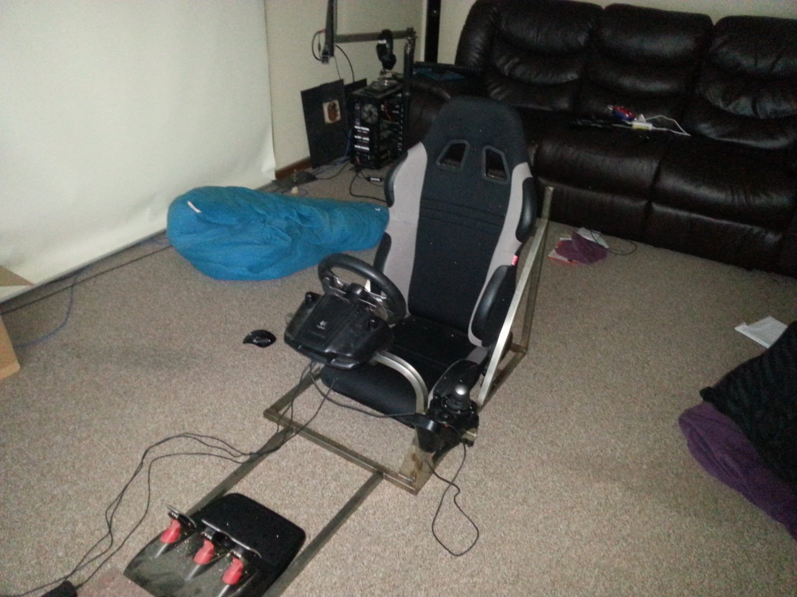

    My cheapo chair I picked up. I didn't get many build pics of the start of the frame. This is the basic design that will sit on the floor.

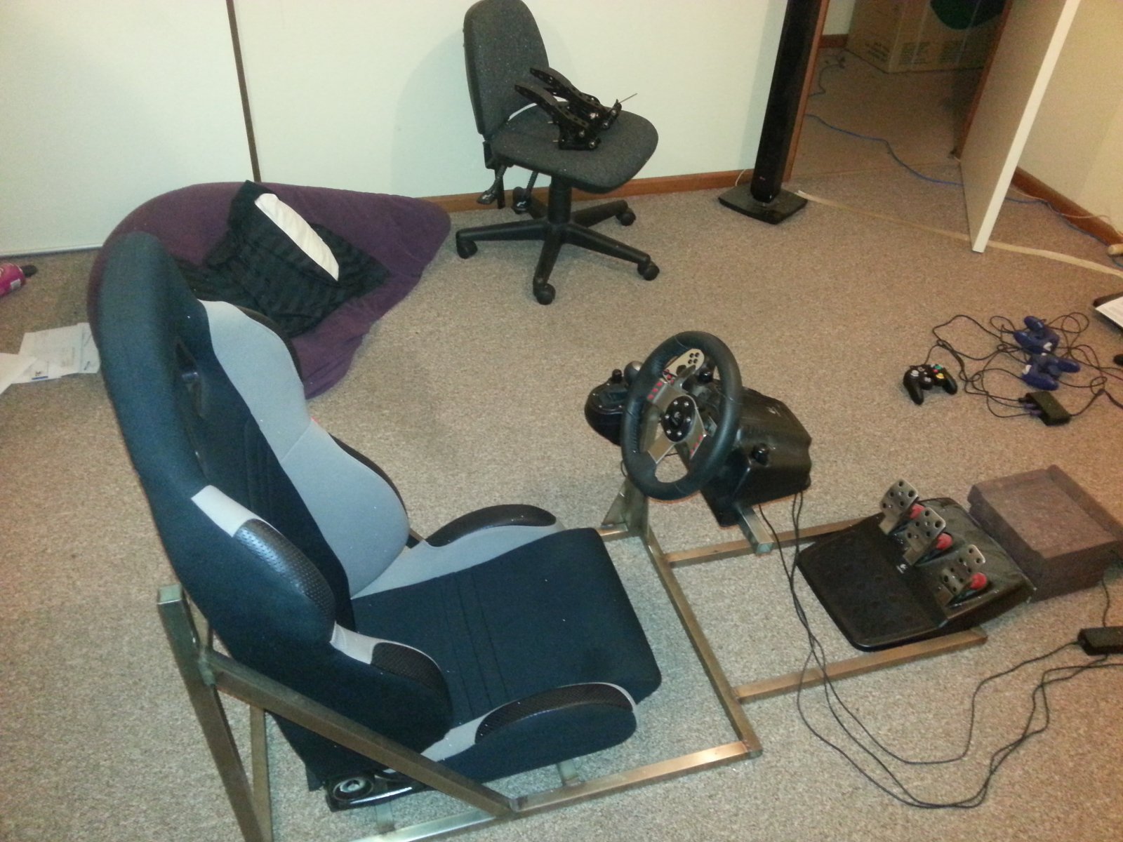

    The steering wheel at the time was the trusty old g27 which will clamp to that top bar. The H pattern shifter will clamp to the little piece of square tube sticking out the side.

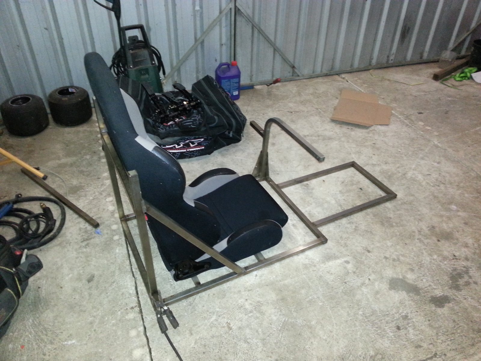

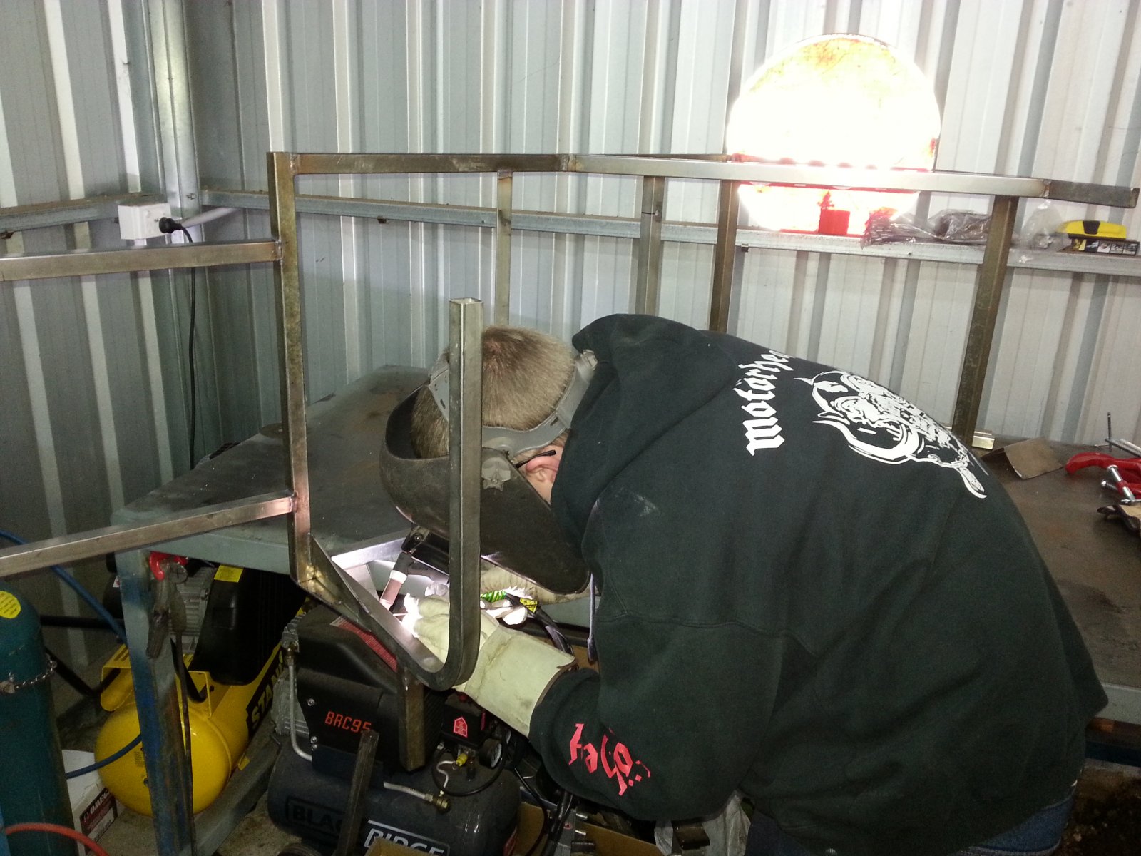

    My mate helping me out with the trickier welding as I just seemed to heat up the steel with the TIG welder.
    Here I give you MK1 of my frame.
    Comes with a custom brick setup to hold the pedals in place lol! Can I sense a hydraulic pedal build?

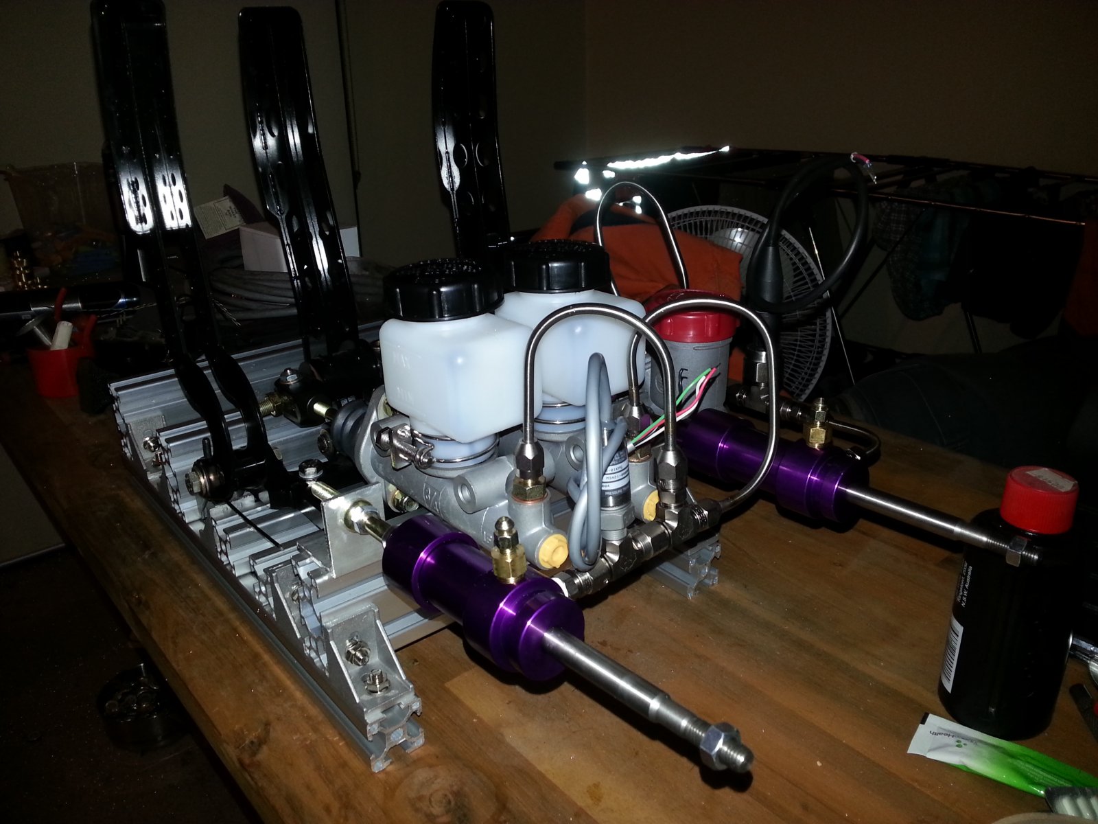

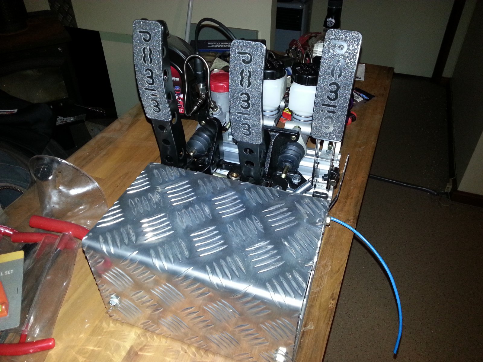

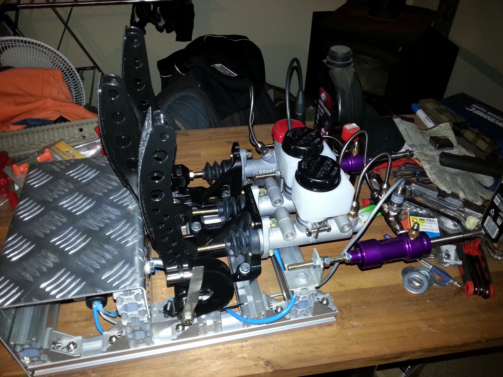

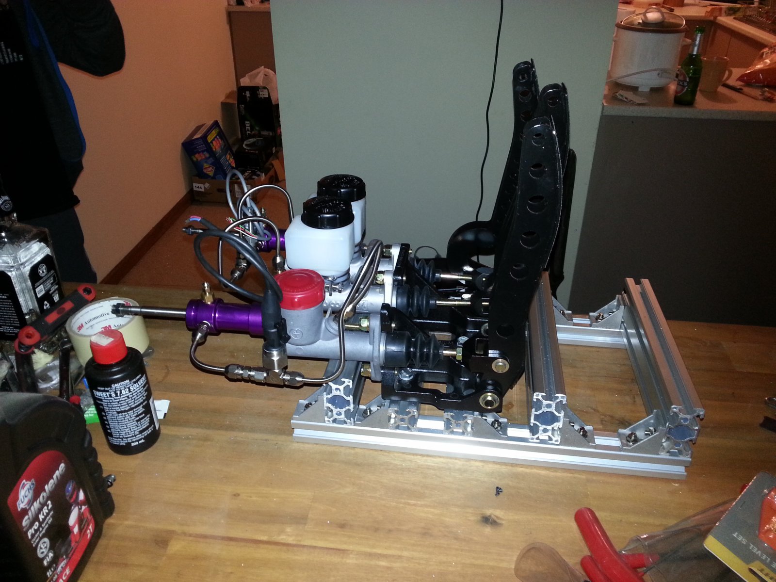

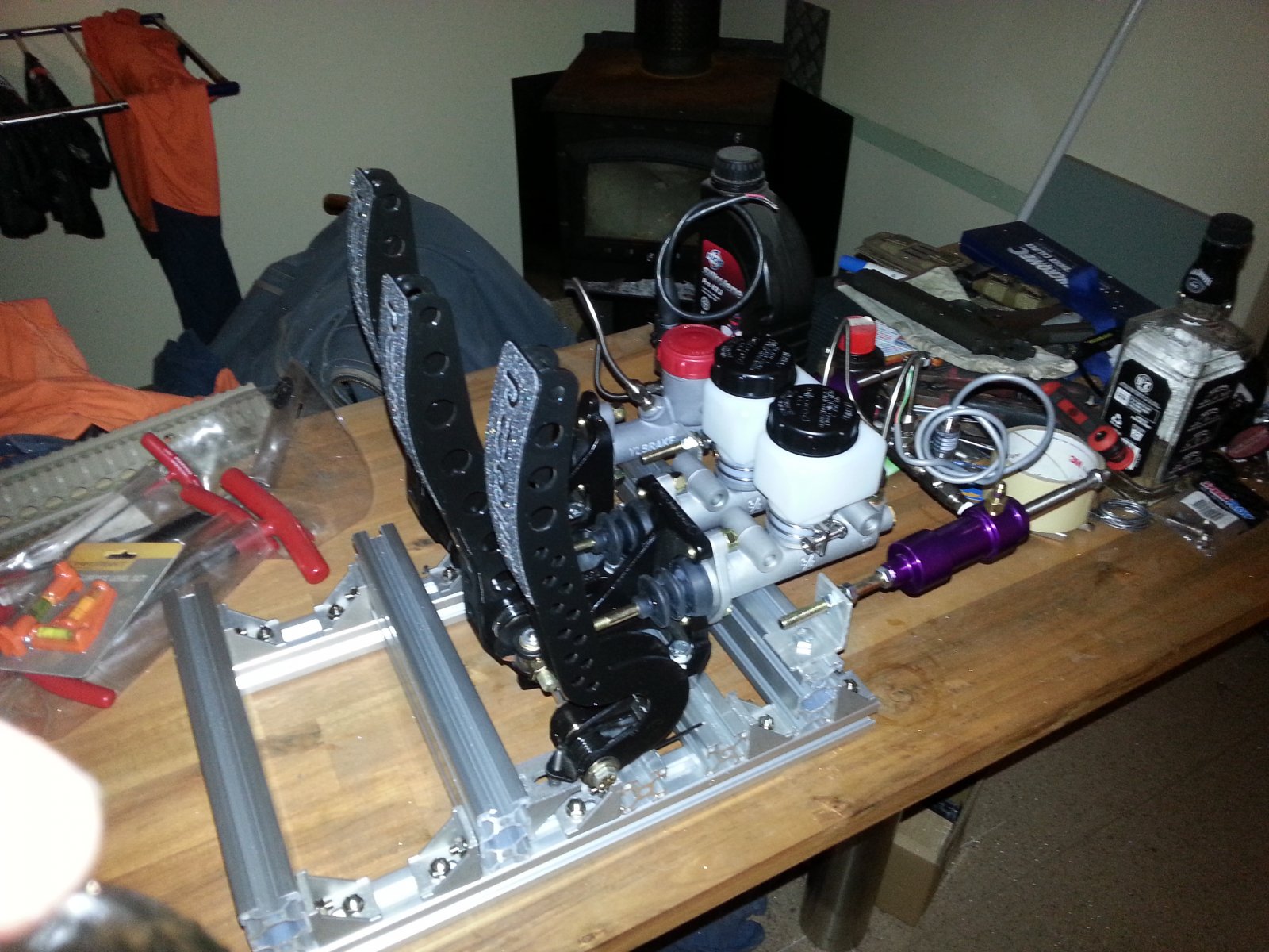

    Yep you guessed it some Wilwood custom hydraulic pedals. I decided on using stainless steel 3/16 tubing with -3AN flare nuts. Was a pain in the ass to flare. Had to heat it up to stop it from cracking. If you want to go down the hard line route I suggest using normal bundy tube, so much easier to work with but to keep in theme with my frame stainless steel was chosen.
    I used 80/20 in 30mm tube to build the frame for the pedals to mount to. Here you see the master cylinders hooked up to the pull slave cylinders.
    Sorry for the poor pic. The electronics are going to be housed at the front in a junction box. All my wiring will be kept within the pedal set so its modular. All that is needed for these to work is a USB cable.
    A piece of checker plate aluminum got bent up to go over the electronics and to bring your feet up to the pedals.
    Can see where all the wiring leads back to. I'm using a hall sensor for the throttle attached to the piece of stainless steel coming up of the throttle pedal bolt. The magnet on the throttle pedal moves past the hall sensor which sends a signal to the DSD pedal board resulting in acceleration without using pots or pressing on loadcells.
    Had to figure out a way to mount the pedals. My solution was simple, cut 2x 25mm tubes and drill holes in the centre for m8 35mm bolts. Using 80/20 m8 sliding nuts I could slide my pedals in between the tubes and do up the bolts making it a solid fit.

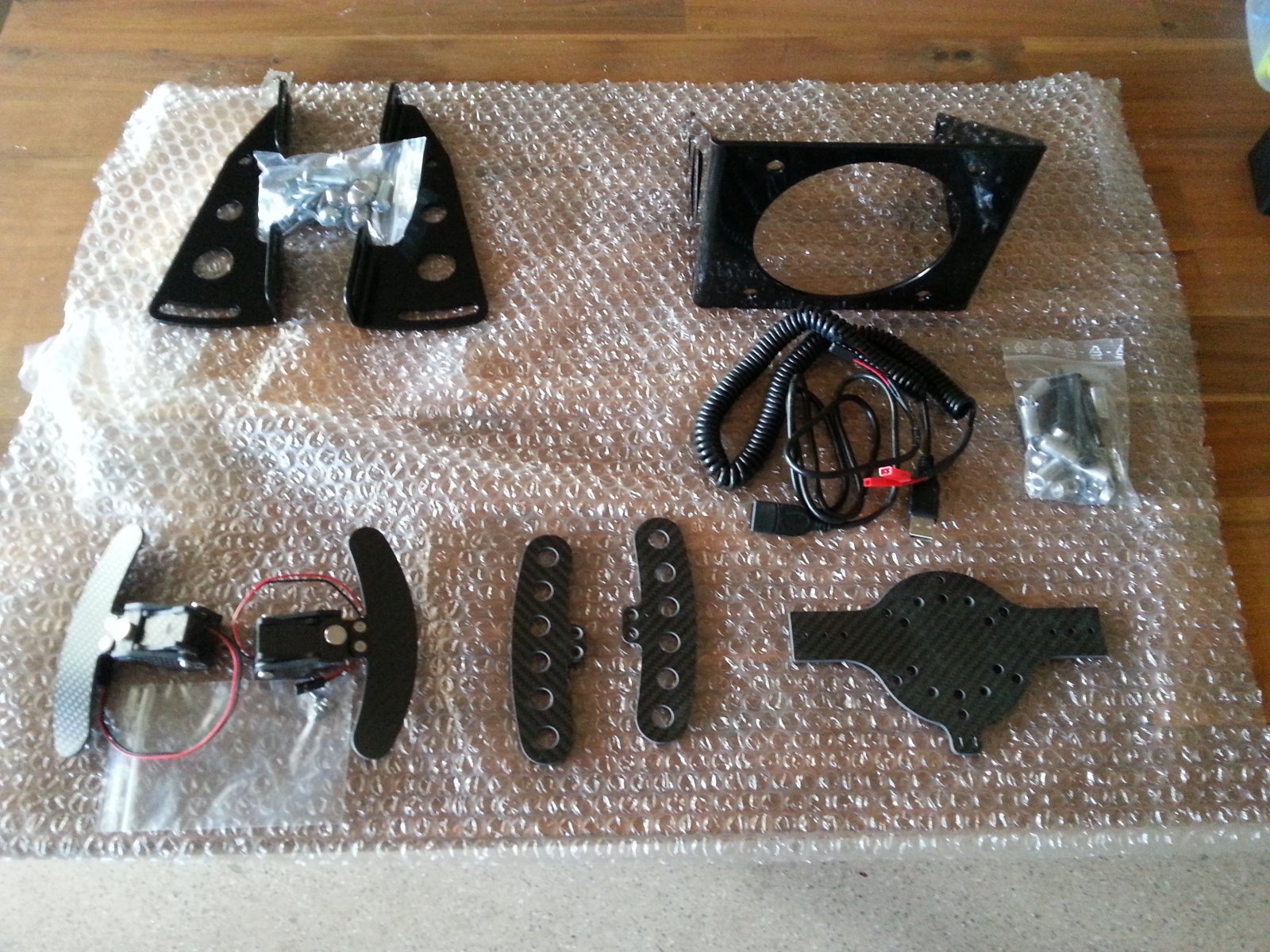

    Received some goodies from Ascher Racing. I must say these carbon fibre paddles are the best I've used, well worth the money.

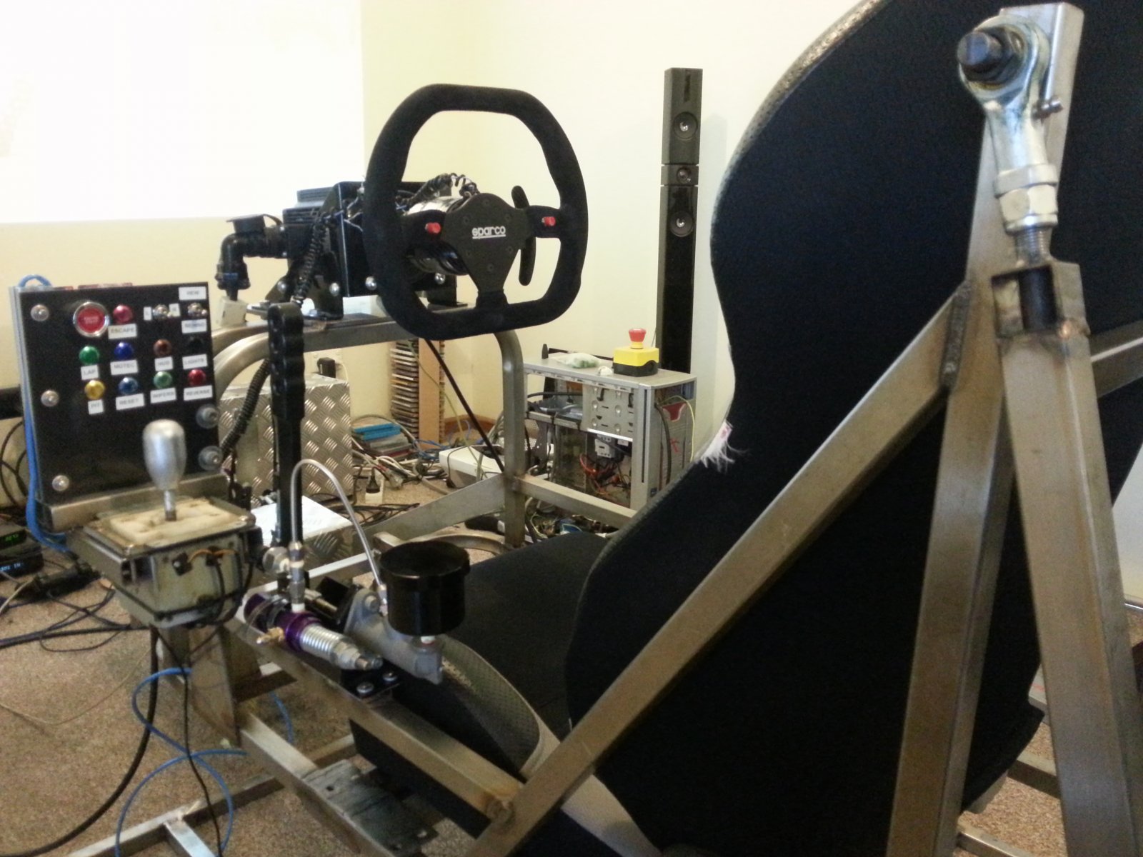

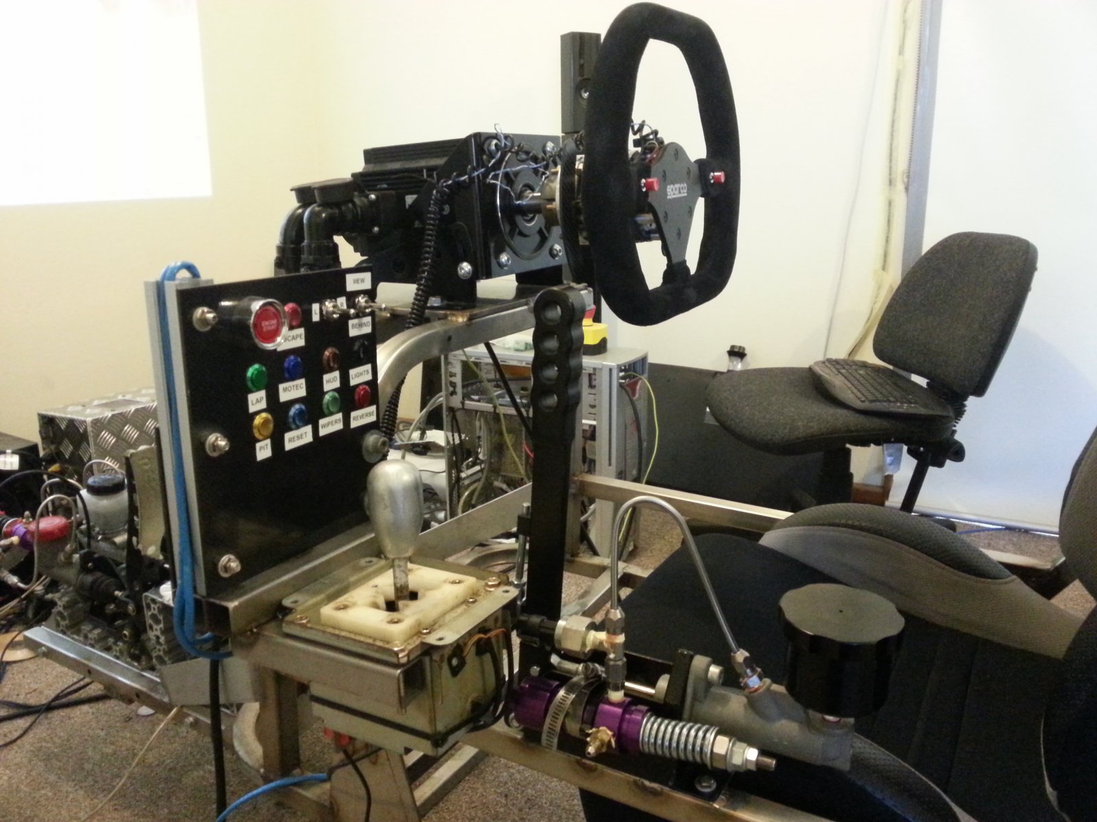

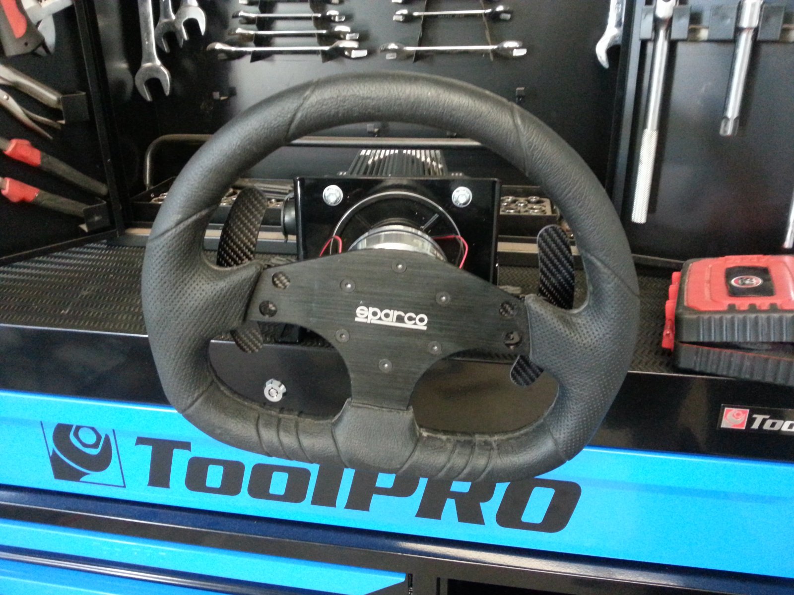

    In the process of building all this cool stuff I couldn't resist building a MMO's force feedback steering wheel as well. It compliments the pedals so much better than a g27. Here it is with a rip off Sparco wheel and those awesome carbon fibre paddles.

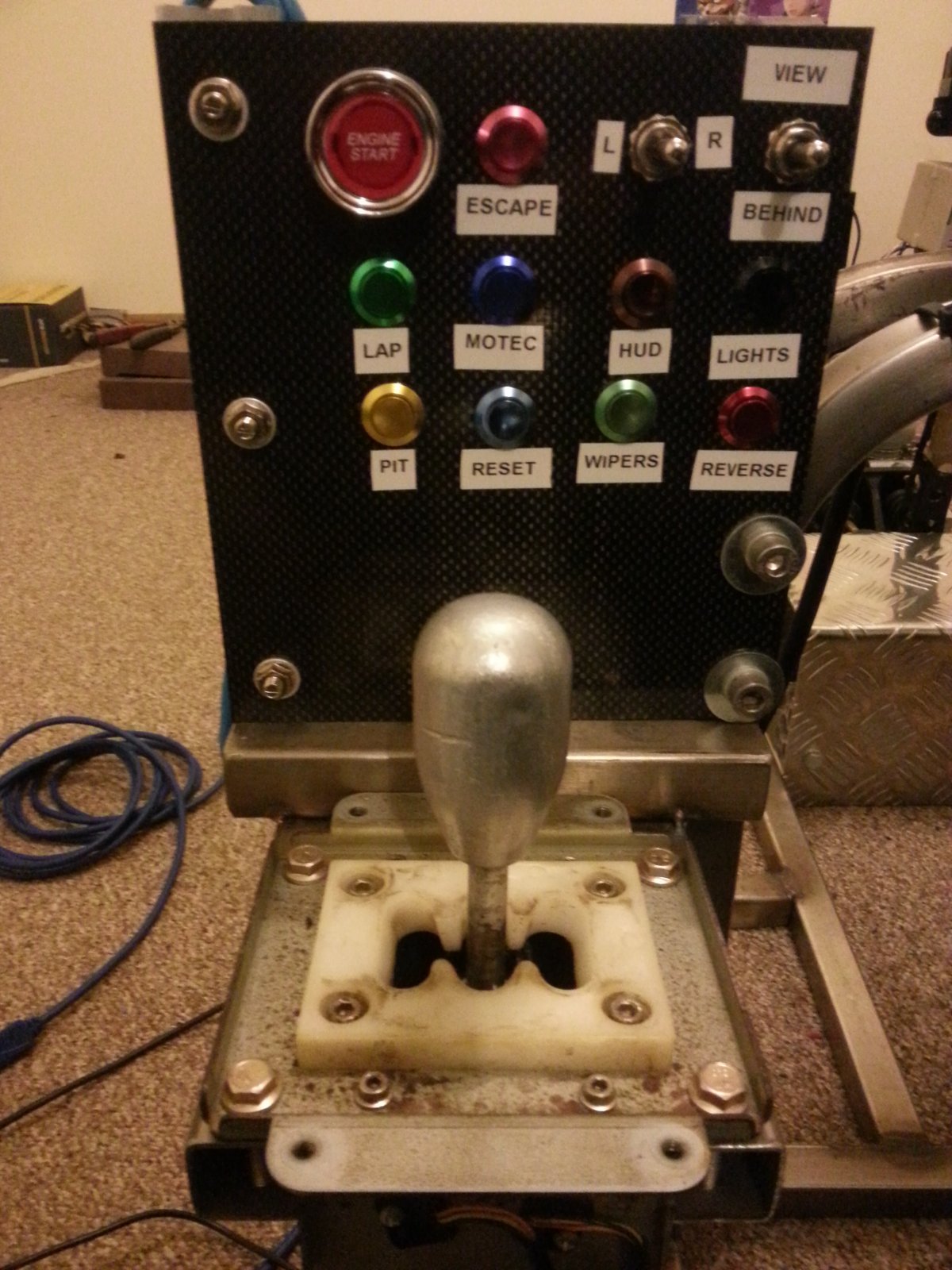

    I also made a button plate out of some carbon fibre. I bought a second hand H pattern shifer off an arcade machine as well. The button plate and shifter are both wired into a Teensey with programing done by a mate.

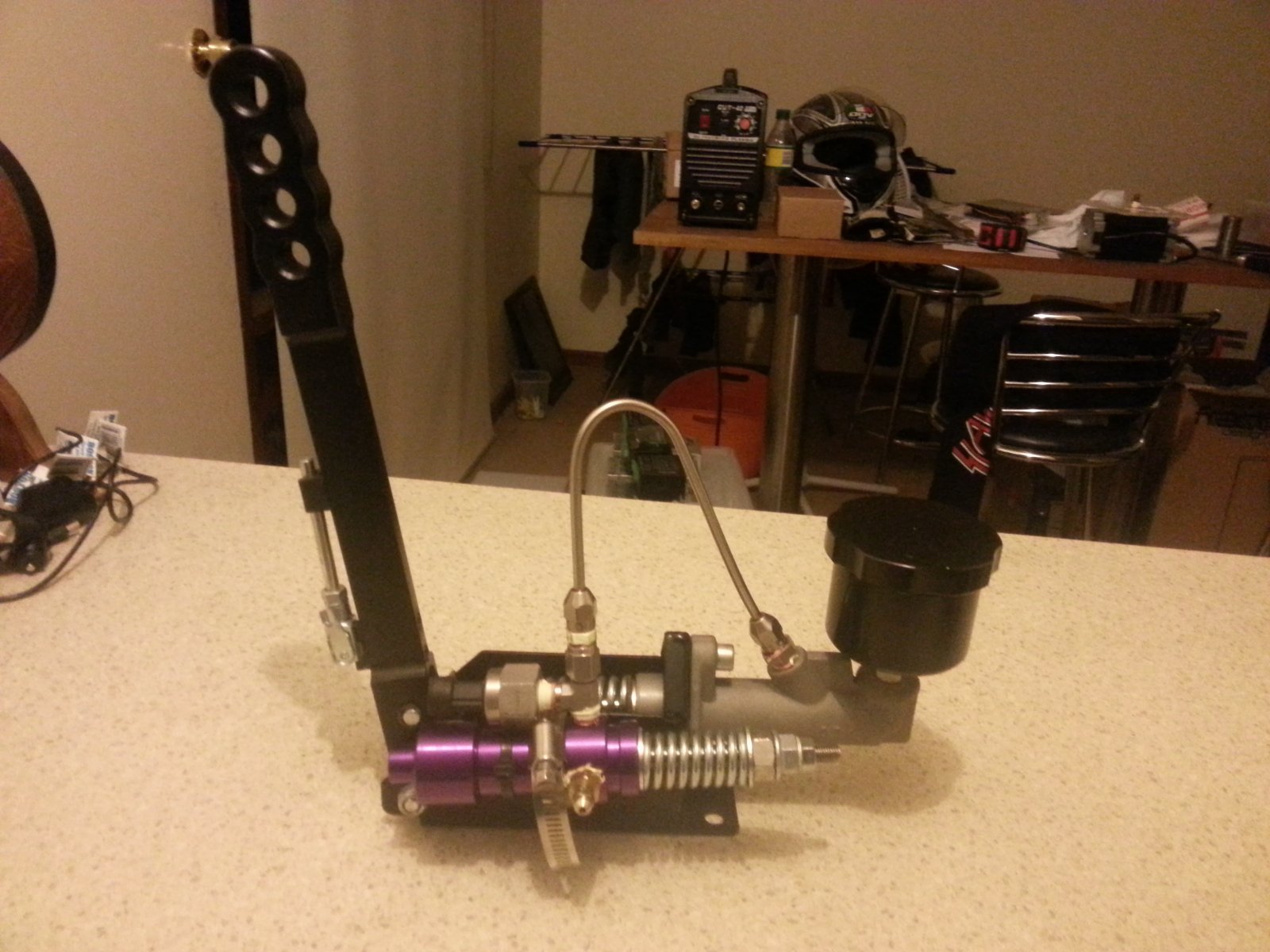

    No rigs complete without a handbrake. Whipped up this beauty one Friday night. Just an ebay cheap chinese drift brake. Plumbed it up to a slave pull cylinder with a pressure transducer like my hydraulic pedals. This is wired into my DSD board in my pedal box.

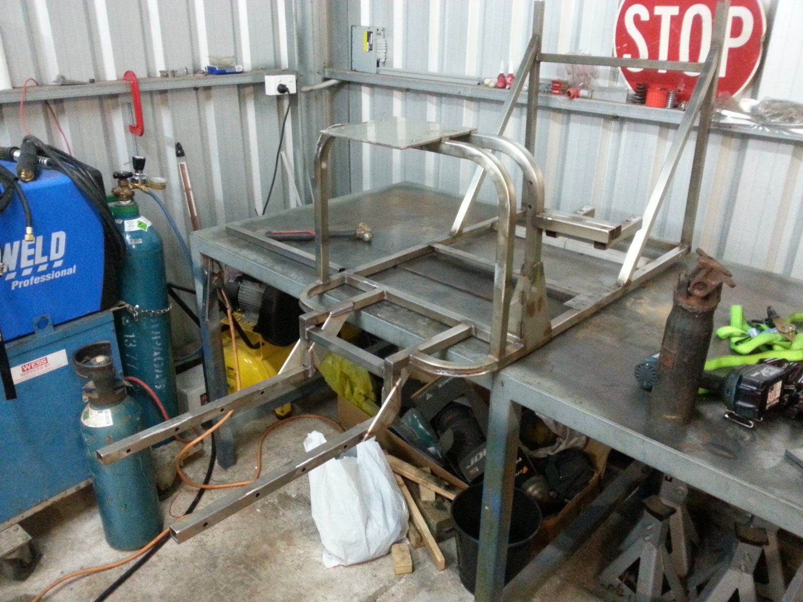

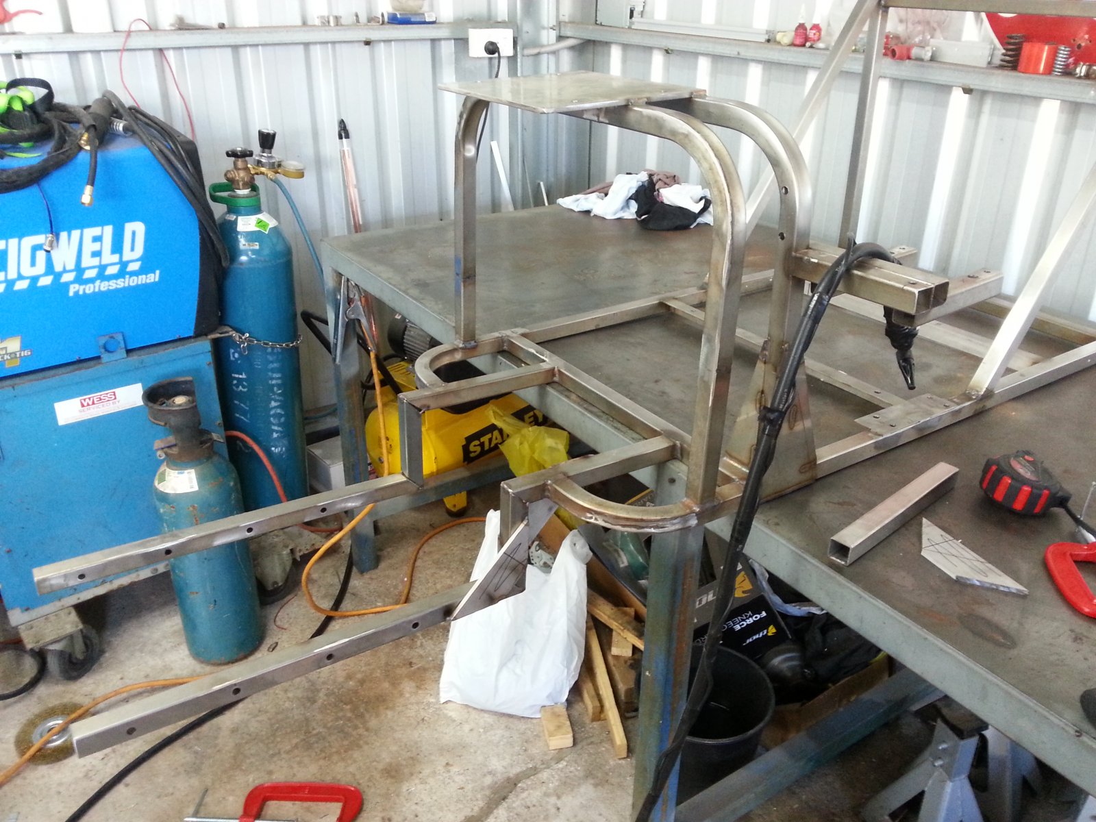

    First things first because my pedals sit on the ground I'm going to have to offset them so they sit 150mm lower to make it more comfortable. Being on the ground the pedals were a bit high making an uncomfortable postion for long races. Also I don't want to bash my knees on the steering wheel frame when this thing starts rocking!

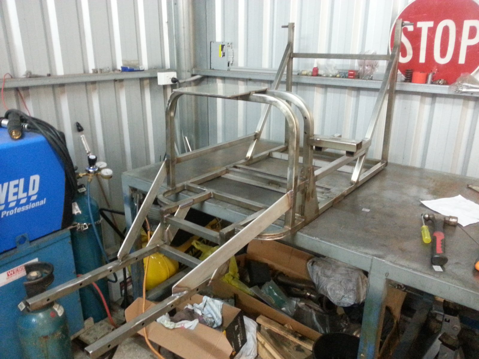

    Drop legs made and tacked now time to brace them.
    Bracing done on the pedal drop legs. Used 50mm x 6mm flat bar for the outside bracing.
    50mm x 6mm flat bar was also used on the bottom of the frame for where the uni joint will bolt to.

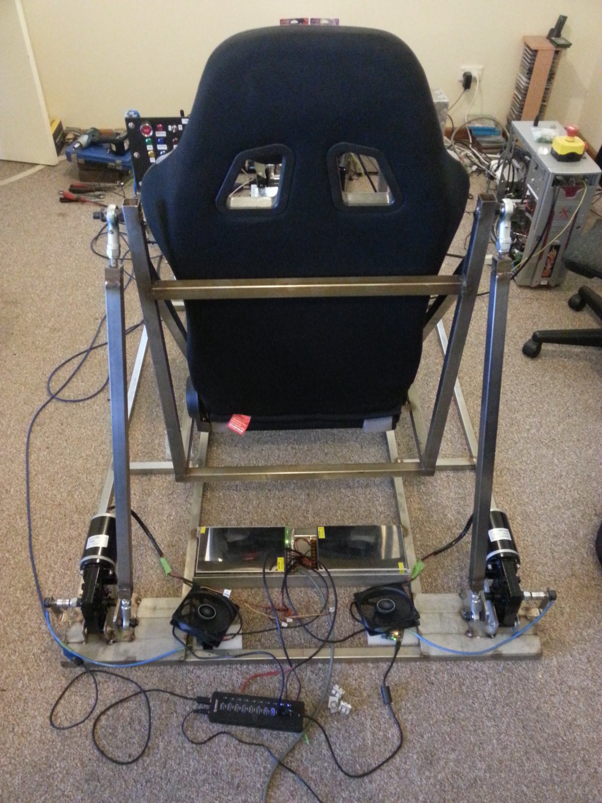

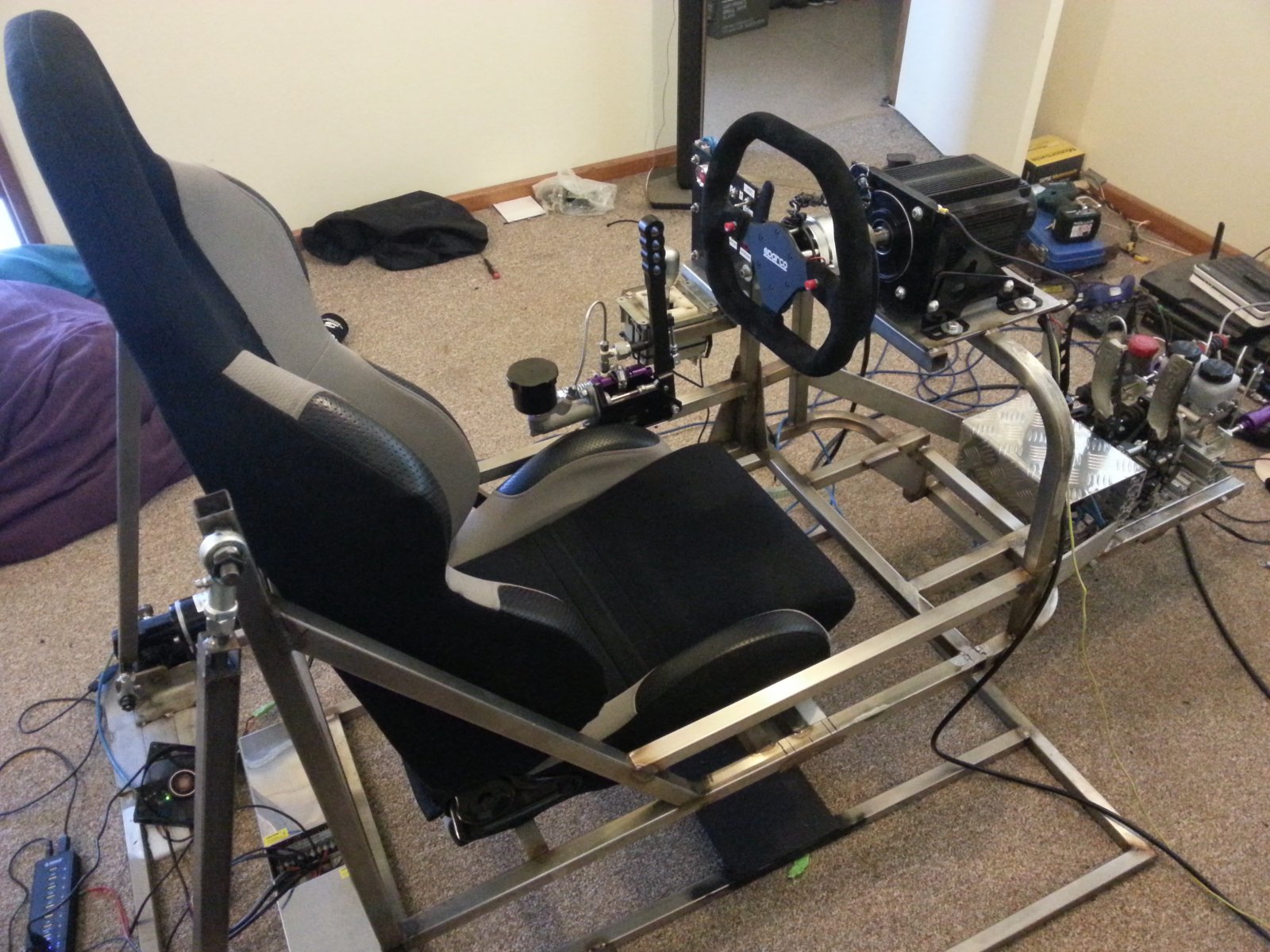

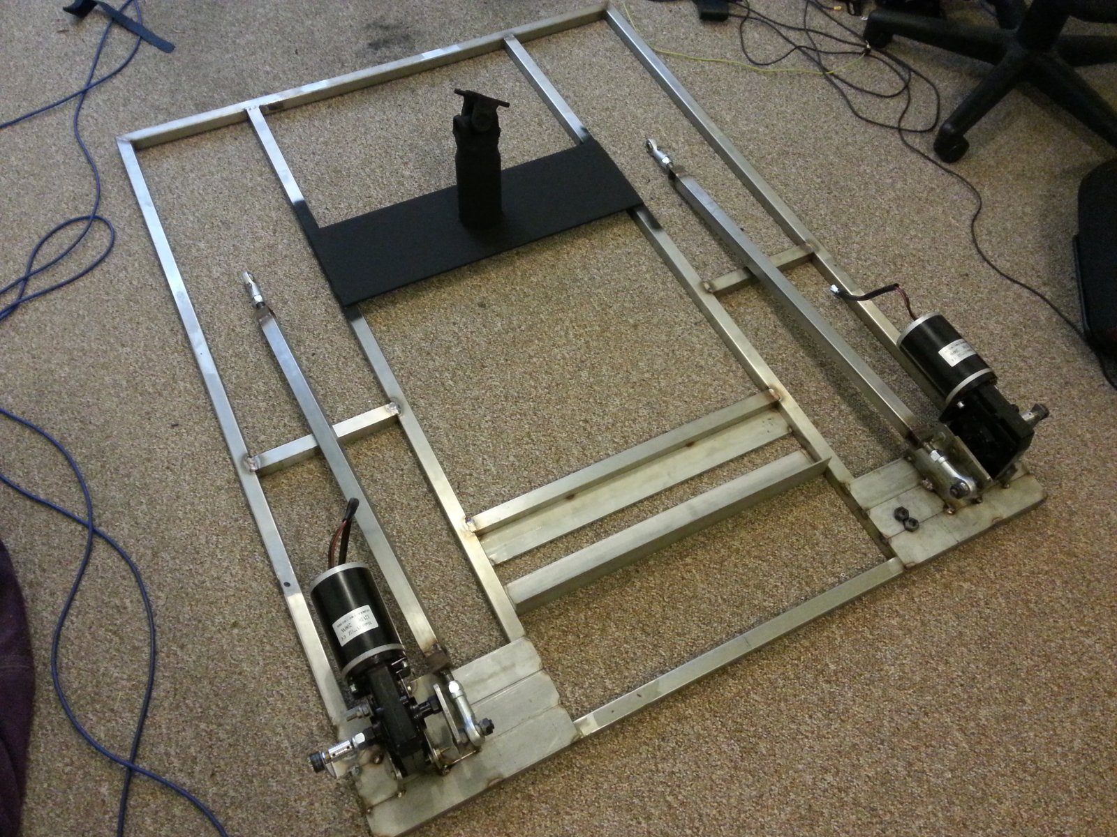

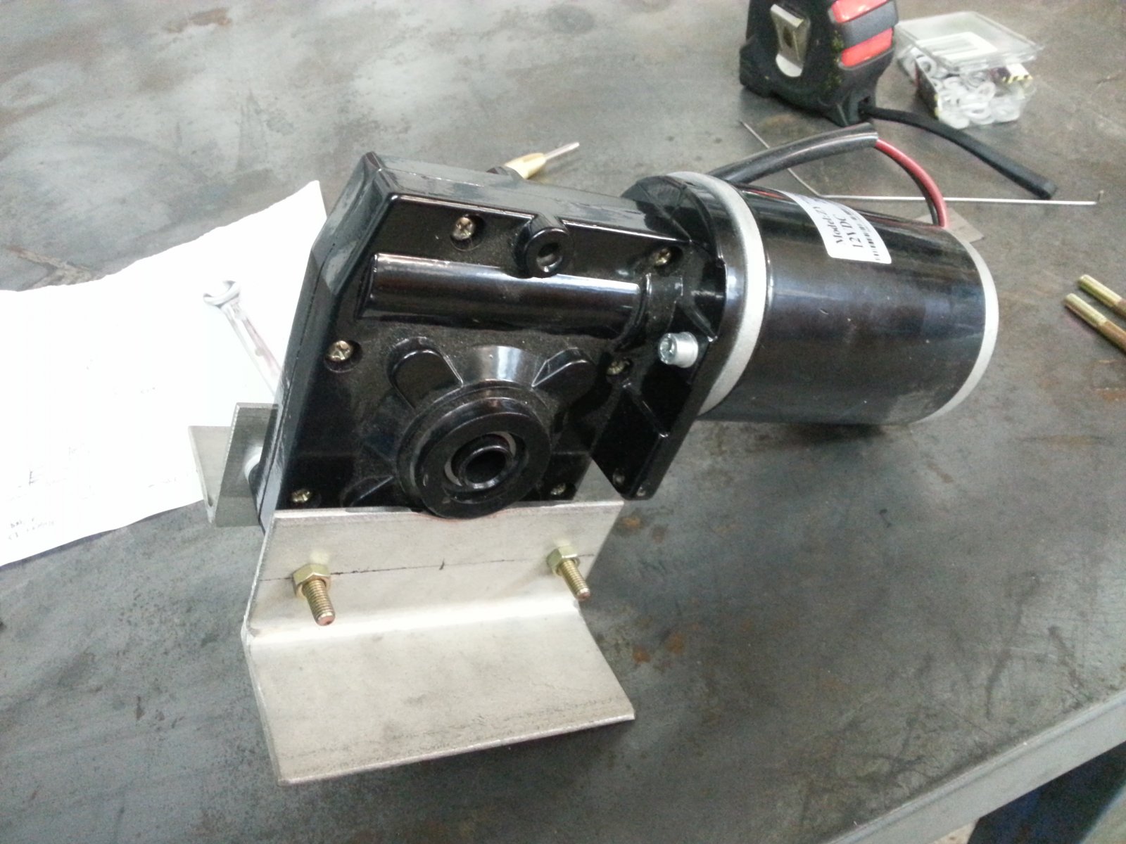

    Using 200W motors from motion dynamics with 25:1 gearbox. Made the mounts with 50mm x 4mm angle held together with m6 bolts.

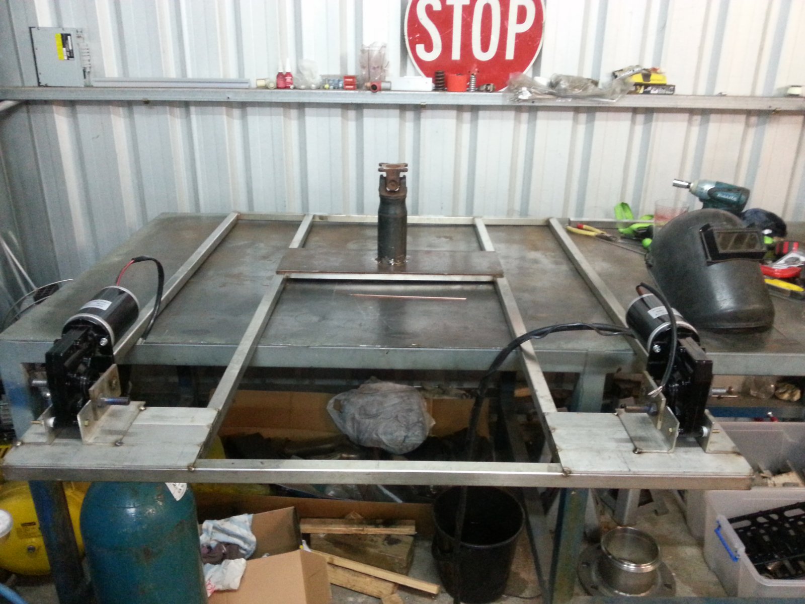

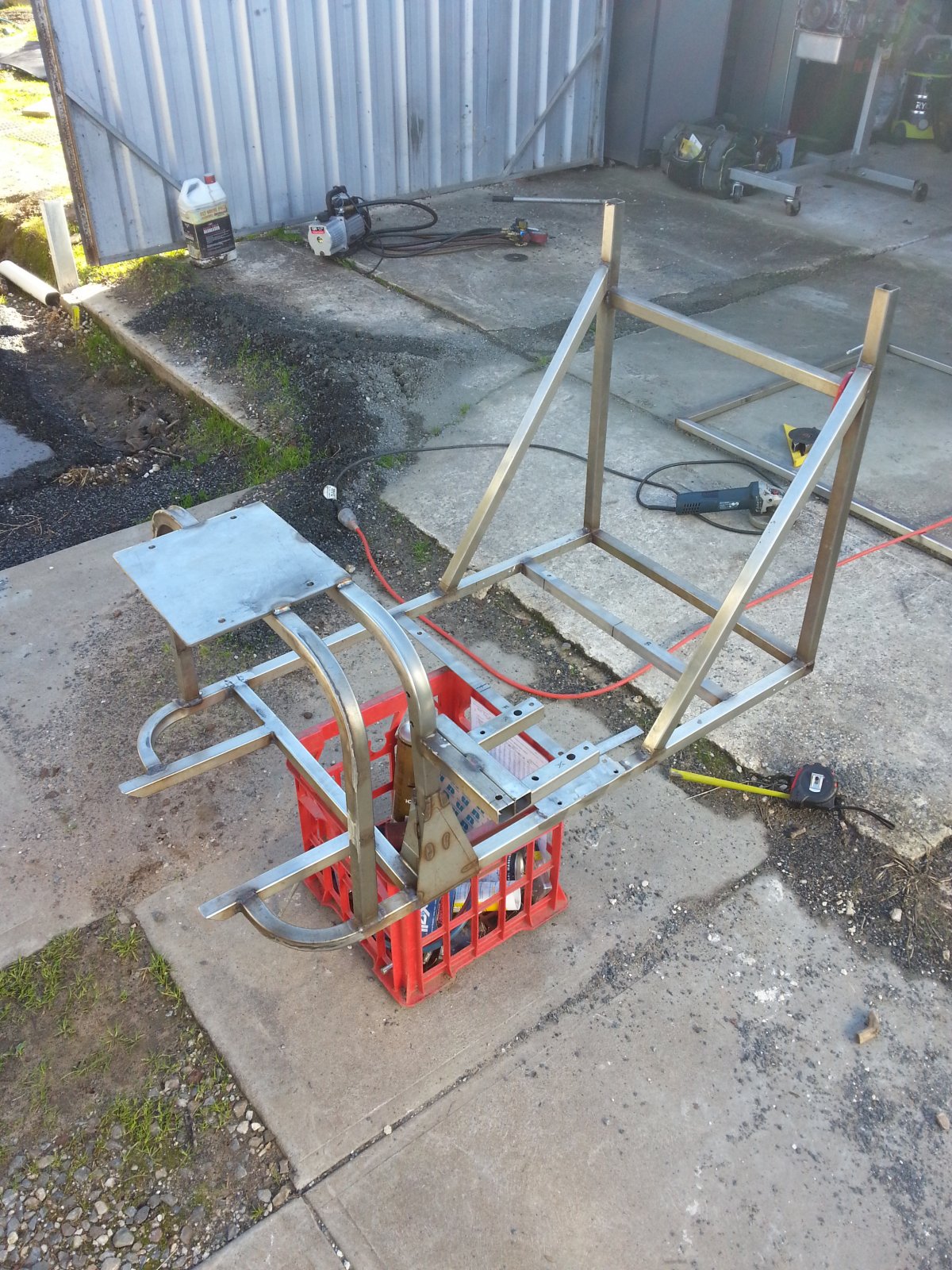

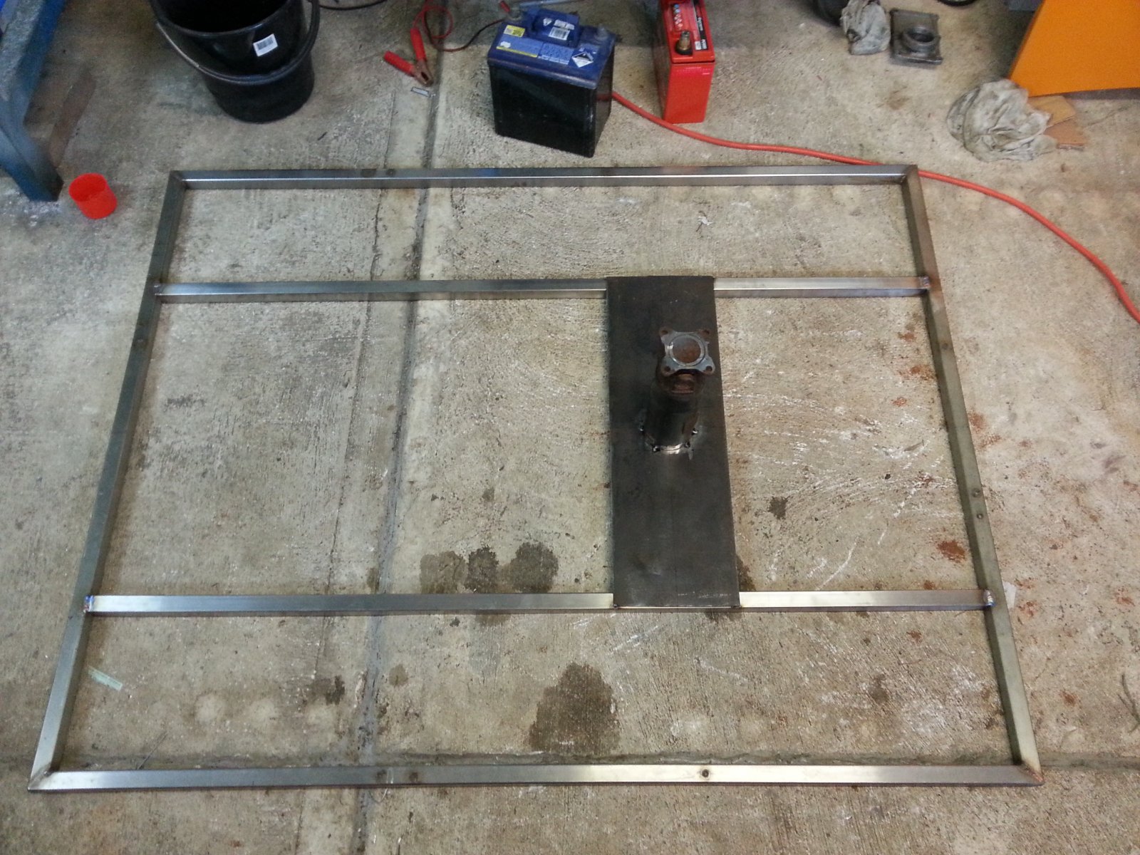

    Made up the bottom frame. Using just some scrap 10mm mild steel plate to weld the uni joint to.

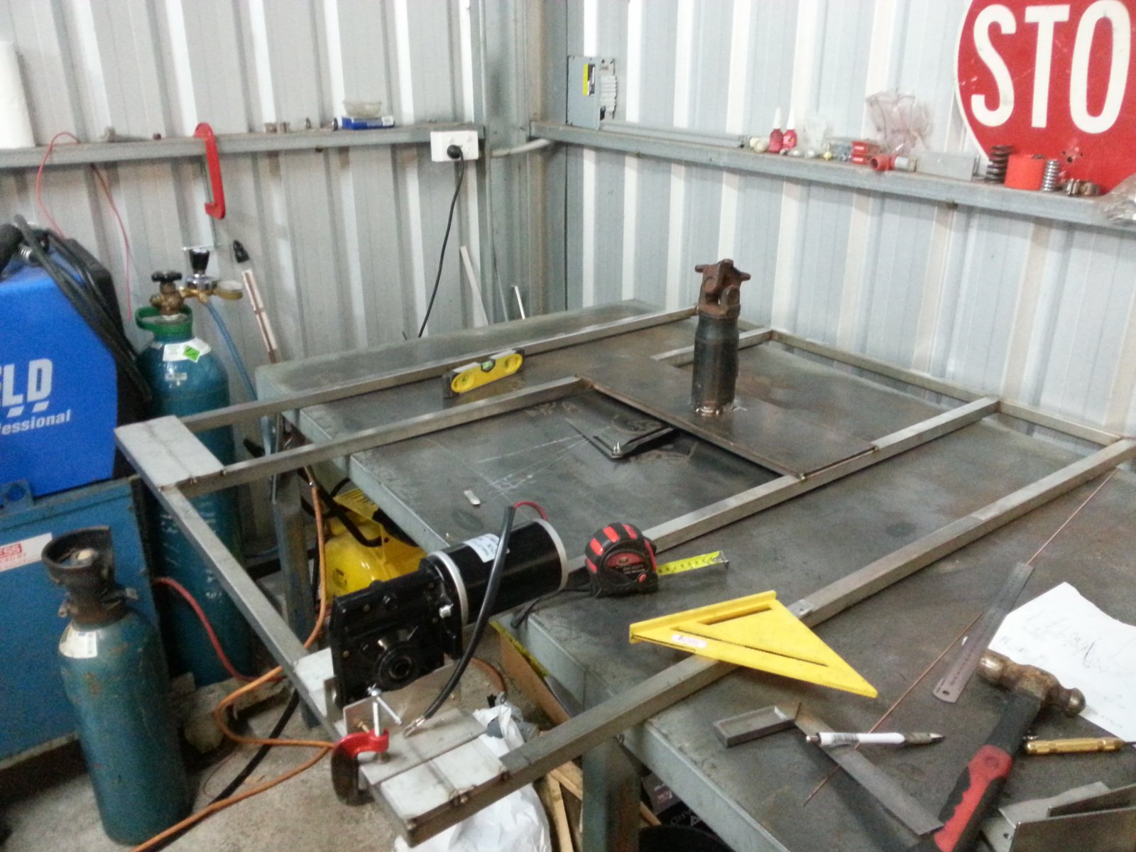

    Tacking the base for where the motors are going to mount.

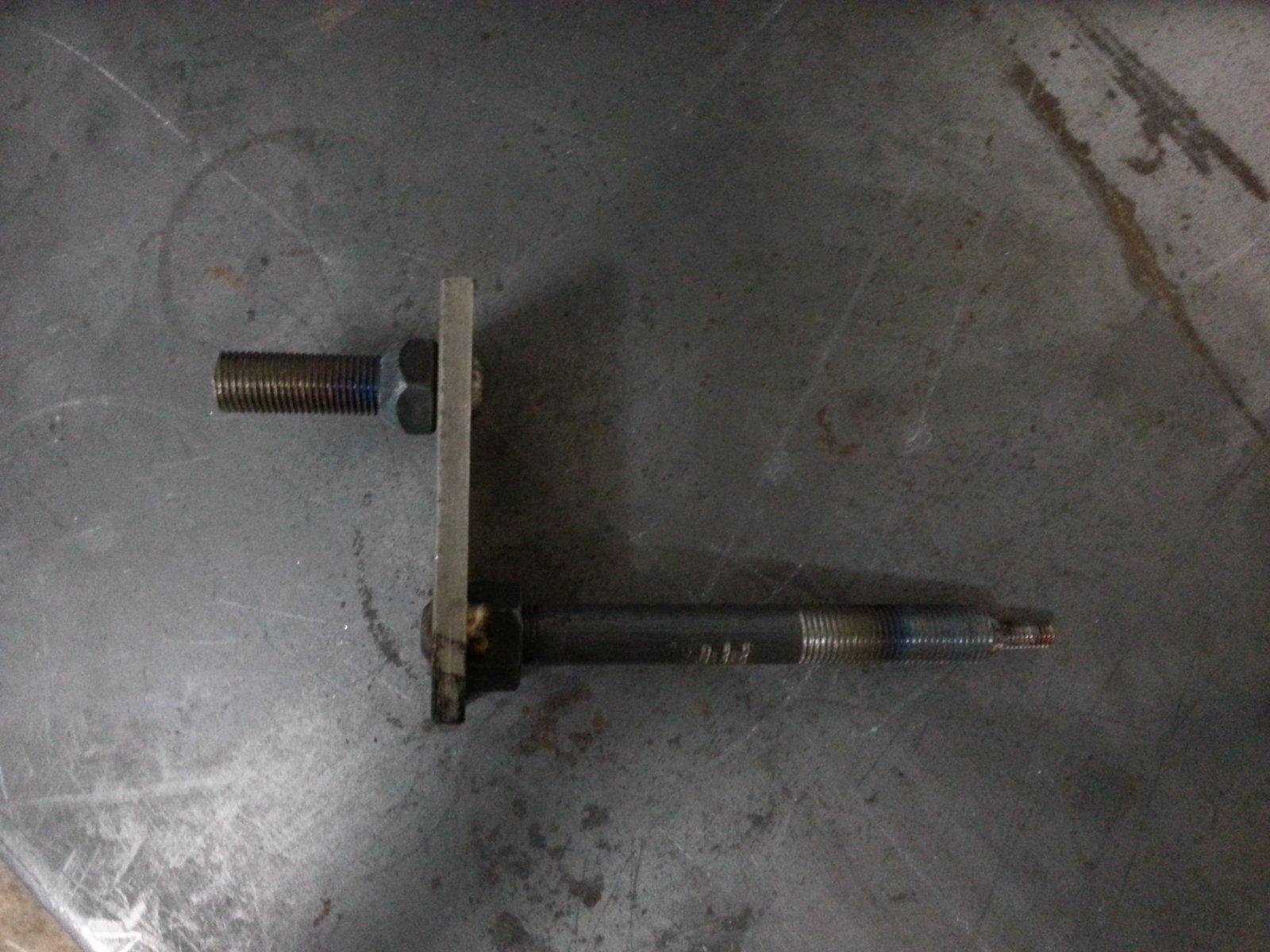

    Welded up some lever arms. They are 50mm CTC. I made it from 1/2" rod which got welded to the 50mm x 6mm flat bar. I then threaded it to 1/2" UNF to accept nuts to hold the rod ends in place. On the pot side I drilled a 6mm hole and welded a 6mm bolt in and chopped the head off. A flexible coupling will join 6mm thread to the pot.
    Motors and uni joint now tacked into place, now to make up some arms.

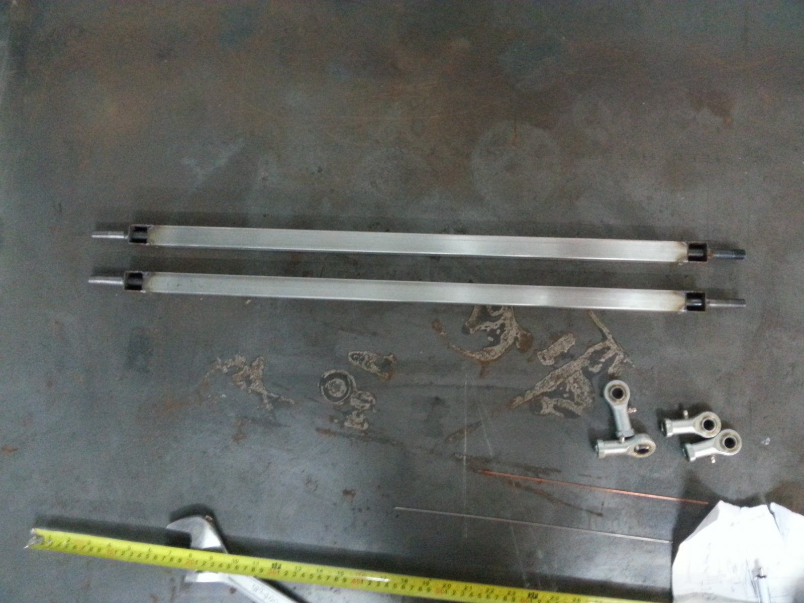

    The arms were made by cutting 25mm square tube into 4x 25mm pieces. These 4 pieces had a 12.5mm hole drilled in the centre and 1/2" rod inserted and welded in. I then threaded them to 1/2" UNF to accept the rod ends. I then welded these to some 25mm square tubes.
    Finally getting somewhere. Everythings looking good.

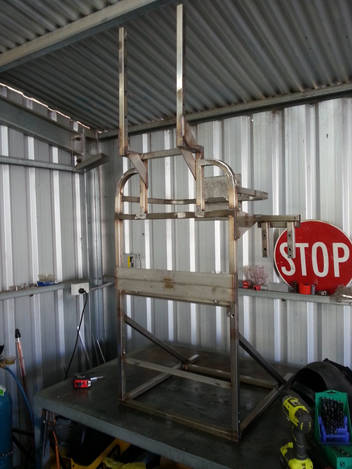

    Did a mock up and top frame was a bit bendy so additional bracing got added to make it more metal!
    Inside finally. Welded in some bar and angle for the PSU's to sit. Still have to make up some guards so people don't kick the pots. Next one I build I'll put the pots on the inside.

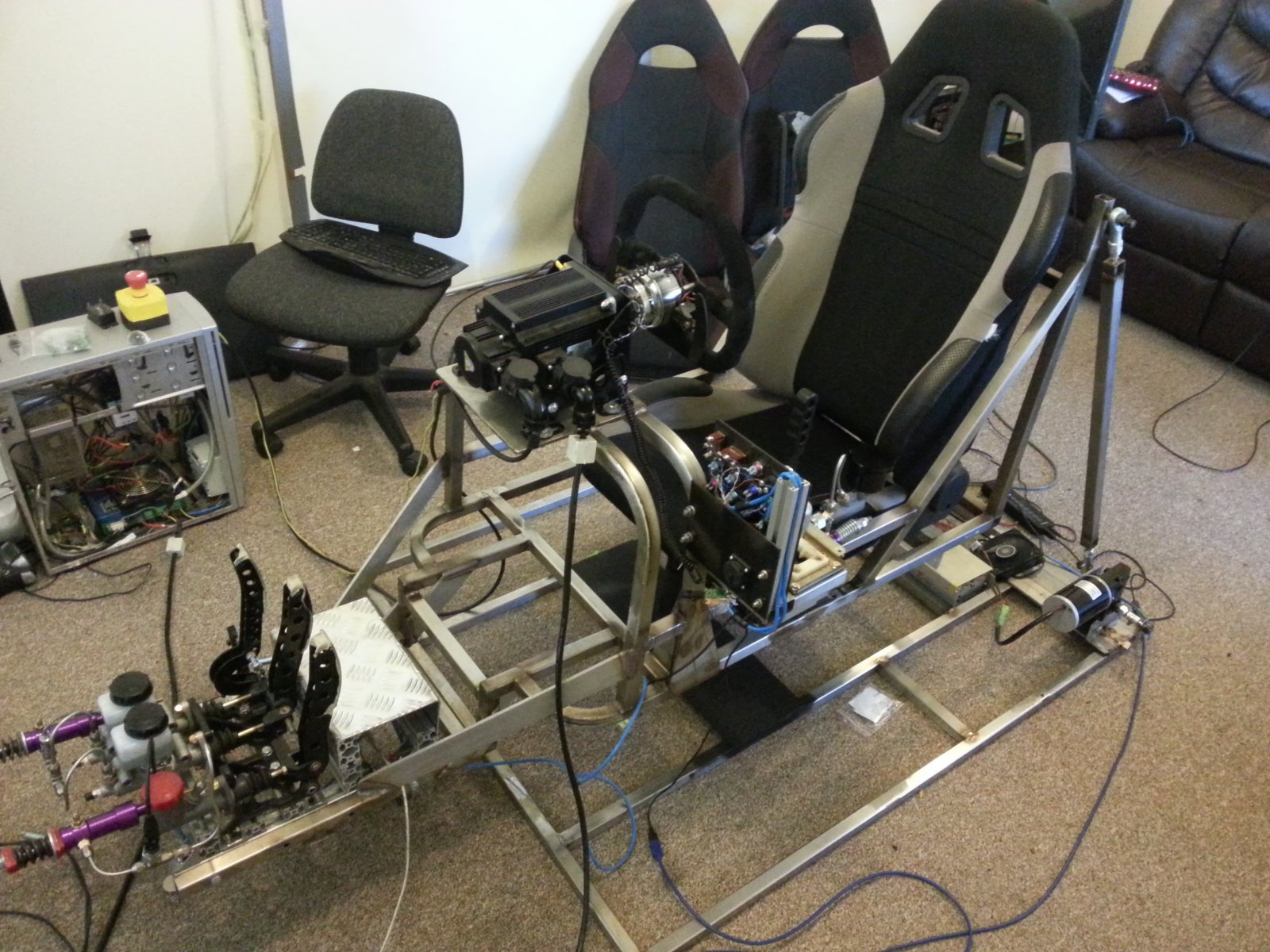

    Finally here it is complete
    Haven't figured out what to do with the electronics yet. Might 3d print something to house them in.
