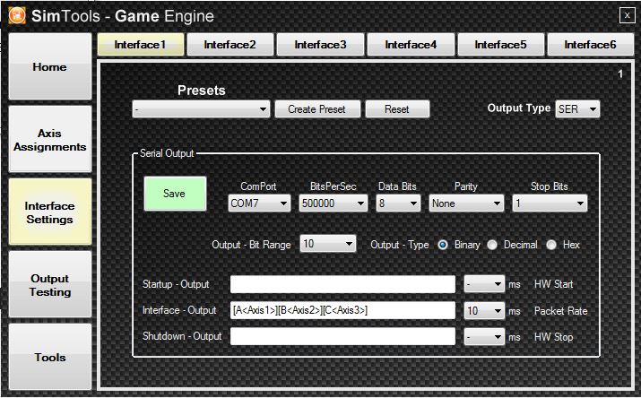

    So I loaded the SMC3 coded to Adruino and was able to use SMC Window Ultility to test the two motor, it seem to work fine.
    Next, I follow the SimTool Quick Start guide and installed everything. But were not able to get my motor to move using Game Engine > Output testing> Mouse.
    I then realized hum... I am using the wrong code for Adruino, so GameEngine is not communicated correctly? I have been searching for the proper CODE and Interface output for the motor/adruino wiring I did above and no luck, the more I look the more confused I get...
    I don't understand what SMC3 code would work or not? Or is it only for testing/tunning the motor?
    Can someone point me to the right Adruino code/Interface output for the above wiring?
    thank you.

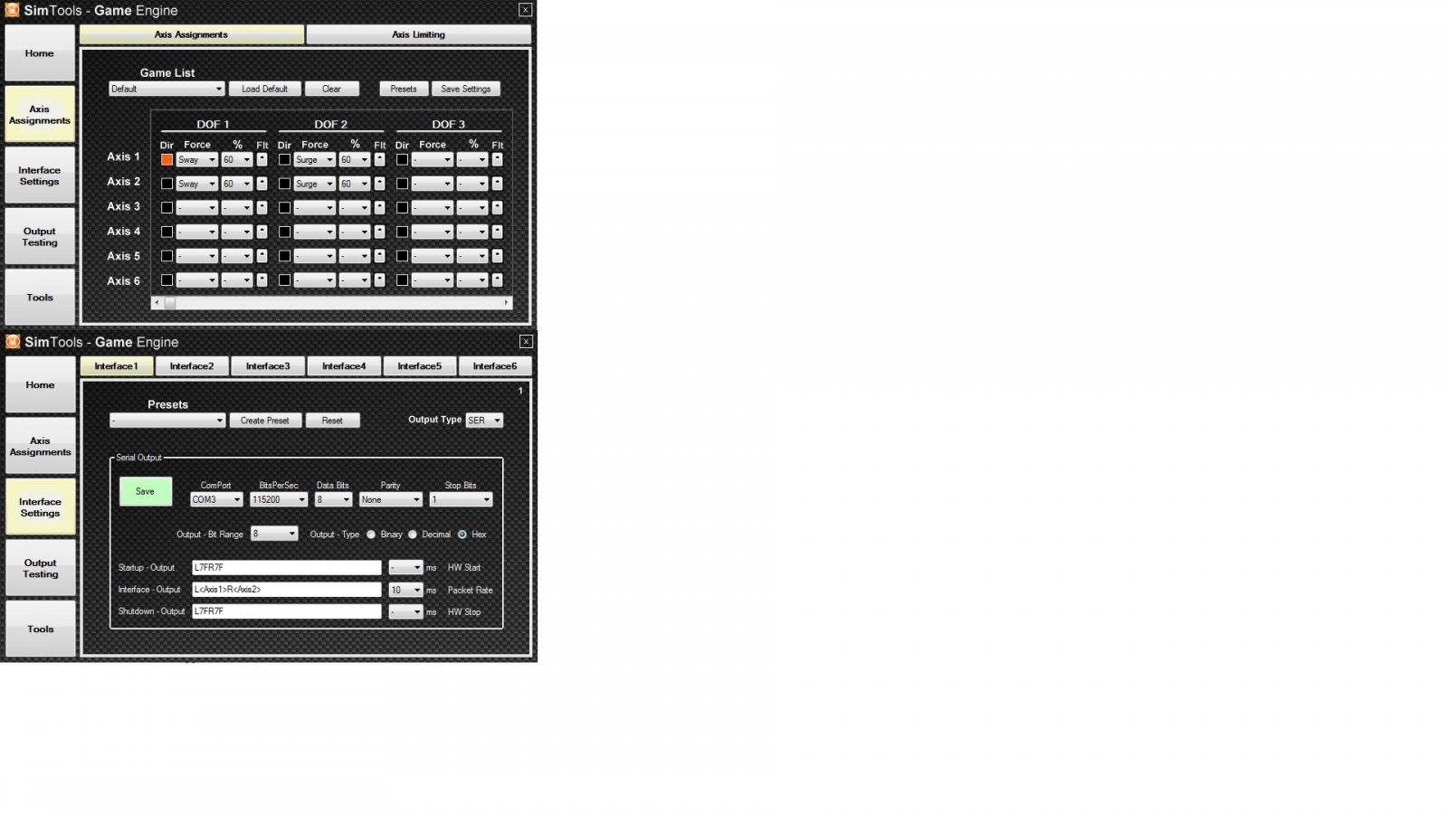

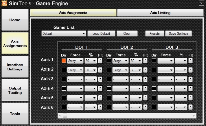

    All versions of SMC3 code should work unmodified for MM boards. I recommend using latest version of SMC3 as it has latest features and any bug fixes etc.
    You only need to change SMC3 code if you want to enable/disable a special feature (which is uncommon) or you are using one of the Chinese IBT2 drivers.
    The screenshot has incorrect Interface settings - they are for another interface.

    Select your COM port.

    Yes, I am using the Adruino that required a special firmware, so I guess that's the Chinese one you mention. My adruino communicated just fine with SMC Utility.
    I guess I am confused with the part... if SMC3 Ardruino code that work with the SMC Window Ultility test, would work with SimTool Game Engine? So if I use the motor testing software and the motors moved and seem to work correctly, then it will work with simtool, just need to config the interface correctly?
    Since this code is for a 3DOF, if I only need 2DOF, it will work fine? I can remove the [C<Axis3>] ?

    For the Axis Assignment, I just choose the default and load SimForce GT and it automatically change it to this... attached screen shot.

    Yes you can remove [C<Axis3>] if only using 2DOF
    Wont matter if left there though.
    Correct, if the motors move OK with SMC3Utils then all you should need to do is setup simtools correctly, no wiring changes.
    Use the settings in the screenshot I posted above.

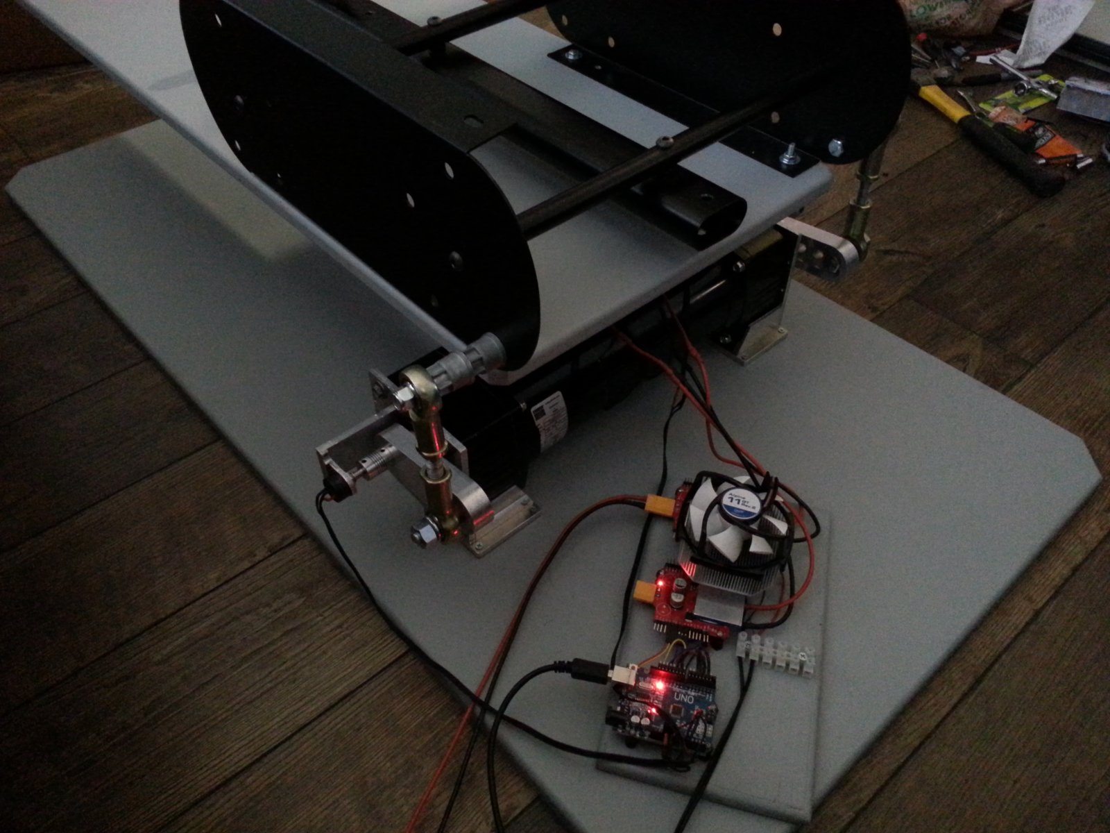

    Hey guys,
    So as you can see my 2DOF is moving the entire platform, seat, steering, pedals. Even though it's CG correctly, but only when I am on it... When I am not, the front is falling down quite hard... How do you prevent this, when motor is not engerize? I see some people add spring to hold the two front corner... Is that to prevent the platform to drop when no motor, or does that only to increase performance?

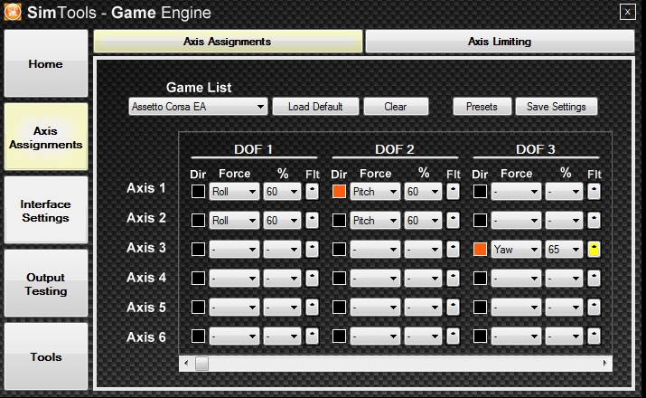

    Hey guys,
    I have added traction loss axis to my rig. But I am not sure if I config it correct? If I am using AssettoCorsa, which do I assign it to? Yaw or Extra one? It seem I can't get either one to work right.
    If I set it as Extra 1....then it seem like it a direct response to the steering, if I steer left, rig slide right, steer right rig move left. If I set Yaw, it doesn't follow steering but it doesn't seem to start losing traction at the right moment, it's doing some funky stuff.
    Attached screen shot of Axis assignment. I hope it's right.

    Unfortunately I have read both of those thread and can not figure out a correct values... or it doesn't seem to work right.
    If I set it as Extra1, when I steer left and right, the rig slide left/right, even when the car is sitting still... this doesn't seem right?

    You need to define your settings and use filters plus the tuning center min and max values: https://www.xsimulator.net/communit...s-slow-break-out-fast-return.5999/#post-64128

    Well.... I think it's getting better.
    Axis Assignment, 3rd axis 100% (this values is controlling how much movement to motor and being limited by AxisLimitting right?
    TunningCenter = It's like a calibration? letting SimTool know the range of all the output? (after redoing this it's better now... extra is about 3.98
    Profile Editor = Game output level for each axis varies by saved profile?
    Am I close on the above?
