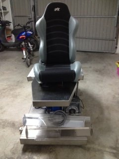

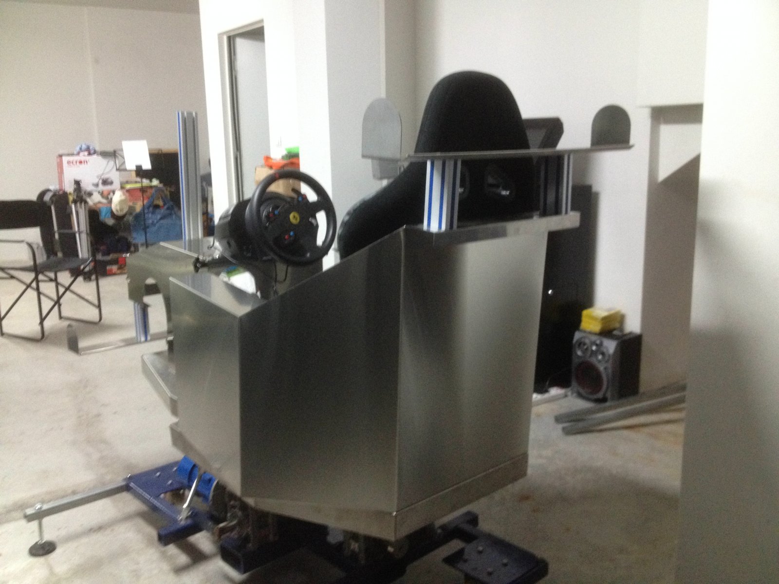

    Hi !. I've started to build my simulator 2dof electrical motors with variators.

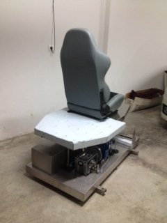

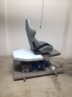

    Hi !, this is my Beta Project.

    That looks interesting, can you please add some more details regarding the build components and process.
  11. simupp
    simupp New Member
    Apr 20, 2017
    26
    murcia
    - 89Coins
    +8 / 0 / -0
    Motion platform

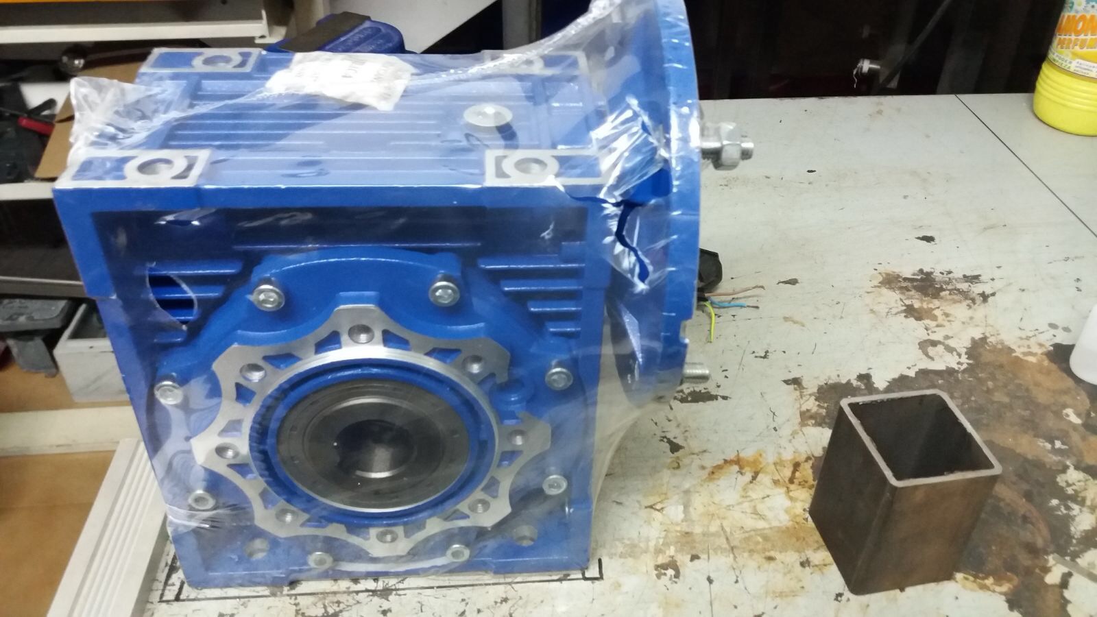

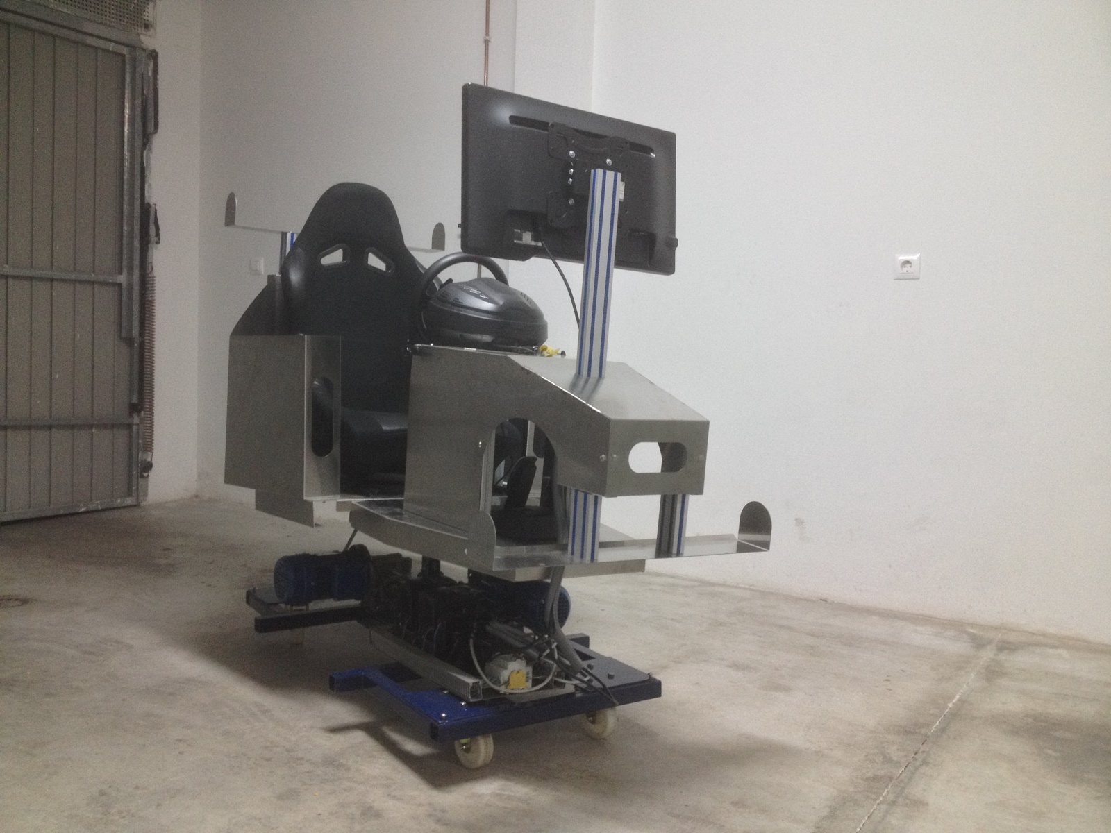

    Our Project has goal to make a small and light motion simulator: plug and game. Small dimensions and easy transport.
    For start up you only need to push on button.
    It is:
    - A plattaform with Plc omron CP1L
    - VFD omron 3g 3mx 007
    - Reduct Motor 3/4 CV.

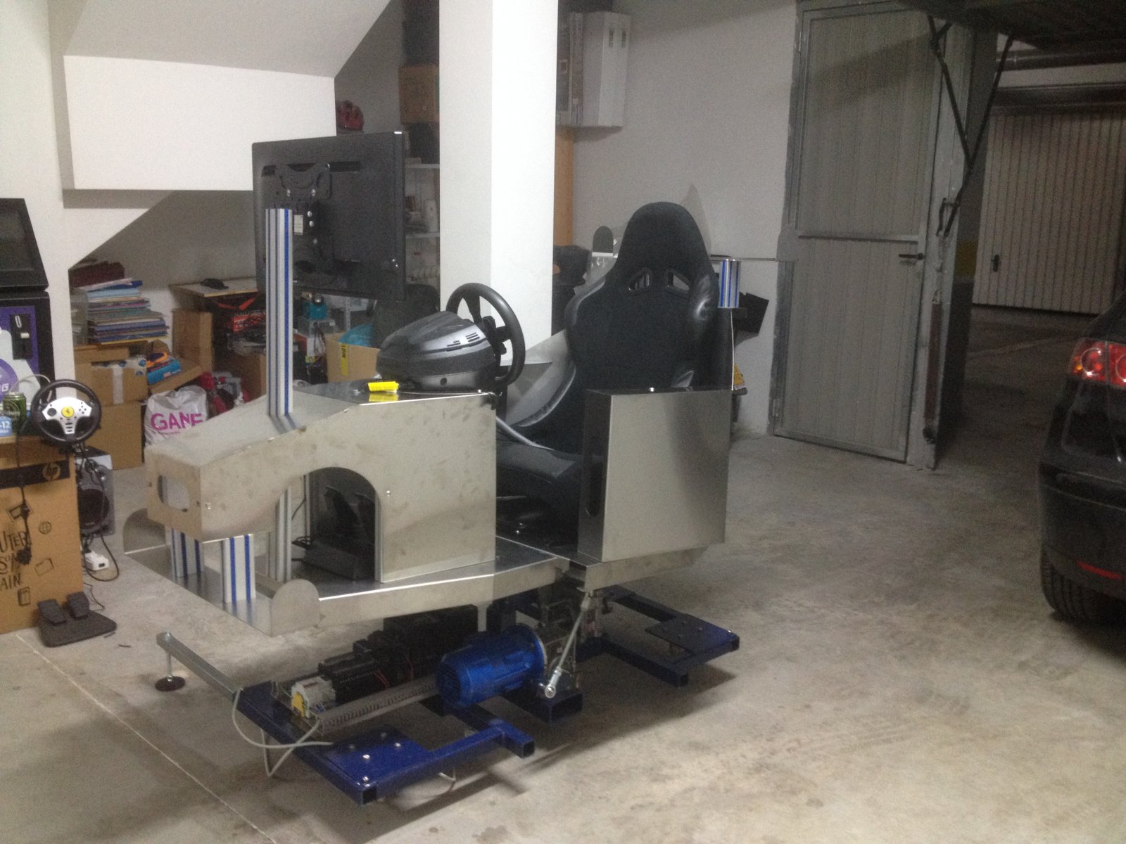

  12. noorbeast
    20,563
    145,196Coins
    +10,781 / 52 / -2
    I am a little confused, there seems to be multiple sims here, as these appear to be somewhat different in terms of the frame, seat and sheet metal work, is this a commercial project or prototype?

    I'm building a car and flight motion simulators at the moment. If everything is good I will sell it. Of course.
