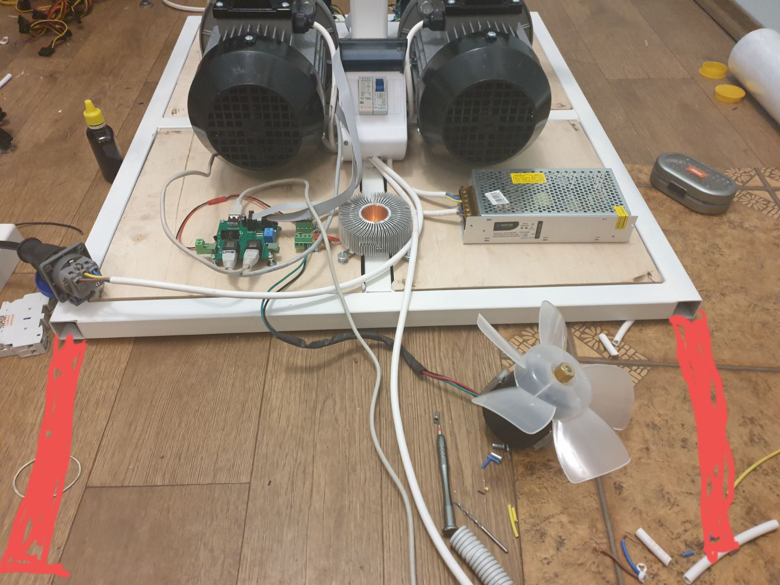

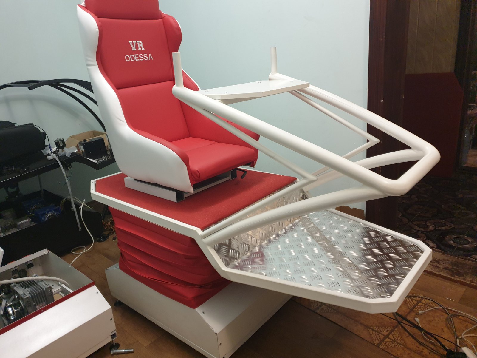

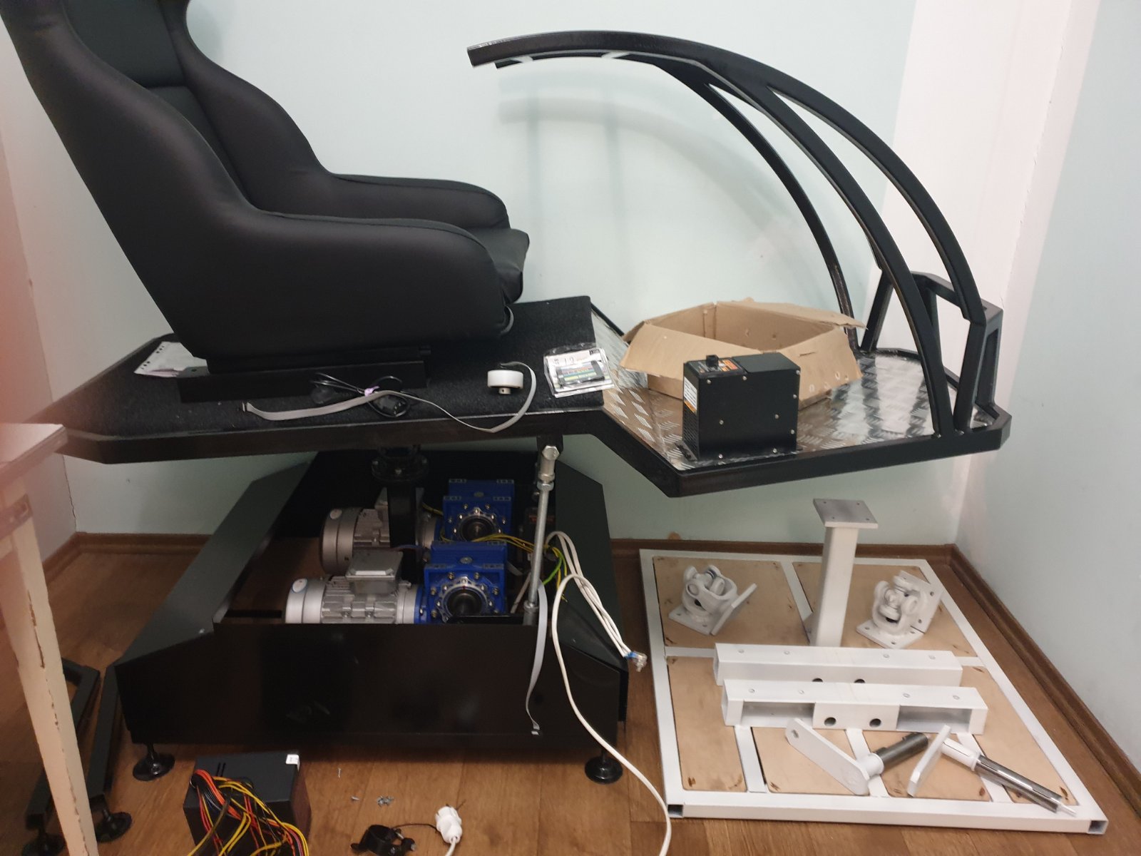

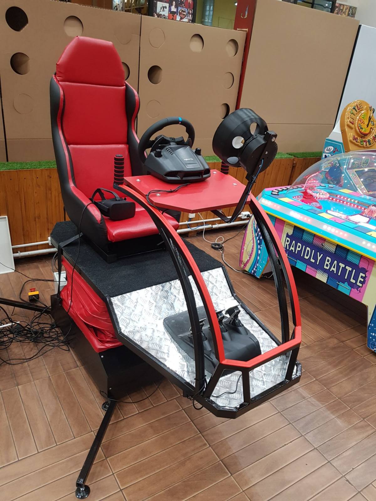

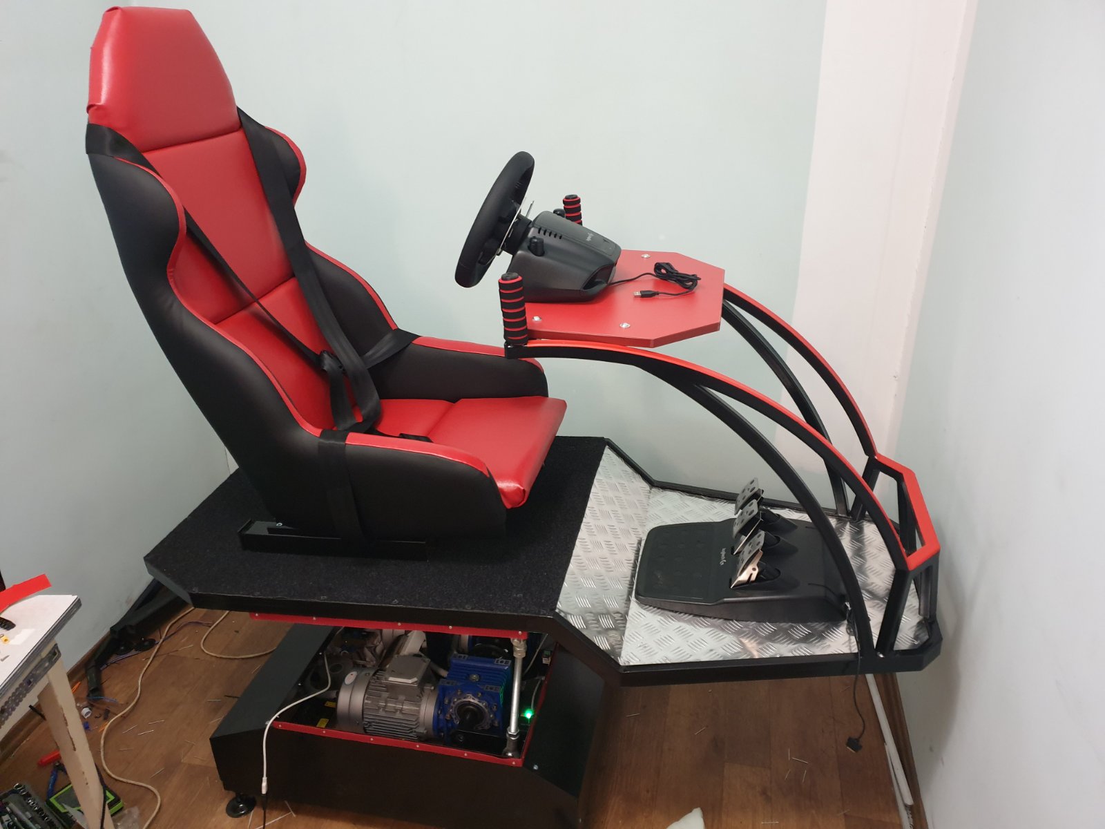

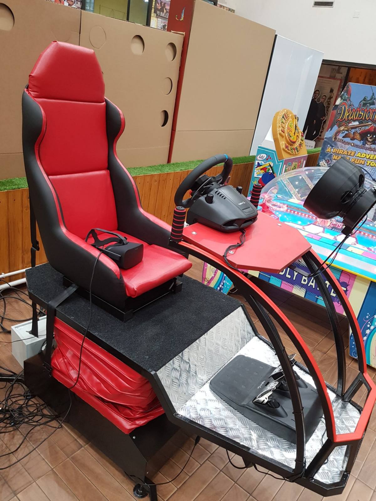

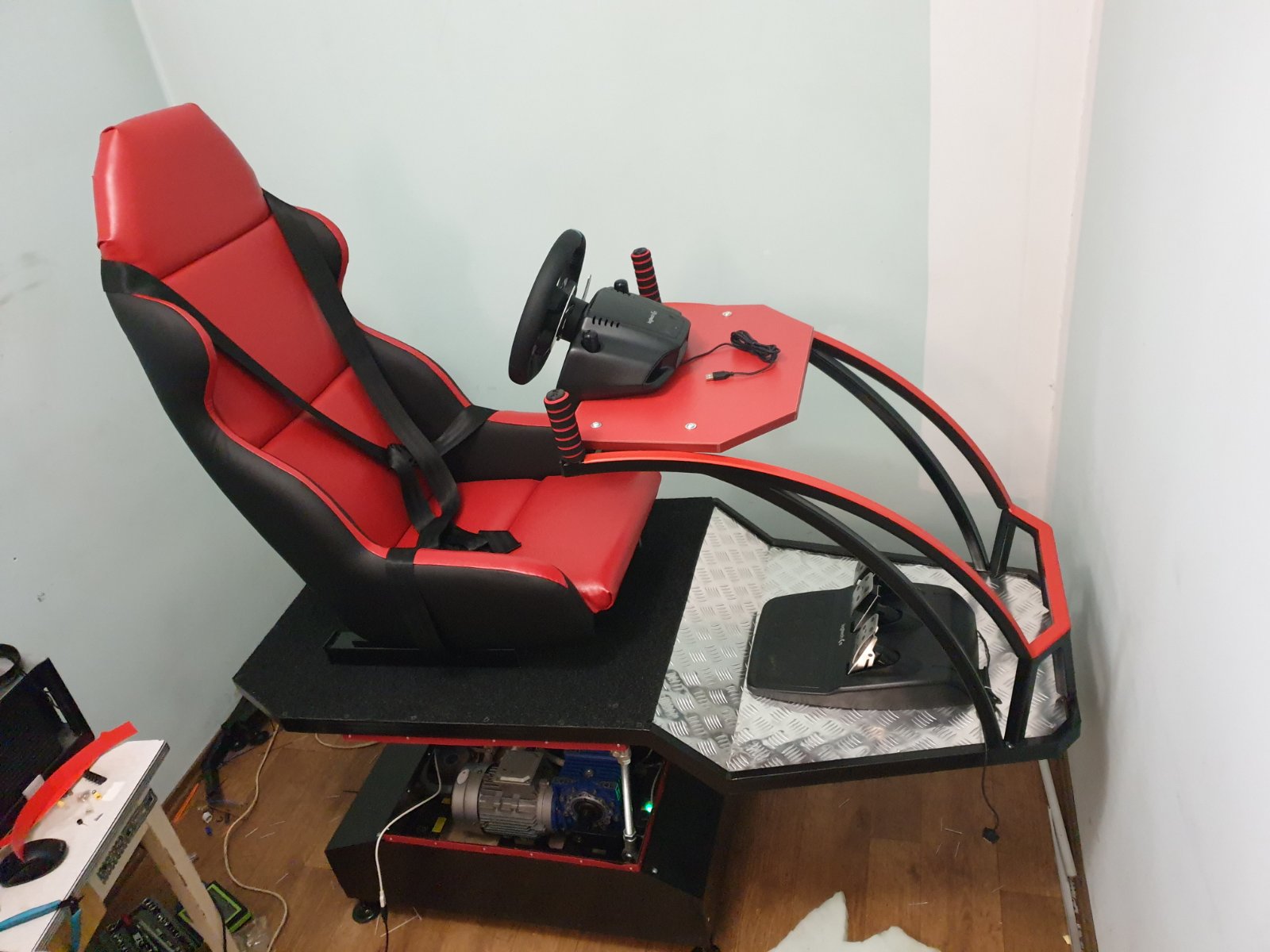

    This simulator was created during the year.
    The mainboard was created by me and printed on in China based on the stm microcontroller.
    The software was also developed by us personally.
    It operates with two electric motors with a capacity of 0 75 kW.

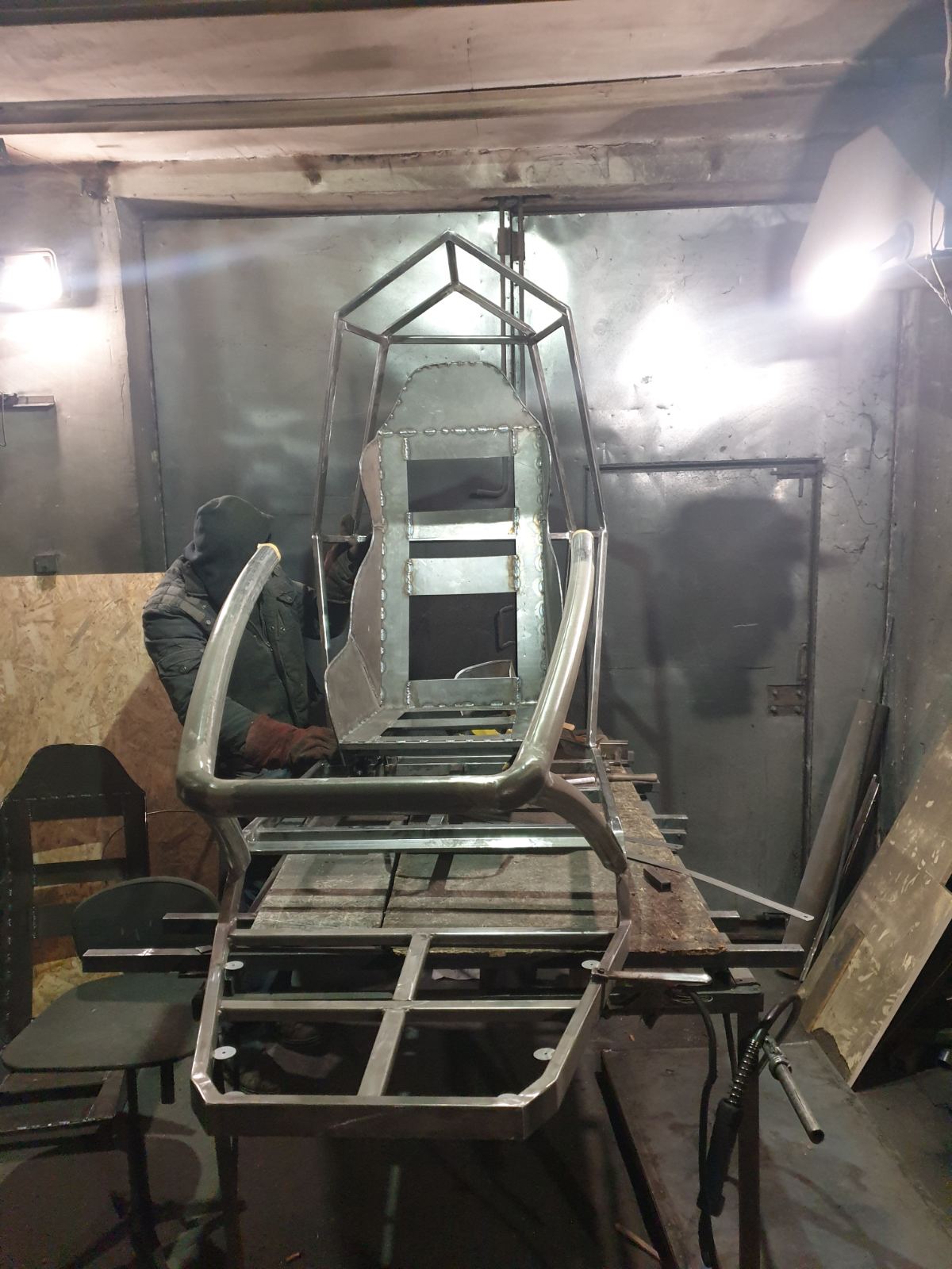

    I assembled and painted the entire construction.
    Also added the ability to control the wind

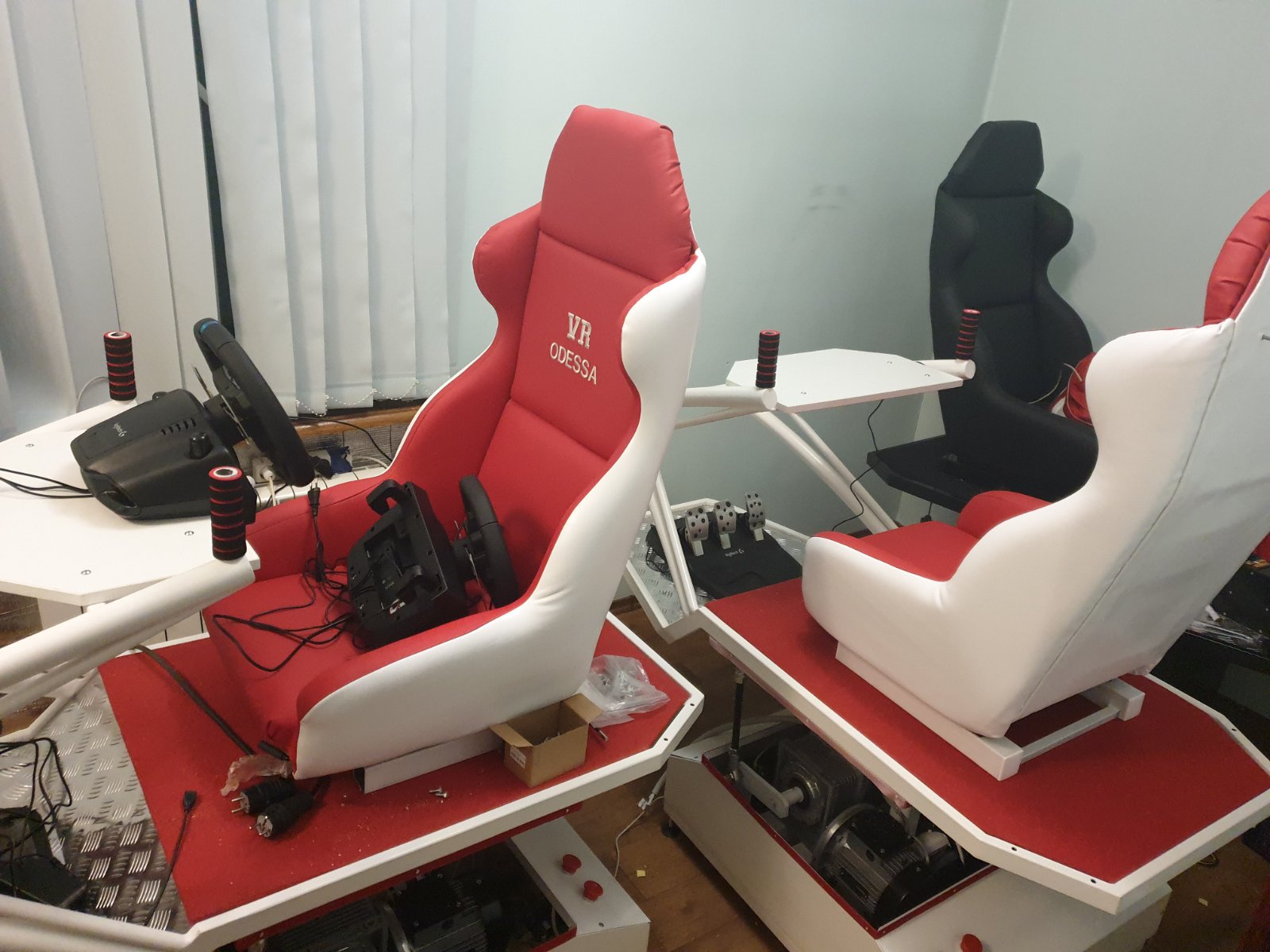

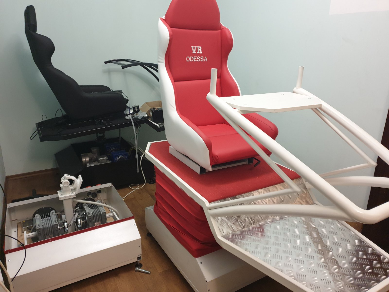

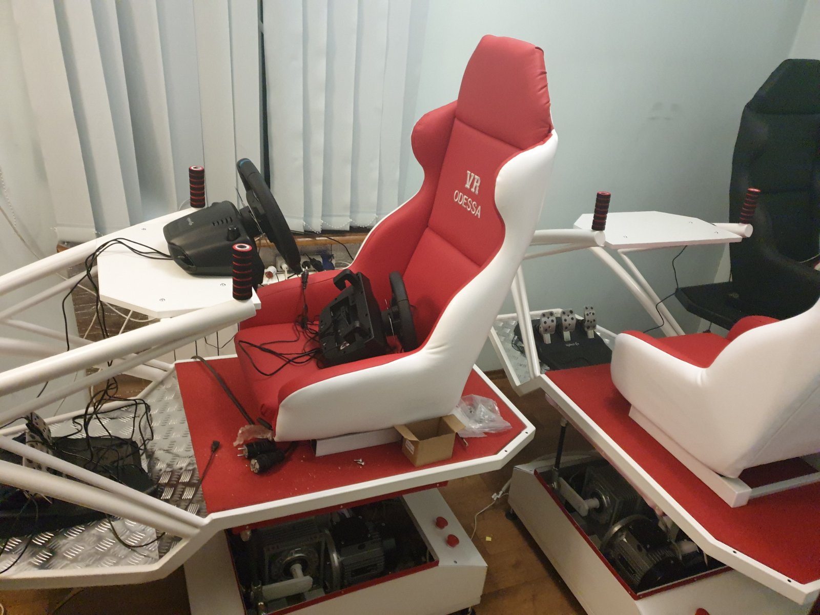

    With the different seats and top frames this looks to have been multiple prototypes, is that right and if so can you tell us a little bit about that? Are you prototyping for possible commercial production, or evolving the rig for other reasons?

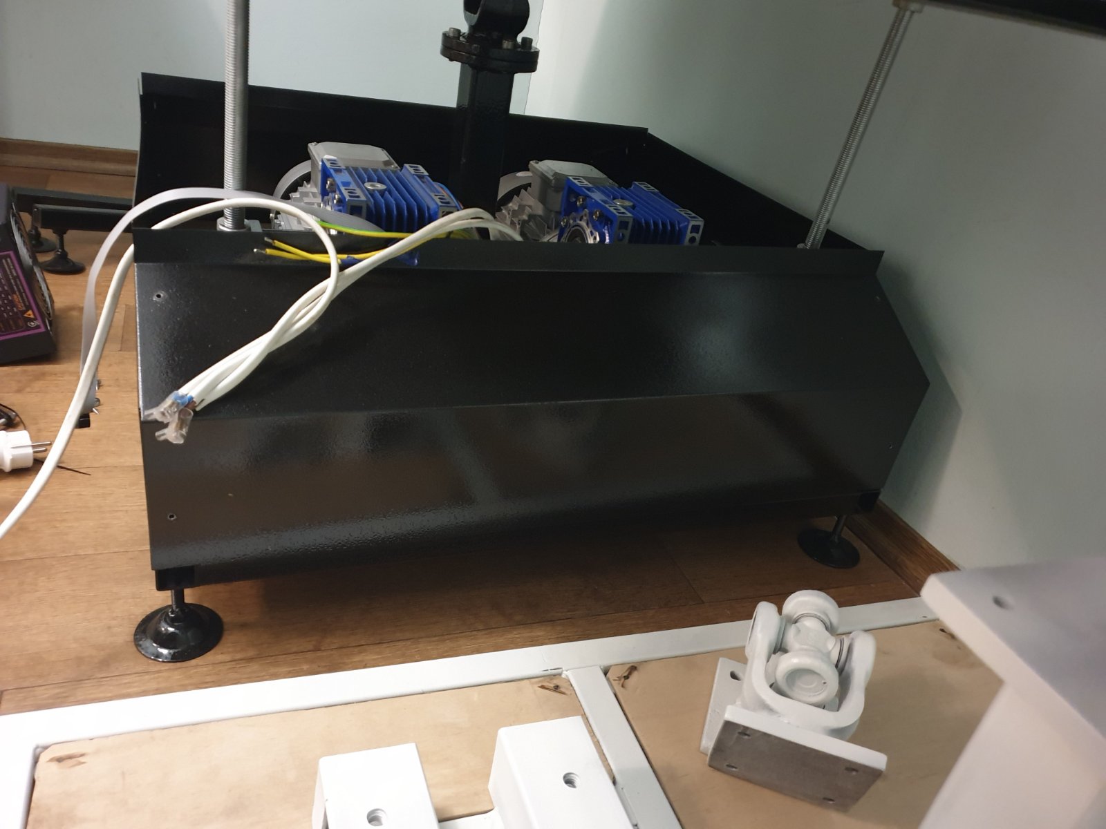

    DC motor, Arduino
    Looks very profesionall ! But I have one question, are the motors 325 w each or are they 750 w each ? If its 750 w each then another question, do you really need such power motors for this setup or is the frame heavy and power here is to compensate the weight?

    Could you list the components?

    For today It is not a commercial Project. we just make three different
    Items for a request of our friends.
    and they are in testing period for now...
    In future it is possible that it can be commercial Project

    750 each

    - 137Coins
    all this power for my friend 143kG)))

    i will, but at the end of project////
