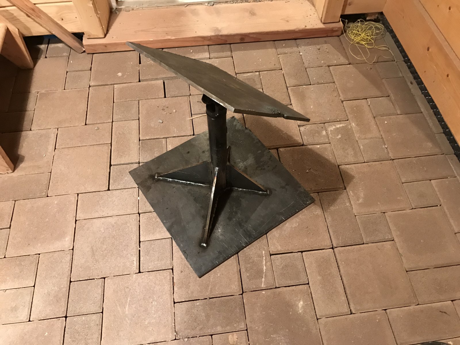

    Little update: cutting metal
    8mm Steel- its quite heavy but will be durable

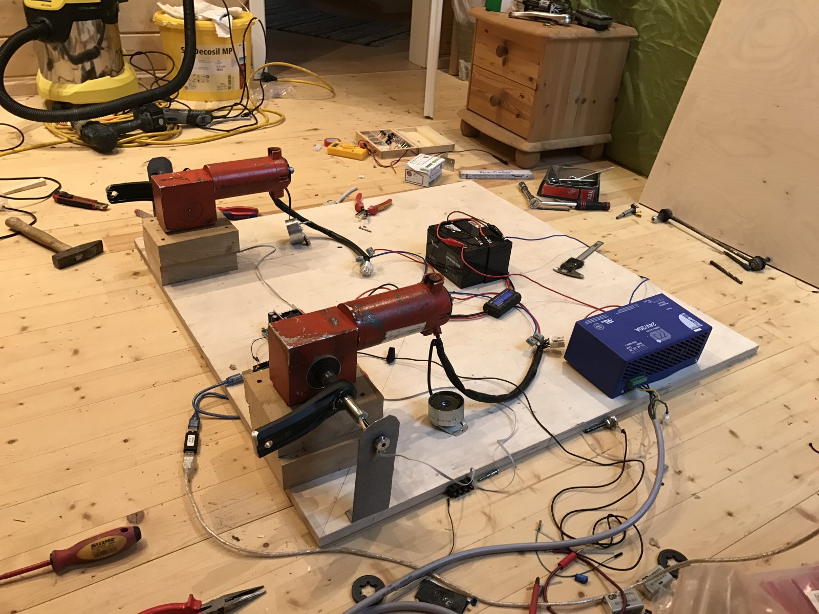

    Yesterday a friend helped me welding the strut , very strong now
    This morning I mounted the second motor and tested it

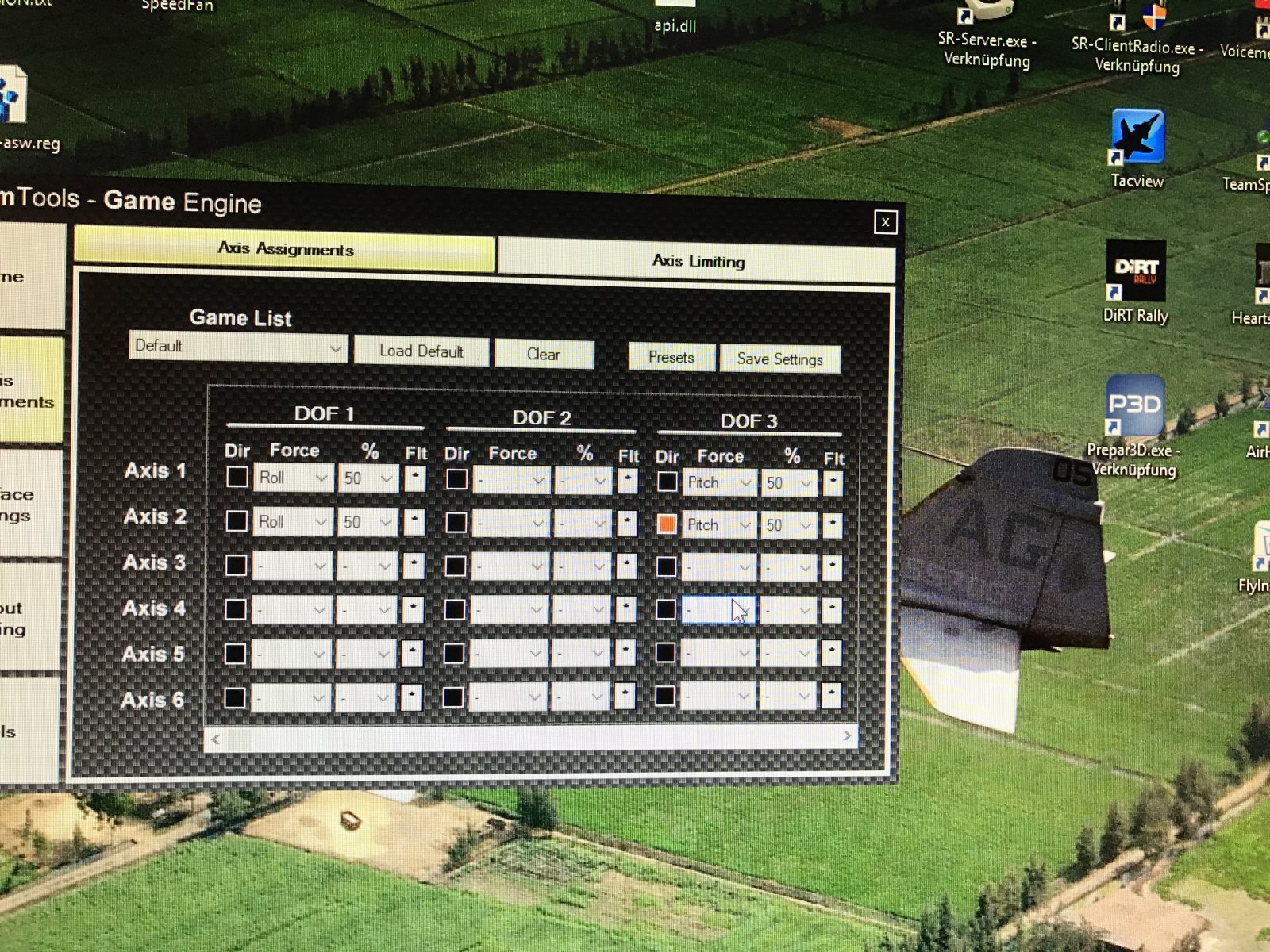

    But now there is a strange problem:
    As soon as I invert an axis movement in simtools, the inverted axis begins to stutter when used ... someone knows this problem?
    My settings with the stuttering pitch axis
    When I uncheck the invert function it works absolutely smooth, but in the false direction
    (Same for any other axis)

    Issue solved! Lowered the boud rate from simtools and the ard from 500k to 115200 - now it's smooth as silk

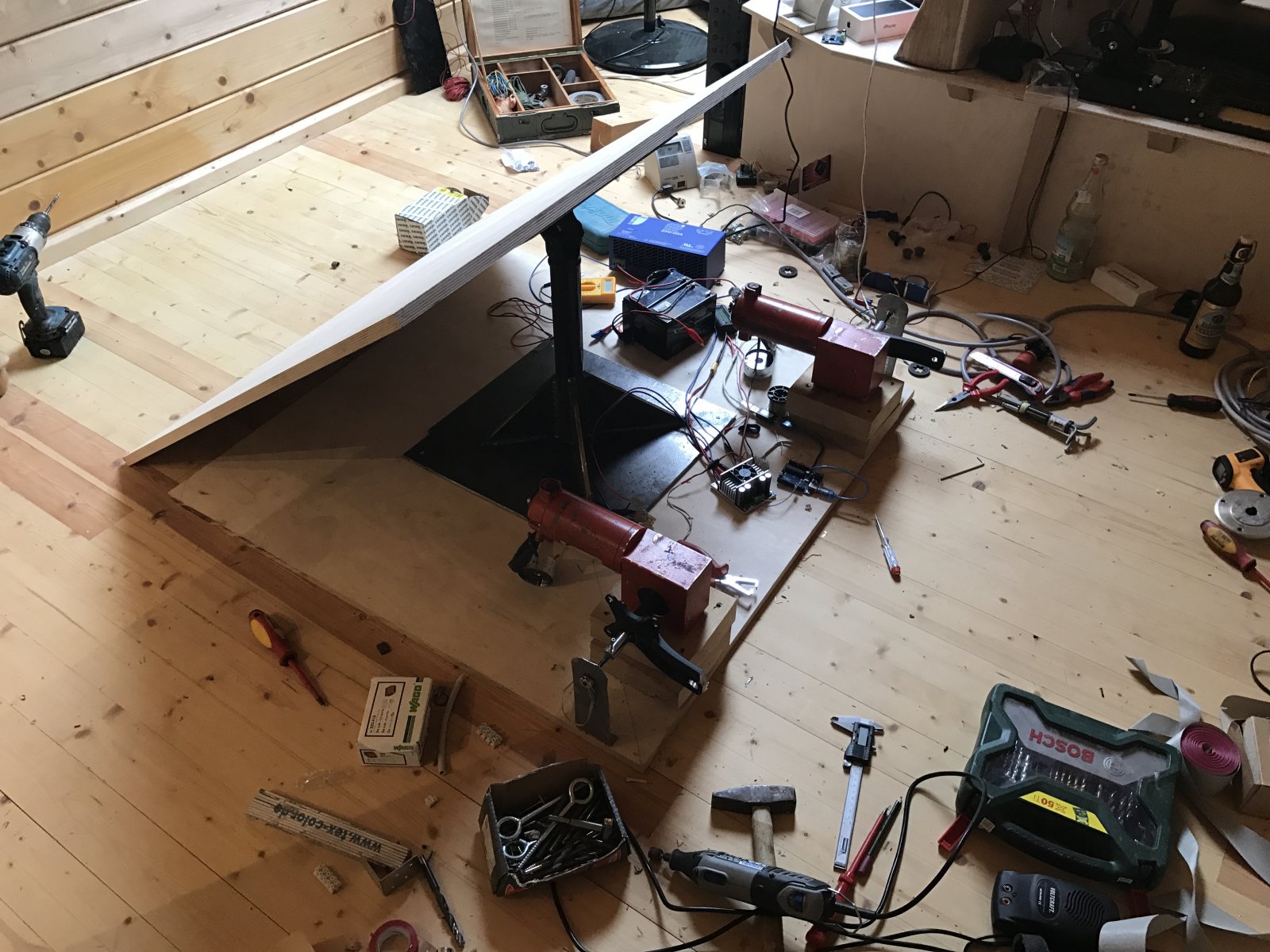

    Update:
    Motors works now, pivot is in place, this evening i will mount the top plate and then start the first manned test and counting currents .

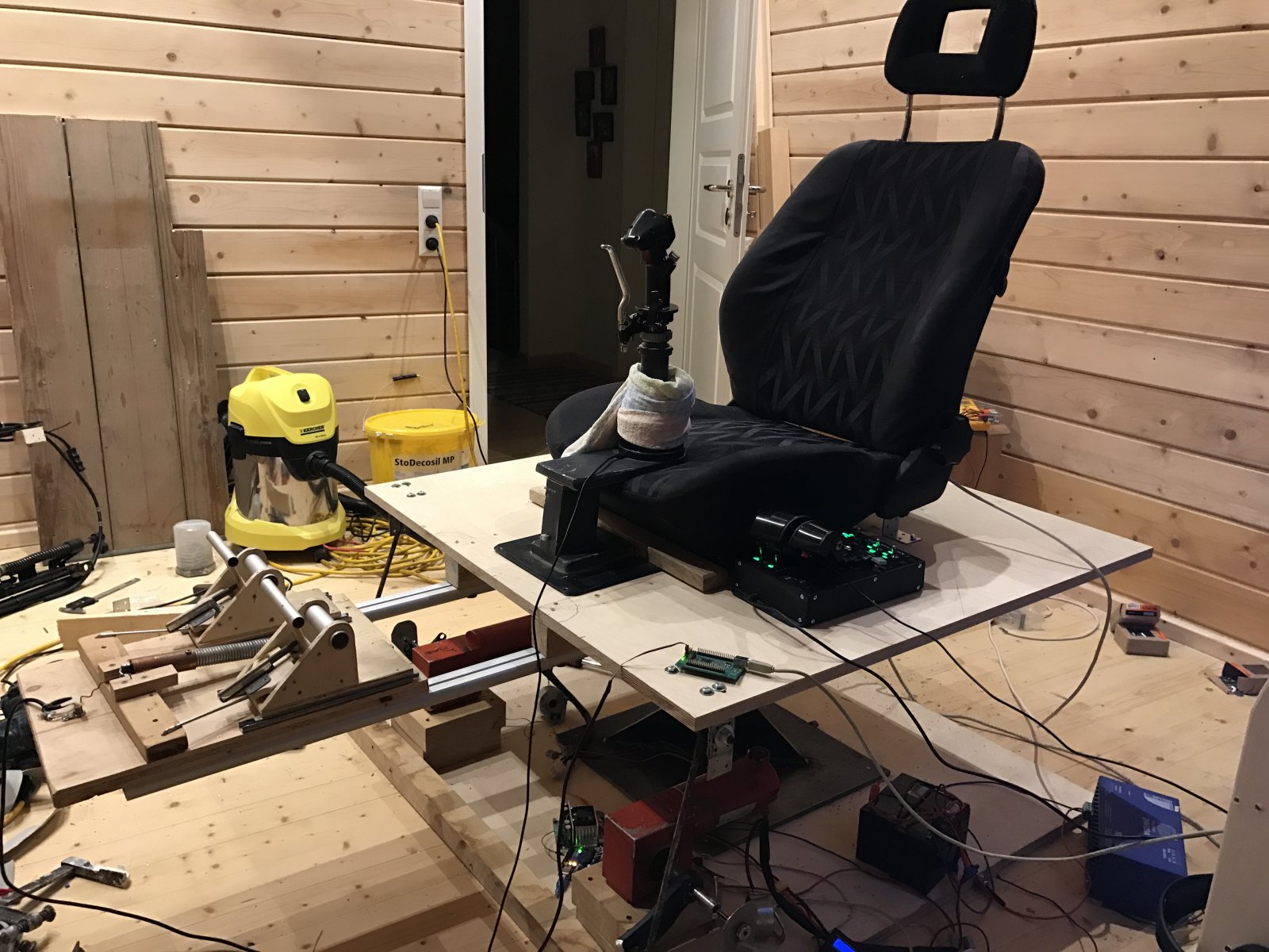

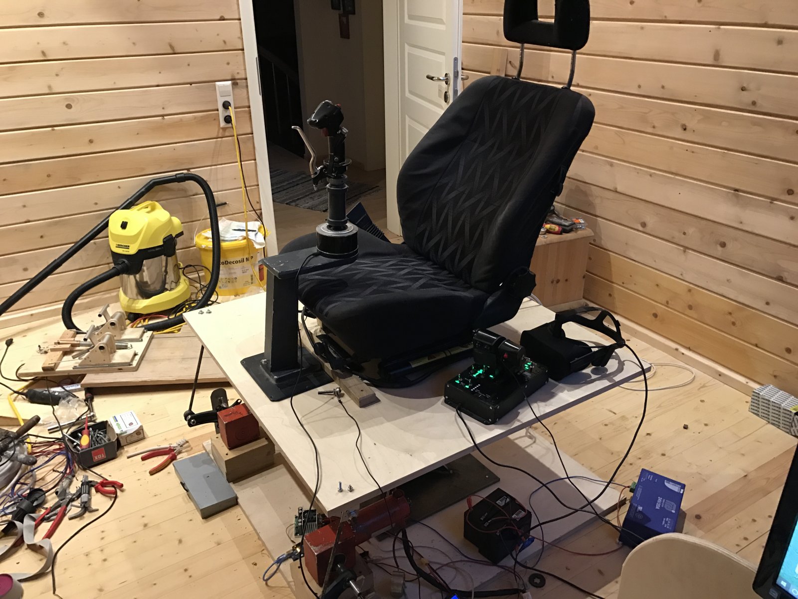

    IMG_5305.JPG It's done! It works , no smoke, no broken arms and legs and moderat current (34A Peak together)
    On motor is getting a little warmer (44°c) then the other (30°) , will search for the "problem "
    All in all it's really great! Now the work on the esthetic aspect starts ;)
    Thanks everyone for your help and good luck with your projects!

    Work continues:
    Lowered seat and stick
    Added pedals
    Reinforced pushrod mounting on the top plate
    Now I have to tweak the pid and output from the DCS plugin. It's a little jumpy sometimes.
    The platform is really fast! It throws me around when I perform a fast roll or g force changes
