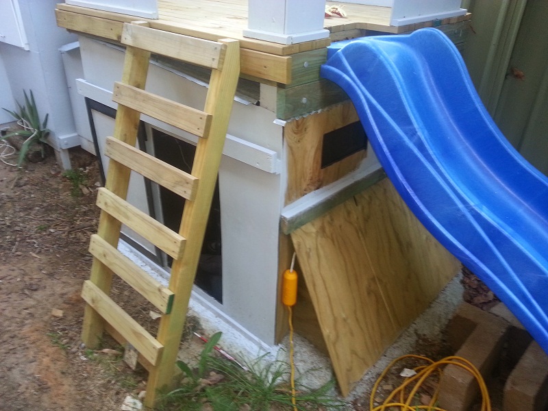

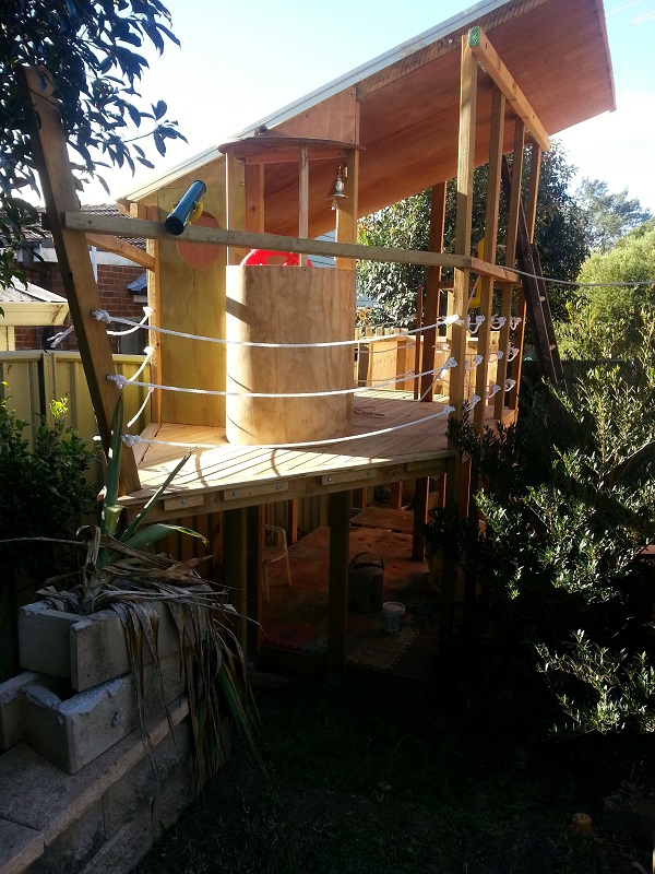

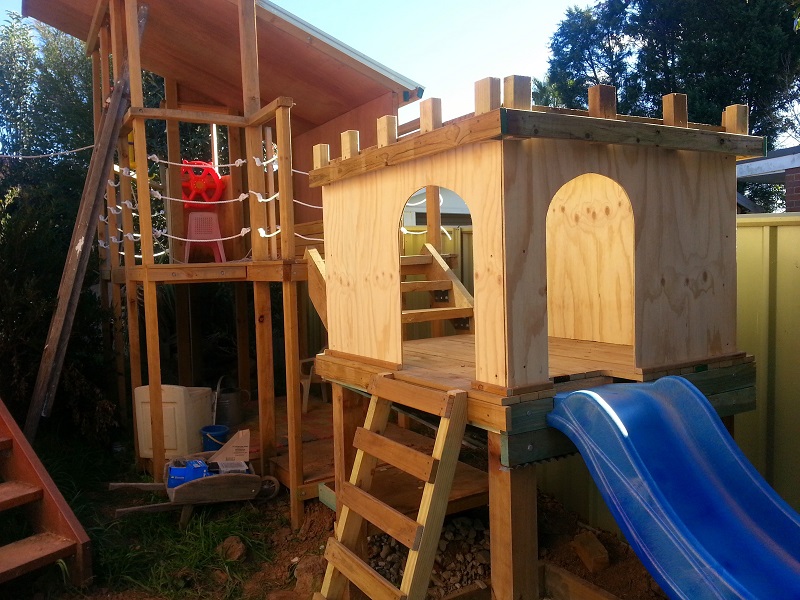

    The idea of building a flight simulator was sparked by my wife deciding it was time I built my kids a cubby house. The oldest kid was into boats and so he decided he wanted a boat cubby house. This is what I built over the following few weekends.
    Anyway, after it was finished the kids were delighted for a few hours. Then my son announced that he doesn't like boats anymore and now really likes aeroplanes. "Can you turn it into an plane for me". So, yes, I beat him.

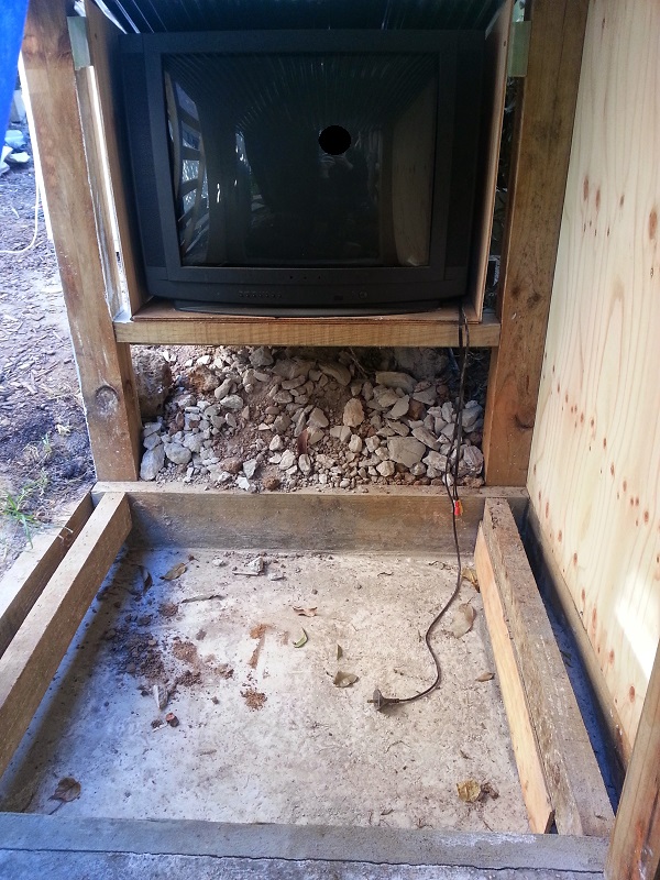

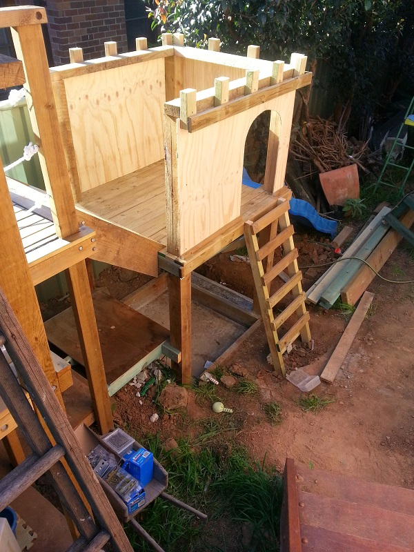

    Anyway, I've always liked planes as well and his comment got me wondering about how hard it would be to build a flight simulator. During my subsequent internet research I was fortunate enough to stumble upon this X simulator site and the plan was hatched. The simulator is buried underneath the cubby house. I had to build a platform for the cubby house's slippery dip and was left with a small space underneath. This area was initially going to be a sandpit or paddling pool but I figured I could probably squeeze a small flight simulator under there.

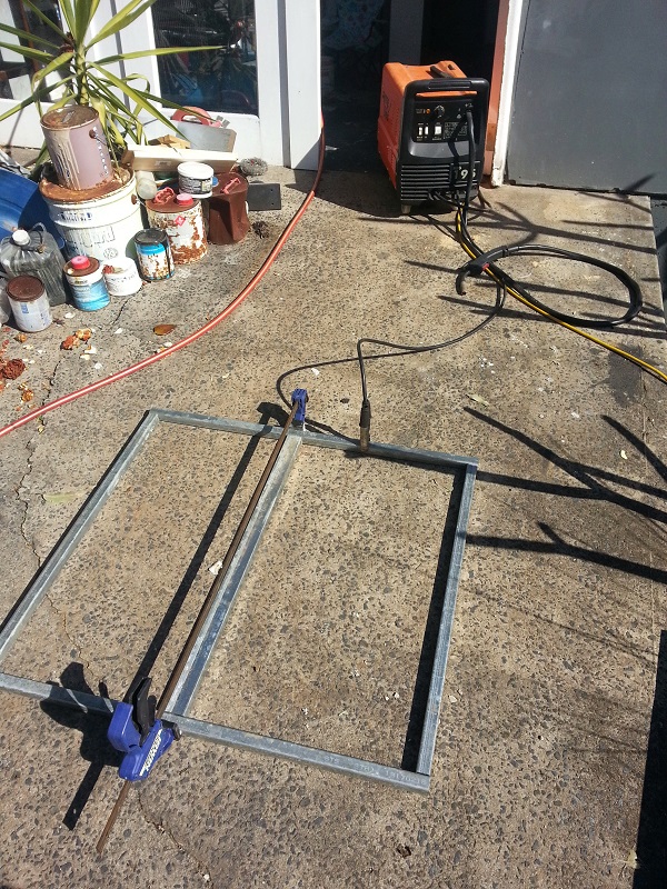

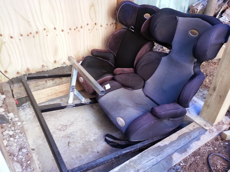

    I mentioned before I can weld. Not well, but I'd taught myself by re-building a boat trailer. Here's how the welding started ...
    Here's how it ended up ...

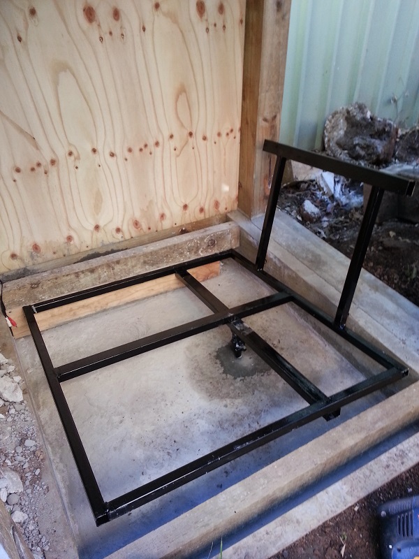

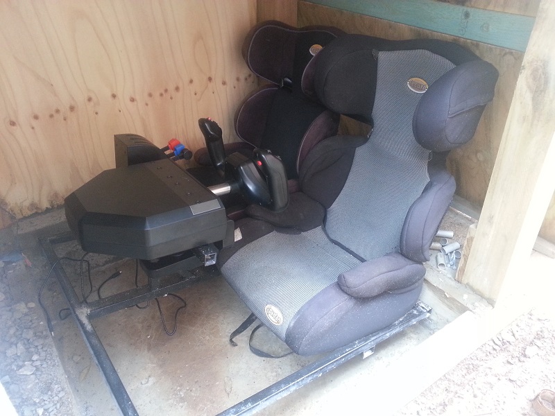

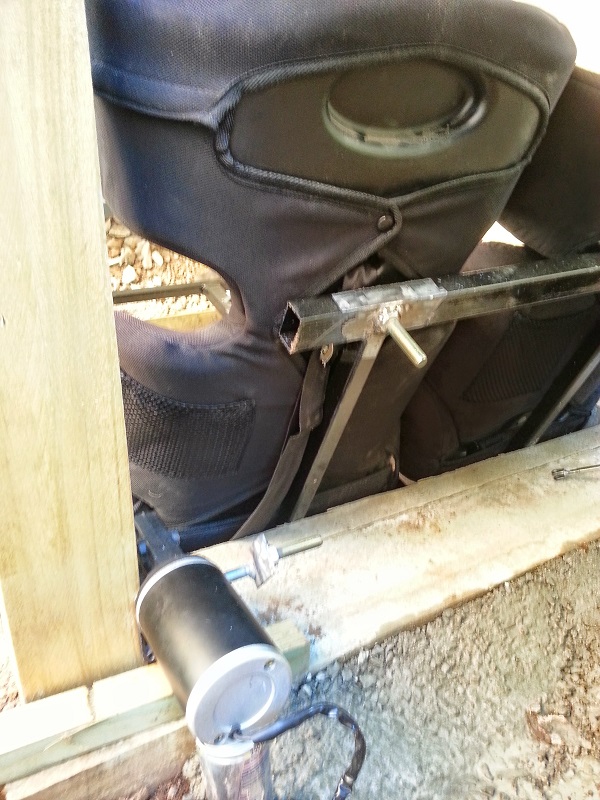

    The motors are mounted to the shoulders (via 12mm threaded pipe and tie rod ends - not shown).

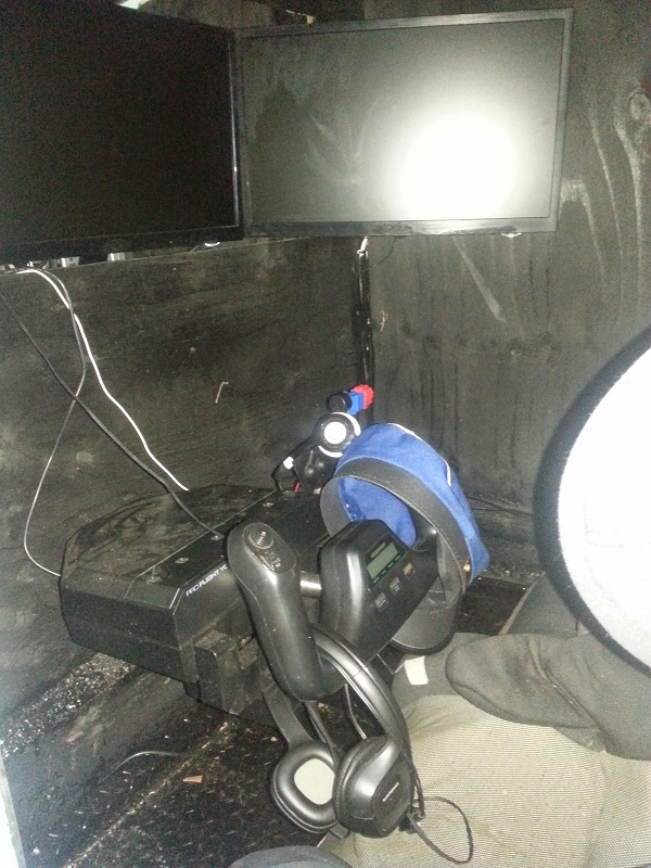

    The flight controls are Saitek Pro Flight Yoke System.

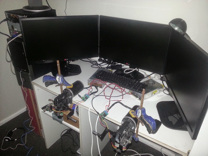

    Here's the electrics all soldered up and working prior to installation. For me, the hardest part.

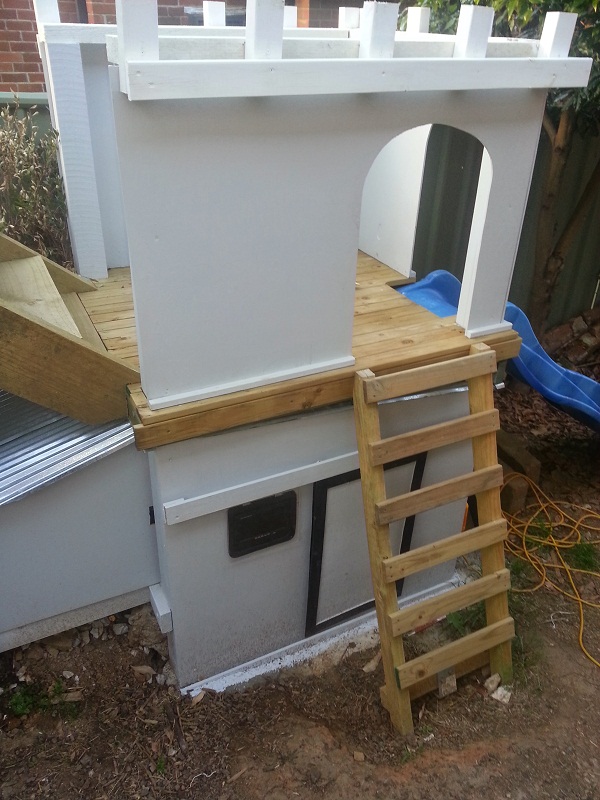

    The exterior completed ... almost. There's still some painting to be done around the back.

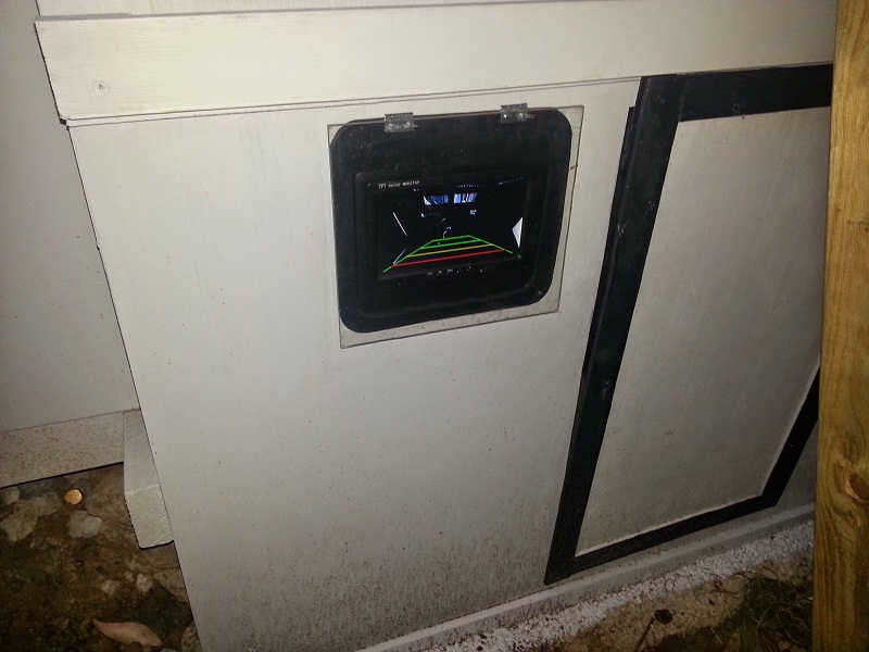

    And the final touch ... a car's rear vision camera connected to the LED PSU so I can keep an eye on the kids from outside.
