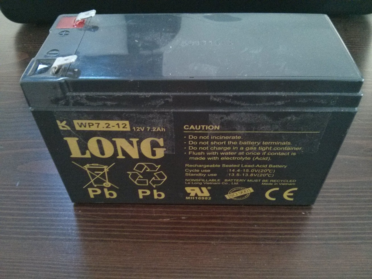

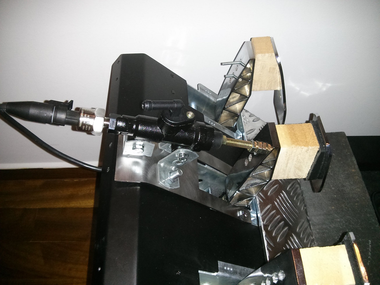

    What is the battery for? To aid the system when turning it on?
    As that is a current plothole in trying to understand everything needed for starting my own build. :roll
  5. pipis2015
    pipis2015 over-boost
    Feb 18, 2015
    222
    Athens, GREECE
    10,248Coins
    +272 / 1 / -0
    The power supply units as powerful as they might be, are purposed for use with computer circuits.
    So they are very sensitive to excessive changes in power draw conditions.
    This can cause their protection circuit to trip and shut them down.
    A battery can absorb power spikes and make life easier for the PSU.

  7. FoxHound.92
    FoxHound.92 2DOF seat mover
    Jan 11, 2018
    73
    62Coins
    +30 / 0 / -0
    Thank you for your fast reply!
    Does the battery need any kind of maintenance over time, e.g. charging or something like that?

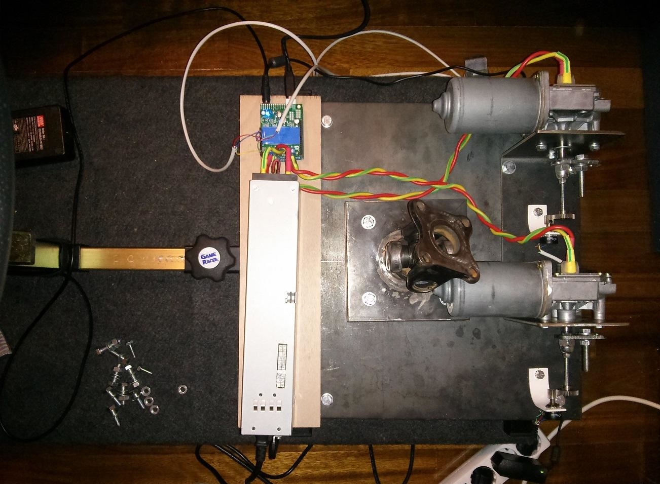

    - 6Coins
    +29 / 2 / -0
    Where were you able to get the sheet of metal for the base ?
  9. Tags..(VR)
    Tags..(VR) Member
    Aug 28, 2017
    237
    indiana
    - 6Coins
    +29 / 2 / -0
    Where were you able to get the sheet of metal for the base and how thick did you get?
