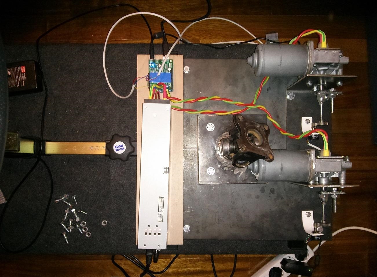

    Hi all,
    I d like to share my 2dof seat mover project. Many of you may notice details that are inspired by your designs.
    It is designed as a detachable module that can be installed under my (static) gaming seat to convert it to a motion sim.
    It is designed to be as compact as possible.
    Its a "box" measuring 40x40cm width and 15cm height.
    The same design can probably be installed under any static seat to convert it in a 2DOF motion seat.
    parts list:
    • 12v 47A 575Watt server Psu
    • Arduino Uno R3
    • 9v ( 2.1mm centre positive plug) psu for arduino UNO
    • Pololu Dual VNH5019 motor driver shield for Arduino
    • 2x single turn Cermet 10k linear pots
    • 2x SWF VALEO 24v wiper motors
    • two 40cmx40cm steel plates + 15cmx15cm steel plate for Ujoint + 40cmx10cm bended steel sheet for motor chassis
    • USB isolator
    • AWD Suzuki vitara Ujoint
    • 12v 7Ah UPS battery
    Cost:
    300-350 euros

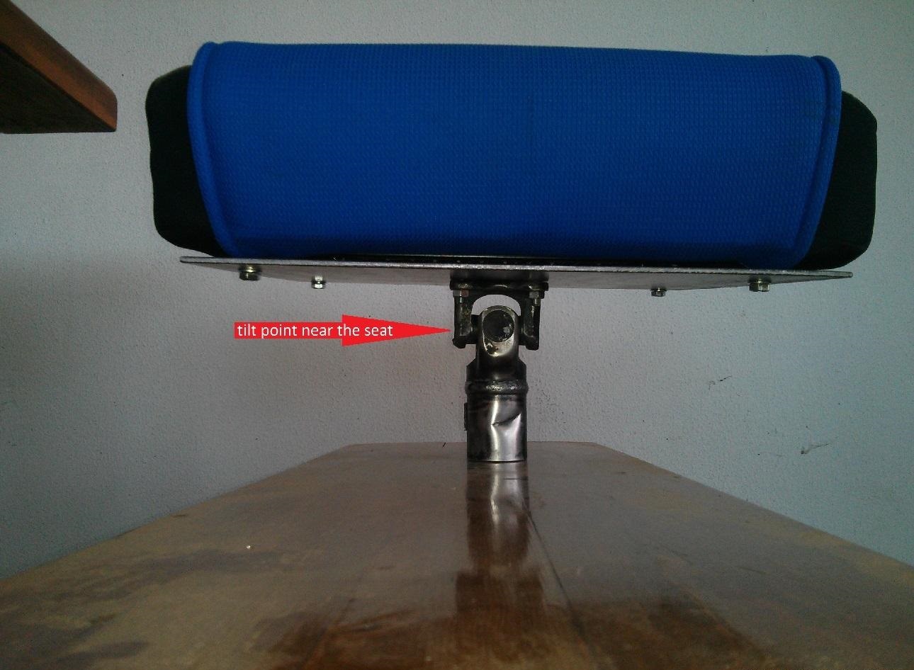

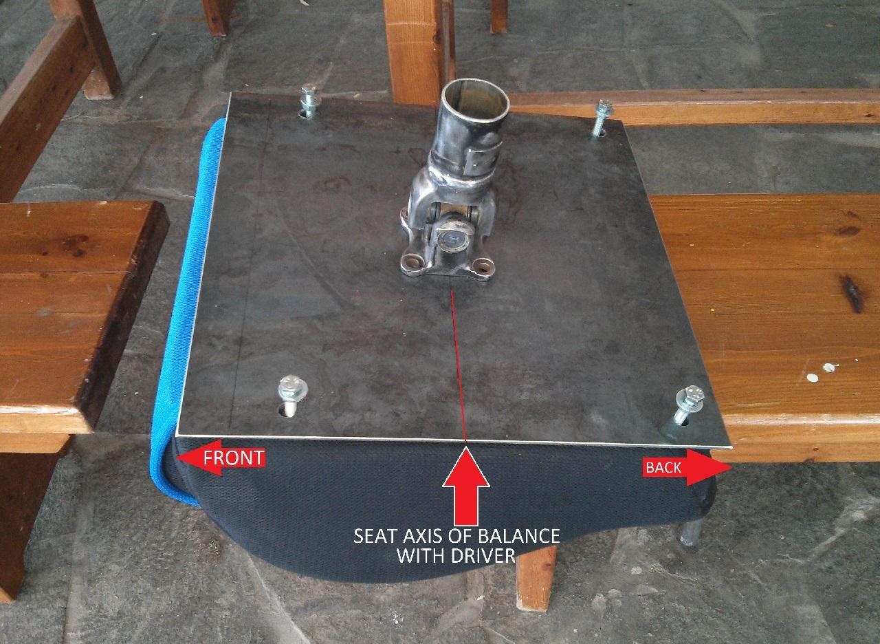

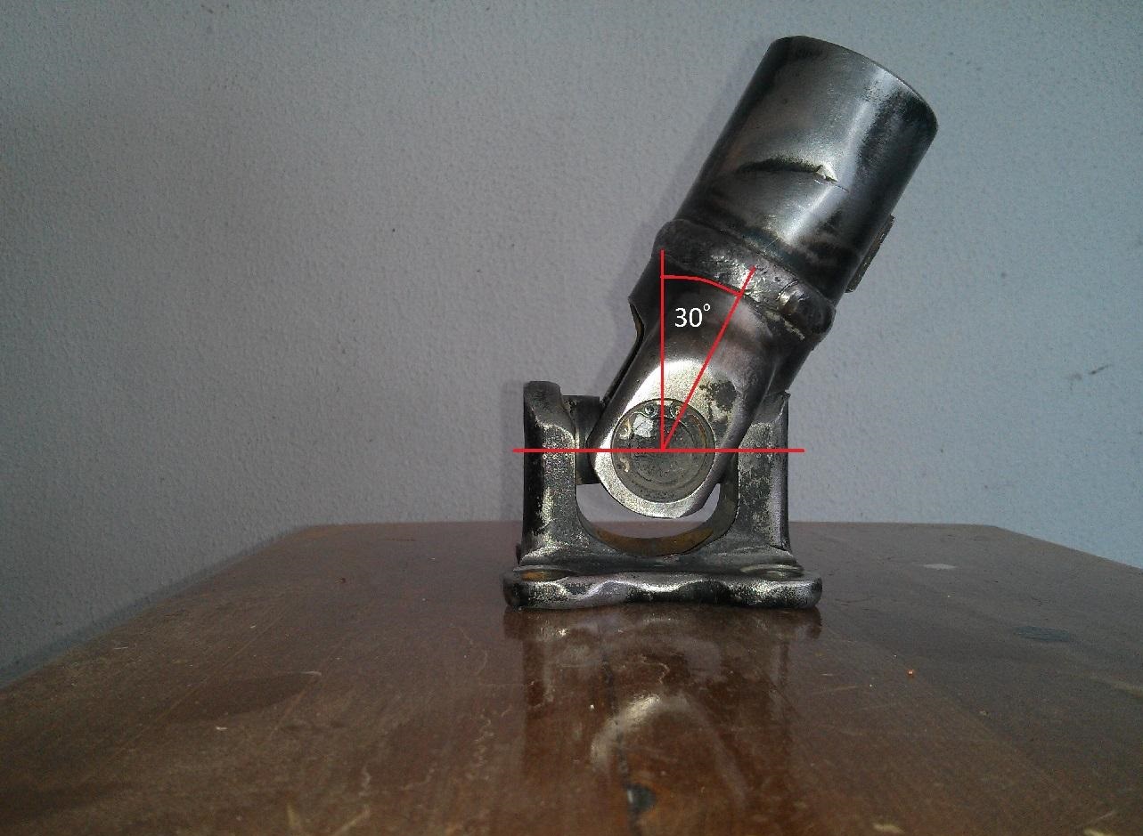

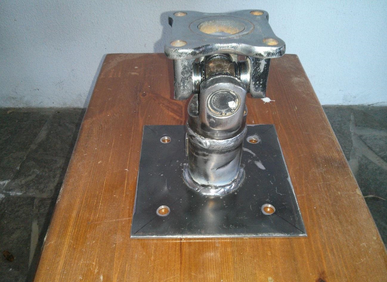

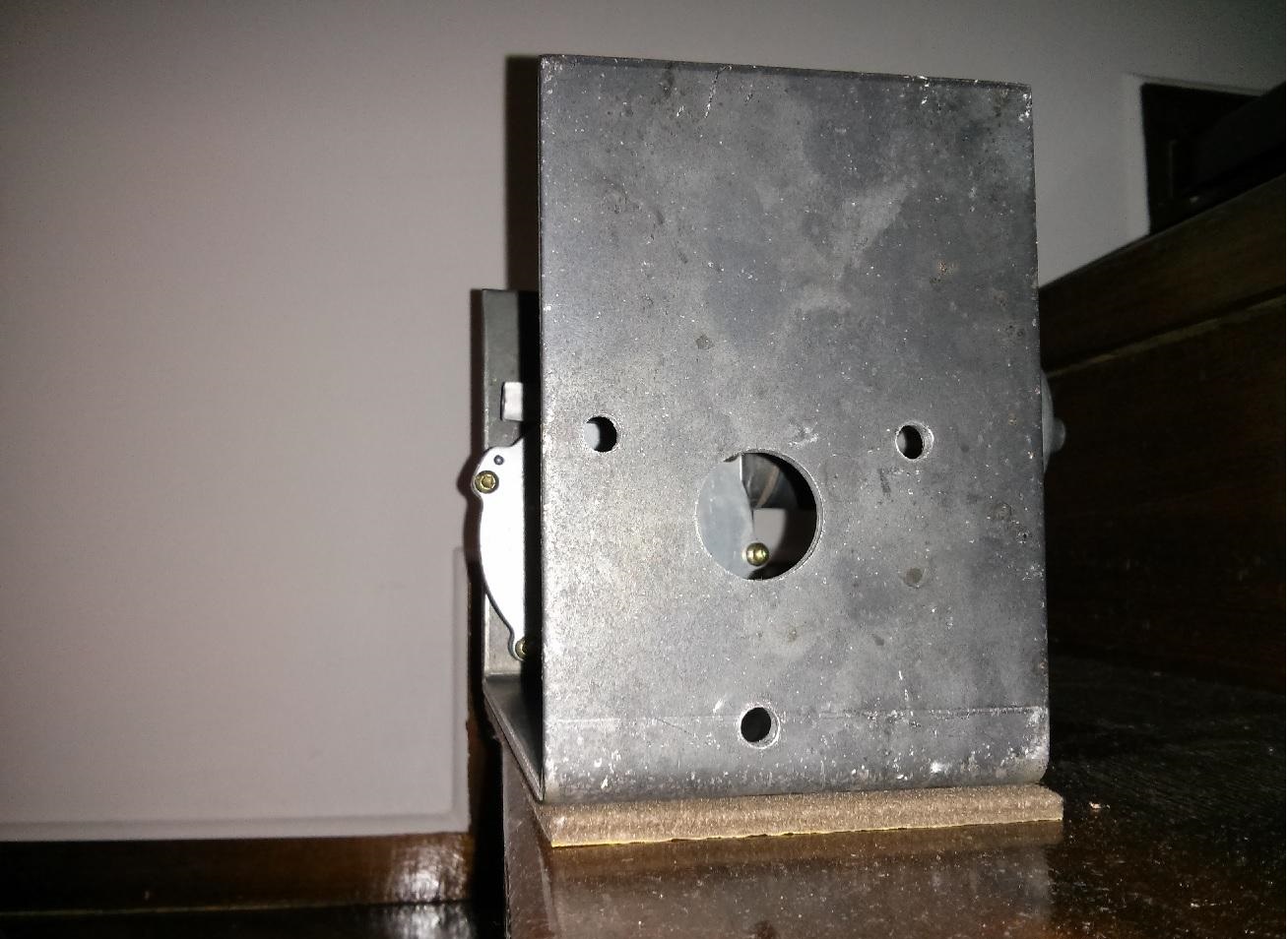

    So starting from this:
    A Suzuki Vitara u-joint is probably an overkill but it was for free and its future proof.
    First thing to do was calibrate and drill holes to the steel plate.

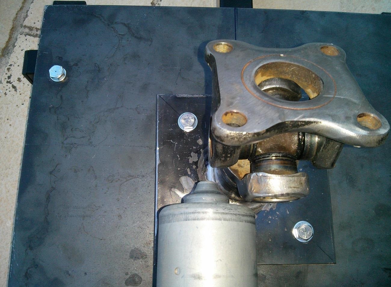

    Welding the U-joint's base.
    4WD Ujoint after welding.jpg ...

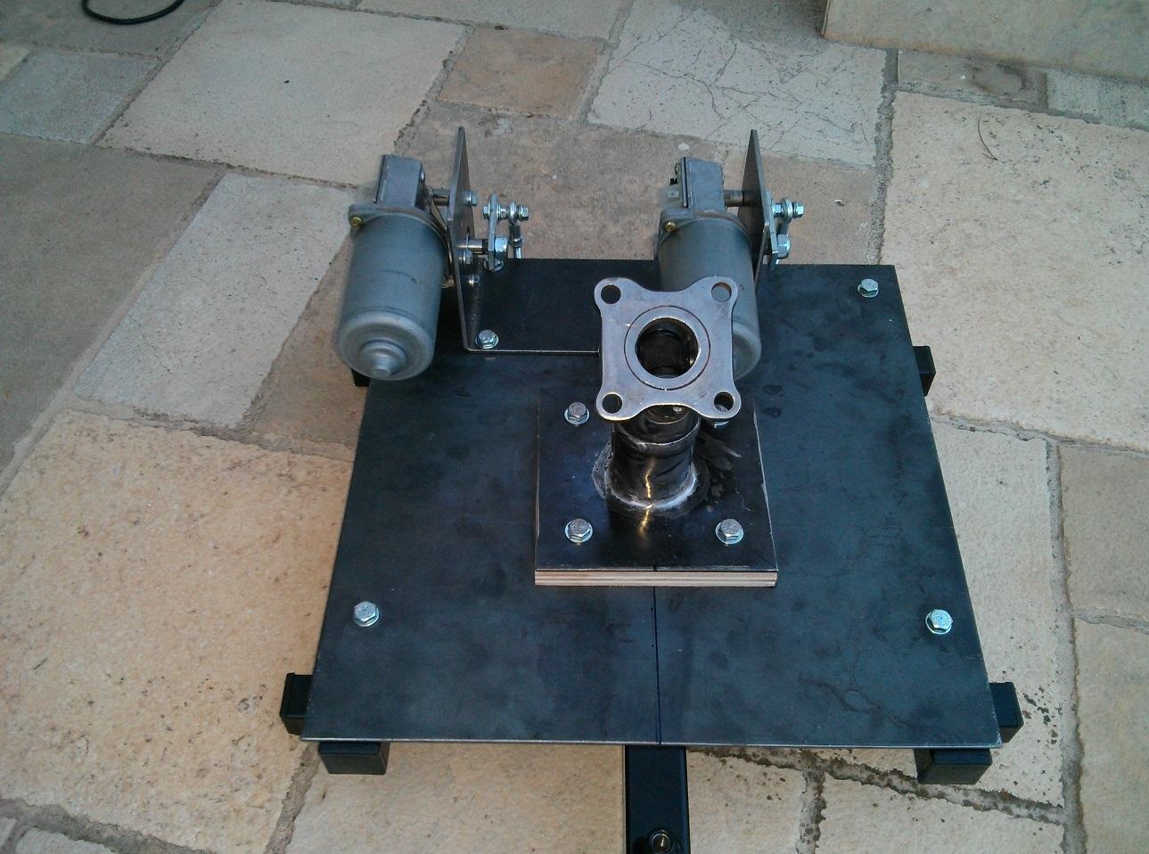

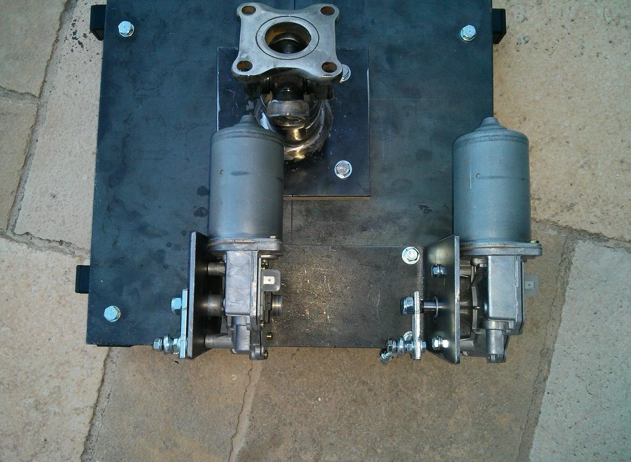

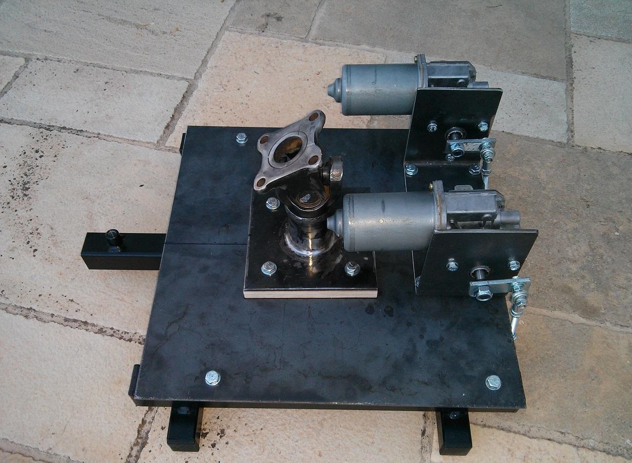

    Quick preview.

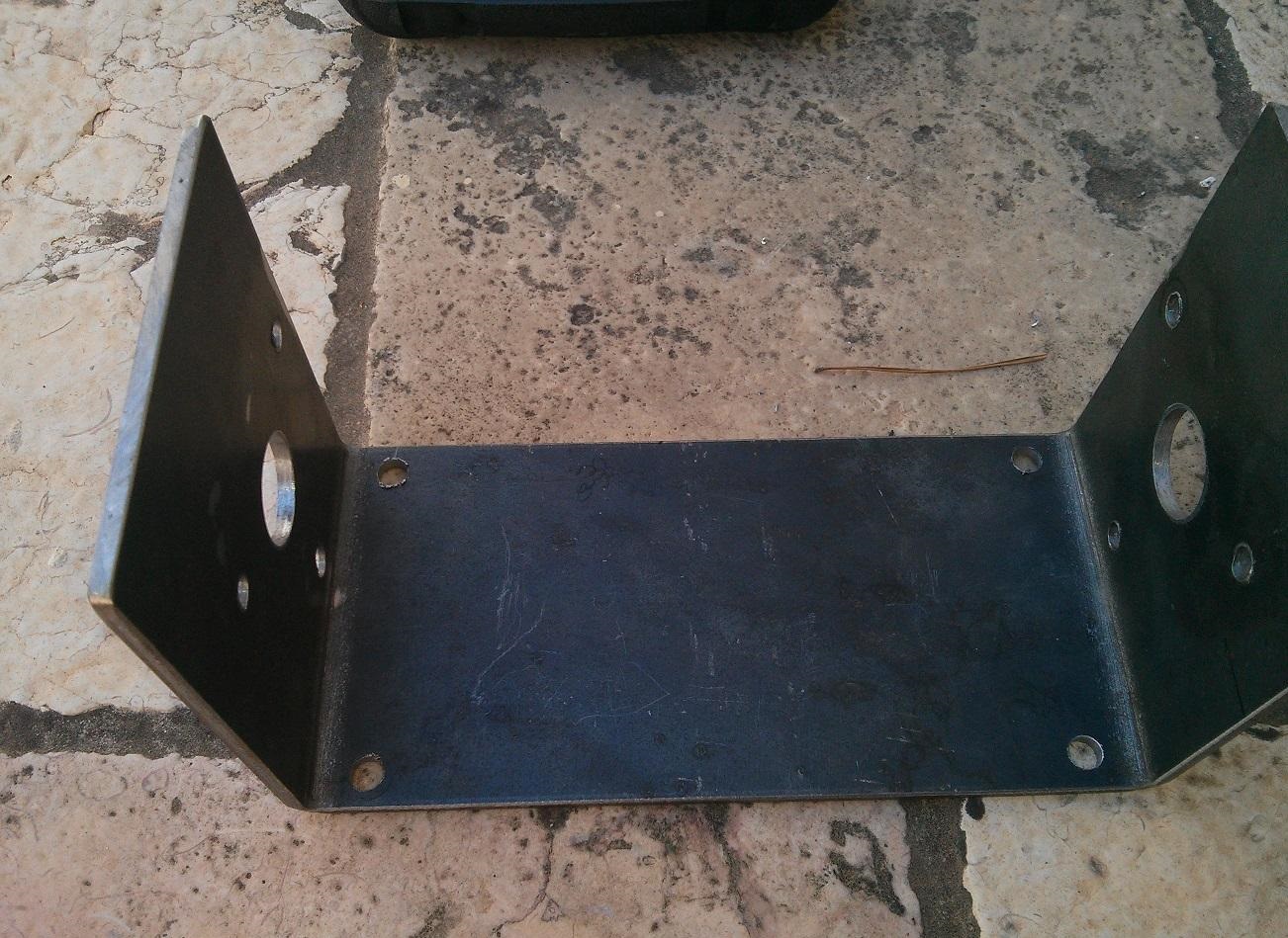

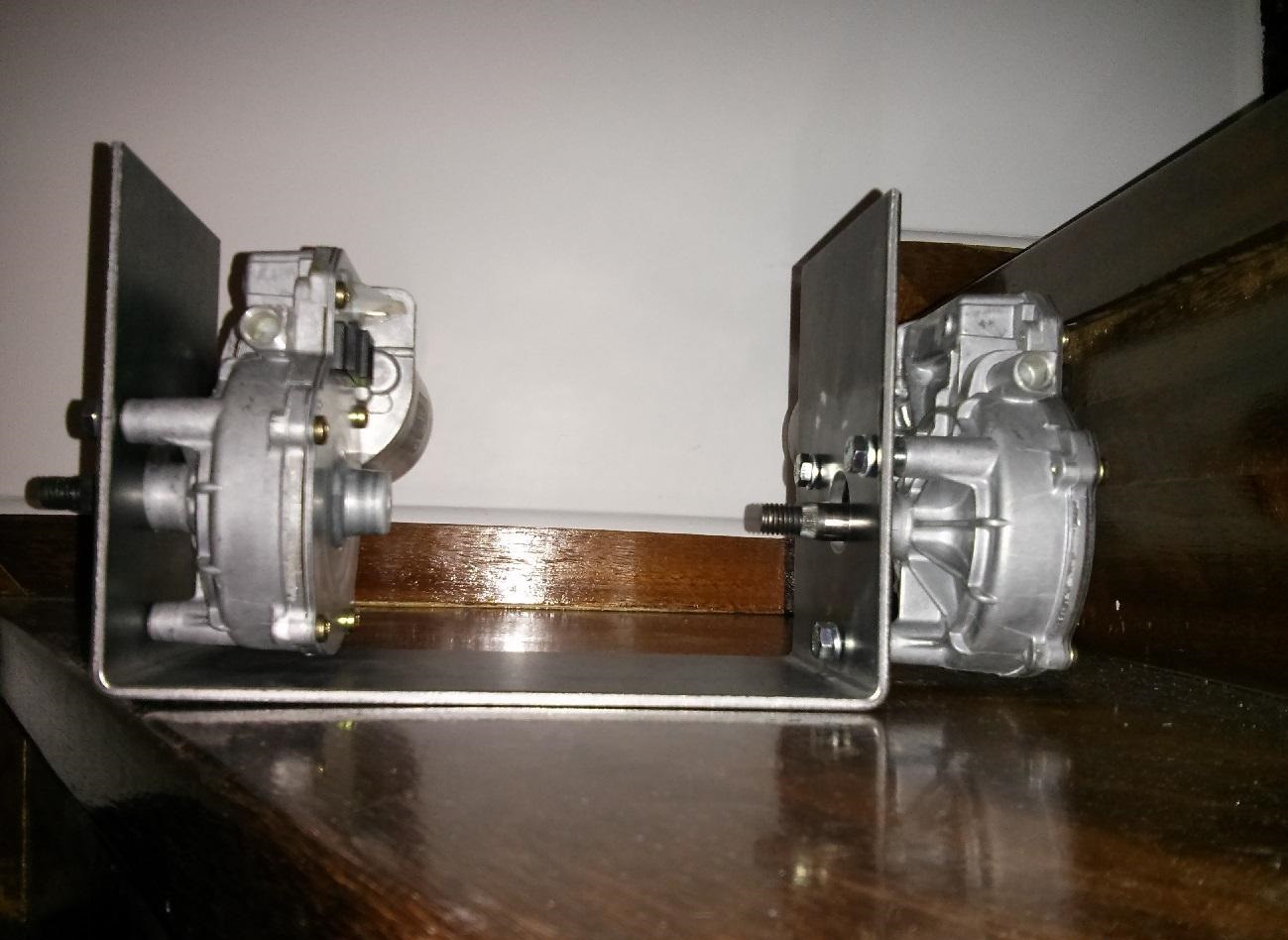

    Closeup on the motor chassis.

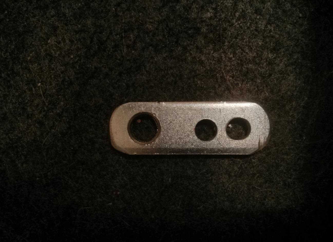

    Connecting rods (for motor)
    Dimensions:
    5mm thick
    2cm x 6 cm

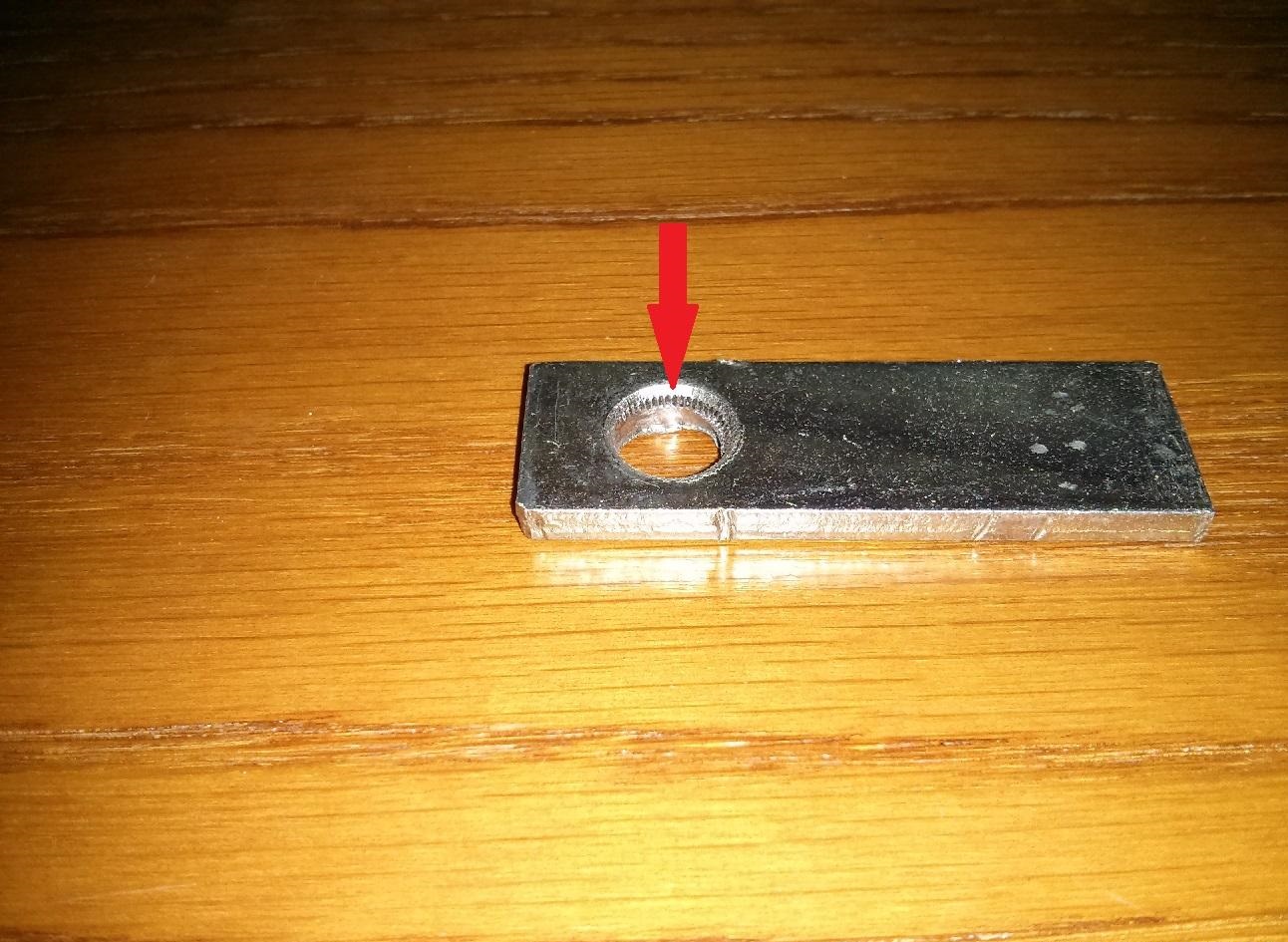

    Drilling:

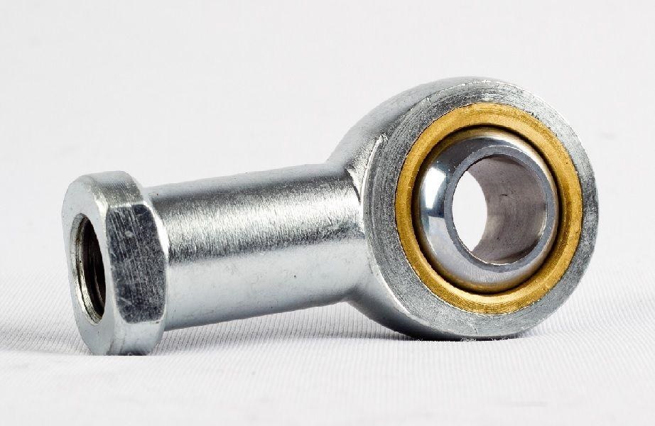

    10mm hole for motor
    8mm hole for rod-end bolt.
    center to center "C-C" distance is 2,5cm and 3,5cm (for motion adjustment purposes).

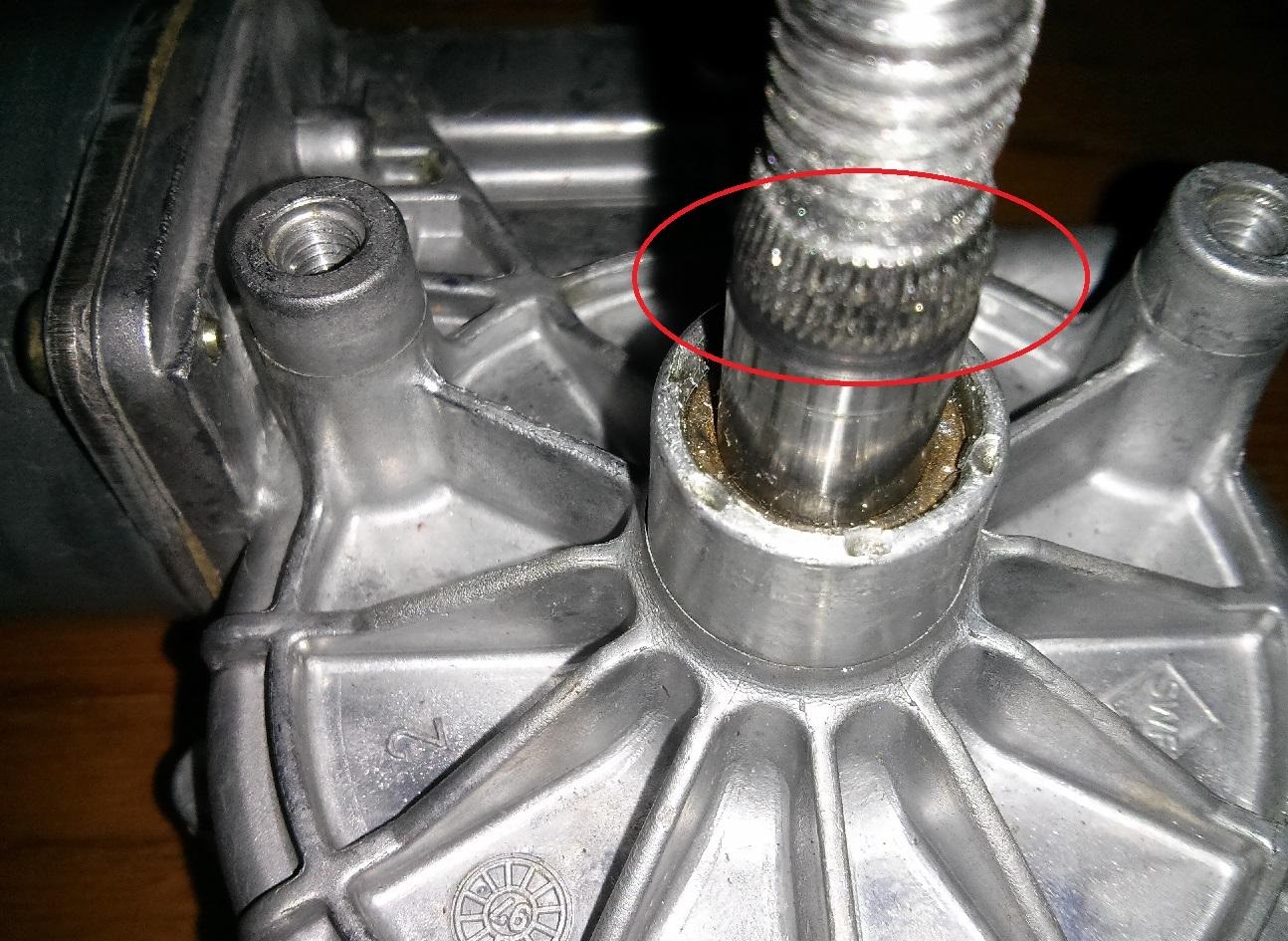

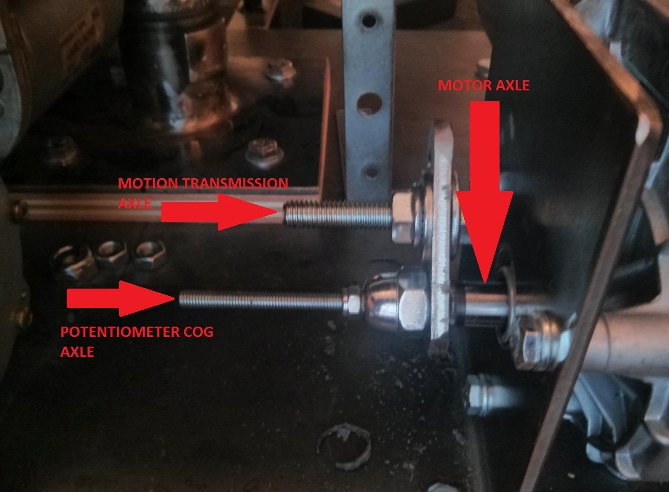

    The holes require some more "refining" because their inner surface has to obtain a conical profile.
    When fitting the rod, make sure it sits very tightly on the "dents" of the axle.
    The easiest way to achieve this is to choose a "softer" metal alloy for the rod (not steel). So when you install it on the motor axle and as you progressively tighten the securing nut, the grooves of the axle will be "registered" on the softer alloys surface. Just don't go for a very weak alloy for this rod because it is a very crucial part of the motion transmission assembly.

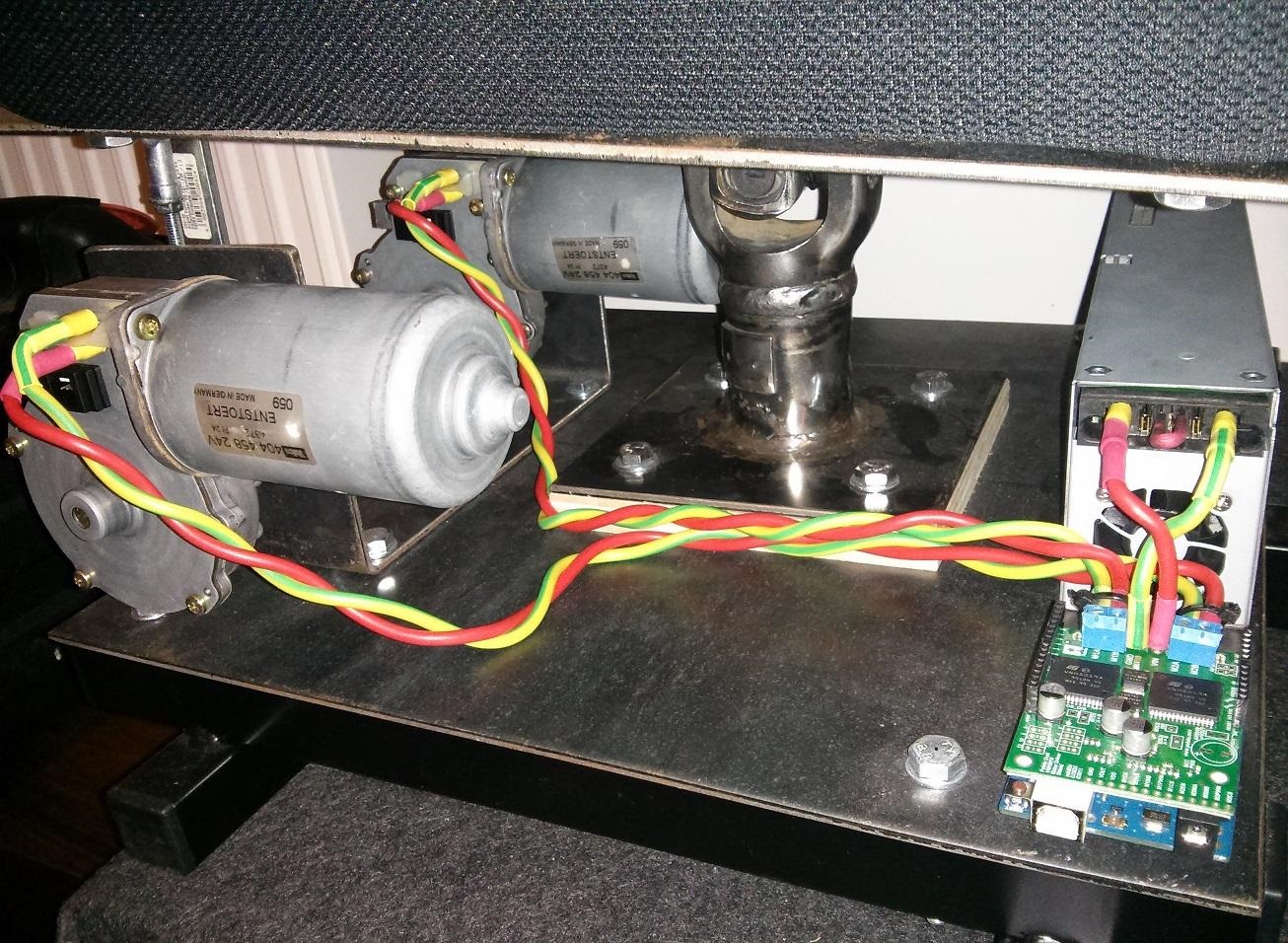

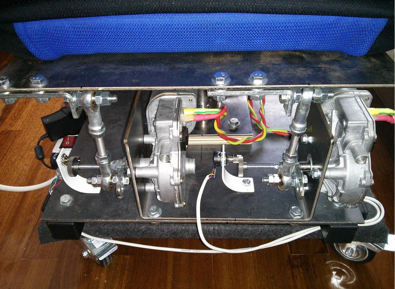

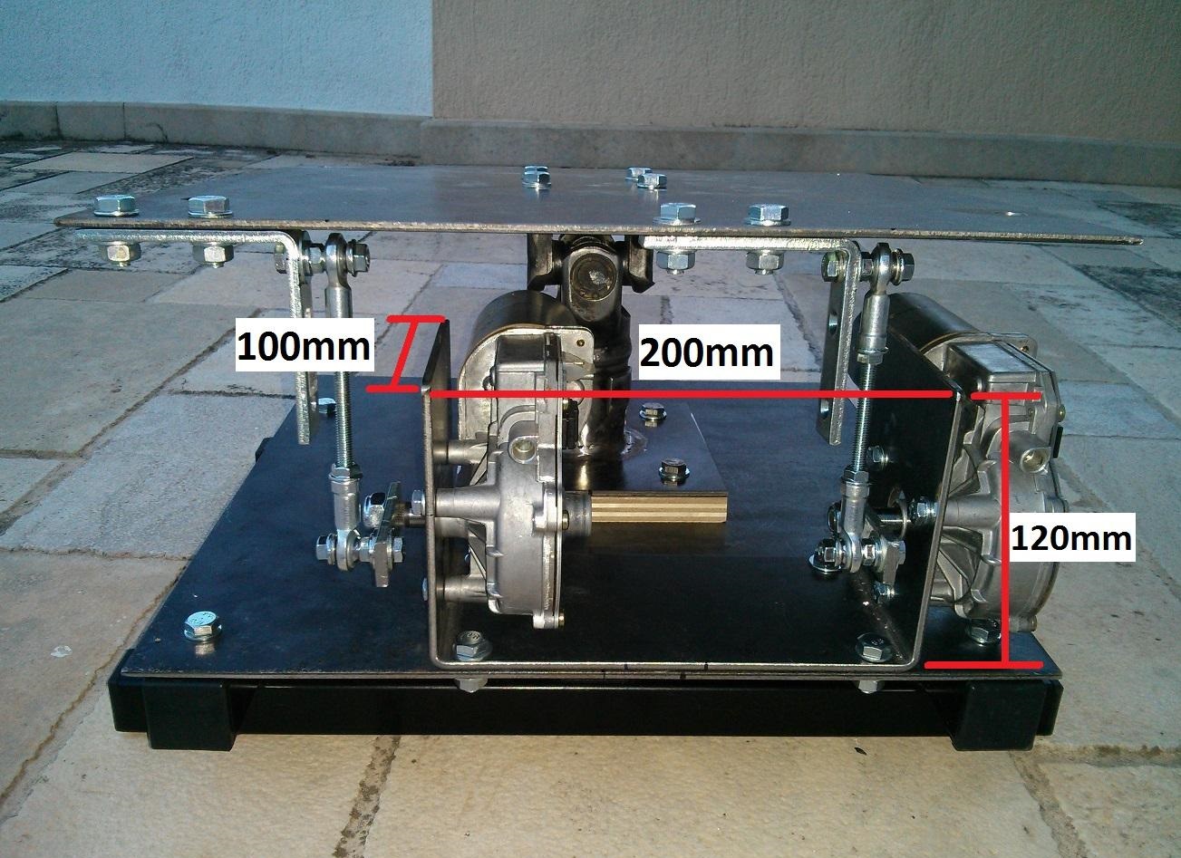

    Powerplant assembled.

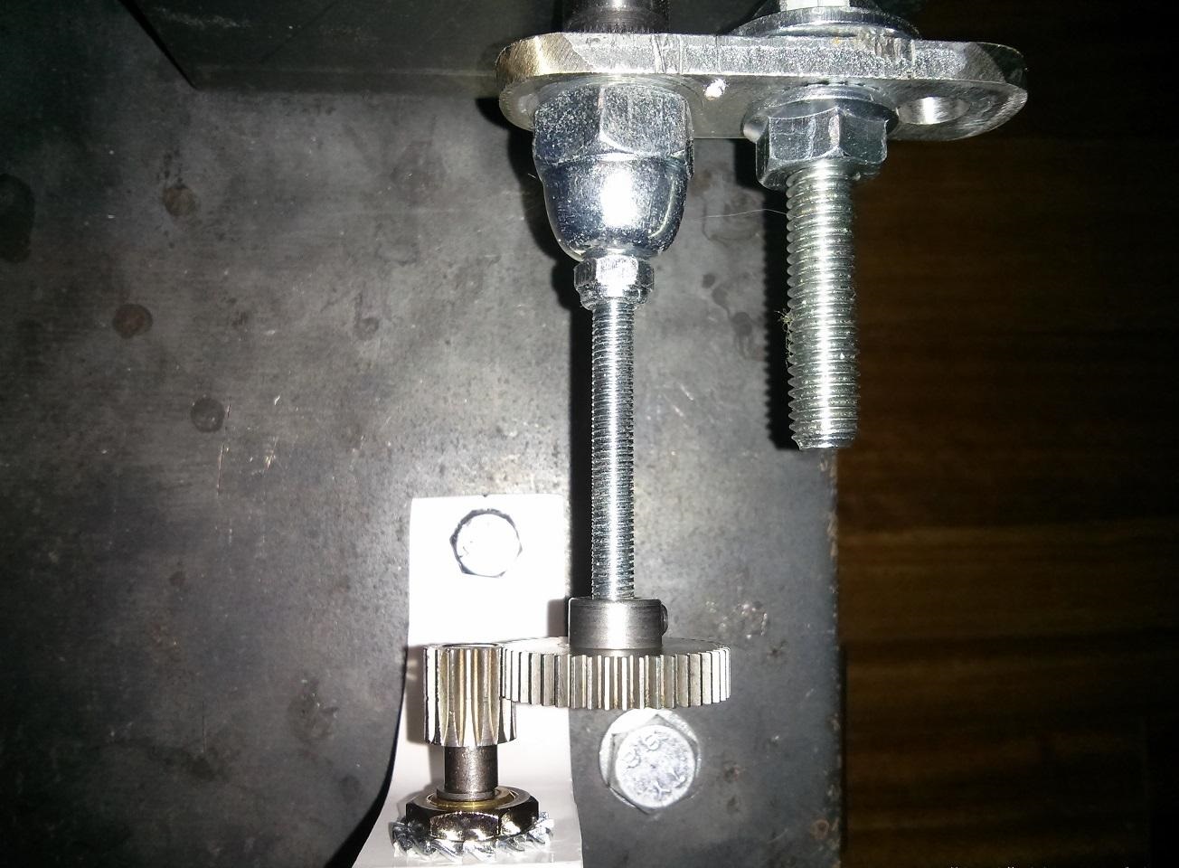

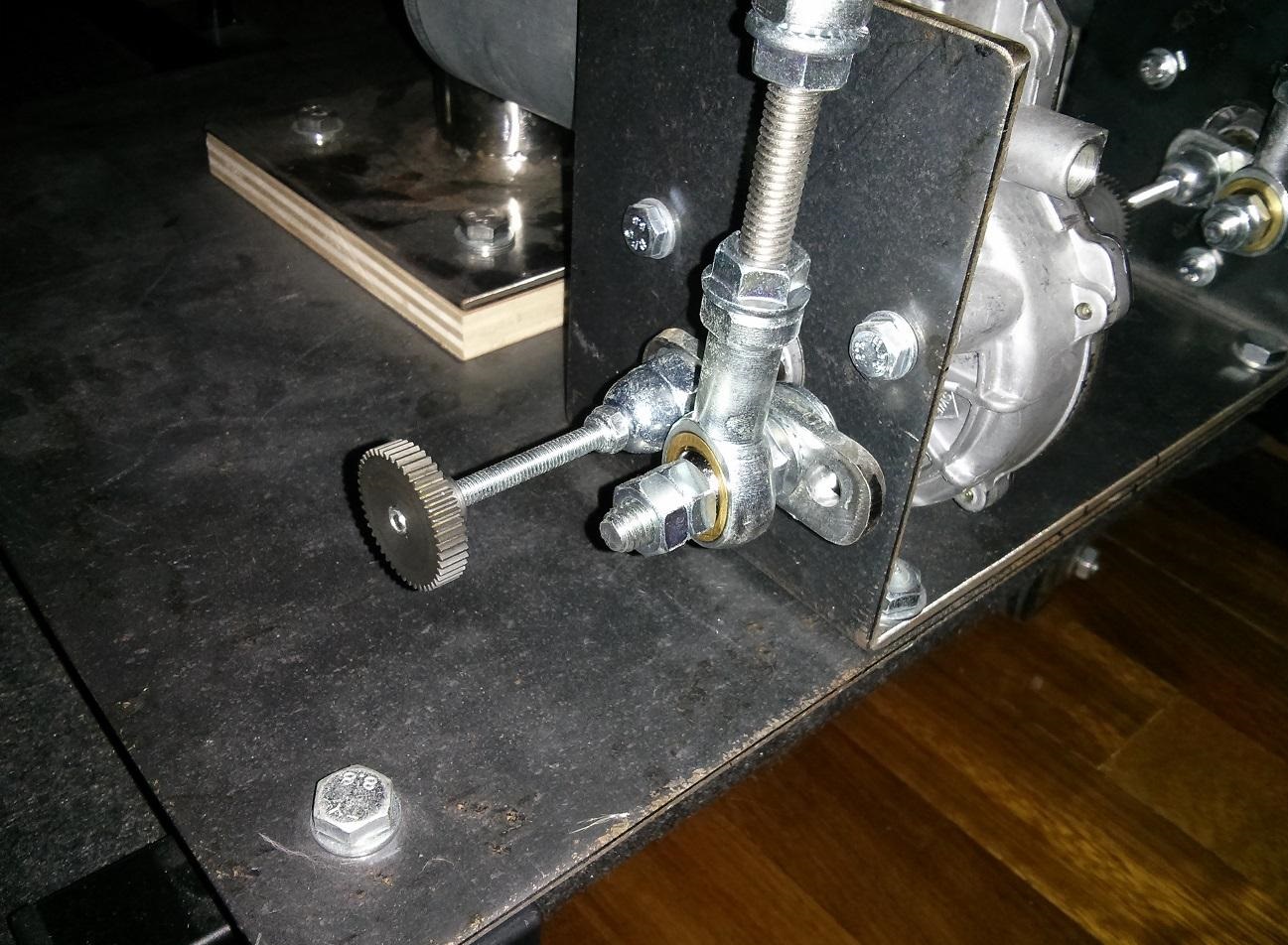

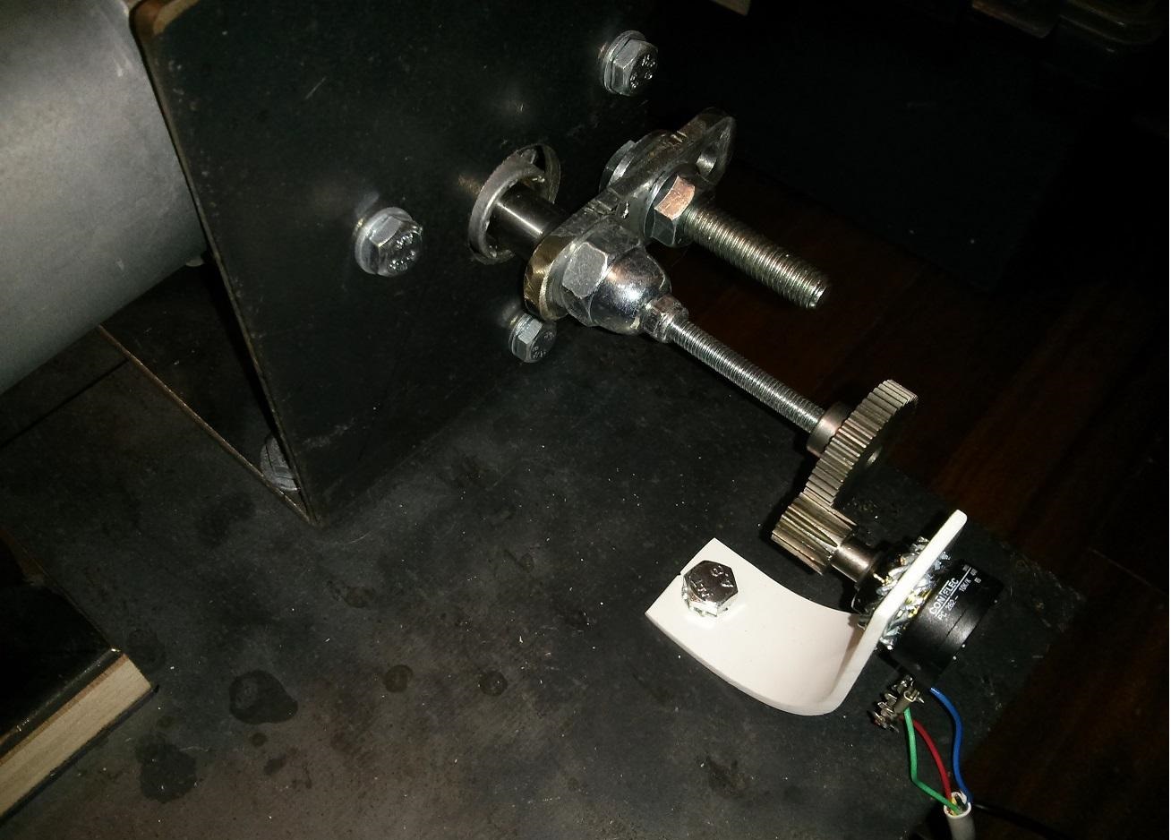

    For the potentiometer,i tried to find the best solution amongst many presented on every possible project online.
    After trial and error i ended up with a custom solution from the r/c racing world(cogs with 45t/17t~2,7:1 ratio).
    I intend to use 90* to 100* (+/- 45* to +/- 50* from resting/center point) of rotation of the wiper motor axle, so this equals to 243* to 270* of rotation on the potentiometer axle.
    This way i can take advantage of full 270* potentiometer range -and arduino ADC range- for better resolution).
    The motors are designed to work From -45 degrees to +45 degrees from rest (horizontal rod) position, for more linear motion.
    A combined use of both motors can output a maximum of about :
    10 degrees LEFT or RIGHT(-10 to +10),
    OR
    5 degrees Front or BACK(-5 to +5),
    tilt on the seat.

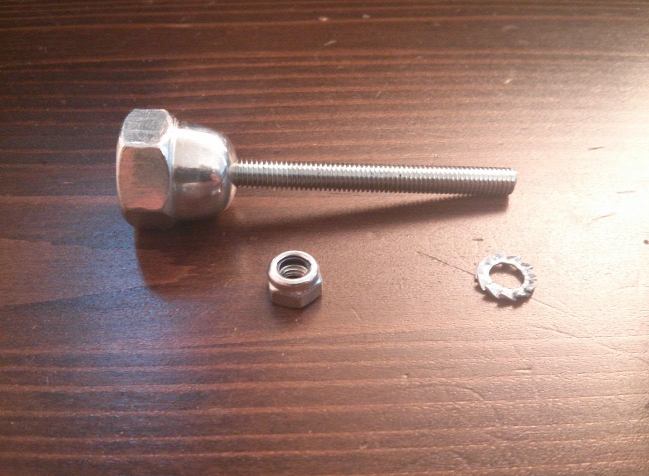

    The cogs have a fine pitch of 48p (small dents) to increase "sensitivity" for finer motion tuning.
    I have heared pinions make noise when they turn on some projects ... this is not the case here .. no sound is heard at all.

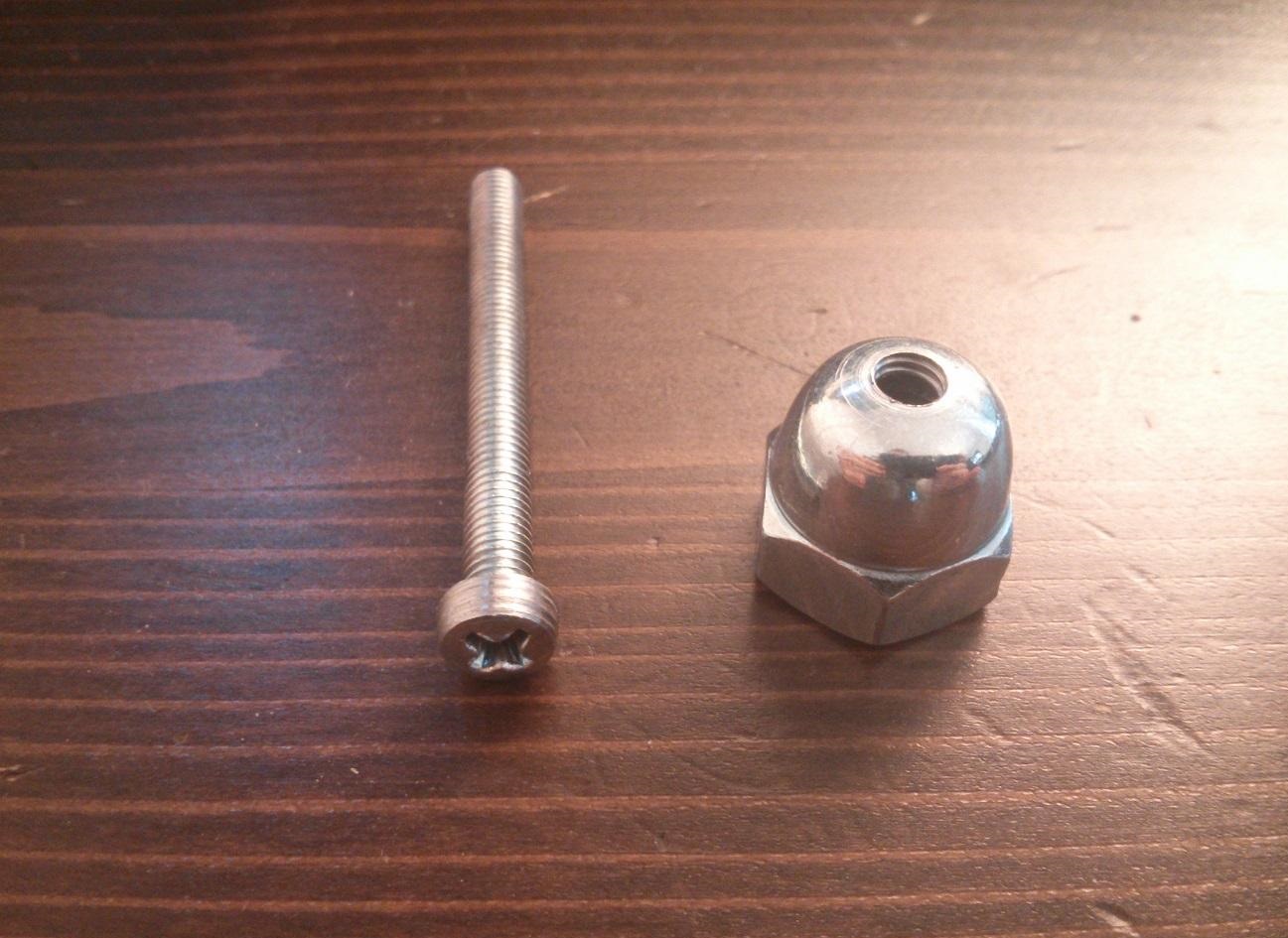

    Round head nuts ...Some drilling and some treatment with the lathe and.
    This s how it looks.
    The potentiometer mounts are pieces cut from a fairly soft pvc drain pipe:
    1)They protect the pots in the rare case something goes wrong and the pots go out of travel.
    2)They electrically isolate the pots from the chassis.

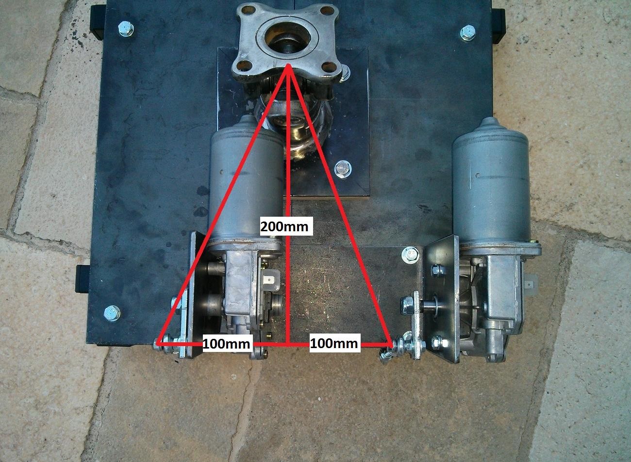

    Some measurements.

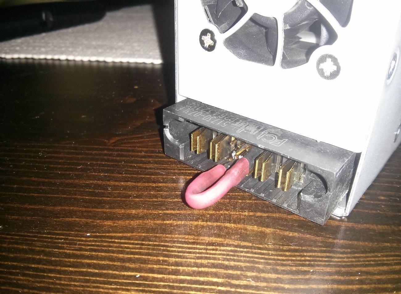

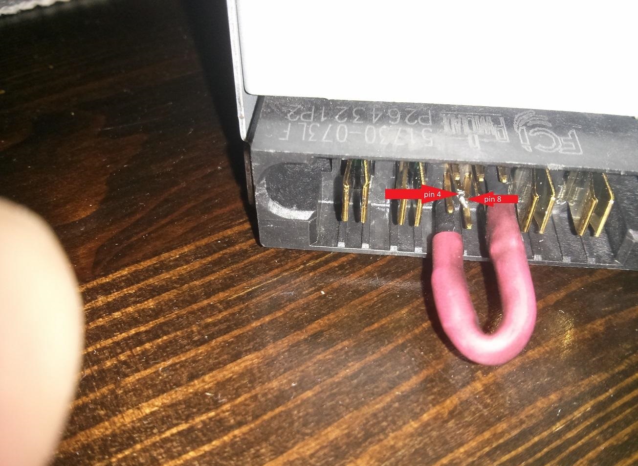

    HP model DPS-600PB
    When the psu is plugged in the fan starts to spin but there is no power output.
    A “Y” cable to short pins 6-9-10, and...

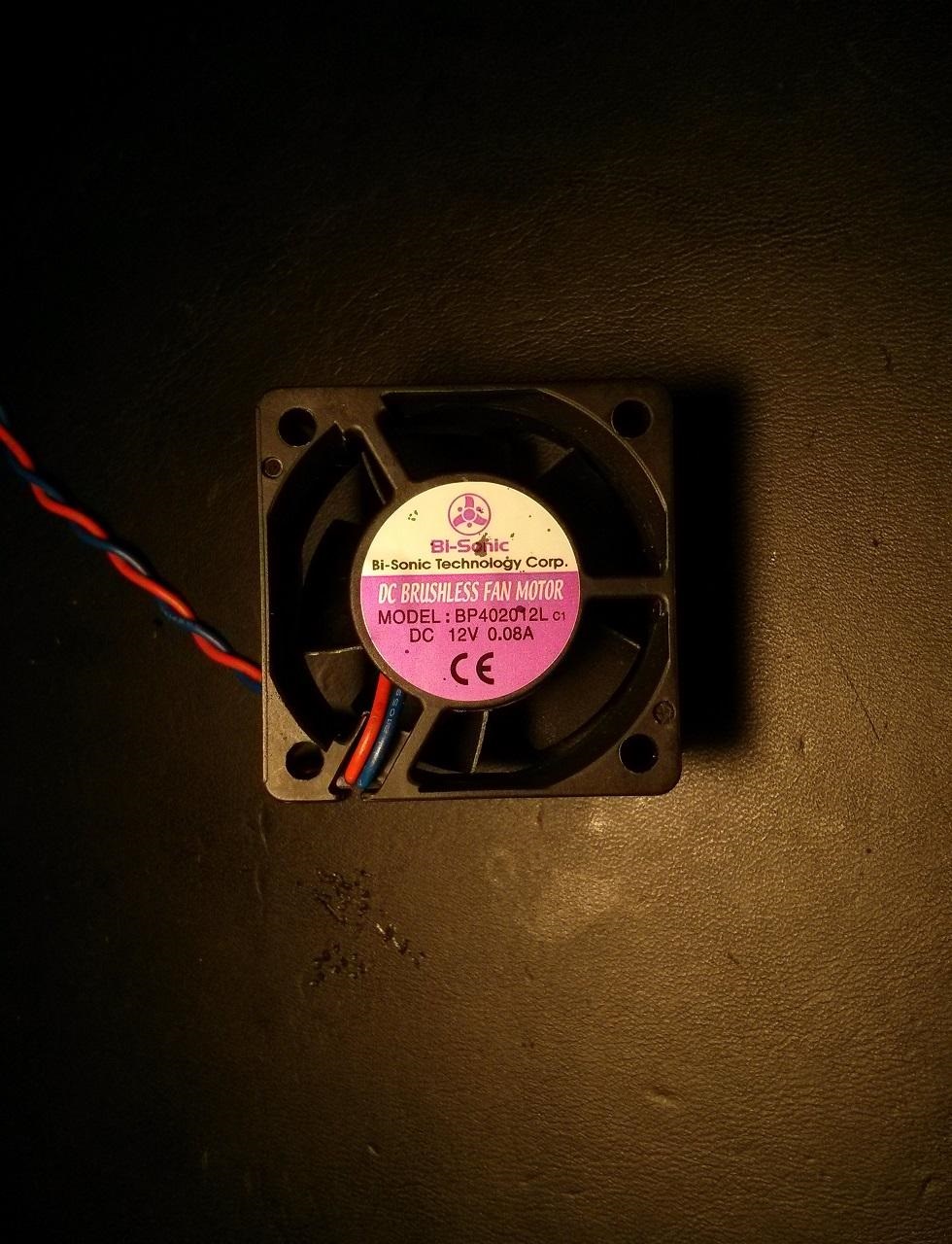

    Shorting pins 4-8 reduce the fan rpm to minimum. The fan still spins up when needed but stays quiet when the psu doesn't require cooling.

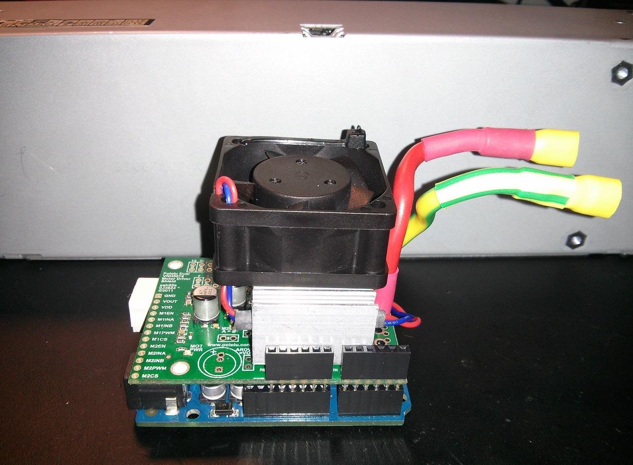

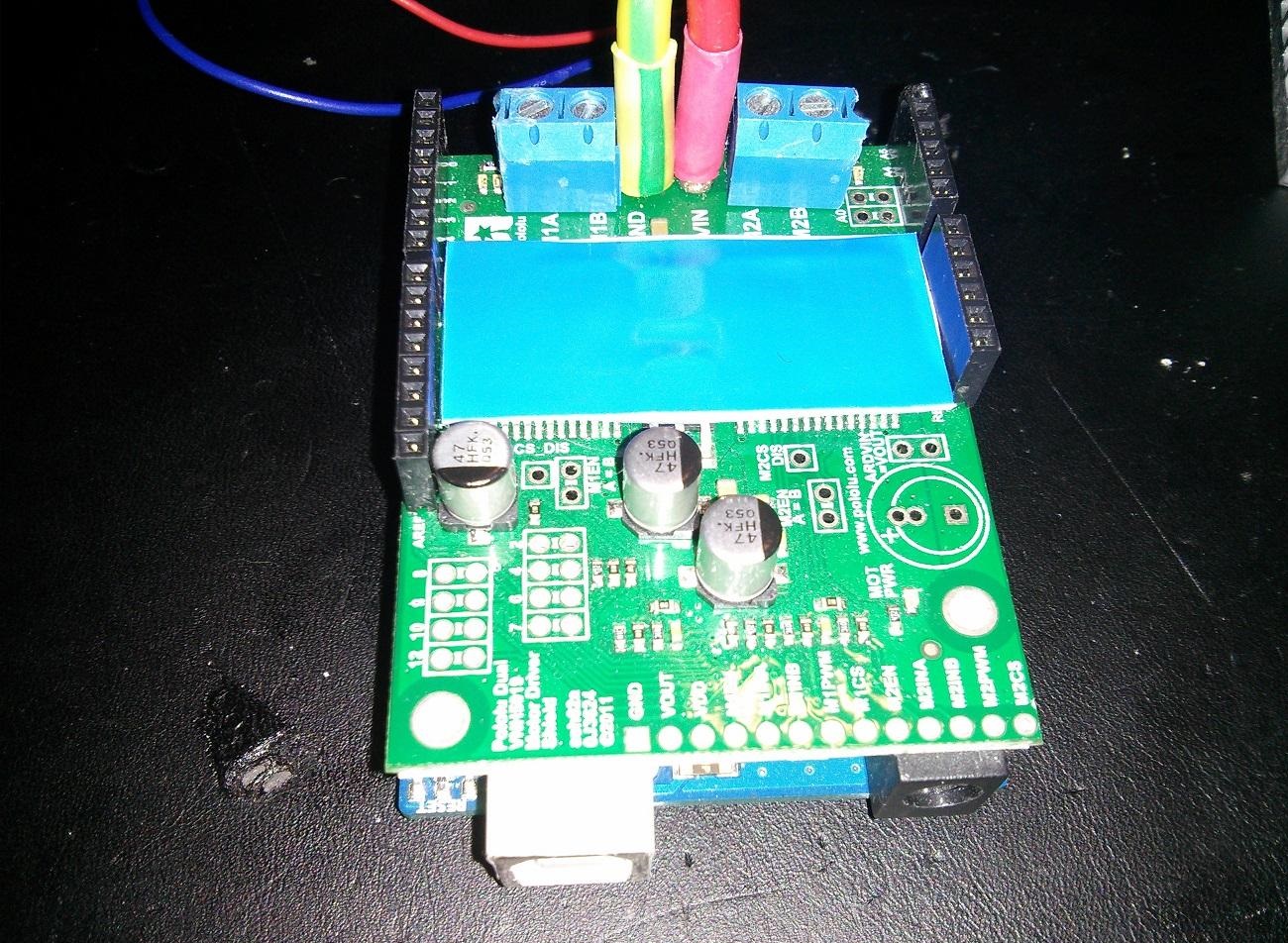

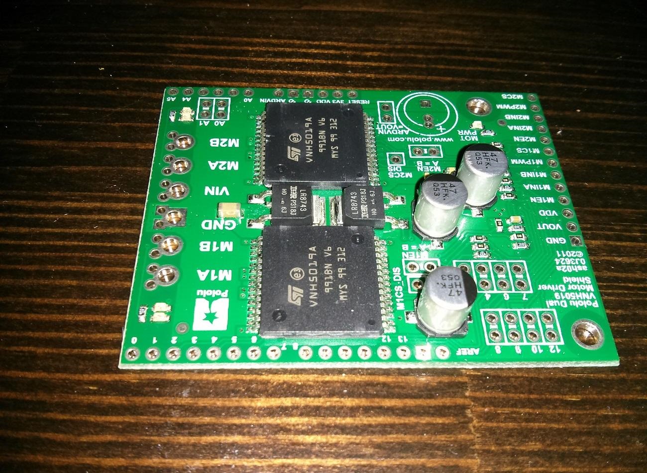

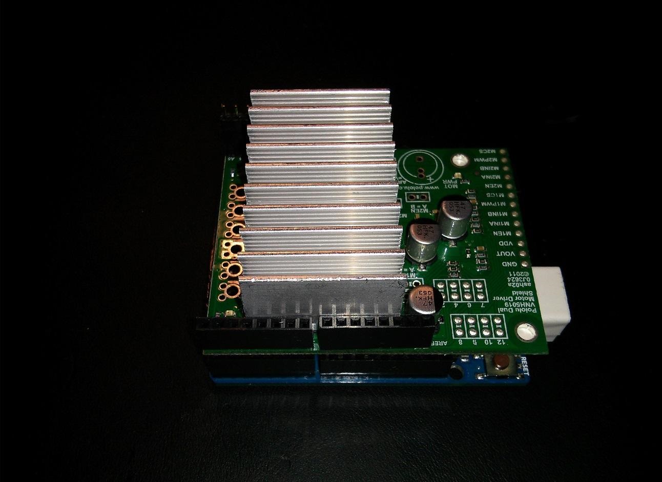

    Pololu Dual VNH5019 Motor Driver Shield for Arduino.
    Features:
    1. Low price … 49.95USD
    2. Compact … 2 Motor channels on a single pcb
    3. Arduino uno compatible and stackable(allowing for a more compact design)
    4. Works with up to 24volt VIN
    5. 12Amp continuous output current per channel (30Amps peak per channel)
    "short durations (on the order of milliseconds) of 30 A and several seconds of 20 A without overheating"
    6. 24Amp continuous output current for single motor connected to both channels(60Amps total peak)
    7. Ultrasonic PWM frequency 20kHz (works stacked on arduino uno)for quiet motor operation
    8. Reverse voltage protection
    9. overvoltage shutdown
    10. thermal shutdown
    11. Short protection

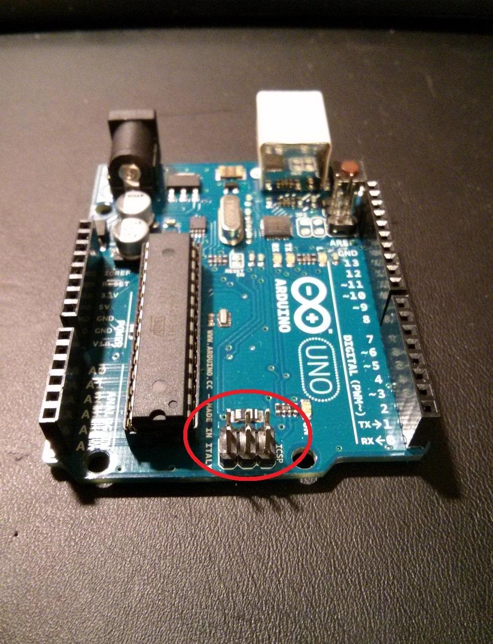

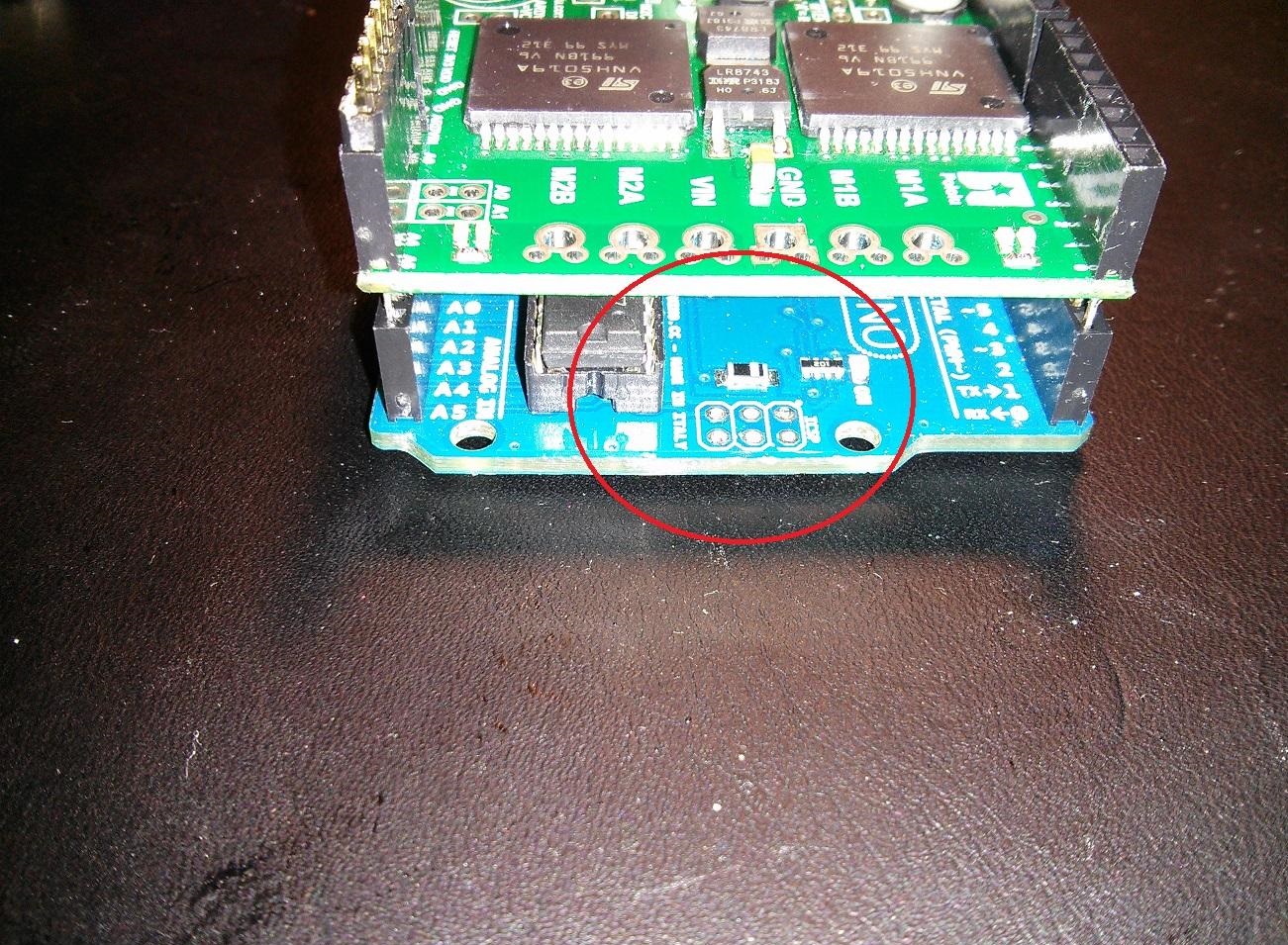

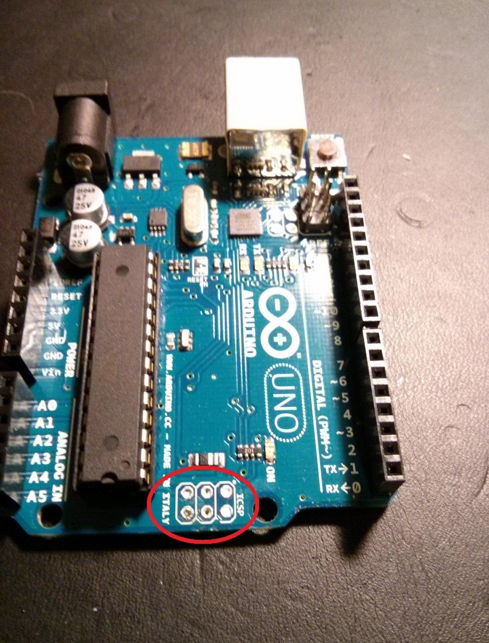

    Taking a look at the arduino board ... six ICSP pins seem to stand very close to the power input/output of the Hbridge (which sits on top of the arduino board).

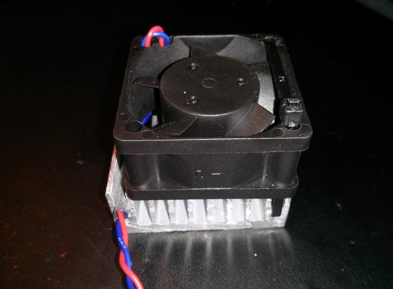

    Phobya Thermal Pads.(high thermal conductivity of about 5W/mk, while also being flexible enough).
    Brushless fan .
    Aluminium heatsink.

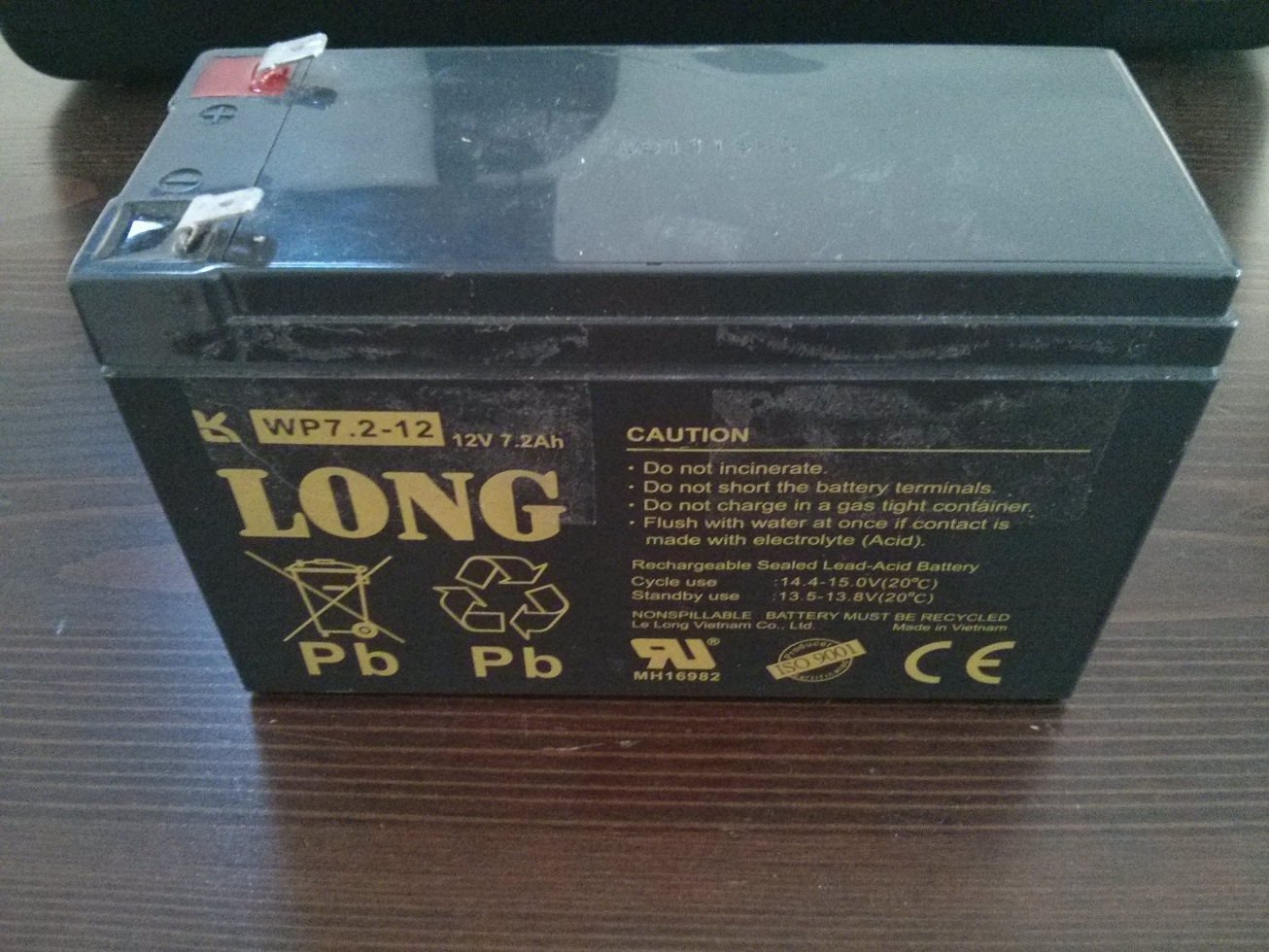

    Twisted power cables.
    a standby UPS battery in parallel with the psu.
    It is cheaper and more compact than a big 12v capacitor.
    Its puspose is just to assist momentarily the psu.

    Very neat setup there, @pipis2015 . Everything looks solid enough while keeping the construction simple. Top work!
    Can I ask what you used to mount the Arduino board to the base? Is that directly mounted to what looks like a steel plate?\
  5. pipis2015
    pipis2015 over-boost
    Feb 18, 2015
    222
    Athens, GREECE
    10,248Coins
    +271 / 1 / -0
    I have placed both the psu and the stacked boards on a 10x40cm plywood board. For stability and electric isolation.
    pics will follow when things are settled to a descent configuration.

    Latest addition(10 euro)...
    ... a standby UPS battery in parallel with the psu.
    To be honest it is something that i expected so there was more than enough room to fit.
    But, boy what a difference in performance!!!
