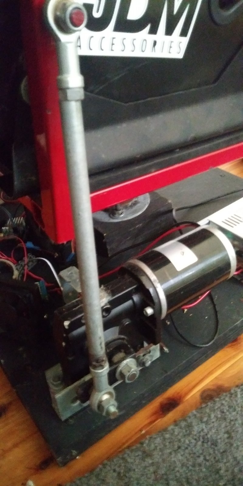

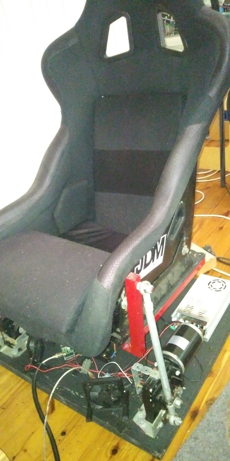

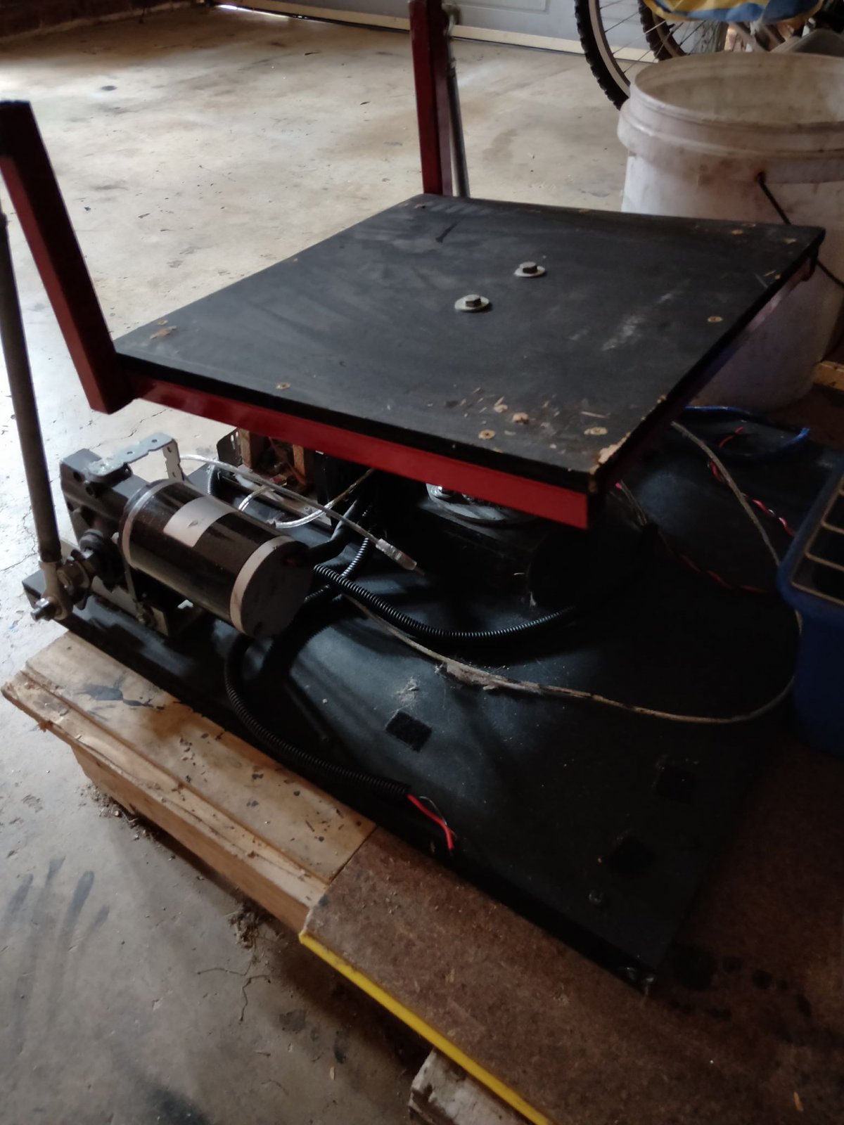

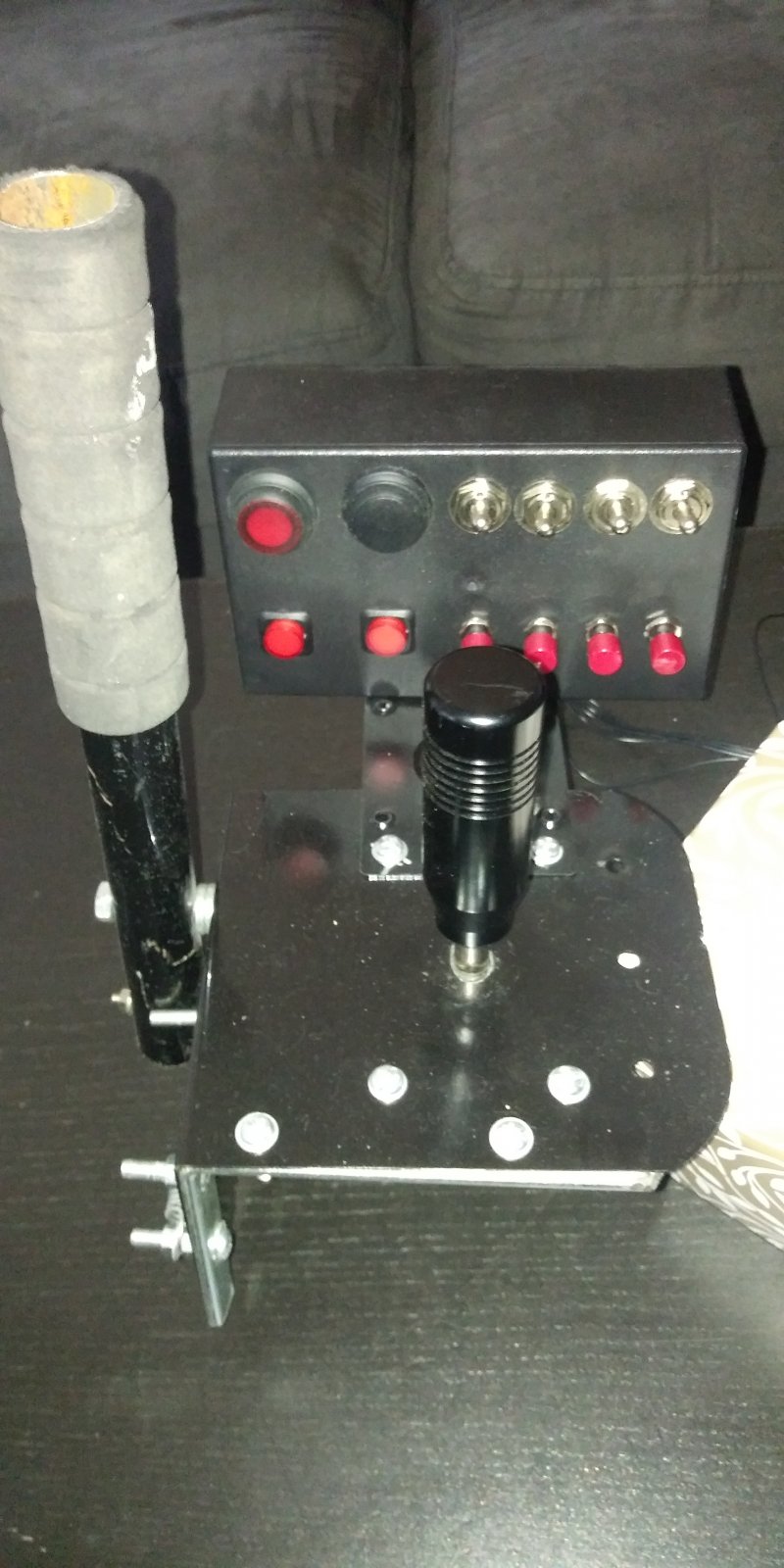

    Gday folks, this is my 2DOF front motor mounted seat mover project. It's quite a compact setup which is nice if you don't have a lot of room to work with. After seeing some of the incredible build threads on here i plan to rebuild it as a rear mount rig, using U frame aluminum extrusion when i can afford to.

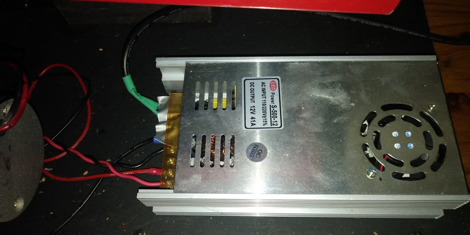

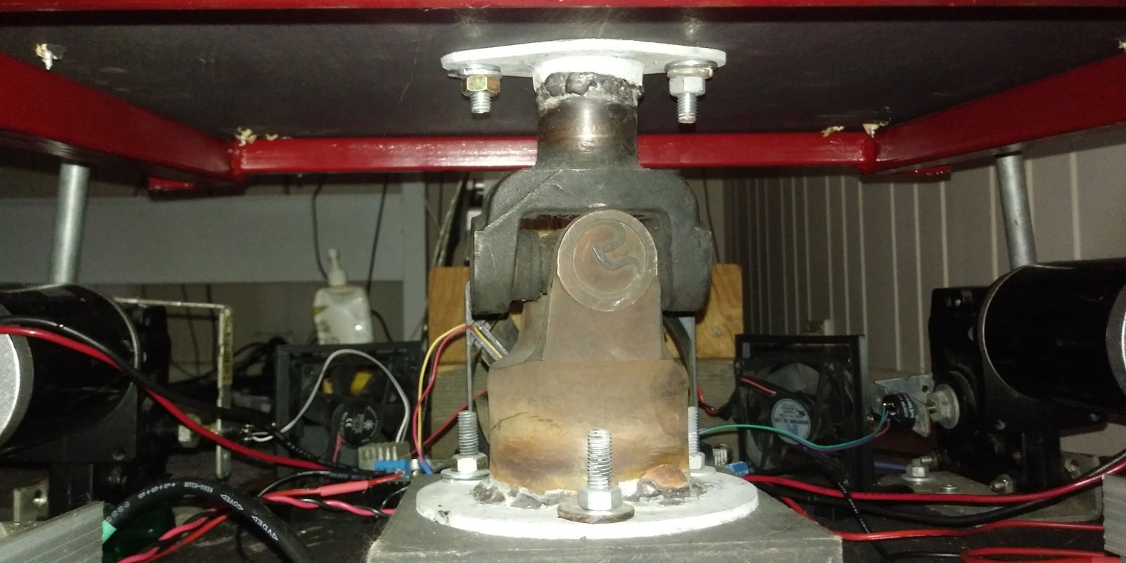

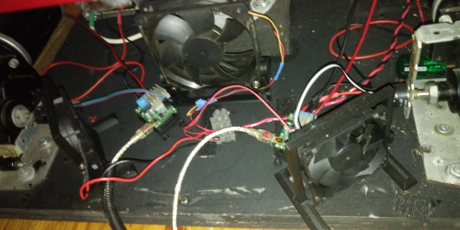

    It's running DC motors with JRK 12v12 controllers and LED power supplies. The seat is mounted on a cut and welded car drive shaft. A good mate helped me out with some wiring and had a spare seat to donate to the project.

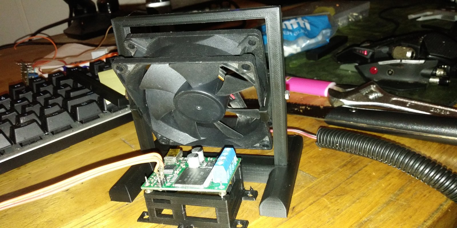

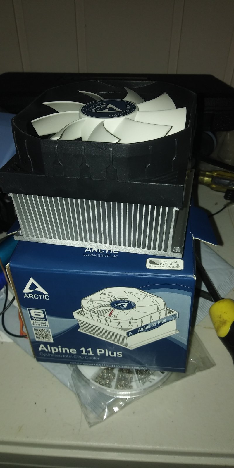

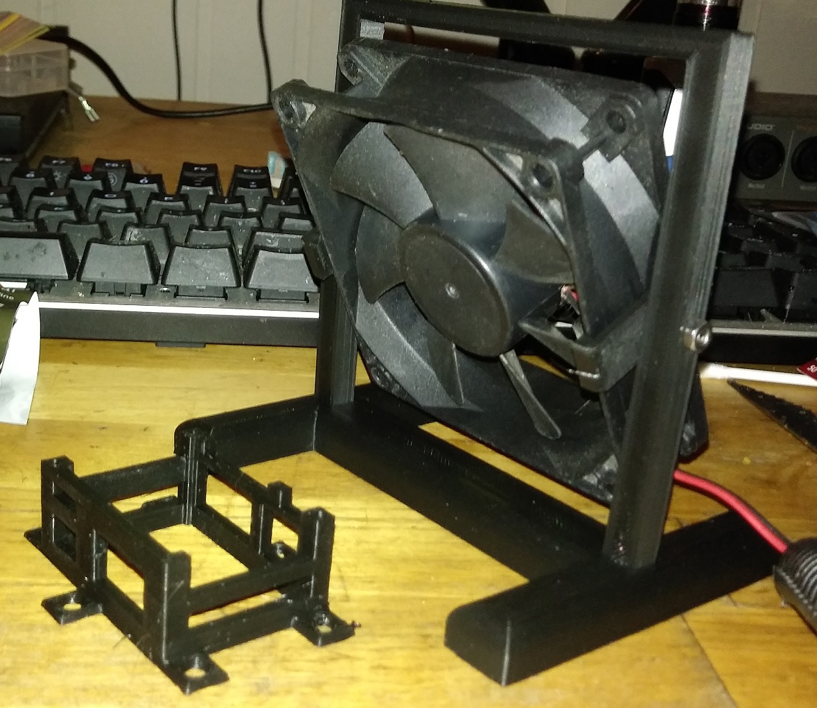

    The wiring is a mess at the moment, didn't want to do too much to it until i have the artic cooler setup running. At the moment it has a push pull running with two 80mm fans for intake and a 120mm taking some seat away. The JRK's barely get warm at all even after hour long league races.

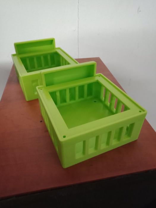

    I 3d printed out the JRK mounts that Lol4 designed and a couple of 80mm adjustable fan holders to help cool the JRK's.
    I have also 3d printed out the artic cooler mounts that ZED from these forums designed, just waiting for a friend to be able to drill and tap some threads so the JRK's can be screwed in rather than sticking them to the heat sinks with double sided thermal transfer tape.

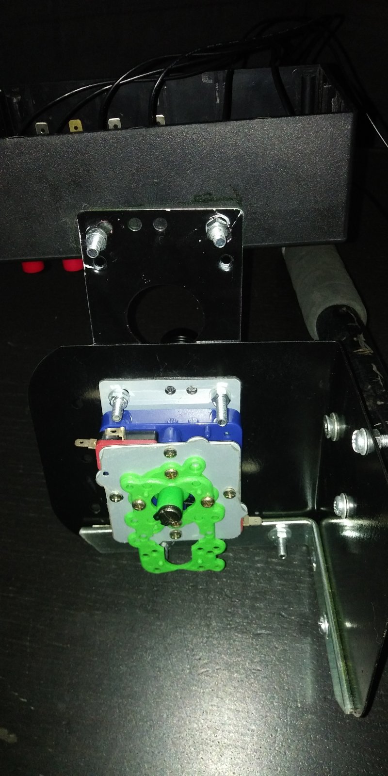

    I made a cheap sequential shifter and handbrake setup from bits and pieces i had laying around. The shifter is running off an arcade joystick and the handbrake is just running off a switch.

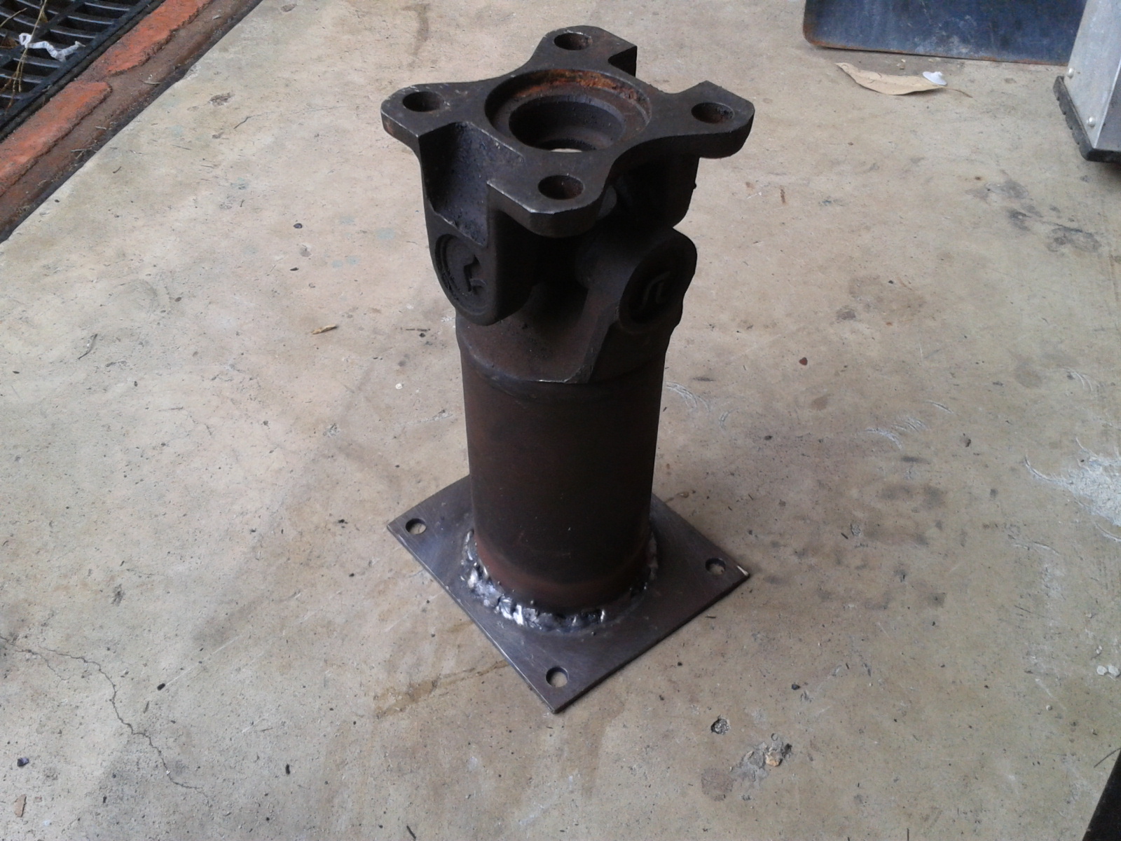

    The car diff cut and welded onto a plate for mounting.

    can I ask you where did you find this car diff I don't know what is that
  15. noorbeast
    21,725
    152,063Coins
    +11,065 / 56 / -2
    It is the universal joint from a cut down car tailshaft.
