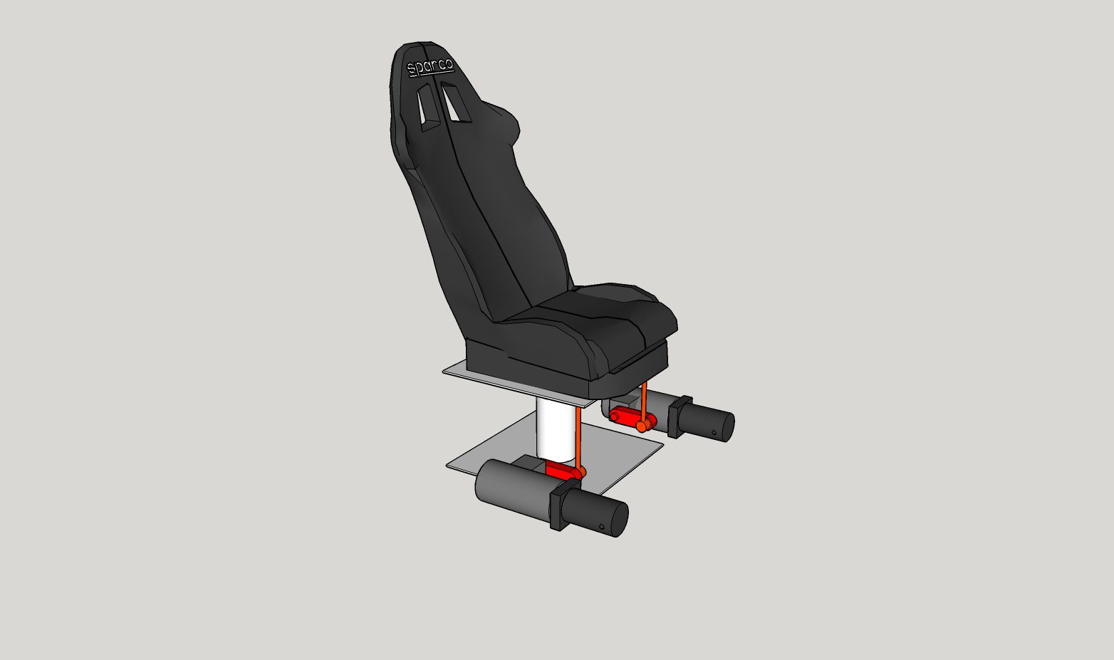

    As I do not have a dedicated room for the simulator, I'd like to keep it fairly compact and easy to move. Here is my first concept drawing for a layout.

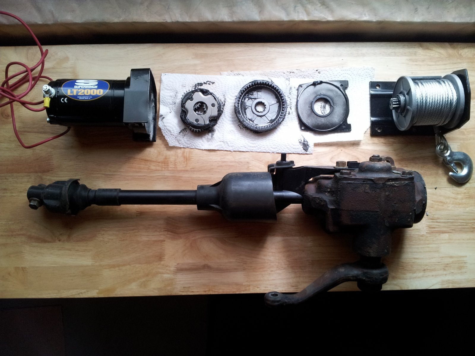

    So far, the parts I've collected are:
    - 2 Superwinch LT2000s for motors
    - 2 Steering boxes from '85 Chevrolet S10 for gearing (28:1 ratio)
    - Rear driveshaft from '00 Dodge Dakota for universal joint

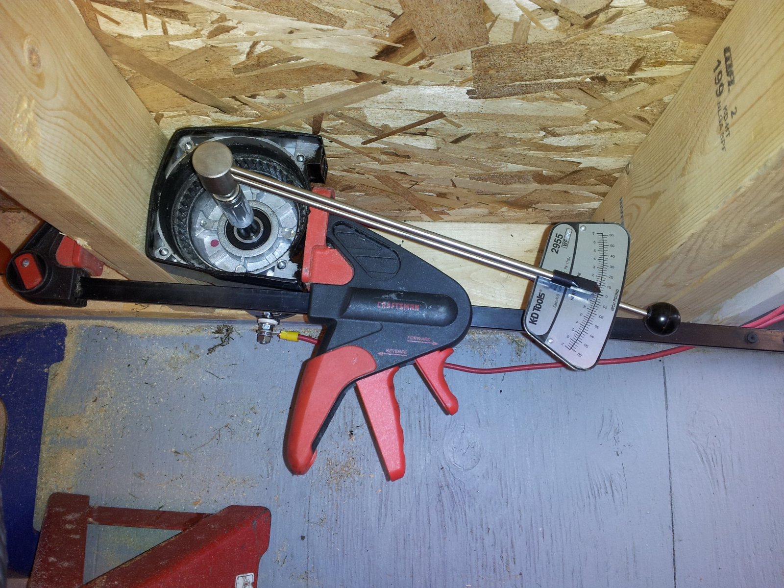

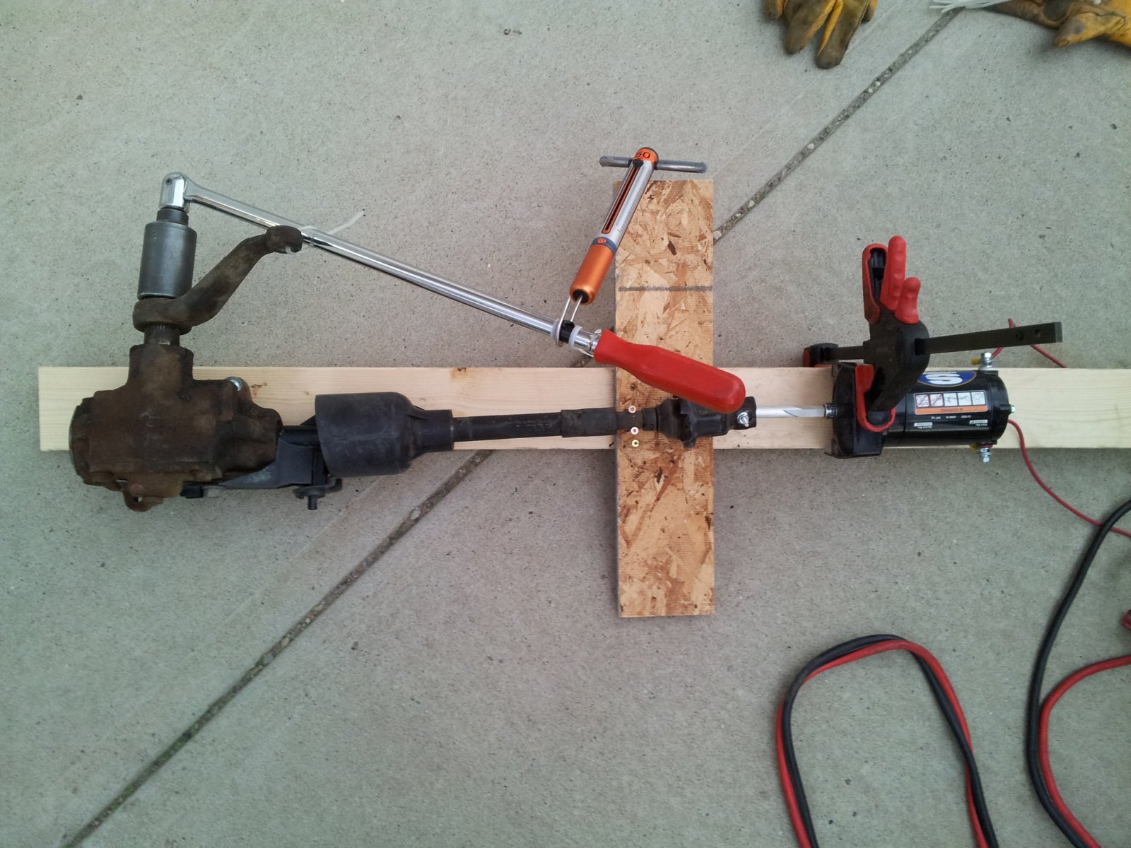

    @bsft my steering boxes max out at 93 degrees total travel on the output shaft, so I'm thinking if I drill some new holes in the pitman arms 50mm from the center of the shaft, that should give me 72 mm of total travel.
    Just tested the mechanical output of the winch motor/steering box combo using a breaker bar and a fish scale. I feel like this rig needs a bit of duct tape to complete the look lol.
    Results are 19.2 kg at 0.393 m from the center of the shaft.
    After a little math, that means my output torque is 73.9 Nm. My output force on a 50mm arm would be 151 kg for each actuator. I'm pretty happy with that!

    @noorbeast the specifications on the Superwinch website state that it is a 750W motor. I tried to work backwards from their output specifications based on rated line pull, rated speed, gear ratio, and drum diameter to figure out the motor torque and speed, but the numbers just weren't working out for me. Instead, I disassembled the winch and took some measurements of my own.
    By my own measurements, the stall torque is 3.5 Nm and the free speed is 4420 rpm. I measured output torque with one of those bending beam style torque wrenches (I have a nice little 1/4" one that worked perfectly), and I measured the output speed at no load with a photo tachometer. Both measurements were done using jumper cables from my truck battery as the power source and a 12V contactor I had laying around.
    Putting 3.5 Nm of torque into a 28:1 gearbox and getting 74 Nm out at the other end, I figure these steering boxes are about 75% efficient at transferring torque. Replacing the lubricant in the steering boxes might improve that number somewhat too.

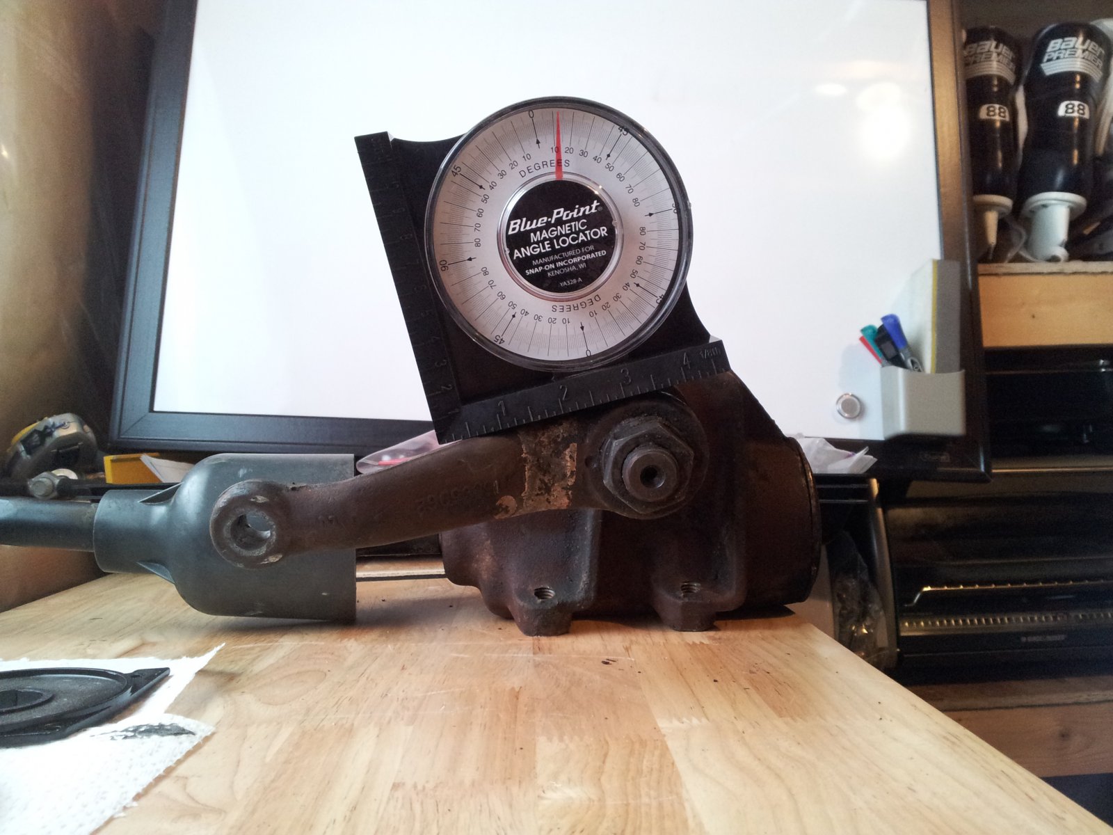

    @noorbeast since the steering box is a ball screw assembly, the output shaft can only move in a range of 93 degrees. It moves so quickly from lock to lock that I'm not sure I can accurately measure the speed.
    I checked the ratio by counting revolutions of the input shaft and using a magnetic angle gauge on the output arm. Input moved 7.25 turns or 2600 degrees; output moved 93 degrees. That gave me a ratio of 28:1.
    Inspiration to use winch motors came from @Pit 's build. They cost me $90 CAD each brand new, and they are available at many local stores. The steering boxes cost $60 CAD each from a local auto wrecker.
