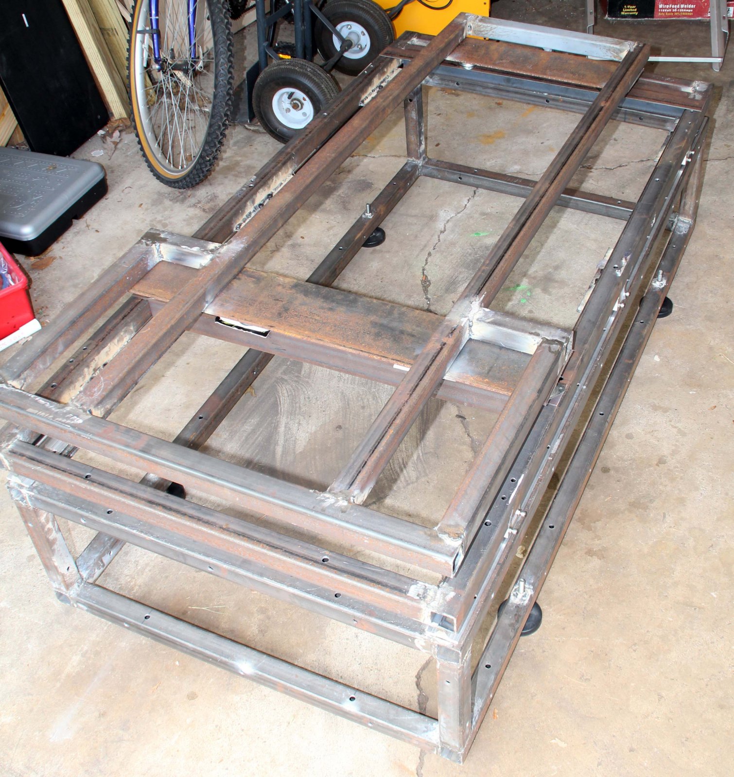

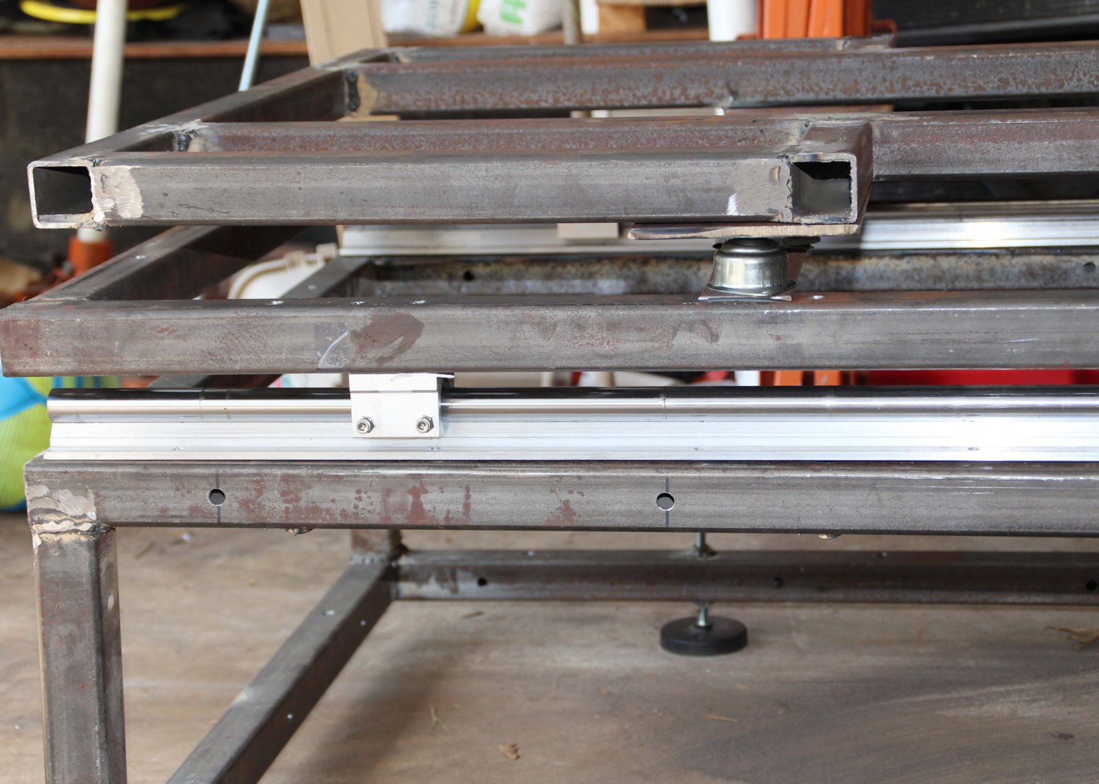

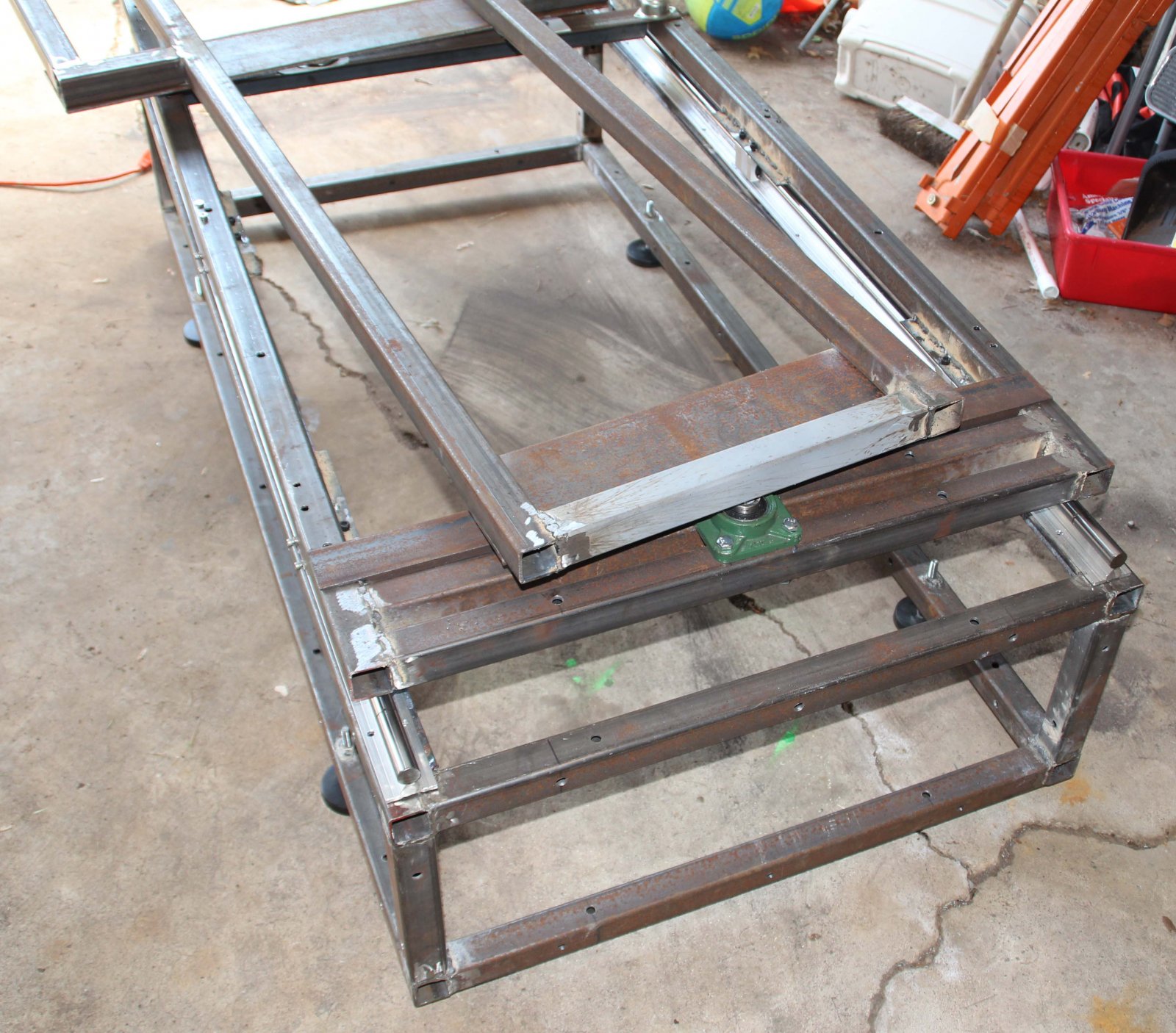

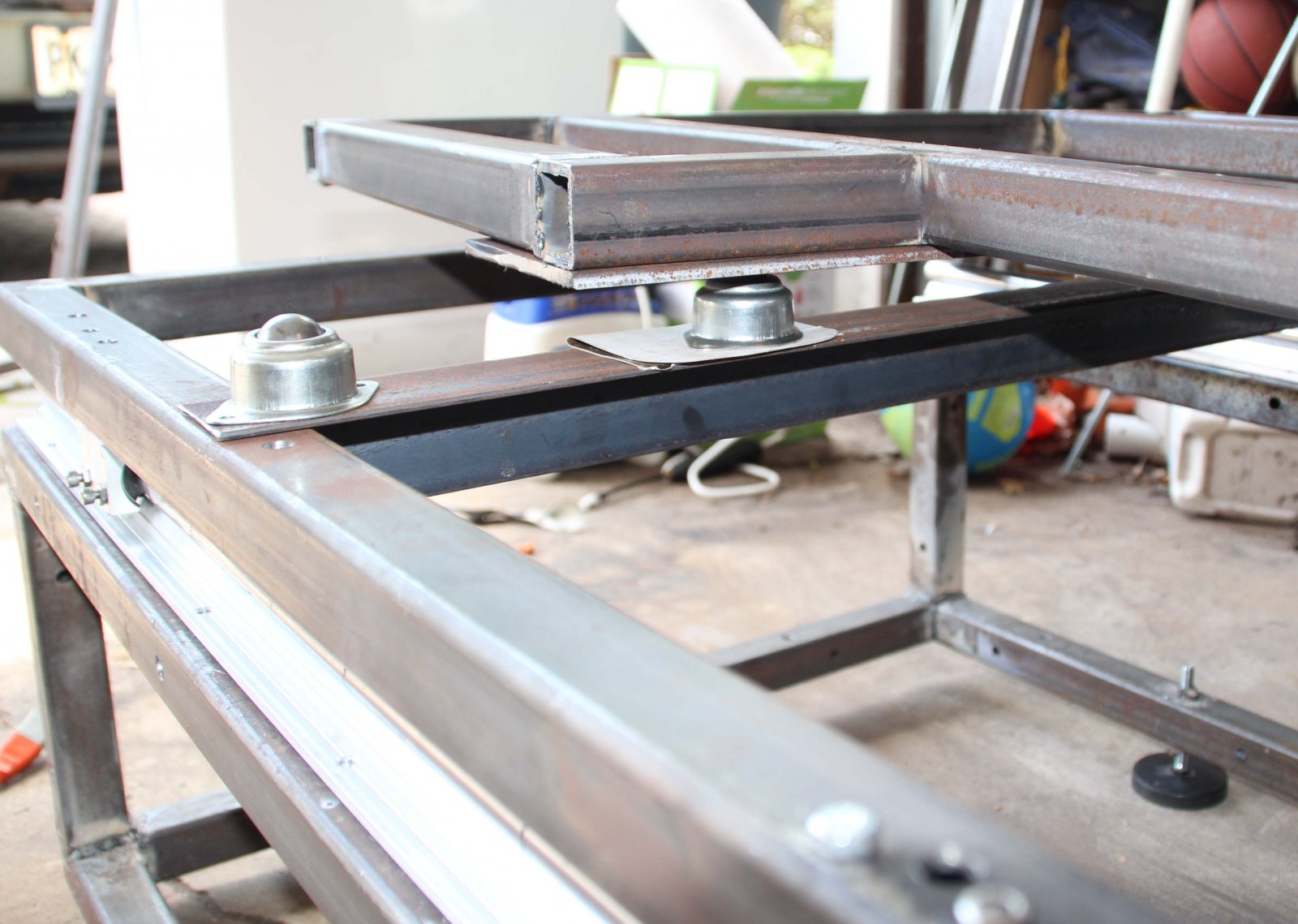

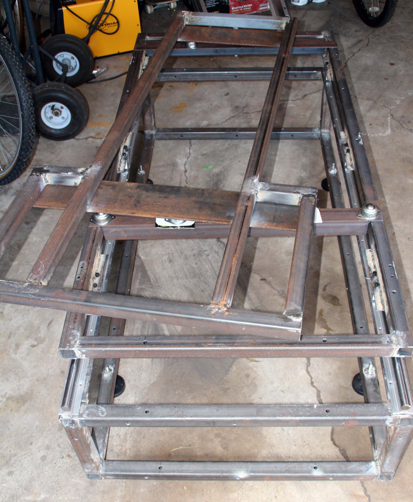

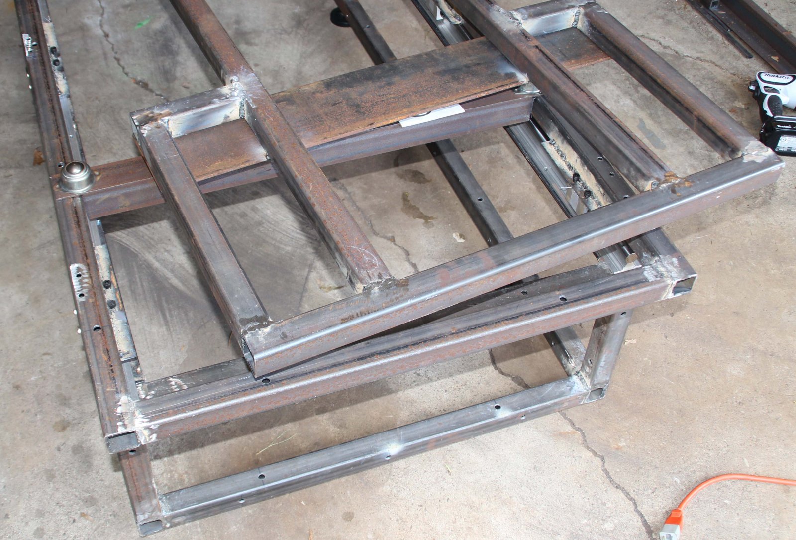

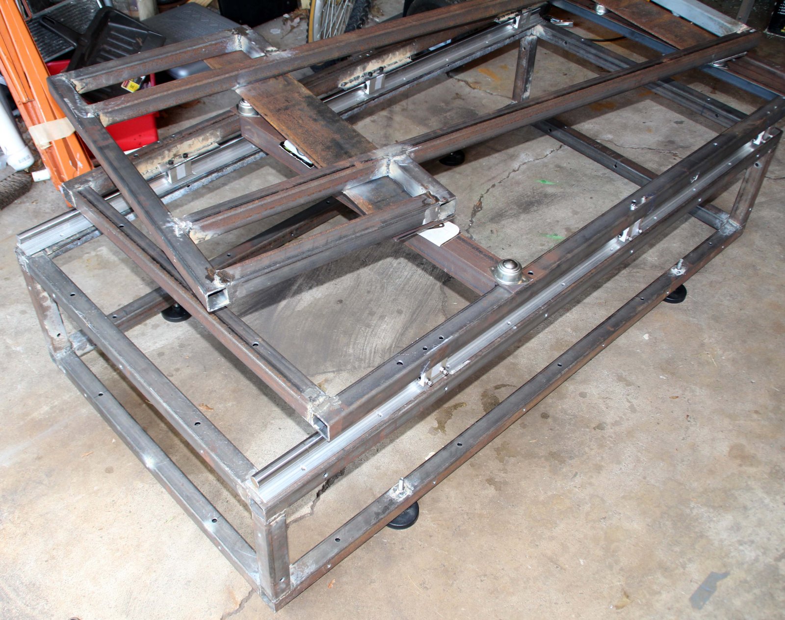

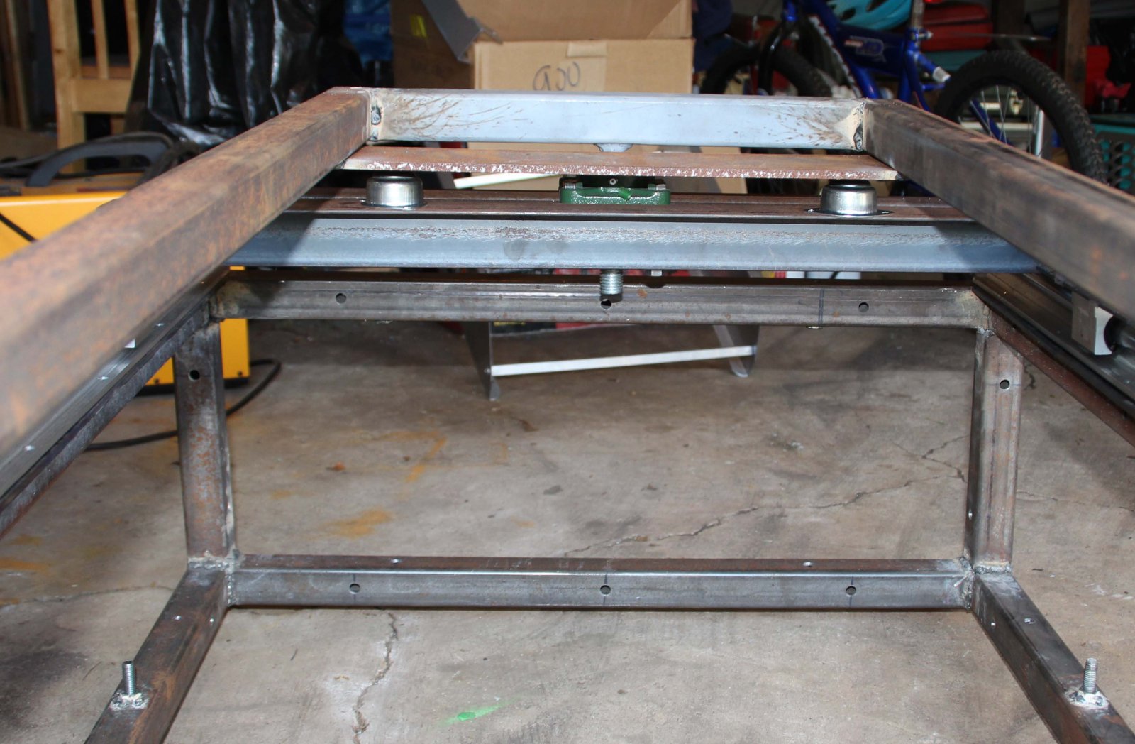

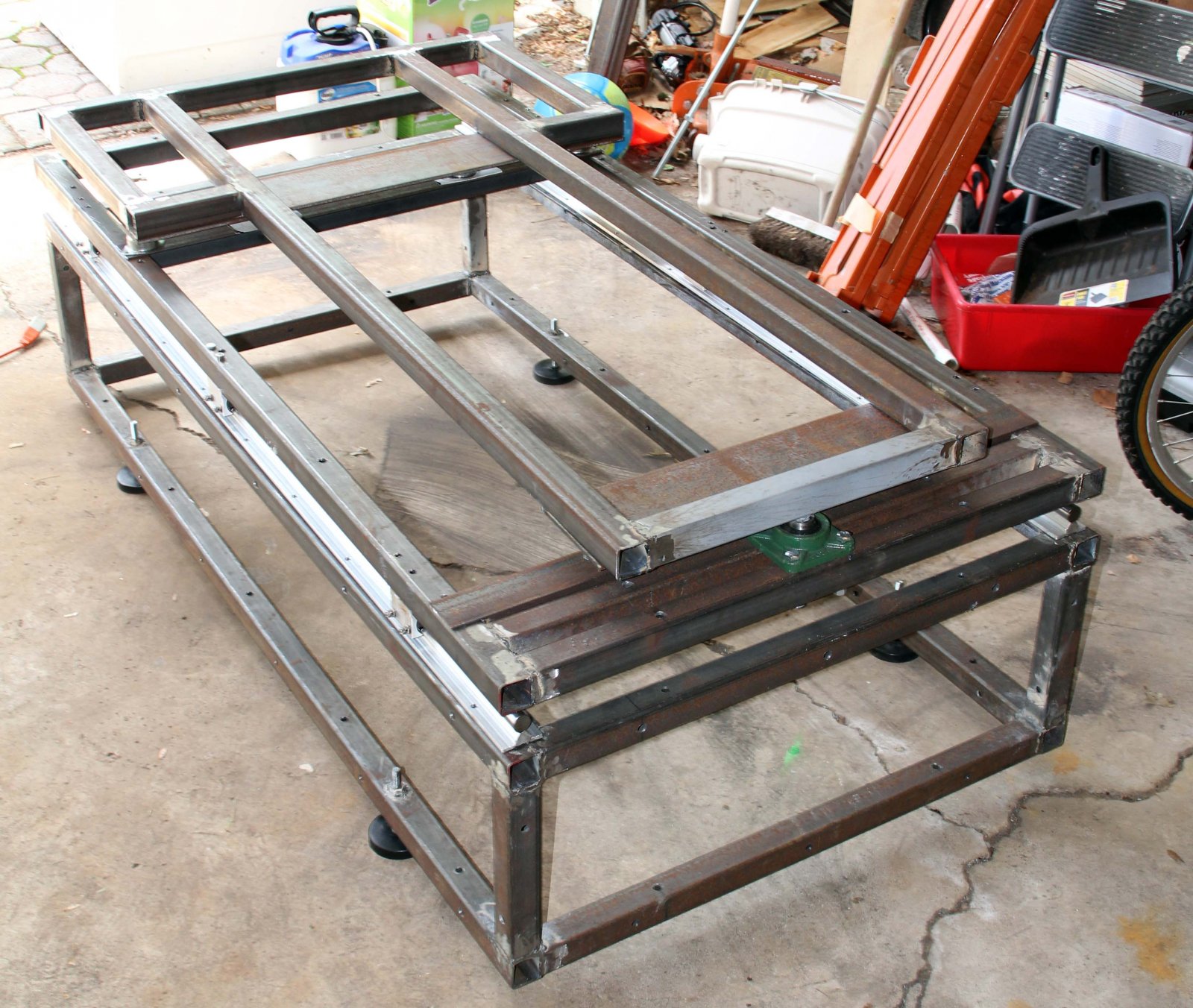

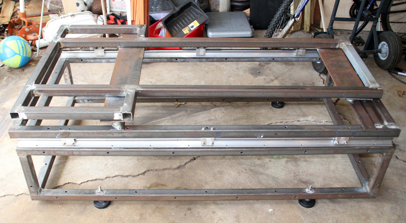

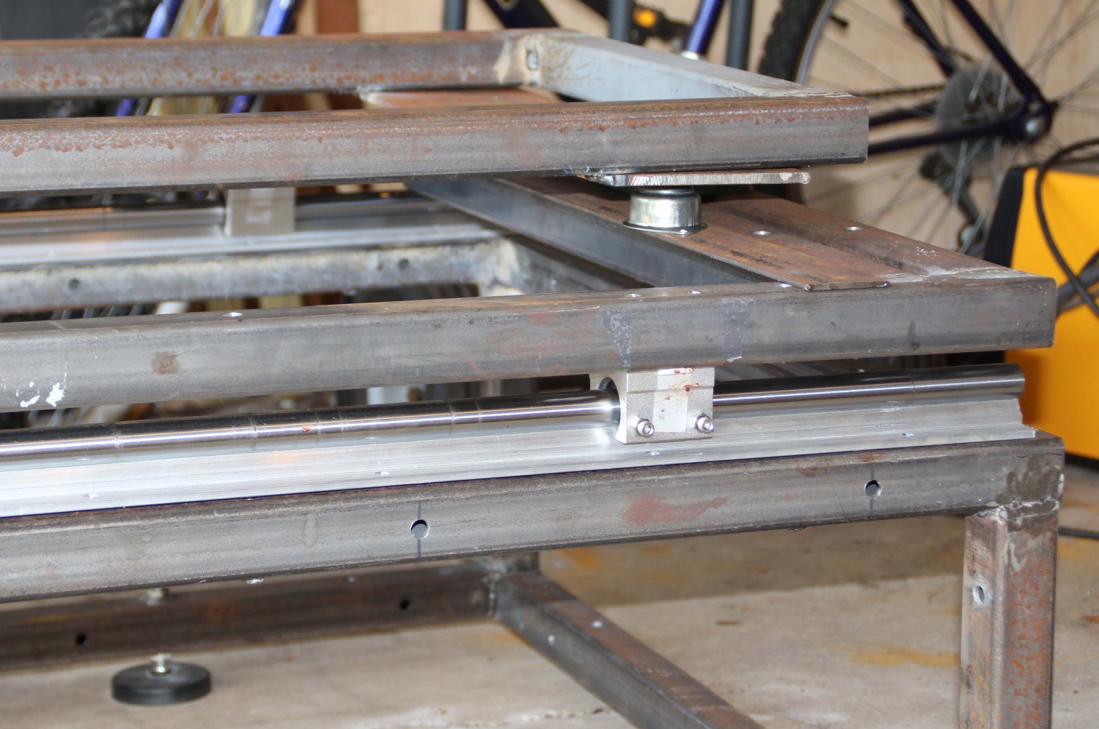

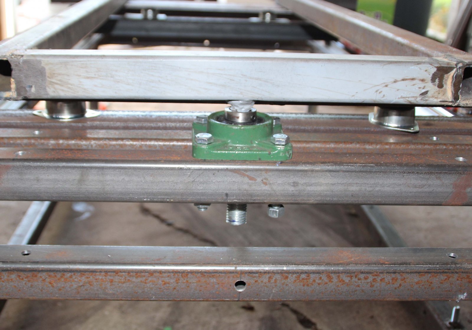

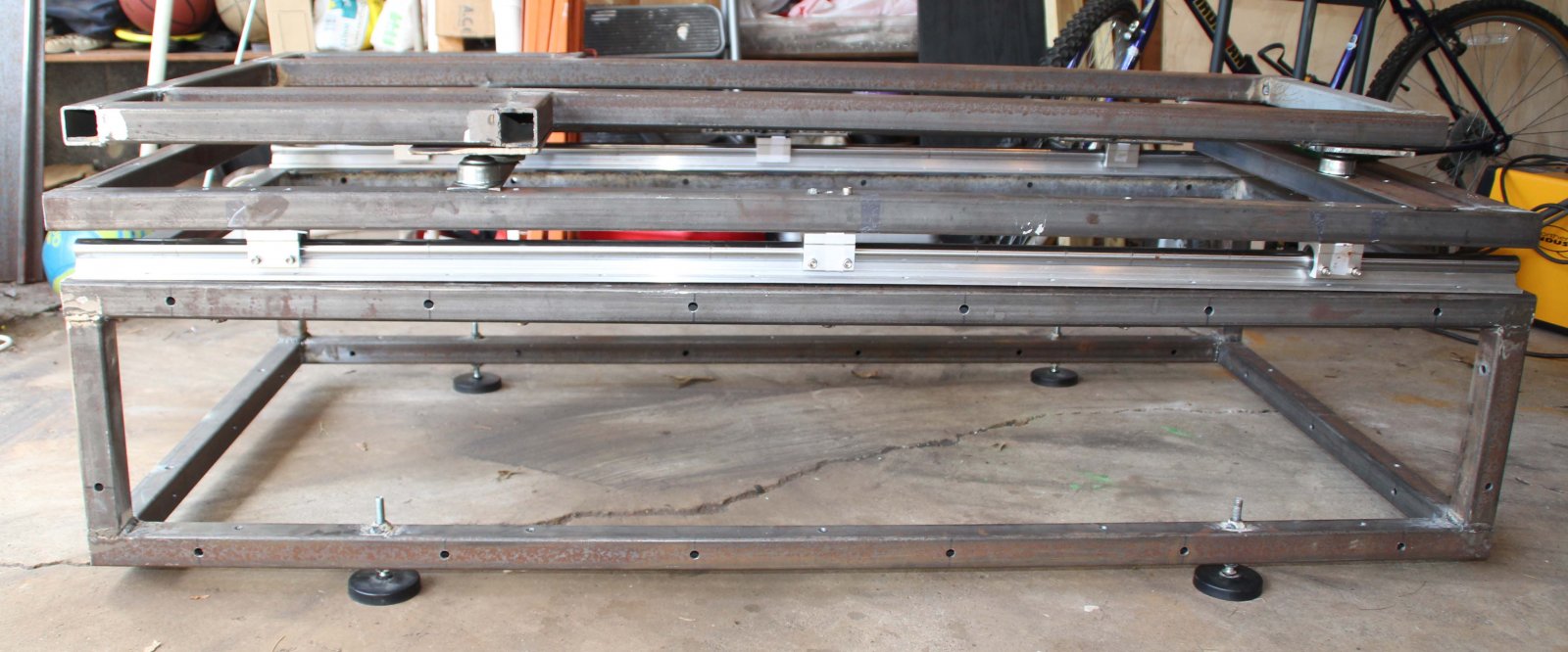

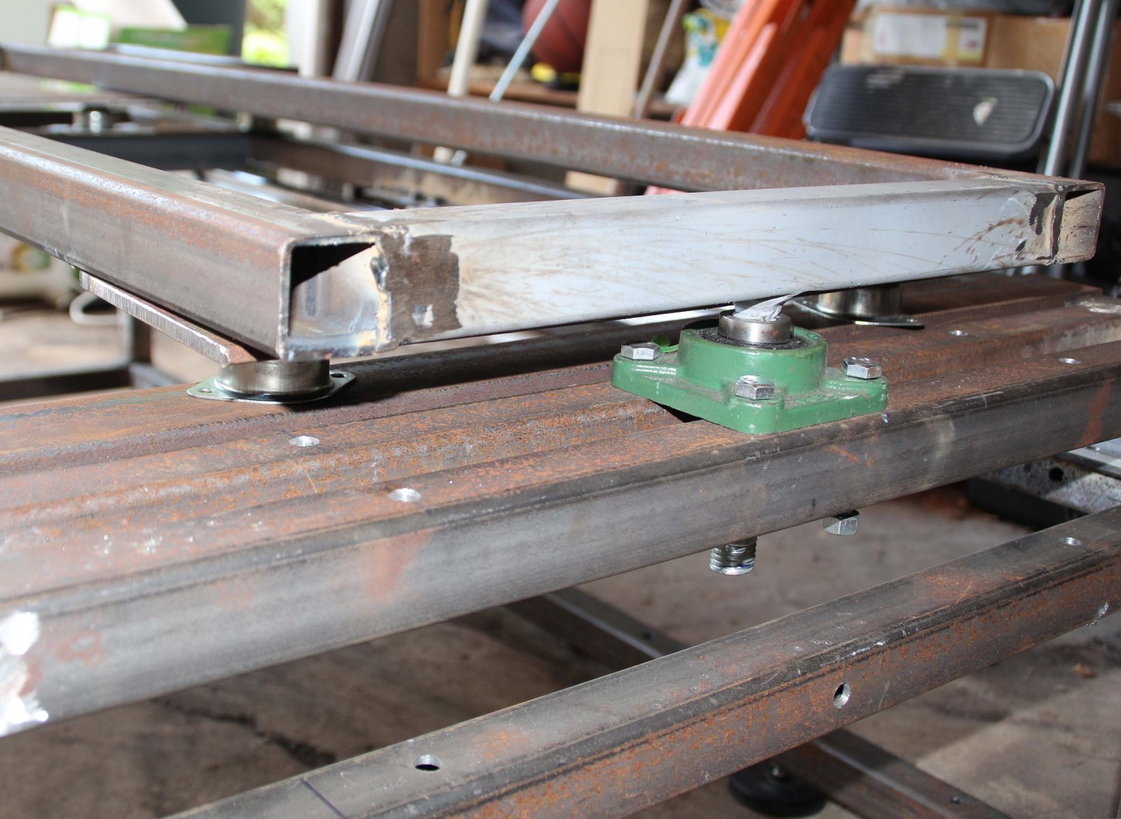

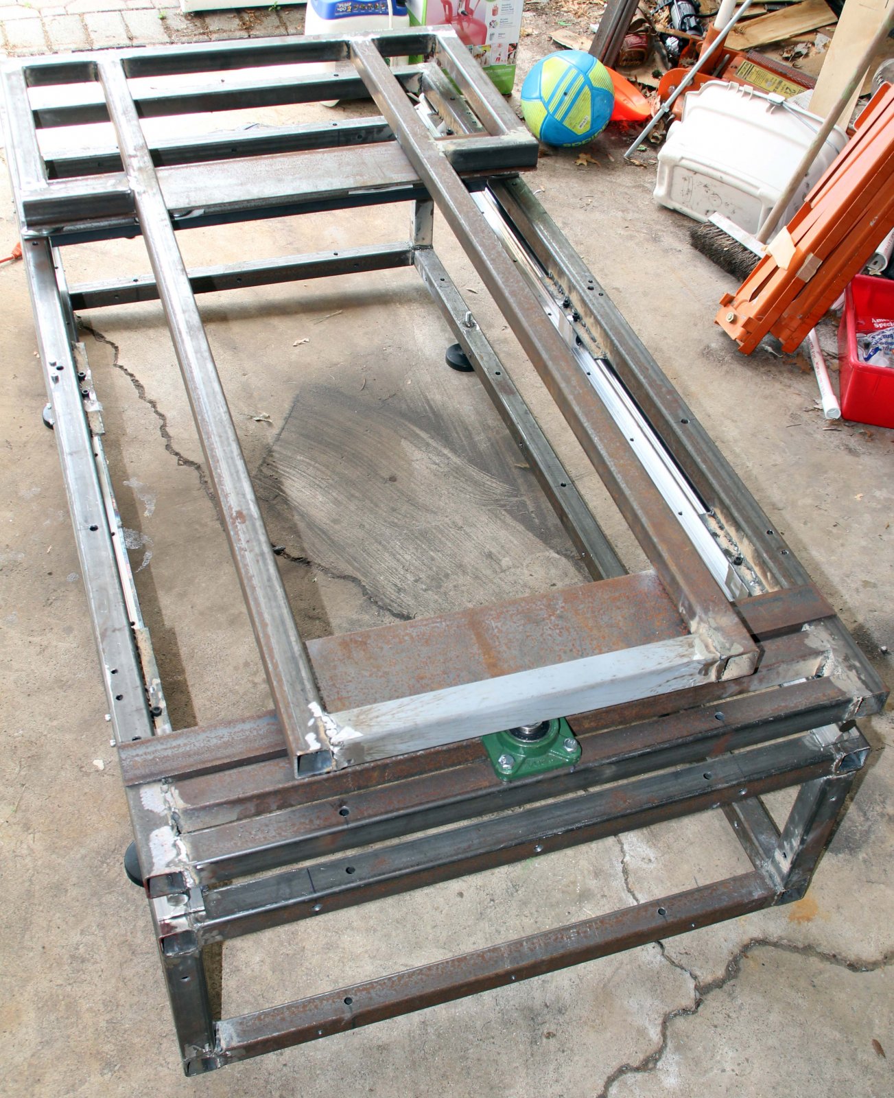

    Some progress to report. Lower frame is completed. Provisions for surge and traction loss.
    IMG_4525.JPG IMG_4519.JPG IMG_4523.JPG IMG_4524.JPG IMG_4522.JPG IMG_4515.JPG IMG_4514.JPG IMG_4506.JPG IMG_4508.JPG IMG_4511.JPG IMG_4512.JPG IMG_4513.JPG IMG_4517.JPG IMG_4520.JPG IMG_4521.JPG

    Thanks for the build update, you have been busy.
    How do the ball rollers for drift hold up under load, they look pretty smooth unloaded?

    each is rated for 110lbs, very smooth. if anything they are more quiet under load.
