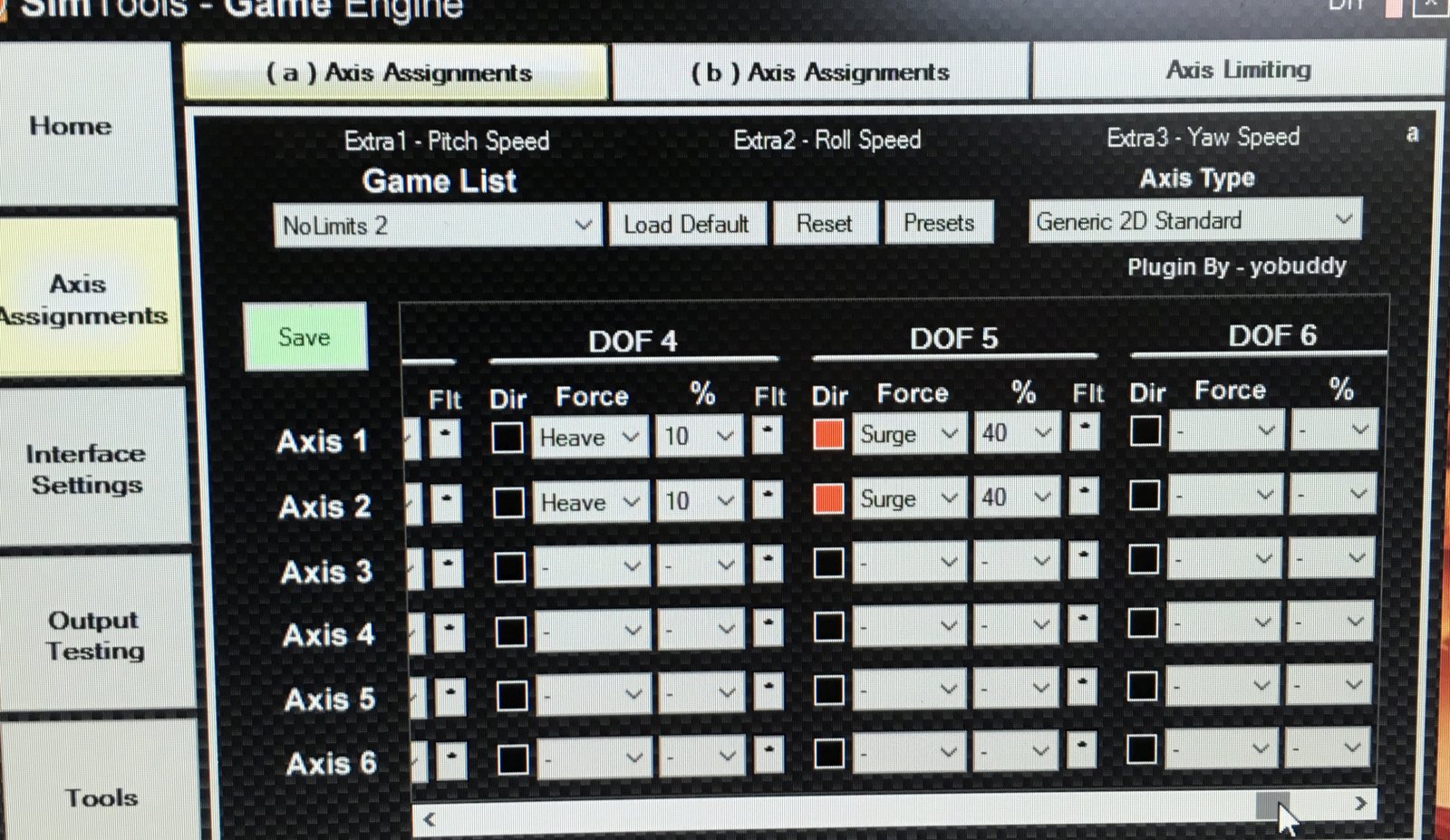

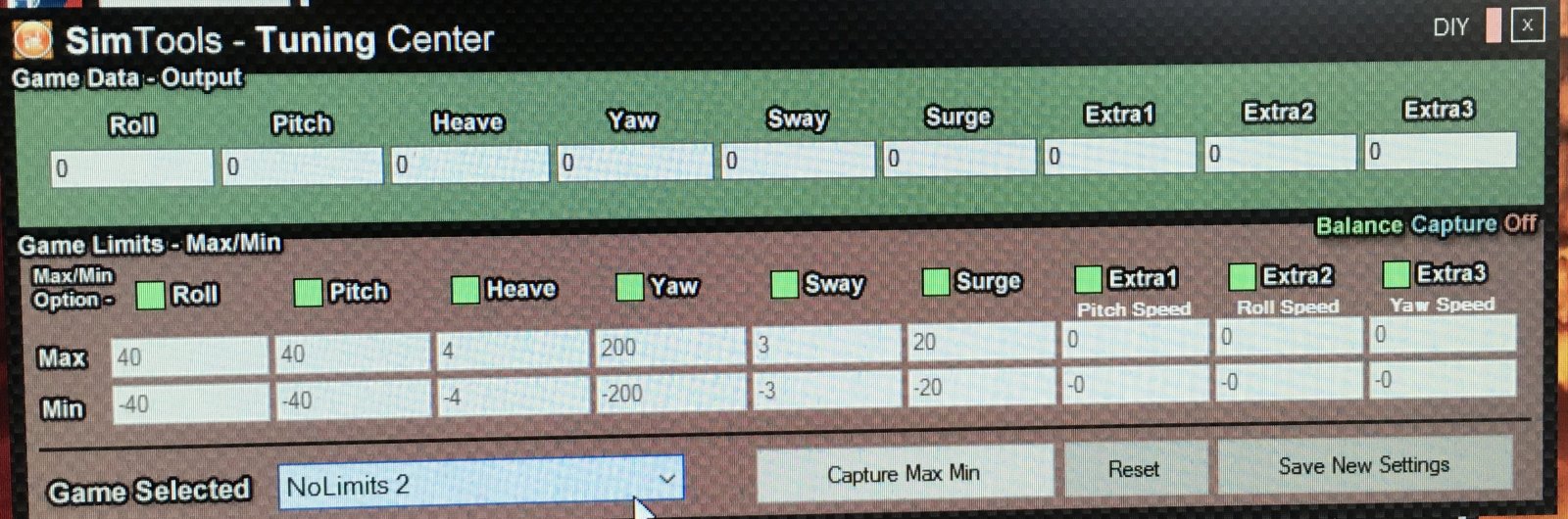

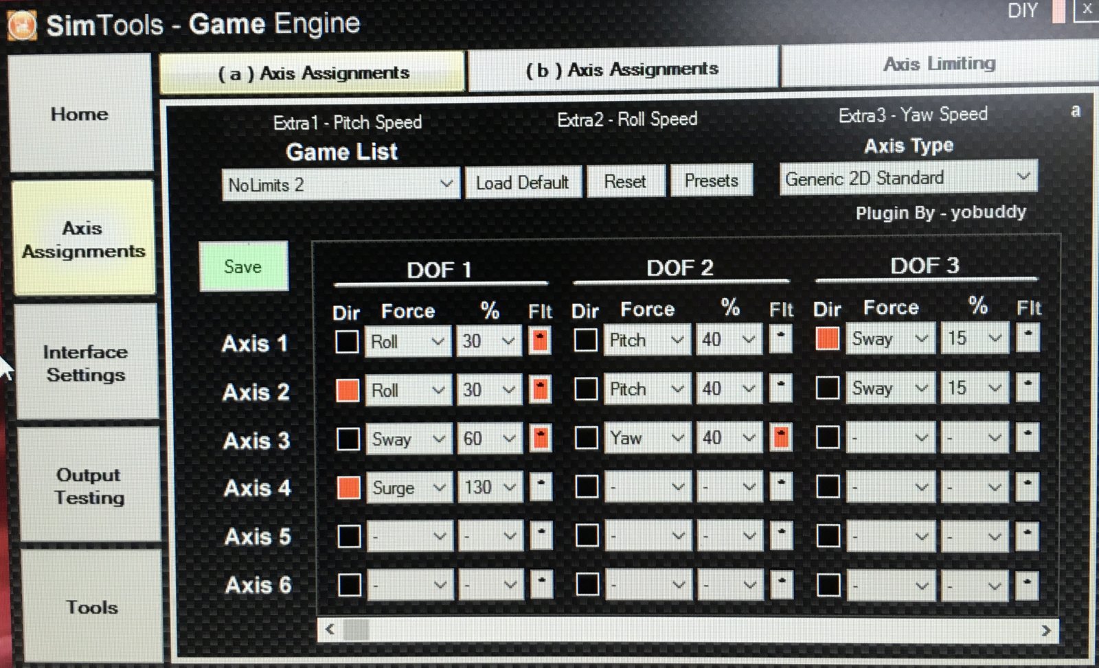

    Was able to successfully setup No Limits 2 for motion (with some help from @noorbeast) . Could've saved myself an hour if I paid attention to instructions and put "--" instead of "-" in front of telemetry. I attached my settings, please comment away. Axis 1 and 2 are shoulder motors, axis 3 is traction loss and axis 4 is surge. I also have 35% smoothing for roll, 50% smoothing for sway, and 40% smoothing for yaw. Also notice that I don't have yaw assigned to shoulder motors, after experimenting a bit I think it works best with the traction loss axis. I also opened tuning a bit for a smoother motion as compared to more snappier response I have in Assetto. Any suggestions are appreciated, cheers.
  13. noorbeast
    22,031
    153,782Coins
    +11,150 / 57 / -2
    Generally it helps to post both the settings and a video of the rig in action showing its movement and the game screen at the same time.
    That way members are in a better position to advise about possible further tweaks.

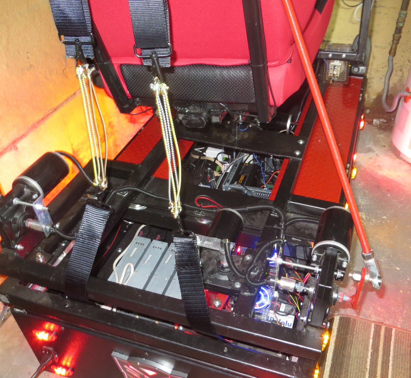

    Major issue tonight. The hollow tubing that u-joint is attached to gave in under my weight. Relatively easy fix, but I have to tear the whole thing apart. I just finish dressing up the wiring, permanently mounting everything in place, etc. Just started to enjoy the darn thing...Oh, well.

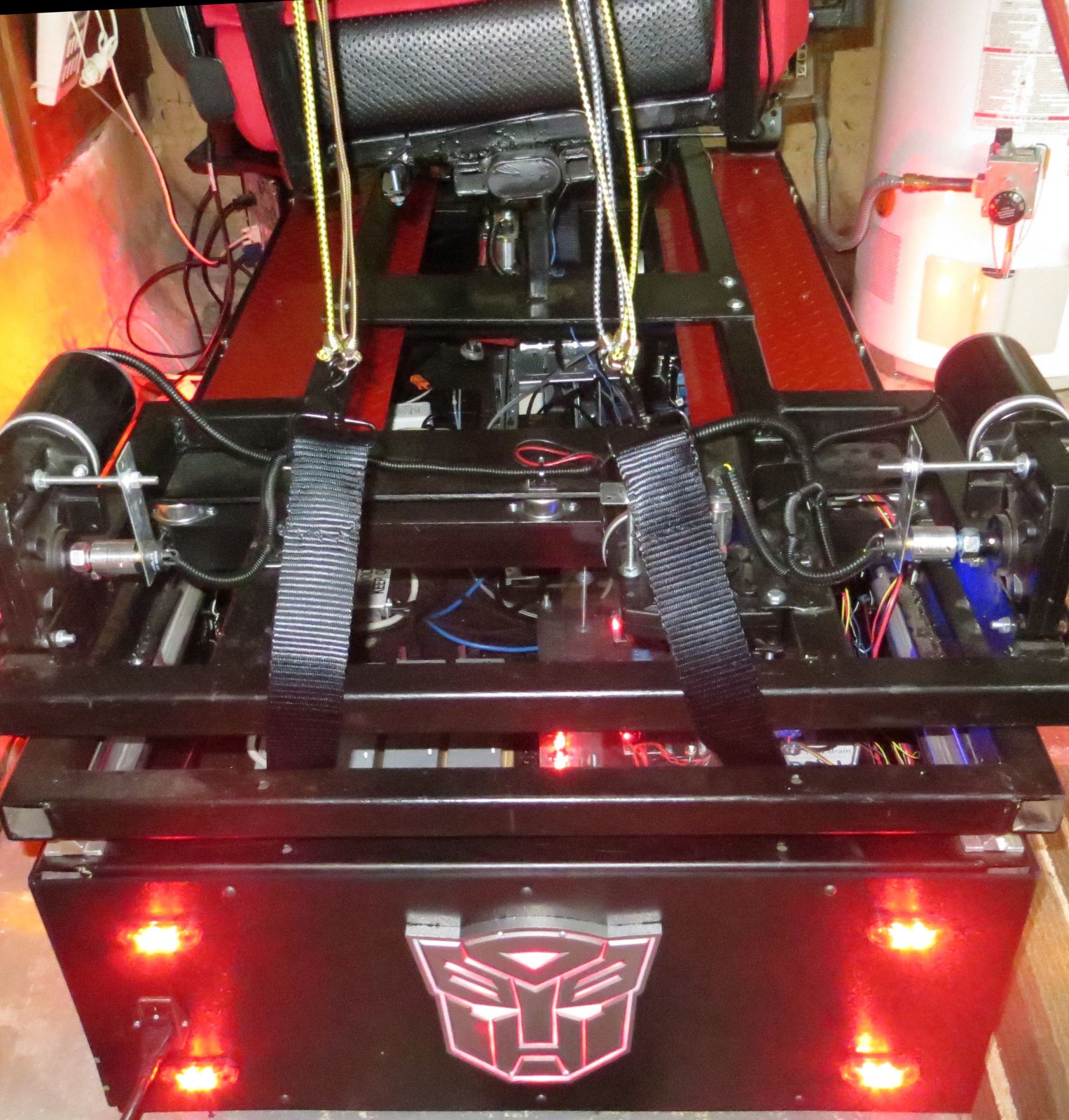

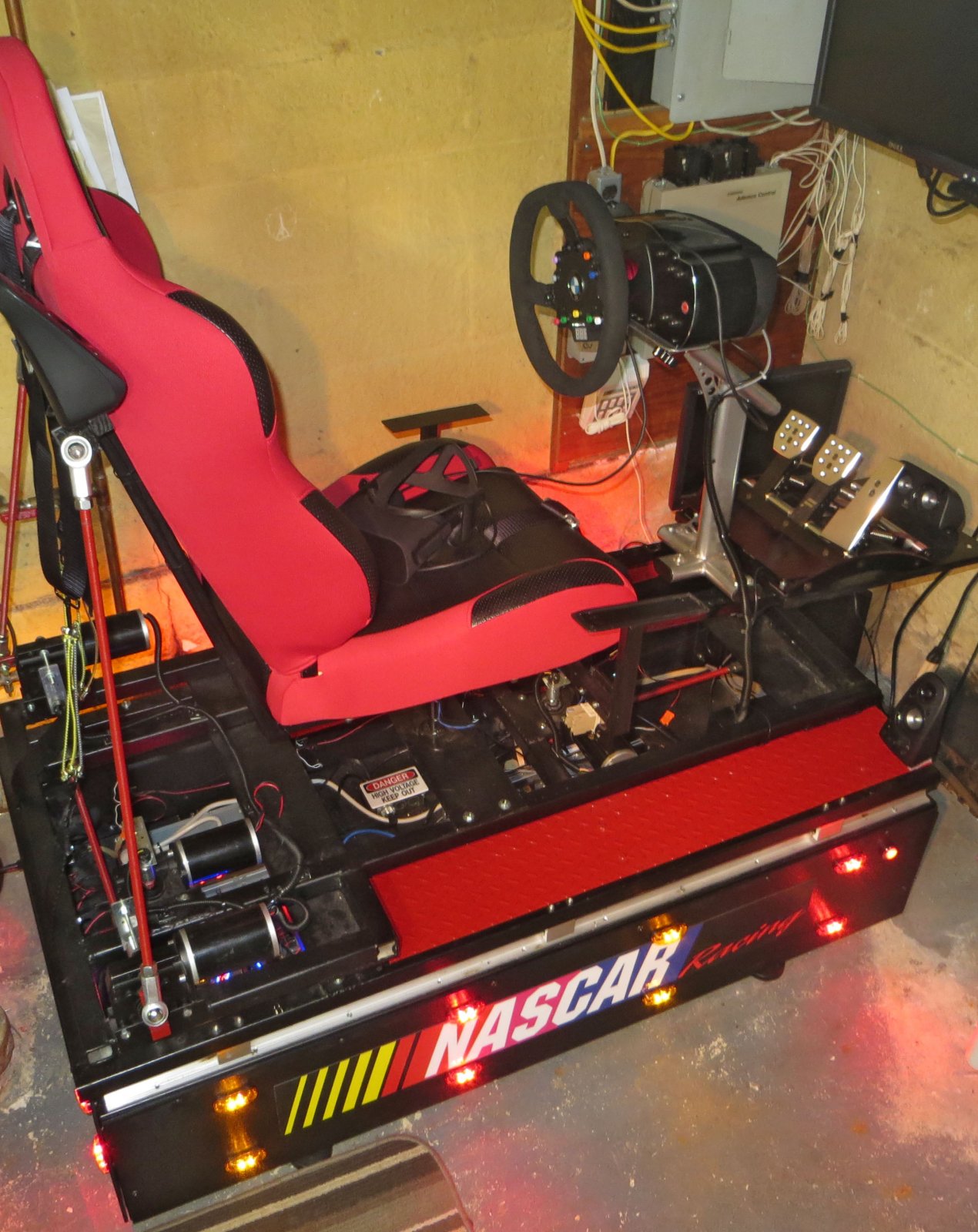

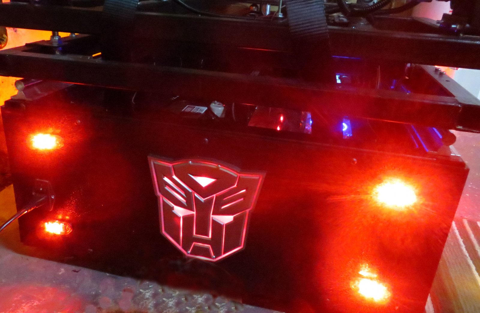

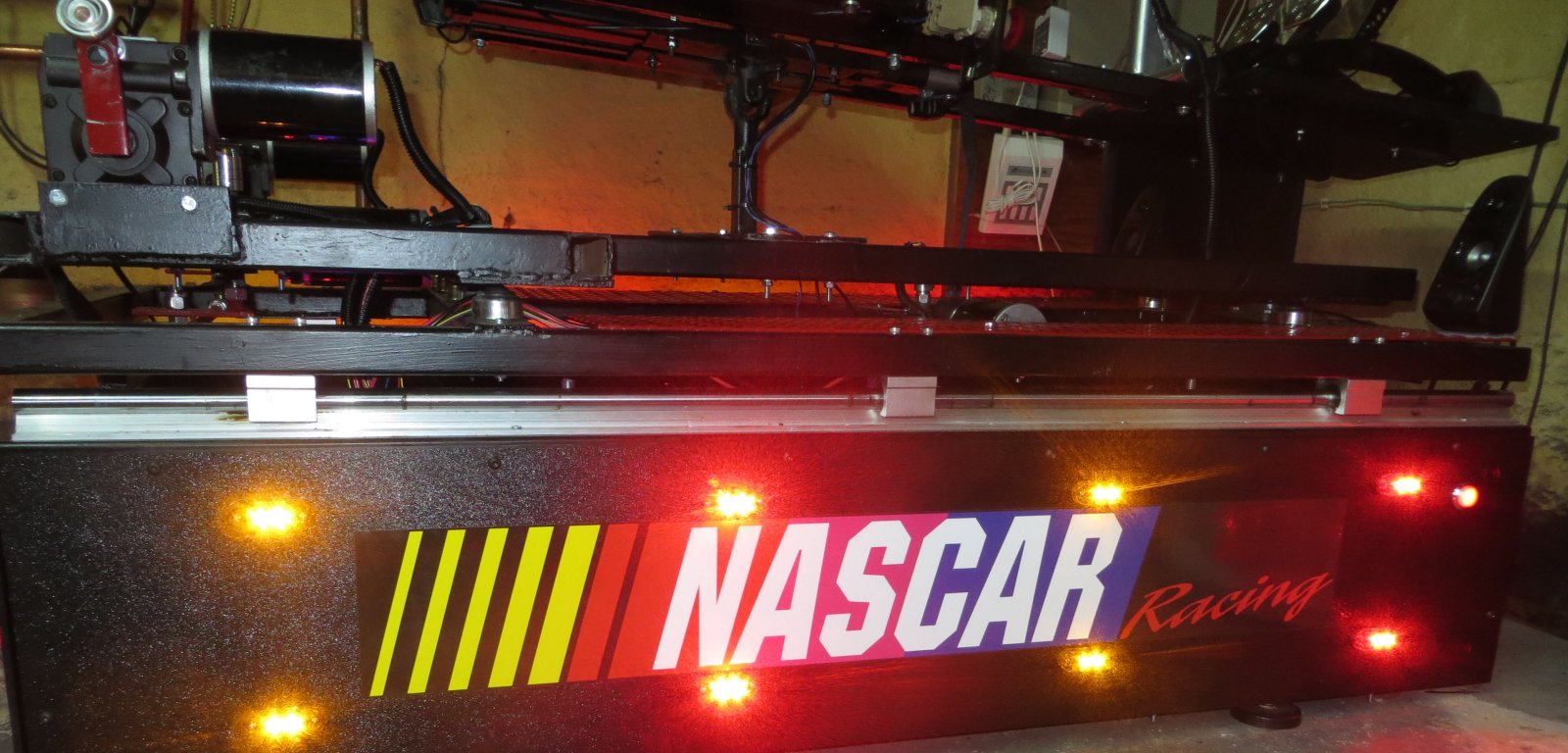

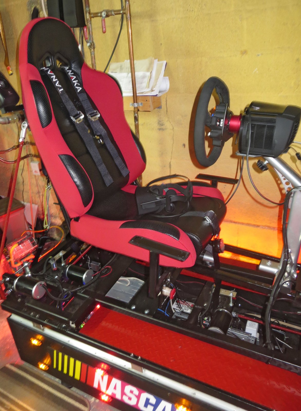

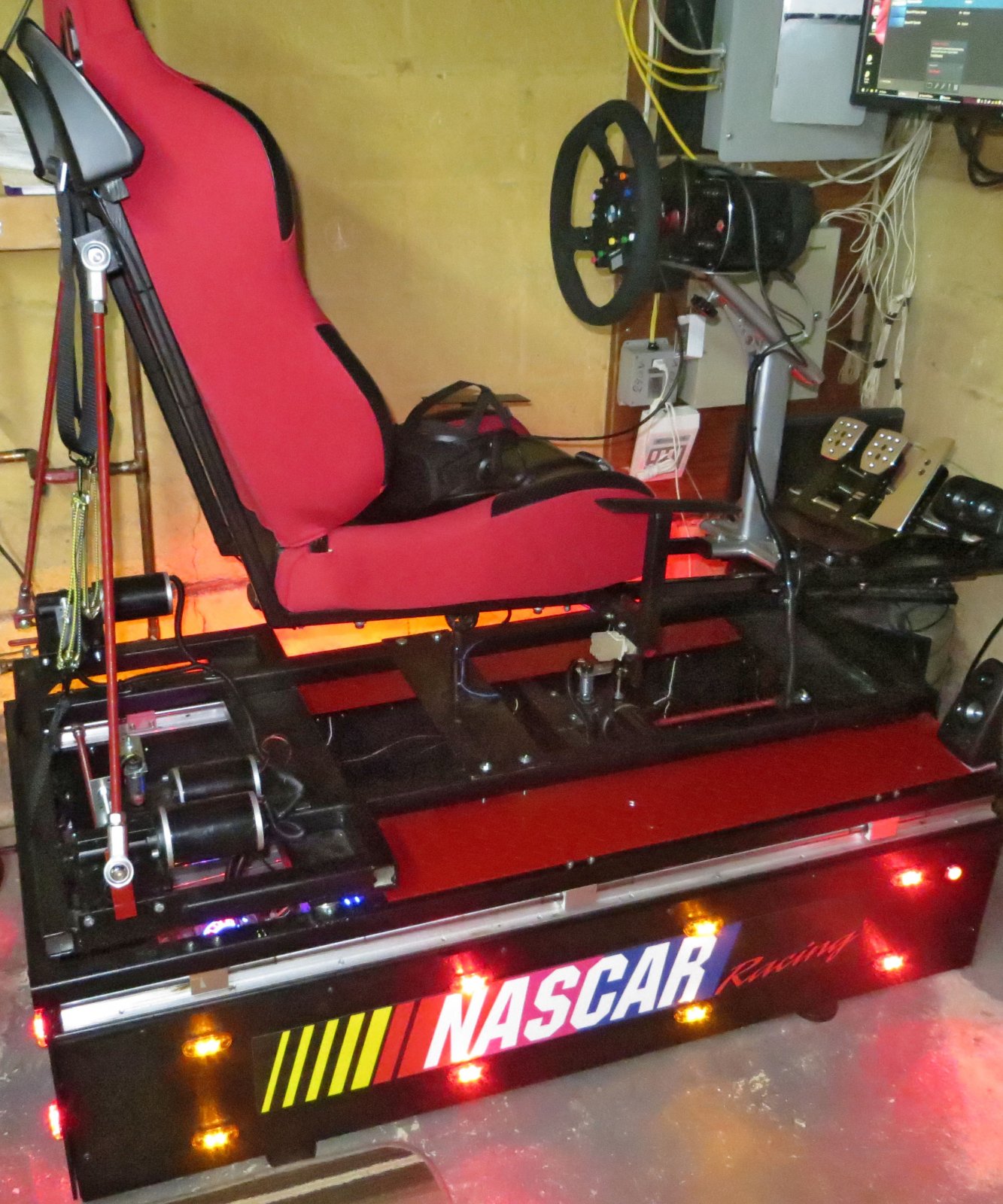

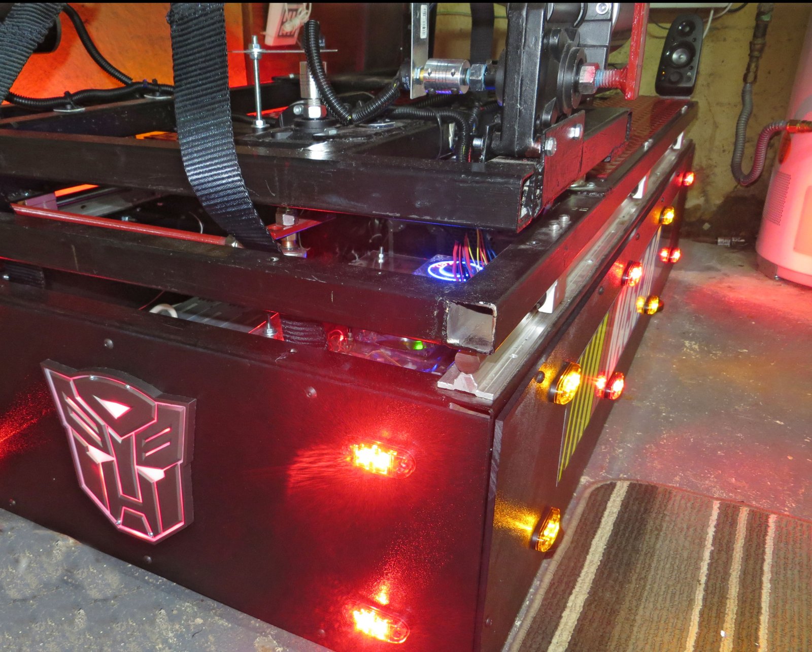

  17. reko19
    reko19 Active Member
    Sep 23, 2011
    179
    electrical engineer
    usa
    38Coins
    +53 / 0 / -0

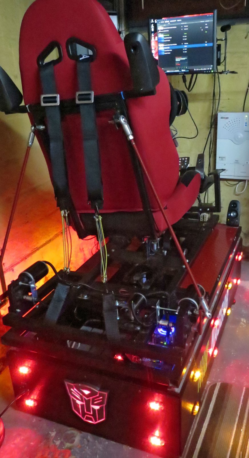

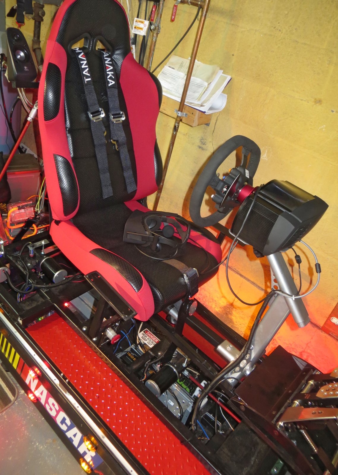

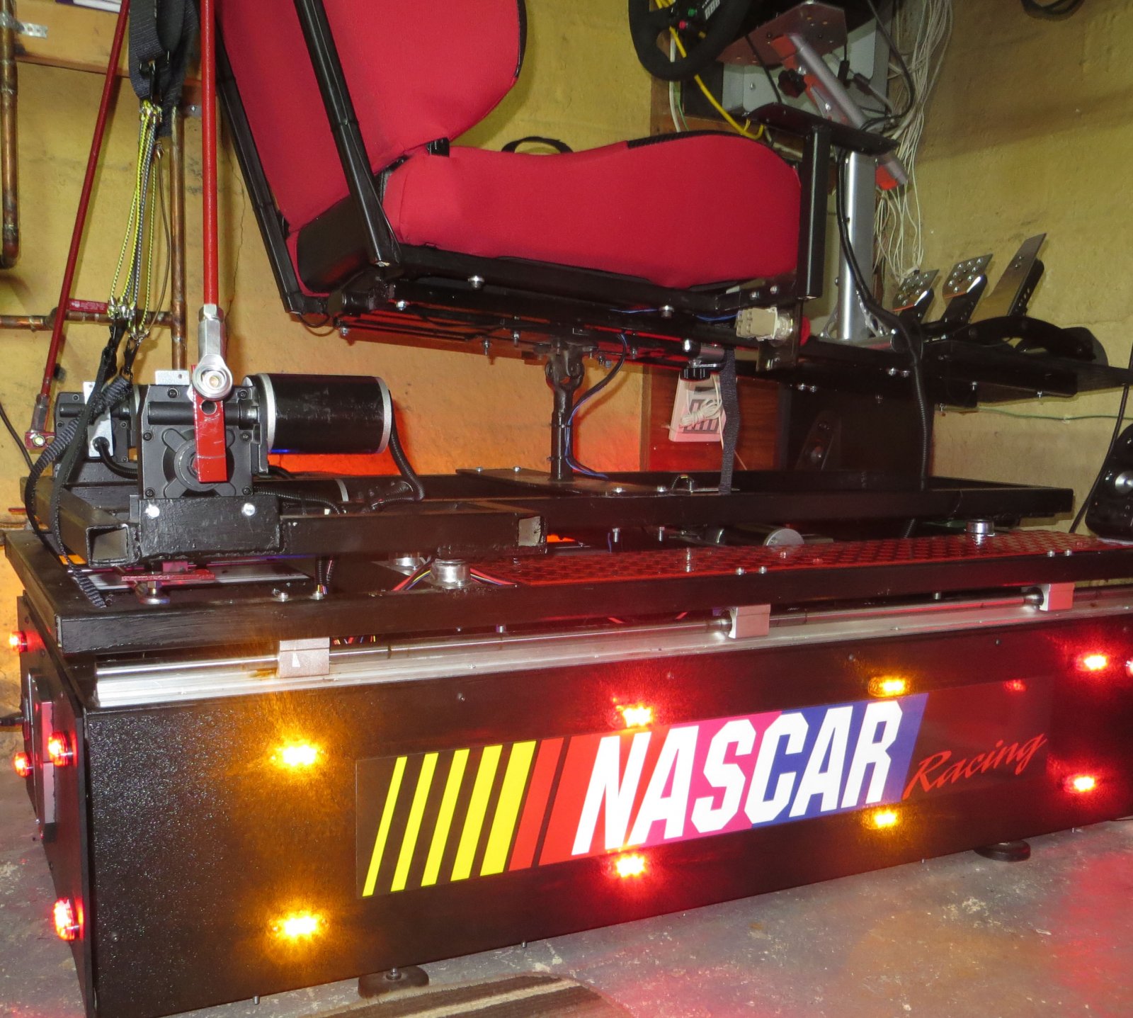

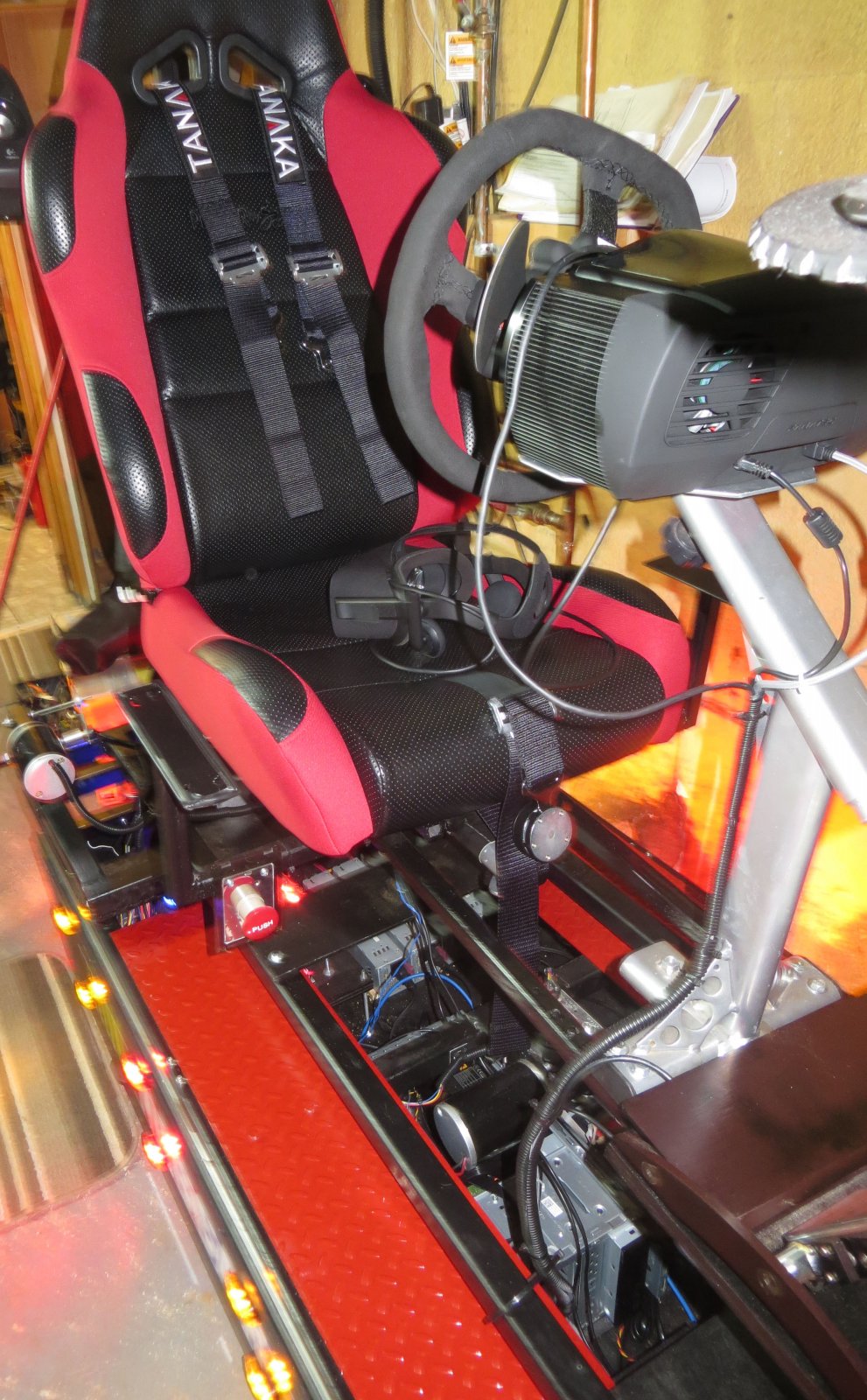

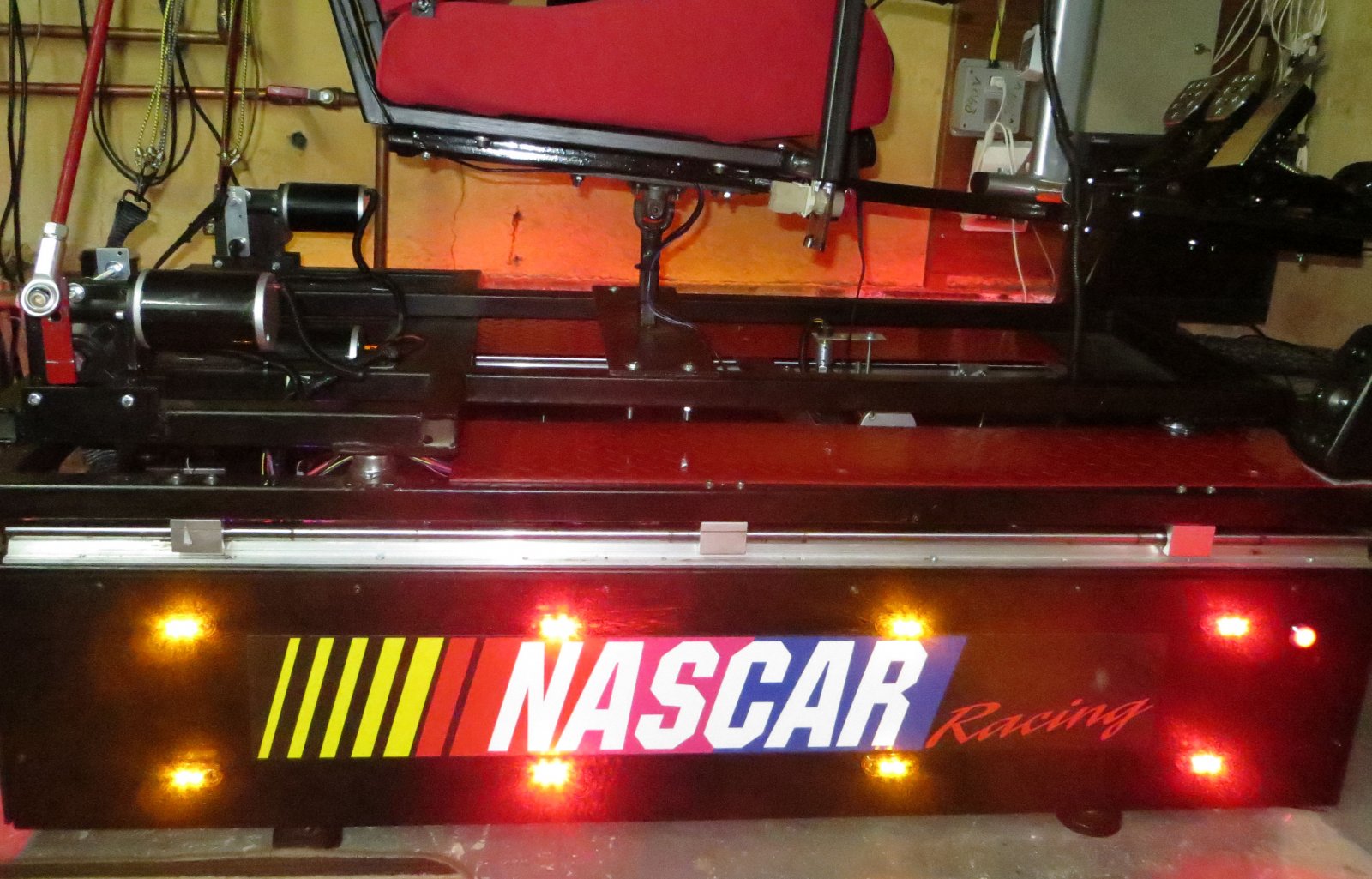

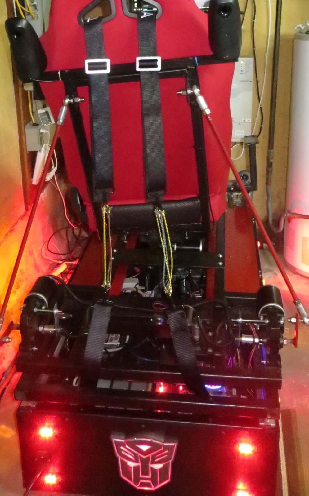

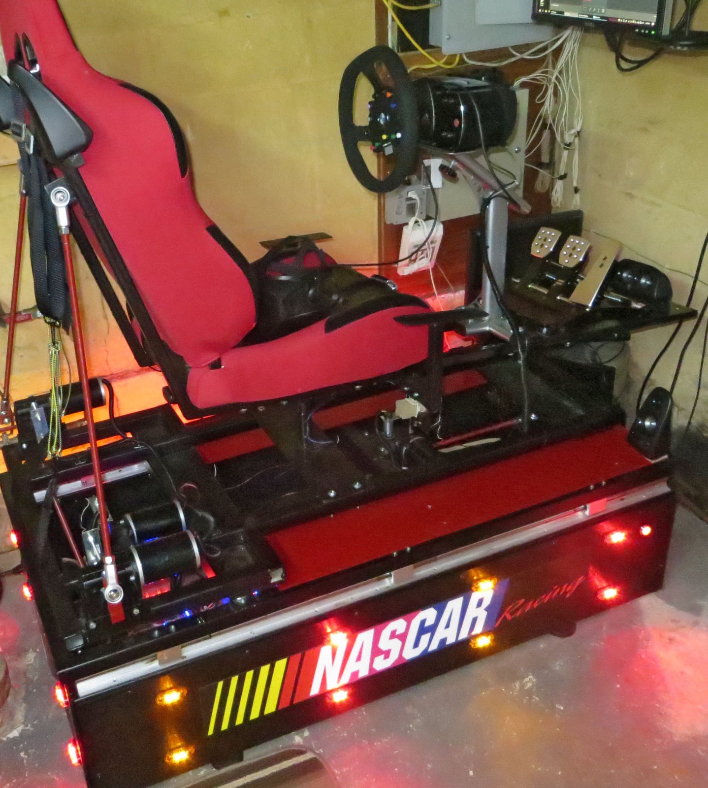

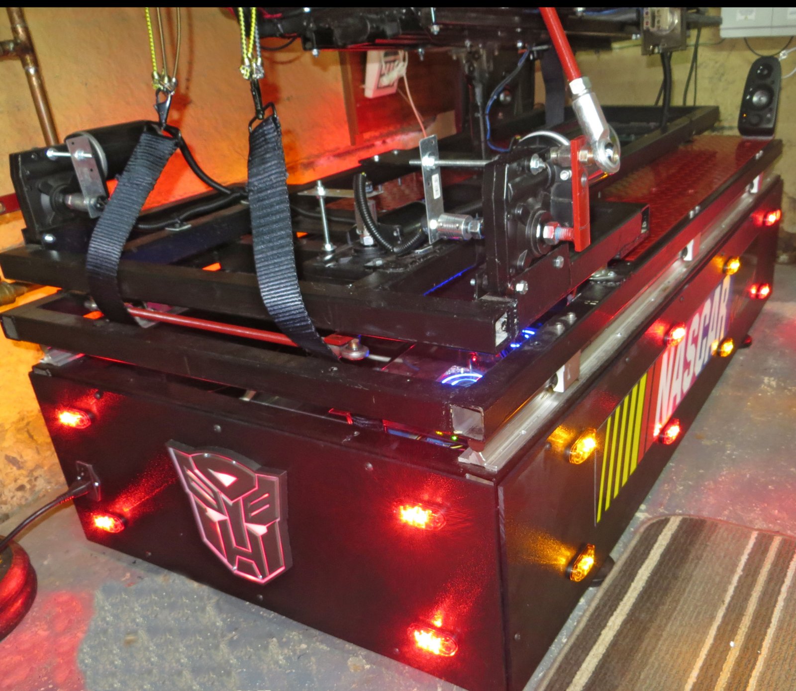

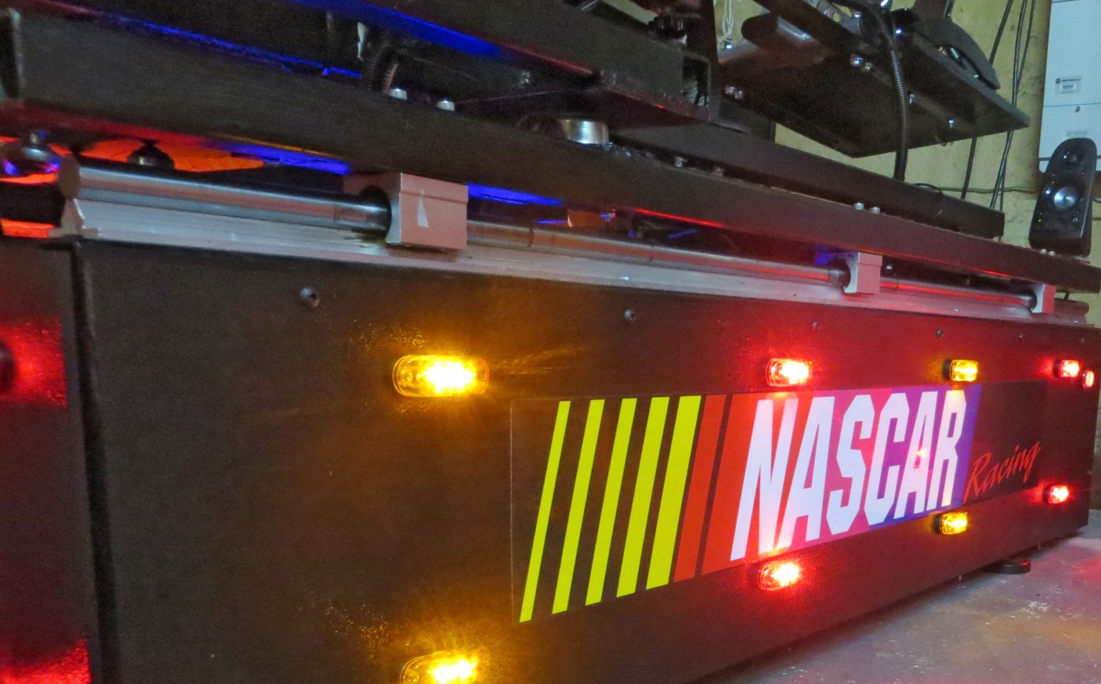

    updated pictures of this never ending project...

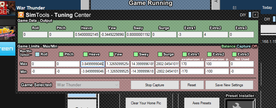

    Hi everyone, I am back and finally got around to setting up war thunder and have some questions.
    For some reason I don't get any movement captured on roll and pitch axes, pls take a look at the screenshot.
    Also I was wondering how you are handling switching between controls. Once I connected my HOTAS Warthdog, it completely messed up my AC settings and I had to reassign all controls. Is this a one time deal, or should I disconnect controllers that are not used for a particular game? I hope this is not the case.
    Lastly, could someone pls tell me where sim tools stores games presets so i could delete old ones i no longer need? I managed to mess this up as well and has to re0enter all the settings. It ios not very intuitive as you can't really select from the drop down list of the old presets, need to type the name and then it overwrites it.
    thx
