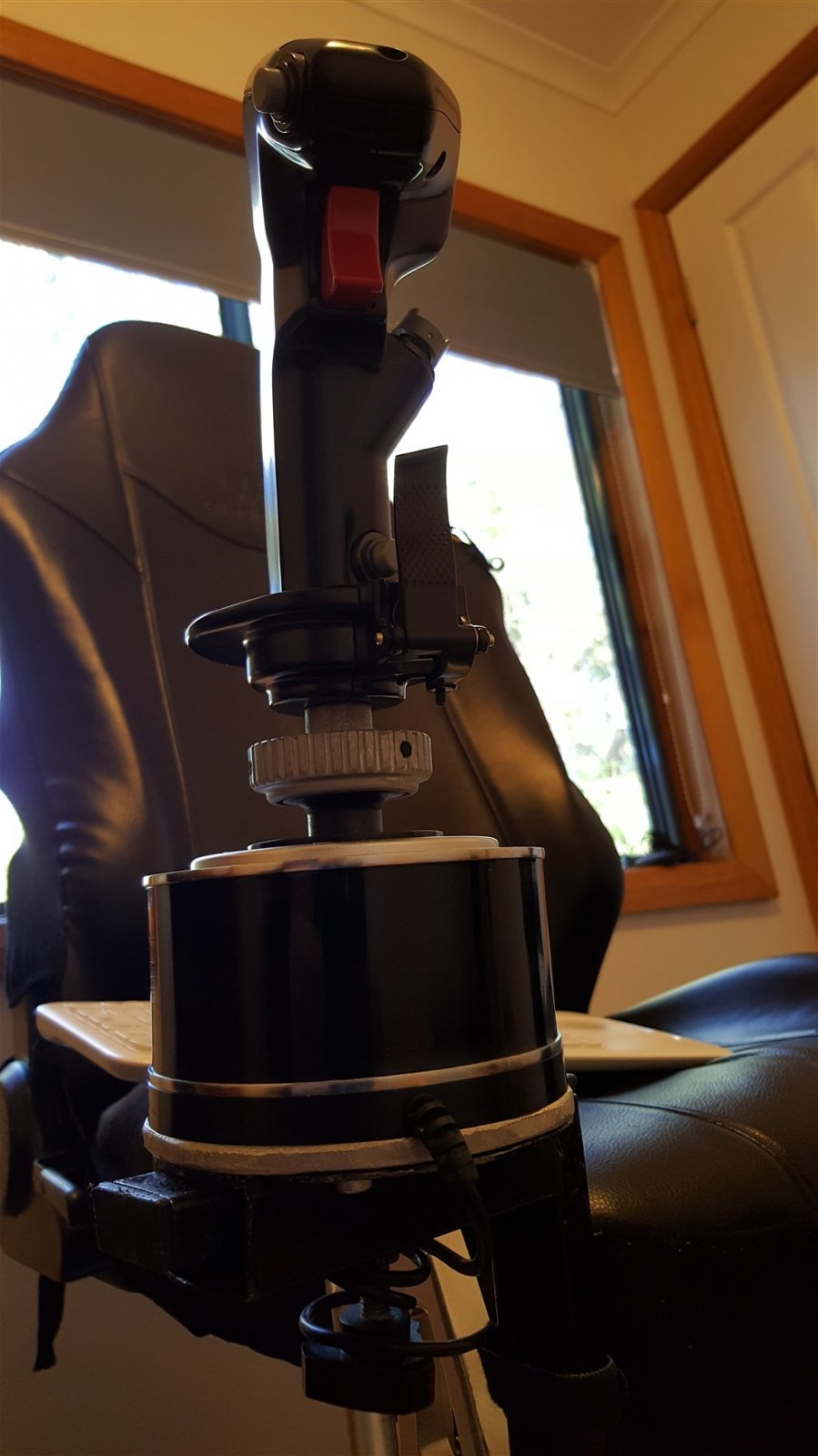

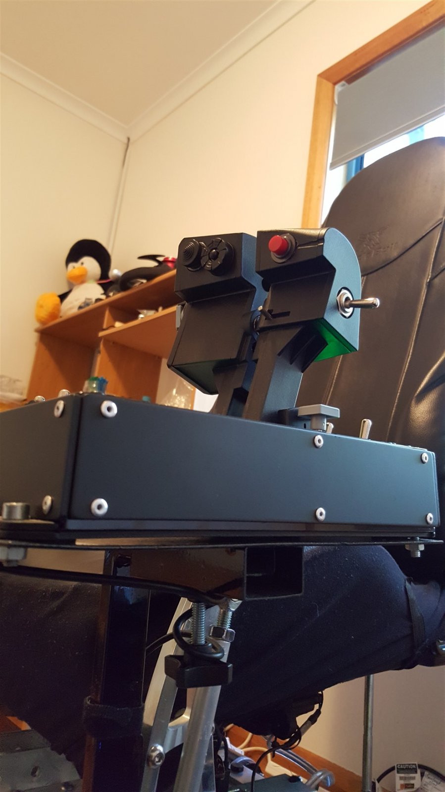

    Hey guys, HOTAS throttle control weights a ton. Since I will be mounting it to the chair armrest, it would be nice to get rid of that additional weight. I think this is just a dead weight so that unit stays put when being used. Anybody has any insights if this weight easily removable.

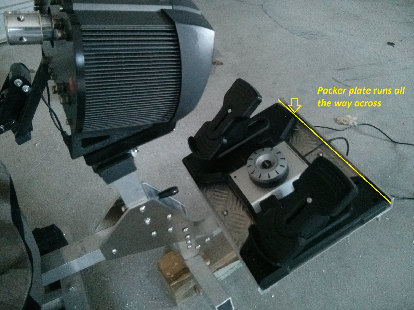

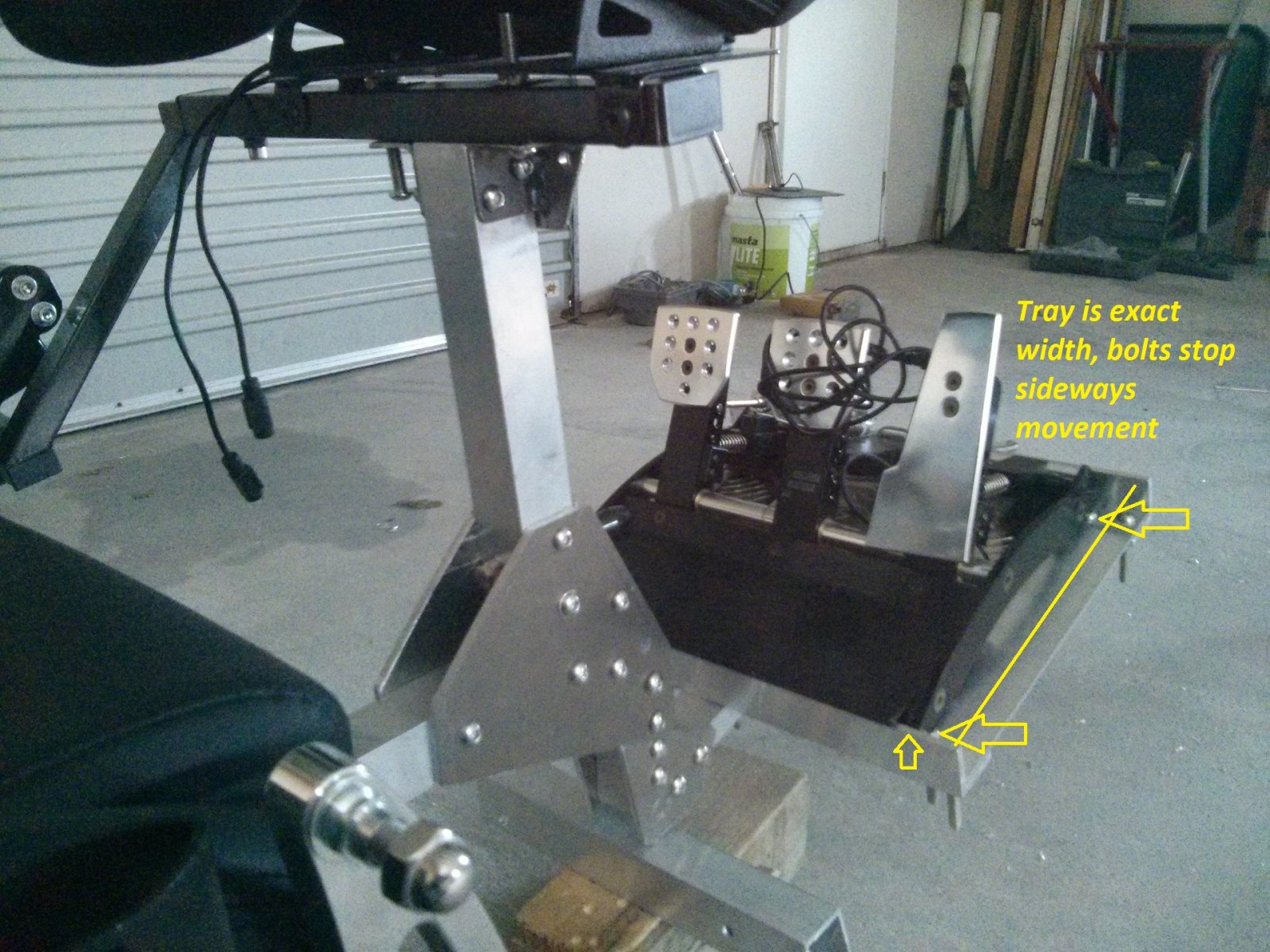

    Also, anybody has any great ideas on how to mount pedals so that are easily swapable between race / flight sim. I now have it bolted so it would be a pain to swap.

    I have a mount plate on a tube attached with a single thumbscrew for my Hotas quick release setup.
    My pedal tray is the exact width for my Clubsport pedals, with the front plate of the pedals slipping over the front tray aluminum angle and the bolt heads preventing sideways movement. Nothing else holds them in place other than the tray design and angle.
    I just lift the pedals out and put in the Saitek rudder pedals and they are held by a full width packer plate that goes on the back edge and again the position of the bolt heads stops them sliding sideways.
